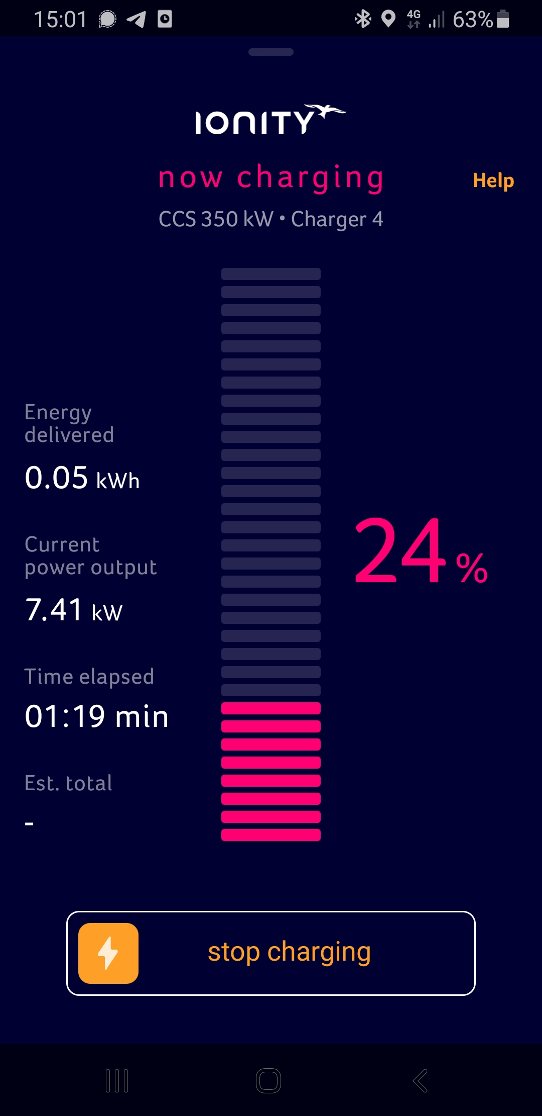

Ok so regards errors on the stations. Ionity gives no error. Efacec qc45 helpfully says : DTC4341.
Regards talking to the LIM with BMW tools its not too hard in theory. I have all the software like ISTA+ ESYS etc and an ENET cable. Problem is in the i3 the obd port is routed through a module called the BDC (Body Domain Controller) as we can't have those pesky car hackers getting access to CAN!!! So to get fault codes, live data or code the module to a car we would need something like a BDC simulator or a bdc itself :

I suspect the VIN for our purposes is a red herring. If we were just swapping a lim into an accident damaged car then its a big deal as it will not work if it sees the incorrect vin in 0x380. Now what would be super fun is to use a can bridge in a working i3 to kill 0x380 to the lim and see if it will still fast charge. Sadly though I don't have 20k to go buy an i3 for experiments:)
Anyway, I do believe my lack of ability to perform the weld test and lack of contactor close during ccs are linked. If it will do one it will do the other. So I think its down to one of two things : Wrong/missing CAN messages , hardware setup. I'll keep going...

You guys are gonna love this. Weld test now working on the bench with code posted above. No vins needed.
Genius here had the rely coils wired wrongly! I had one relay on both + and one on both -. Guess what? Its the same in the car. See, I warned you guys about leaving something as important as opensource ccs in the hands of a a moron. so it's really all your fault not mine...
Weld test will occur if
a) lim is started from cold, cp door is closed, ign turned on.
b)abnormal voltage detected on ccs pins, door closed, ign off then on.

Jack Bauer wrote: ↑Tue Jun 08, 2021 11:47 am
and c) the link voltage on 112h must be above 200V!

Update : Car wiring changed. With 2014 LIM fitted we weld test on ign on as per the bench. 2017 LIM no weld test. Pulled both lims onto the bench. 2014 cold starts with a contactor fault and then weld tests at ign on. 2017 cold starts with no fault but will weld test if one is generated by putting an unexpected voltage on the ccs dc pins. going to refit the 2017 and go visit mr.ionity.

Yeah pritty much. There is a bug in state 5 of my ccs state machine. I'll leave it there for you guys to find. Video soon.
So the LIM branch on the vcu wiki is what I used today. No vins or other nonsense required. Probably a lot of can messages on there that don't need to be. I'll camp out at a charger and chop off msgs until it stops working once the dust settles. In the meantime would super appreciate a bit of help to tidy things up in the LIM class and maybe give it a way to control current ramp, cv state etc and oh yeah a shutdown state would help:) Had to shutdown the session via the app which pissed the LIM off a bit. Interestingly it did a contactor weld test when I fired up the car to go home.

Oh yeah and the session went on for 20 mins. I had to stop it as the car was full so the LIM must have been happy from a CAN point of view.
