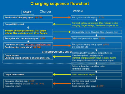

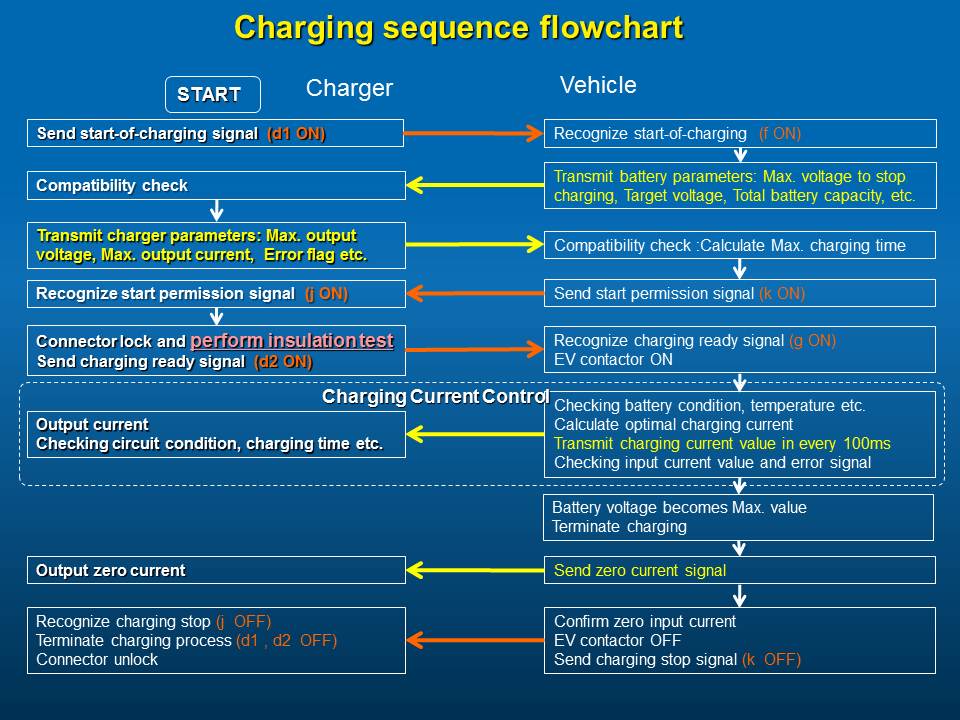

Alright, first cut down. Of course fully untested due to lacking charger.
https://github.com/jsphuebner/stm32-car/tree/chademo
So chademo.cpp just handles the CAN decoding/encoding. Sequencing takes place in stm32_car.cpp
So I will be disabling the relays 12V supply by the proximity signal. Additionally the inverter won't power up when I inject 5V into the VCU. So the inverter voltage will definitely read as 0.
So if 3s after startup there is no voltage reported by the inverter, I consider being in charge mode.
I stop sending the normal CAN messages and instead send the ChaDeMo messages. Of course the Nissan BMS CAN also stays active.
Next I wait for the charger to lock the connector, which it signals via CAN bit #109.5.2. 3s later I enable charging using bit #102.5.0
All other flags are unused...
I set a charge current as allowed by the BMS. I might need to add a ramp because it says 20A/s change rate.

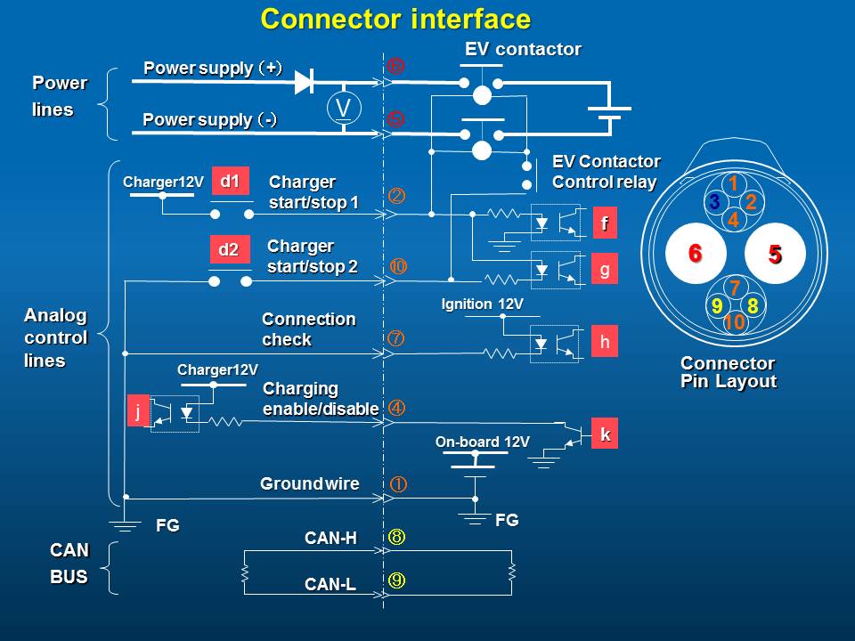

celeron55
Posts: 805
Has thanked: 39 times
Been thanked: 136 times
Post by celeron55 »
You need to send out the physical signals also in addition to canbus. Maybe I just didn't notice that in the code?
The standard says the charger not only has to make sure the signals you send out match the canbus flags, but also that the bus and the signals change in correct order relative to each other. I suppose not all chargers check the same things though.

celeron55 wrote: Wed Feb 12, 2020 11:24 pm You need to send out the physical signals also in addition to canbus. Maybe I just didn't notice that in the code?
No you're right, it's not (yet) in the code - so well spotted :)
I found the only signal that needs special timing is the "Charging enable" on pin 4. I will forego the "EV contactor control relay" as I just don't believe there are chargers out there that continue charging despite being told not to by CAN and the enable signal.
So "Charger start/stop 1" will power up the whole system and consequently it can only start sending messages then. The relays are then solely controlled by "Charger start/stop 1+2". I will reuse one of the "fuel gauge" signals (open collector output basically) as "Charging enable".
What is it with all those opto couplers?

I've been wondering about the optocouplers myself. Maybe it's just a way of drawing some relatively low impedance heavily filtered signals? There's no particular explanation or requirement anywhere.
Altough, at least in the Leaf PDM CHAdeMO is indeed implemented with the same exact optocoupler setup, as far as I cared to look into it.

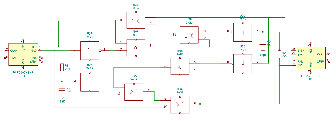

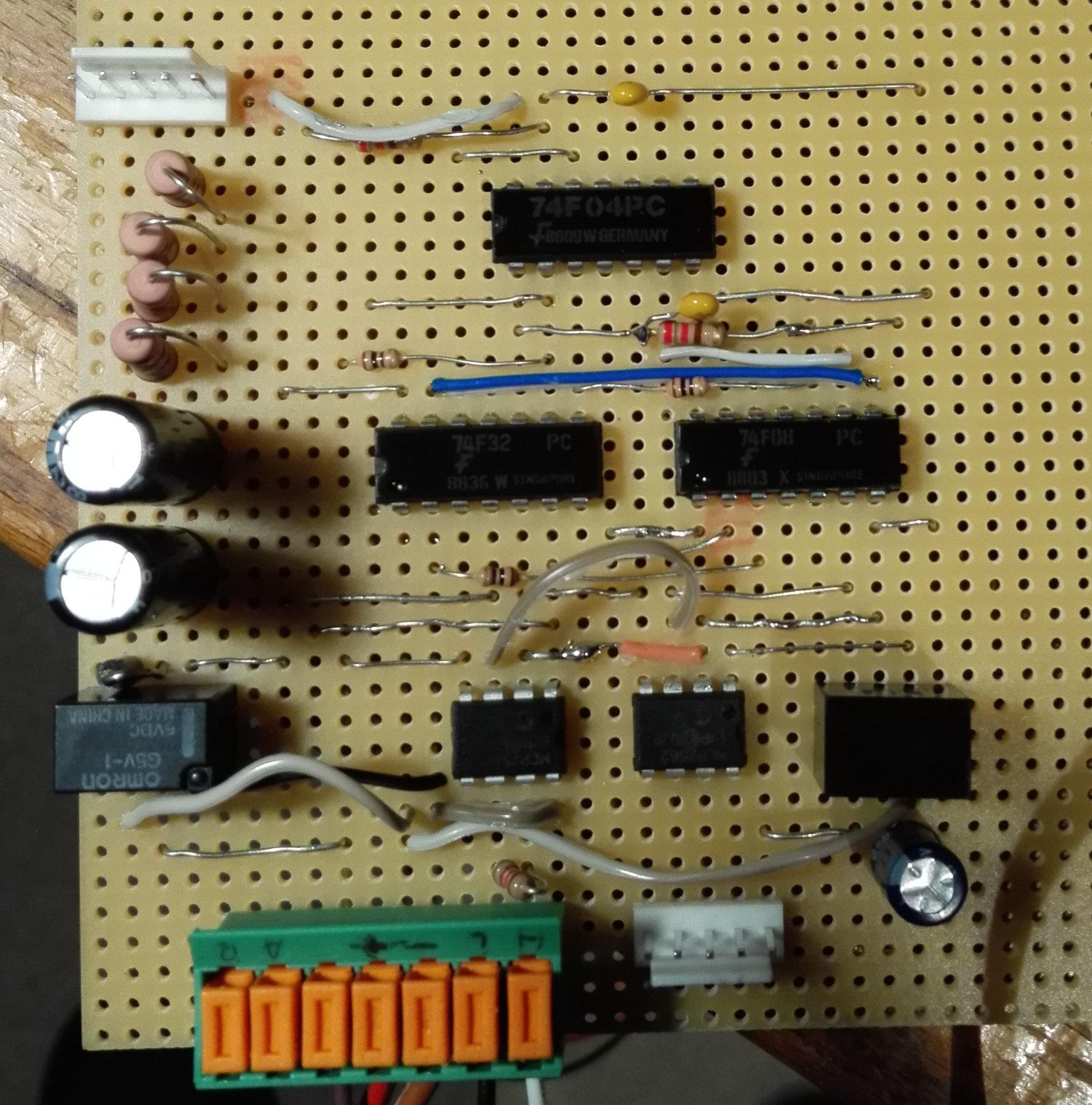

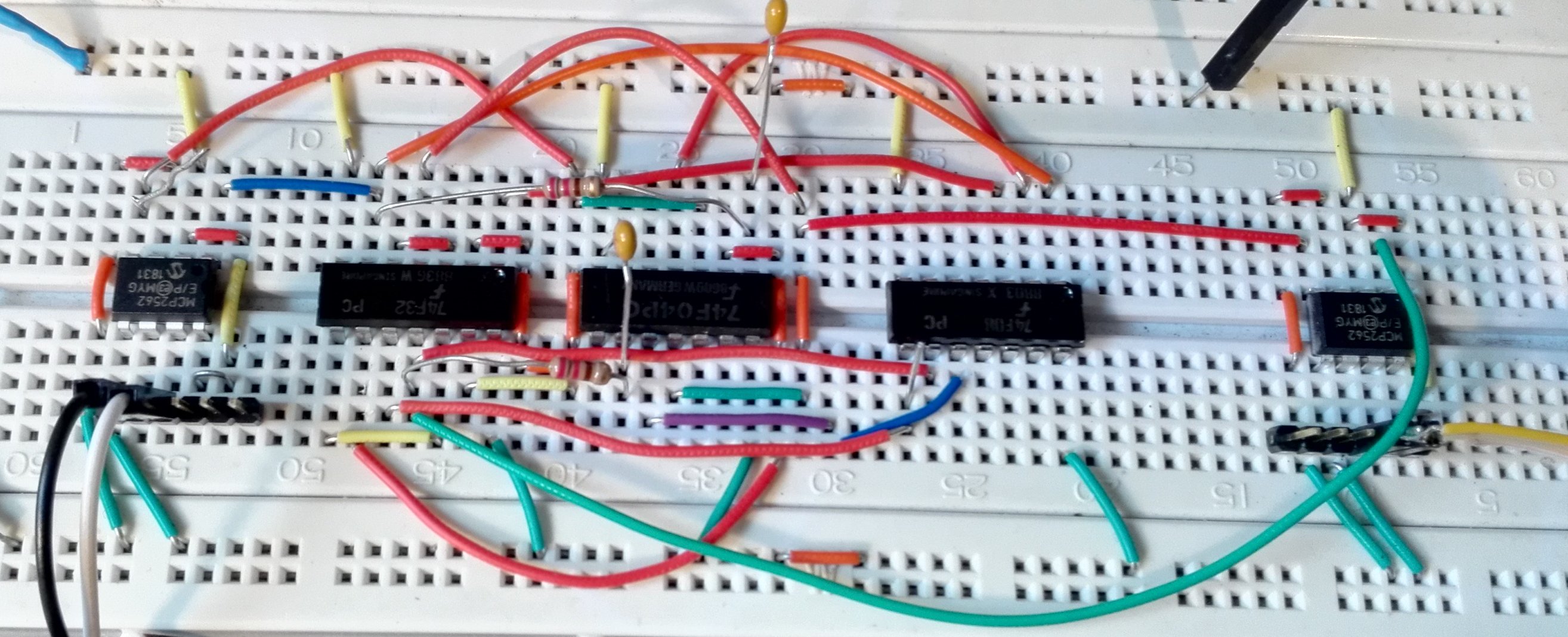

Last nights lesson learned: you cannot put two CAN transceivers back-to-back :(
In hindsight it's obvious: CAN transceivers always feed back the sent data to the receive pin so that the actual CAN interface may detect bus congestion. So what happens
CAN1H/L -> Transceiver 1 RX -> Transceiver 2 TX -> CAN2H/L -> Transceiver 2 RX -> Transceiver 1 TX -> CAN1H/L
Loop complete, permanent bus congestion. Looks like I'll need an STM32F107 just to act as a CAN gateway :roll:
EDIT: maybe there is a chance: http://www.ti.com/lit/ug/tidudb5a/tidudb5a.pdf
Been thanked: 1918 times
Yes, this works :) It opens the feedback loop.
Hail to my 74 logic collection :)

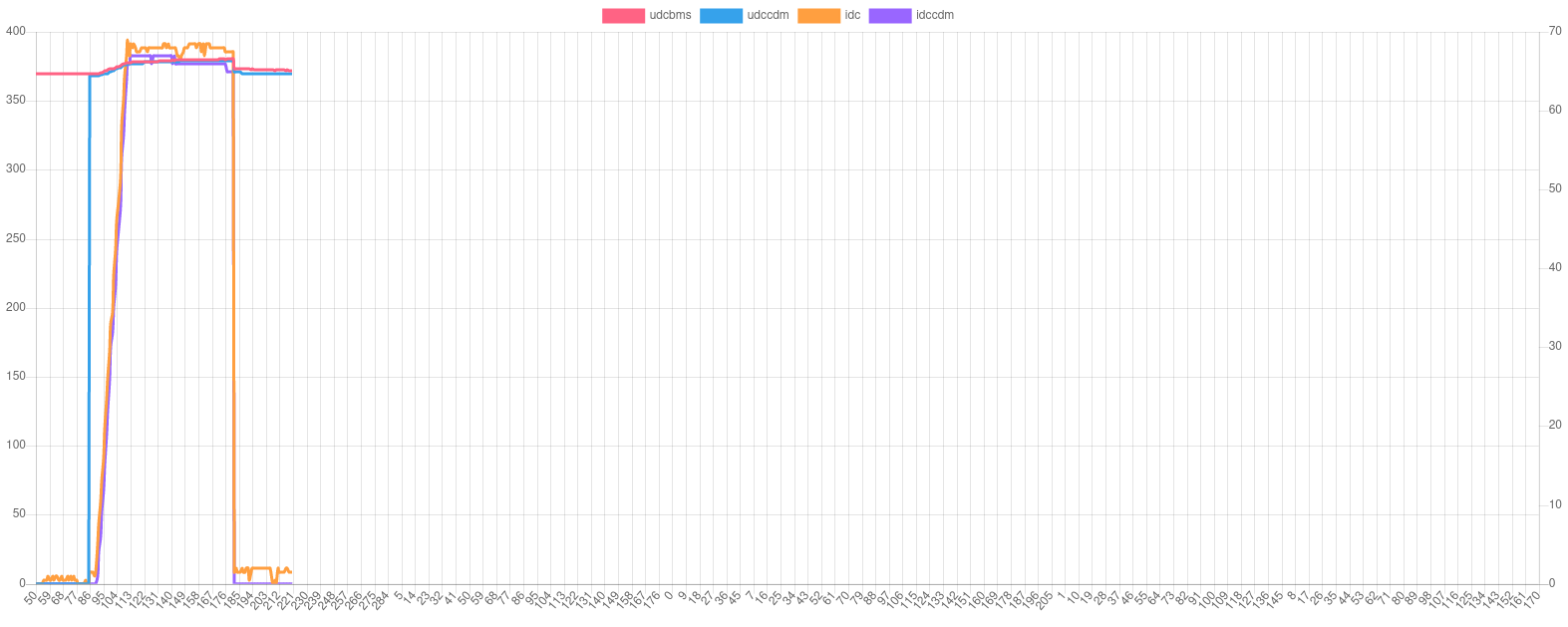

I decided to work on ChaDeMo a bit more. Drove to the local Peugeot dealer who has a fast charger and tried. Results:
- It doesn't work when ignition is off. Not sure why
- I reacted to what I thought was an EVSE stop request by sending a stop request myself - wrong! It's apparently just a status bit.
- I failed to send a current request
With that fixed the EVSE started charging but not for long. Most energy I ever got from it was 0.5kWh. It did successfully ramp up to 70A and reported the same DC voltage as the BMS but it always turns off after a short while. The target charge voltage is set to 410V, limit voltage to 420V but it turned off at about 380V. It just says "charging complete" and thats it. Any clues?
