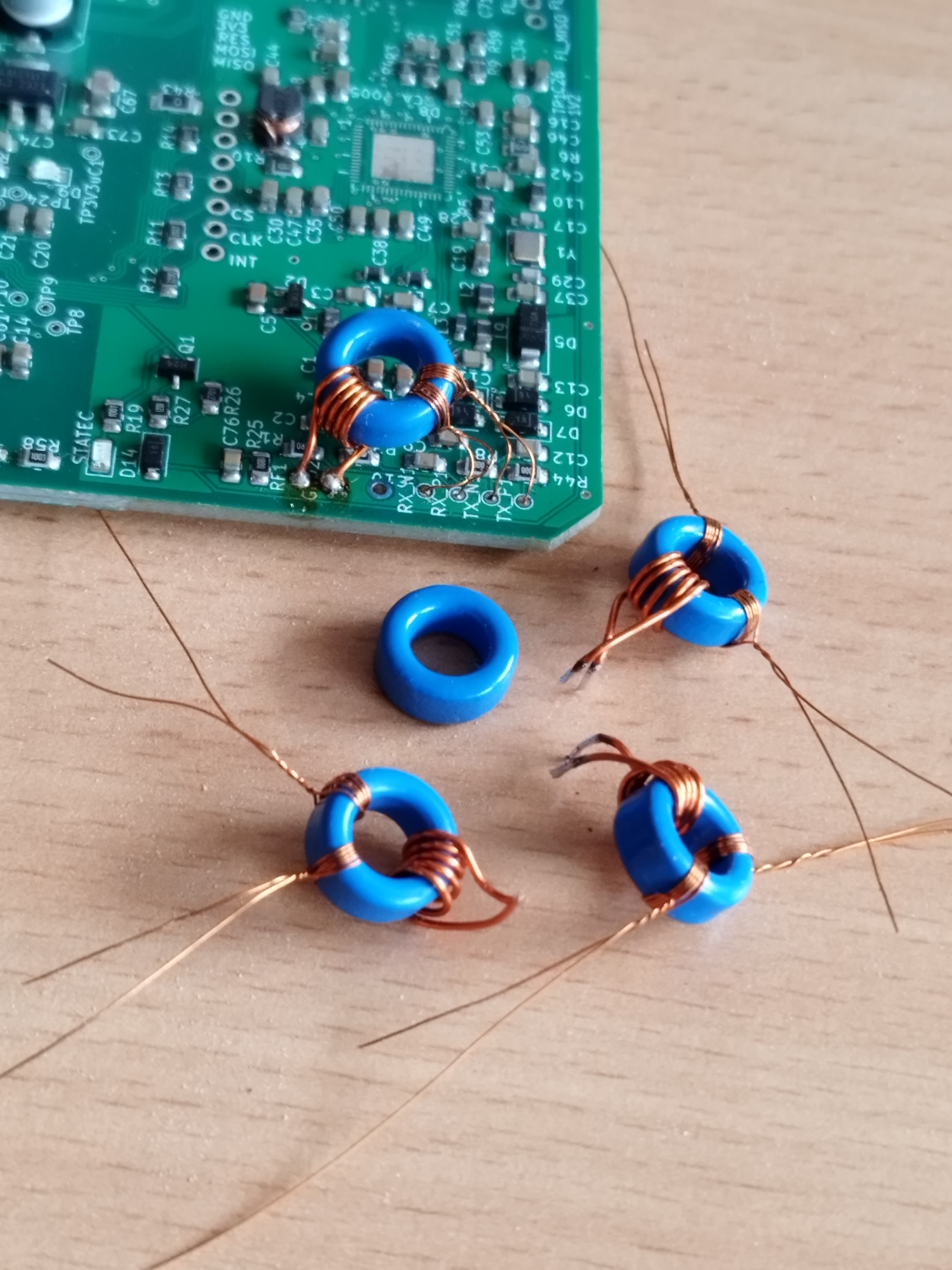

The parts which I have are organized by projectgus from an Chinese source (taobao or so), around 12 Euros including shipping. More details on page 1 of this thread.
- uhi22
- Posts: 1117
- Has thanked: 206 times
- Been thanked: 617 times
Re: Develop a QCA7000 board?

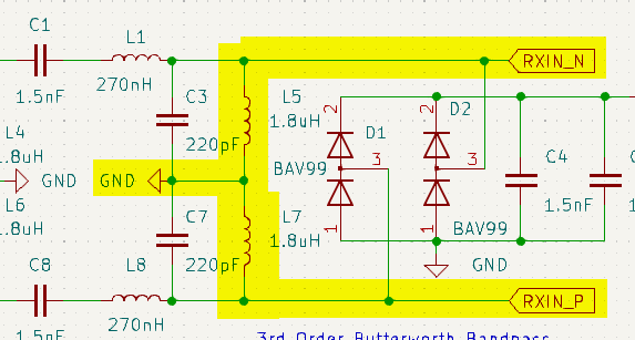

The core is a RIK10 from https://www.reichelt.de/index.html?ACTI ... =1&q=rik10. Each of the three coils windings has 5 windings turns.
One coil winding connects to MODEM_RF and ground. Second coil winding connects to TX_P and TX_N, and the third to RX_P and RX_N.
The mechanical solution is not really good, in terms of mechanical strength. There is the risk that something breaks in long-term use due to vibrations. The core should be fixed by something, maybe hot-melt-glue or something similar.

Very nice. They look different to whats on my board with 3 windings?

Yes, on the first boards I used the minimal approach, just shorted RX_N to TX_N and RX_P to TX_P. And used a core which I just had in my "Bastelkiste", and measured how many windings turns lead to a good signal. For the current boards I go the more official way.
Sooner or later, yes, of course. But no hurry, let's stabilize the things first a little bit.

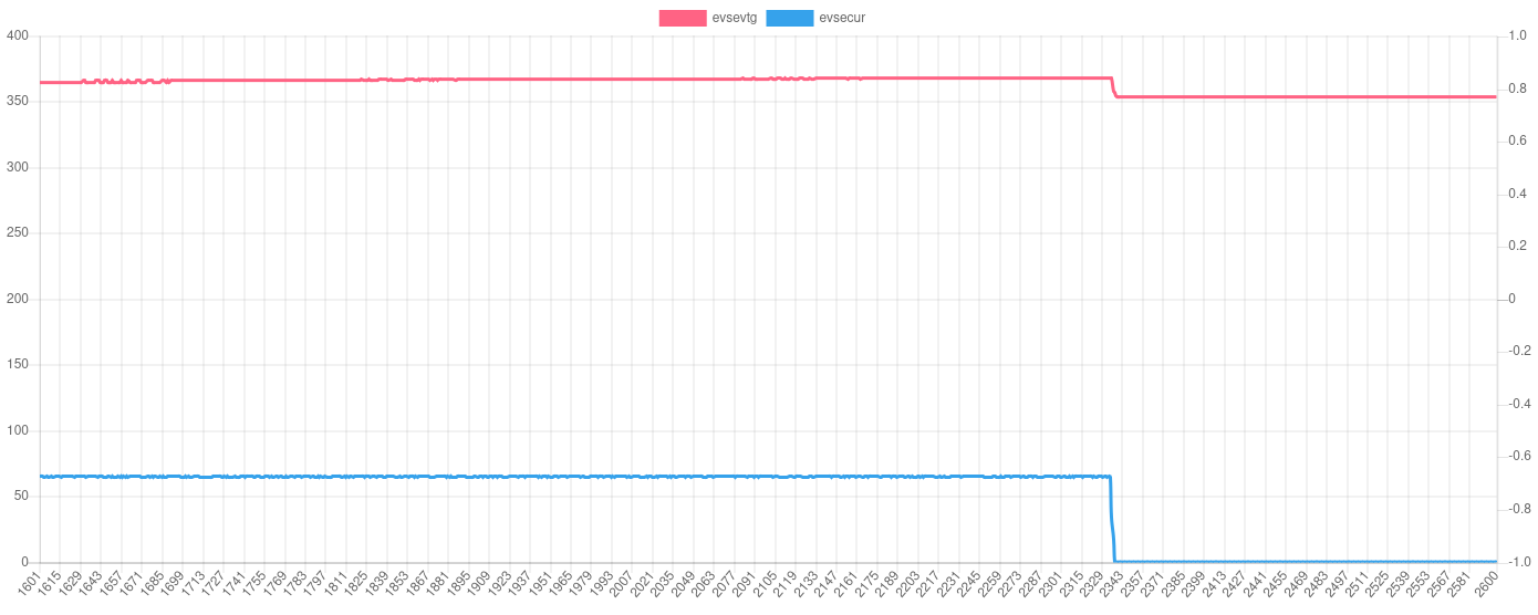

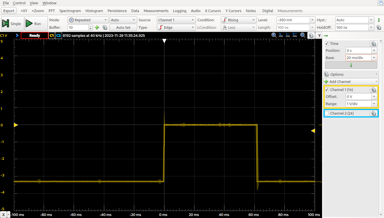

Trip to the charger with Clara
Result: I charged!
Result 2: just briefly
I tried 2 times and after like 30s or 0.12 kWh the charging session stopped. Log attached.
I noticed as soon as we're talking EXI CPU usage is indicated as 150%. Not sure what's up with that.
EDIT: checked the CPU usage calculation and it seems legit. It means it executes longer than 30 ms. I'm afraid we're only running every other round of the 30 ms task so it becomes a 60 ms task or something.
EDIT: read the code a bit, apparently it's a timeout because it goes to state 99 PEV_STATE_SequenceTimeout. But the timeout is 5s. Strange.
I'm experimenting with DMA for SPI transfers. No improvement so far because now it just waits until the request is complete

UPDATE: that was easy! It's the trace outputs that slow it down! Upped speed to 1 MBit which makes them unreadable (maybe uart4 doesn't like high speed?) but now runtime is normal and CPU usage 50%.
Will work on that.
I think I will give two boards to a local company so they solder the difficult parts.
Anyway, I did some runtime analysis (thanks for all the test points!). As expected the overall runtime is 60 ms: And the main processing time is spent in spiQCA7000checkForReceivedData() and of course the state machine Will look into it deeper. If it is the exi decoding then there is nothing we can do I guess. Would 60 ms still be acceptable or will chargers dislike that?
I will look into making data exchange with the QCA more efficient but that only saves 10ms at most.
Will work on that.

No need to. Got cpu usage down to 3%
A faster controller doesn't help when waiting for a UART to finish sending stuff
I've removed the in-place traces and now spit out the current PEV state in the idle task. Might add more debug info there.

Progress with the boards. Finally all five are talking to my "demo evse" (aka pyPLC with AR4720). The most interesting finding is a bug in the schematic, that was not detected with the older boards, because I never populated the RF filter components. With the filter populated, the QCA is nearly deaf, it does not hear the evse, only by chance. All five boards with the same symptoms, so it must be a systematical issue. And it is. The receiver inputs of the QCA are biased to around 1.6V. But my "bugfixed" circuit pulls them to ground, and the receiver input does not process the signal without the bias. As workaround, removed the L5 and L7, and now everything is fine. The original millisman design did not have this ground in the middle, and I considered this as bug, so I "corrected" it quite in the beginning. Will roll this back.
Need to test the peripheral functions (temperature sensing, voltage sensing, connector lock, ...) in the next days, but at least the hardest part is done now.

Great, thanks for testing. It confirms, that the thing is quite instable at the moment. I guess it is just random behavior, not really related to certain chargers.
In best case the complete received and transmitted ethernet traffic. ( I'm still dreaming to have a device which just listens to the homeplug and allows to make a trace in wireshark, but nobody has an idea how to enable the "transparent mode" of the homeplug modems, so that all traffic is routed. Somehow this must be possible, because there are commercial sniffers, like https://www.vector.com/de/de/produkte/p ... e/vh5110a/# )
Should be not too complicated, f0ld already had a look, not sure about the results.
