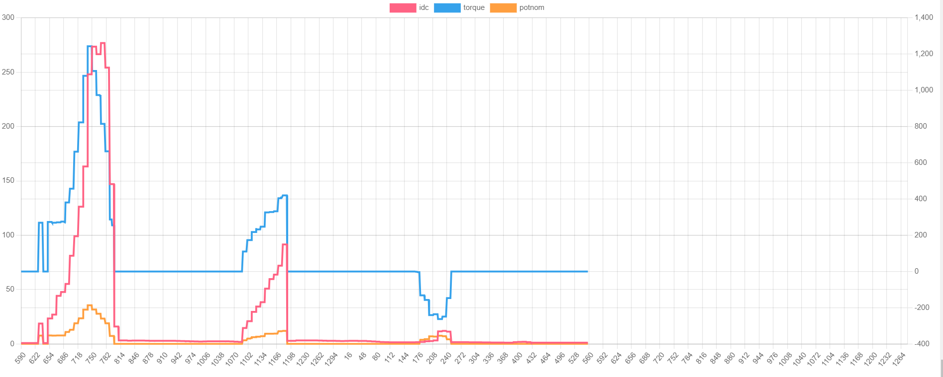

tom91 wrote: Wed Feb 28, 2024 12:19 pm So currently you are hitting +/- 110-120A consistently, has your voltage been dropping and you not charged when doing tests over the past week?
It is very likely that you are hitting a discharge power limit.
no batt volts doesn't drop much and I've set any batt min limits 50v below that

I've sent you a bin with a change from Tom, possibly fixing this limit issue. God Speed

Bigpie wrote: Wed Feb 28, 2024 1:17 pm I've sent you a bin with a change from Tom, possibly fixing this limit issue. God Speed
Thanks Jamie, Andy please keep to a conservatie throttle max for now, we want to see if the IDC levels off as quick now. Should theoretically not be the case so the torque will carry on for longer.

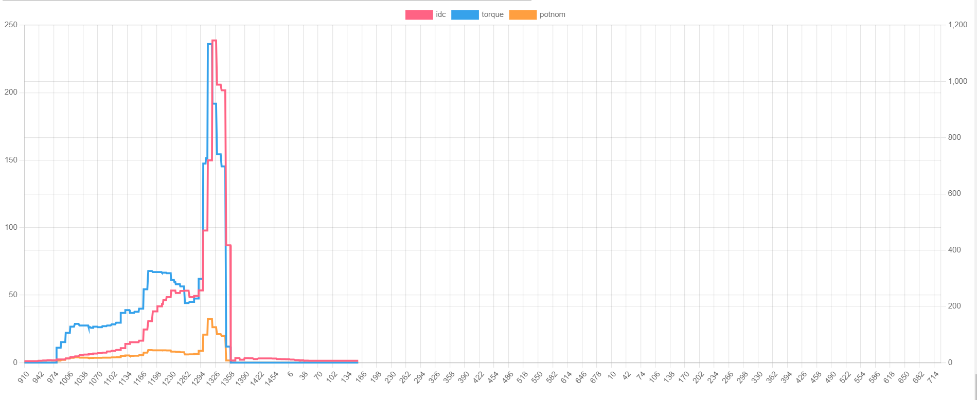

tom91 wrote: Wed Feb 28, 2024 1:22 pm Thanks Jamie, Andy please keep to a conservatie throttle max for now, we want to see if the IDC levels off as quick now. Should theoretically not be the case so the torque will carry on for longer.
Too late :lol: :lol: :lol: :lol: :lol: :lol: :lol: :lol: bloody awesome
After these 2 runs I floored it and span the wheels half way up the road, my neighbours are so pissed :o most of the juddering has gone I feel a lot of what's left may be the backlash in my diff I'm not sure it will last much longer with that torque :lol:

Now thats more then double the current draw, and no flat point insight on the current draw. Better get the car ready for some higher speed acceleration tests. :)
