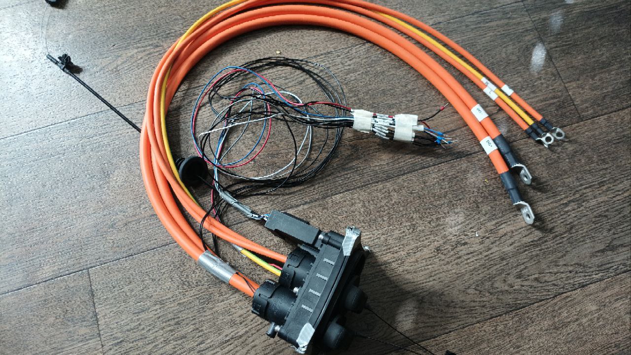

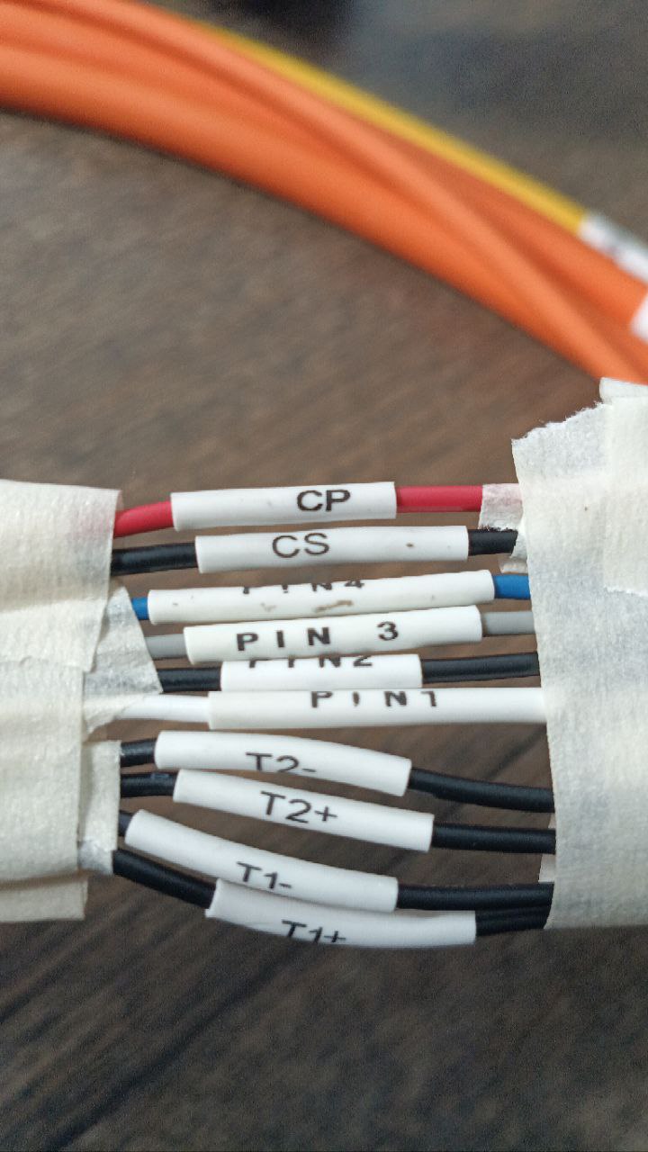

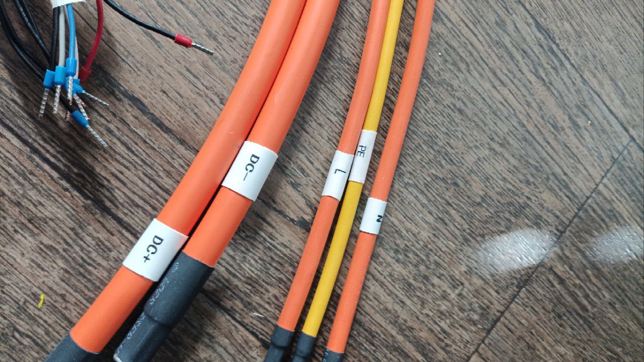

For example this is the CCS1 (USA) socket I got from China:
I see CP in the wiki but not CS,
I do not see PIN1,PIN2,PIN3 and PIN4.
Would be nice to have a video with an explanation on what is each pin, what is does and how to connect it.
I have 3 temp probes. WIKI specifies a 10k resistance, but I do not know if I have to add one to mine.

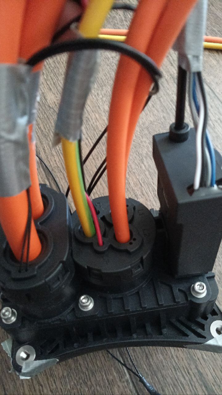

Since we do not know the data sheet of this charge port, we just can make some guesses, and you need a multimeter to check whether they are true.
Seems we have two temperatur sensors. Measure the resistance between T1+ and T1-, and between T2+ and T2-. They should be nearly equal. Measure in the other direction. Should lead to the same results. This would confirm, that we have two temperature-dependent resistors (and not other sensors like diodes or onewire or whatever). If these are resistors (NTCs), connect one end to ground and the other to the Focccies temperature inputs. Foccci has three of them, but we have only two in the charge port. This does not matter, we leave the third unconnected. Foccci interprets this a large negative temperature, this will not hurt, everything fine. Since there are different possibilies of the NTC characteristics, it is necessary to set parameters for the NTC. You can start with default settings, and check whether Foccci shows the correct temperature. Try at leat with two different temperaturs (put the inlet into the kitchen stove and heat e.g. to 80°C). If there is no data sheet of the NTC, it may need some measurements to find out the parameters.
Next is the CP, this is easy, just connect to Focccis CP.
The CS is unusual, but I guess they connected it to PP. Use multimeter to confirm. Also measure the resistance between PP and PE. Some charge ports have a resistor inside, some not. Foccci needs to know this.
The most difficult is the charge port locking. Usually this consists of a DC motor and a feedback switch. So I assume: Two lines for the motor, two lines for the switch. Try to find out using resistance measurement, which pins are the motor. If this is clear, try with a lab power supply to actuate the motor in both directions. Start with 5V and current limited to 100mA, to not destroy anything. If this works, check wether it looks okay to use 12V. If the motor turns fine with 12V in both directions, you can connect the motor lines to Focccis motor outputs. Connecting the feedback lines is optionally, you can configure Foccci to just operate the motor for one second. If you want to use the feedback, measure the resistance in locked and unlocked position, and connect one feedback line to ground and one to the Focccis lock feedback input. Set the parameters in Foccci to match the physical situation.
PE is chassis ground, and needs to have a short path to Focccis ground.
(Edit: Added more details to the pin description in the wiki.)

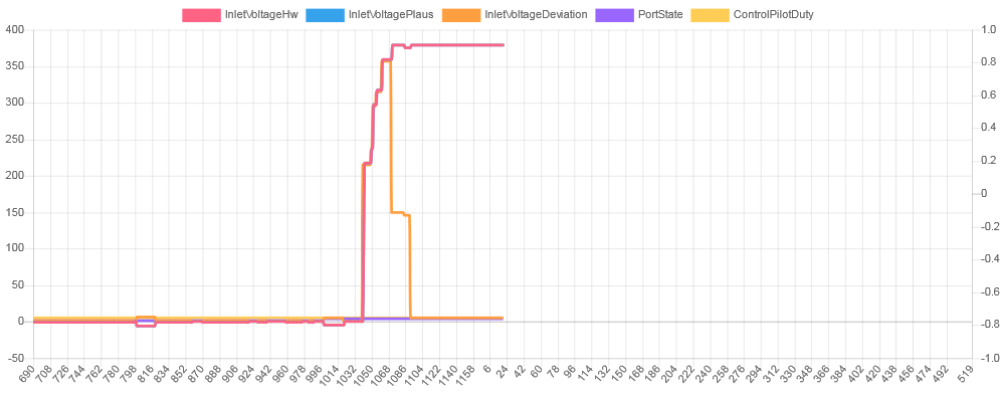

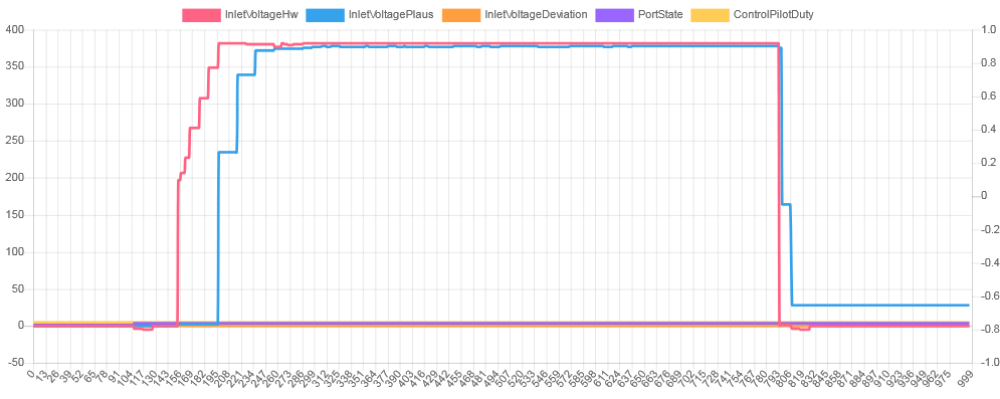

While charging is working, could you look to the spot values
InletVoltageHw and EvsePresentVoltage? They shall be nearly the same.
And InletVoltageDeviation shall show the difference.

I have made further attempts. When I take the DC voltage from the charger output, it works. I think the problem is checking the difference in connection with a time offset!
Image with charger output
Image with analog input
