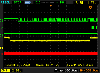

I finally logged the REQ line along with the comms data, looks similar enough to what was seen before. Although it looks like one transfer is aligned with one edge of the REQ line and the other transfer is aligned with the other edge.
D1 = MTH Data (120 bytes) (Happens first on one edge of the REQ signal))
D2 = HTM Data (100 bytes) (happens second on next edge of REQ signal)
Yellow = REQ Line (CAN+ Side)

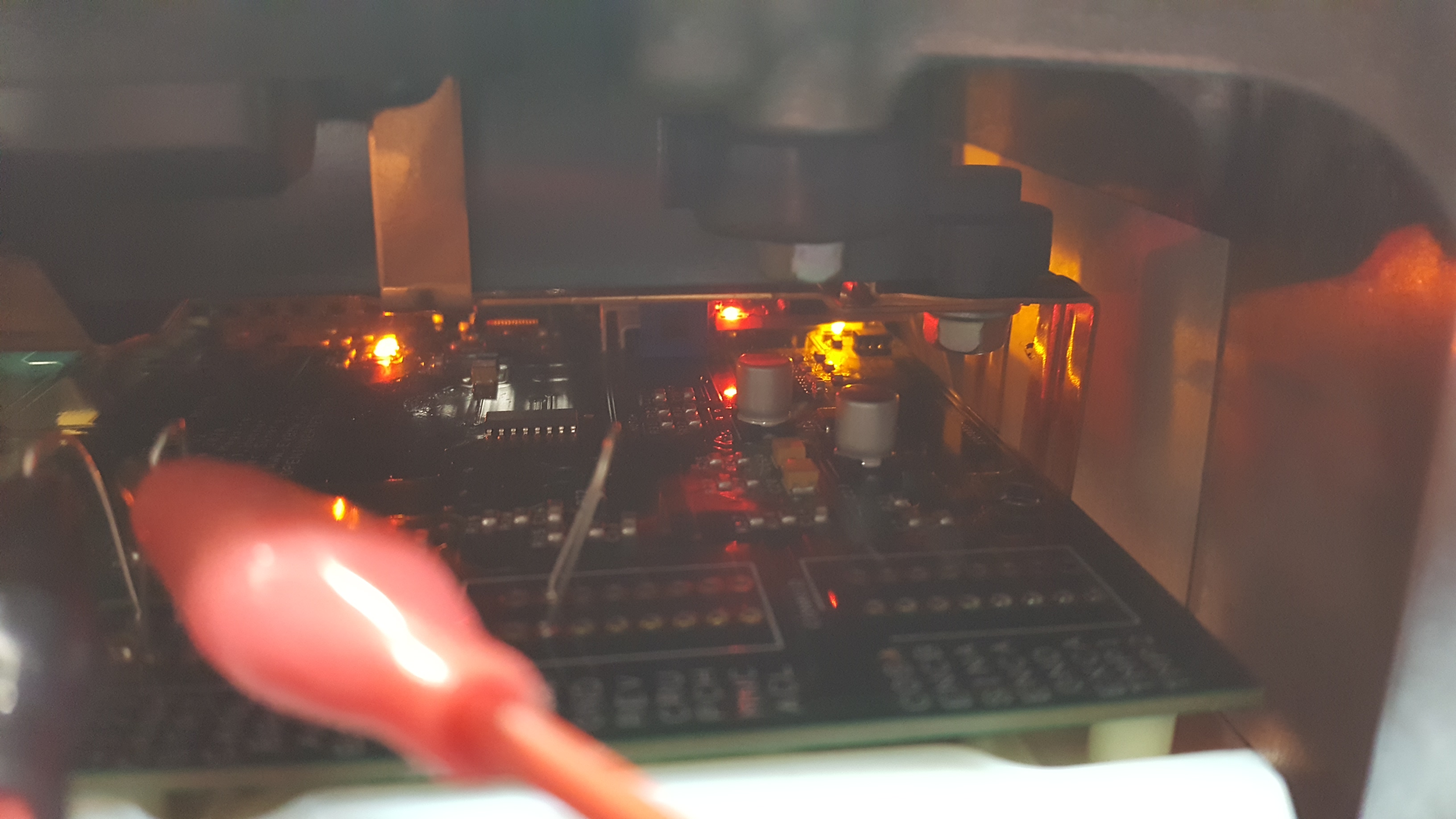

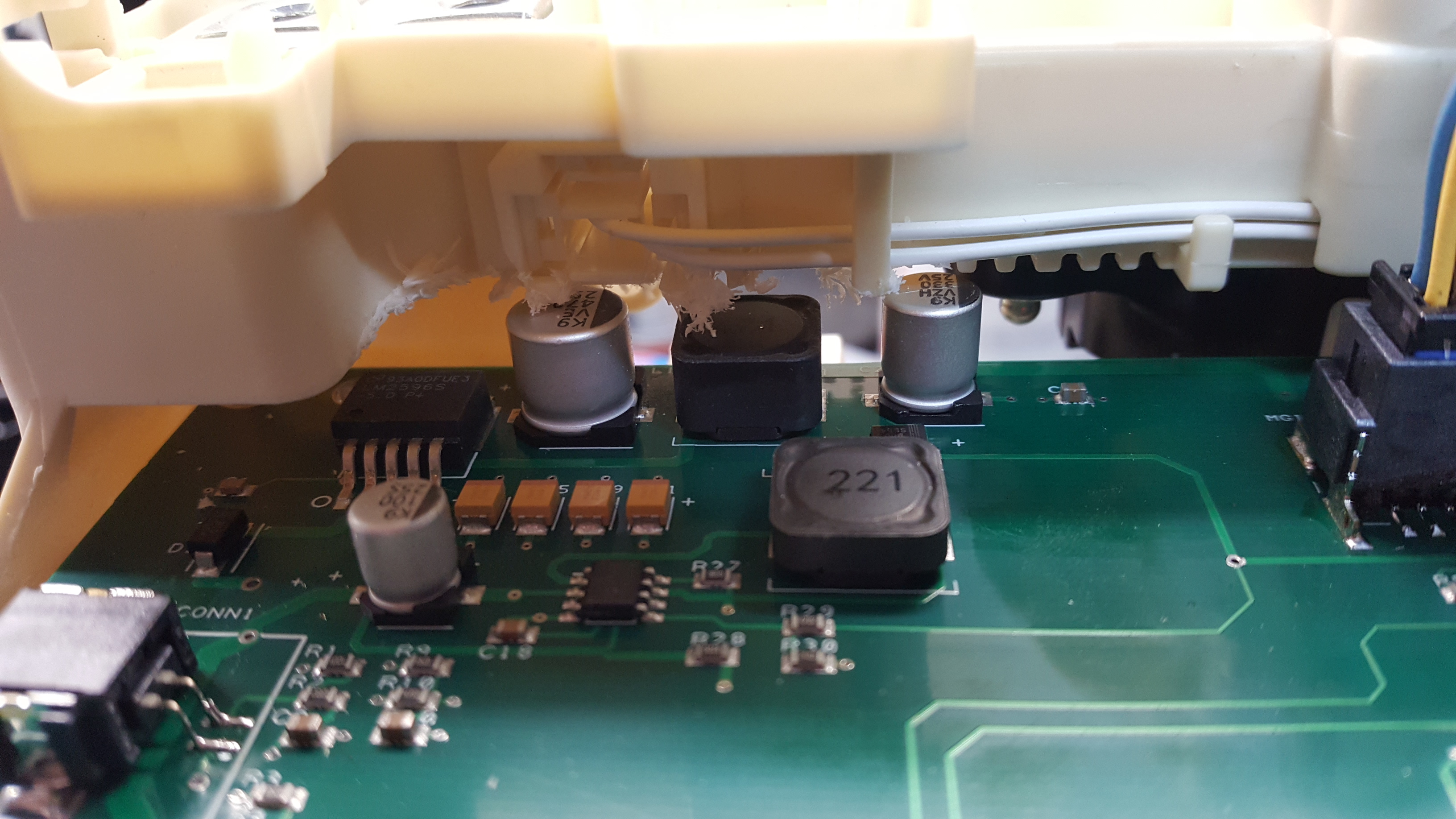

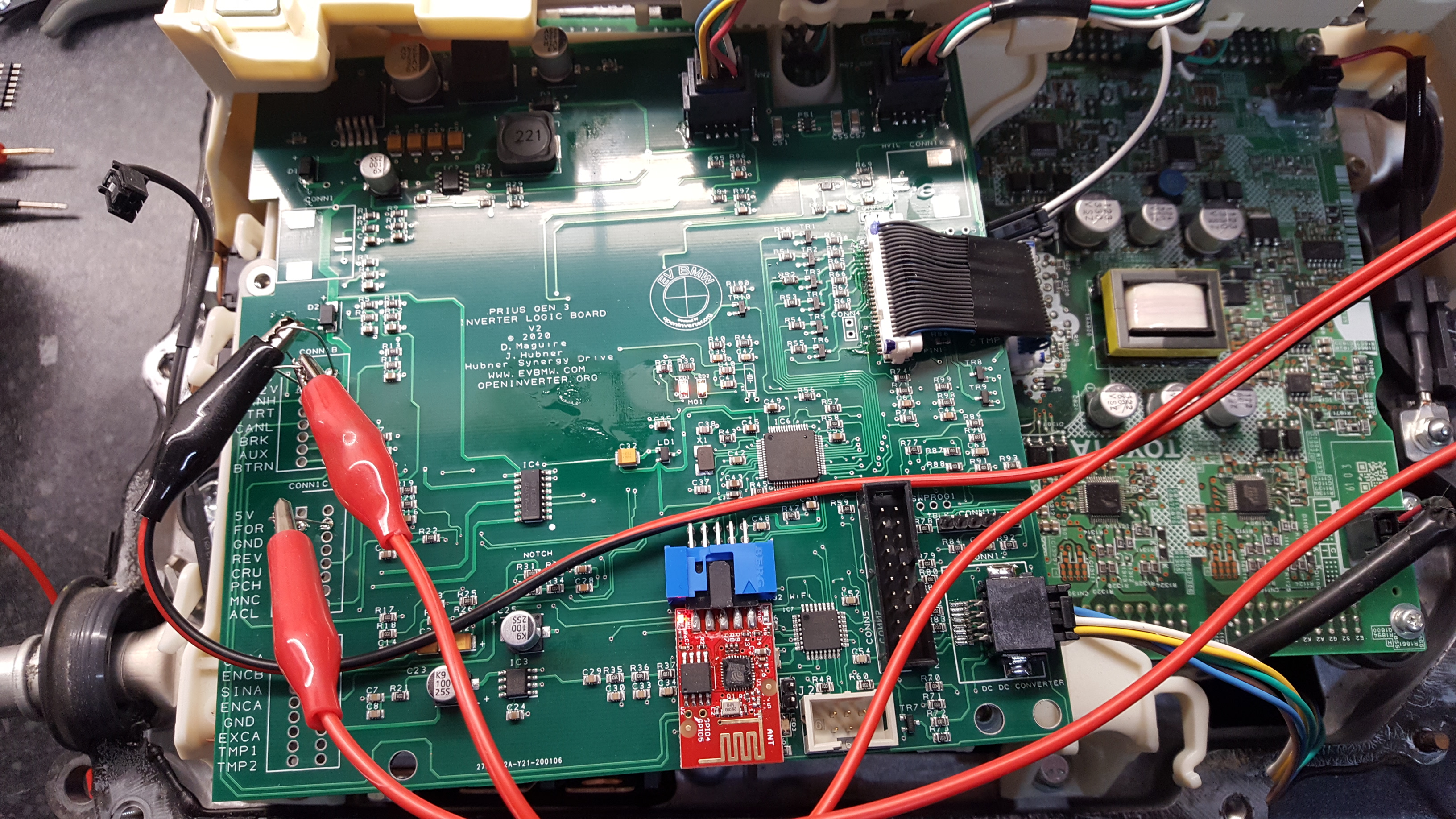

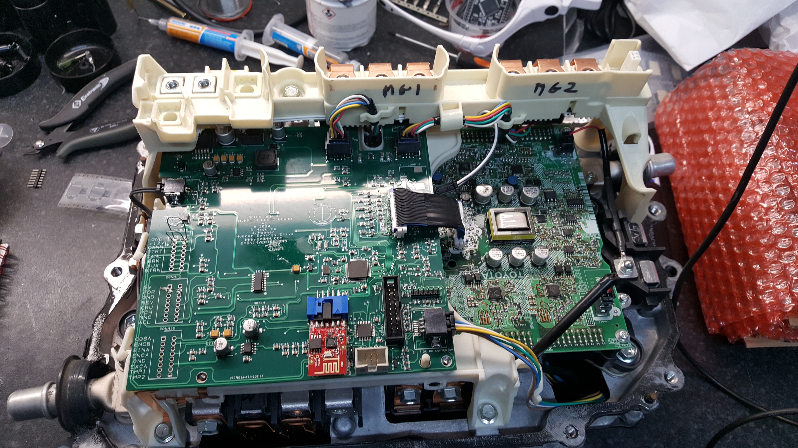

So first look at the new Prius Gen 3 from JLC.
First, my mistakes :
1)D1,D2 and D3 incorrect polarity
2)R28 needs to be 1k not 330R as the red led that JLC use looks like a 5Watt laser at 10mA (The goggles,they do nothing).
3)LED2 and LED3 missing from BOM.
4)R52 (100R) missing from BOM.
5)C26 330uF 25V cap on the 26V line......not a good idea:)
6)Need to have a notch indication on the silkscreen for Conn2 and Conn9 (current sensor connections). Towards top of pcb.
7) The 5v power supply section will need to move to the center of the board as the main smoothing cap and 470uH inductor are fouling on current sensor mounting plastic.
8)I'd forgotten the Prius inverter is much happier at 4.4kHz than 8.8 so need to change filter caps on resolver amp.
Now the good news. Everything that JLC did is perfect. The inverter stage programmed and runs perfectly. Ditto the atmega328 for boost converter control. No wrong parts, no solder mess etc.
Full power up test on the inverter went fine. Pumping out pwm, reading the inputs, current sensors etc. Next phase will be fitting the inverter case back together and running a motor.

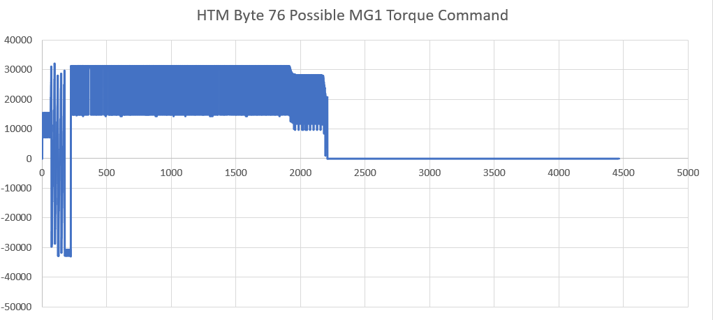

On the GEN3 protocol, it looks like the MG1 toreque command could be in the same position. Here's a graph of an engine start.

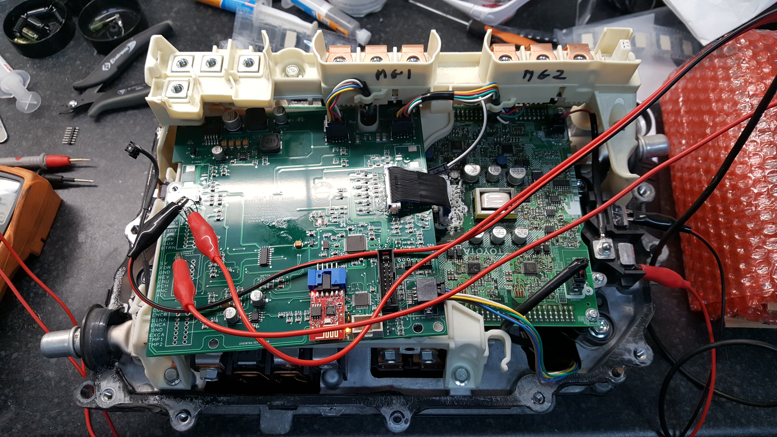

Posts: 4006
Been thanked: 1136 times
Re: Prius Gen3 Inverter Hacking
So with a little hacking of the plastic current sensor mount it all fits. Once the terminal blocks turn up I'll complete the board and start testing.

The board will be redesigned to move the parts that foul on the case. Stuff like this is the very reason I didn't just dump the design files out in public:)
Regards the Yaris / Auris board this will need to be a new design. Not just because the size / hole placements and different current sensor connectors but mainly because the 50 way connector to the igbt board uses a different pinout to the prius. One thing that people could do to accelerate the process would be to work out the pinout.

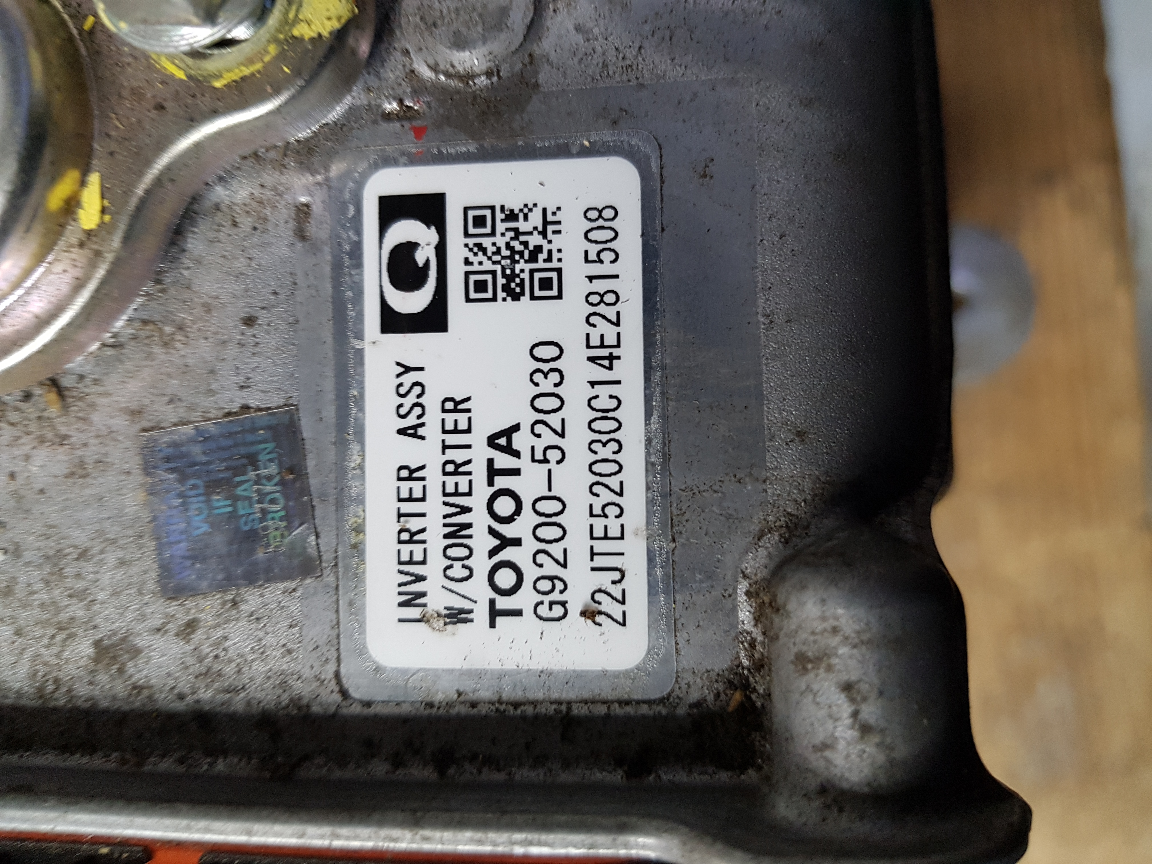

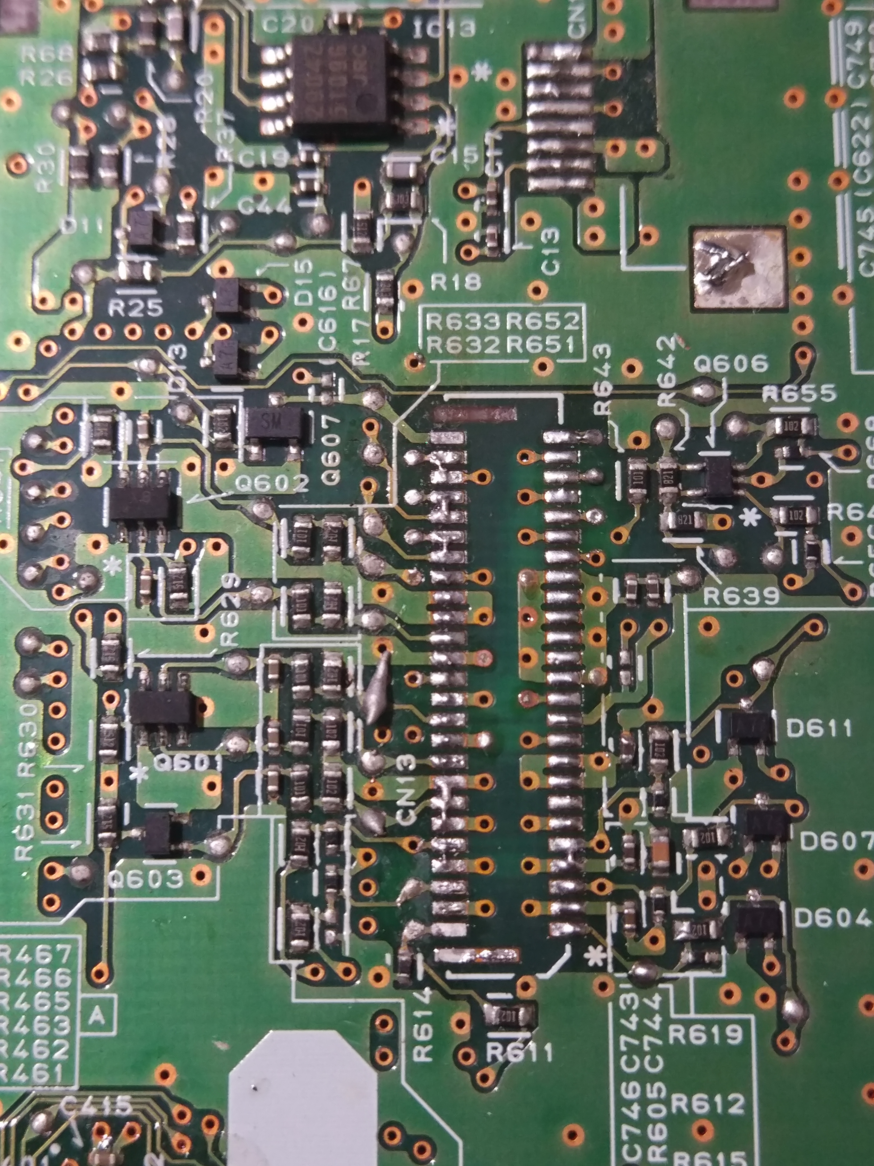

Posts: 3796
Been thanked: 413 times
I am already working on auris/yaris charger and first I was stumped. I setup everything and started to run the boost section, but inverter would just tik at me.
I belive you would have to use damiens first prius board which has separated outputs. I will try applying 300v DC to battery input and control transistors...

One more idea regarding Prius and Yaris support on the same board - we can have two places for that "unobtainium" connector and mount one or another (matching used inverter). As of now we could also use Prius board (one connector, but with additional holes for screws) and switch wires in the cable - the one coming from Yaris IGBT board.
Posts: 3796
PatrykS wrote: Sun Jan 19, 2020 4:08 pm One more idea regarding Prius and Yaris support on the same board - we can have two places for that "unobtainium" connector and mount one or another (matching used inverter). As of now we could also use Prius board (one connector, but with additional holes for screws) and switch wires in the cable - the one coming from Yaris IGBT board.
Yeah... good luck about that. I dont think changing wires in white connector was Toyota engineers idea when they designed it.
But i would like to make a comparison. Does anyone have a Prius (not Auris) main board with white connector removed? I would like to see a closeup photo of the area nder the connector to compare to my Yaris/Auris board. See my Auris board closeup.

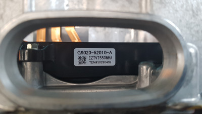

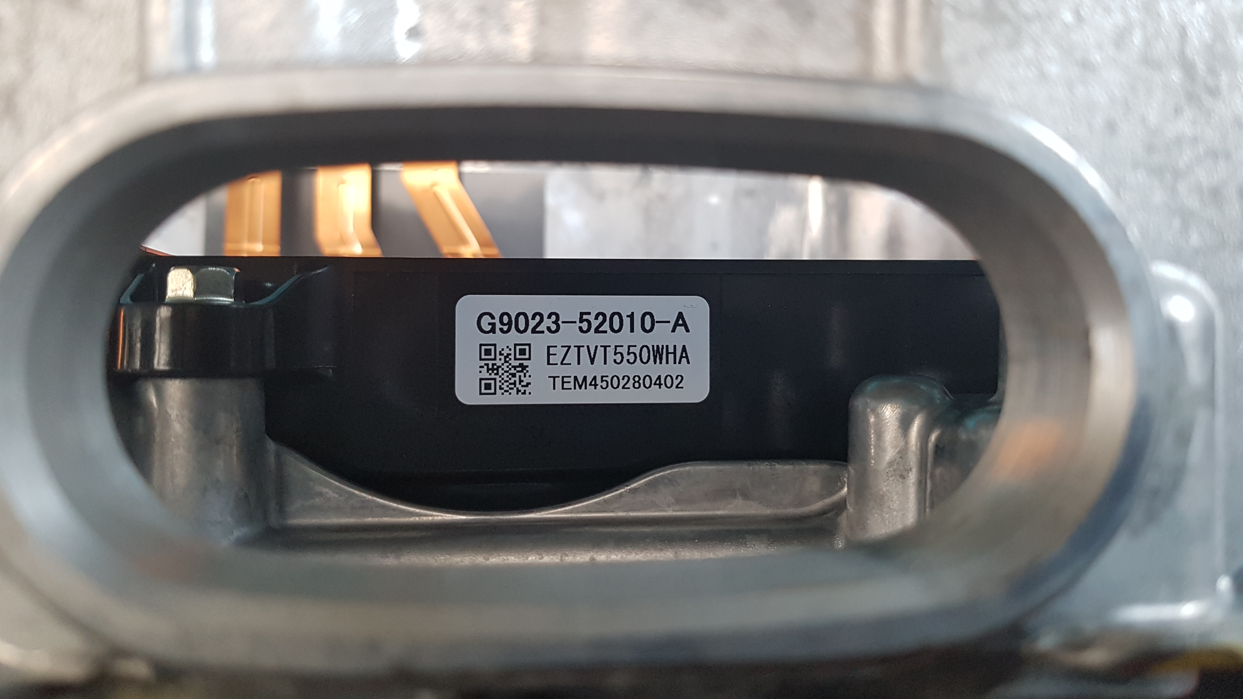

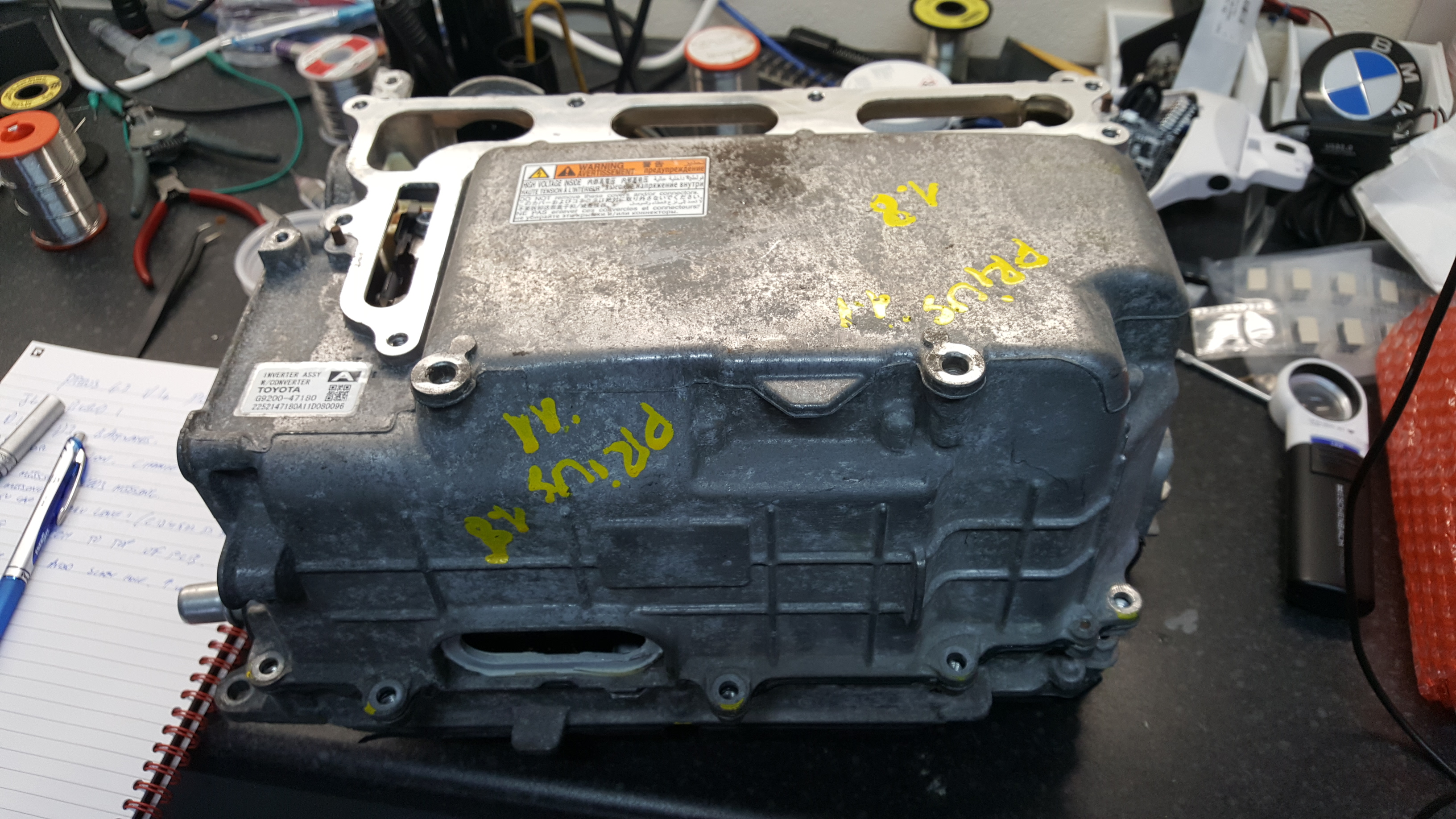

Stephen Darbey
Posts: 77
Joined: Tue Jan 15, 2019 10:49 pm
Post by Stephen Darbey »
Yes I have a 2014 Auris inverter. I will take photo of Id label and post, to check. I hoped it was the same as Prius (inside)

Posts: 3796
No Prius has larger main board than Auris and Yaris.
I would like to see if Prius PCB top layer in connector area is any different from Auris/Yaris one.
What i have posted is Yaris board and it is totally the same as Auris board.
Stephen Darbey
Posts: 77
That's very disappointing. It does however explain what it was considerably cheaper

Alexstarex
Posts: 28
Joined: Mon Jan 13, 2020 1:53 pm
Location: Russia
Post by Alexstarex »
Stephen Darbey wrote: Sun Jan 19, 2020 9:00 pm Yes I have a 2014 Auris inverter. I will take photo of Id label and post, to check. I hoped it was the same as Prius (inside)
Only the inverter from a Toyota aqua is similar to a prius
