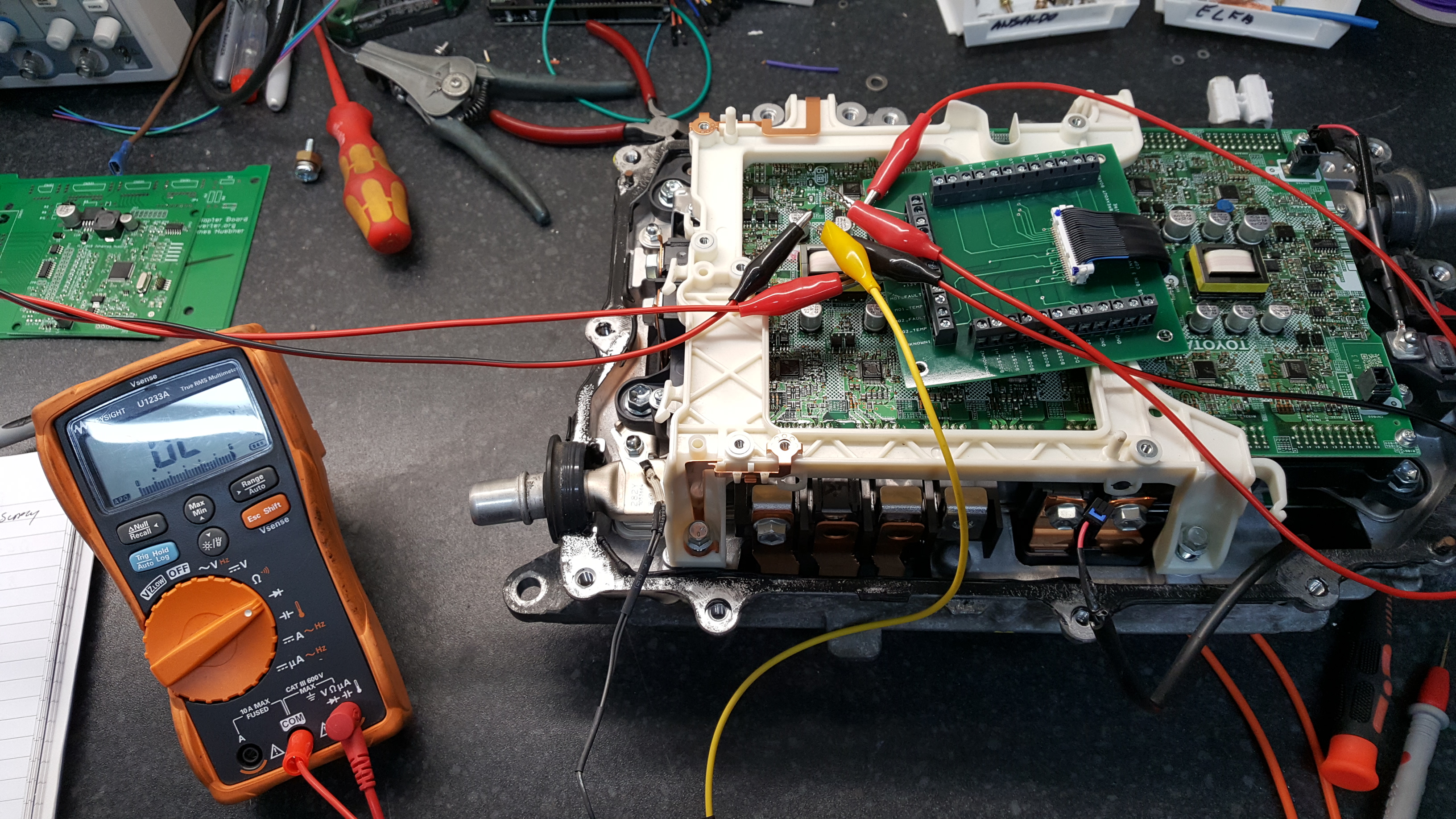

Thanks:) Going to try spinning a motor open loop at the weekend to make sure the drivers are working correctly.

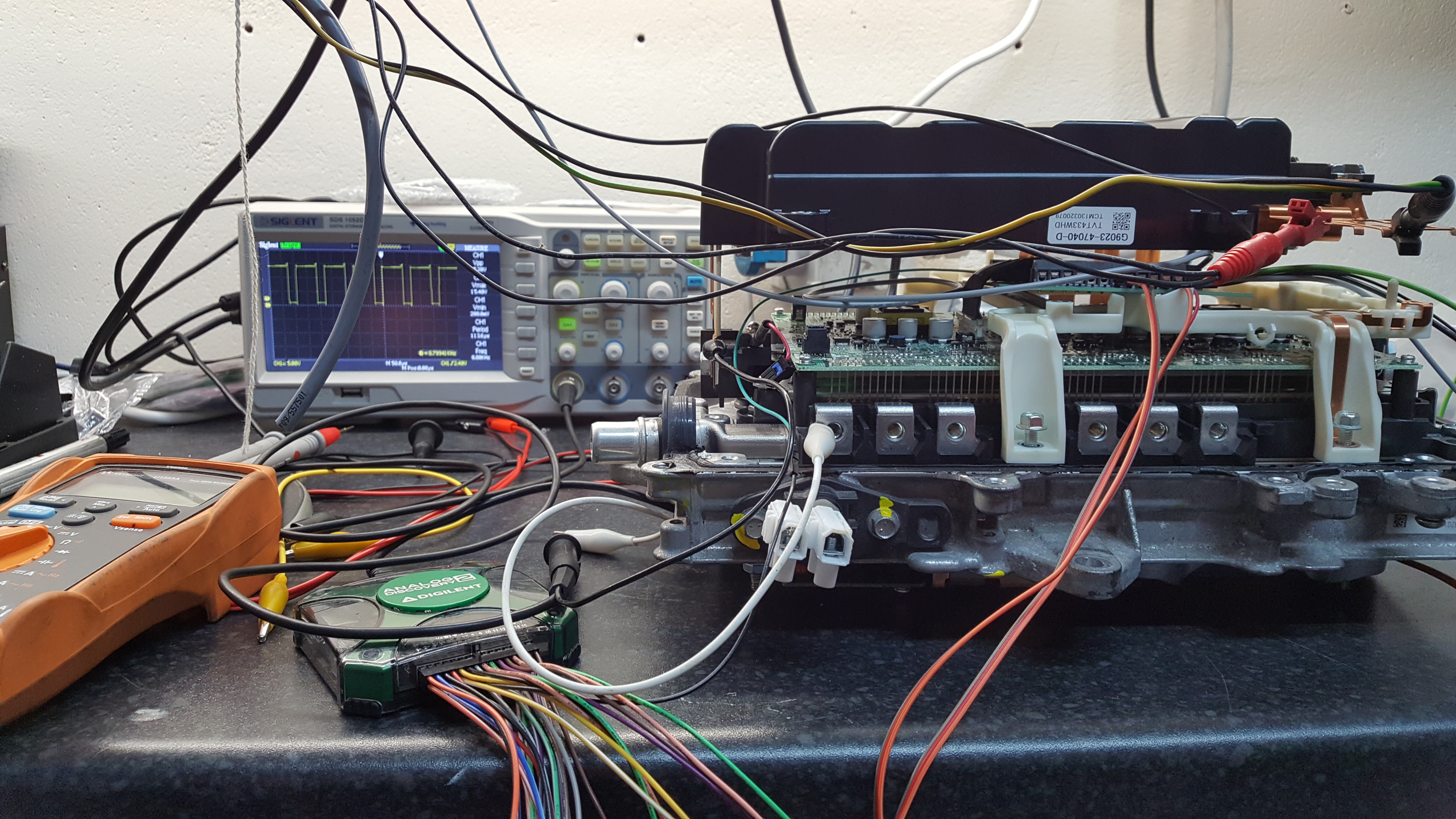

Re: Prius Gen3 Inverter Hacking

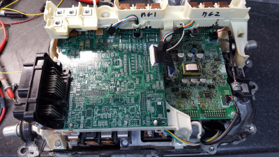

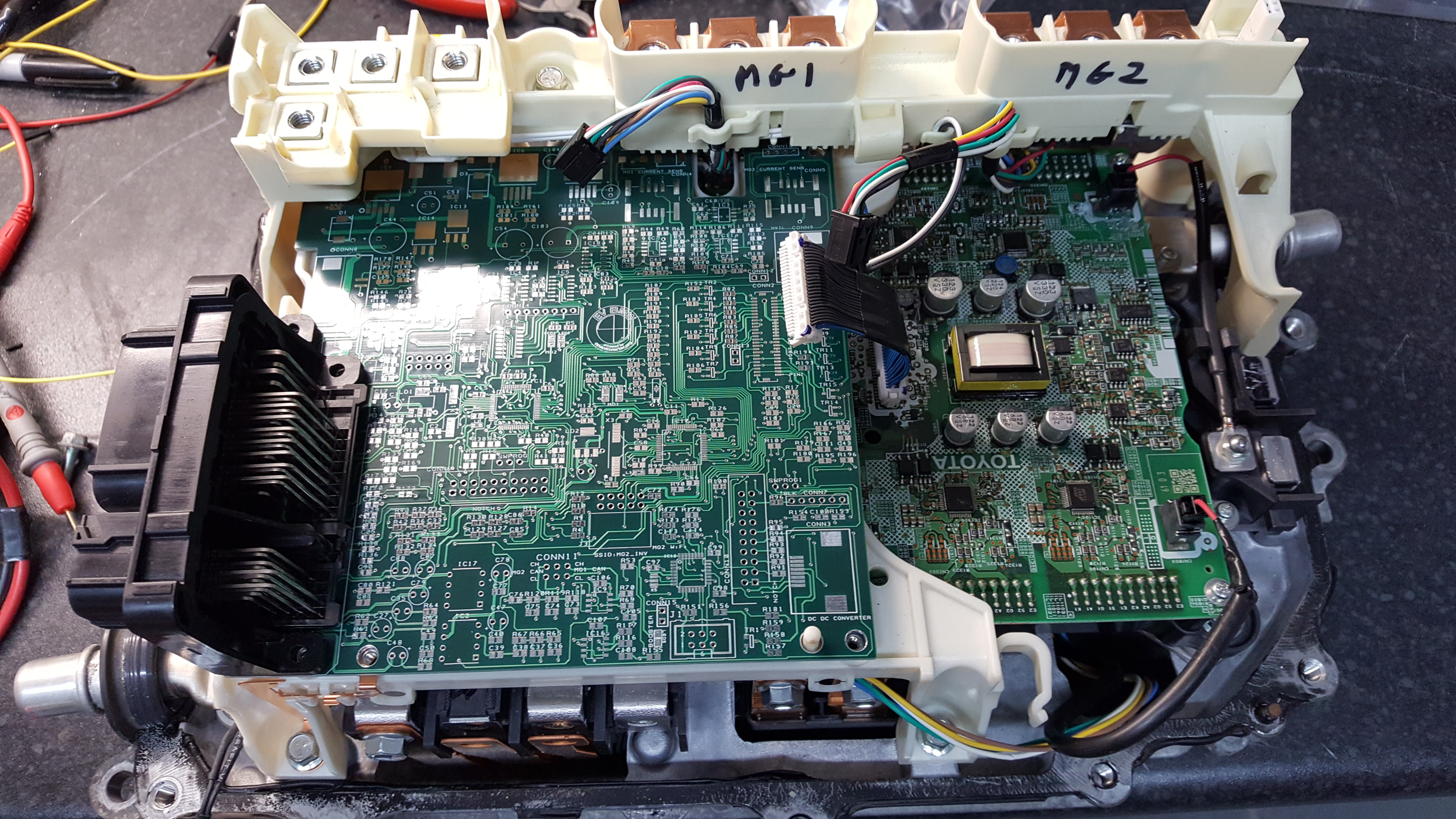

The Prius Gen 3 inverter is now responding to gate drive signals. :)
Motor spinning with the Prius inverter. Will get some video done in the next few days.

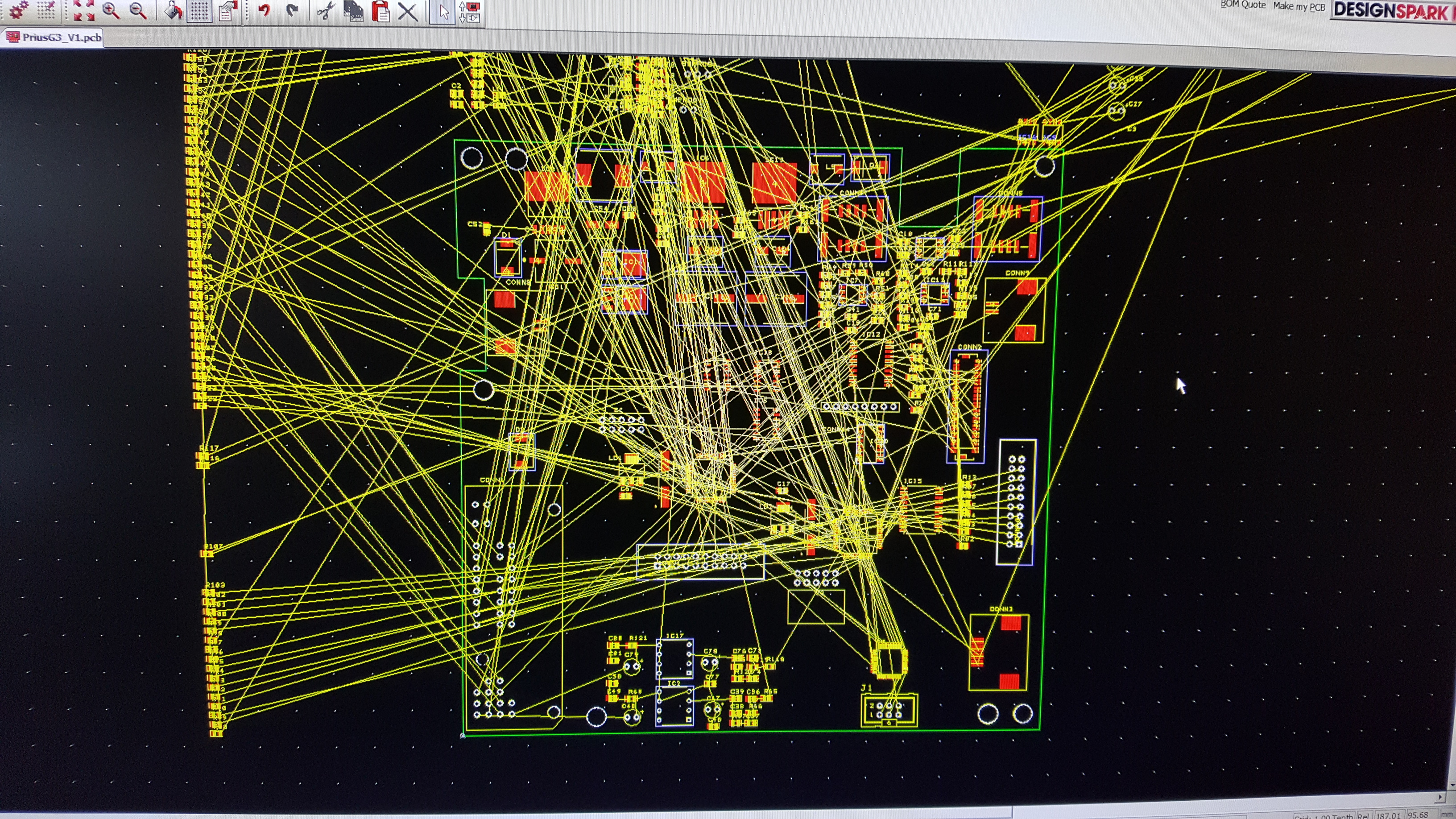

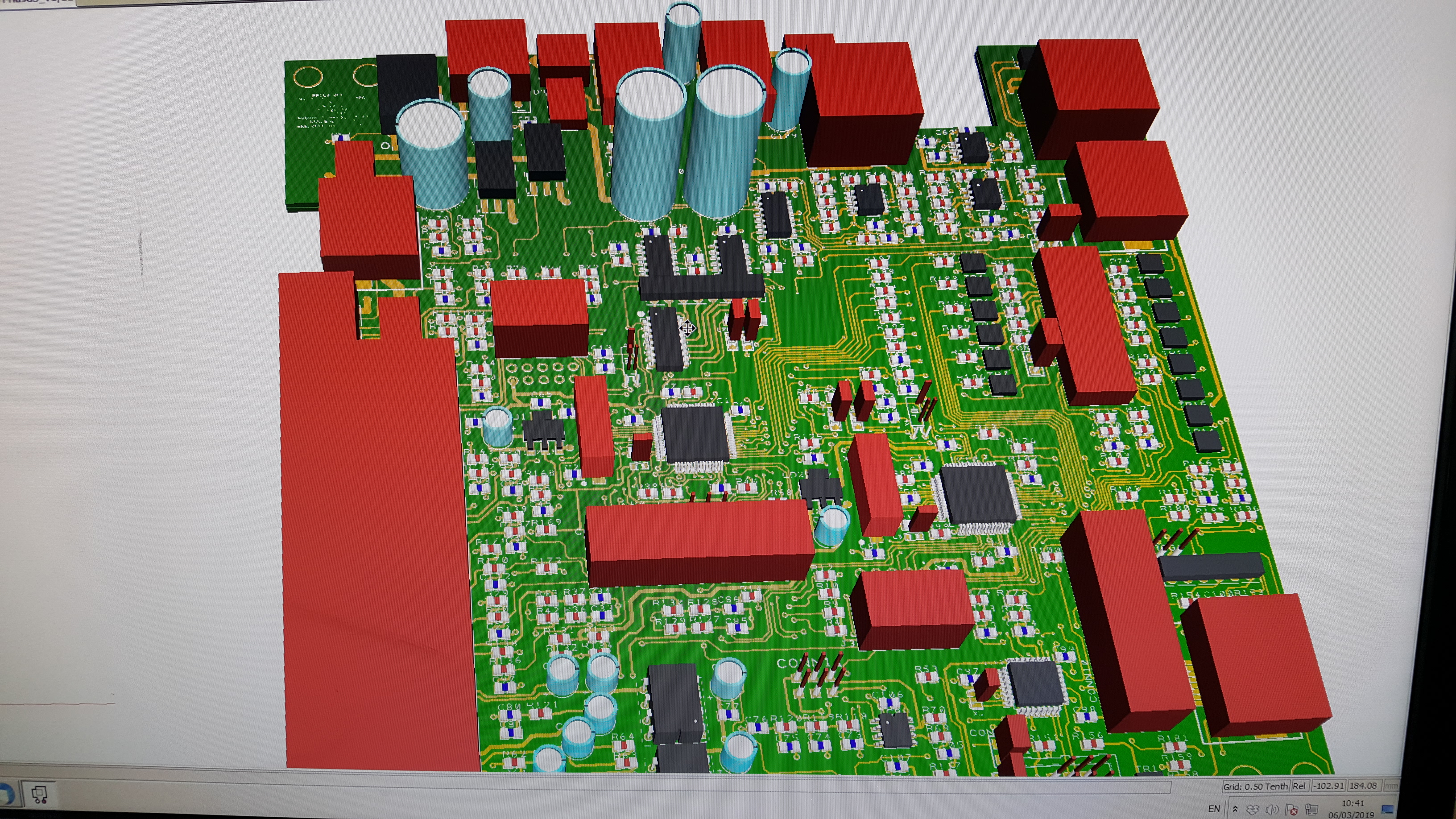

Got started on the logic board design today. Three micros in total :)
Can you tell how would you distribute logic units? Are they full blown Johannes units?
I recommend adding Lebowski brain as MG2 to have sensorless BLDC generator or rear motor application possibility.
Also i wonder if it wouldnt be good to account for buck/boost module as EMW charger? Hm... my mad scientist brain is thinking of charge pump application for charging from different sources like 3phase AC, single phase generator, DC solar source, DC battery extender etc...
:D
Posts: 4000
Been thanked: 1116 times
i think the design should handle most applications. There are two complete Johannes brains and an atmega 328 to handle the buck/boost and 12v dcdc converter control. I'll be uploading everything to github in a few days.

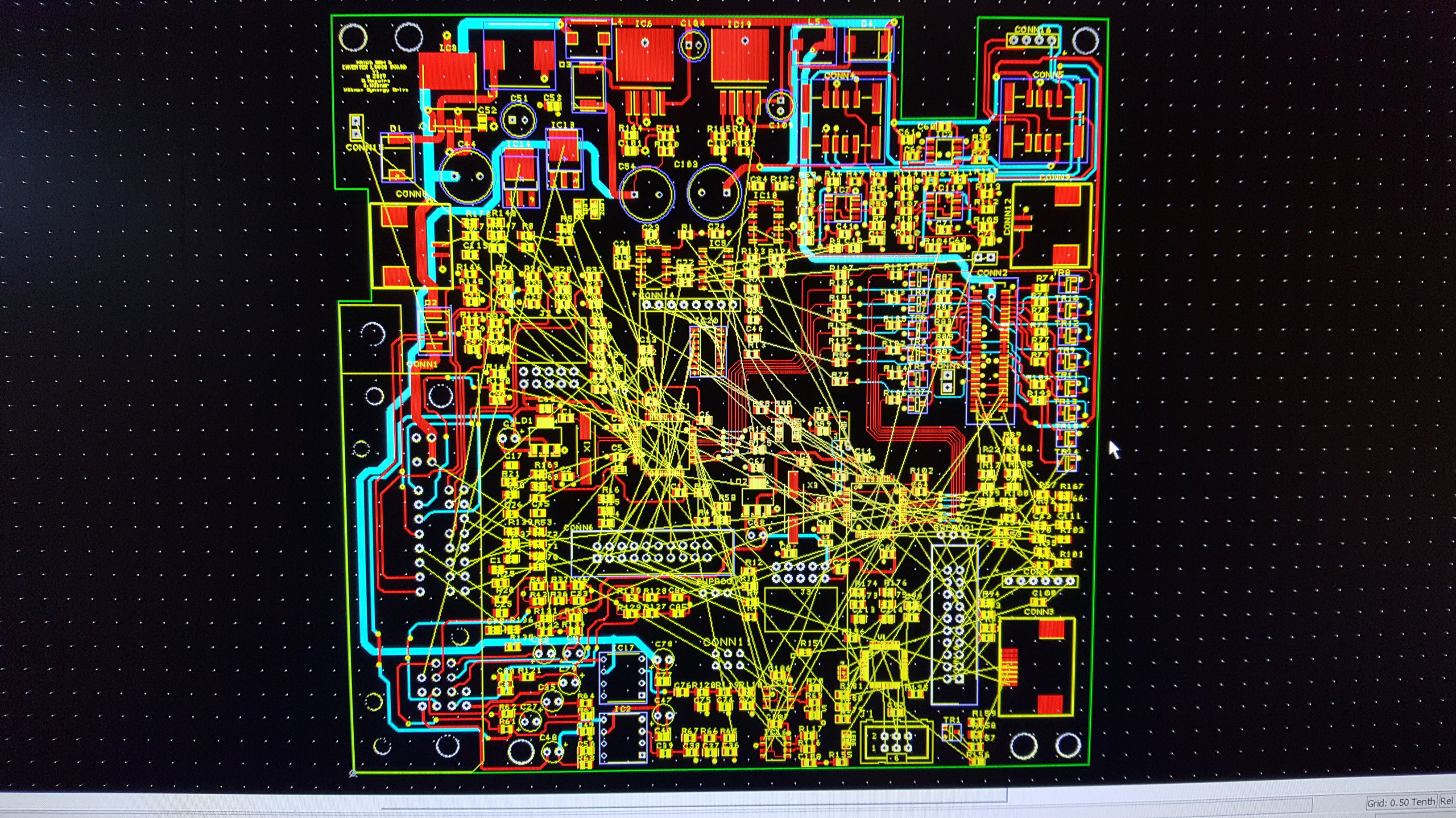

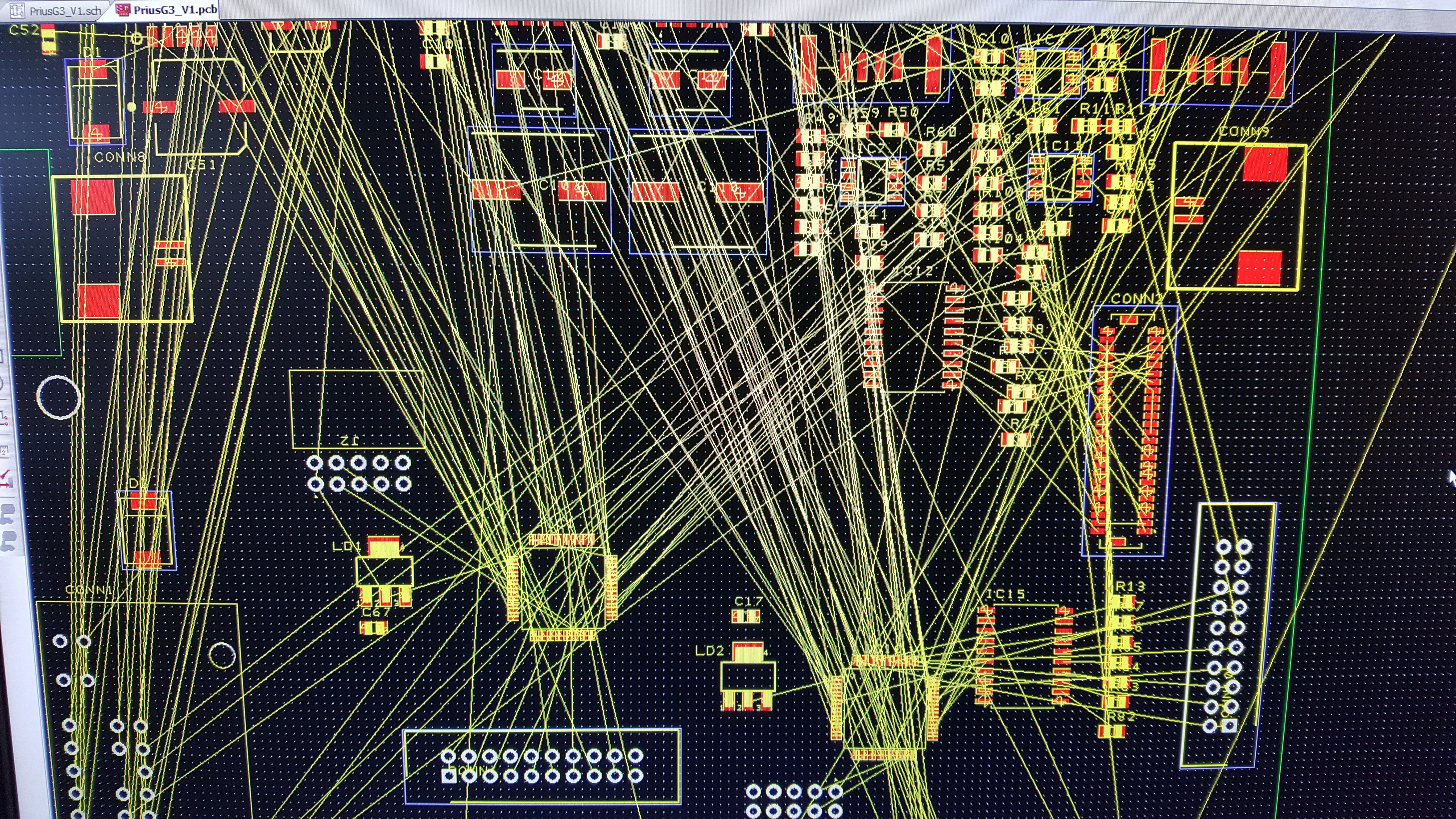

Posts: 4000

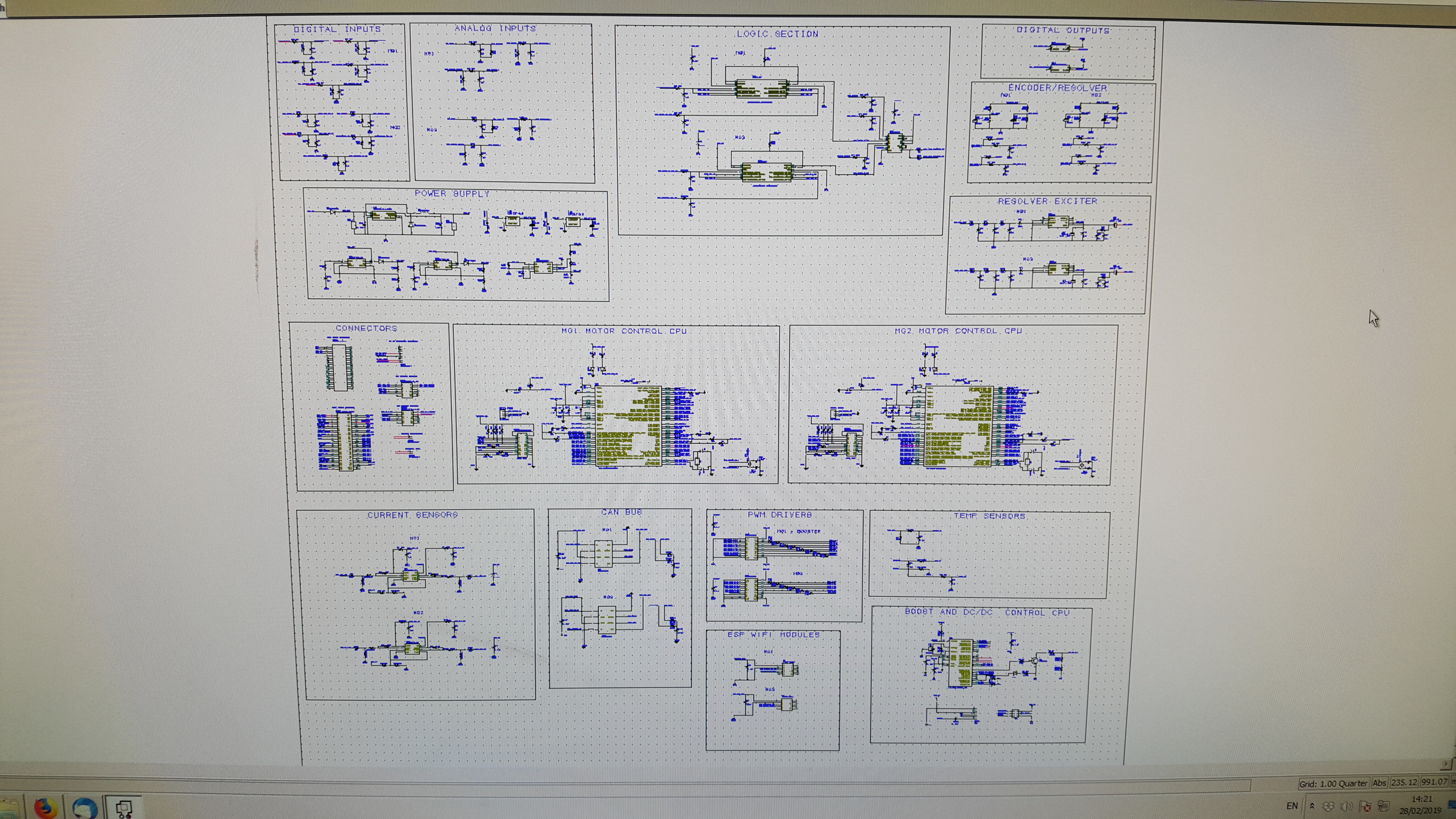

V1 logic board design schematic :
https://github.com/damienmaguire/Prius- ... ematic.pdf
Would appreciate it if people could throw an eye over this before I screw up too badly. PCB design in progress.
Post by sonachan1 »
I can take a look over the weekend. The base Johannes design you've used is mainboardv1.1 from his GitHub page here?https://github.com/jsphuebner/inverter-hardware
Been thanked: 1913 times
Very nice!
Only thing is the bypass caps of the resolver (C47, C78). 10µF proved a bit to small when I tested. I got power supply oscillations. I'd recommend at least 100µ.

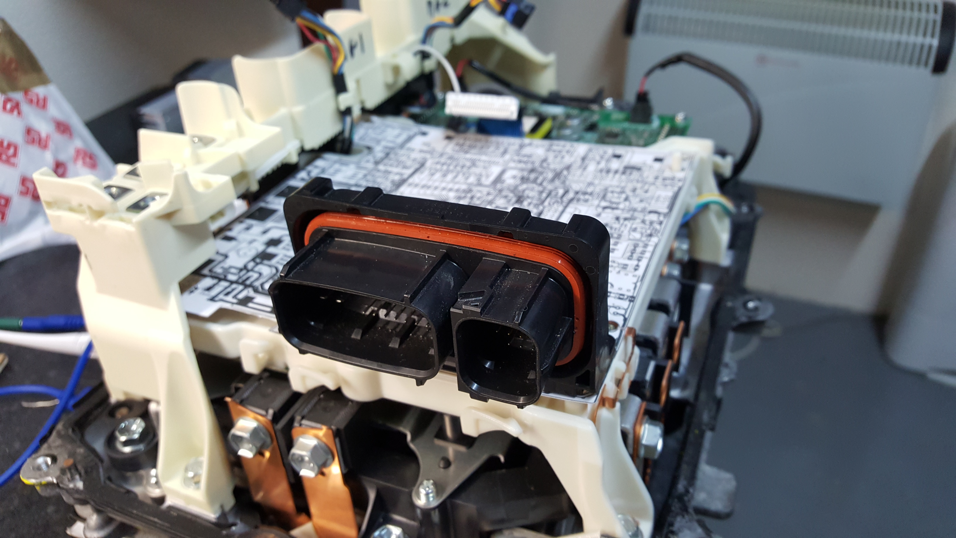

Go that. Thanks a lot :)

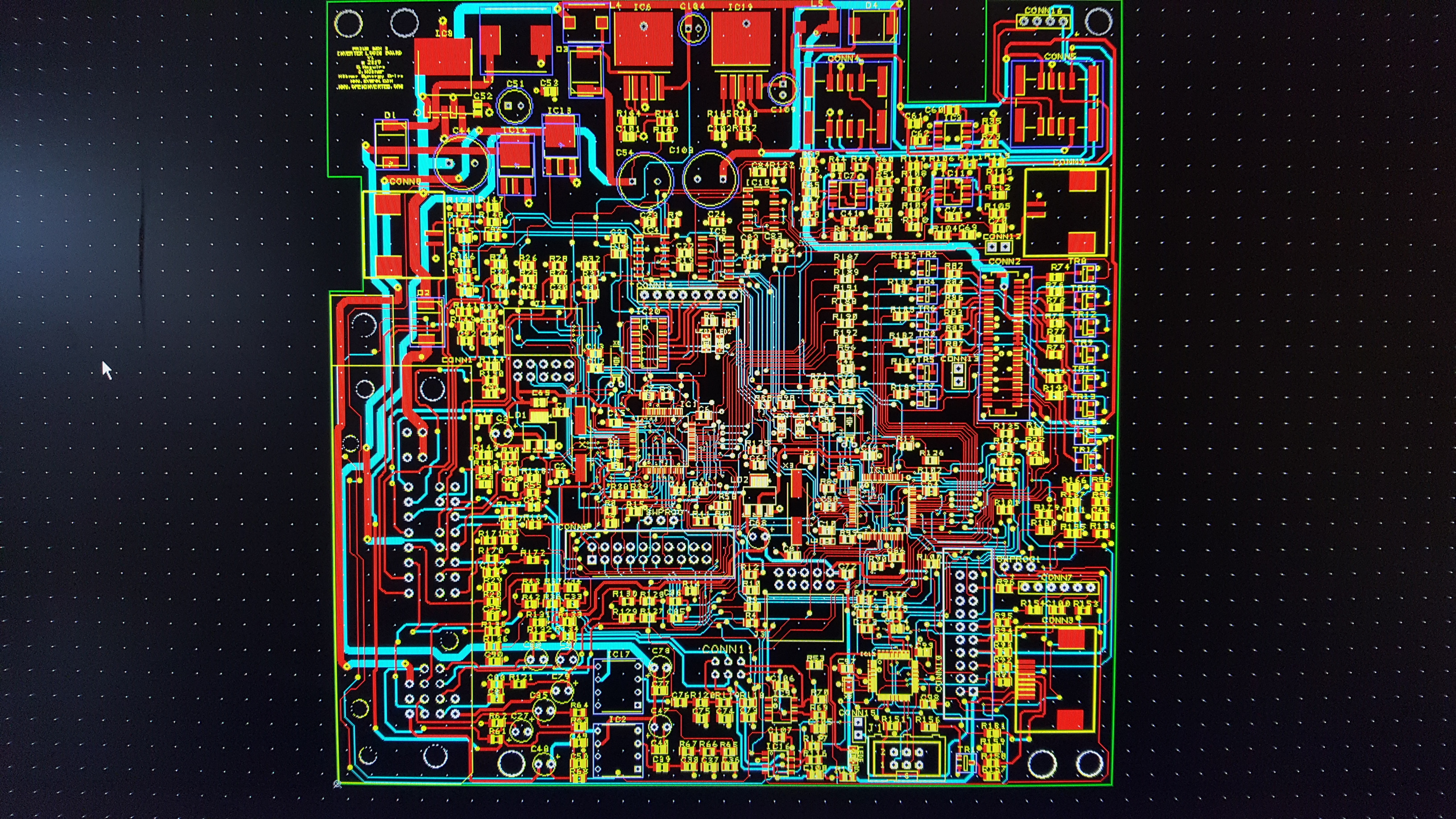

Making progress ....

Why not make "Expansion Board" just like Leaf, standardized v3 can be dropped instead of another custom design.
Posts: 4000
The board space would be a problem. Also the pcb skyline has to be low as the current sensors bracket sit on the top. If it was just a single inverter I could probably get away with it but this being the Heubner Synergy Drive it's a very tight layout especially as I'm trying to keep it single side surface mount to ease assembly.

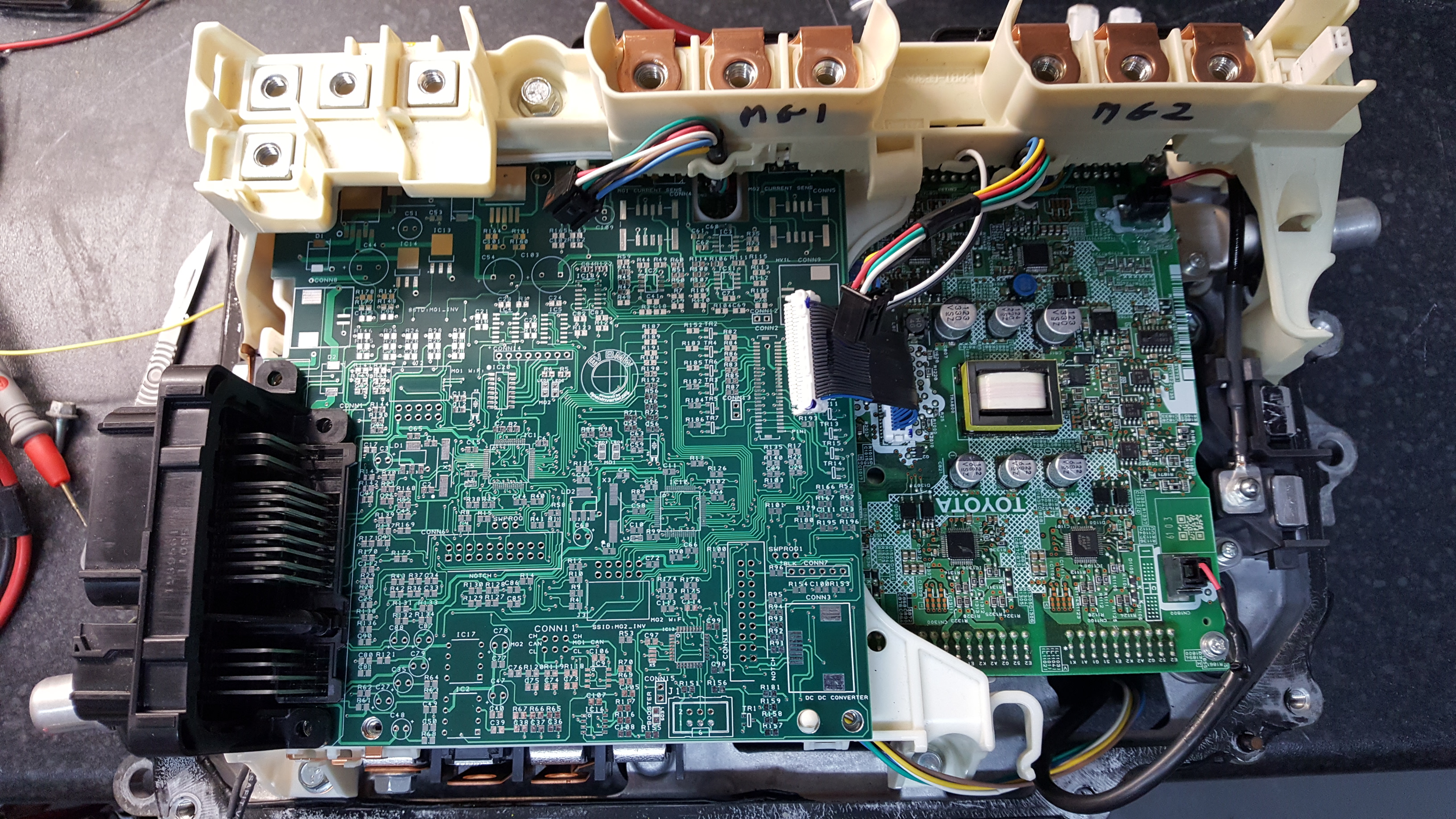

Done :) :) :)
Wow, that looks like a lot of work, great achievement!

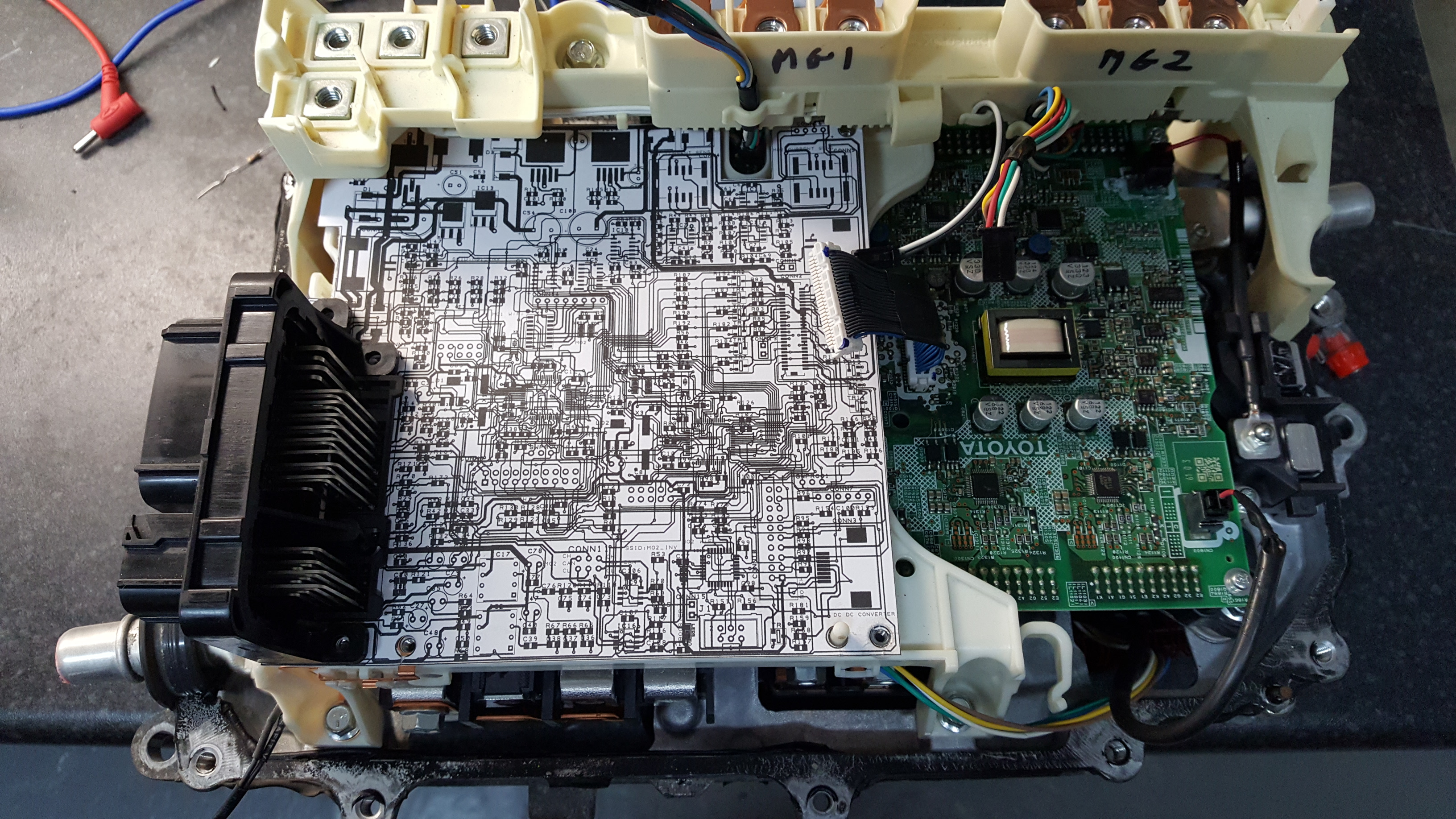

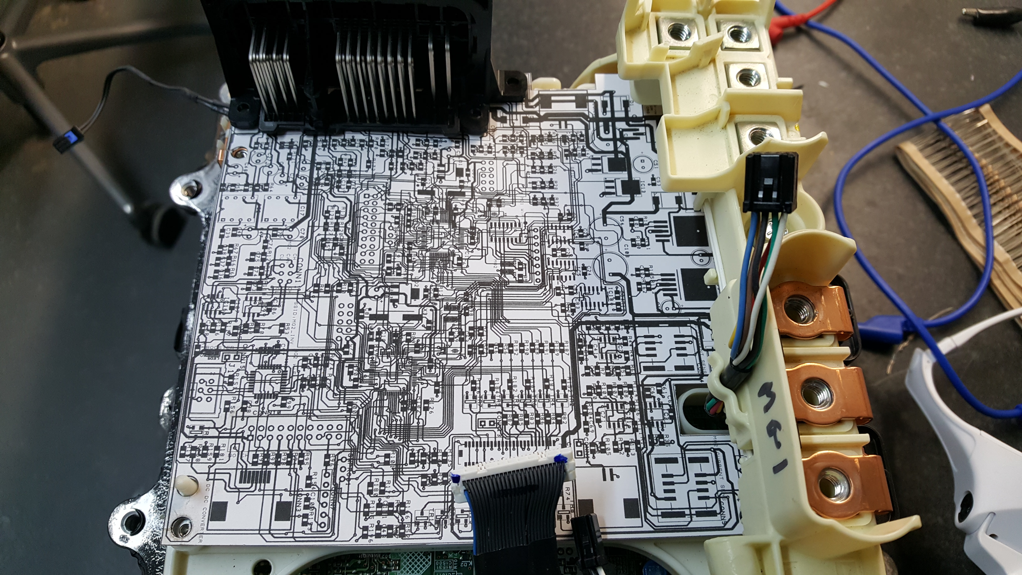

Posts: 4000
Final test fit with a cardboard template to check size and hole location before ordering prototypes.
