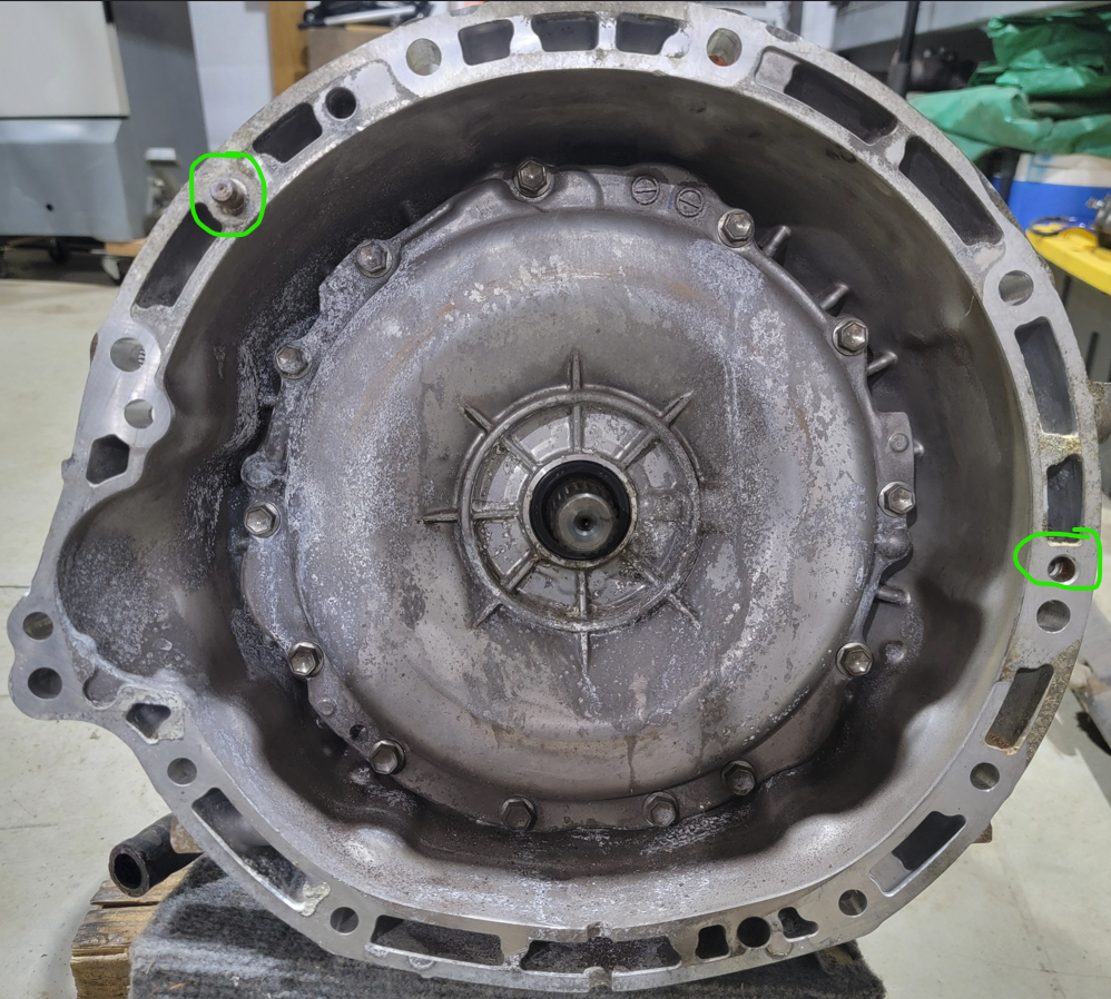

@HerbP, the LS600H bellhousing is a completely different shape than the GS450H

jrbe wrote: Tue Nov 04, 2025 10:22 am And if you guys have the ls600h bellhousing pattern and can share it, I can make that version too.
Another forum user just did a 3D scan of the ls600h transmission and transfer case. I'll let him chime in to offer up the file. I was going to take my ravigneaux section down to a friend's place to have the tail end of the transmission scanned and can also have him scan the bellhousing but maybe the other user can get the file to us sooner. It's a 4hr drive though so I've been putting it off.
I might also be able to figure out how to import his 3D scan into On-Shape and create a body from it but this is new territory for me.

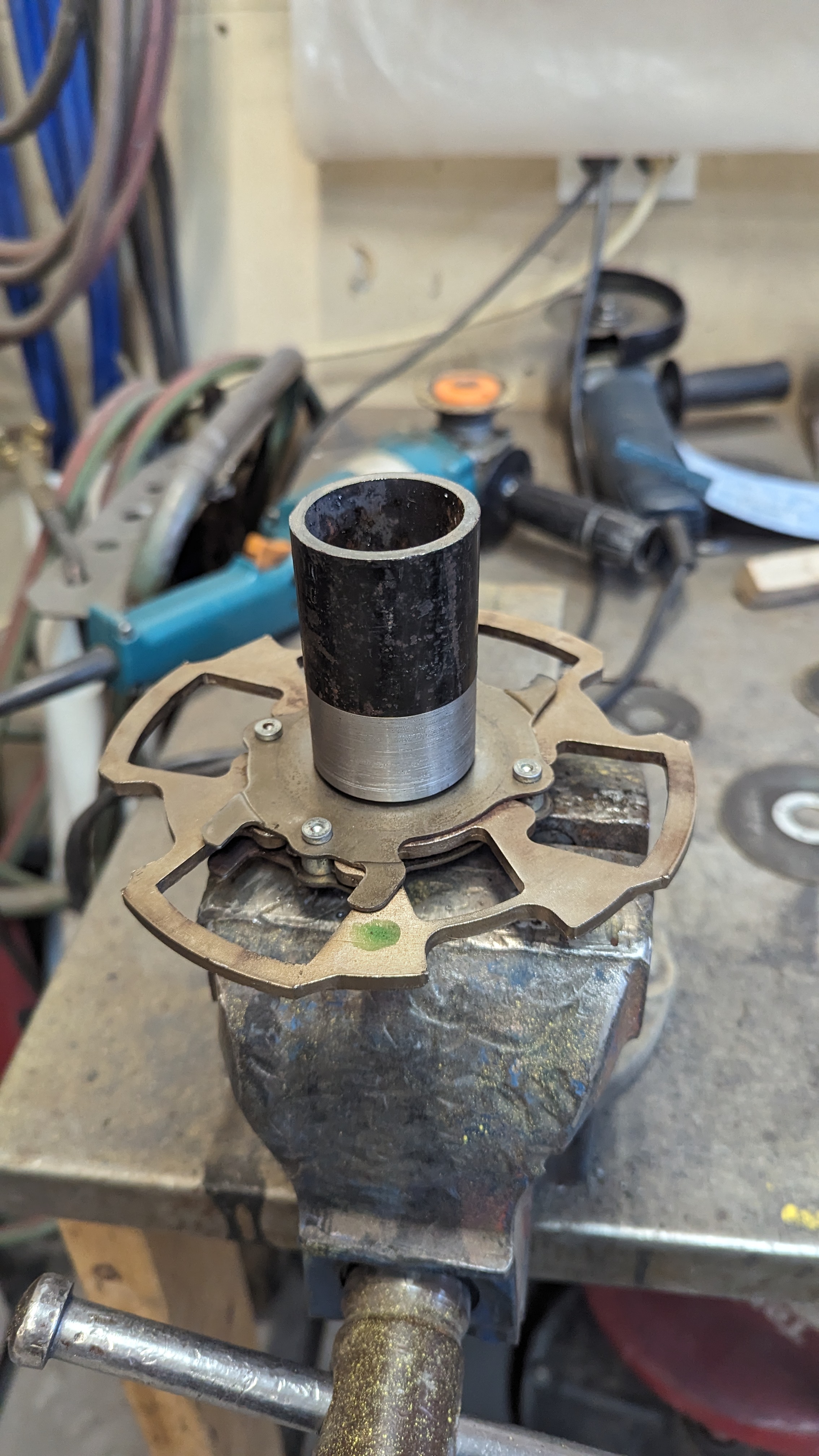

I turned my own adapter from a Toyota 3B clutch disc (same splines) with intent to weld it to the bellhousing plate.

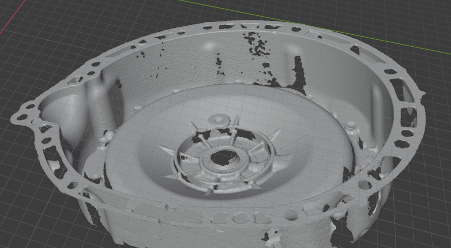

Here's the 3d scan of the LS600H. Not the best quality but may be good enough to work from.

tmhb16 wrote: Wed Nov 05, 2025 3:19 am Here's the 3d scan of the LS600H. Not the best quality but may be good enough to work from.
Well, I was unable to get OnShape to load the .3mf bellhousing before it ran out of Browser Memory, so I guess it'll have to be someone with an actual CAD program.
https://drive.google.com/drive/folders/ ... drive_link
I downloaded the files, thanks for sharing them. Bellhousing looks pretty good, thats all i've opened so far..
Should be enough to work from
The pin doesnt have enough scan data to use and the other pin is not in the transmission / scan. I dont think anyone is worried about the pin for this.

HerbP wrote: Tue Nov 04, 2025 1:53 pm I turned my own adapter from a Toyota 3B clutch disc (same splines) with intent to weld it to the bellhousing plate.
Gregski wrote: Sun Dec 08, 2024 2:27 pm I actually plan on using eight M10 bolts to hold my star down, 4 in the stock OEM closer to center holes that are already there, and 4 on the outside which we need to enlarge ie drill out
We also don't have the ninja star bolt circles (Greg, which disc is this?) or the 3B clutch hub bolt circle or the hole diameters. I know Herb you plan on welding but it would be nice to have a bolt in option.
Greg mentioned using M10 bolts, did that require drilling?
I'm not sure I ever found confirmed stack heights of the assembly. Not sure if stack height is different 450 to 600.

I believe I saw somewhere that we can just use TOYOTA clutch plates which have the same splines, this is on my to do list to find which MAKES will work, I am bumping it up my list now. Anyone know off hand any 2007-12 era manual transmission Toyota car Models or there abouts?
I may pick some up at AutoZone today to try for fitment and then once we have some part numbers...

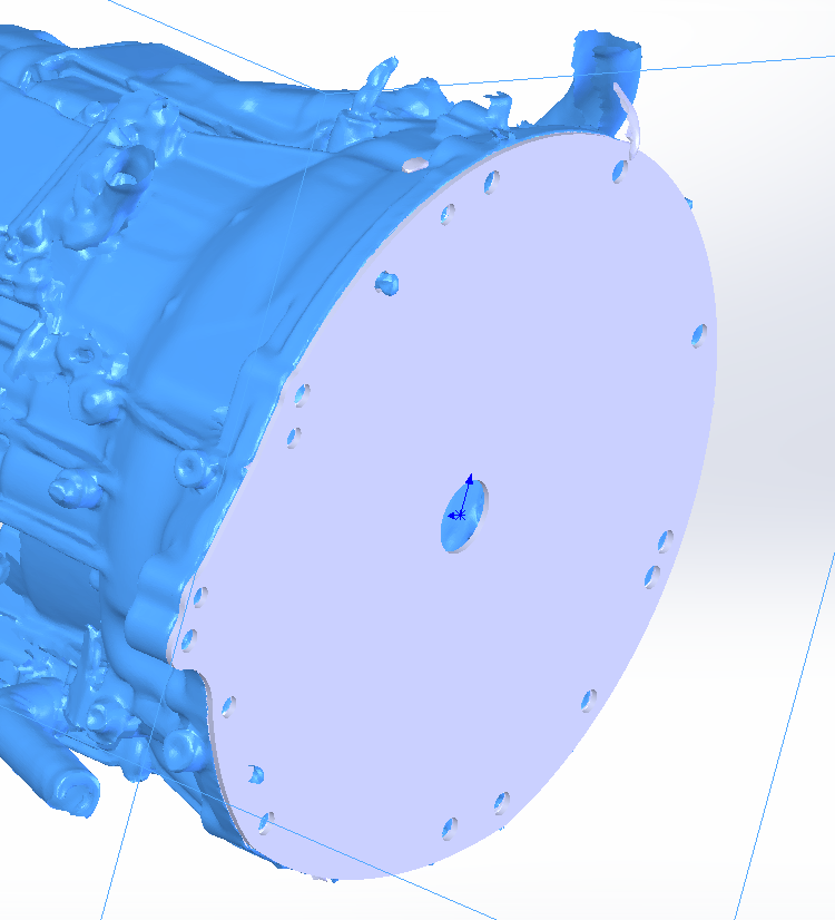

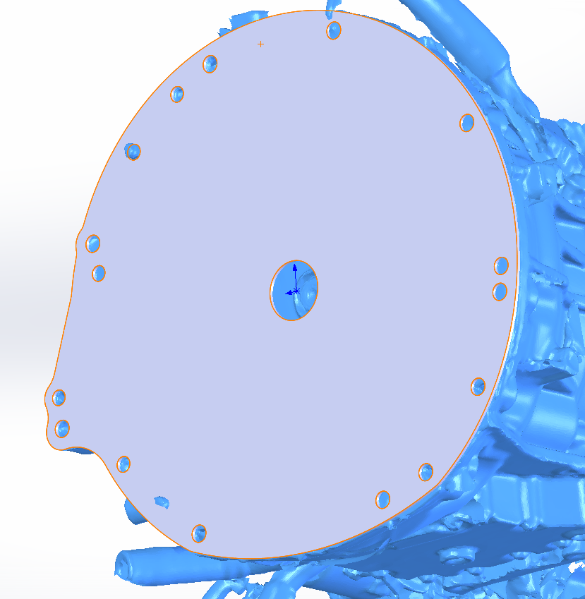

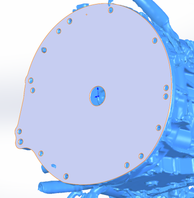

This needs to be made / validated but is specifically for the LS600H bellhousing with a center bore hole meant for steel black pipe.
Rename the .step file from .step.txt to just .step, the forum blocks this file type.
If anyone wants to propose other bolt patterns for the clutch hub attachment methods let me know and i can help with the design.
Also, if anyone can propose some good mounts to use I can add some wings to this on the bottom for them.
LS600BellhousingAligned.STEP.txt
(83.23 KiB) Downloaded 15 times
Flat pattern - LS600BellhousingAligned.DXF
(25.98 KiB) Downloaded 14 times

This is really great! For mine, I went all arts and crafts and used an opaque plastic sheet to trace out the bolt pattern, this will certainly help others in the future and will be way more accurate than mine.
Regarding the front mounts, I don't think there would easily be a 'standard', given the front driveshaft/propshaft passes through that area and will vary based on front differential location. That said, it's pretty easy to pickup on a few of the existing bolts - mine is a basic H-pattern front mount using 4 of the existing bell housing bolts.
jrbe
Posts: 766
Has thanked: 363 times
Been thanked: 249 times
Re: GS450H Adapter Plate
Post by jrbe »
Great point on the prop shaft protruding through this area.
There's an excessive amount of holes in the one I just drew up. Not really a problem and should give some flexibility.
I have the Solidworks file too but it's huge with the full ls600h transmission & bellhousing scans.
I also have the aligned transmission scan too. It's the one from earlier in this thread reoriented to align with the bellhousing on the front plane and the input shaft aligned as well as I could get it on an axis. These scans had missing input shaft / bore / cylinder point data making it a close guess.

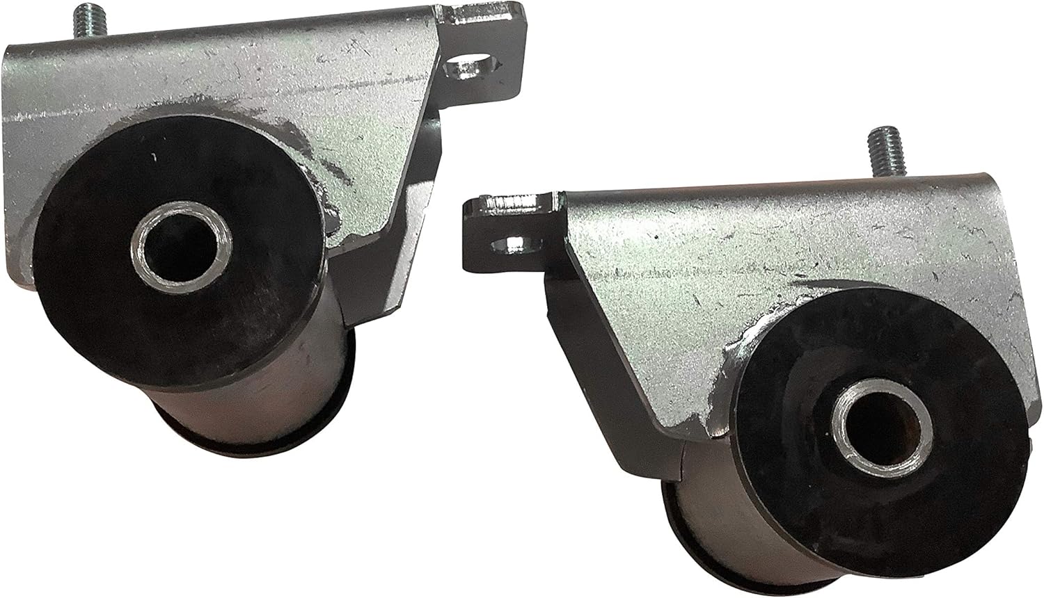

Gregski
Posts: 3164
Has thanked: 633 times
Been thanked: 1610 times
Post by Gregski »

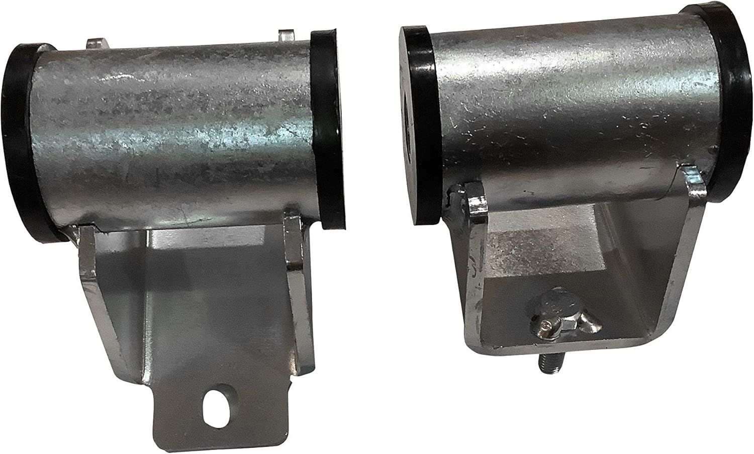

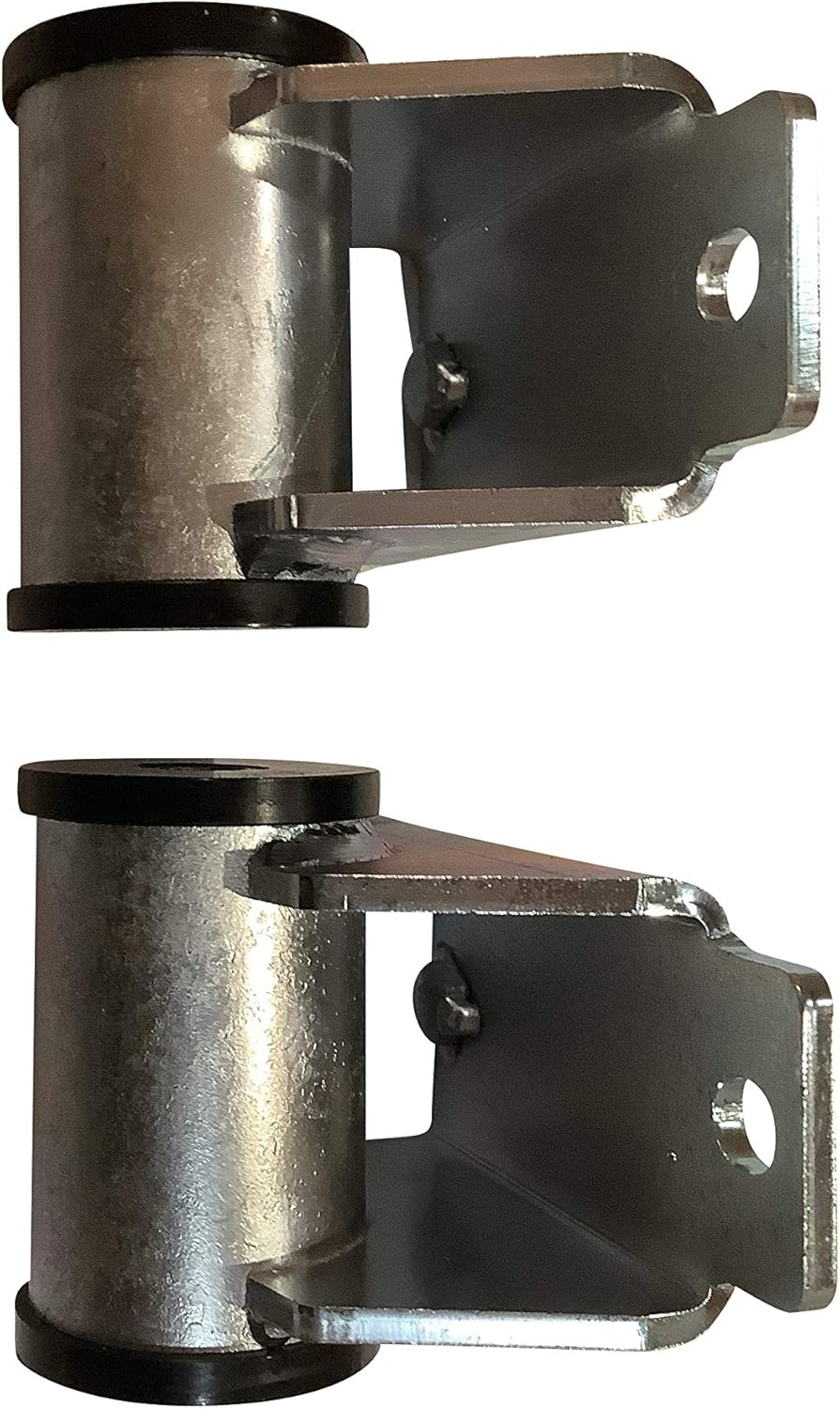

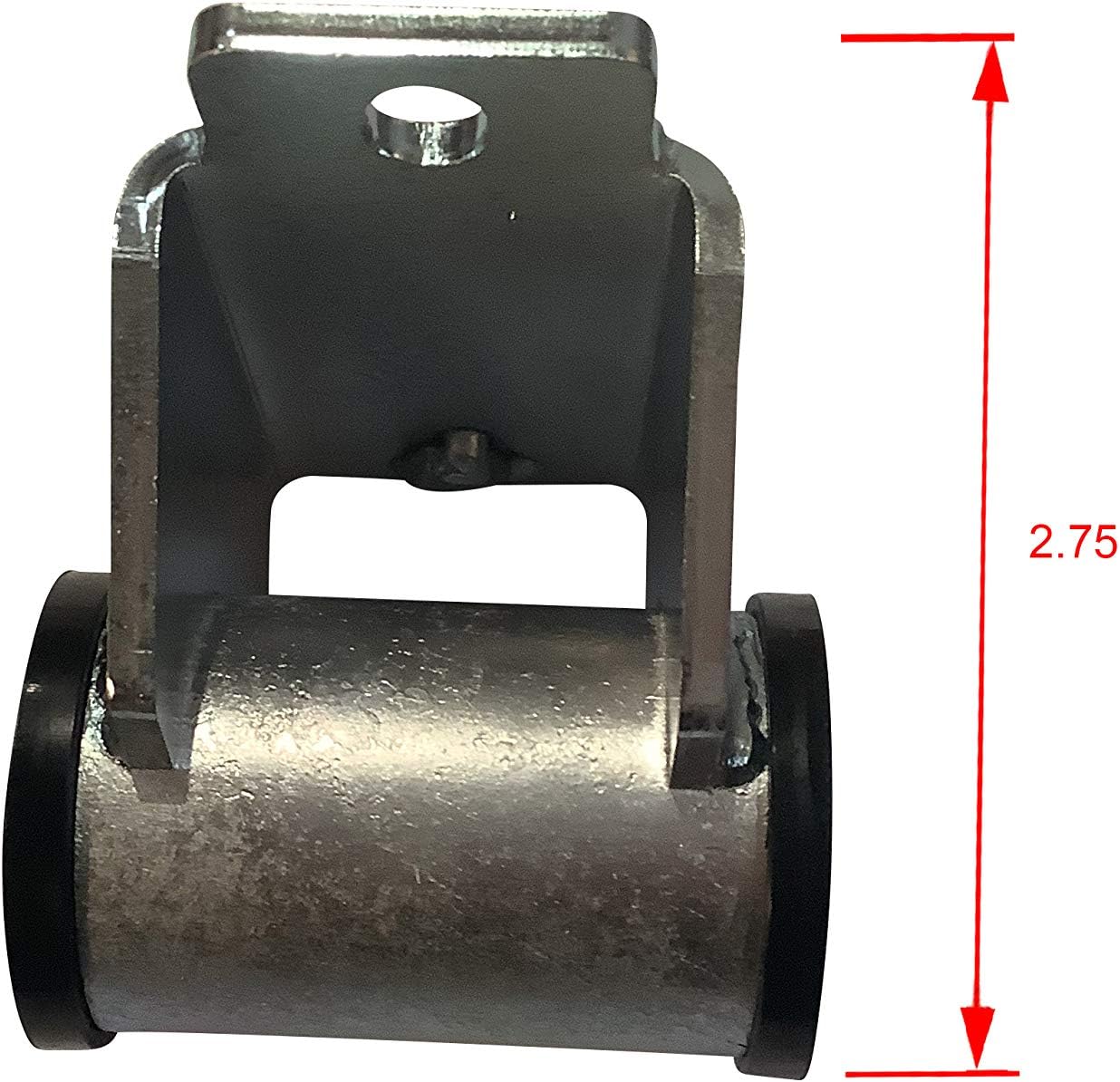

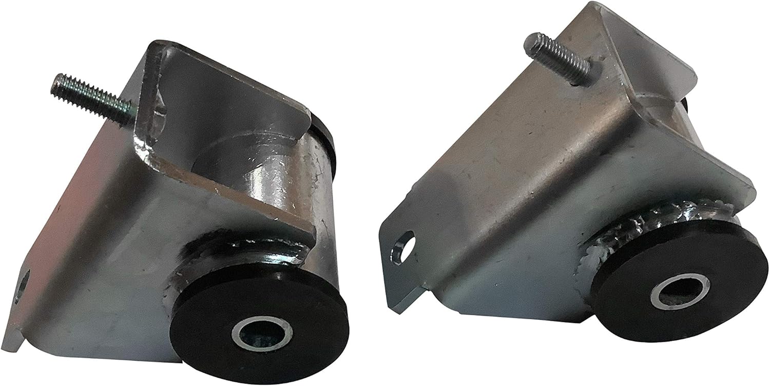

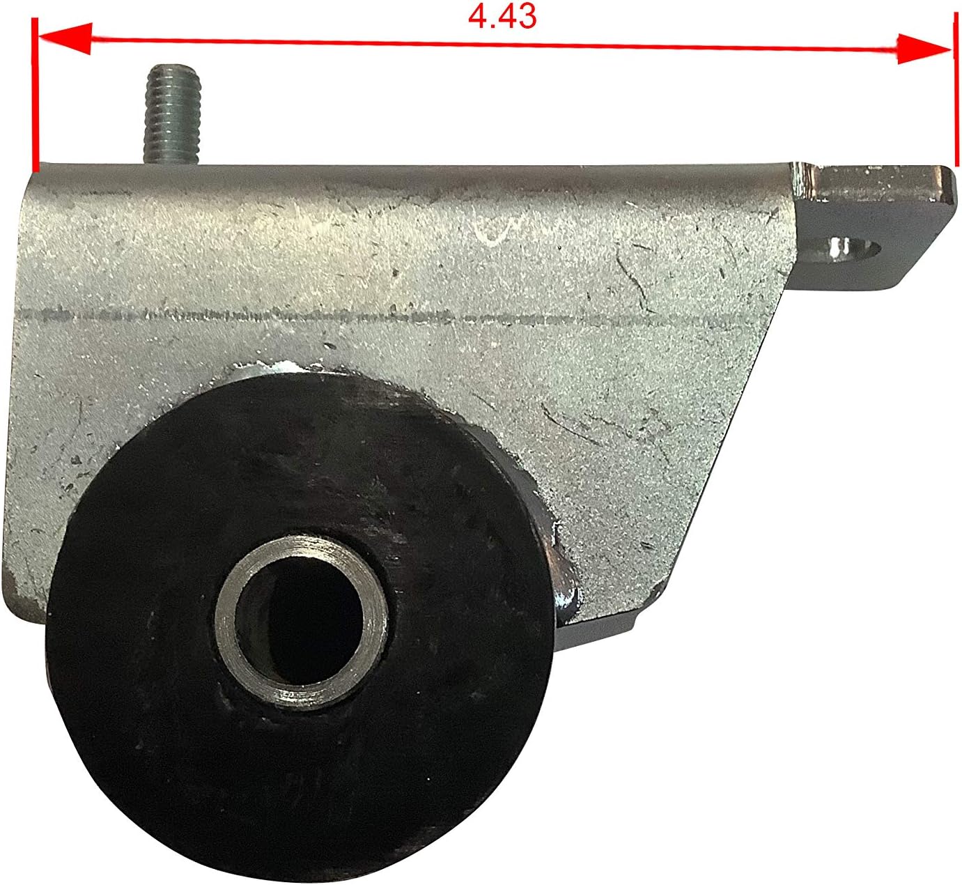

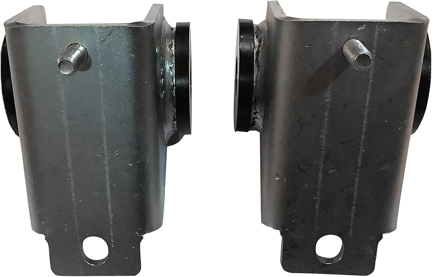

jrbe wrote: Thu Dec 11, 2025 1:28 am
how about these, off Amazon for $50 bucks
Polyurethane Motor Mounts - Heavy Duty, Durable Bushing, Fully Welded Interlocked Steel - Compatible with 2/4WD 1986-2006 Jeep Comanche MJ, Wrangler TJ, YJ, Cherokee XJ Engines - 2-Pack

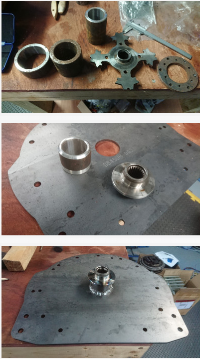

nkiernan wrote: Sat Dec 19, 2020 7:53 pm Attaching some files that might also help. Drawn up from the dimensions above and fits 100%. Includes mounting holes in lower corners.
DSC_5049_1.gifDSC_5045_1.gifDSC_5050_1.gifDSC_5038_1.gifGS450H-005.DXFGS450H-005.pdf
can you tell where you get the other parts - next to the plate in that pic -> Image
did you weld everything together as a final step?

The spline center is turned down from the center section of the standard GS450H flex disc and the spacer is off the shelf mechanical tube. I welded these together, but others have made bolted versions using the same centre spline section without removing the four legs! Check out Greg's 450H videos for some good references
