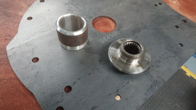

Just thought Id share I've been working on this today and 3d printed it and test fit it and it fits like a charm. I will be making this for my build and will have either bolts or a center hole for welding the flywheel on, depending if I go steel or aluminum. As I will use it as a mounting point for the transmission and other items if deemed needed.

You must have a large format printer for something that size?
Re: GS450H Adapter Plate
No I just sliced it by .01mm then glue back together after print

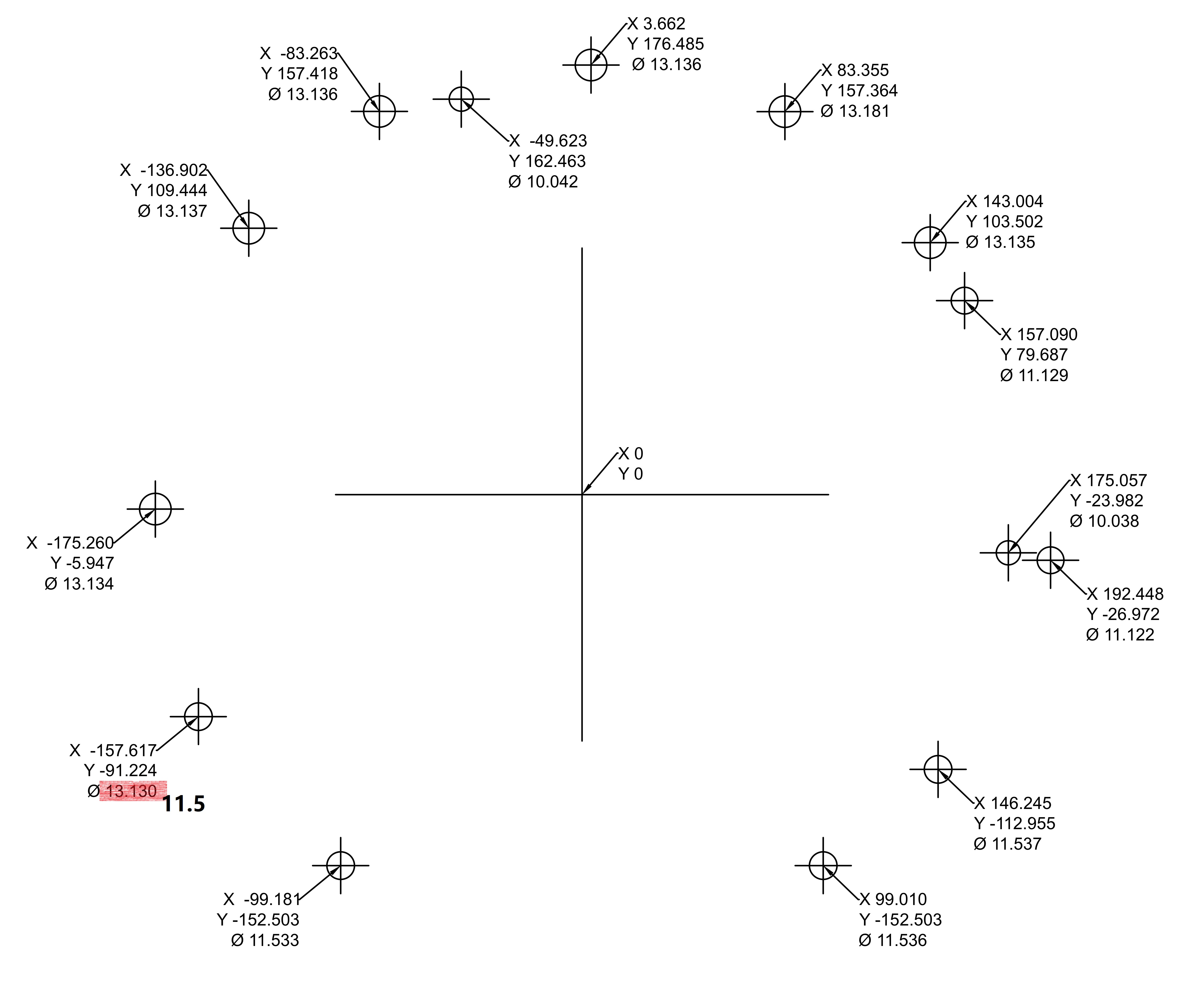

Hy Gigas
Nice looking adapter plate,
I just realist that I mad a minor mistake on the Drawing of the bolt plattern i posted in this forum.
One hole diameter was not corect.

Attaching some files that might also help. Drawn up from the dimensions above and fits 100%. Includes mounting holes in lower corners.

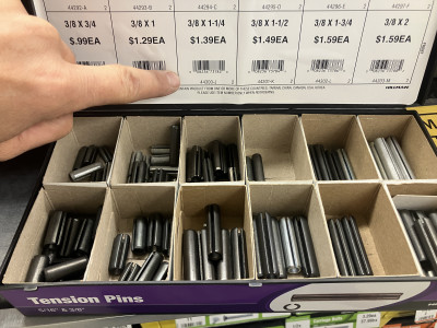

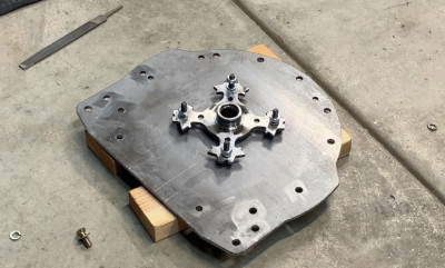

thanks for this, I just had mine cut, cost me $300 at my local mom and pop place, anyway first I am totally appreciative so these are just a couple of observations, I aint complaining
the bottom two holes could be larger in diameter to match those of the bell housing
also I noticed that you missed two holes for more tension pins, I found that these 3/8ths tension pins from my local hardware store work great for precise plate mounting, so there are two holes currently and I thought at least three would be more better, anyway I will add pics later to show which ones I am talking about, here's some pics for now

once again I am very thankful for this design, and the goal of the video below is just to provide some hands on real world application feedback
I wish there were at least three tension pin holes in this plate to allow for more of a triangulation when mounting it, currently it only supports two pins as explained in the video. The two red Xs in the pic below show where the other two holes should be drilled.

ah good point(s) and yes I agree, some holes had to be enlarged a smidgeon like the very bottom two, it's all in the excruciating boring video above, and I plan on using the tension pins to align and drill all the holes in the fly wheel pressure plate ninja star to lock the input shaft, then mount the plate without the tension pinsjrbe wrote: ↑Sat Dec 07, 2024 4:31 pm How well does the plate align?

Greg, If you get me what the hole sizes need to be i can update the DXF.

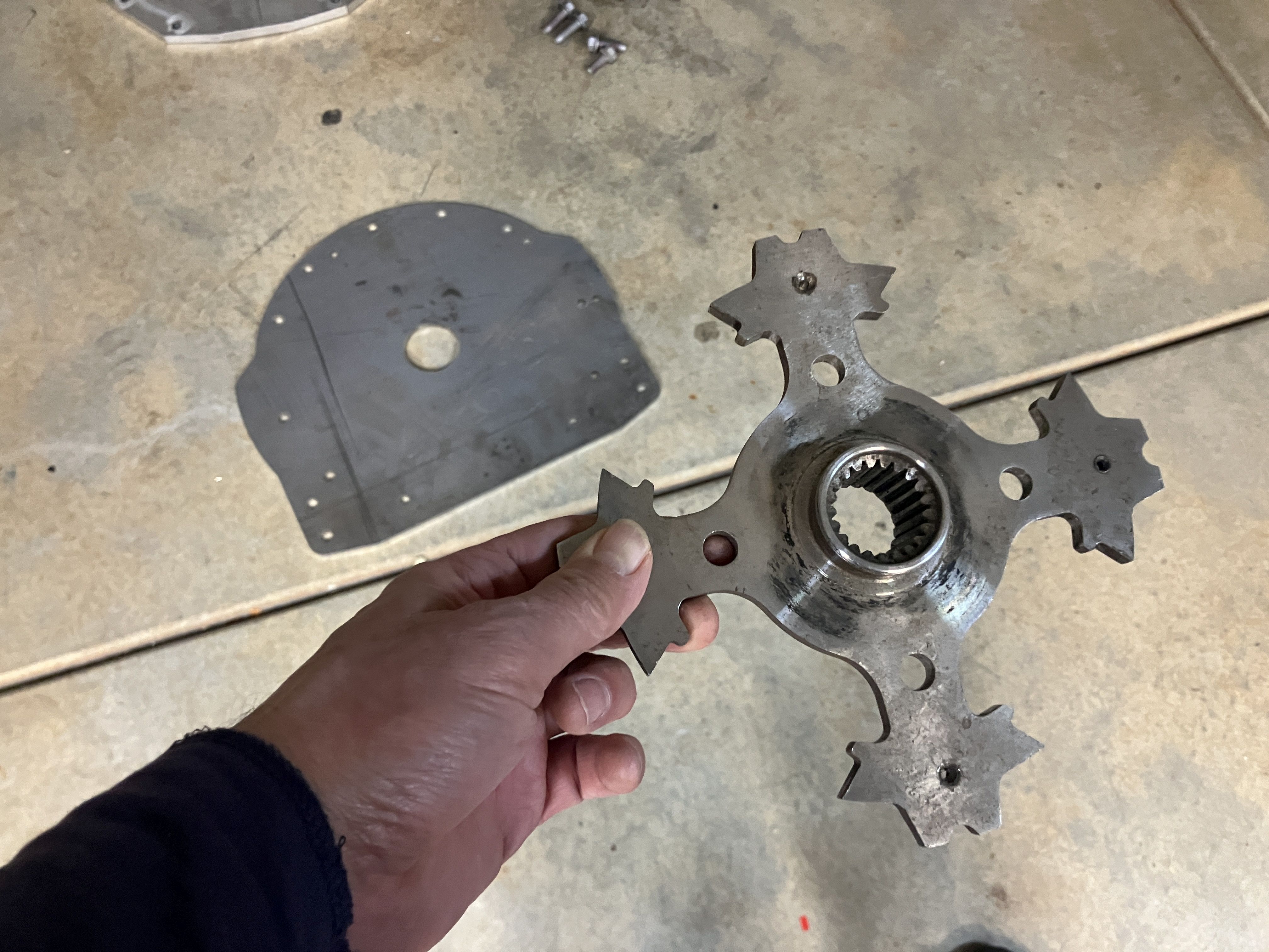

Doesn't the ninja star need a spacer? I could draw up a bent sheet metal spacer that could get welded in or could do a bolt in version. Ît should simplify this a lot. Can you get dimensions of all this stuff?

thanks I will try to get you those measurements, and what would really be helpful is having these 4 holes to mount the Ninja star via bolts since I don't think many folks like me will be welding this especially since I plan on using a 1/2 aluminum plate, Artur did this on his Jaquar and has been driving the car for about 4 years now, I actually plan on using eight M10 bolts to hold my star down, 4 in the stock OEM closer to center holes that are already there, and 4 on the outside which we need to enlarge ie drill outjrbe wrote: ↑Sat Dec 07, 2024 7:55 pm I'm guessing op might not be interested in updating this.

Just curious if you ever created an updated DXF? I was just about to send one of these off for mfg.

I never sent in the proper hole sizes as requested, so this is on me, I think you can just enlarge the ones I am talking about yourself later obviously with a drill if you decide to use those holes, you may not need all of them as you crossmember may be in the way or something like that
