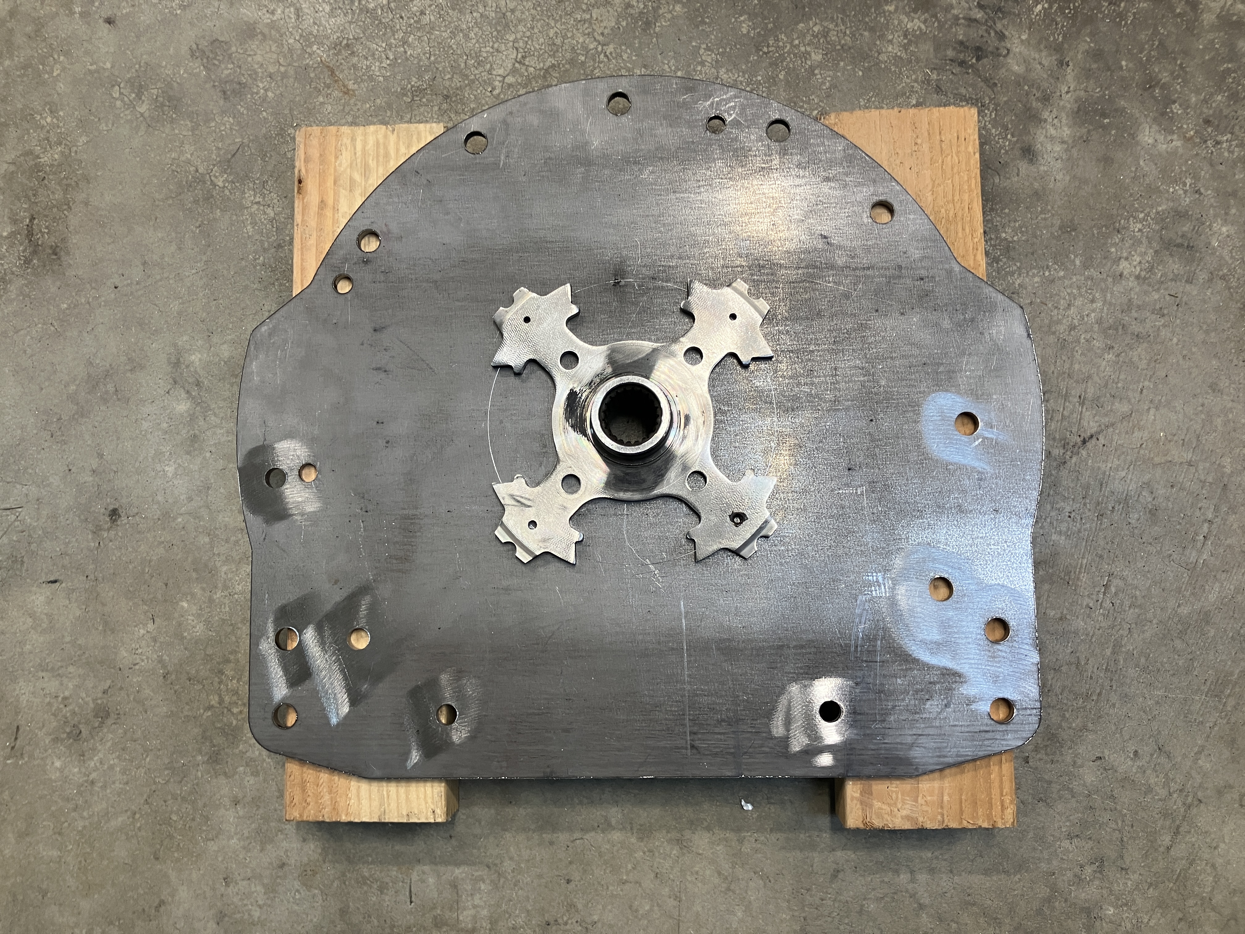

Just thought Id share I've been working on this today and 3d printed it and test fit it and it fits like a charm. I will be making this for my build and will have either bolts or a center hole for welding the flywheel on, depending if I go steel or aluminum. As I will use it as a mounting point for the transmission and other items if deemed needed.

sfk wrote: Mon Dec 14, 2020 6:04 pm You must have a large format printer for something that size?
No I just sliced it by .01mm then glue back together after print

TheSilverBuick wrote: Mon Dec 14, 2020 6:13 pm Why not just water jet it out of plate steel or aluminum?
I needed a test fit first - now I will get it laser cut

nkiernan wrote: Sat Dec 19, 2020 7:53 pm Attaching some files that might also help. Drawn up from the dimensions above and fits 100%. Includes mounting holes in lower corners.
DSC_5049_1.gifDSC_5045_1.gifDSC_5050_1.gifDSC_5038_1.gifGS450H-005.DXFGS450H-005.pdf
That spline coupler from the flywheel?

Post by nkiernan »
Yes, cut out of the flywheel and cleaned up on the lathe. Bit of approx 63mm OD 8mm wall off the shelf mechanical tube then.

Mobert wrote: Mon Dec 14, 2020 7:38 pm Hy Gigas
Nice looking adapter plate,
I just realist that I mad a minor mistake on the Drawing of the bolt plattern i posted in this forum.
One hole diameter was not corect.
thanks for this, I just had mine cut, cost me $300 at my local mom and pop place, anyway first I am totally appreciative so these are just a couple of observations, I aint complaining
the bottom two holes could be larger in diameter to match those of the bell housing
also I noticed that you missed two holes for more tension pins, I found that these 3/8ths tension pins from my local hardware store work great for precise plate mounting, so there are two holes currently and I thought at least three would be more better, anyway I will add pics later to show which ones I am talking about, here's some pics for now

once again I am very thankful for this design, and the goal of the video below is just to provide some hands on real world application feedback
I wish there were at least three tension pin holes in this plate to allow for more of a triangulation when mounting it, currently it only supports two pins as explained in the video. The two red Xs in the pic below show where the other two holes should be drilled.

jrbe wrote: Sat Dec 07, 2024 4:31 pm How well does the plate align?
Tension pins are not great for concentricity / alignment as they will spring a bit off center.
Are there factory alignment collars or pins in the transmission usually? The challenge is if you make the plate for a very exact fit the machining costs go up a bunch and your other machined parts and tolerances have to be exact. If you're a bit off or as the tolerances add up and shift things it can load up the input shaft bearing.
Leaving it a bit loose let's you jiggle it centered as you tighten it down.
ah good point(s) and yes I agree, some holes had to be enlarged a smidgeon like the very bottom two, it's all in the excruciating boring video above, and I plan on using the tension pins to align and drill all the holes in the fly wheel pressure plate ninja star to lock the input shaft, then mount the plate without the tension pins

Gregski wrote: Sat Dec 07, 2024 4:40 pm ...some holes had to be enlarged a smidgeon like the very bottom two, it's all in the excruciating boring video above, and I plan on using the tension pins to align and drill all the holes in the fly wheel pressure plate ninja star to lock the input shaft...
I'm guessing op might not be interested in updating this.
Greg, If you get me what the hole sizes need to be i can update the DXF.
Doesn't the ninja star need a spacer? I could draw up a bent sheet metal spacer that could get welded in or could do a bolt in version. Ît should simplify this a lot. Can you get dimensions of all this stuff?
Any other mounting holes needed to help make this more universal?
I'll make a pdf drawing that gets printed out to 100% scale to give a printable drill template to help guide your hi tech tooling.

jrbe wrote: Sat Dec 07, 2024 7:55 pm I'm guessing op might not be interested in updating this.
thanks I will try to get you those measurements, and what would really be helpful is having these 4 holes to mount the Ninja star via bolts since I don't think many folks like me will be welding this especially since I plan on using a 1/2 aluminum plate, Artur did this on his Jaquar and has been driving the car for about 4 years now, I actually plan on using eight M10 bolts to hold my star down, 4 in the stock OEM closer to center holes that are already there, and 4 on the outside which we need to enlarge ie drill out
