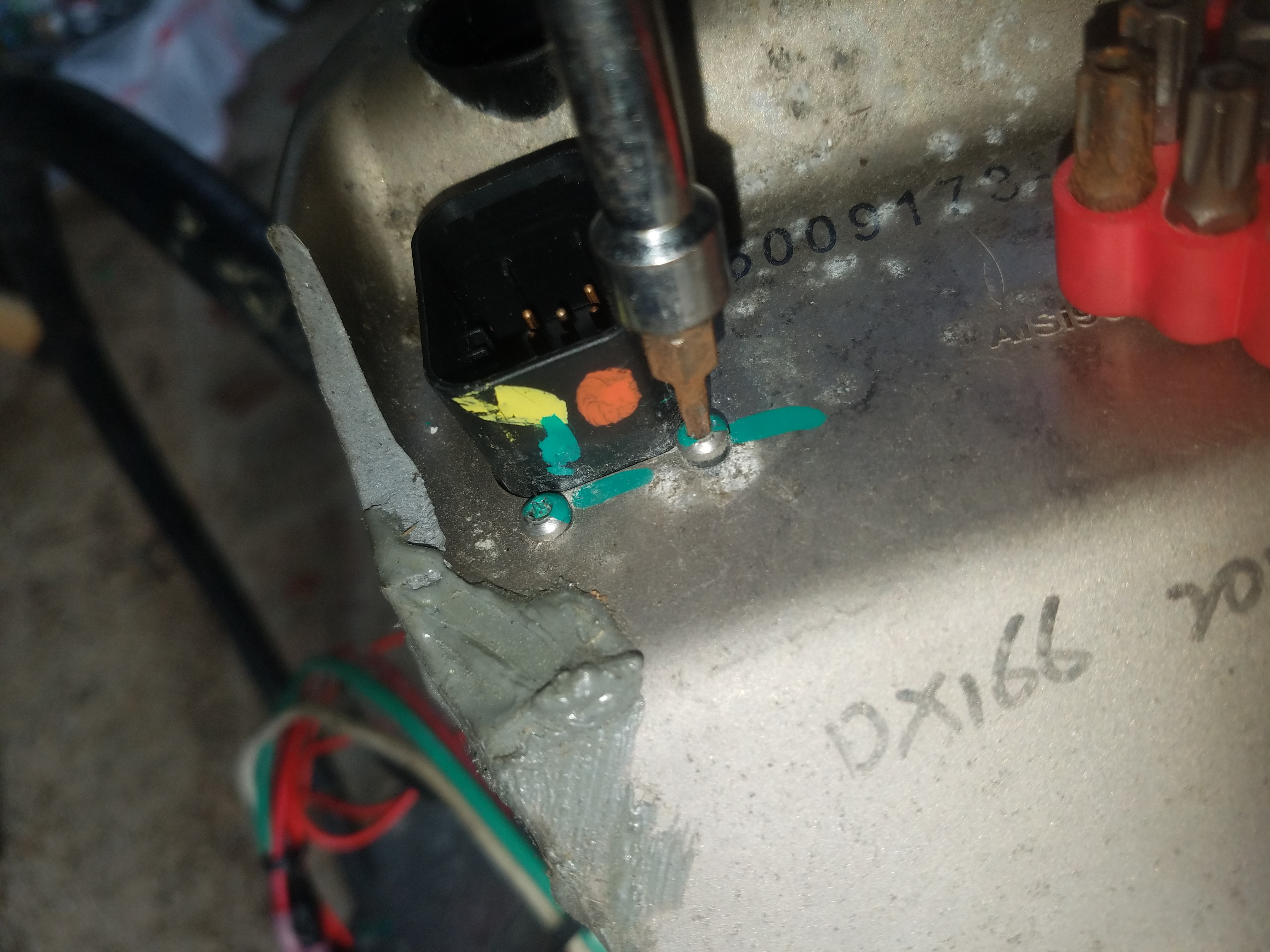

Ok, cool. I will keep you guys updated once I get the part, modify the case, and install it on the case.

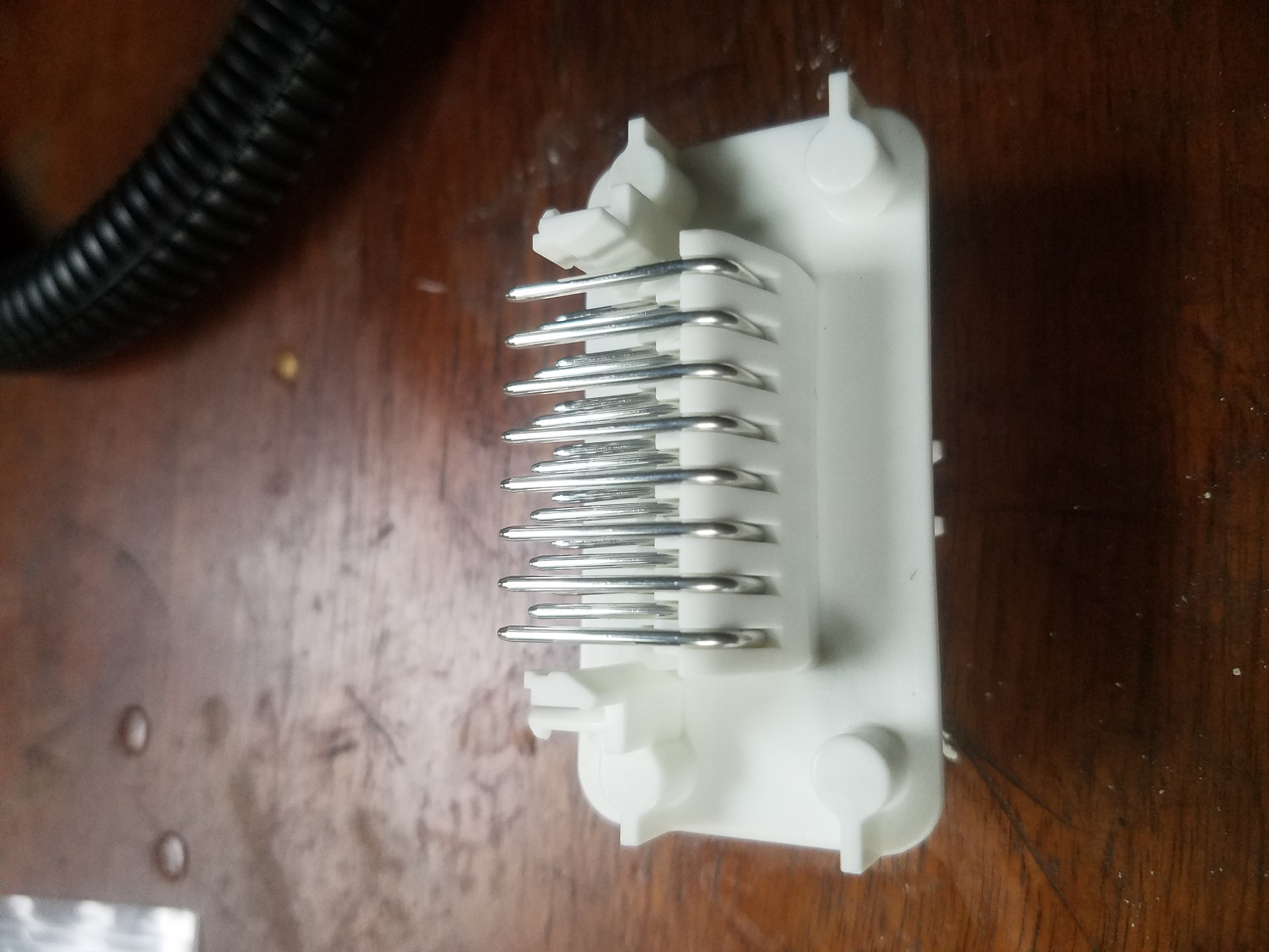

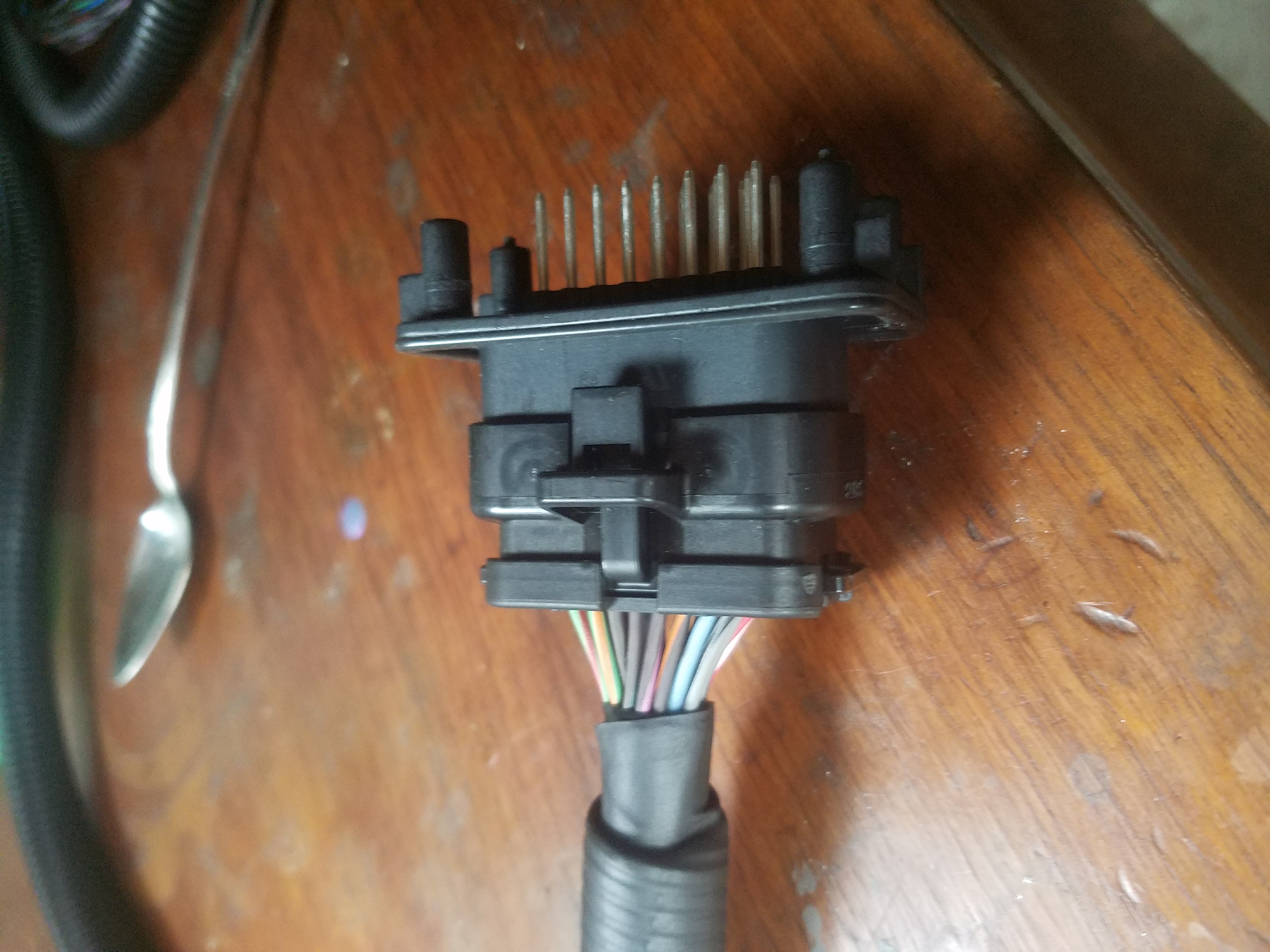

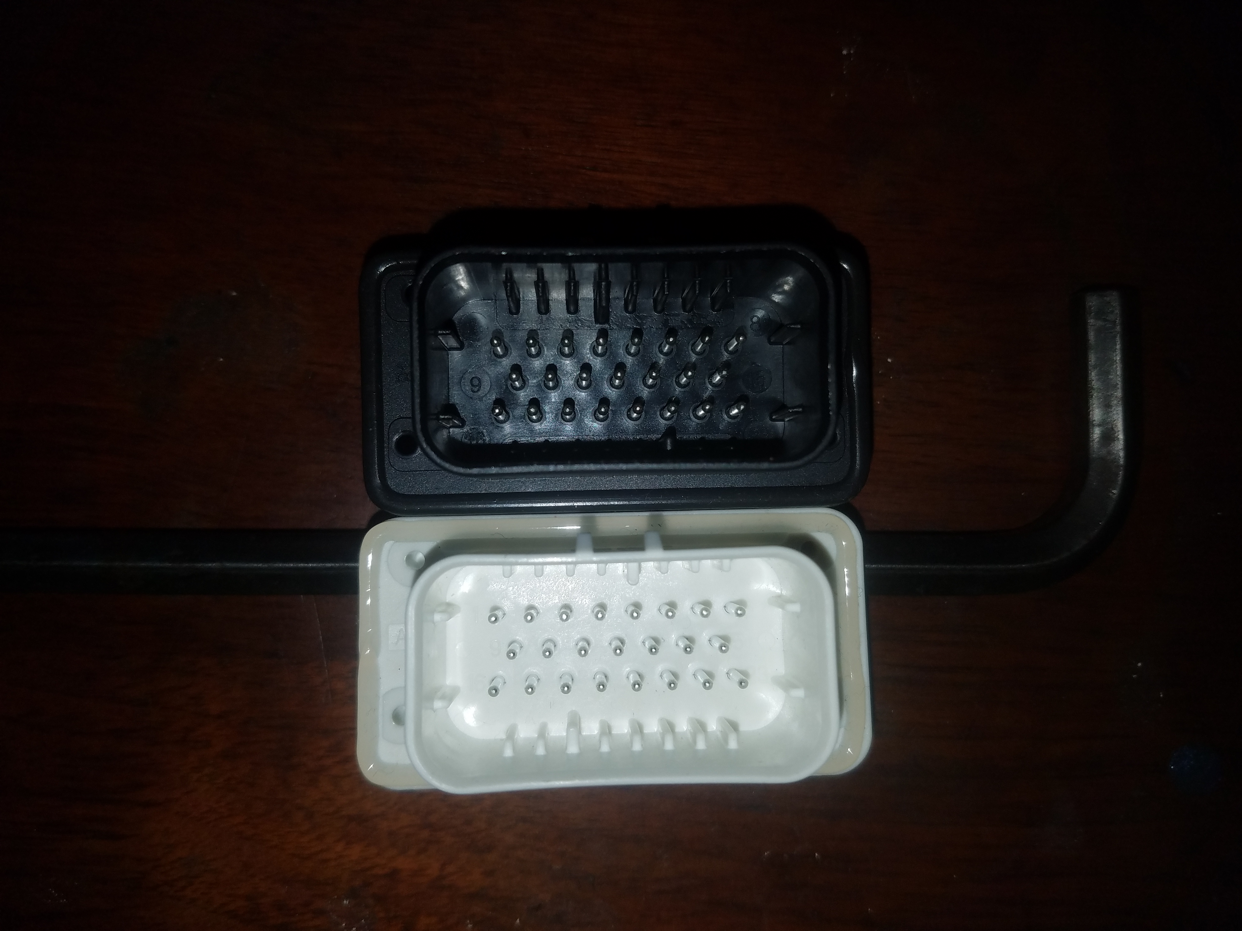

Ok got a couple of the the female connectors. One is a 90 degree TE Connectivity, however none of the plugs I bought fit it. The other is not a 90 but the harness and Male plug slide together perfect and connect perfect. So maybe I can build a largish box to attach to the side of the motor to fit all this stuff inside or modify my 90 degree to fit? It's just a bit different but I think maybe I could modify with a dremel perhaps. I will post some pics.

The 90 degree header is set up a little different. the large plastic alignment prong is off a little bit to the left. Tried getting good pics under my led work light. Gonna try to set up better lighting.

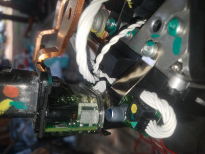

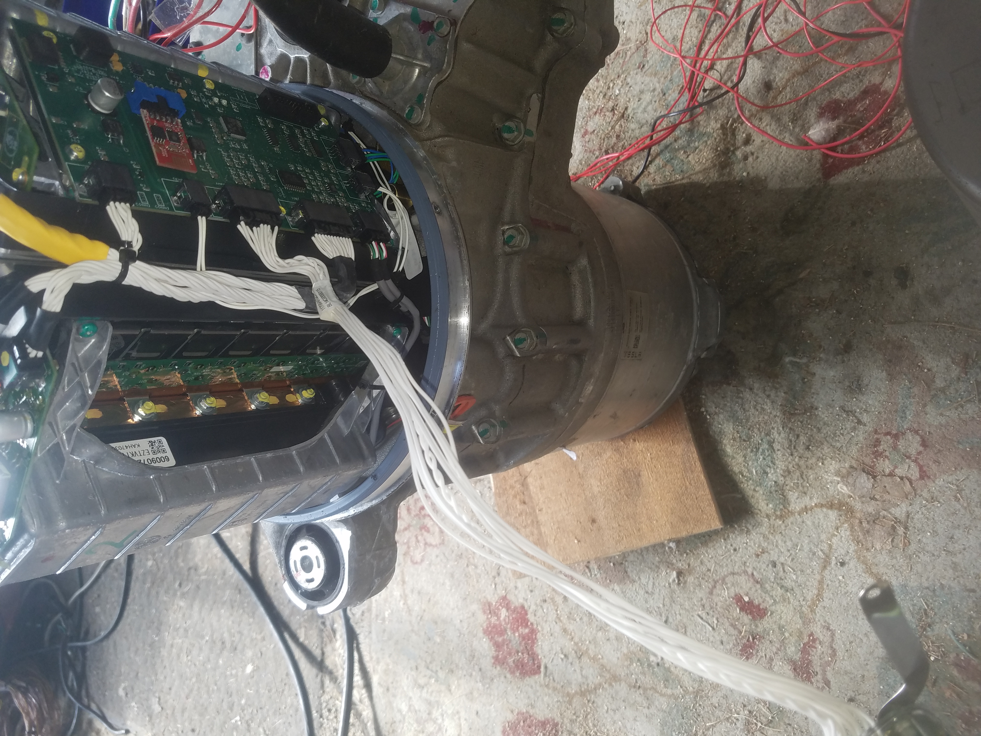

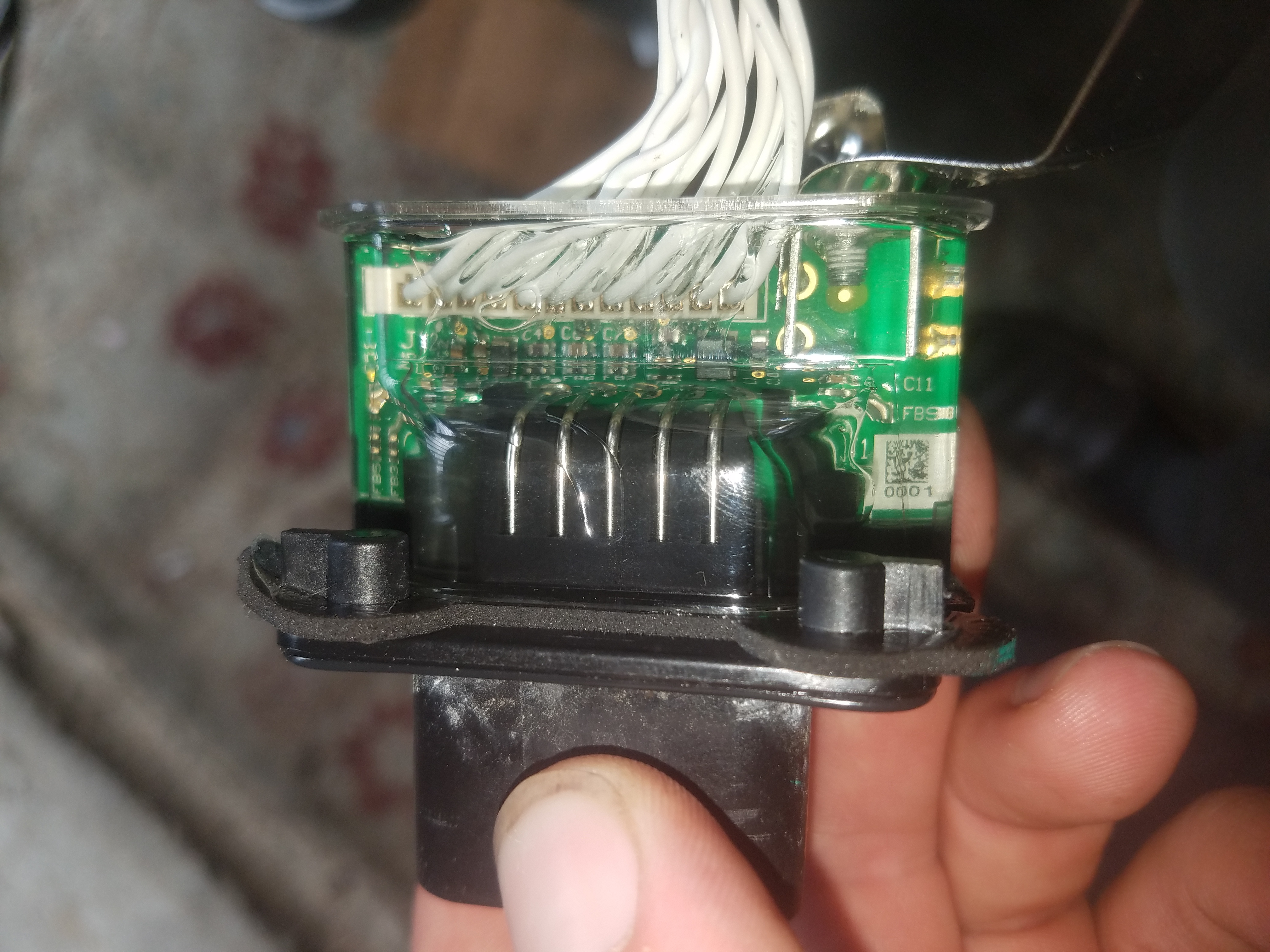

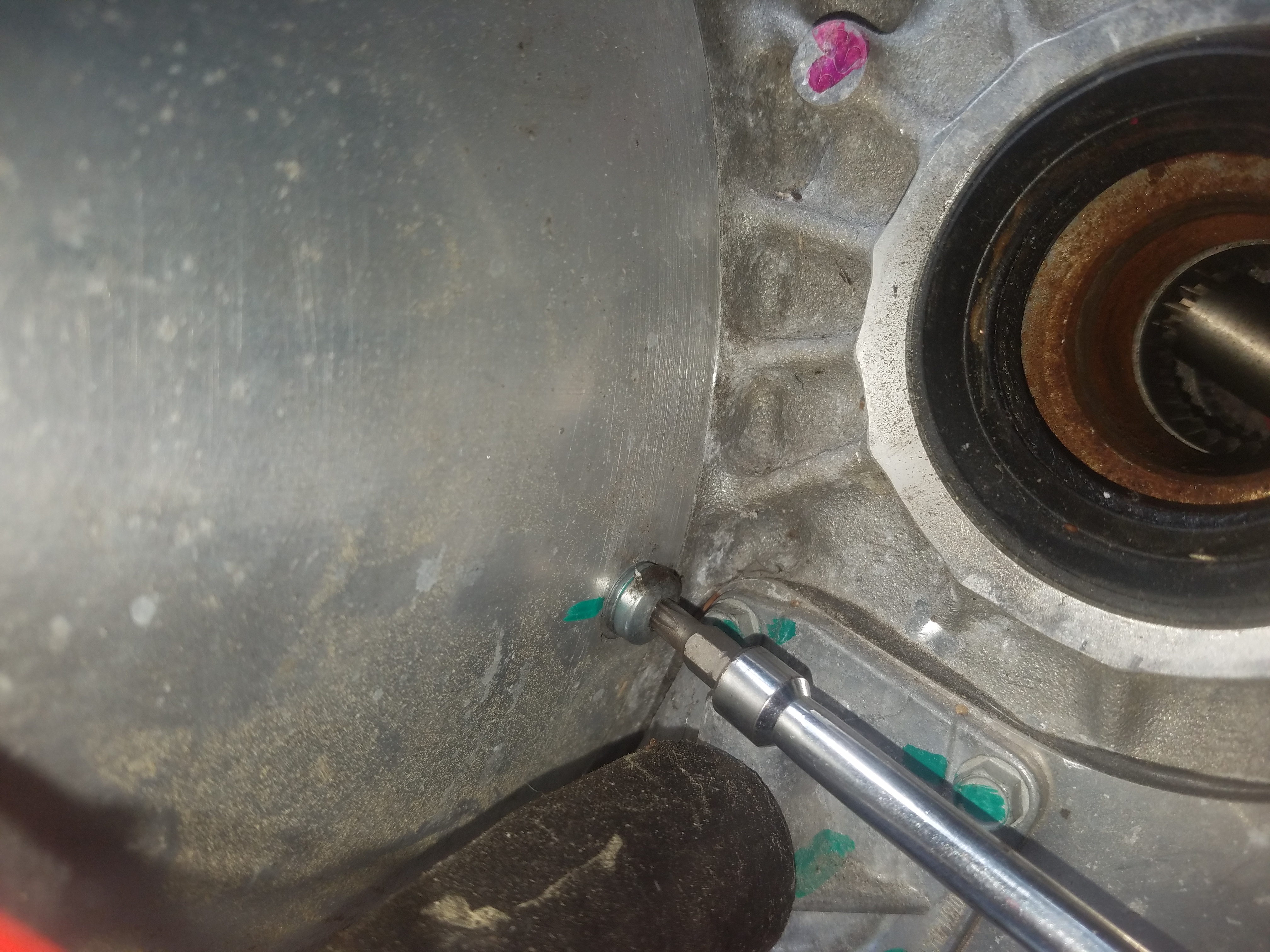

Ok opened up the case again to get a better Idea of what I am dealing with.

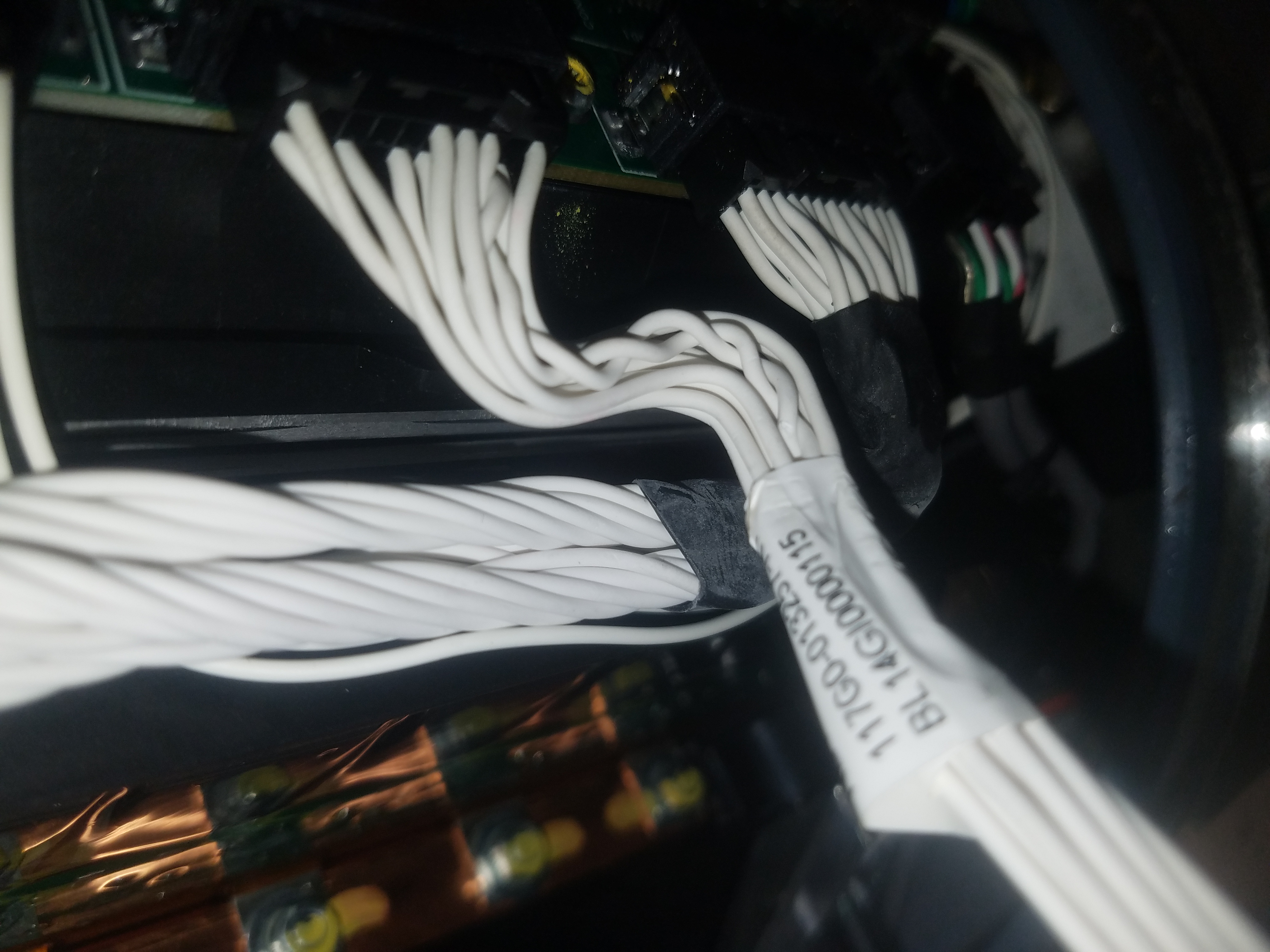

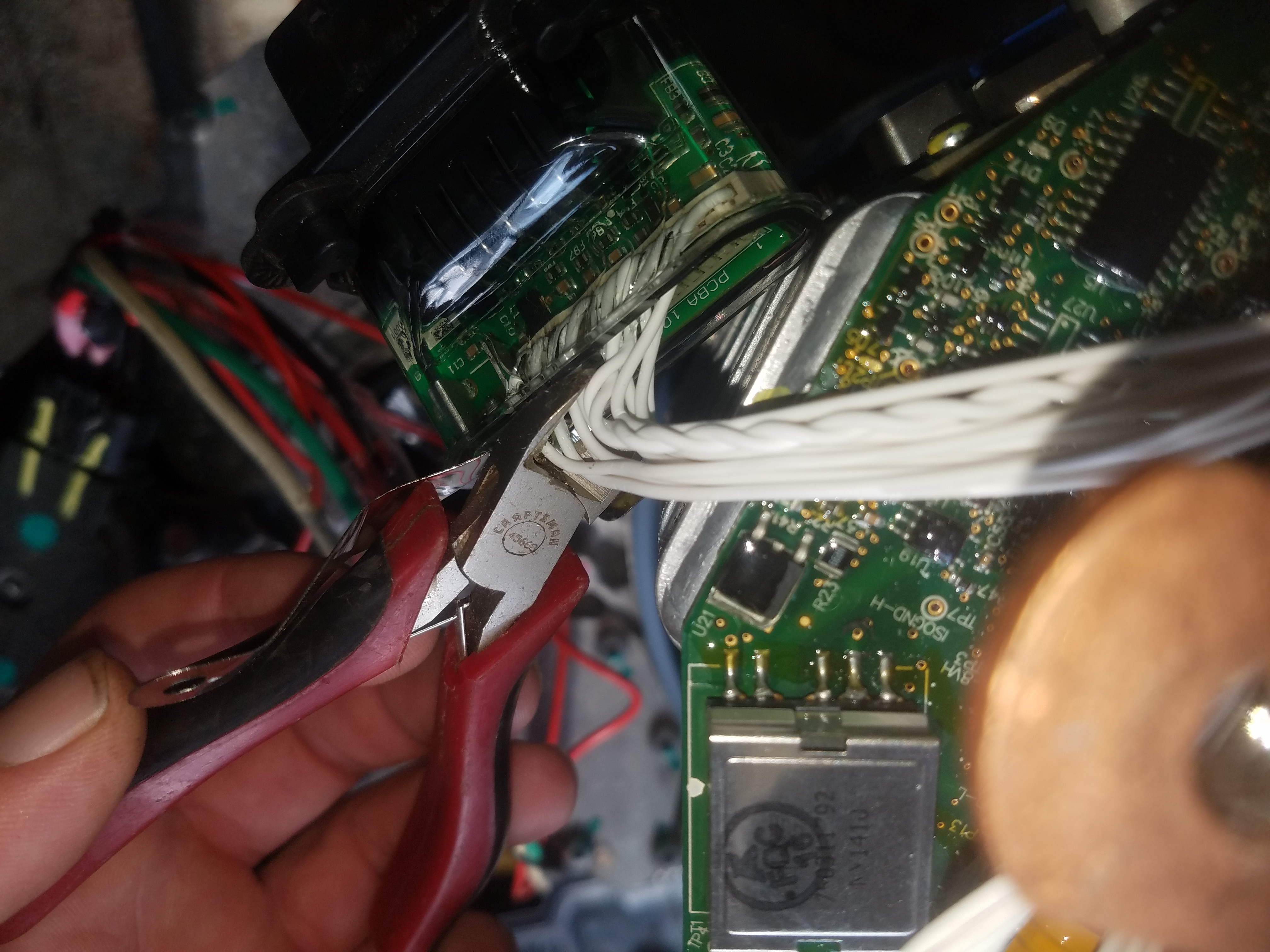

The wiring loom all passes through some type of mercedes connector board. Should I just cut the wires off one by one, extend them to be twice as long and then solder them to the pins of my new ampseal connector that fits my harness?

I didn't actually cut all those wires yet. Haha
Posts: 2410
Location: Bristol
Has thanked: 209 times
Been thanked: 572 times
Re: Mercedes-Benz B Electric - motor support
You are missing wires on the control board side. As I mentioned before in this thread. You need to source the crimps to add more wires into the board connector.

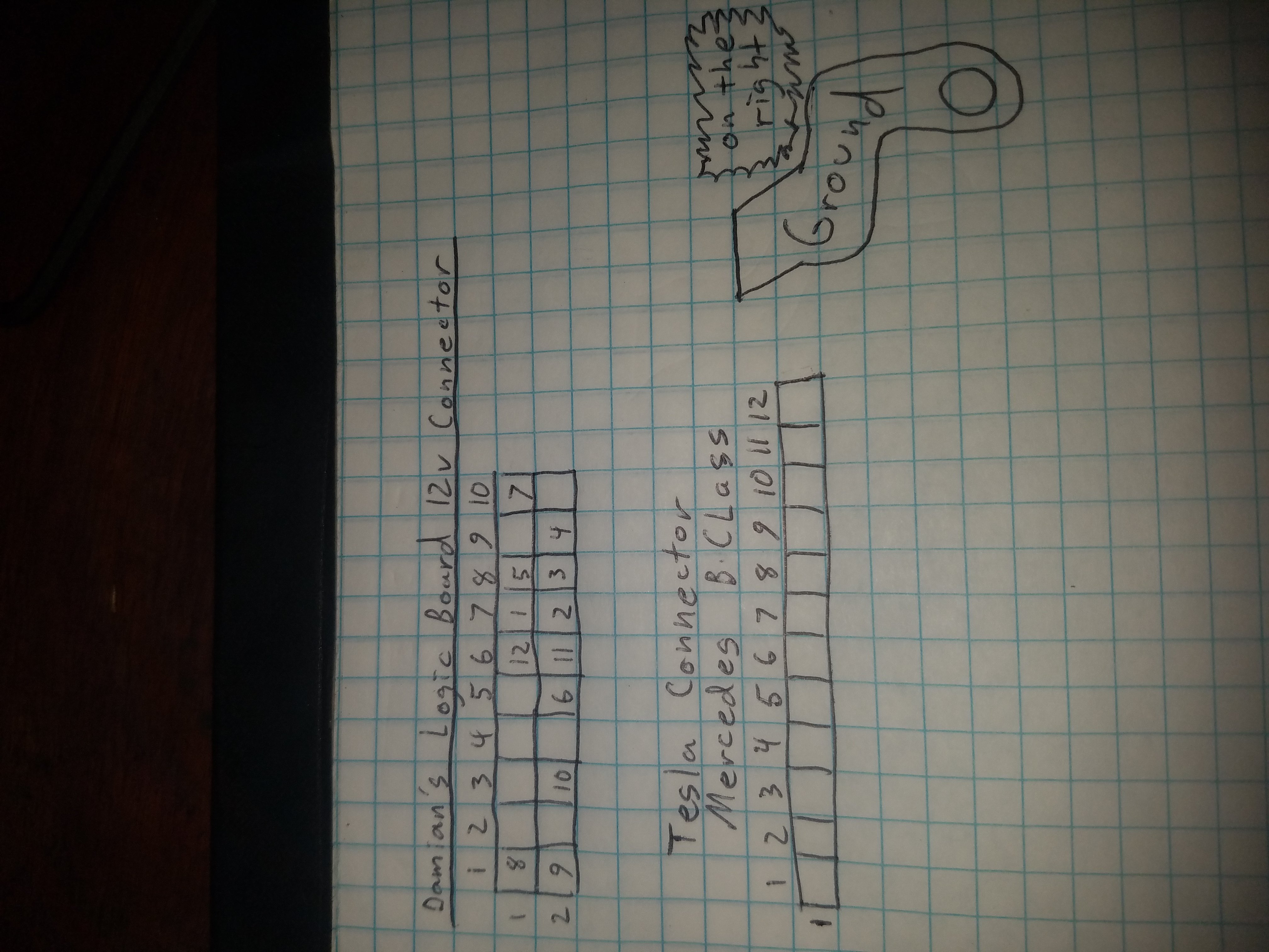

Generated a wiring pinout.
This is actually the connector from the mercedes. I need to find the 12 volt pinout from a tesla large drive unit because that is what I am trying to get to work.

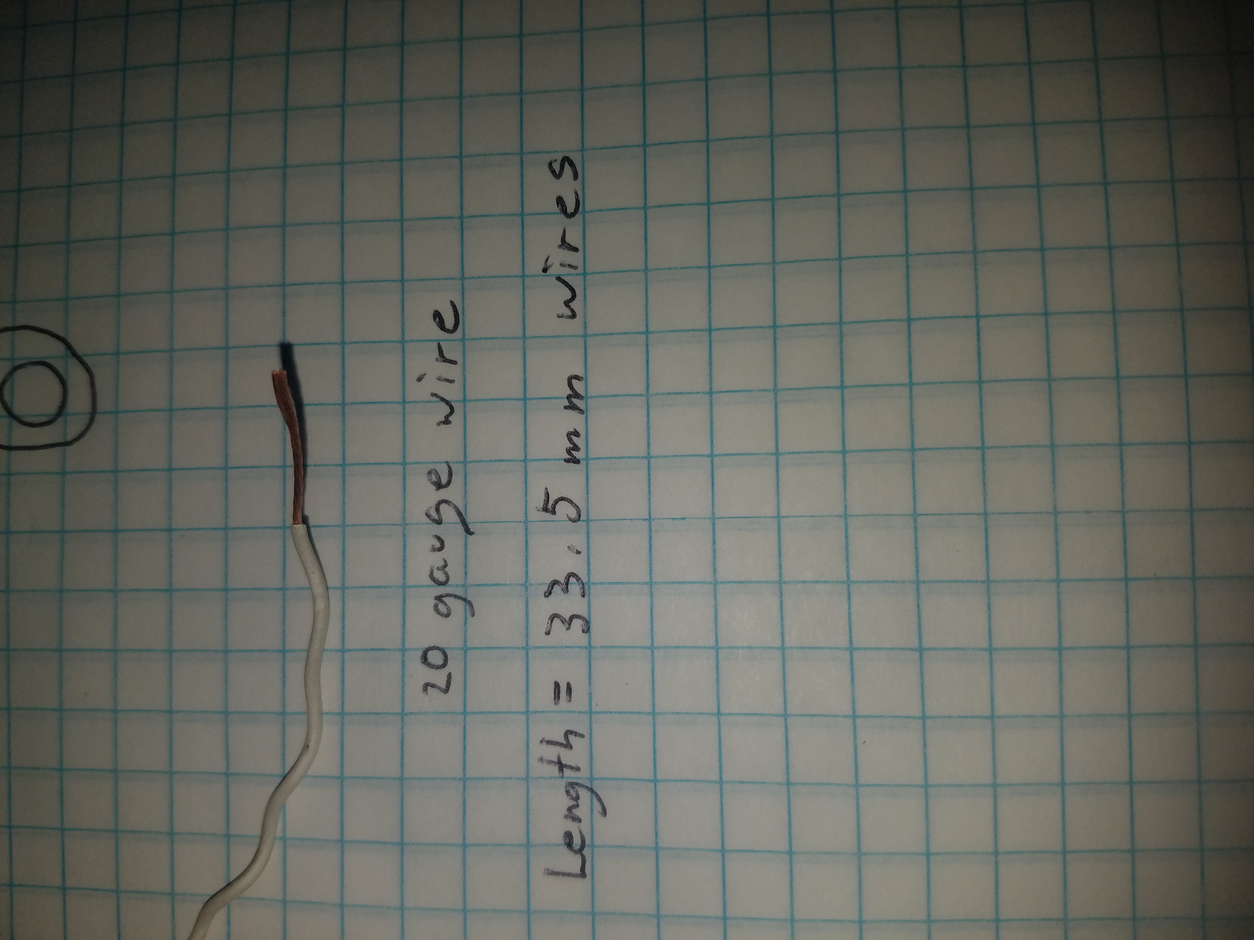

Now I am starting to understand. This connector needs more wires and female pins added so that I can have all the wires I need. Anyone have an idea what size I am looking for? I know the wire gauge is 20. Maybe someone knows who makes this connector or where there is a part number on the connector?
You cannot swap the "Tesla" version of connector in there, it will hit the internals as I said before.
Connector for the logic boards is: JST 24CPT-B-2A
Pins are: scpt-a021gf-0.5

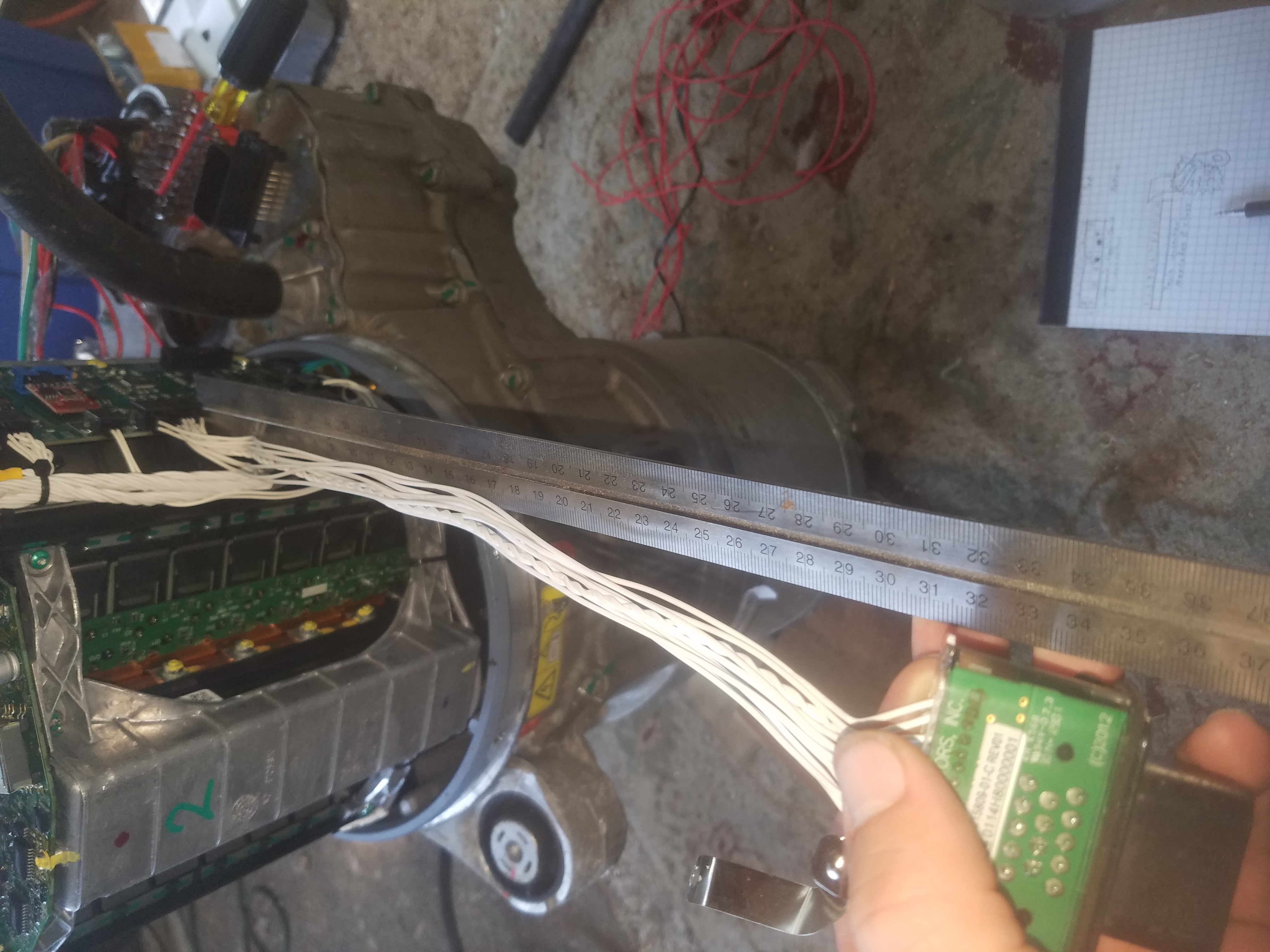

Now that I am starting to wrap my head around all these cool parts I think I am about to finally complete this simple task. Wish I bought this harness like suggested earlier on and just cut off one end and made it twice as long. I was very confused back then and thought this was a harness outside of the inverter. Now I can see that it is the harness that comes directly off my logic board and it just needs to be twice as long.
Today I have all the parts to build this harness except for cables. I am going to drive over to home depot and see if they got some 20 gauge cable like the ones that my mercedes harness used. It looks like it was not shielded. I still am on the look out for some cat5 shielded ethernet cable like damian recommends for using for all of the 12v cables on the large drive unit. Wonder if I used shielded cables it would be ok for this board to 23pin connector project I got going on?

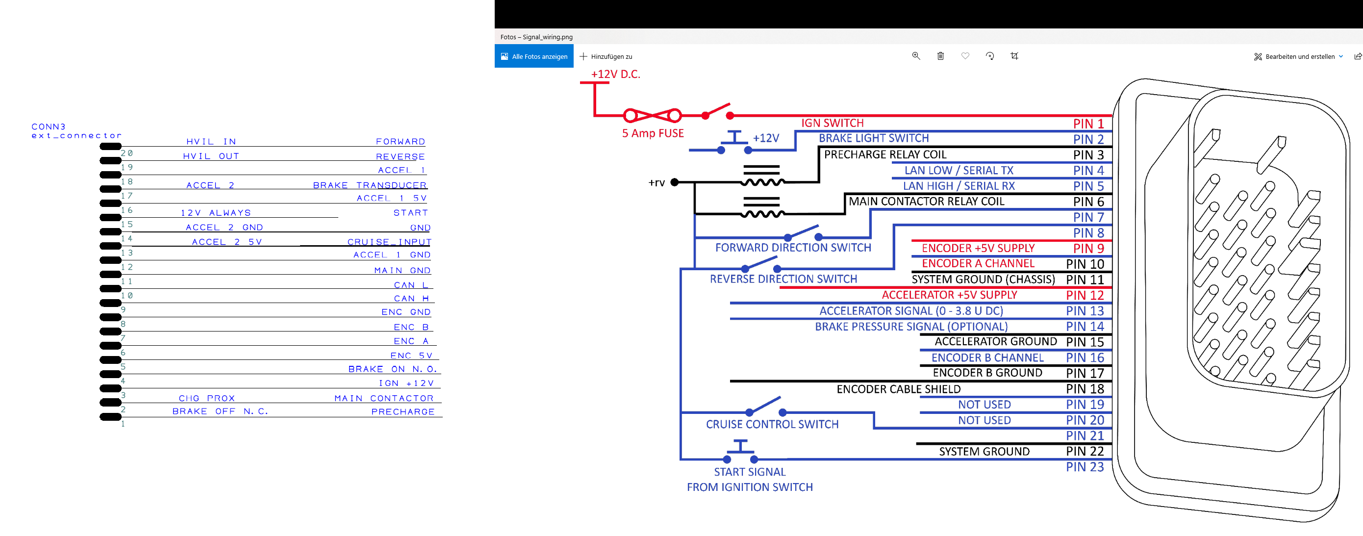

Also not exactly sure about the pinout on the board end. I know what the pinout should be for the 23 pin amp seal connector should be because of the Large Drive unit support page has it on the first page.
openinverter.org/forum/viewtopic.php?f=10&t=76

leman2112 wrote: Thu Oct 15, 2020 8:10 am Also not exactly sure about the pinout on the board end. I know what the pinout should be for the 23 pin amp seal connector should be because of the Large Drive unit support page has it on the first page.
Does that help?

Wow yeah that helps ! Thanks!
