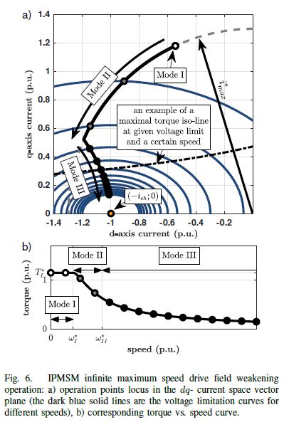

I can see in this graph attached a few posts earlier that at the mode 2 - 3 transition point Id is more than double that of Iq. Is this a typical ratio for these types of motors?

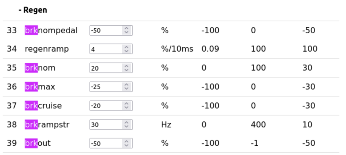

johu wrote: Thu May 13, 2021 5:36 am Bad news: the problem with uncontrolled regen at high rpm can still occur :(
Was coasting down a steep decline at 130 km/h (7000 rpm) when a 100 limit came up. Regen was off, so I switched it back on. First nothing happened, then a huge jolt of regen, then, fortunately, overcurrent.
We tripped the overcurrent limit at 65mph today when removing foot from the throttle.
Got -180A, thats -64kW of braking @ 356V!
ChaDeMo is -50kW I suppose, so we are vaguely within battery params, but I would like to reign it in regardless.
A lot more than I feel comfortable with, but at the same time the vehicle drives very nice in city traffic.
What are good settings to have strong regen in city traffic and not hit overcurrent limit on fast roads?
- I could reduce regenramp back to 1 to give it more time?
Settings and outcome below.
We are not going on the motorway before we figure this one out I think.
Help appreciated.
Edit: Sorry, just saw that this thread is about 5.05, found it via search. We are running 5.14 on that car. Can move the post over if that is better.
Been thanked: 1914 times
Re: Inverter Firmware v5.05.R
What rpm are you running at said speed?
I'd reduce regenramp to 0.3 and also choose a slow throtramp. Like 4 or less.

johu wrote: Tue Jan 25, 2022 8:50 am What rpm are you running at said speed?
Nice, same occurs with those parameters.
rpm were not captured, but wheel diameter is 66cm @ 8:1 & 65mph I would expect to be 6200rpm+.
I had a look at float Throttle::RampThrottle(float potnom), there were some changes lately, the car drove 5.14R. I will upgrade to 5.17.
You mentioned it might be possible to change the ramping up for Regen in the code, is that the 5 in throttle.cpp:135@R5.17?
   if (potnom >= throttleRamped)
      throttleRamped = RAMPUP(throttleRamped, potnom, throttleRamp);
   else if (potnom < throttleRamped && throttleRamped > 5)
      throttleRamped = RAMPDOWN(throttleRamped, potnom, throttleRamp);
   else //potnom < throttleRamped && potnom <= 0
      //throttleRamped = MIN(0, throttleRamped); //start ramping at 0
      throttleRamped = RAMPDOWN(throttleRamped, potnom, regenRamp);
https://github.com/jsphuebner/stm32-sin ... e.cpp#L135
I had a quick browse but wasn't 100% sure yet. I can compile that with a 10 and try it again next week.
Edit: Discussion continued in dedicated thread: https://openinverter.org/forum/viewtopic.php?f=7&t=2226
I see, I thought I had it start at 3% but it's 5. Of course the comment is wrong, it starts slow ramping below 5 or whatever you put into the preceding if statement.
