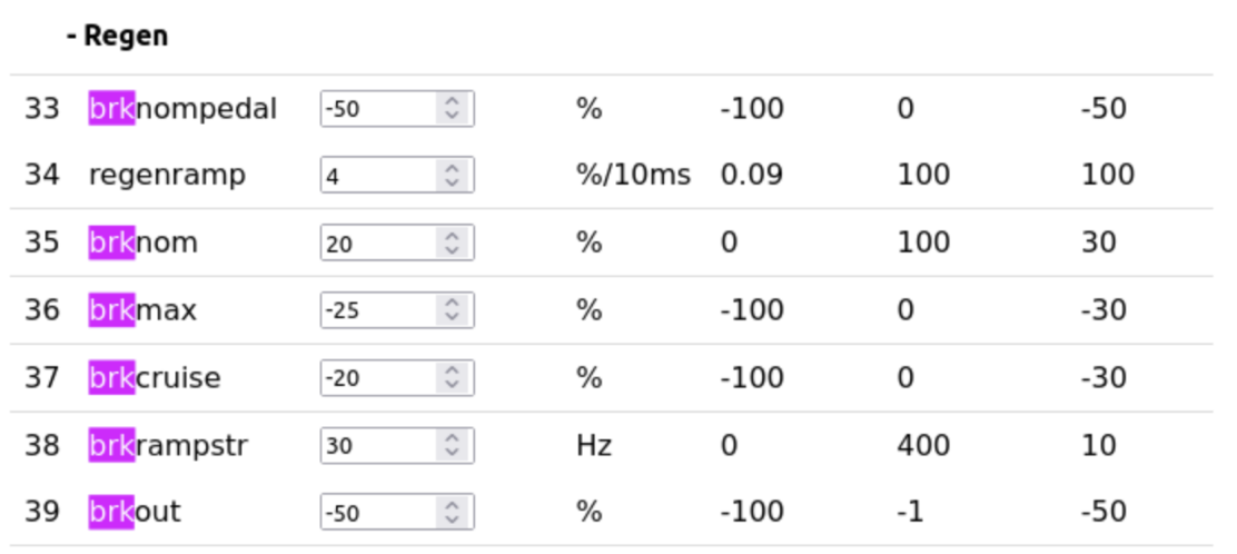

Well I like both, in city driving or on hilly roads I enjoy strong regen. So I ultimately want it to be fully usable.
I tested the field weakening controller today. At around 5500 rpm and full throttle it starts to command a current. With light throttle at 7000 rpm it commands no current. So I'm thinking to turn off regen while field weakening current is still above a certain threshold. So when you come off throttle it will taper off and then regen can come back in.
Still gives you the liberty to turn it off.

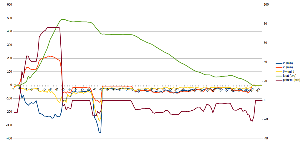

Did some testing today but could not provoke unintended regen or overcurrent shutdown. Probably because the battery is fully charged and not as much field weakening is needed. Still some interesting results:
Starting at around sample 37 you can see I'm coasting (downhill) at 7200 rpm. The field weakening (FW) controller commands about -50A as to not produce negative torque. Strangely though I could see about 4 kW going into the battery and also felt a braking force.
Now around sample 50 I step on the brake which commands 15% regen through the pressure sensor. Now I would expect the FW controller to stop commanding current because I WANT negative torque. But it actually commands like -250A FW current! I think that is a problem.
So I'm seeing two issues: FW controller not working as intended in high speed regen scenario and probably misalignment of actual rotor position and calculated rotor position. The latter can be attributed to bad tuning of syncadv, i.e. the factor that compensates the rotor movement between measuring and processing the position.
I will temporarily make syncadv a parameter again and go over the maths of the FW controller.

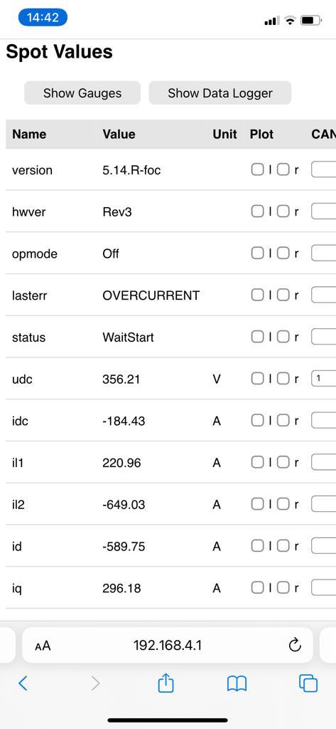

Had some success by limiting the maximum output of the d-current controller to (max-2000)/2. In normal operation it outputs a negative or slightly positive value but whenever I ran into an over current it was stuck at max-2000. This severely limits the output range of the q-controller which outputs a high positive value when regenning at high speed. I never ran into unwanted regen again.
I still ran into an over current issue when transitioning quickly from uphill full throttle at max rpm to uphill regen. Now in this case the q-controller was stuck at the negative-most value while in forward motion it never usually outputs negative values. In reverse it outputs only negative values.
Now I could also limit its output to negative only in reverse and positive only in forward. I think that would cure the over current events, even though it's a bit of a symptomatic fix.
I would rather like to know WHY it outputs negative. Maybe the integral gain is too much at 20000?
Also it seems operation is more stable with high values for fwkp, had set it to -150 and that alone cured many over current events without limiting controller output.

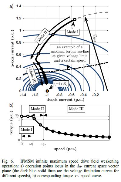

That's an interesting one. Would that apply to all IPM motors?
bexander
Posts: 866
Location: Gothenburg, Sweden
Has thanked: 71 times
Been thanked: 97 times
Re: Inverter Firmware v5.05.R
Post by bexander »
Interesting indeed.
Measuring the characteristic current as described seem like a real hassle. If the permanent magnet flux is the same as flux linkage it might be easier to measure this and Ld and calculate the value of the characteristic current. Might also be possible to set a value and then test and adjust.
I think this is similar to the "fancy equations" found here https://se.mathworks.com/help/mcb/ref/m ... rence.html for the Interior PMSM?
