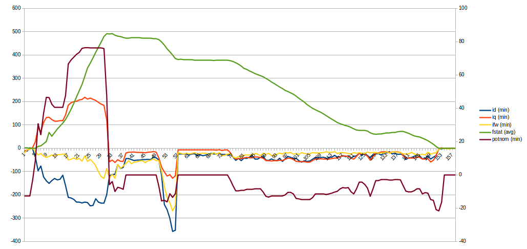

Did some testing today but could not provoke unintended regen or overcurrent shutdown. Probably because the battery is fully charged and not as much field weakening is needed. Still some interesting results:
Starting at around sample 37 you can see I'm coasting (downhill) at 7200 rpm. The field weakening (FW) controller commands about -50A as to not produce negative torque. Strangely though I could see about 4 kW going into the battery and also felt a braking force.
Now around sample 50 I step on the brake which commands 15% regen through the pressure sensor. Now I would expect the FW controller to stop commanding current because I WANT negative torque. But it actually commands like -250A FW current! I think that is a problem.
So I'm seeing two issues: FW controller not working as intended in high speed regen scenario and probably misalignment of actual rotor position and calculated rotor position. The latter can be attributed to bad tuning of syncadv, i.e. the factor that compensates the rotor movement between measuring and processing the position.
I will temporarily make syncadv a parameter again and go over the maths of the FW controller.

Had some success by limiting the maximum output of the d-current controller to (max-2000)/2. In normal operation it outputs a negative or slightly positive value but whenever I ran into an over current it was stuck at max-2000. This severely limits the output range of the q-controller which outputs a high positive value when regenning at high speed. I never ran into unwanted regen again.
I still ran into an over current issue when transitioning quickly from uphill full throttle at max rpm to uphill regen. Now in this case the q-controller was stuck at the negative-most value while in forward motion it never usually outputs negative values. In reverse it outputs only negative values.
Now I could also limit its output to negative only in reverse and positive only in forward. I think that would cure the over current events, even though it's a bit of a symptomatic fix.
I would rather like to know WHY it outputs negative. Maybe the integral gain is too much at 20000?
Also it seems operation is more stable with high values for fwkp, had set it to -150 and that alone cured many over current events without limiting controller output.

Ok, best test run yet.
I have limited q-controller output as described. That led to like 1s of unwanted strong regen. So I lowered curki=10000 and everything is smooth now. Can transition quickly between regen and accel both uphill and downhill.
I also think low speed stuttering is less pronounced.
Please try it and remember to lower curki.
