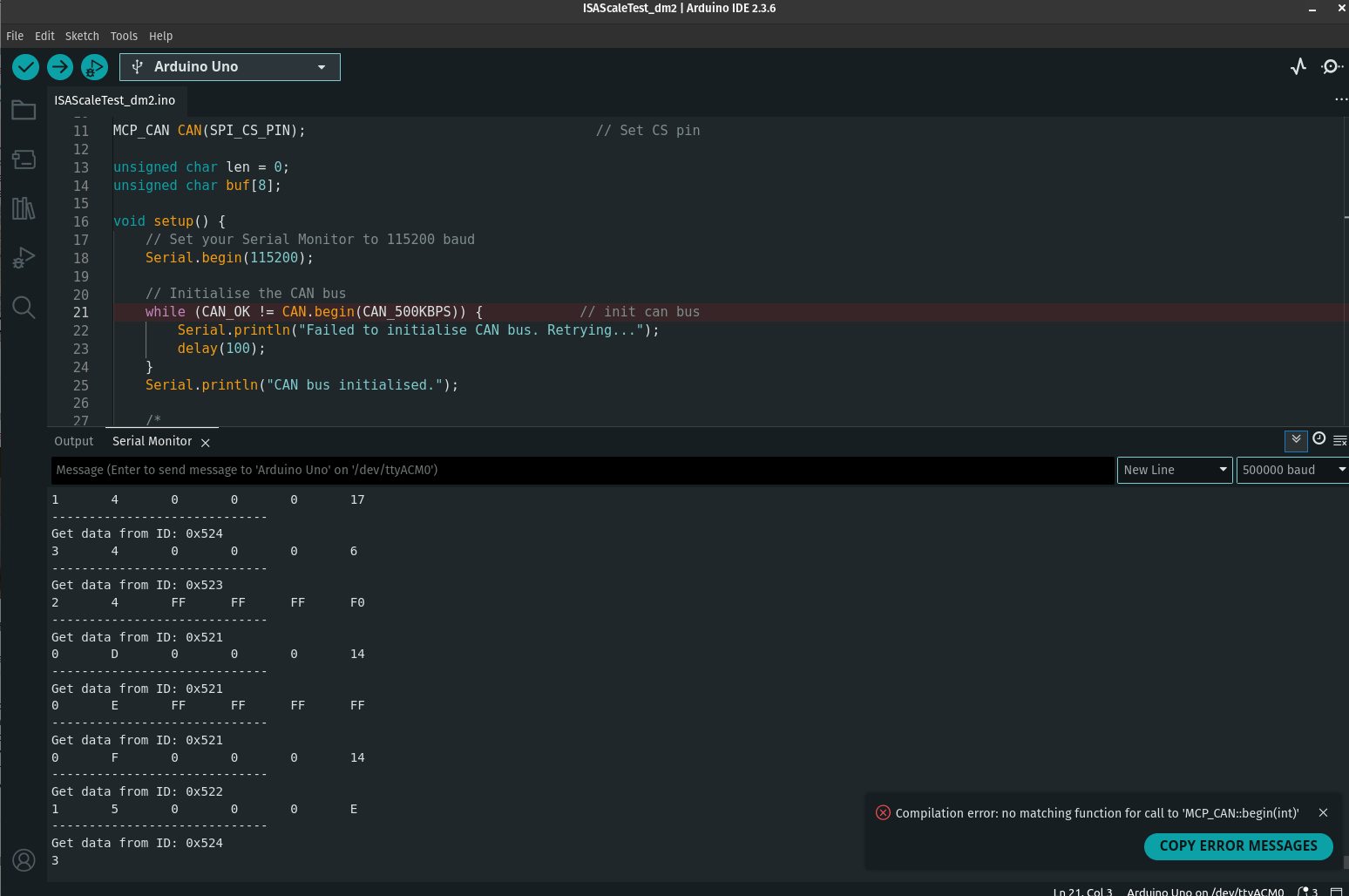

Did your shunt talk in 0x680 and 0x620 IDs too? I'm having difficulty with mine.
I received similar ISA (only 1x port) and having difficulty initialising.
I first hooked up Arduino Uno and followed: https://openinverter.org/wiki/Getting_s ... rduino_Uno
Arduino Uno spits out weird 0x680 and 0x620 IDs. When I try to filter for 0x521 (per https://openinverter.org/wiki/Getting_s ... bus_shield), I see nothing in the terminal.
I then hooked up to Due but it cannot seem to initialise :( I did follow https://openinverter.org/wiki/CAN_bus_with_Arduino_Due to ensure Due can talk CAN.
My current setup is: Arduino Due + Arduino Uno + ISA shunt. Bus is 60ohms - 2x 120ohm terminators. Uno is there to ensure Due does send data to the bus.
When I initialise from Due, my Uno sees the following - looks like correct init. data

But the ISA shunt keeps yelling the following by default. This is just a snippet for the continuos data.
Get data from ID: 0x680
6	D	0	0	0	0
6	4	0	0	0	0
Get data from ID: 0x620
0	E	FF	FF	FF	DB
6	F	0	0	0	0
6	5	0	0	0	0
6	B	0	0	0	0
6	1	0	0	0	0
0	8	FF	FF	FF	E7
0	D	FF	FF	FF	E7
6	4	0	0	0	0
0	62	0	0	0	3E

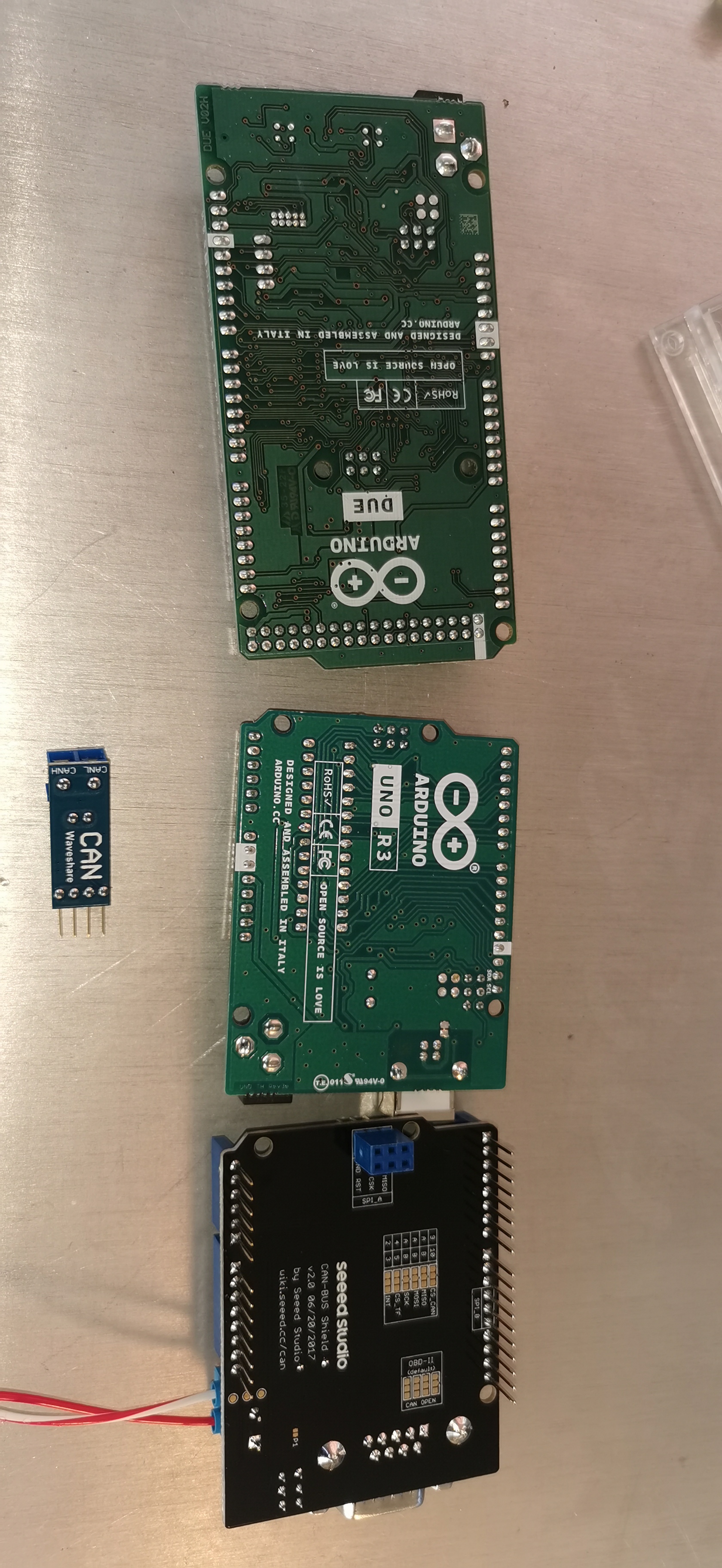

These are my hardwares. For some reason PMs get stuck in the outbox. I use the shield with UNO and the tiny CAN transceiver with the DUE.

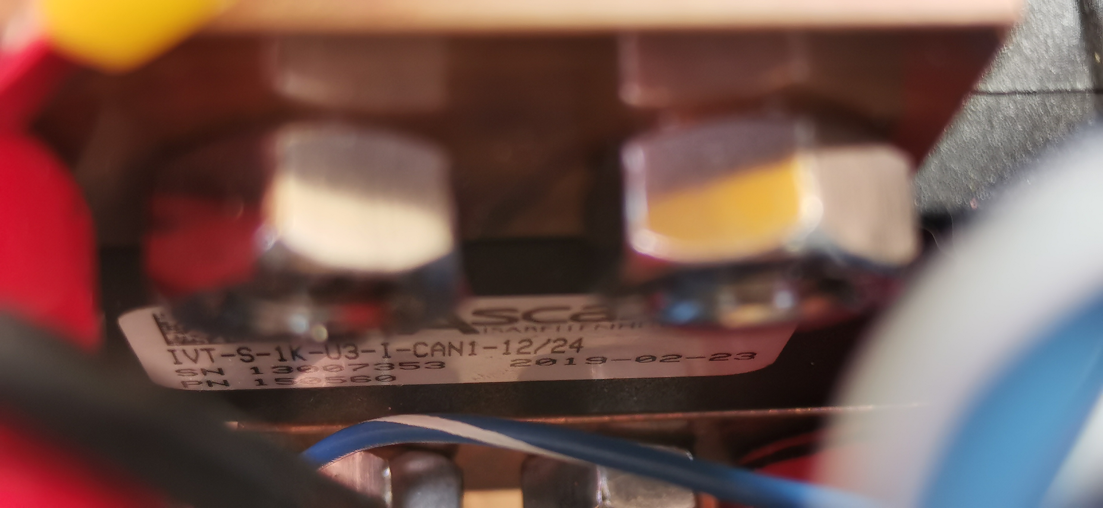

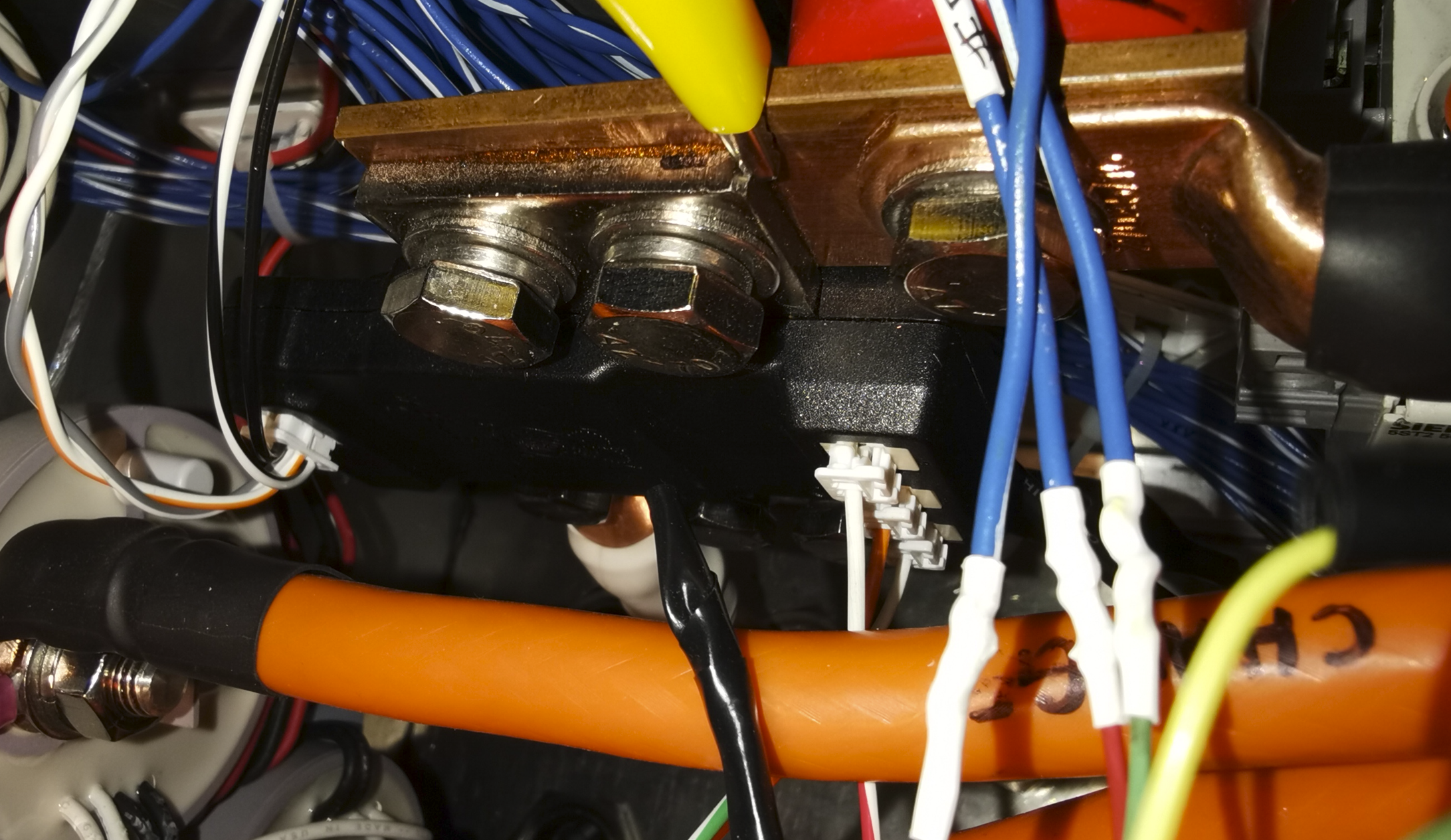

Did you inspect the shunt for origin? Last year i got similar ISA shunt out from the Jaguar pack.
I recorded some messages of current. viewtopic.php?t=1282
You may have OEM programmed ISA.

No markings other than what I've posted above.
Messaged ISA tech support and they said I should be able to reprogram it, but I don't think the shunt responds to 0x411 ID at the moment. The first data command on 0x411 ID is to put it in STOP. I'd assume it will stop posting messages on the CANbus, yet it still sends the 0x620 and 0x680 ID data.

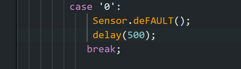

royhen99 wrote: Wed Sep 27, 2023 9:10 pm It looks like 0x620 is the current reading. You could try send 0x3D on byte 0 of ID 0x411 to reset to factory default settings, check CAN ids at this point and then initialise as before.
Tried this without success. :( Within the ISA.cpp there's deFAULT function. Added the case to the code. Triggered it, but no result. Still only receiving 0x680 and 0x620 IDs. Initialising after that doesn't work either.
void ISA::deFAULT()
         //Returns module to original defaults
	    outframe.id = 0x411;      // Set our transmission address ID
        outframe.length = 8;       // Data payload 8 bytes
        outframe.extended = 0; // Extended addresses  0=11-bit1=29bit
        outframe.rtr=1;                 //No request
        outframe.data.bytes[0]=0x3D;
        outframe.data.bytes[1]=0x00;
        outframe.data.bytes[2]=0x00;
        outframe.data.bytes[3]=0x00;
        outframe.data.bytes[4]=0x00;
        outframe.data.bytes[5]=0x00;
        outframe.data.bytes[6]=0x00;
        outframe.data.bytes[7]=0x00;
		canPort->sendFrame(outframe);
        if(debug)printCAN(&outframe); //If the debug variable is set, show our transmitted frame

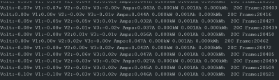

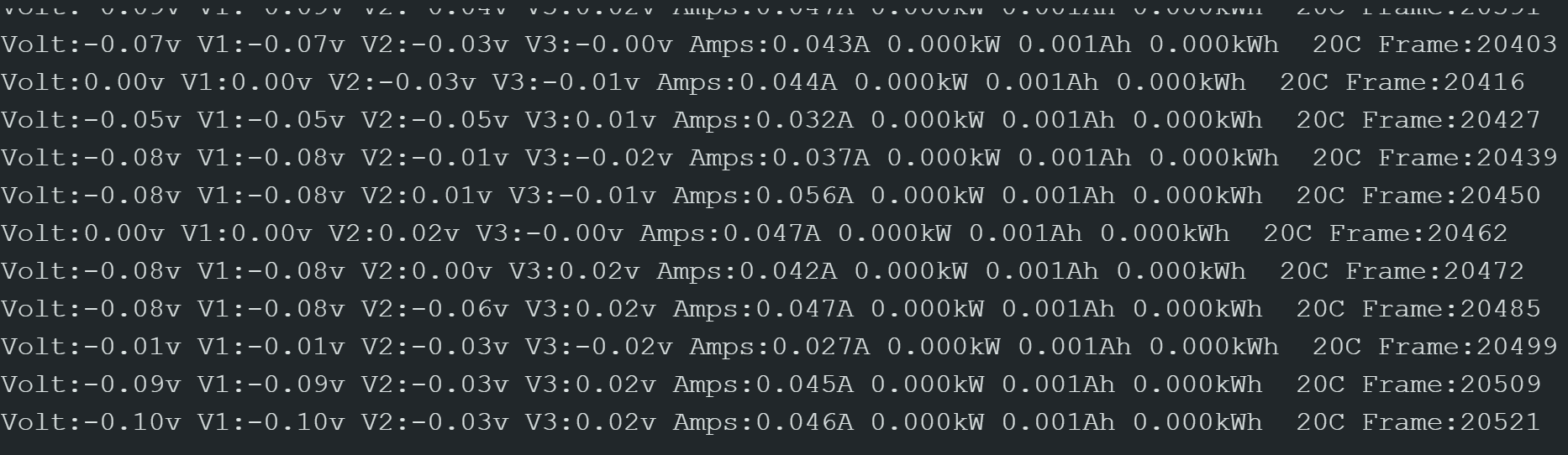

Ok. Some new findings.
Either after running the above factory reset command new IDs came out or after playing with the code I filtered for additional IDs.
0x620 - unknown. but I suspect this is where the current is read. having trouble finding 12VDC load with >1A. I think the sensor cannot read under 1A..
0x630 - V1 input
0x640 - V2 input
0x650 - V3 input

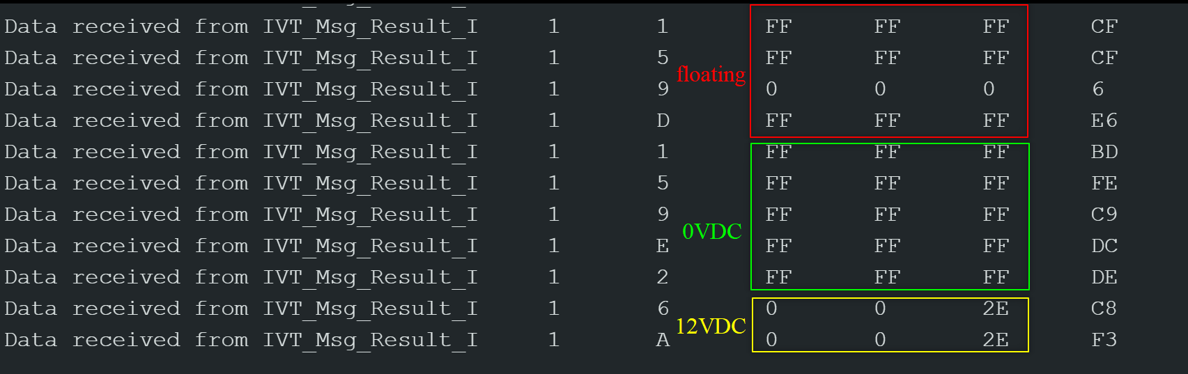

0x680 - unknow, some kind of counter. updates on its own, load or no load. maybe it's the runtime..
Vx inputs report FF FF FF and 00 00 00 when left floating, but always FF FF FF when tied to 0VDC. 12.09VDC reads as 00 00 2E. 12.56 reads as 00 00 30. 13.06 reads as 00 00 32.
example:
Still looking for the current ID...
Sensor doesn't respond to 0x411 ID to reprogram. Can the program ID be changed!? :roll:

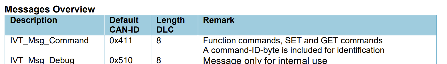

According to the data sheet the command ID can be changed. As you have a Ardunio Due it may be better to run Savvycan which allows all messages to be seen. You could also go through all the IDs automatically until you find the correct command ID.
alexbeatle
Posts: 292
Has thanked: 82 times
Been thanked: 35 times
Re: Can't Initialize Isabellenhütte ISA Sensor.
Post by alexbeatle »
royhen99 wrote: Mon Oct 02, 2023 4:03 am According to the data sheet the command ID can be changed. As you have a Ardunio Due it may be better to run Savvycan which allows all messge to be seen. You could also go through all the IDs automatically until you find the correct command ID.
Brilliant! Thanks for your help!

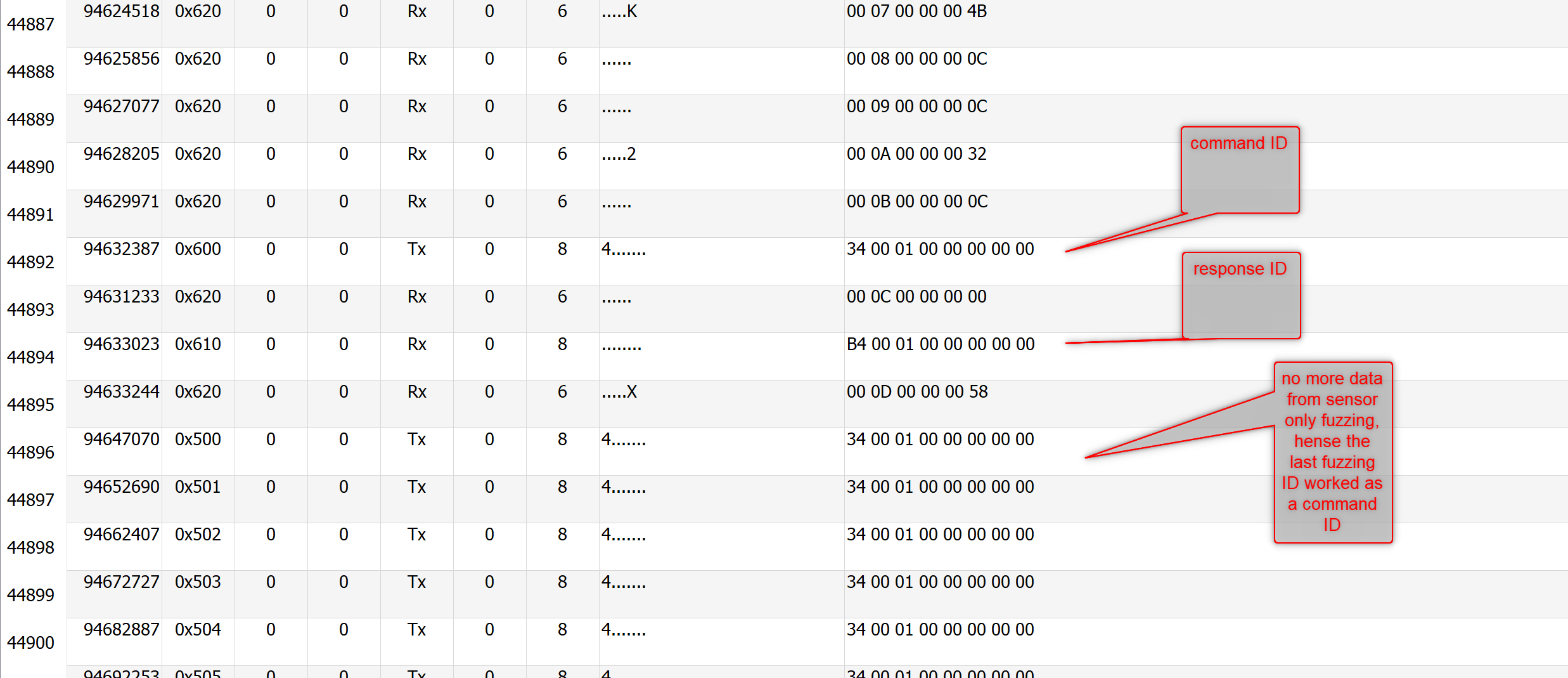

For future somebody who will get in the similar situation and not a programmer just like me....

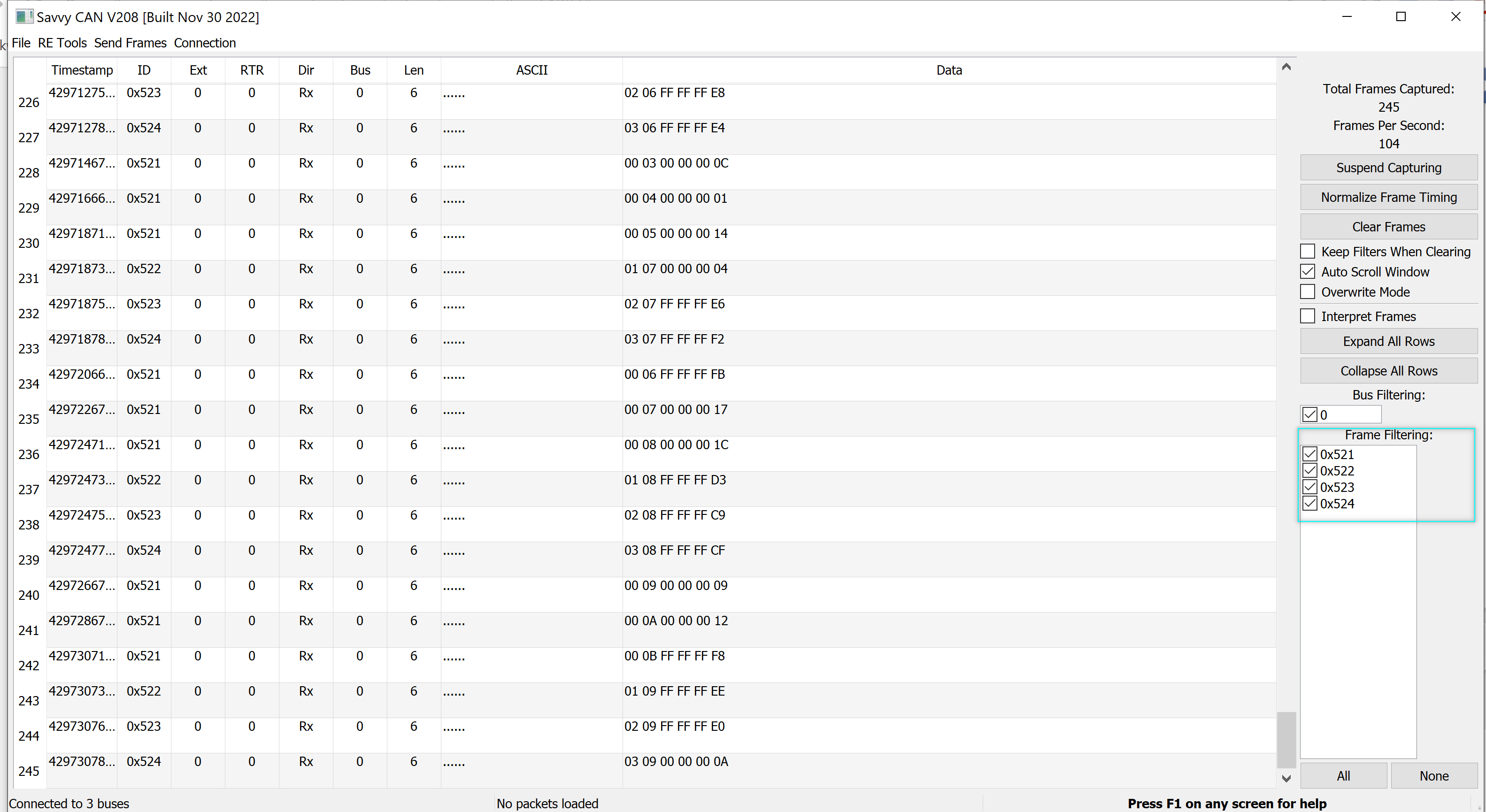

Setup SavvyCAN using this...https://openinverter.org/wiki/CAN_bus_with_Arduino_Due
Watch the video in the wiki to get yourself familiar with the SavvyCAN interface
Follow this tutorial for fuzzing.
You'll see a live data from sensor when connected.

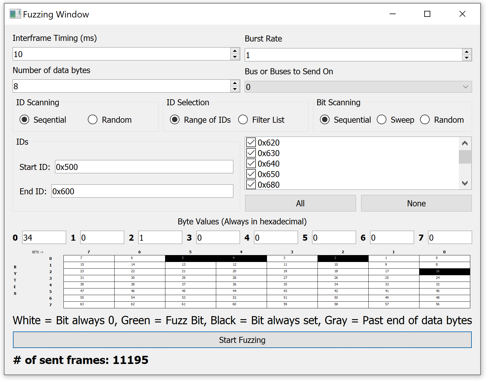

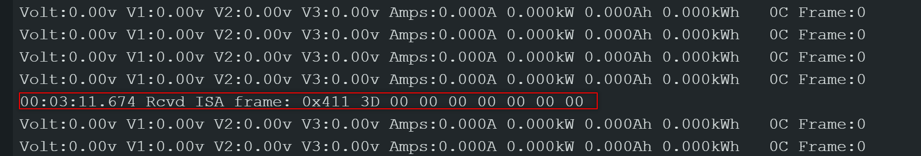

I decided to "fuzz" with the STOP command over a span of IDs to ensure I do not miss a response.

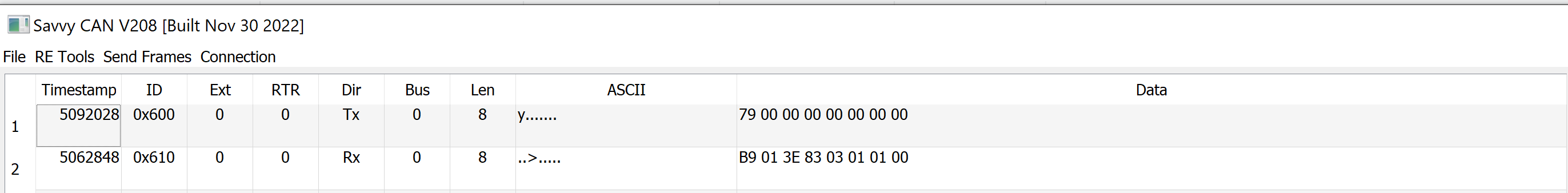

Turned out that my Command ID was 0x600 and Response ID was 0x610. I essentially ran the fuzzing until the sensor accepted the STOP command and stopped transmitting data and sent back confirmation.
Confirm by requesting data from sensor, e.g. request sensor version
Send Factory reset command to the command ID discovered above - data: 3D 0 0 0 0 0 0
...and voila, sensor transmits data over default IDs, ready to initialise.

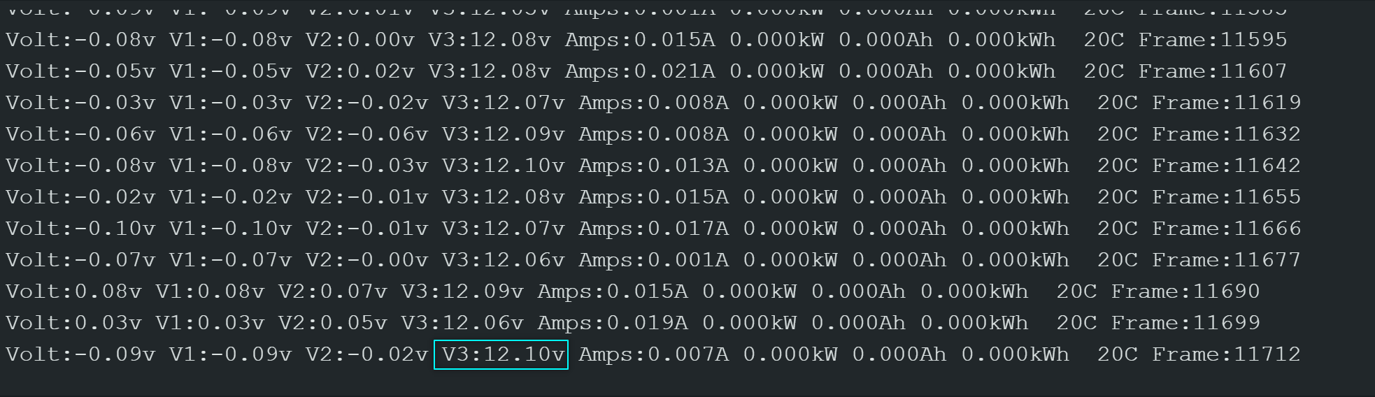

After initialisation:
Connected 12.09VDC to V3 input:
Amps are a little jumpy, but rather close. I think it's because my load is much too small (only 0.04A) for a 1000A sensor, cannot find anything larger in the house to test with.

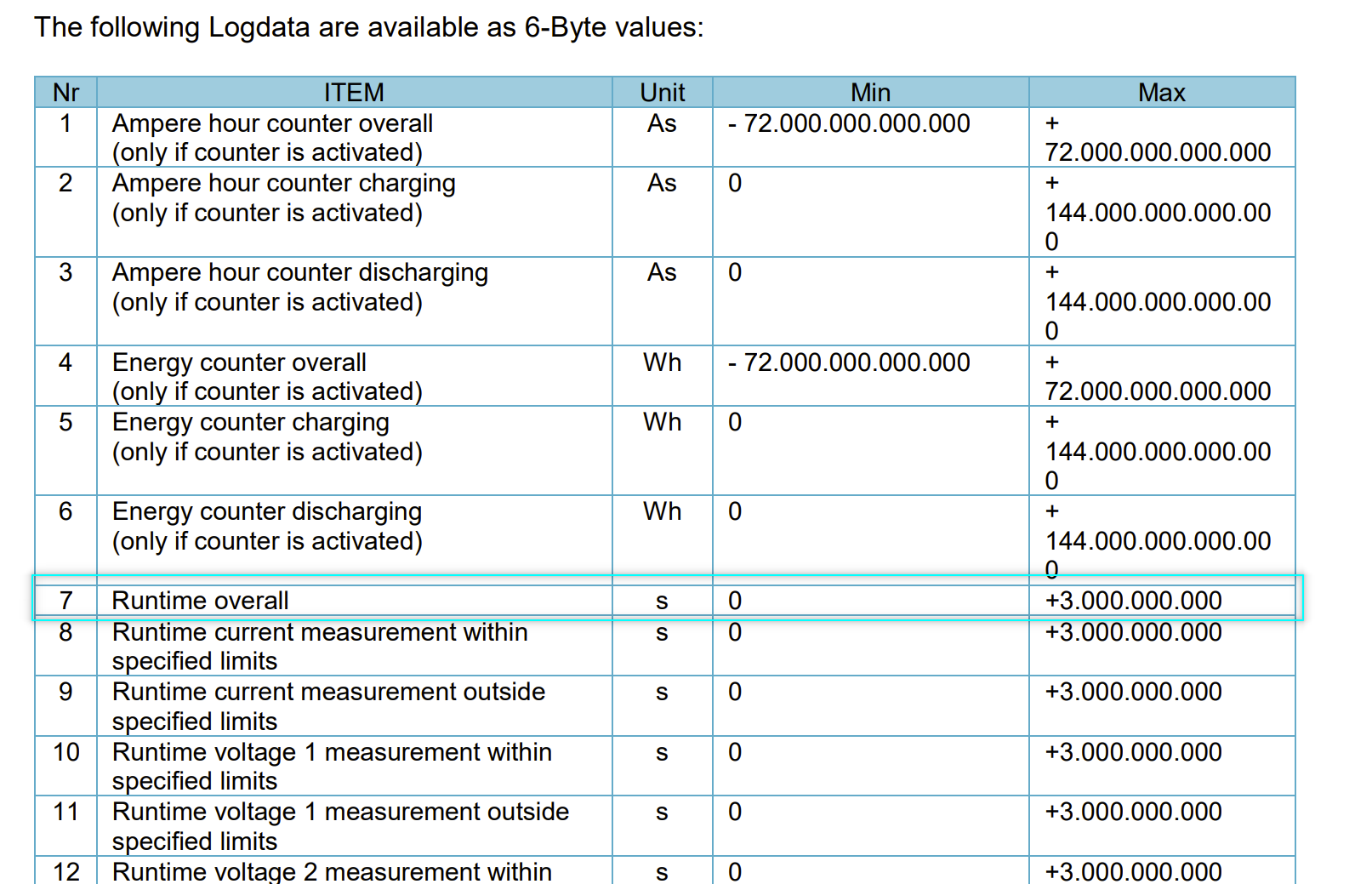

Attaching a useful How-to doc for different commands...
IVT-Mod_IVT-S_HowTo_1.2.pdf
(453.54 KiB) Downloaded 249 times

The code below should allow you to communicate with the ISA shunt and change it from the factory defaults to whatever you need. In my case, I got two shunts from Ebay with unknown provenance. They turned out to be set to 500kbs baud rate (the ISA can be set to 250kbs, 500kbs and 1000kbs).
I strongly recommend you read the ISA data sheet, as the code below is the bare minimum you need.
Some gotchas:
The Jack-Rickard-derived code set the rtr flag on the CANmessages to 1, it should be set to 0.
By default, the ISA is big-endian so the shunt may be working fine, you just may be decoding it wrong.
That said, whilst the code below sets all the messages to come back little endian, the current persists in coming back big-endian and I haven't looked into why yet. Fixed, I wasn't sending the correct identifier.
Check your CANbus termination - some of the shunts have in-built termination and some don't.
Check your CANbus transceivers if you are using cheap rubbish like me. I have had two batches of SN65HVD230-based tranceivers from Amazon, some worked, and some didn't, and some turned out to be not terminated when others were, so don't assume the transceivers are good.
I used a Teensy 4.1, with code below, and you need the excellent flexcan_t4 library by Tonton81 from here https://github.com/tonton81/FlexCAN_T4.

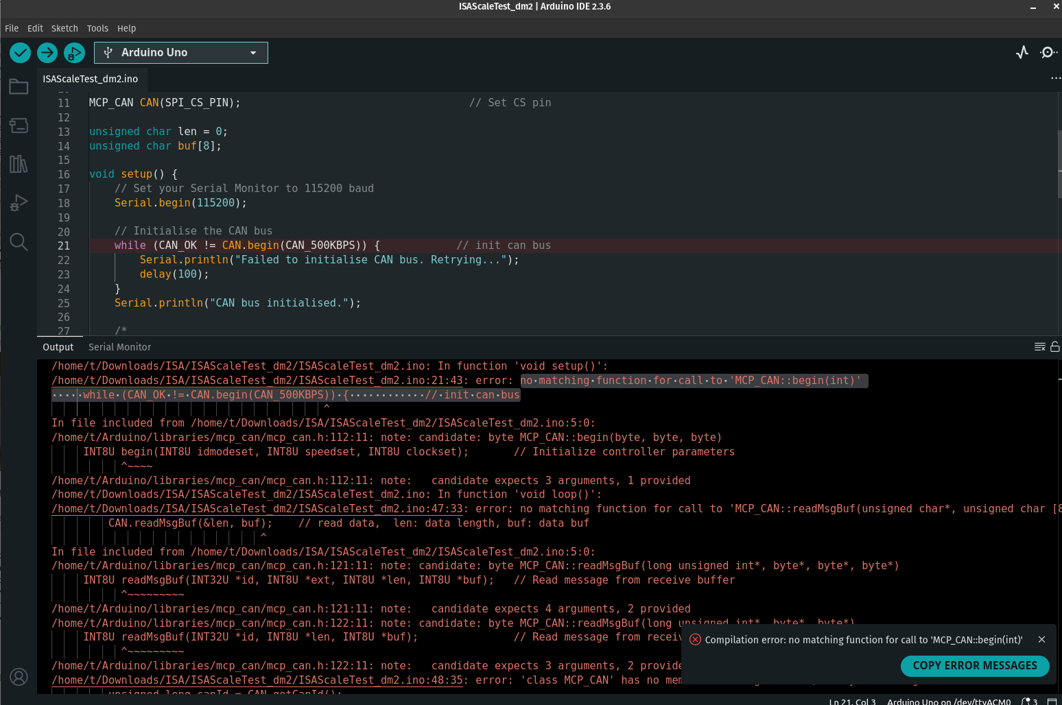

I was trying to use the Arduino UNO version with the shield but I get a lot of errors.
The ISA works but i cannot add the 528 message for energy since I cannot make the sketch work.
If anybody has any suggestions.
