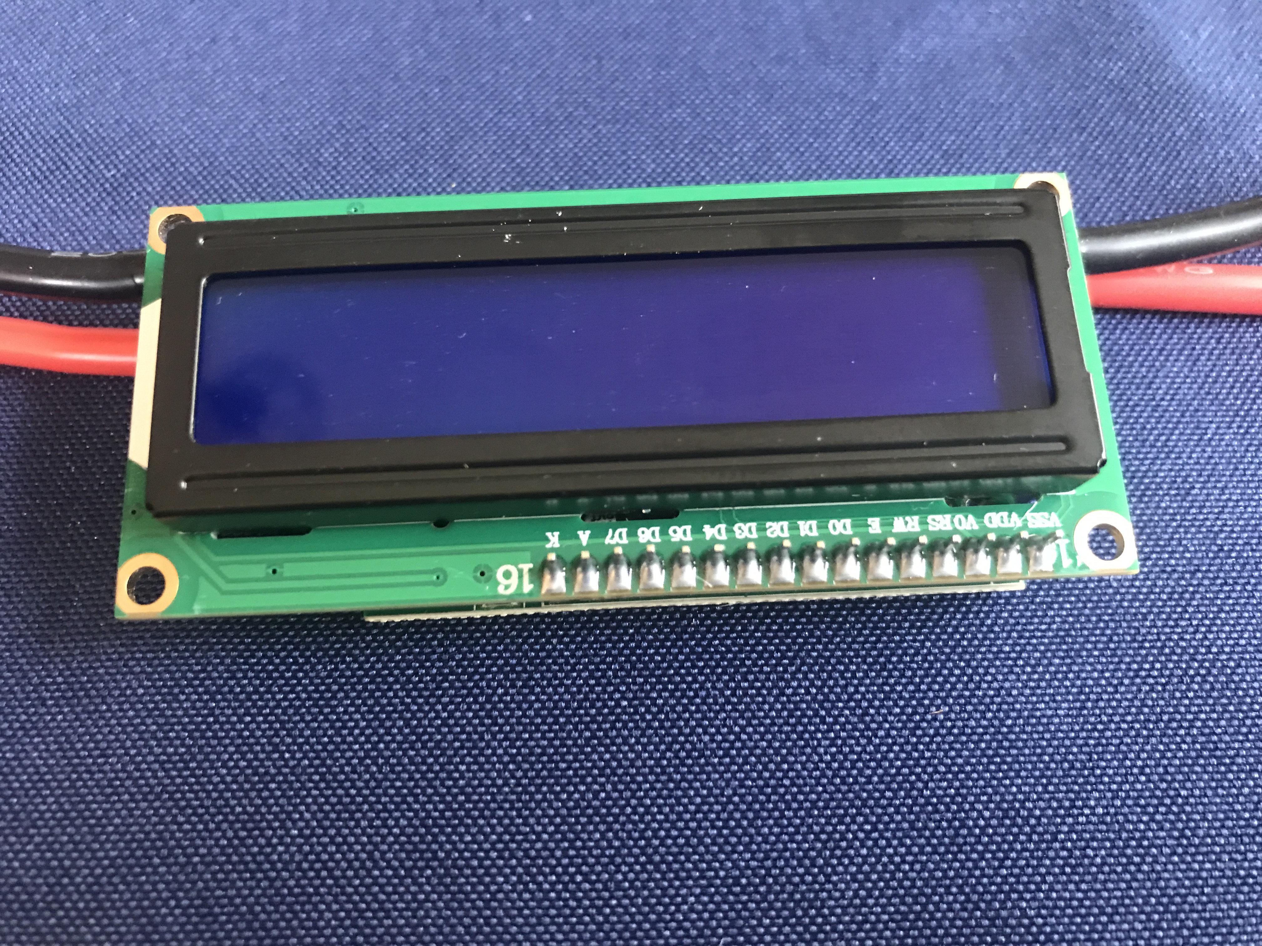

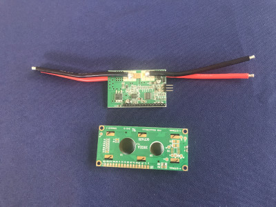

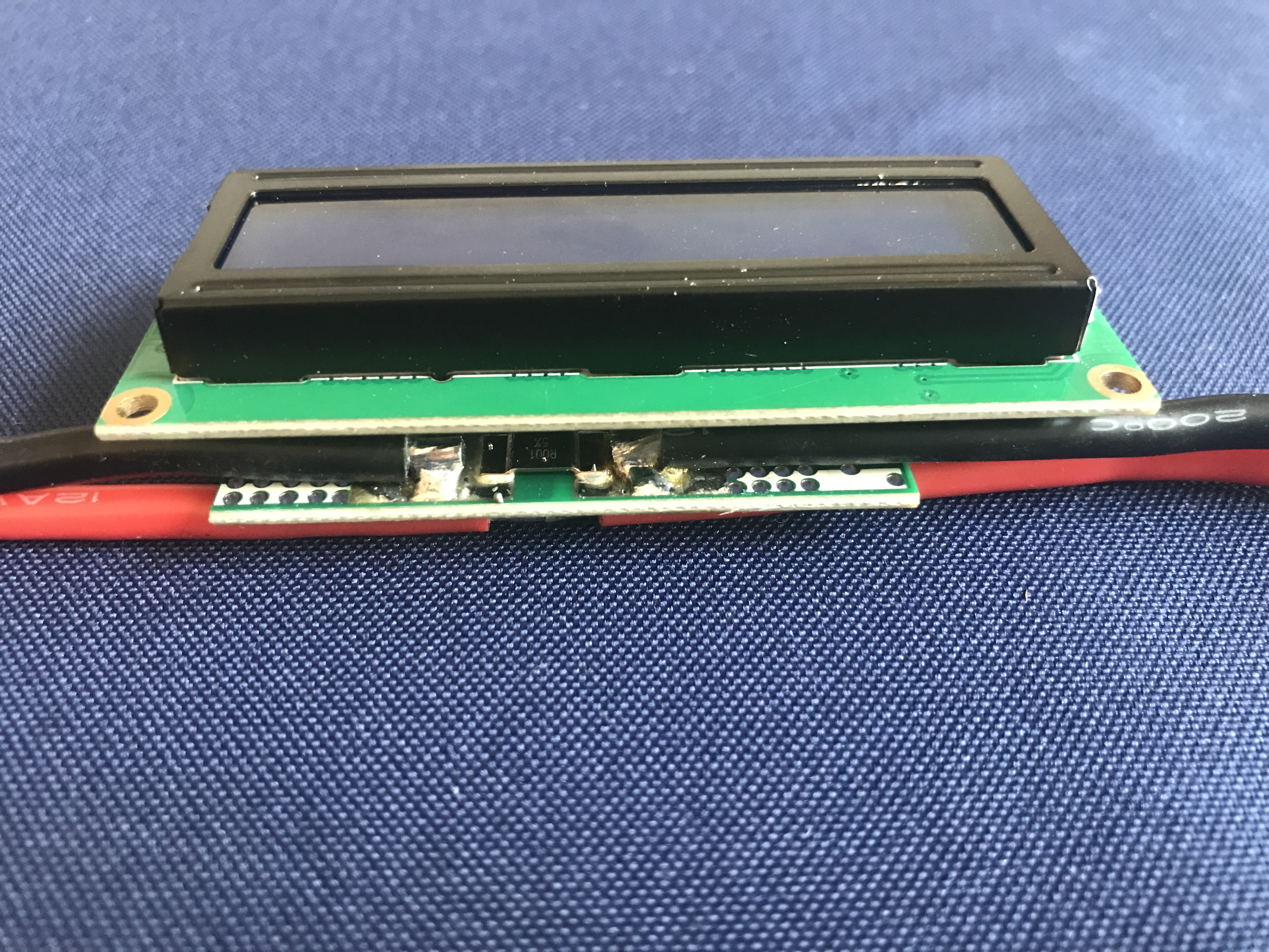

Scrappyjoe wrote: Fri Aug 12, 2022 7:56 amSurely you mean you captured .672kWh with your single panel? Aka 672Wh?
correct, that was a typo

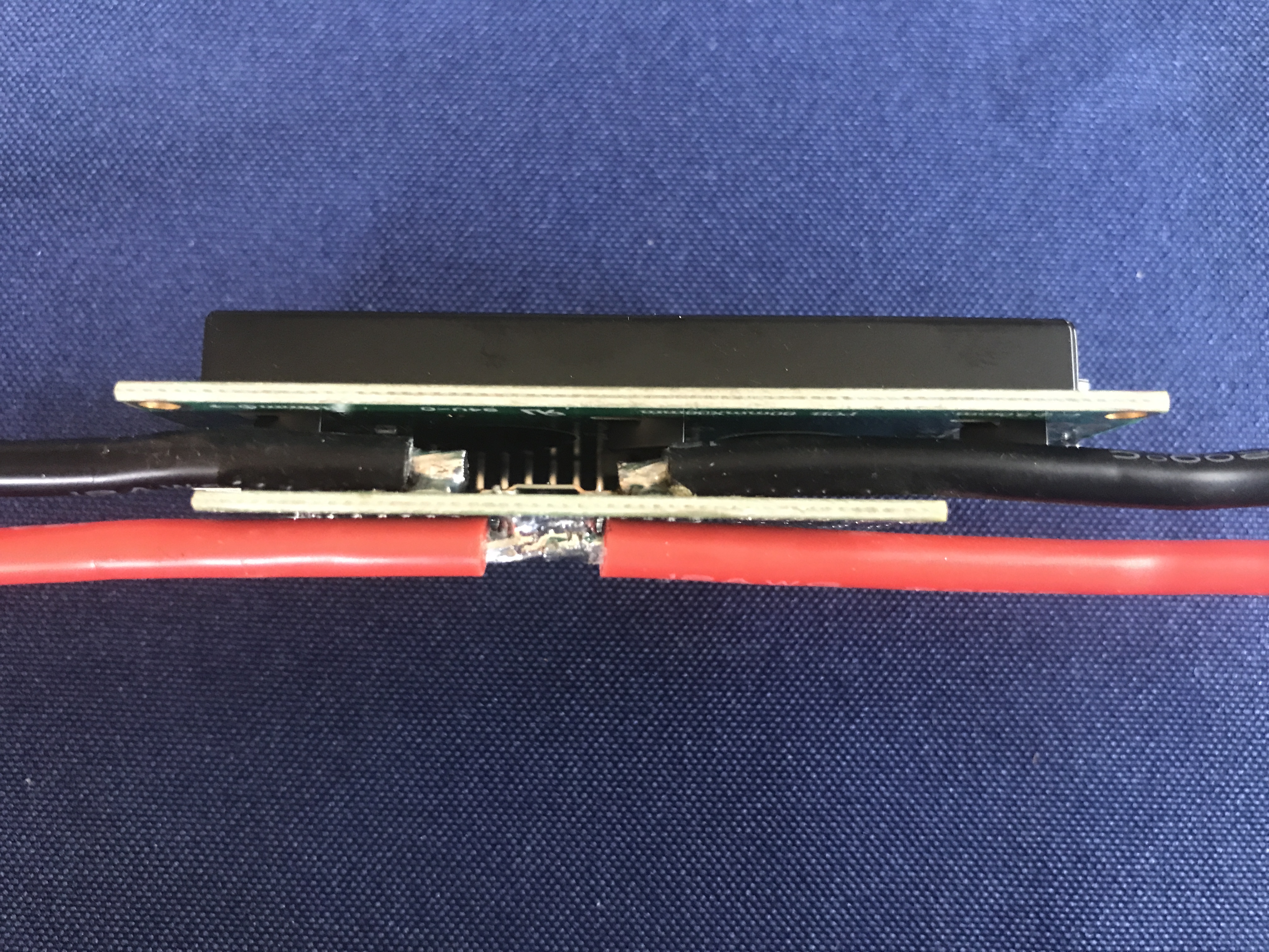

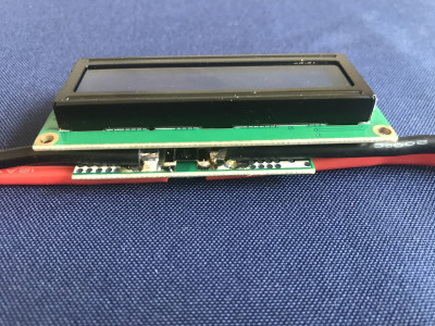

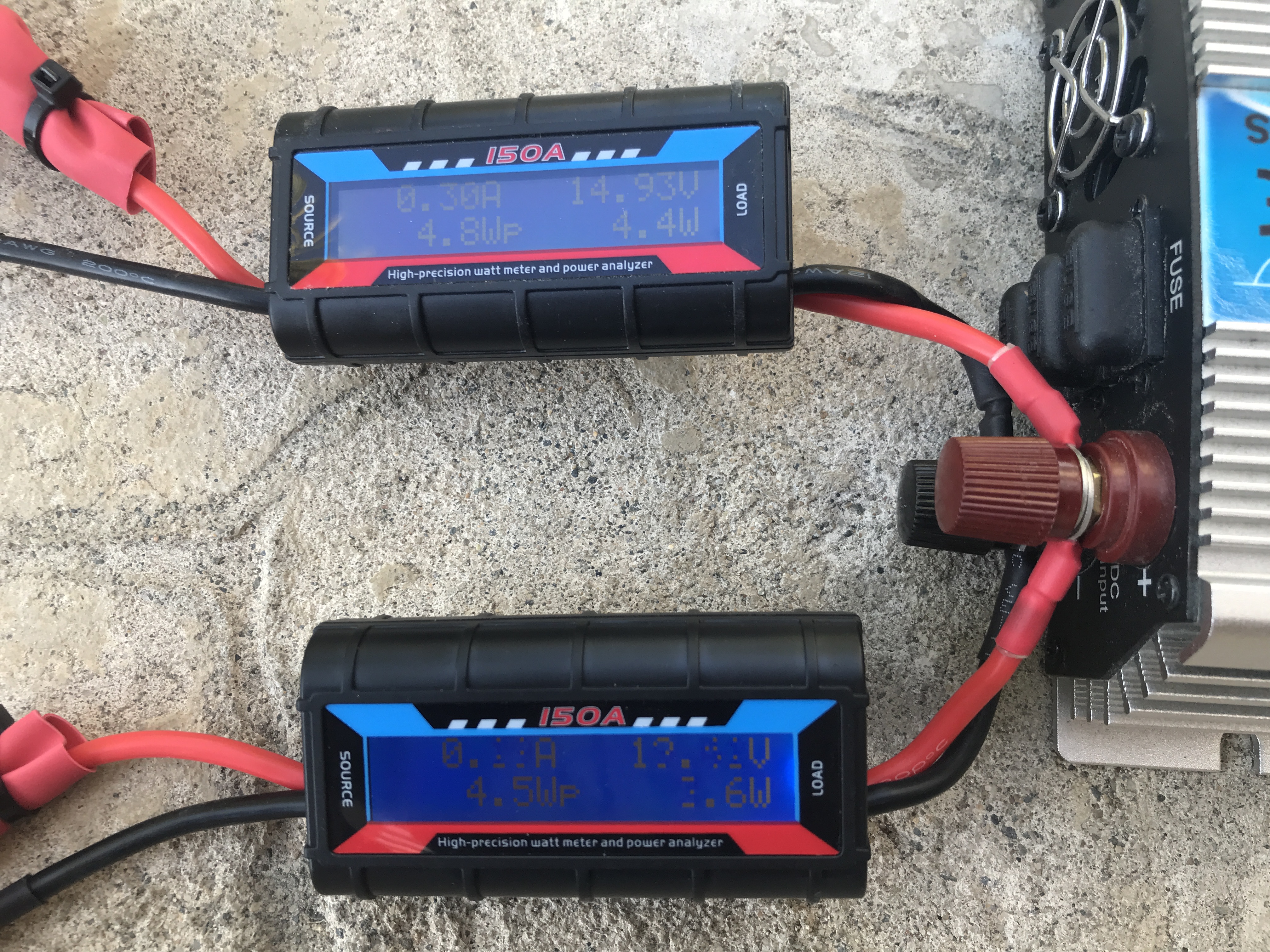

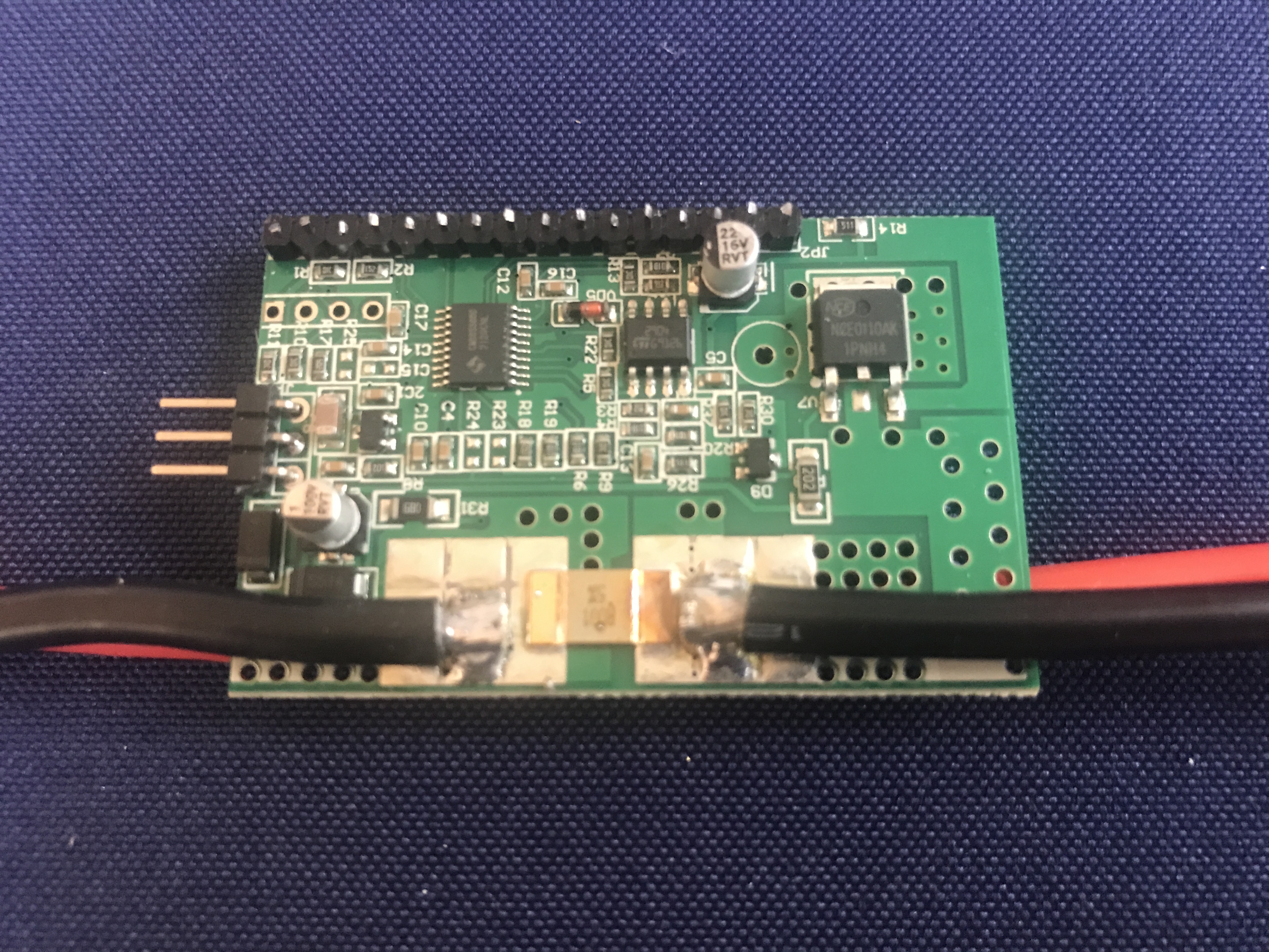

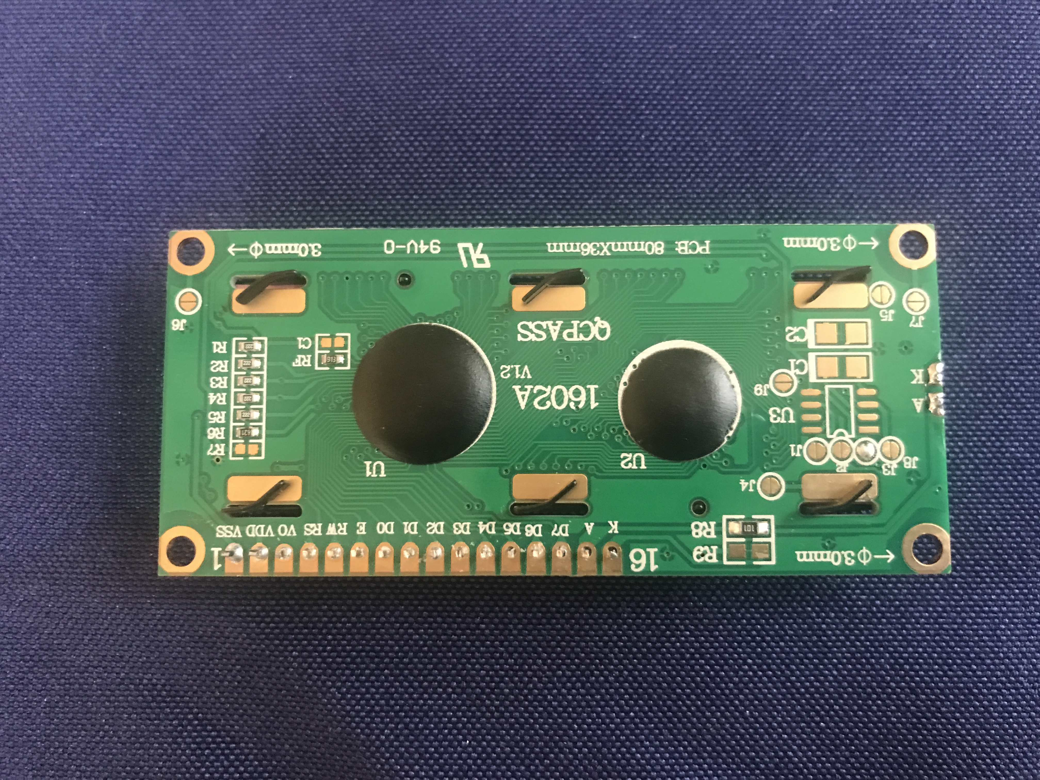

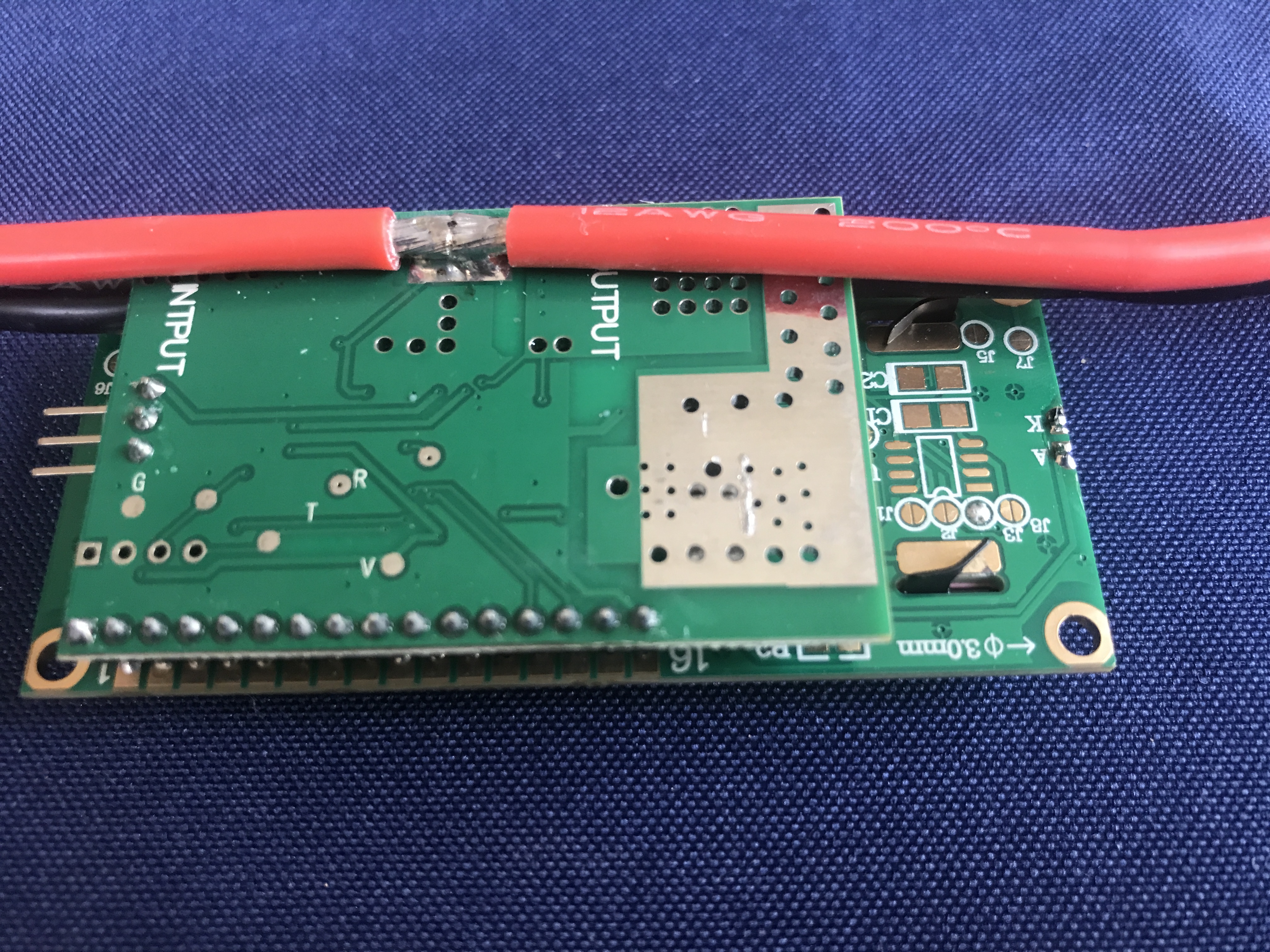

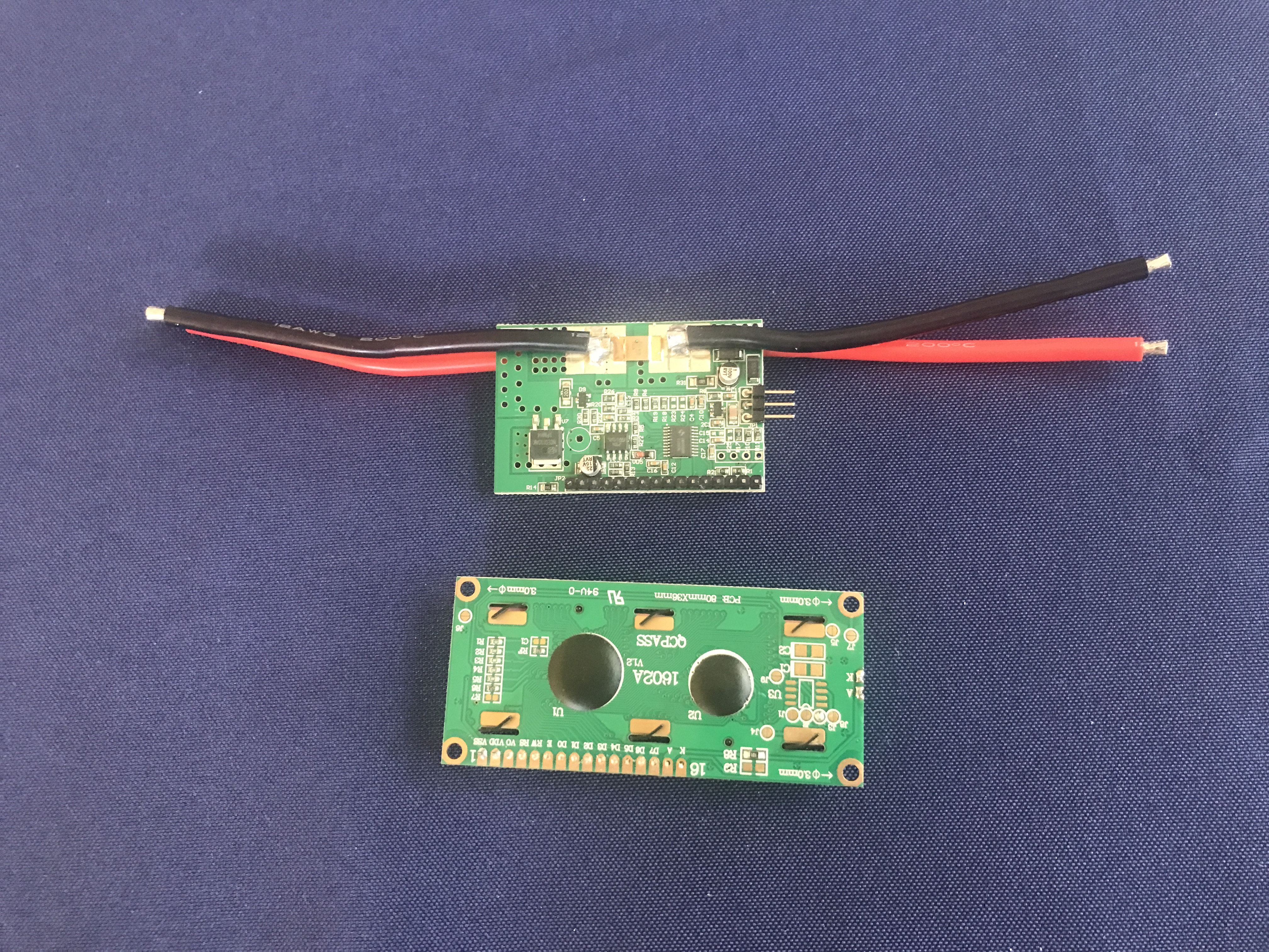

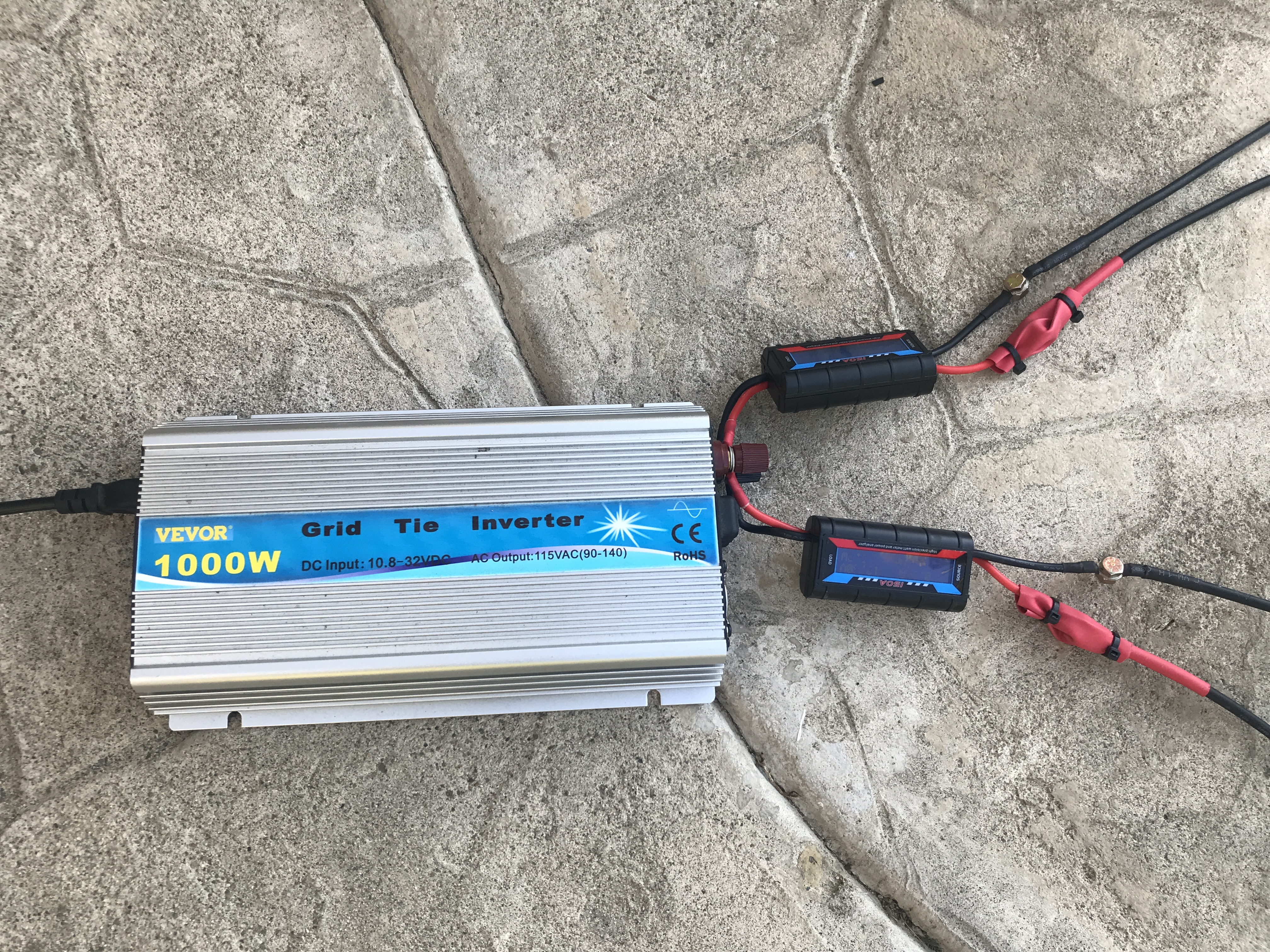

and here's a look at the guts of that little $15 dollar 150 amp DC power meter

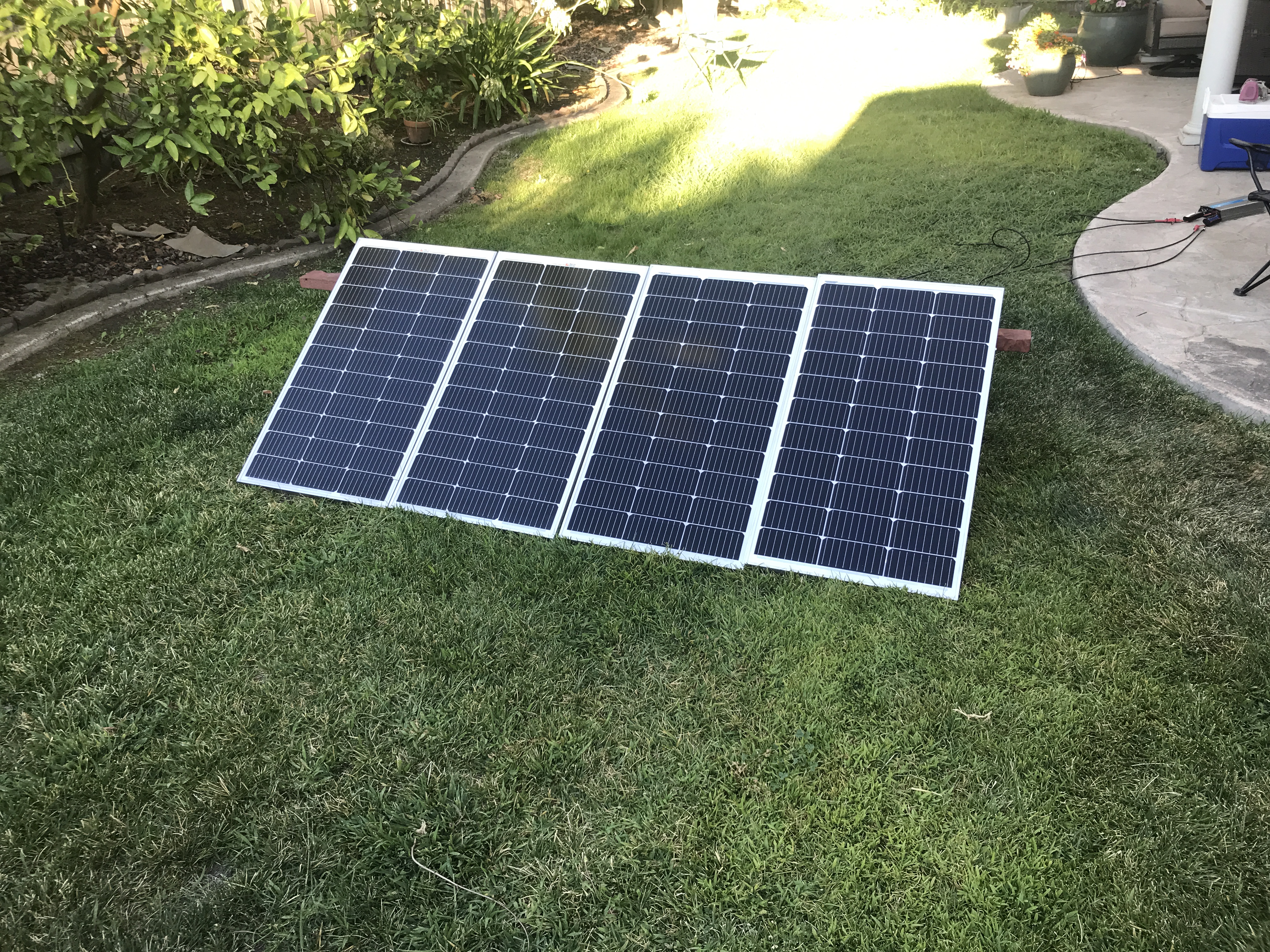

THE 4 PANEL $500 DOLLAR SETUP
  • four panels x 100 watts each, at 12 volts, these can be had for $84,99 as I write this (and I just bought some more)
  • same ol' 1000 watt 12 volt grid tie inverter, currently on AMAZON for $85.99
  • 20 feet of 12 gauge wire $23.99
  • outdoor, organic, vegetarian, free range installation

I was ronin' two different solar panel pairs Windy Nation on one side and Rich Solar on the other, so I decided to use two DC meters, to see how each pair compares

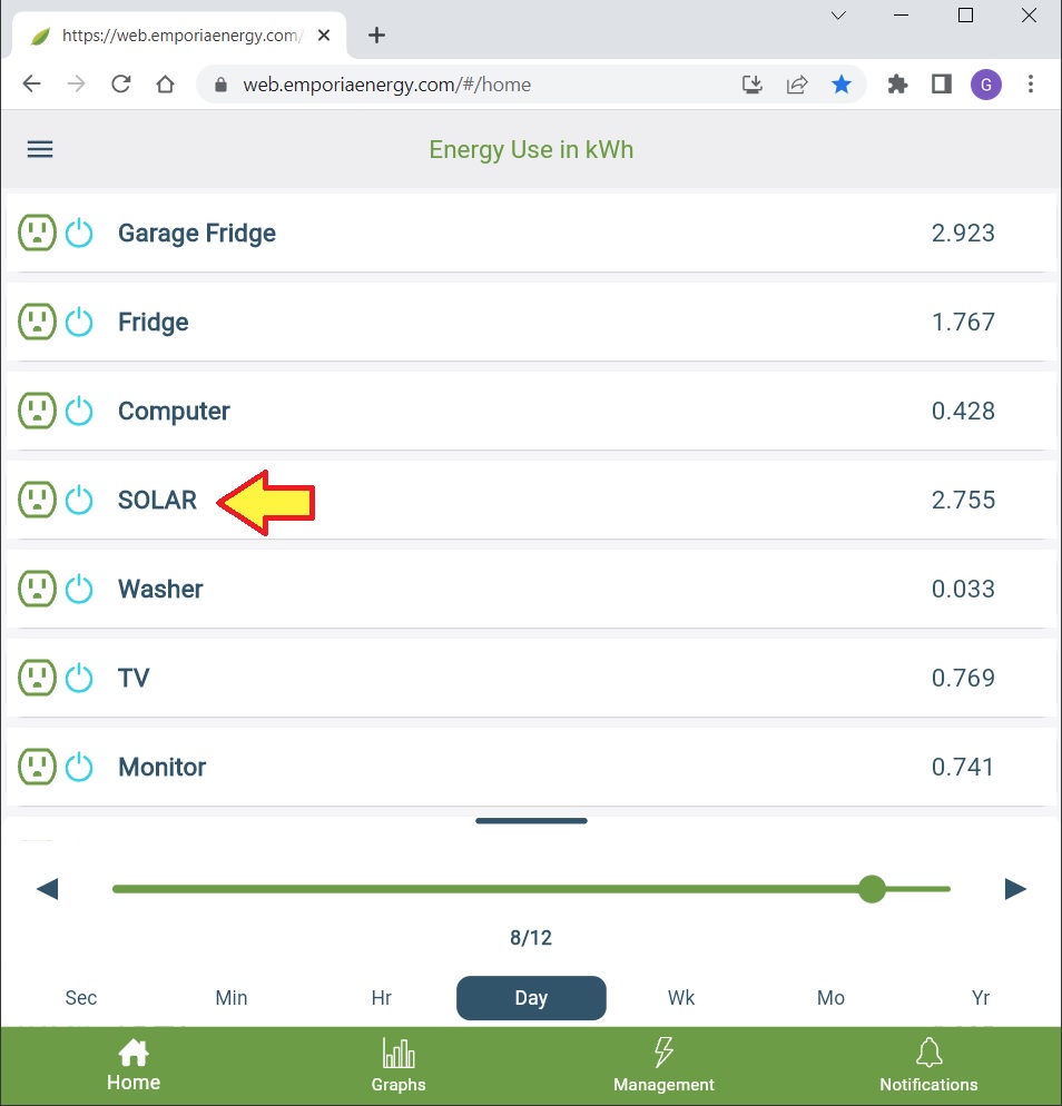

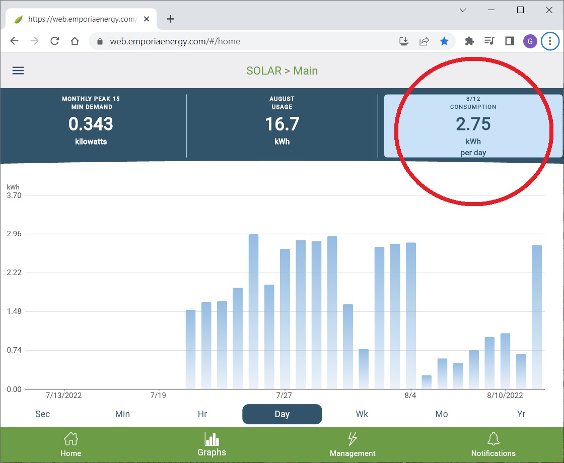

THE 4 PANEL $500 DOLLAR SETUP = 2.75 kWh
so this little 400 watt system generated 2.75 kWh of energy in one day in August of 2022 for me, so let's do some maths, 2.75 killer watt hours divided by 4 panels is 687.5 watts per panel, so we take that and multiply it by 9 panels and we project we can make 6.2 kWh of energy per day with this $1,000 gitty up

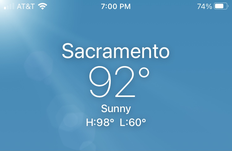

yes it was 92°F @ 7:00 PM that day [makes you view the heat in a totally different perspective now]

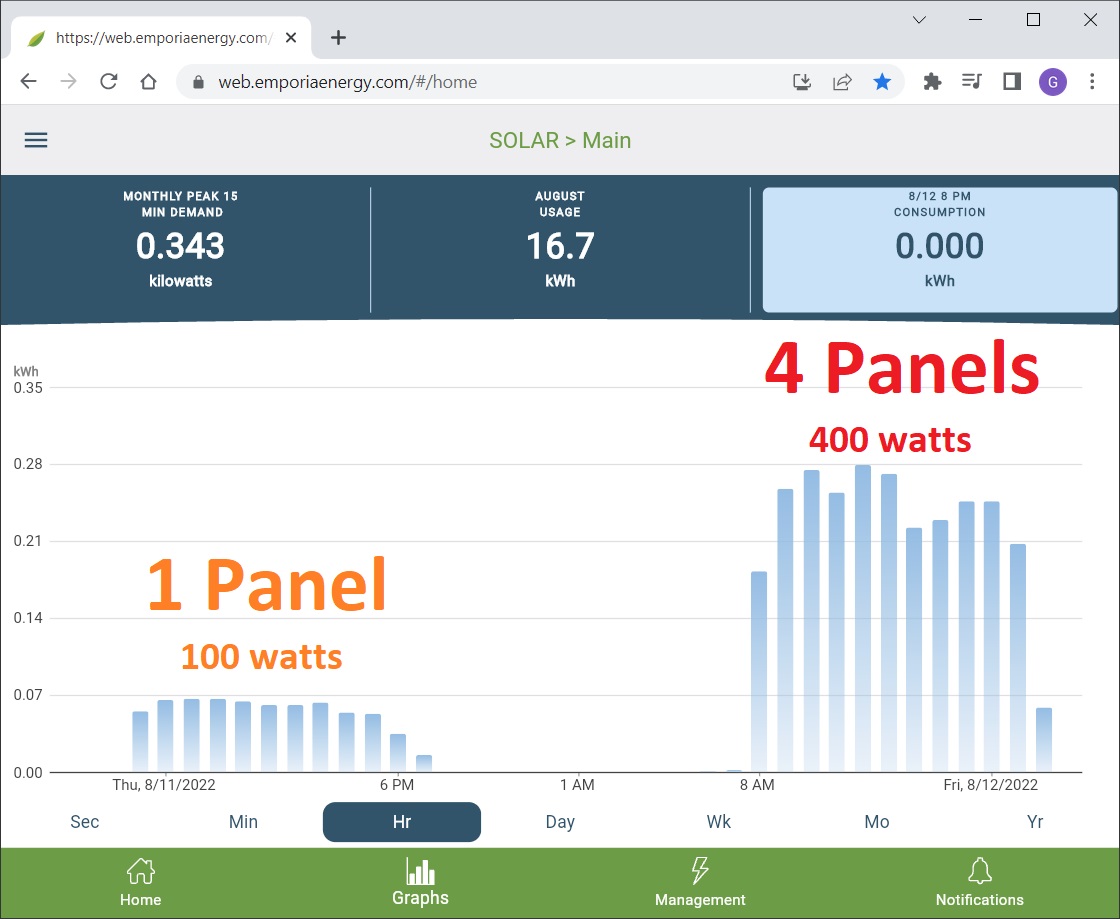

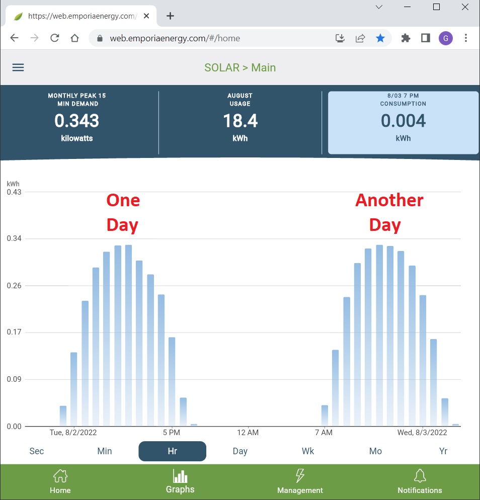

so let's do a little stare and compare of the $200 dollar 100w OPS (One Panel System) and the $500 dollar 400w FPS (Four Panel System) daily generation report, is it generation, or is it absorption, or capturization? I don't know
it's very interesting to see that I am able to catch the sun for 12 hours a day (each vertical bar represents an hour 8am - 7pm)

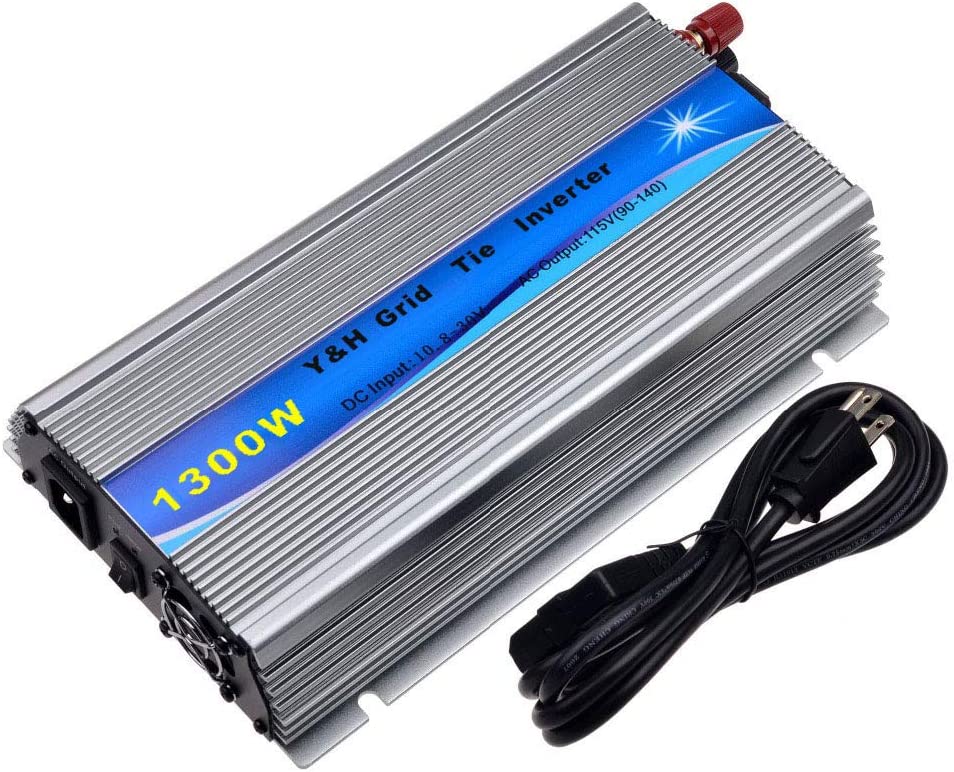

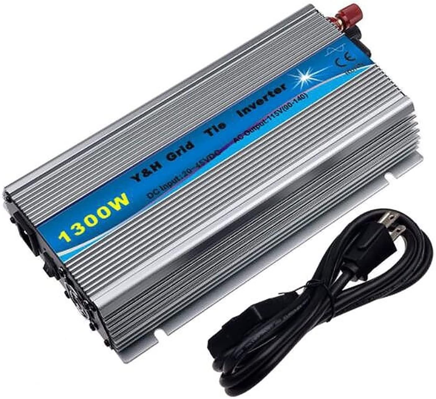

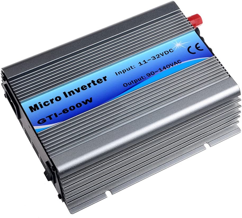

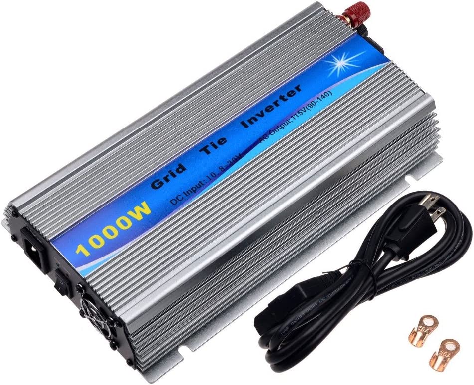

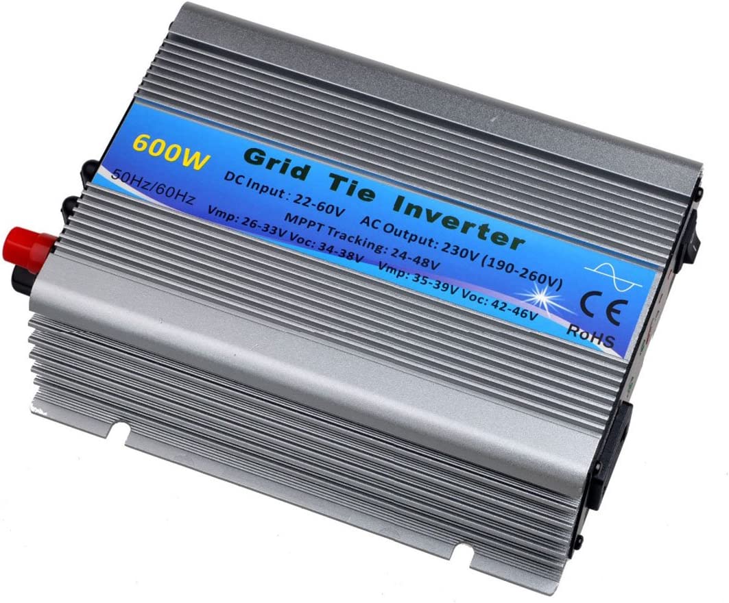

just wanna share a fun little line up of these grid tie inverters, keep in mind that since these simply plug in to your regular AC household outlet (mostly a standard 15 amp circuit here in the US) they are limited by that circuit to just under 1,500 watts
120 volts times 15 amps (at 80% efficiency for safety) means 120 volts times only 12 amps so roughly 1,440 watts
12 volt 24 volt
10.8 - 30V
20 - 45 VDC
15-28 VDC
30-45 VDC
22-50 VDC

oh wow the same Inverter that I bought for $104 bucks is not on sale on AMAZON for only $85, there are three left, no I am not the seller and no I am not affiliated with them in any way, just sharing what I just saw, since they were SOLD OUT, back ordered for quite some time, this would be a great time to pick one up to play with
VEVOR Grid Tie Solar Inverter, 1000W MPPT Power Inverter, 50/60 Hz Solar Grid Tie System, Grid Tie Inverter, DC10.8-30V Input to AC90-140V Output Wind Turbine Grid Tie Inverter for Solar Panel System

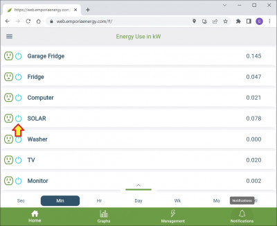

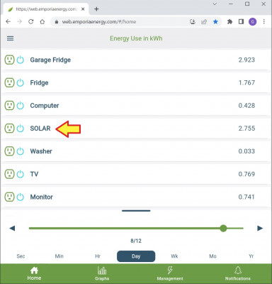

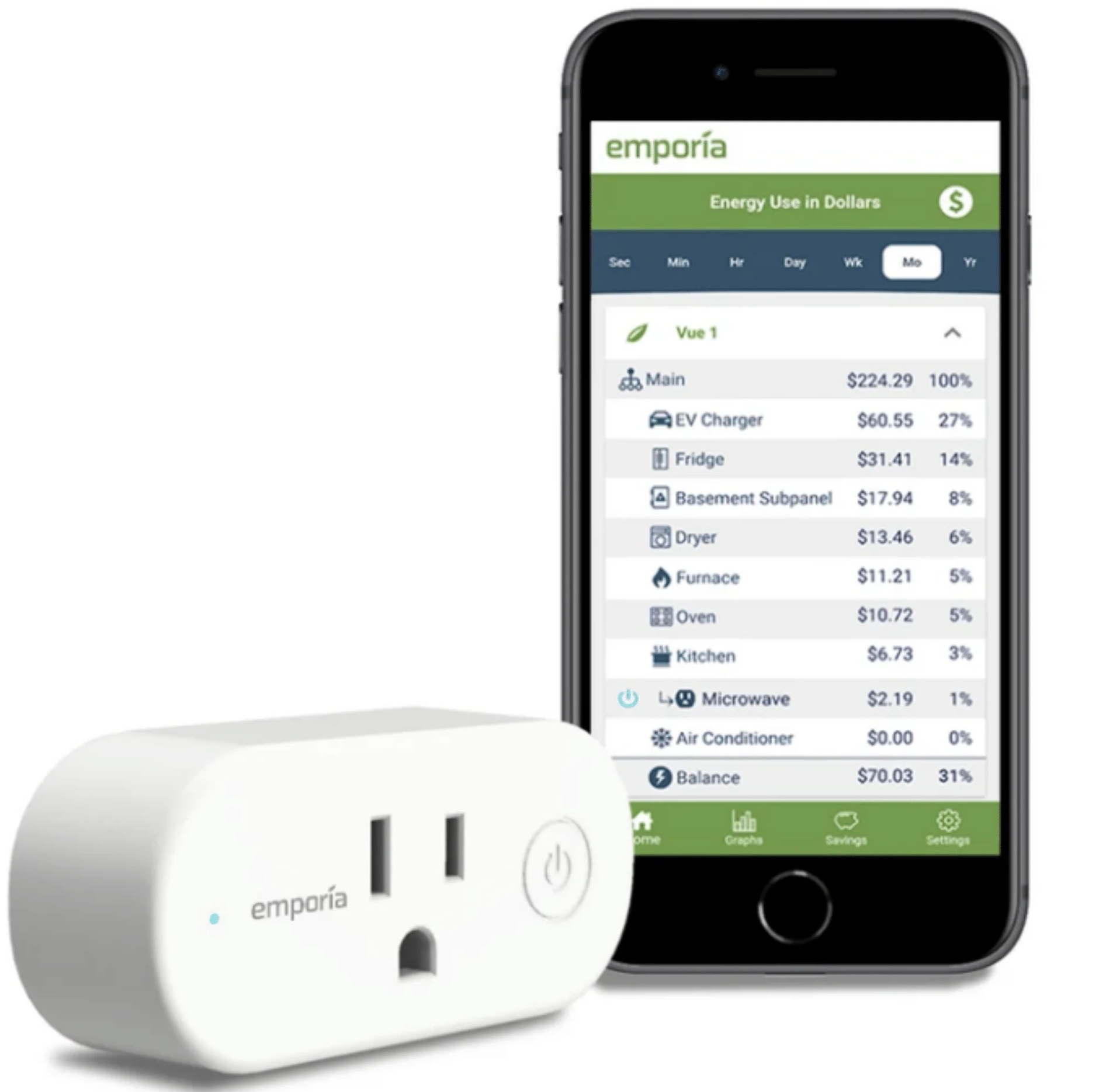

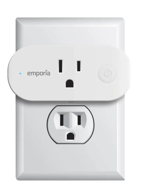

so how do I manage this thing? well, with a $10 dollar Emporia smart plug, so let's start off with some stock pics and then I'll tell you all about it, and why I picked this smart plug instead of half a dozen others
Gregski
Posts: 3164
Has thanked: 633 times
Been thanked: 1610 times
Re: The Greg's Grid Tie Solar Project
Post by Gregski »

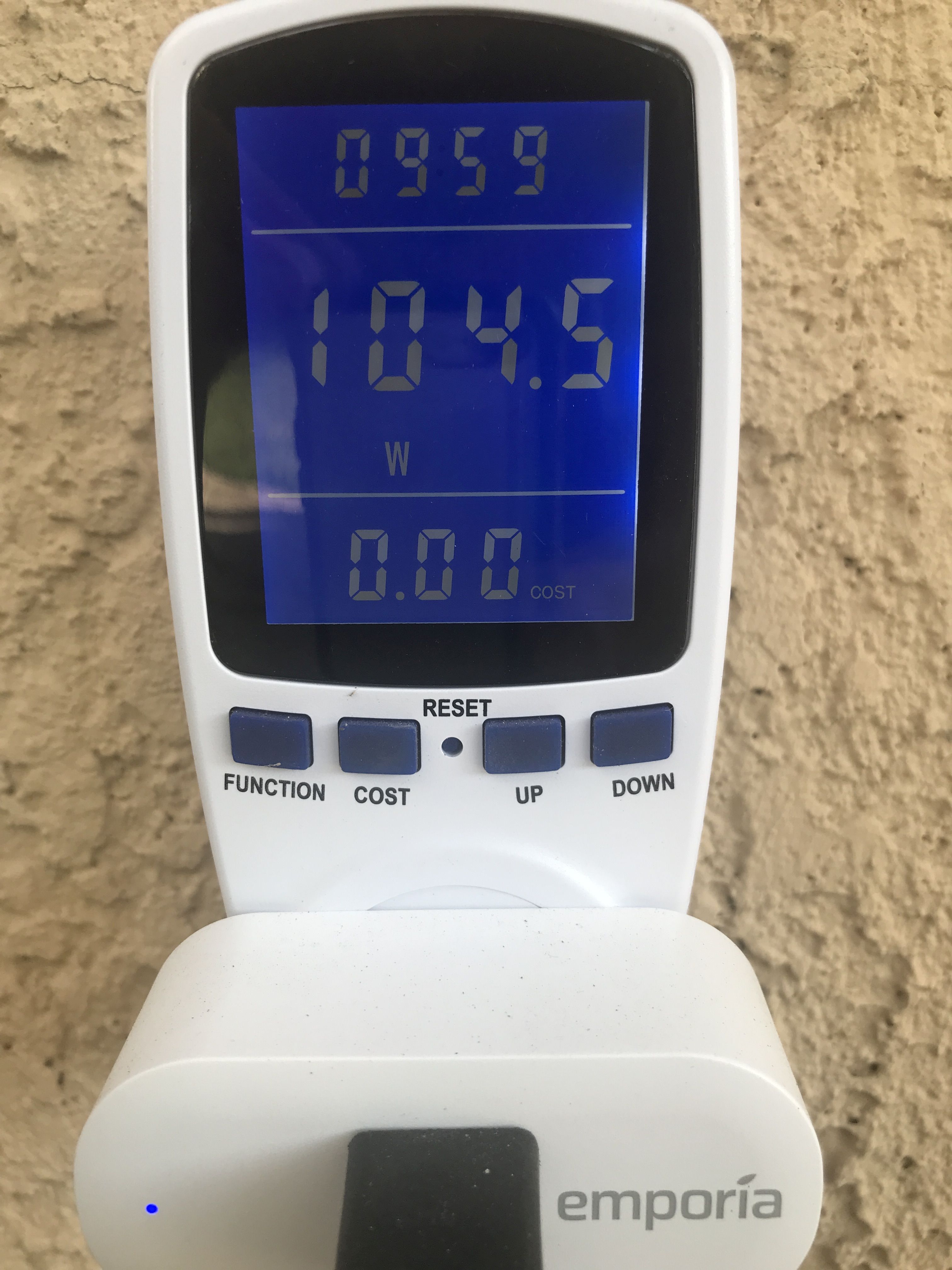

so what the hell is a smart plug, well, it's a Kill A Watt meter on steroids, there are bazillion different kinds and they all claim to be smart (in most cases that means you are able to turn them ON and OFF using some sort of software) most come with their own proprietary software, some advertise themselves as Alexa or Google Home friendly (which means you still need their proprietary software to talk or integrate with those two big fish)
what I like about the one I chose is that it adds two more radical features:
1. remote Wifi access to your data in real time from anywhere in the world (notice I did not just say Bluetooth as some only pair with Bluetooth) so graphs
2. historical data logging, so more graphs
here's the WiFi Emporia smart plug actually plugged in to the Kill A Watt meter just so I can see the real time data right next to the inverter for troubleshooting

now before we go any further let me tell you that this Emporia logging solution is not perfect meaning it is not solar aware it does not know that the energy is flowing into the house it only measures it one way as though it was coming out, but that's ok it's not adding to my utility costs it just skews the consumption results in the app, as Emporia software (which also runs on an actual PC in addition to them little hand held iGadgets you all know and love, bonus!) sees it as yet another appliance
note to self: ditch the garage fridge and be done with it you won't need this crappy criminal sketchy solar setup
I honestly stumbled upon this app in an even a blind squirrel finds a nut sometimes fashion strictly by accident, yet it is the best app out there that is not an expensive solar dedicated management thingie, here we are looking at what solar fishing looks like throughout the day, it basically represents a bell curve, in the morning you get a little energy, and that increases till it peeks at some middle point of the sun in the sky, then it decreases until the sun goes na nights

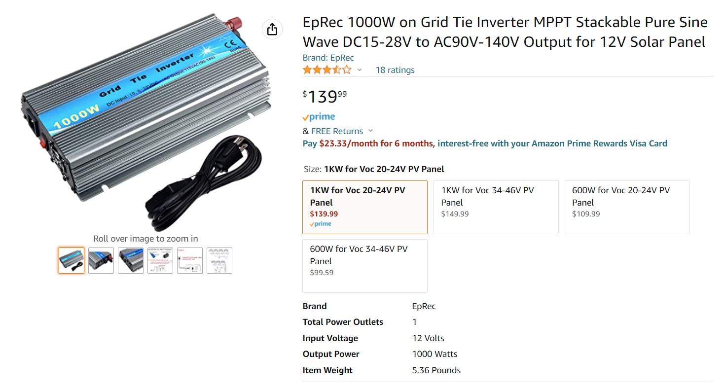

and here you go, if you thought I was BSing about that $85 dollar Inverter price being a good deal, they are now sold out and the going price is $140
even if you don't use it for production it is a fantastic and cheap way to learn about solar

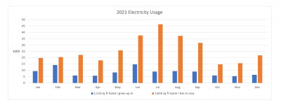

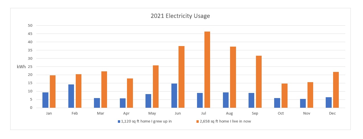

so I decided to do a little stare and compare of the energy usage of the house I grew up in (currently still lived in by my mom) and our current house (family of four with both kids about to head off to college this very month)
the point I guess is to share a very common trend of how everything seems to be getting bigger here in the States (cars got bigger, people obviously got bigger, and now homes are getting ridiculously bigger) I grew up in a 1,100 square foot, 3 bedroom, 1 bath home with my brother and mum and dad, and we were perfectly happy. Now my family of four, wife, daughter and son live in a house twice the size, and of course we are happy, but boy do we consume a lot of killer watts, naturally I blame the girls!
each month's figures represent the daily average for that month
Been thanked: 1918 times
For Europeans and other metrically minded: dividing by 10 roughly gives you m² :) Who vacuums all that?
I don't understand the scaling - if you only consumed 45 kWh in the hightest month that wouldn't be much. Is that per day average?

johu wrote: Tue Aug 16, 2022 8:36 pm For Europeans and other metrically minded: dividing by 10 roughly gives you m² :) Who vacuums all that?
sorry yes those are daily averages for those months, and mostly hard wood floors that was all the rage over the last 20 years, I think last month we hit 75 kWh in one day, I may need to give my family a refresher course on shutting windows when the AC is running

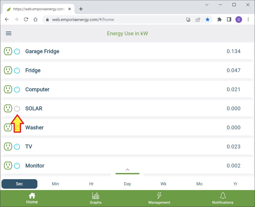

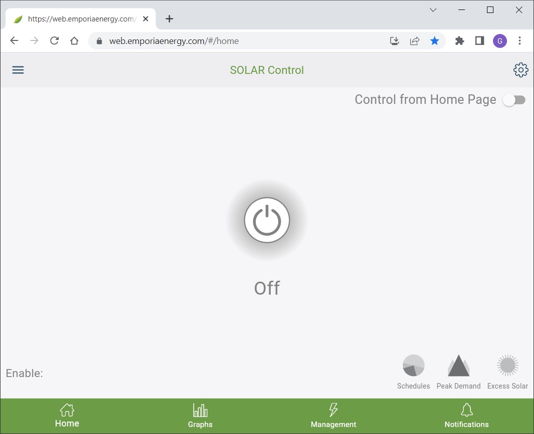

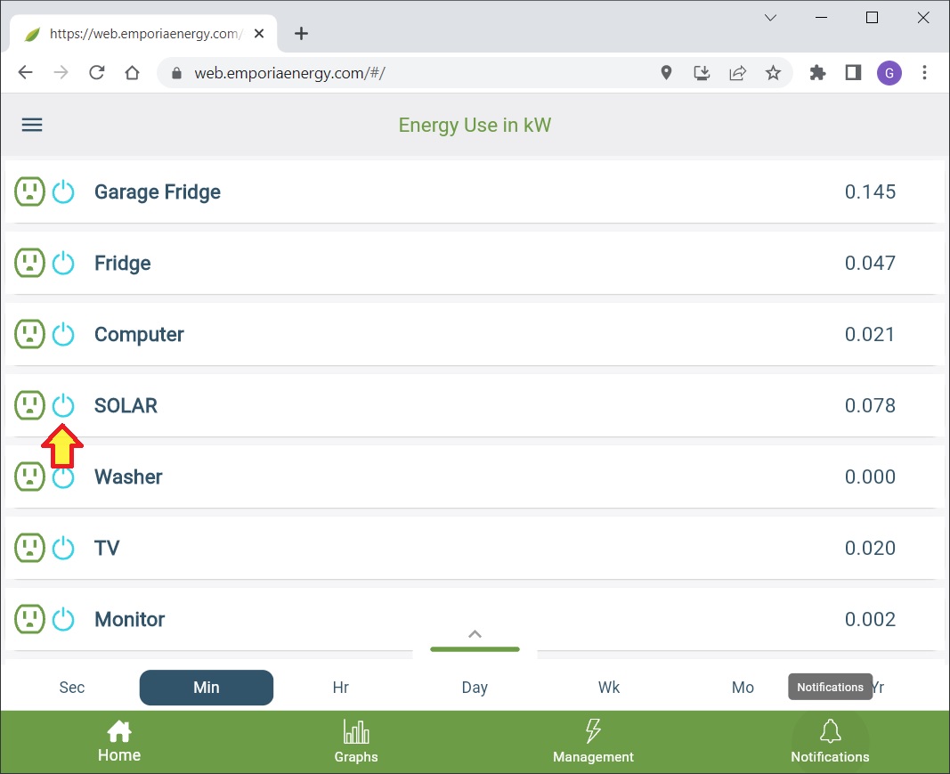

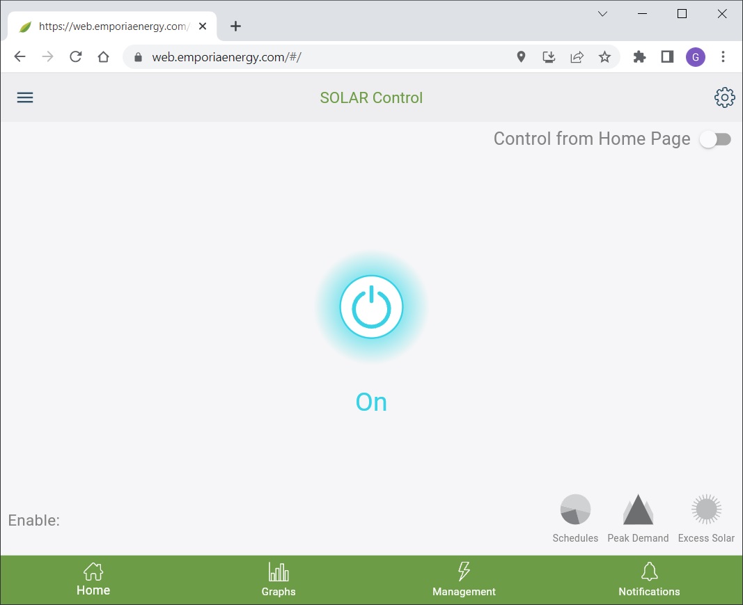

Post by Gregski »
goes without saying that this "system" is built on workarounds and here is an example of one mitigating factor one could implement, let's say you don't want the system running while you go away for the weekend, but you find yourself 60 miles down the road before you realize you forgot to unplug it, no worries, that's where the Smart Plug shines, I can just use my cellular phone to turn it off remotely from anywhere in the world, well except from my buddy's Rod's house that's straight up Verizon zone only, ha ha
