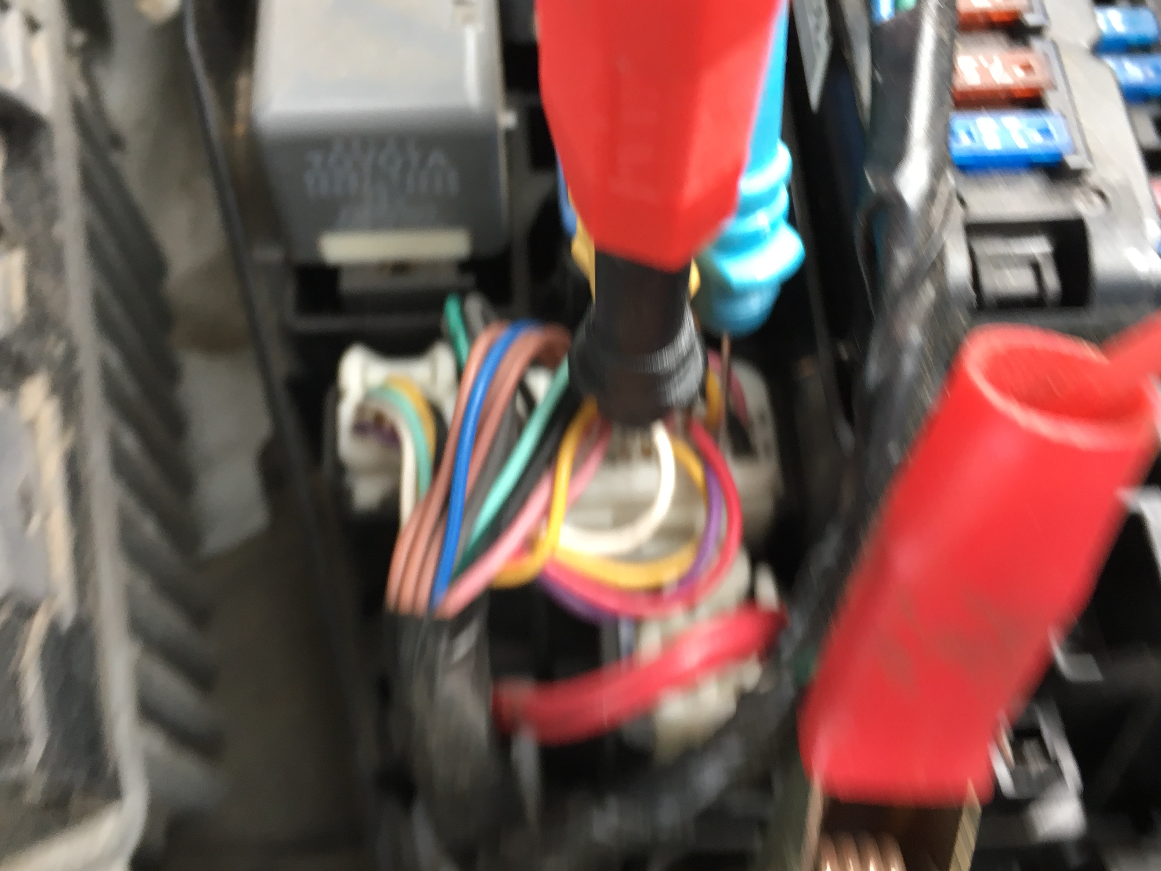

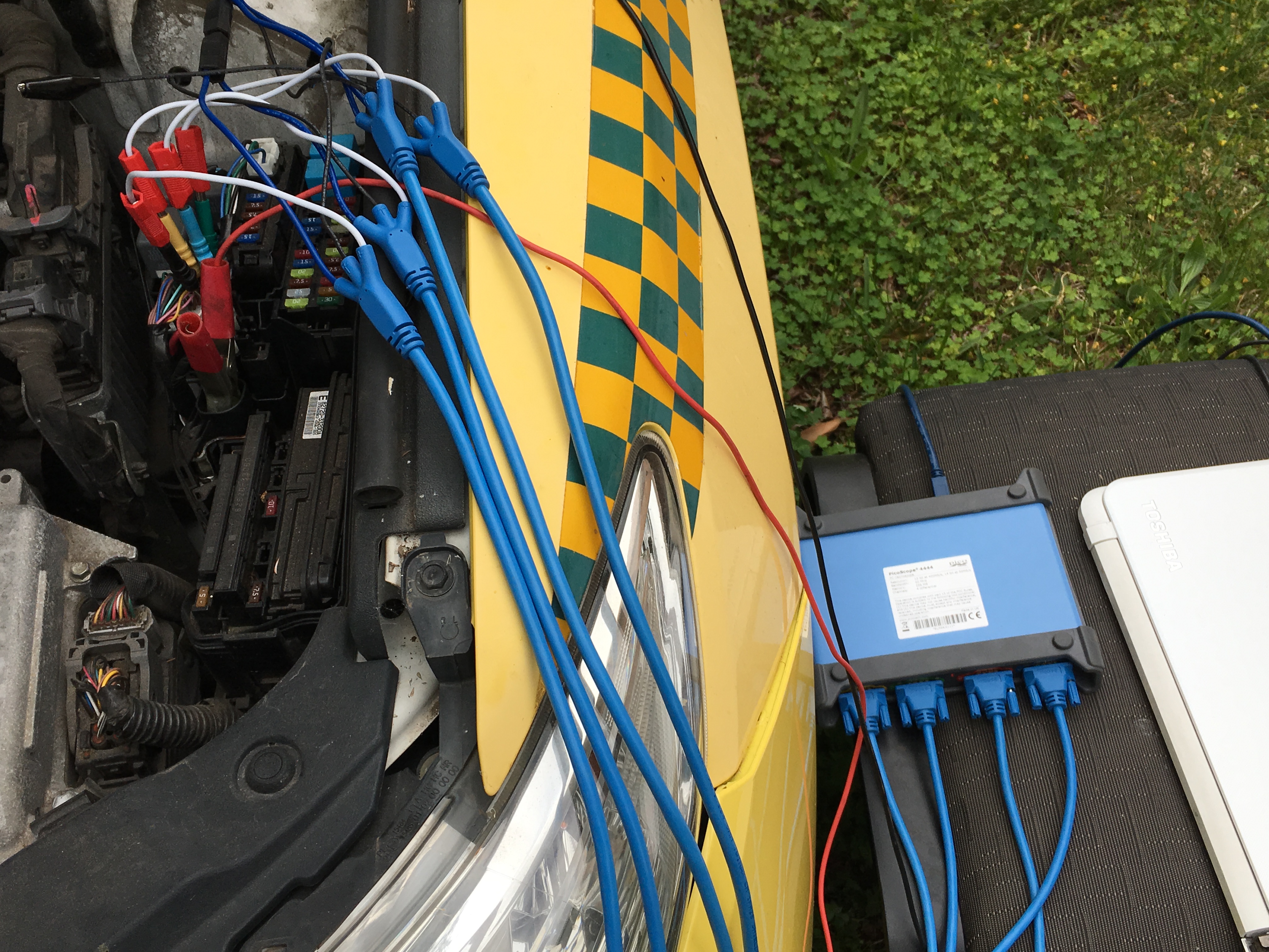

Well you won't believe it, but i finally got to get picosignals out of this thing for a AVV50R Toyota Camry Hybrid taxi.
I have tried to add the picoscope files but so far have not been able.
This scope can use multiple serial decoding patterns as well, so i can try that later on if you like. Today, whilst i was doing this, the laptop decided to shut down. So these are the only traces i got today. So will try again another day.

Oscillographs of AC for AVV50R yellow taxi.docx- Sample of wave-forms gathered at different sampling rates.
- (870.29 KiB) Downloaded 939 times

These oscillograms are what I got out of a Denso AC compressor for an AVV50 today. Its backward of what has already been posted, but it is what I understand. PS: I have not got a signal on the CLK post so far. These signals were obtained with a Picoscope 4444. You can analyse the Picoscope signals directly using Picosoftware that is free.
https://www.picotech.com/downloads Look for PicoScope 6.1.4.68.
I will post more later today.

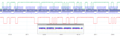

Re: Denso ES27C AC Compressor control (Toyota/Lexus)

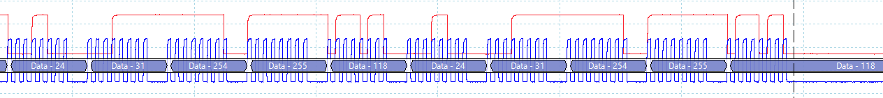

So, found out I was getting all the signals...
So, Clk is the 10 sets of 8 pulses (in blue)
STB has a high going long pulse when energizing the DOUT of the compressor, and a high going short pulse when de-energising the DOUT of the compressor (in mustard yellow).
Also, a DIN of the compressor message occurs over 2 sets of 10 sets of 8 pulses.
AVV50R Air conditioner motor DINDOUT signal Message Pattern.pdf- (67.09 KiB) Downloaded 847 times
AVV50R Air conditioner motor DINDOUT signal Ignition On ACOff.pdf- (88.7 KiB) Downloaded 897 times

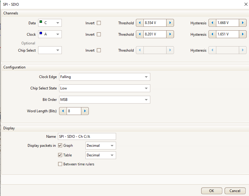

I have just been able to ready via the PicoScope 4444 the DIN data line using: No inverting DATA, No inverting Clock, Clock Edge falling, (Chip State Low), Bit Order MSB, word length 8 bits, serial reading via SPI - SDIO. Am displaying graphic with decimal, and also tabulating with decimal.
I now get these numbers in a csv file: Will look at the DOUT data later with the spi serial feature, to see if that is the same...

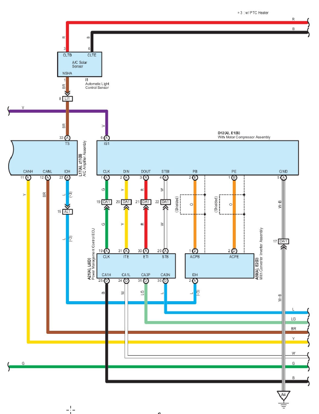

xp677 wrote: ↑Wed Sep 04, 2019 12:32 am A quick detour from my current Lexus projects, a Denso ES27C arrived in the mail today, I set about building a controller for it.
I had already pulled data from a GS450h, it looks like this:
These were the first packets pulled from the car when it was started. There seems to be an initialization and then repeated packets.Code: Select all
Byte 1 Byte 2 Byte 3 Byte 4 Byte 5 Byte 6 Byte 7 Byte 8 Byte 9 Byte 10 Packet 1 0 0 0 0 0 0 26 103 0 125 Packet 2 0 0 0 4 0 0 154 108 0 245 Packet 3 0 0 0 4 0 0 29 108 0 113 Packet 4 0 0 0 4 0 0 29 109 0 113 Packet 5 0 0 1 4 0 0 154 110 0 242 Packet 6 0 0 1 4 0 0 30 110 0 110 Packet 7 0 0 1 4 0 0 154 110 0 242 Packet 8 0 0 1 4 0 0 30 108 0 112 Packet 9 0 0 1 4 0 0 154 109 0 243 Packet 10 0 0 1 4 0 0 30 110 0 110 Packet 11 0 0 1 4 0 0 154 108 0 244 Packet 12 0 0 1 4 0 0 30 109 0 111 Packet 13 0 0 1 4 0 0 154 110 0 242
Byte 9 is a checksum. It's the LSB of the sum of bytes 3 thru 7, subtracted from 254.
"Would someone please show me how to calculate this so I can transfer concept to AVV50 that I am working on, Kind regards, Johnspark."
The data is sent as a clocked serial signal, looks very much like SPI, but is far too slow to function with SPI transceivers.
Each clock cycle is 3.2ms, each byte of data takes 26ms to receive, and each packet of 10 bytes is received over 315ms, with a 80ms gap in between. So less than 3 packets per second.
I wrote a basic program to bit-bang this out of an Arduino Nano. One interesting point is that the logic level is 12V, so I added some transistors and an optoisolator to communicate with this unit. This code produces exactly the same output as the HV ECU in the car.
Note that due to the nature of this code causing the processor to wait until certain timings events are reached, this microcontroller would likely need to be dedicated to the role of communicating with the compressor. I have added inputs on my schematic for an AC button, pressure switch (trinary switch) and evaporator thermo switch, these would be to start and stop the data transmission. Trying to run other EV things from this unit may cause unexpected results, and would likely affect the timing of the data transmission to the AC compressor.Code: Select all
#define LEN 10 //message length #define PACKET_GAP 76000 //79100 microseconds between packets #define BYTE_GAP 6463 // 9650 microseconds between bytes #define ETI_DROP 22500 //drop eti to 0v this long after packet transmission #define CLK_HIGH_TIME 1573 //actually 1550 high clock pulse duration #define CLK_LOW_TIME 3247 //actually 1700 low clock pulse duration (they are different for some reason) byte response[10]={0,0,0,0,0,0,0,0,0,0}; byte data1[10]={0,0,0,0,0,0,26,151,0,125}; //packet 1 byte data2[10]={0,0,0,4,0,0,154,108,0,245}; //packet 2-4 byte data3[10]={0,0,1,4,0,0,154,110,0,242}; //packets after byte data4[10]={0,1,2,3,4,5,6,7,8,9}; //testing unsigned long lastpacket=0,lastbyte=0,clk_hightime=0,clk_lowtime=0; bool bytecomplete=0; #define ITE 12 //arduino pin. can be any pin, doesnt have to be SPI pins #define ETI 11 //arduino pin. can be any pin, doesnt have to be SPI pins #define CLK 13 //arduino pin. can be any pin, doesnt have to be SPI pins void setup() { pinMode(ITE, INPUT); pinMode(CLK, OUTPUT); pinMode(ETI, OUTPUT); Serial.begin(115200); } void transferbyte(byte packet_id,byte dataindex) { if(micros()-lastbyte>BYTE_GAP) { for(int i=0;i<8;i++) { clk_hightime=micros(); clk_lowtime=micros(); //send ETI primitive packet handling for proof of concept, easily improved in future switch (packet_id) { case 1: digitalWrite(ETI, bitRead(data1[dataindex],i));break; case 2: digitalWrite(ETI, bitRead(data3[dataindex],i));break; case 3: digitalWrite(ETI, bitRead(data3[dataindex],i));break; case 4: digitalWrite(ETI, bitRead(data4[dataindex],i));break; default: digitalWrite(ETI, bitRead(data4[dataindex],i)); } while(micros()-clk_hightime<CLK_HIGH_TIME)digitalWrite(CLK,0); bitWrite(response[dataindex], i, digitalRead(ITE)); // capture ITE while(micros()-clk_lowtime<CLK_LOW_TIME)digitalWrite(CLK,1); } //digitalWrite(ETI,0); //in case last bit of byte was 1 (inverted logic) lastbyte=micros(); bytecomplete=1; } } void transferpacket(byte packet_id) { if(micros()-lastpacket>PACKET_GAP) { for(int i=0; i<LEN; i++) { while(!bytecomplete)transferbyte(packet_id,i); bytecomplete=0; } lastpacket=micros(); } //HVECU in car holds ETI in last state for this long before sending 0 if(micros()-lastpacket>ETI_DROP)digitalWrite(ETI,1); } void serialdiag(byte packet_id) { Serial.print("Sent: "); switch(packet_id) { case 1: {for(int i=0;i<LEN;i++){Serial.print(data1[i]);Serial.print(" ");};break;} case 2: {for(int i=0;i<LEN;i++){Serial.print(data2[i]);Serial.print(" ");};break;} case 3: {for(int i=0;i<LEN;i++){Serial.print(data3[i]);Serial.print(" ");};break;} default: {for(int i=0;i<LEN;i++){Serial.print(data4[i]);Serial.print(" ");};} } Serial. print("\n"); Serial.print("Received: "); for(int i=0;i<LEN;i++){Serial.print(response[i]);Serial.print(" ");} Serial.print("\n"); Serial.print("\n"); } void loop() { transferpacket(2); serialdiag(2); }
My plan for the 3 switch inputs is to just put an "if(all switches closed){run the compressor}" in the main loop. The serialdiag() functino will be replaced by a CAN transmit function, if the AC compressor is found to produce any useful data.
I've attached a schematic of the circuit I used. Note the pain numbers have changed - I've freed up the SPI pins so I can add a CAN controller in the future. I'll get this board fabricated when I next place an order.
I'm currently facing two issues:

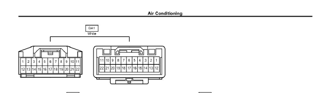

1. The AC compressor pinout. I believe it is:
1 - CLK
2 - ETI (data from HV ECU to compressor)
3 - ITE (feedback from compressor to HV ECU)
4 - STBI
5 - GND
6 - 12V
However, the service manual contradicts itself over which pin is ITE and which is ETI. From metering the two, pin 2 has the same specs as CLK, while pin 3 is pulled up when pin 6 is connected to 12v via a 1M resistor. I am going with the assumption that my list above is correct.
To activate this unit, the STBI line needs to be connected to ground. Doing so causes the unit to pull 14mA from the 12v line. This isn't enough to power the unit, I believe that the unit is disabled until it sees voltage on the HV DC connector. I opened the unit, there is a sensing circuit connected to these lines. Likely the inverter is shutdown until it receives adequate HV voltage. I tried 12v. Nothing happened.
So, I'm about 10 hours in and have made plenty of progress already. I'll likely put this project on hold until I have access to a 288V DC source to try this again. I've posted this now in case anyone else wants to use my work so far to attempt to control a compressor of their own. These are widely available AC compressors, and if they can be controlled, it would provide a cheap source of AC for electric car conversions.

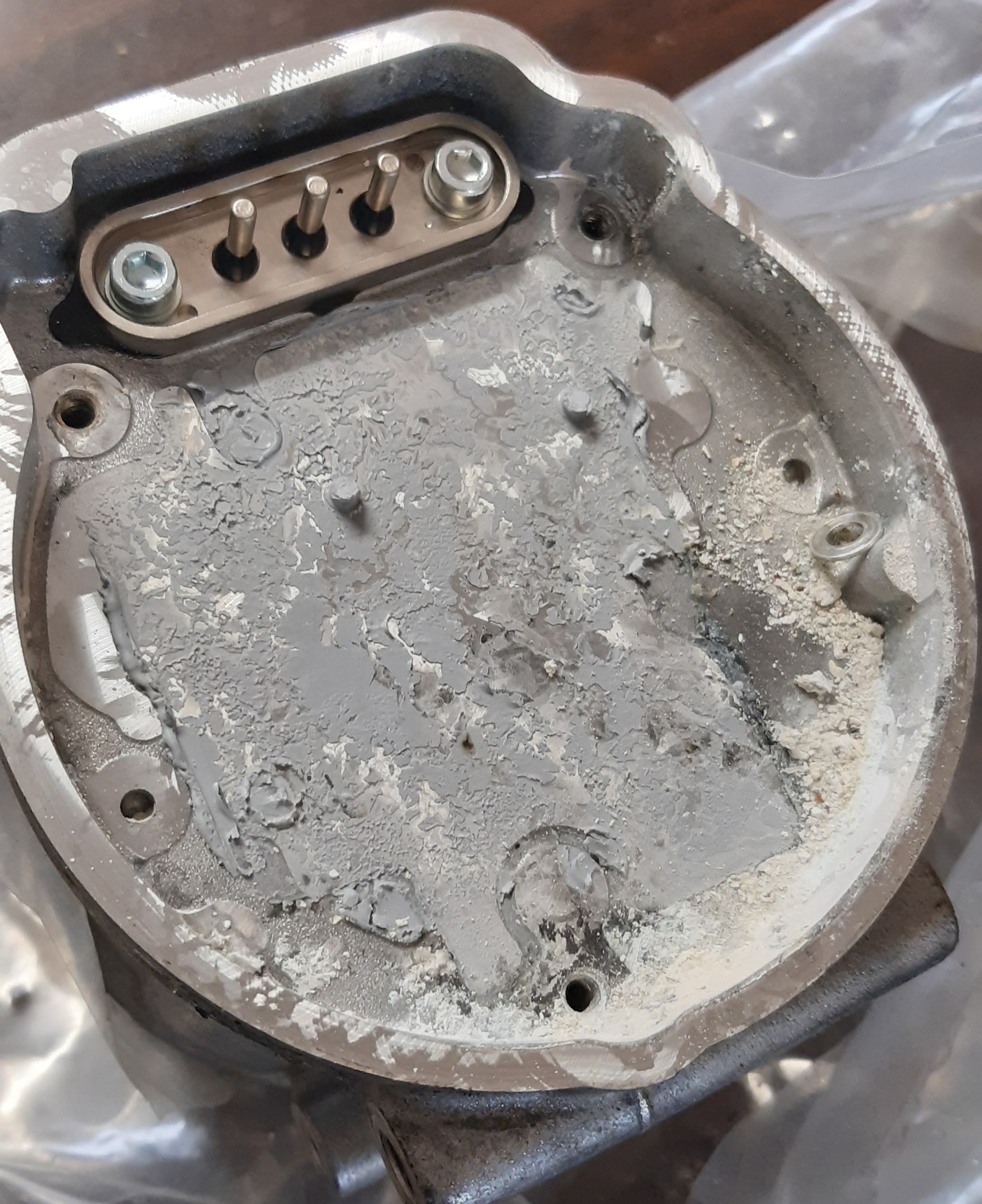

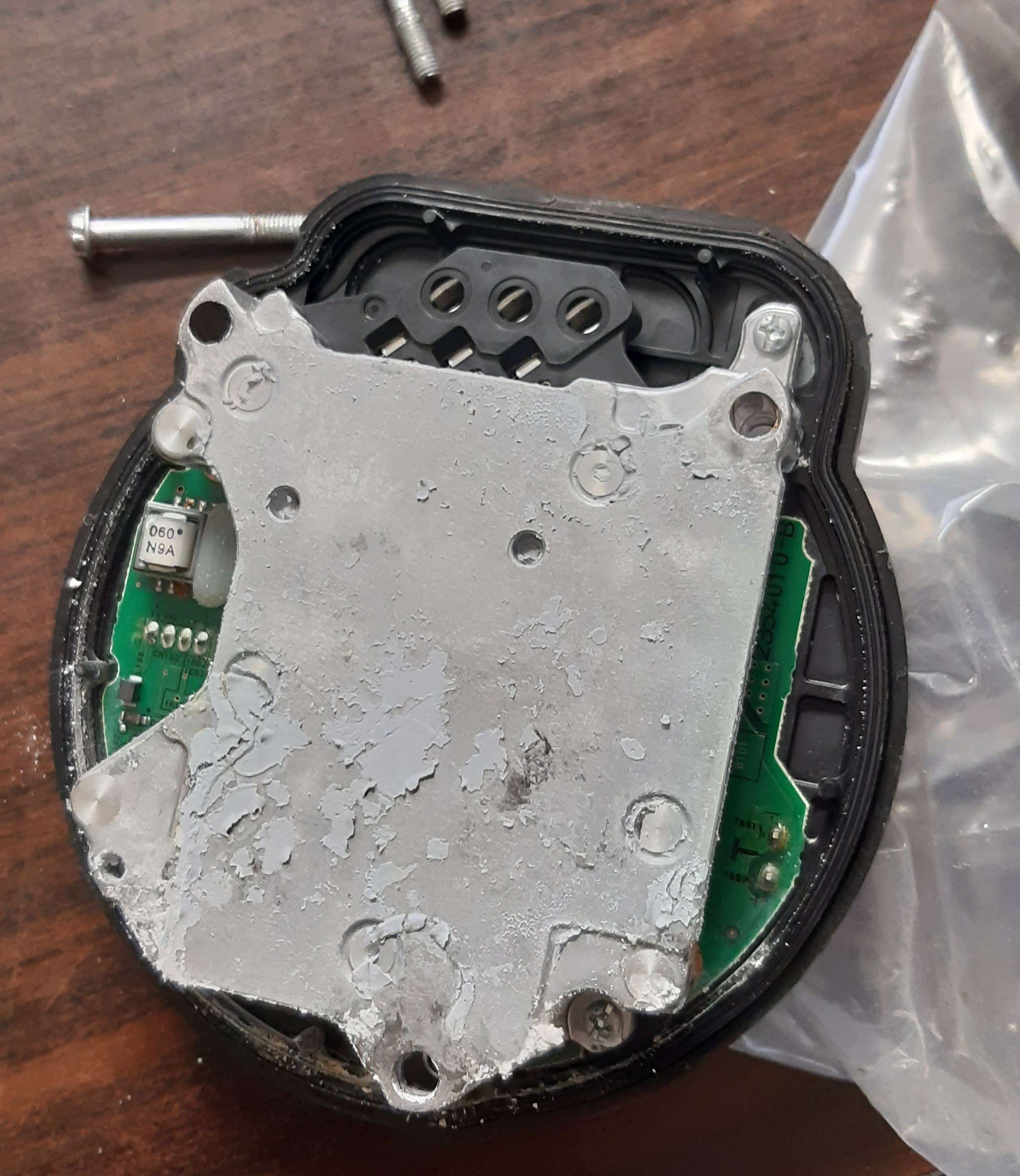

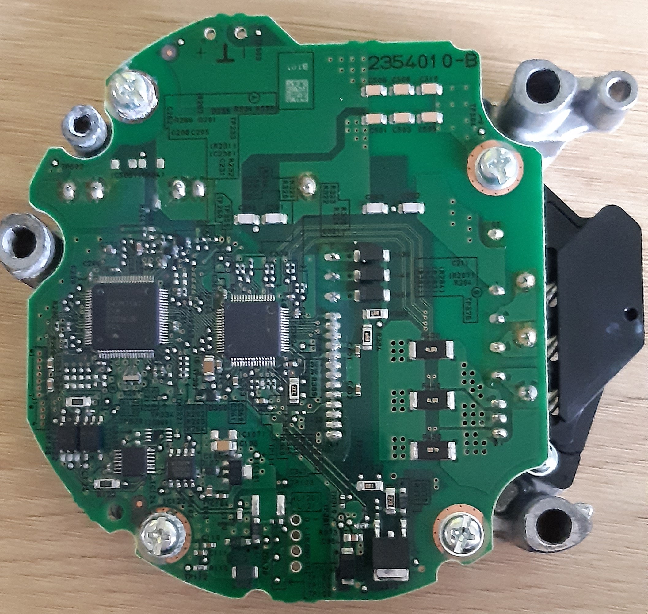

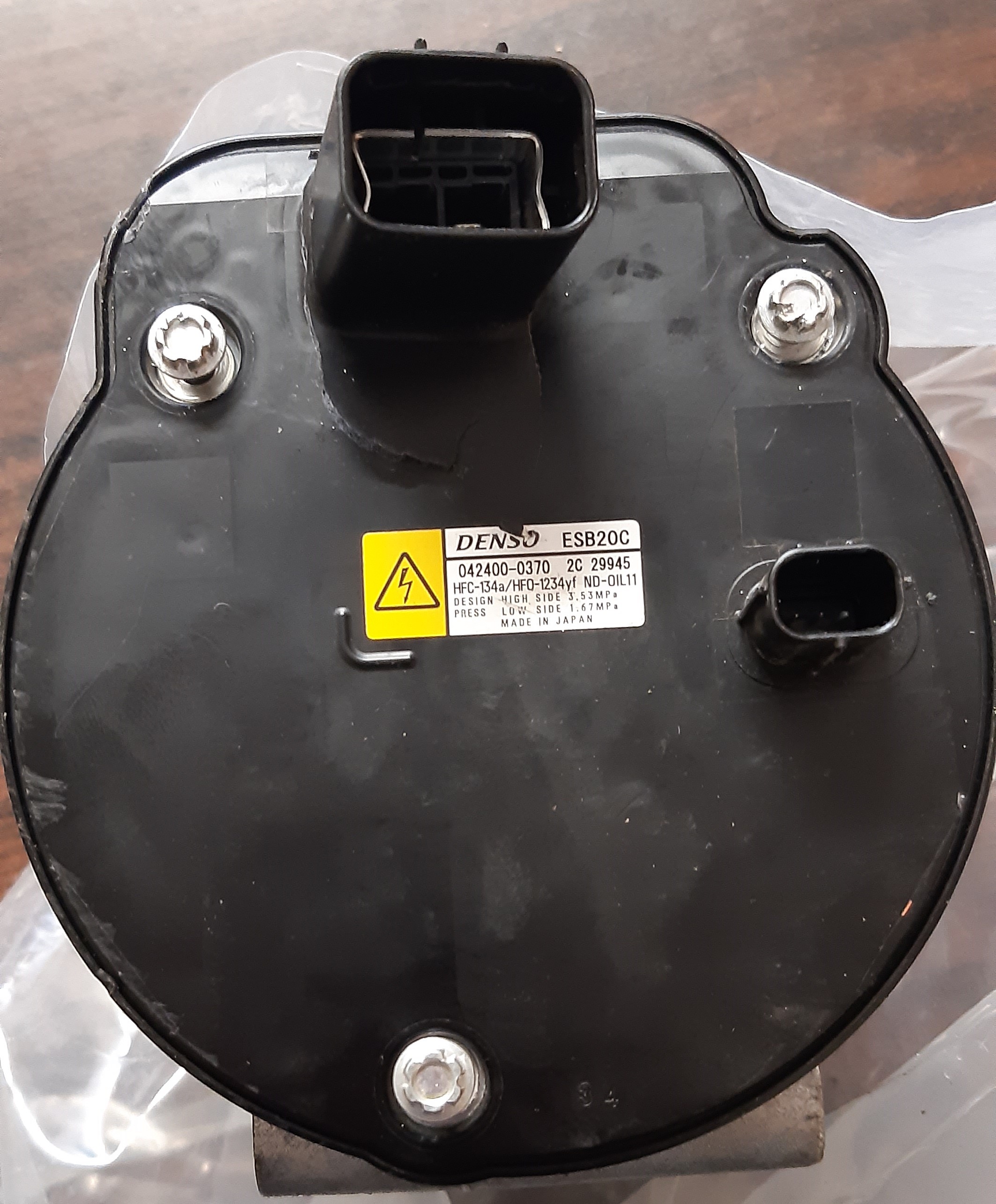

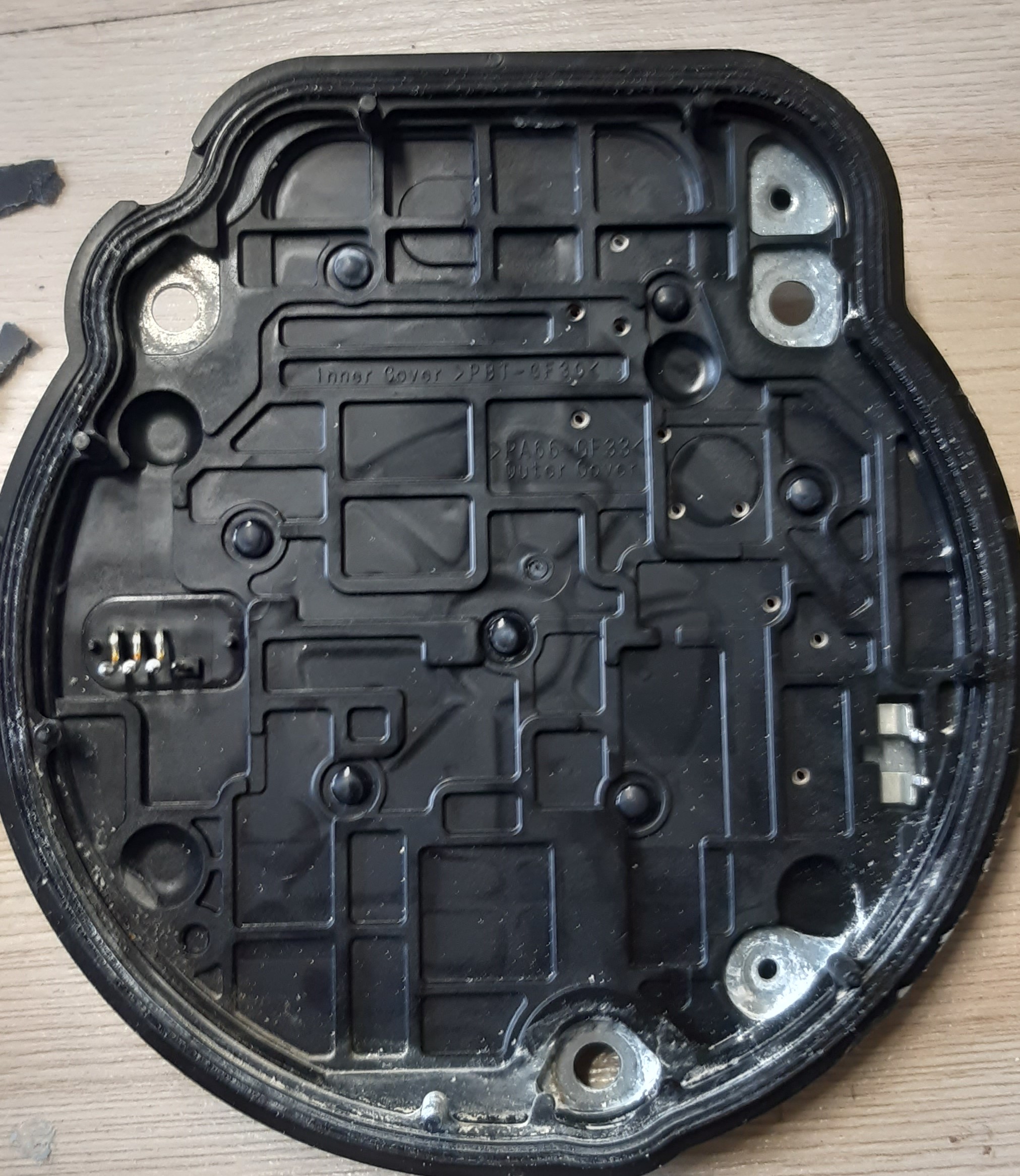

Hello, All
As I have read this thread, and some others, and found that used in ES series compressors proprietary interface / protocol is not very usable ...
I did some research and :
DENSO ESB20C ( cheap successor of es series compressor ) .... I believe this all is valid for ESB27C as well. ( bigger one also easily available )
As i didn't find any internal pictures to confirm my suspicions .. I bought one .. not sure if working one ( this got some punch in crush probably, but besides power connector it looks good. - This is what I can handle. )
These new compressors have now "standarized" LIN interface ( I believe they meet the standards ) - check the pictures - they even clearly stated LIN interface.
My goal is to run one and test it in controlled environment.
These compressors has 3 pin control terminal where is GND in the middle, LIN on the left, and ignition 12VCC on the right side.
Inside HV and LV sides are isolated = on the LV side there is LIN transceiver that outputs serial interface via two optocouplers to main processor and drive processor. Drive part is some IPM ( Integrated Power Module ) I did not check details for now.
The left terminal HV is +, right is - (internal solid capacitors are rated 450V)
As I have currently no access to any car with such equipment is there any good soul that may have such access and can perform some protocol sniffing
I will try to do so by my self, but it may take time as I have no access to such car at the moment.
I still have my Hybrid Camry AVV50 of which I can test the Denso compressor. I have uploaded signals before, but I could redo assuming my compressor uses Lin bus too perhaps?
