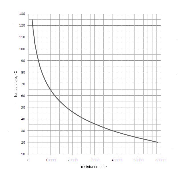

I measured the nominal value for the MG1 & MG2 thermistors and it came out @117K for an ambient temperature of 5-6C, which seems very high.
Has anyone else had a chance to measure the MG1 & MG2 thermistors?

I just checked mine and I am getting exactly the same results ~116K @ 6C
What the coincident that temperature in my garage is the same :-)

It is hard to find data on the GS450H, but it looks like they are using they will use the same thermistor as the gen2 prius.
This NTC thermistor is 3900-3950K 47kohm!

If we want to get more information regarding the temperature rise on the motors, it might be worth changing the 1.8K pull-up to be something bigger.
With the 1.8K pull up the temp of the motor has to be > 90C before the ADC drops into range (<3.3V) where it can take a measurement.
I have verified the above calculation is correct, once the correct values for pull-up resistor is set.

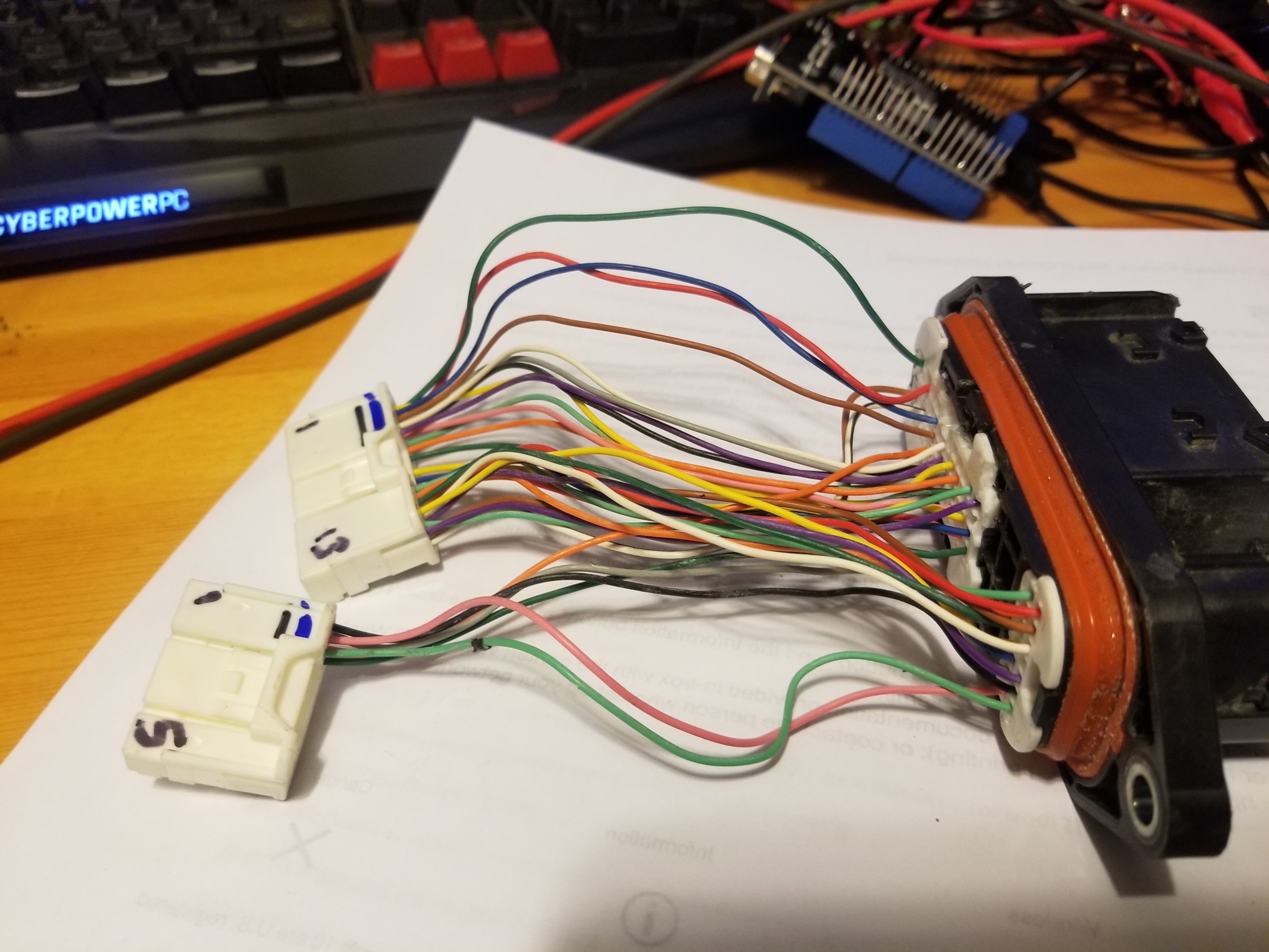

Looking for pin out or a picture of the 450H inverter internal wiring harness.
I had cut the end off to install the amp seal connecter but didn't mark the wires correctly.
And now I can't figure it out, because Toyota used same color wires for different signals.
below is a picture of a Camry Inverter internal wiring harness. 450H has a different layout.
Please help! :)

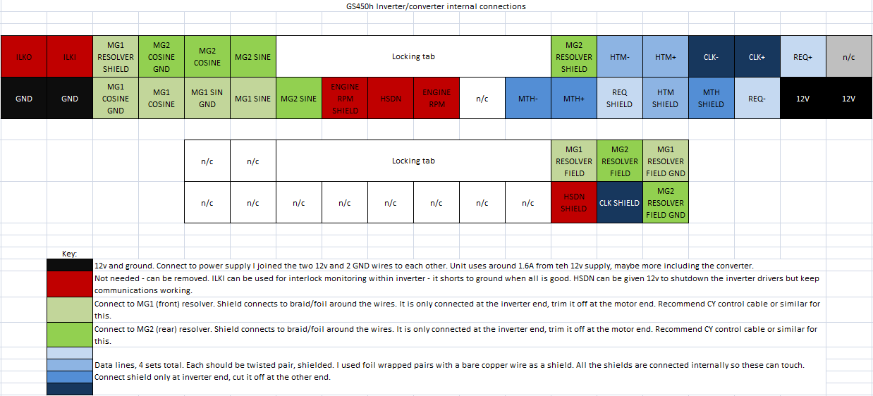

Post by TonyV »
Found this on the Wiki somewhere.
But for the life of me I can't find it again.
Thank god I saved it on my computer before i closed the page.
THANK YOU to whomever put this up!
Anyways this is for the next guy that screws up royally like I did. ;)

xp677
Posts: 442
Location: UK
Been thanked: 15 times
Re: GS450H Motor Connectors
Post by xp677 »
I did originally upload it. The file inverter_connections.png is still there (I can't upload a new copy due to the name being in use) but the reference has been removed, I'm not sure how to fix this.

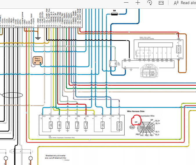

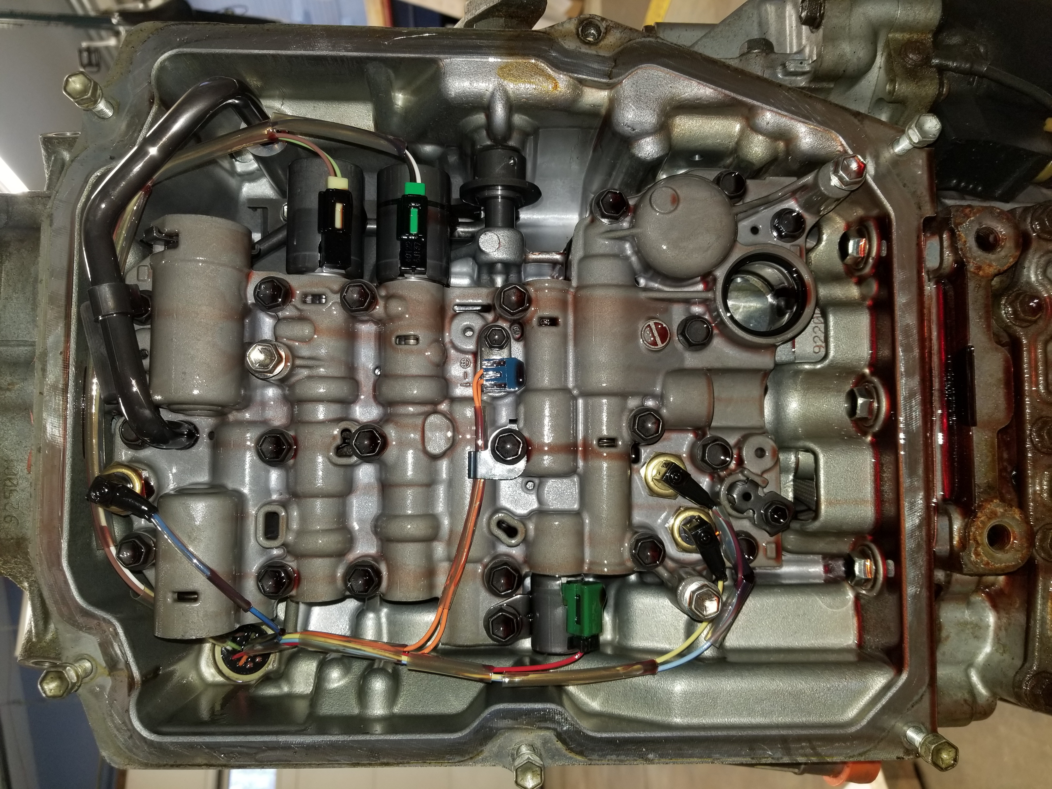

Post by TonyV »
For those of you who were scratching their heads trying to figure out why there are 2 "SP" pins on the wiring harness diagram... well
Pin 1 is NOT used!
Sorry for the poor quality picture.
On my transmission (and I'm sure others must be the same) the actual Pin 1 was missing on the transmission side of the connector and I thought it had broken off somehow.
So I removed the connector from the transmission and I can confirm that there only 10 wires going to the connector from inside the transmission.
I should've taken better pictures but I didn't think I was going to post this, but then thought someone else might be having the same issue.
