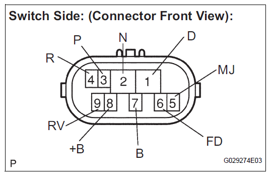

Re: GS450H Motor Connectors
The "SHIFT LEVER POSITION SENSOR" connector is tough one. OEM may be the only option besides some "custom" job.
I am going to look into getting plug assembly or housing from Toyota/Lexus dealer but it may be very expensive and they usually have housings only without pins.
I will report my findings.
Anyways, as functionality goes, my understanding is that lever locks output shaft mechanically to to provide PARK brake and sensor provided feedback to control module which gear is selected by sending +12V to appropriate pin.
Therefore it will be very important to have it wired to VCU to prevent and perhaps limit torque at certain positions.

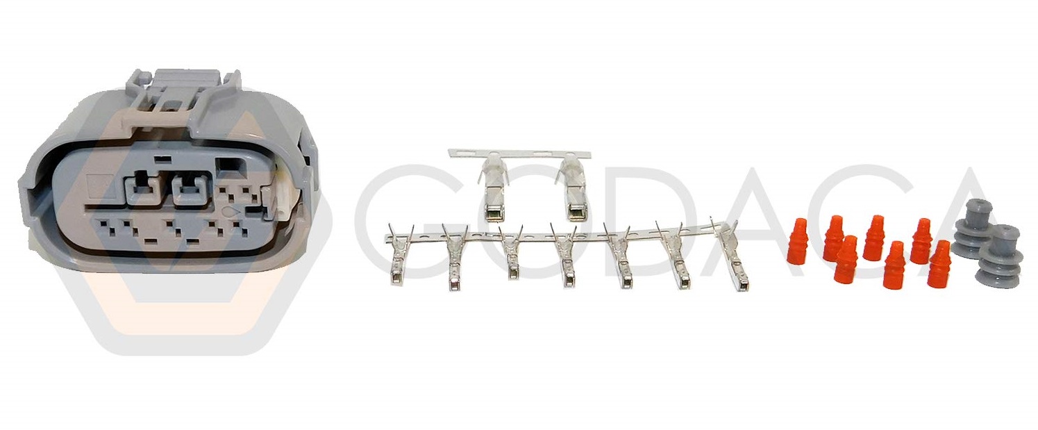

UPDATE 2:
I have discovered part number of this connector which is "90980-12362".
In US it is being sold by vendor named Godaca LLC and here is few links:
http://godaca.com/1x-connector-7-way-fo ... 980-12362/
https://www.amazon.com/Connector-7-way- ... B07RHVGHBH
https://www.ebay.com/itm/1x-Connector-7 ... 4313452300
Honestly, I did not think it was possible to purchase it but here it is! I have already ordered mine

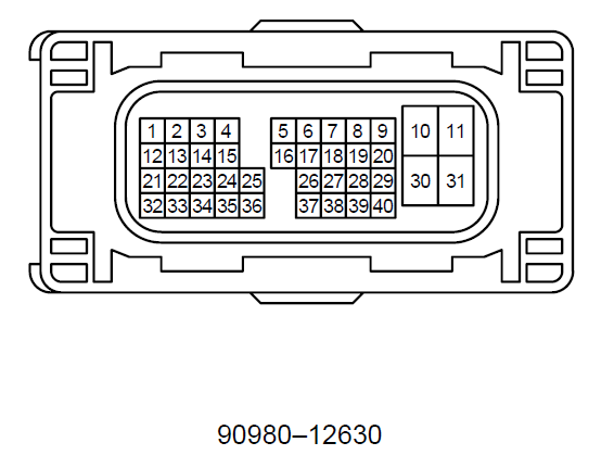

Here is part number for A62 Inverter Connector: 90980–12630
Yes, park is a parking pawl, the other selections are all the same mechanically. It follows this wiring:
For my application I connected the white +B wire to ground, and commoned the R,N,D wires, to give two positions for this switch. If you want to reuse an existing mechanical shift lever, using the 4 or 5 available positions of the switch would be a good way to do it.

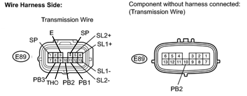

Here is what I have.
Please pay attention at Harness (Left) and Components (Right) sides.

Does anyone know the part numbers for the harnesses that plug into the transmission and inverter?
I've figured out:
8216430040 is the harness from the battery to the inverter and is the two smaller white connectors.
8211130* appears to be the main engine harness and I think contains the connectors from the EV ECU and the Inverter (big plug), but can't confirm that or exactly which variant if it matters.
8212130D10 appears to be the ICE harness and does not appear to be the right one.
No clue for the rest of the transmission, although those seem much easier to replicate than the shielded stuff in the EV ECU <-> Inverter connection.

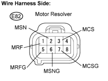

My 450h motor is missing the resolver plugs. Does this look correct to you folks? As for the four twisted pair, can I just wire them up using some CAT6 cables?
Yes, this is correct plug.RE3Rotor wrote: ↑Thu Feb 13, 2020 2:13 am My 450h motor is missing the resolver plugs. Does this look correct to you folks? As for the four twisted pair, can I just wire them up using some CAT6 cables?
https://www.aliexpress.com/item/4000132 ... hweb201603_
Keep in mind those wires have to be shielded, CAT6 shielded should work just fine. I would try to find thick 24AWG or 26AWG minimum.
I am using CAT8 S/FTP 24AWG with each pair is individually shielded.

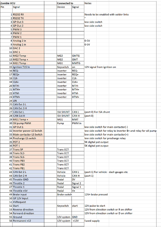

Does anyone have pinout for the resolver connections? Or all the different connections on the gearbox? Or if they can provide me screenshots of the section of the service manual, I can compile that together. I don't have all the wiring harness to go between the inverter and gearbox. I think it is valuable for those of us who needs to build a harness from scratch.
Here is an image of the connector, looking at the front of it.
- gs450h resolver.png (28.67 KiB) Viewed 17661 times
The remaining two pins 4 & 8 are the motor temperature sensor, these don't connect to the inverter, they connect to the Vehicle ECU.
I thought I had it figured out but I don't. Do you happen to know what the two prefixes (M & G) on the resolver wiring denotes MG1 & MG2 respectively?
The wiring diagram is here https://openinverter.org/wiki/images/a/ab/Inverter.png
The pin numbers and signal named in the above diagram align with the earlier connector pin out I posted.
The ones starting with G are MG1 and M are MG2.
