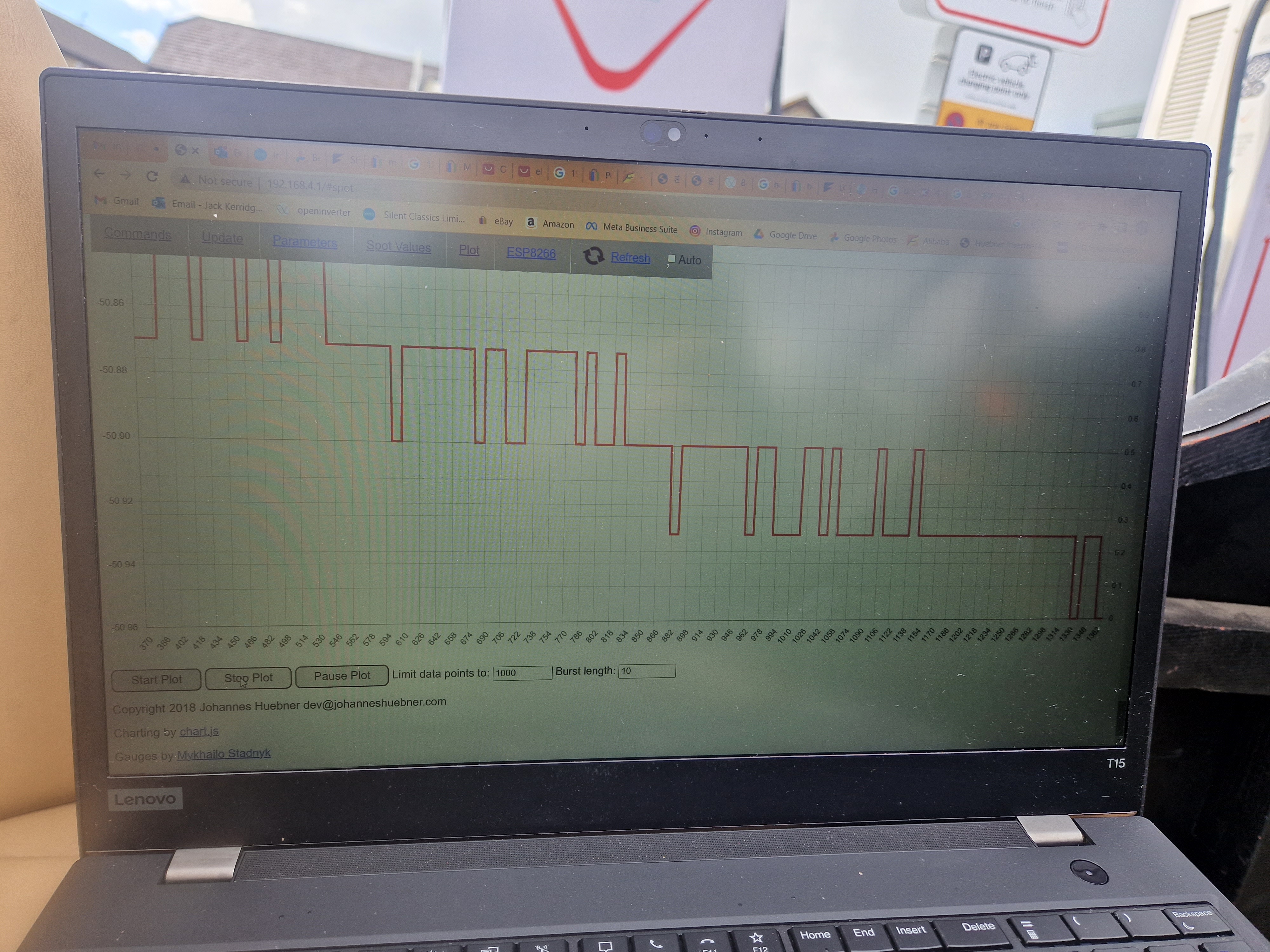

So following on from catphish Posts, we have had a chance to test the CHAdeMO.
I Can confirm that CAN now works! :D I have attached some supporting images.
However no current flow. We have established that the CHAdeMO Contactors are not closing. Within the pdm - (Picture attached from Johannes YouTube video on the pdm) ( We haven't pull ours out the vehicle yet to open it up) however it seems that p2&10 go to a logic board. Assuming this is controlled via can to close the contactors, has anyone got a can log from a leaf during CHAdeMO to try decipher what the required messages may be for the board?
Regards, all!

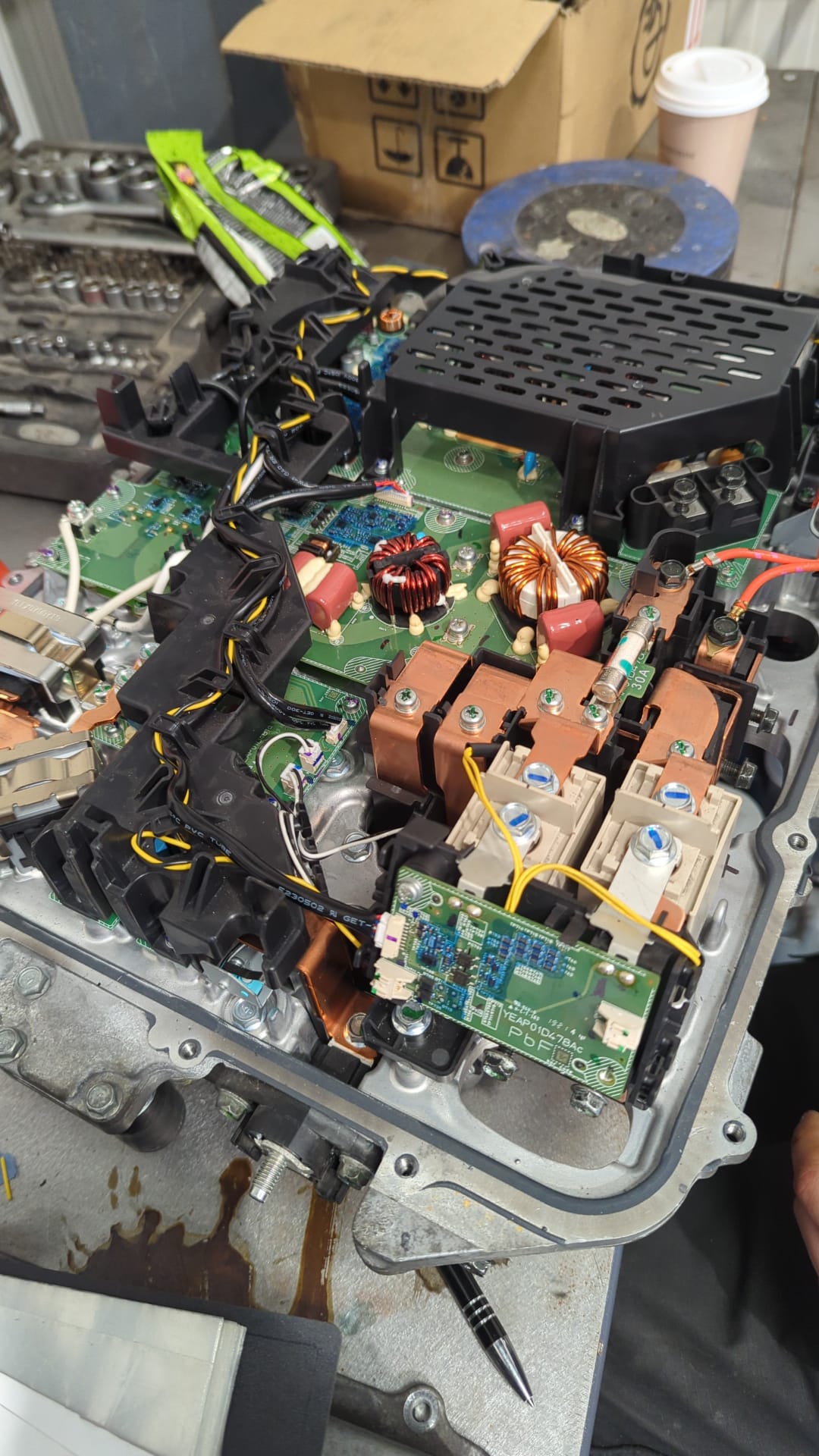

johnlr
Posts: 23
Joined: Mon Mar 20, 2023 10:55 am
Been thanked: 11 times
Re: Chademo Leaf PDM & Zombieverter!
Post by johnlr »
As least for gen 3 PDM the quick charge relays are connected as follows:
Edited after a closer look at the logic board, and further edited after releasing i have a gen 3 PDM (from 2019 110kW leaf)
PDM connector pins:
5 relay plus&minus 0V also connects to PDM case
8 relay minus +12V
24 relay plus +12V
This differs from a PDM connector diagram I found somewhere that does not list pin 5 (that is just another gnd pin). To drive the relays connect pin 5 to 12V and drive pins 8 and 24 to +12V, the relays are 19ohms (measured) so will likely need an economiser unless there is one inside the contactor.
The voltage sensor on the logic board is a simple level detect circuit with a switch to turn on the resistor chain. The voltage sensor uses PDM pins 2, 3, 4 these connect to the logic board. The voltage sensor has two optos one switches the high voltage resistor chain, the other opto is driven by the high voltage resistor chain, this drives the sensor output via a non simple circuit, maybe it is some sort of successive approximation circuit.
I don't know how the sensor functions yet. The resistor chain appears not to be constantly rated (8.7W at 500V) dissapates 2.2W at 500V which is why there is a switch to turn it on during voltage sensing.
At least for gen 3 PDM the quick charge relays and voltage sensor are controlled directly from the PDM connector pins and not by the PDM via can.

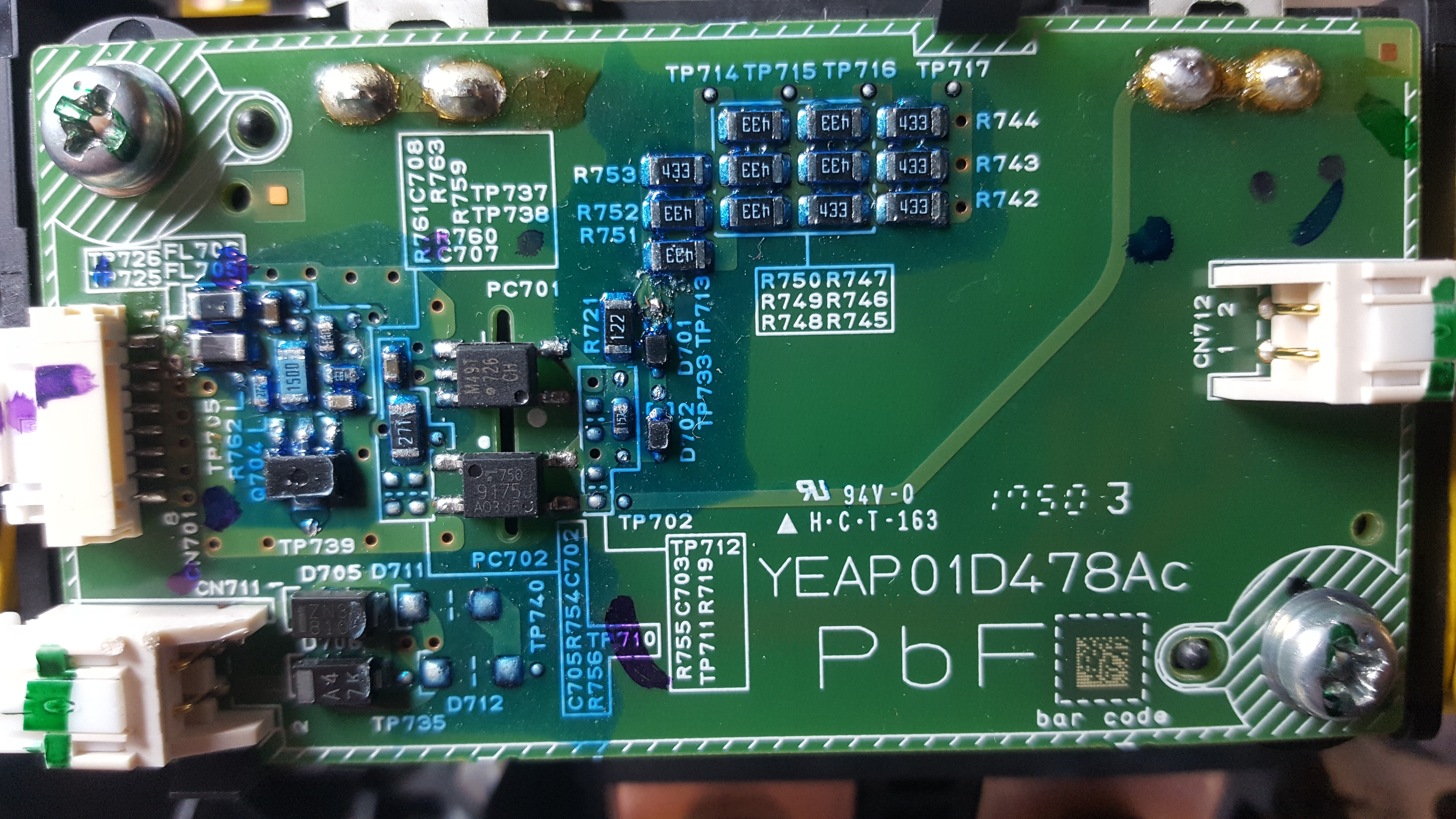

I have had a good look at the gen 3 Chademo logic board (YEAP01D478Ac), attached is the circuit (possibly with some errors) Edit attached picture for reference
I have powered up the voltage sensor and it works as follows:
PDM connector
4 sensor gnd
2 sensor output, pullup to 12V or 5V if using an analogue input)
3 sensor supply, 5V
Connect 5V between pin 3 +ve and 4 -ve, note that powering the sensor from 12V will give 50mA to the opto which is quite high. The sensor work still works with 4V supply so I expect it designed to work with 5V. The sensor is a threshold detector.
Connect 1k pullup from pin 2 to 12V to (5V)
output 1.35V(0.62V) HV is > 180V
output 8.5V(3.5V) HV is < 180V
Note this was tested with a voltage across the 1k5 and 1k2 resistors (no high voltage supply), threshold is 2.65V which equates to about 180V across the full resistor chain.
leaf_gen3_Chademo_contactor_logic_board.pdf
(5.32 MiB) Downloaded 681 times

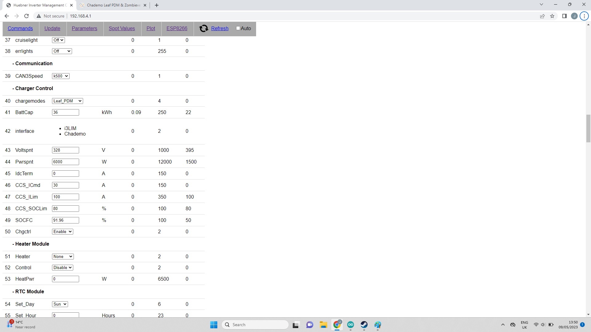

hi guys,
Following the (very exciting) release of V2.00 firmware - Thankyou Damien and anyone else involved.
We have successfully charged using AC however we failed to successfully charge using CHAdeMO..
Should '42 - interface' not be an option as apposed to the bullet points currently shown? - please see my attachment for reference!
Probably helpful to add the car still drives as before without any issues.
Thanks again for these developments guys!

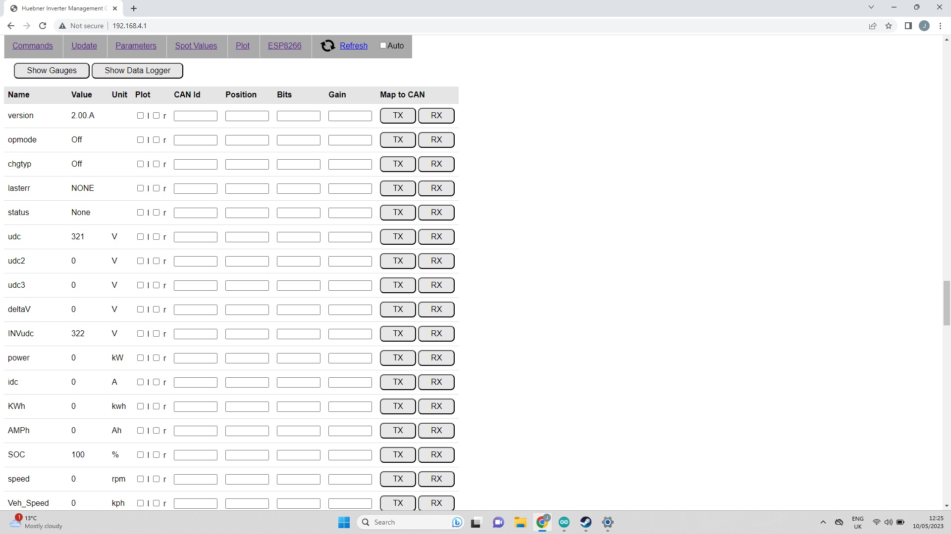

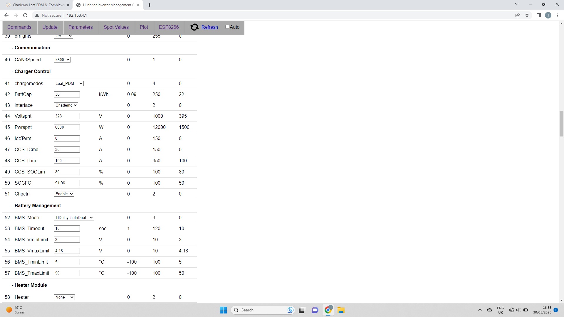

Hi guys, Has anyone tested CHAdeMO with 2.00??
We took our car to the local fast charger this morning to test, following testing driving and AC which were both successful
However we failed to get the car to charge on CHAdeMO..
I have attached our settings for reference.
It seems as though the VCU isn't picking up the 12v from the charge station to send it into fast charge mode, and therefore start sending the can messages required to start charging
