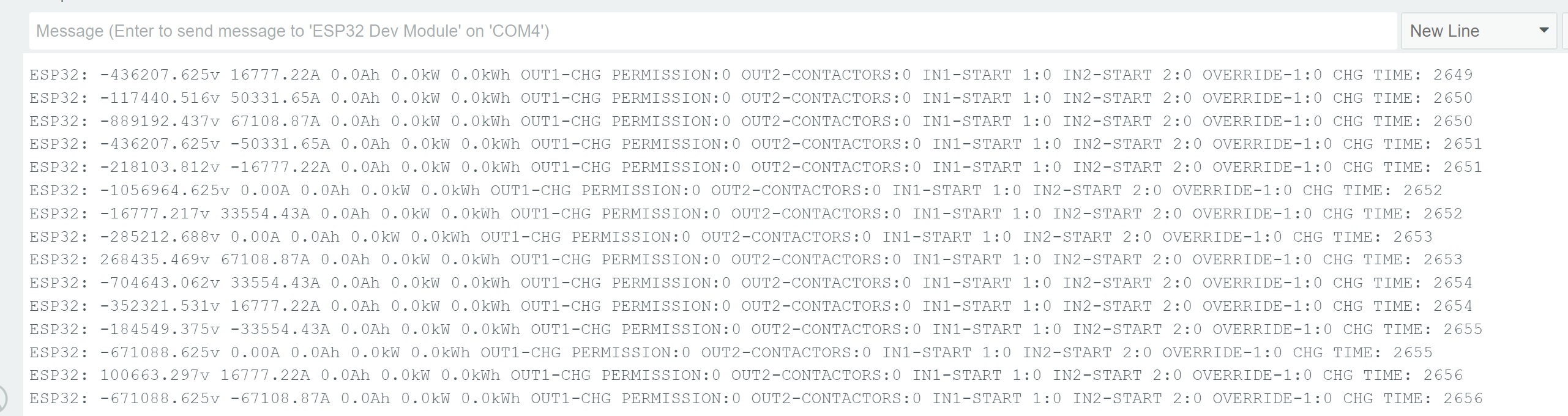

Hey, great work and good to see the esp32 being implemented for this.
I have added a range extender pack to my 2015 outlander so taken the EV range up to wound 140kms so pretty happy with that.
I have purchased the boards and all the hardware and are currently setting up a test setup for this. I am currently getting communication back from the IVT-S shunt however the Voltage and Current seem to be all over the place ranging from large high numbers to negative numbers. If I remove any of the wires both CAN and Power it stays with the reading it has and then keeps going once I put the wire back in. This tells me it is communicating and the ESP32 is getting values from it or at least from the CANBUS.
I have attached a screenshot and would like any help if possible on getting this stable.
Currently its on a test board with 12V power and the same 12V on the voltage input terminal.
Thanks, Matt.

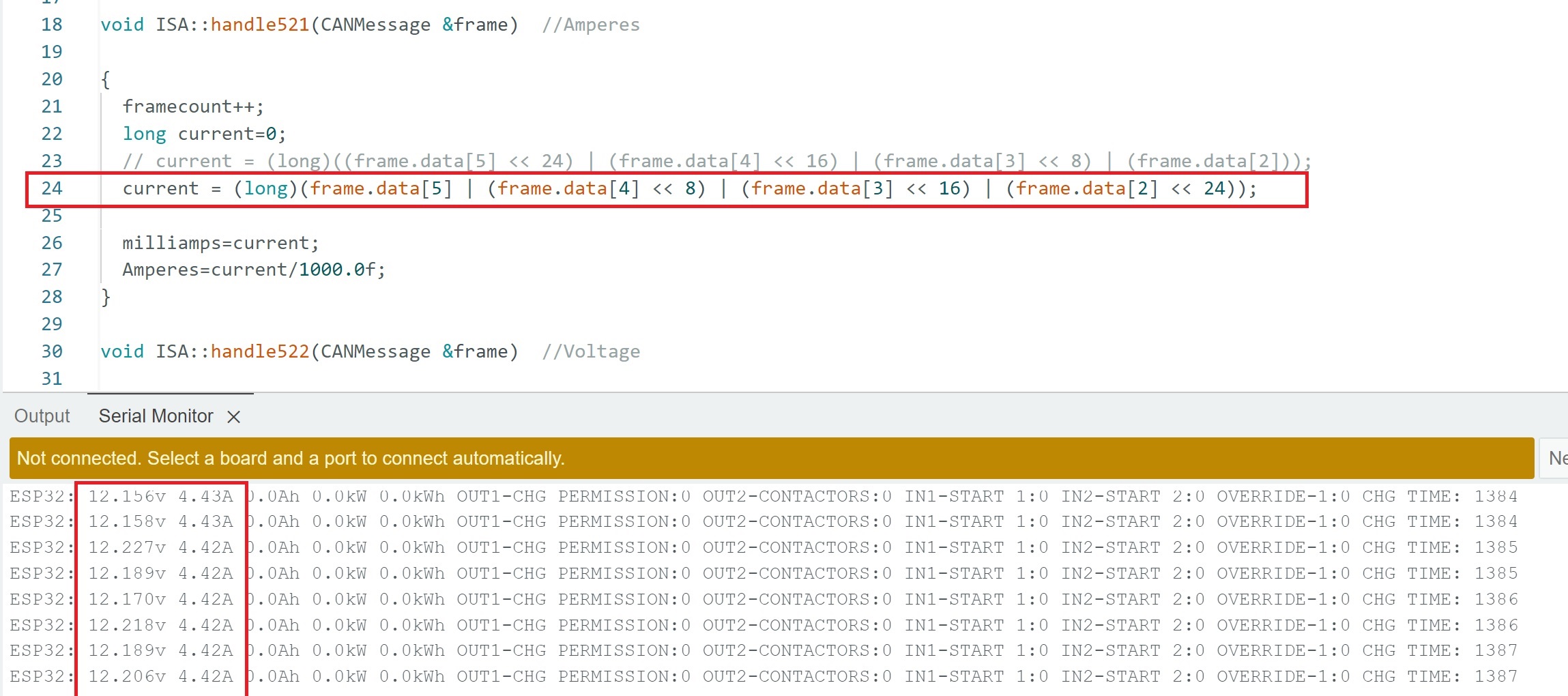

So seem to have got this sorted by changing the Endian order and reversed it. Screenshot of code fix attached.OutlanderMatt wrote: ↑Sat Nov 25, 2023 12:13 am Hey, great work and good to see the esp32 being implemented for this.
Thanks, Matt.

Sorry, somehow missed this.
From new the ISA shunt uses big endian and doesn't output as much data https://openinverter.org/wiki/Isabellen ... te_Heusler has instructions to swtup

Thanks for your reply. That would explain why I am not getting very far. I can get it to charge and for the most part seems to respond however Soc, Kwh etc isnt working. I will see if I can get my hands on a DUE and setup the shunt. Could this be done on a Mega? Also I am getting Voltage and Current from the Shunt at present.Bigpie wrote: ↑Sun Nov 26, 2023 8:12 am Sorry, somehow missed this.
Could this also explain why the current isnt ramping down when the voltage gets up to the target voltage? Seems to reach target voltage and then just shutdown?
Thanks, Matt.

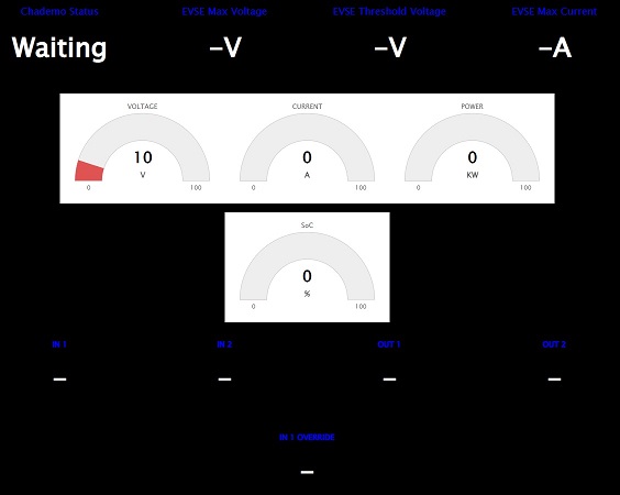

Testing is proving great and also implemented a ramp down feature to go from CC to CV and seems to be working well. Just added in the complete shut down after it gets below the minimum charge current so will test that today.
Have been playing with the web pages just to make them look a bit nicer on my Android screen in the car. I have managed to work out all the colours and font sizes etc so am playing around with them at the mo but cant seem to find how to charge the background of the gauges to Black?
Have done quite a bit of searching and cant seem to fine where this setting is for the gauges. Seem to find all the other settings, just not the one it want
Any help with this would be great
Thanks, Matt.
Thanks, Matt.

Awesome. Do a PR for the ramp down. Can't remember off hand how to change the background. Will have to check tomorrow

Ok thanks. I must have got the older file as there was definitely no connection to 3.3V or 5V. I guess it’s preferable to use the 3.3v?
Also did you get a chance to find out how to change the background colour of the gauges?

I connected the 3.3v
In gauges.js theres a backgroundColor property on the gauges, might be worth having a look at that, not sure, not had chance to look properly
