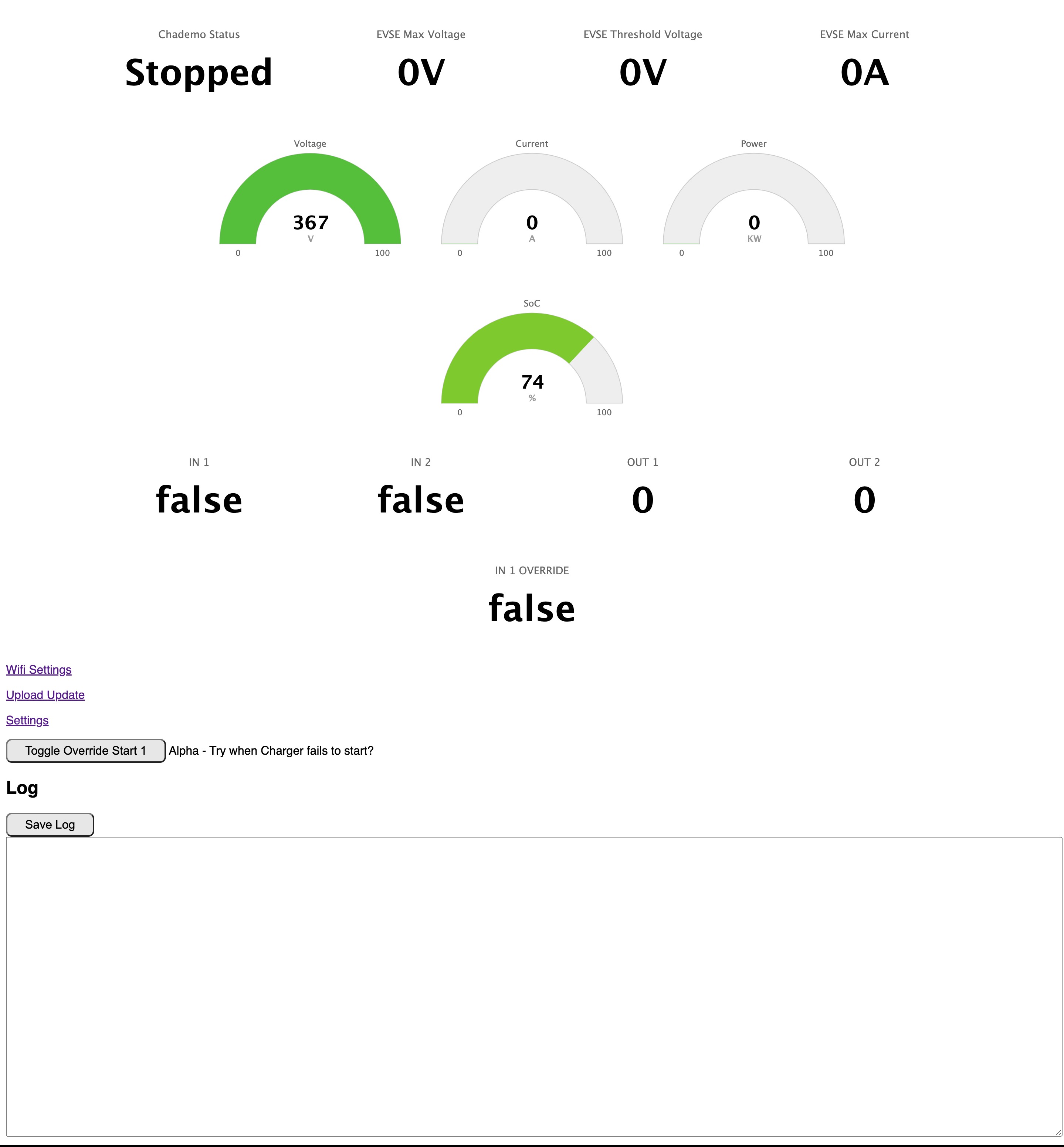

Bigpie wrote: Tue May 23, 2023 7:10 pm Web interface for setting params and logging output
Can you post a screenshot of your wifi charging interface? Just a teaser... :)
Posts: 1884
Has thanked: 91 times
Been thanked: 517 times
Re: ESP32 Based Chademo
Will this do? Wasn't charging, just sat on the drive.
Posts: 3796
Been thanked: 413 times
Bigpie wrote: Wed May 24, 2023 8:21 am ESP32-BMS.jpegScreenshot 2023-05-24 at 9.18.38 am.png Will this do? Wasn't charging, just sat on the drive.
Really good thank you. Its just what i was hoping for :). I will adapt the code and test it in my Chademo setup.

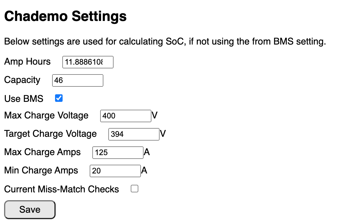

Can you let me know what is with the 1K pullup resistor on the IN2 pin? Do we need one or can we live without one?
It is important to know because i dont have opto inputs designed into my board. I use simple 10k/2k7 resistor dividers on analog pins or 10k pullups on digital input pins. As i wanted to use those inputs with relay towards GND their voltage vulnerability didnt matter much...
tnx
Posts: 1884
whereswally606 wrote: Fri May 26, 2023 10:31 pm amazing work Jamie, was hoping for something like this for CCS for when i supplement the env200's rapid charging capabilities.
I've started looking at CCS based on the Catphish/Uhi stuff.
arber333 wrote: Can you let me know what is with the 1K pullup resistor on the IN2 pin?
The EVSE will ground IN2 when ready to charge, you could do away with it, johu/zombie based chademo doesn't use IN2, but the code will need changing a little

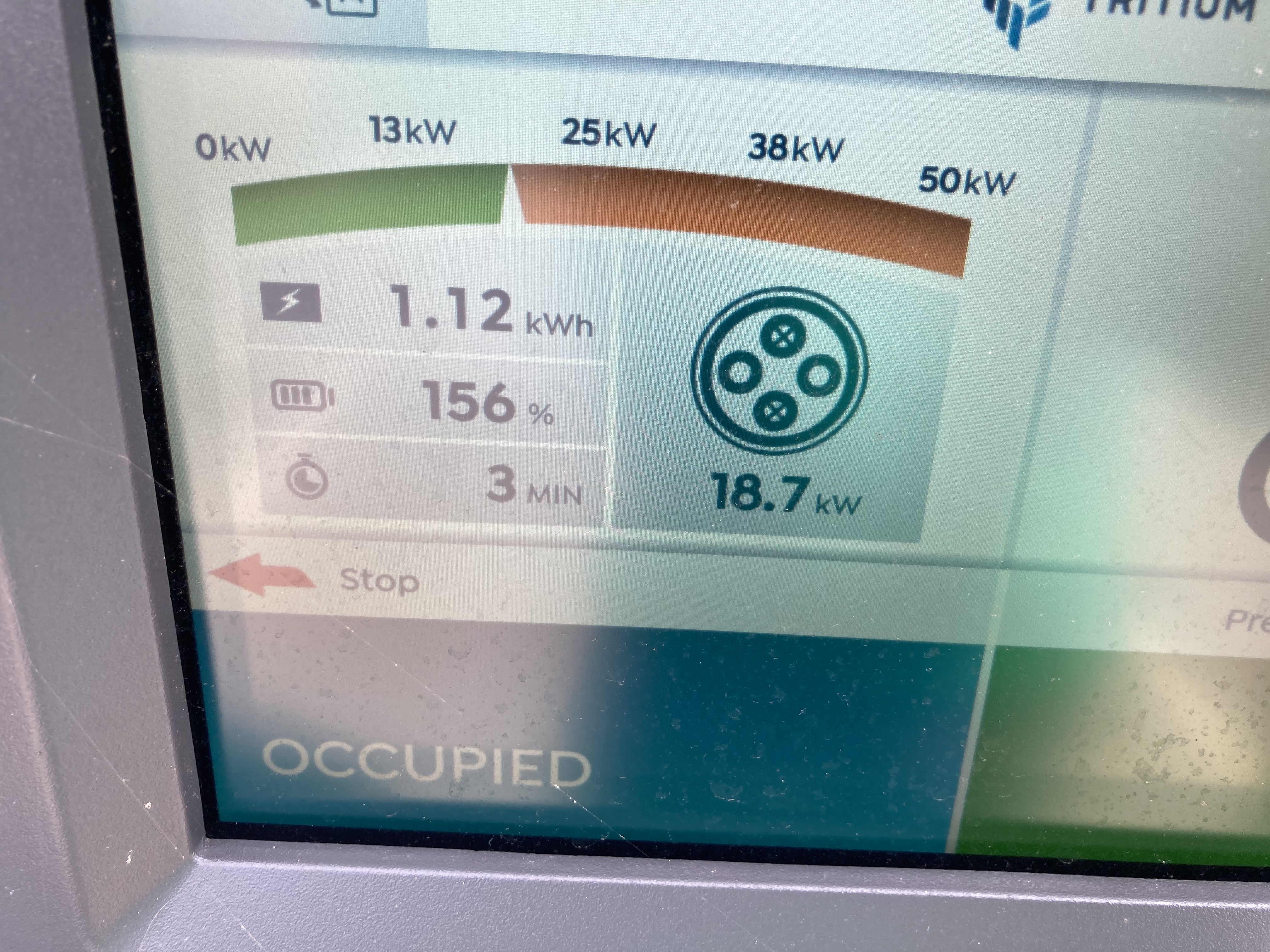

Ev8

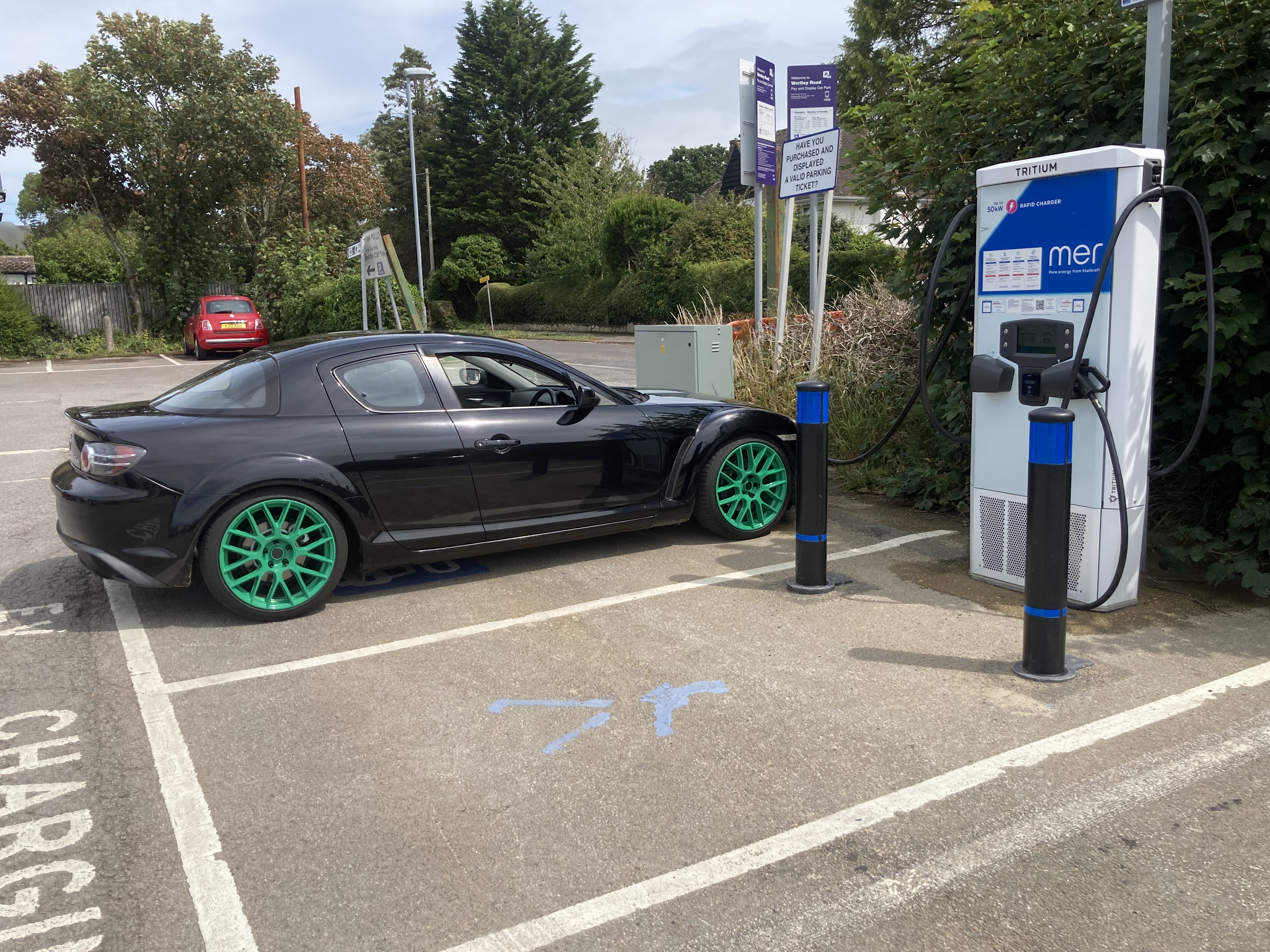

Posts: 835
Has thanked: 44 times
Been thanked: 173 times
