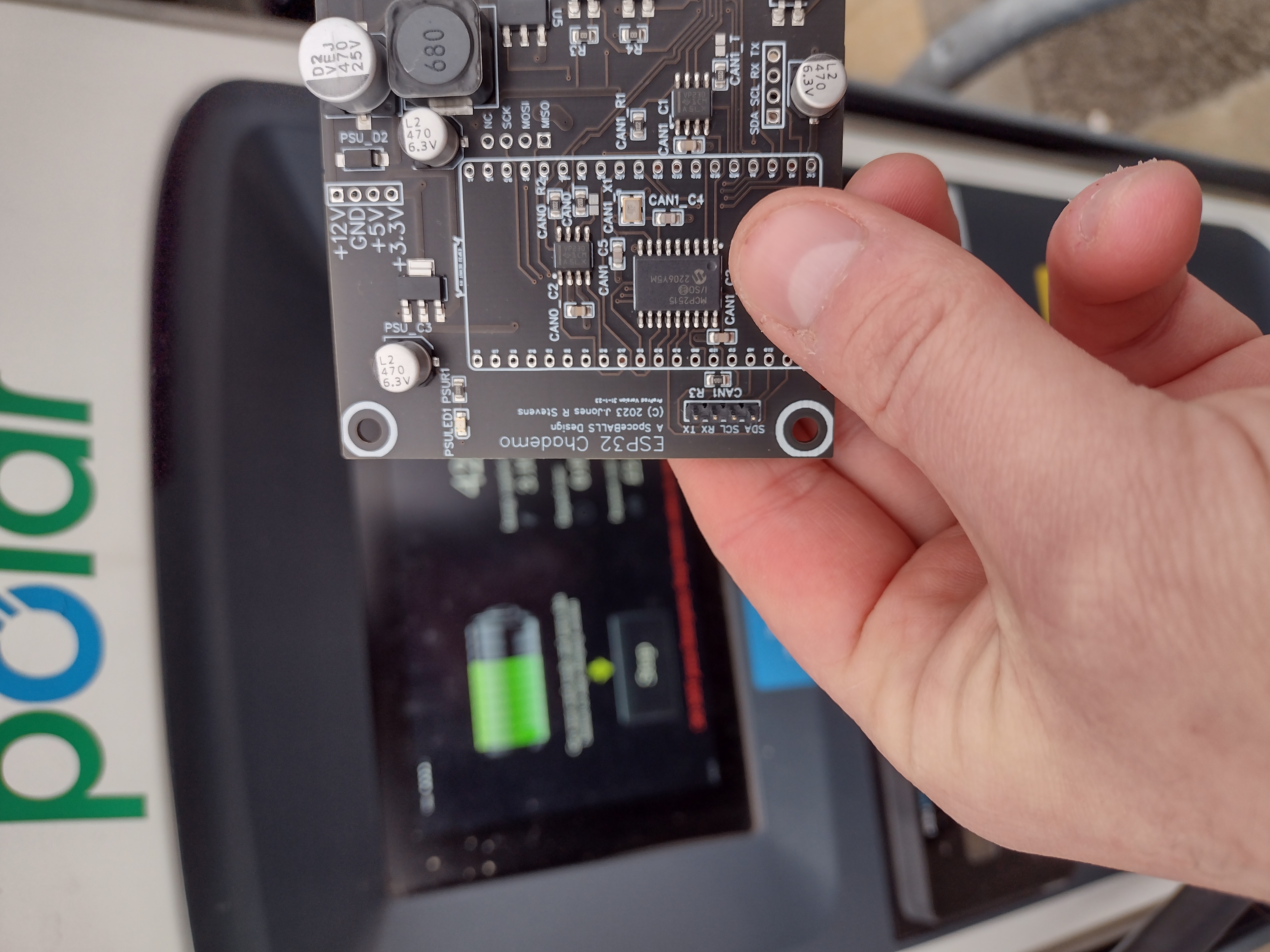

I've been working on an ESP32 based Chademo implementation, it's pretty much a port of the SAM3X code that I was using on my DUE setup.
https://github.com/jamiejones85/ESP32-Chademo boards and software there. Will update the wiki with this option too. Can sell anyone the extra boards if you don't want to get JLCPCB to make you some up.

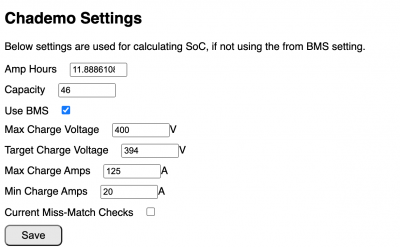

Ok thanks. It seems you only use the 16 and 17 pins for CAN1 which you use with MCP chip. I dont see any code to innitalize CAN0 here. Do you actually use 4 and 5 pins for CAN0? I see code calls out ACAN_ESP32 library?
Do you think ACAN2515 would work with CAN1 and CAN0 with Collins esp32_can library in the same ESP32? I am really more used to CAN_common library and commands as i use it with DUE...

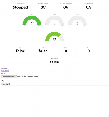

Bigpie wrote: Tue May 23, 2023 7:10 pm Web interface for setting params and logging output
Can you post a screenshot of your wifi charging interface? Just a teaser... :)
Posts: 1782
Has thanked: 83 times
Been thanked: 429 times
Re: ESP32 Based Chademo
Will this do? Wasn't charging, just sat on the drive.
Posts: 3574
Has thanked: 134 times
Been thanked: 340 times
Bigpie wrote: Wed May 24, 2023 8:21 am ESP32-BMS.jpegScreenshot 2023-05-24 at 9.18.38 am.png Will this do? Wasn't charging, just sat on the drive.
Really good thank you. Its just what i was hoping for :). I will adapt the code and test it in my Chademo setup.

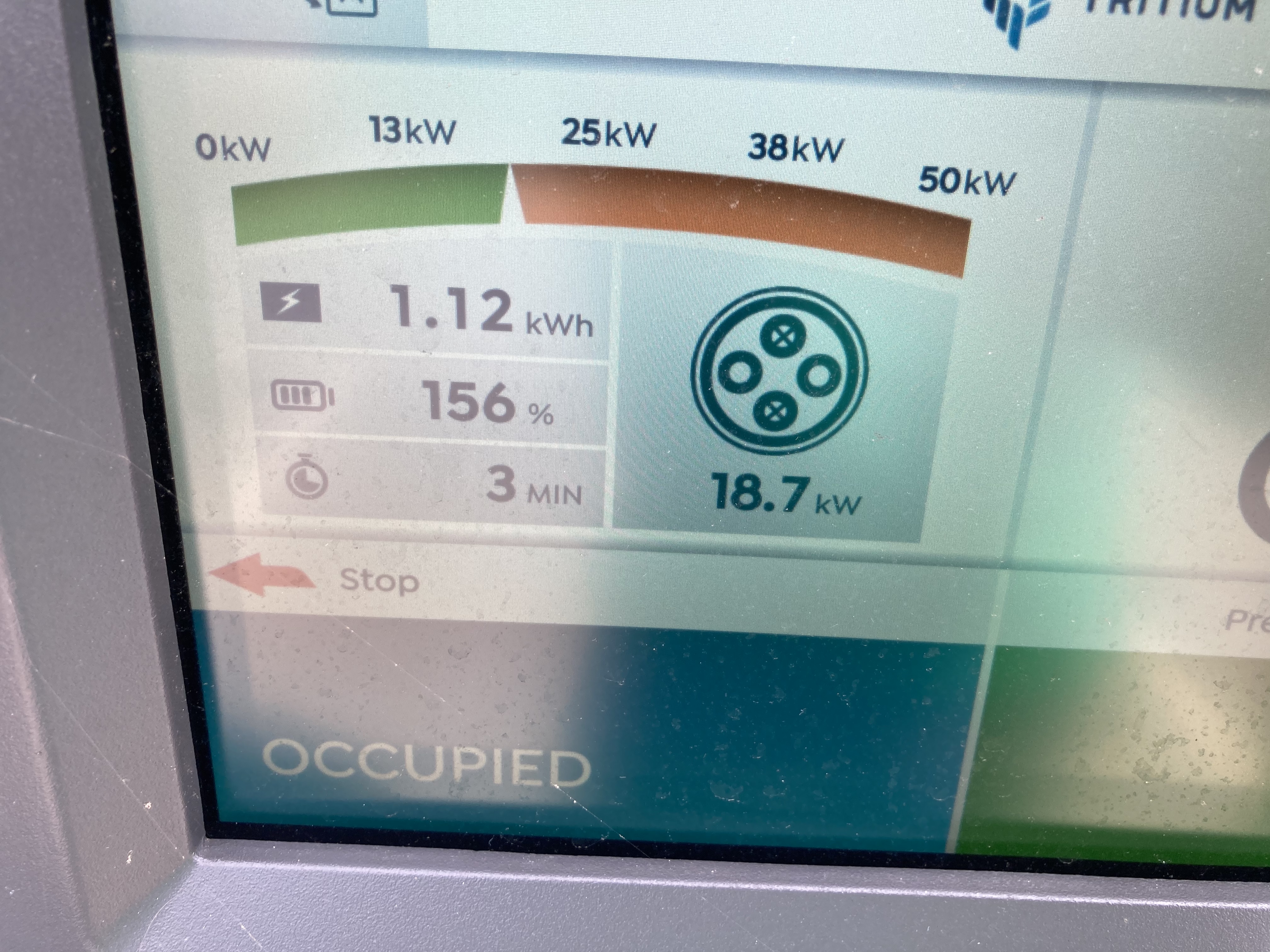

Post by Ev8 »
