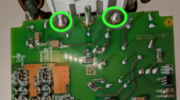

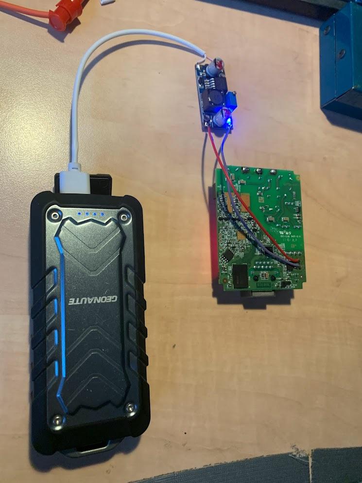

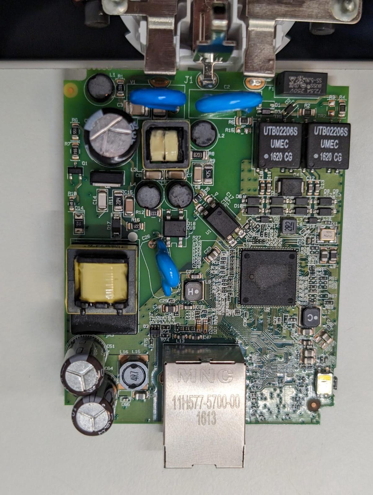

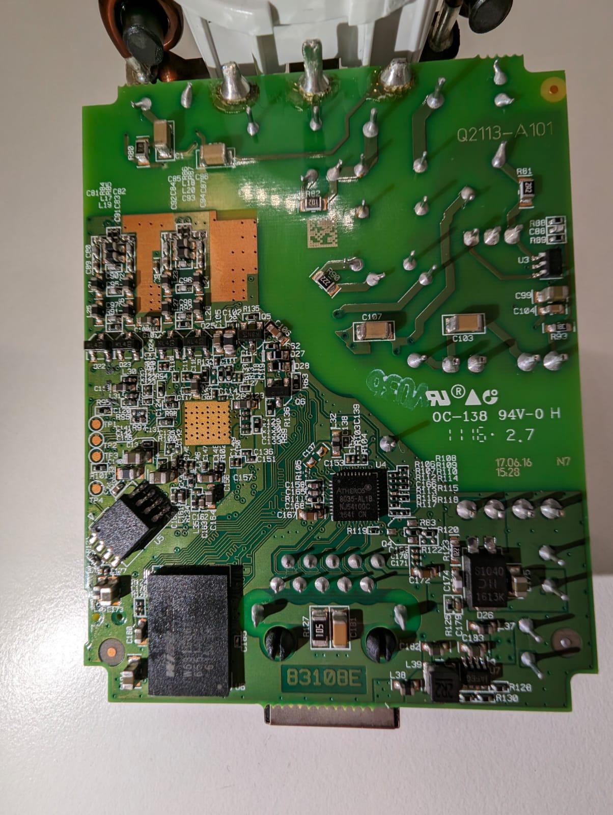

Hi, I would like to test if a Polestar 2 can discharge via the CCS port with a possibility of V2X. I already had a Dlan 1200+ available. And I was able to convertert it to power it with 3.3v and a dcdc converter from 5v (see attachments). Also programming it was succesful but the last step to get it working is connecting the PLC to the car and therefore my question:
Where do I need to connect the CP?

It is not clear, whether the DLAN 1200+ works for this purpose. In my tests here https://github.com/uhi22/pyPLC/blob/mas ... -dlan-1200 the conclusion was, that it does not send the SLAC in PEV mode, and I'm not sure whether it supports SLAC at all. You could try. The original AC power pins should be perfect for coupling to the PE and CP.
The coupling network which needs to be added there is described here: https://github.com/uhi22/pyPLC/blob/mas ... -is-the-cp
