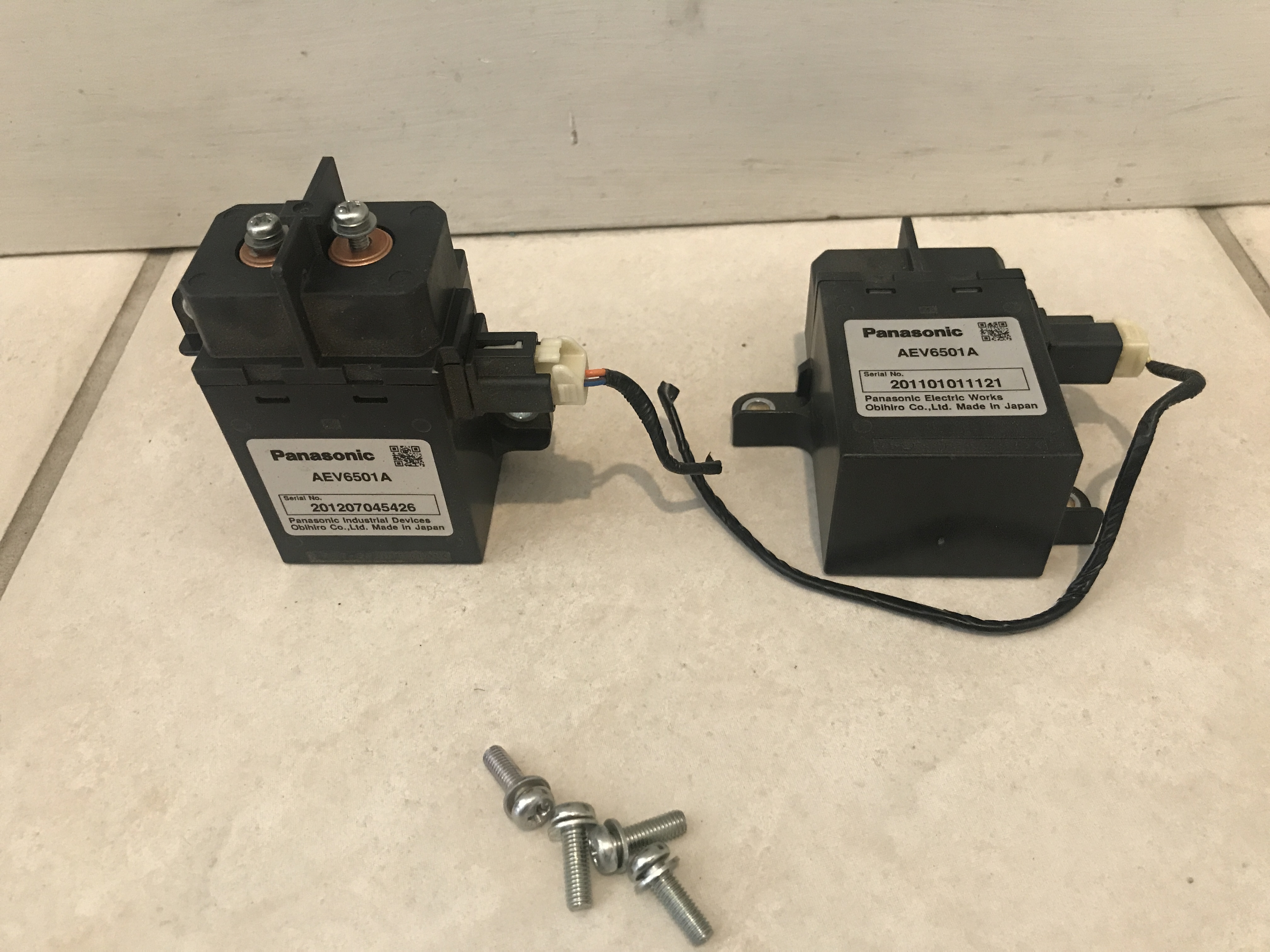

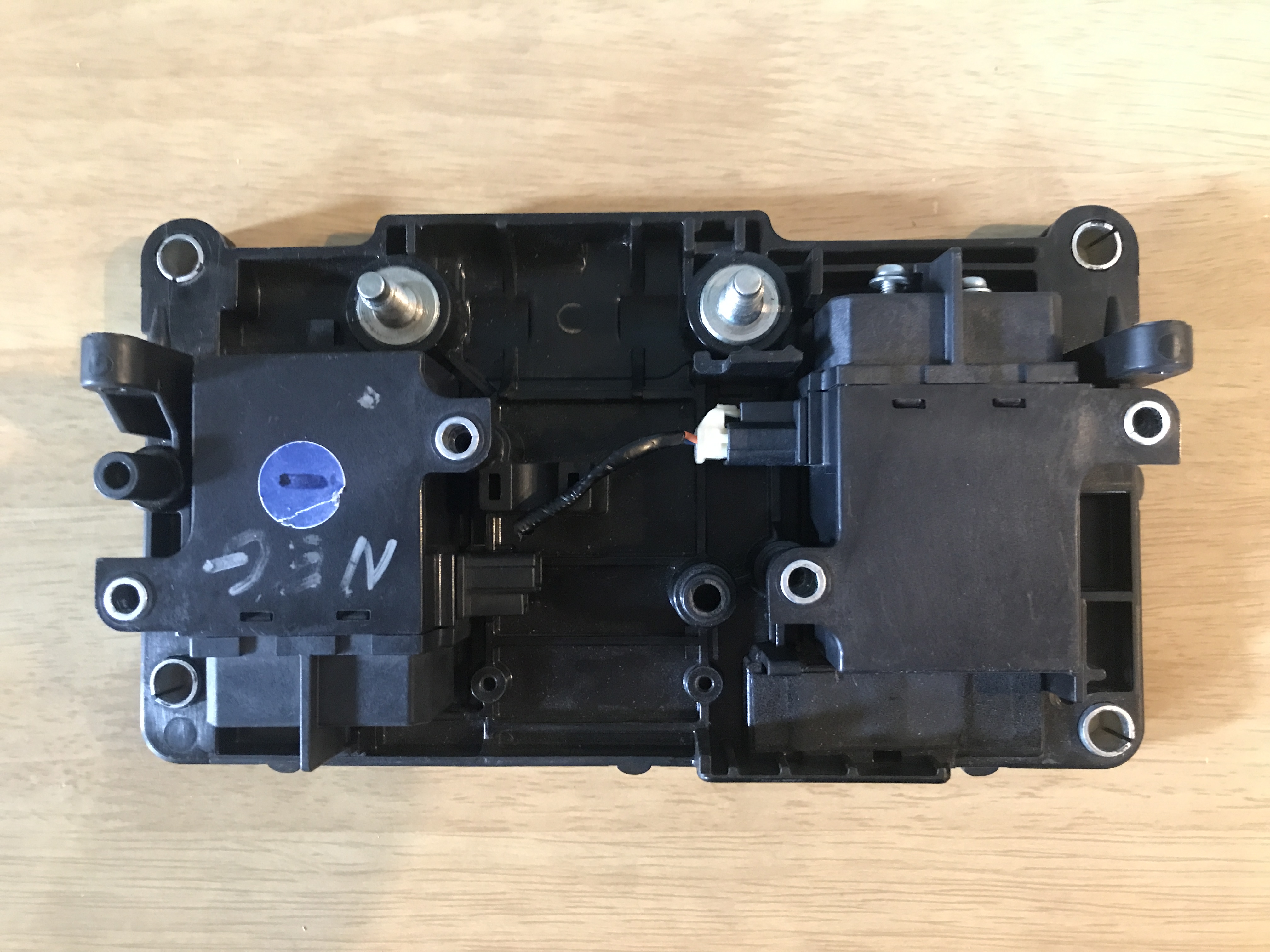

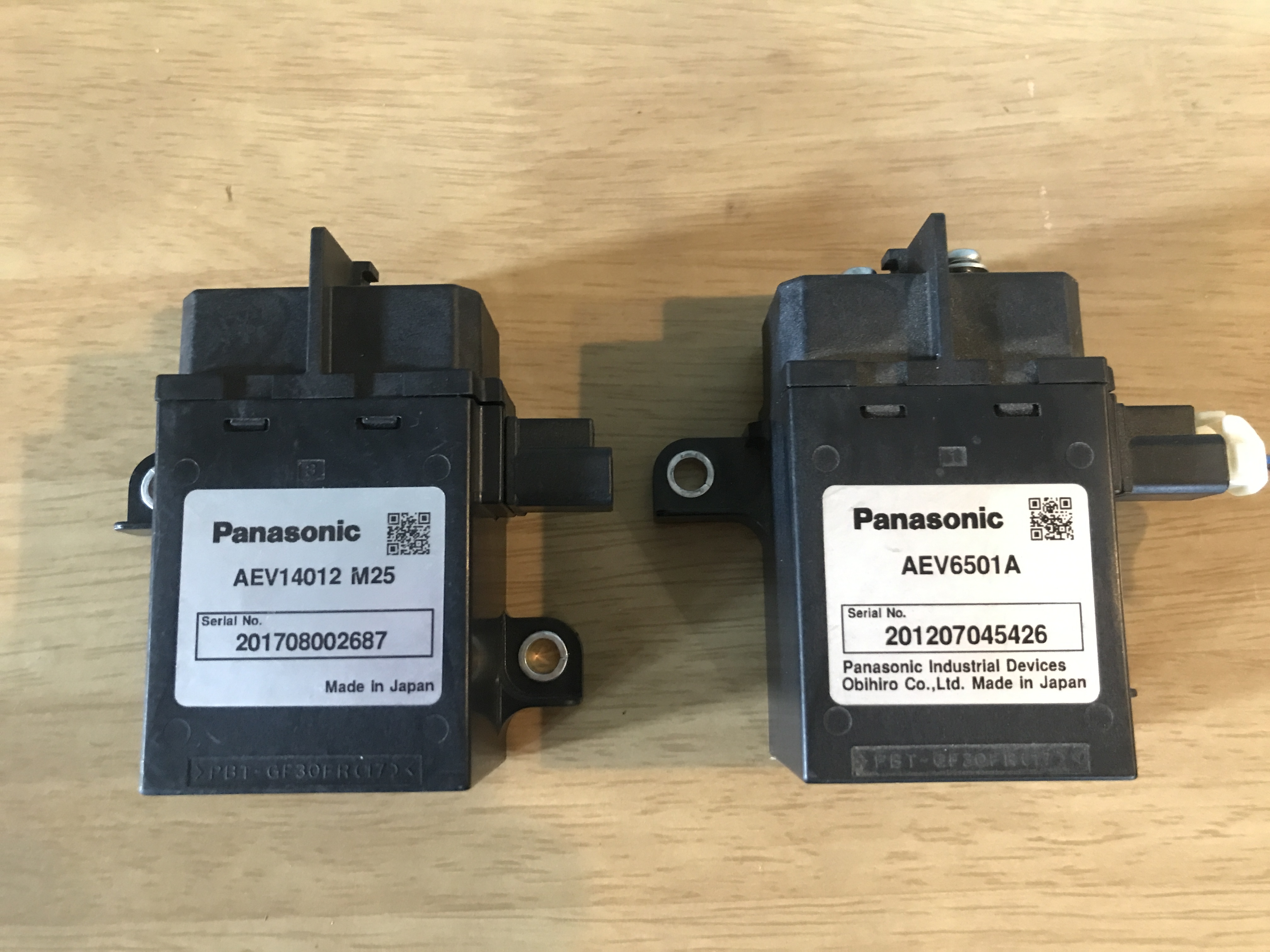

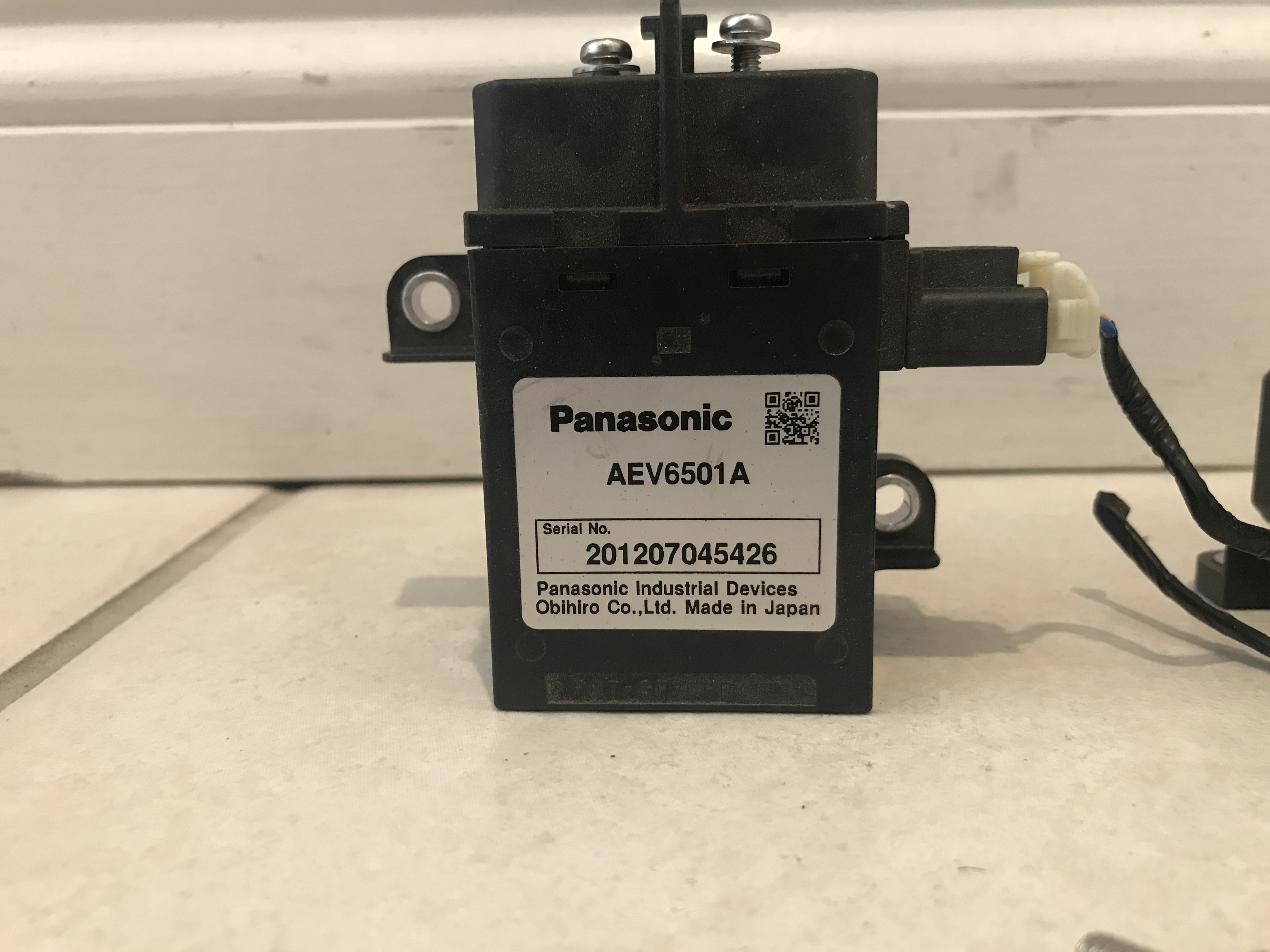

I recently scored some used contactors on eBay for $38 dollars each which were listed as Panasonic AEV6501A 500VDC 200A Contact Relay (From 2013 Nissan Leaf) however they fit into our BMW Safety Box perfectly and have more better specs
Mandatory Stare and Compare: our BMW 530e contactor on the left and the Leafster on the right

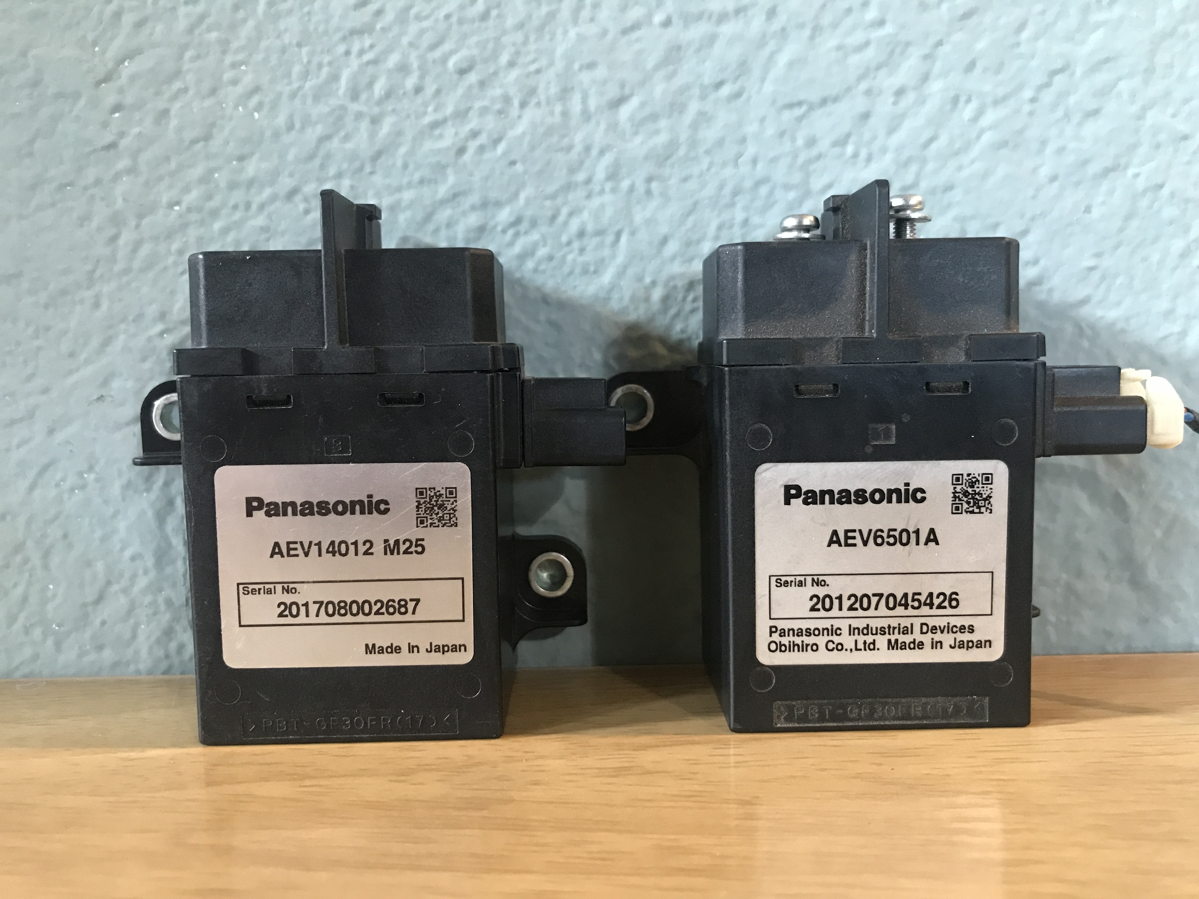

Post by Gregski »

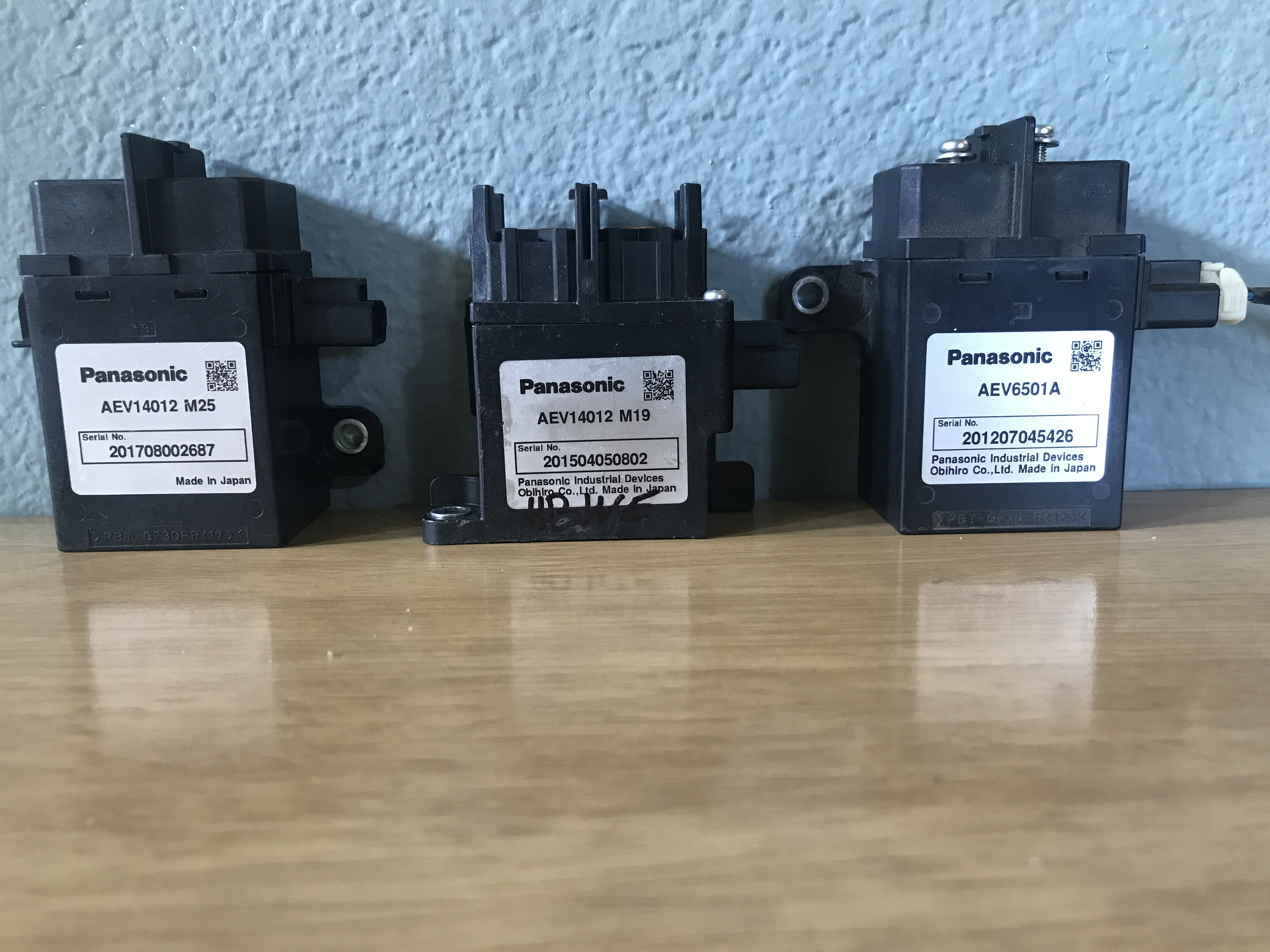

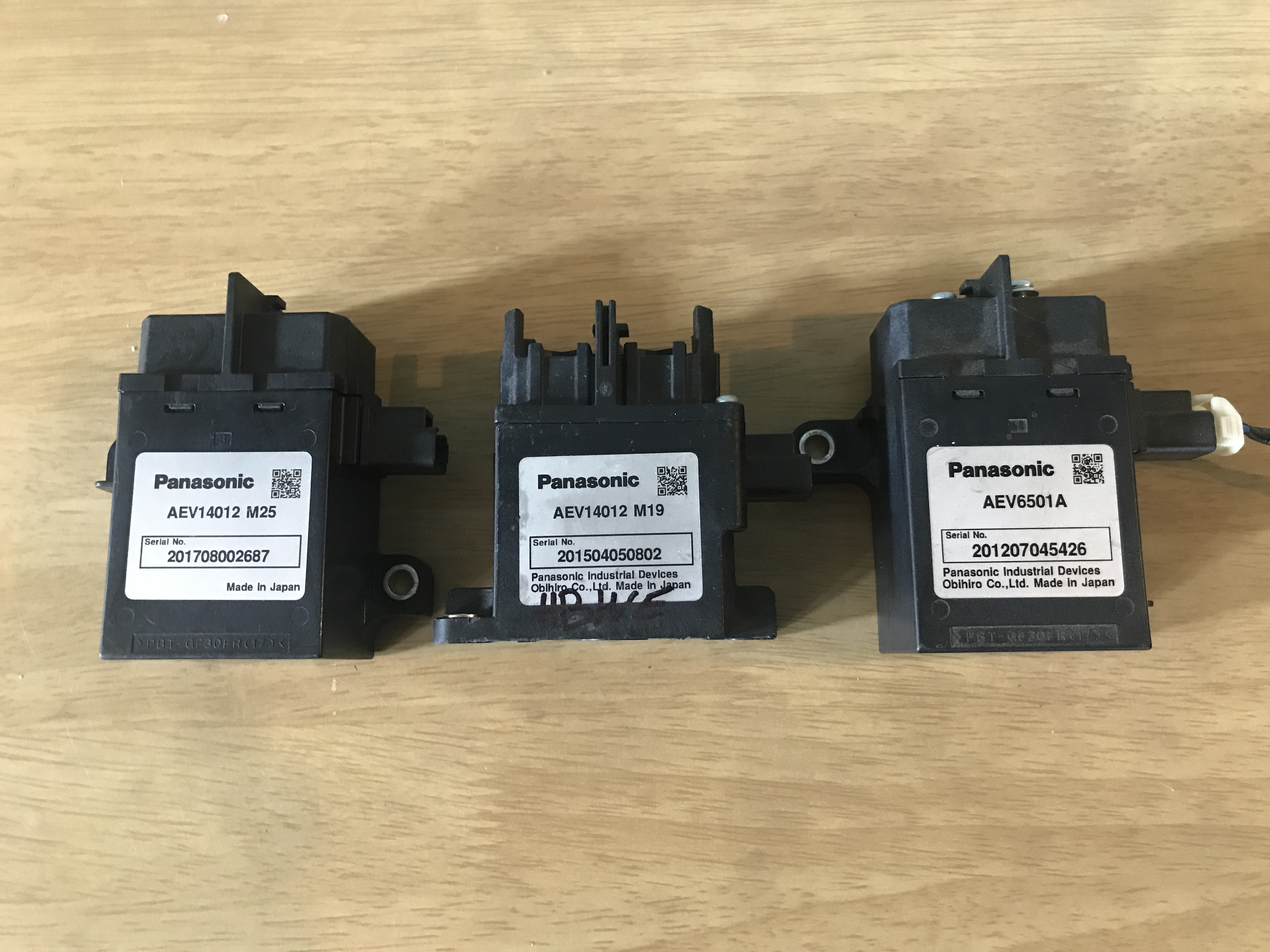

and a little comparison of the Three Amigos so far

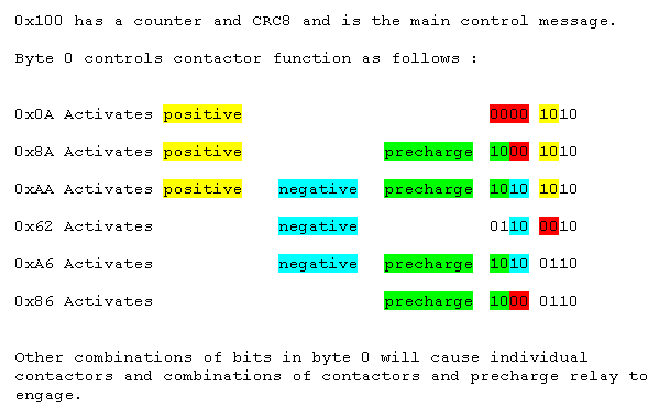

In BMW_S Box byte 0 can have a value of 85 and 00. It seems to me that the contactor states should be 10 or 01 (bin). That is, all closed ones should correspond to 55.

Hello everyone. In what order should contactors be switched on and off?

blik86 wrote: Fri Oct 20, 2023 6:19 pm Hello everyone. In what order should contactors be switched on and off?
I think you are about to be beat up with the we need more information clauyse, but I will assume you mean as related to this Safety Box to drive your car, so...
This is how I turn mine on (Close):
1. Negative Contactor
2. Pre Charge Relay
3. Positive Contactor
This is how I turn mine off:
1. All Contacts Off (Open)
blik86

Gregski wrote: Fri Oct 20, 2023 9:53 pm This is how I turn mine on (Close):
Thank you.
I want to connect the cells in parallel to the note e-power battery (80S, 1.5 kW) via sbox. Subsequently, replace the regular battery and use the sbox to connect an external charger.
I think sbox was supposed to check the insulation and sticking of contactors. Perhaps the sequence of switching on contactors is important for this?
sbox responds to bytes 0x96, 0x66. I believe the contactor state is really encrypted with 2 bits.
