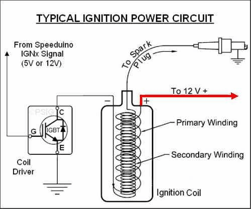

Some Rex ignition Progress,
An adapter to pick up the spline of the resolver, and 3D printed magnet disc, loaded with the magnets.
Have the magnets and sensor giving a clean switch on check before mounting.
Will check with scope once rotating, for waveform.
Have Established engine rotation is Anticlkwise from resolver view, I.e. suction on the intake.
Plug removed to set timing position. Figure doesn't matter whether the adjacent cylinder is ahead or behind 180 °, as is wasted spark method .
So onto coil, have 12v on, and the WS 16 connection is at 12v,
So confirming its a two wire system, operation the third wire is coil ground return ,
I.e. a normalish coil.
Mr Kettering used a condenser, not seeing such on this diagram, looks like resistor of some size..
Any thoughts?

From the diagram, I see:
Position 3, +12v.
Position 2, high voltage (spark) ground.
Position 1, coil - / coil fire trigger.
Digital ignitions don't have condensors that I've ever seen, those are to keep points life up. If you're using an ignition rated driver I don't see why you would need one. If it's not an ignition rated driver a condenser should help it live a bit longer.
It should not need a resistor in line either if the coil driver is strong enough.

Re: State of Rex hacking?
Posted: Tue Feb 20, 2024 7:01 pm
by Woodfie
Thanks for the assistance.
With 12v applied , the White /green "signal" wire
is at 12v, which fits with the Typical Ignition Diagram
When the ground switch is not grounding.
Just treading carefully as have no spares coils,will try some resistance to ground to sink the signal wires 12v , to get a better idea , as could be float if it is meant to be connected to a digital 5v system...
Posted: Tue Feb 20, 2024 11:04 pm
by jrbe
15 is Bosch speak for switched +12v.
31 is Bosch speak for ground.
No, the capacitor is on the +12v line that feeds the coils. It's value is not defined in the wiring diagram. Just dug this up,
The coil symbol clearly shows just the coils, no drivers or electronics in them.
Posted: Wed Feb 21, 2024 9:18 am
by Woodfie
Yes that's what I am seeing, with a 12v light bulb 50w as current limit in the white / green wire to ground, the coil draws 3.5A, with 10v still measured at the multi connector plug .
With momentary pulsing to ground, a resemblance of a spark is generated at the plug.. with this crude switching, a condenser should help, but have at least seen a spark..
Posted: Wed Feb 21, 2024 11:35 am
by jrbe
A normal ignition coil dwell time is about 3ms. That should be all that's needed for a good spark.
The spark energy will want to return to the brown wire / position 2 on the coil connector. Make sure there is a connection back to the plug body or engine while testing, not just position 2 of the coil connected to the battery - and the plug laying on a floating ground engine.
Posted: Thu Feb 22, 2024 11:40 am
by jrbe
Woodfie wrote: Thu Feb 22, 2024 9:50 am Hope that having the brown ground wire separate compared to the circuit diagram will still work,
The capacitor on an ignition coil harnesses is typically a plastic cube with a ground / mounting tab that grounds near a coil. It's likely easier, safer, cleaner, cheaper to add the nearest coil or coils ground wires than to have a bunch of loose ground ring terminals to connect.
The engine should still be connected to the 12v system - / ground.
It will very likely run without the capacitor unless you have sensitive electronics running the engine that are getting interference from the coil noise.
You could hunt down a coil driver from a recycling yard too.
Posted: Fri Feb 23, 2024 11:08 am
by Woodfie
A test run with a Lucas condenser off a Bedford, across the " point " break, and a juicy reliable spark is there.
Confirming this coil over is basically a standard form of coil, with no Smarts inside..
