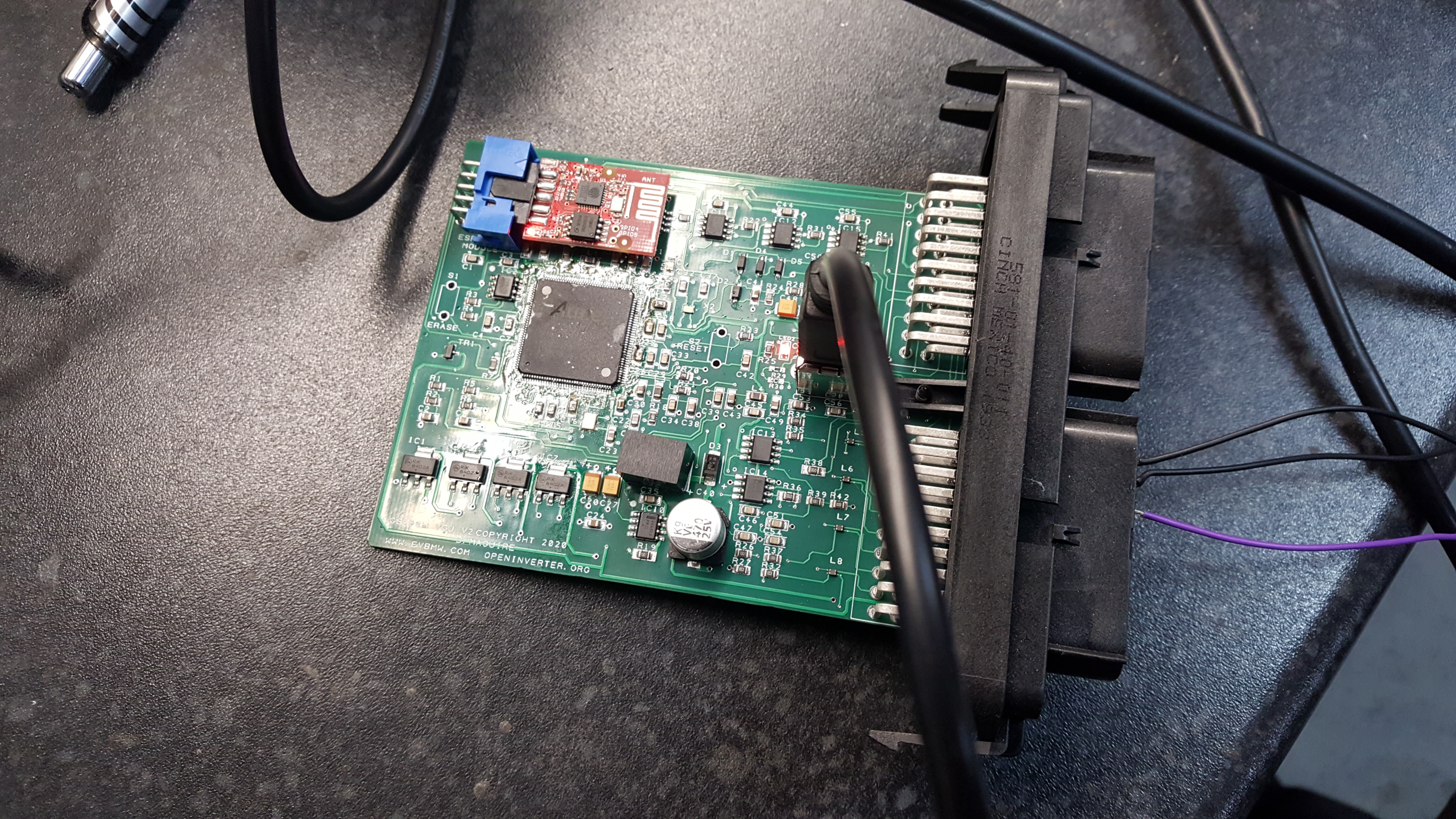

I received the V2 board yesterday (thanks JB). Main problem was that my solder paste was rock hard as i haven't used it in so long, so i had to solder the CPU on by hand.
A couple of very minor things, might save someone else a bit of time:
1) D3 the main 12V diode seems to be backwards
2) As per the video R20-R21 should be 39 Ohms, i fitted 33 and it works fine
3) D1,D4,D5 are getting quite warm, these are the protection diodes, haven't looked up the part number but am wondering are these possibly flipped.
4) The reset circuit has a cap pulling it up to 5V not a pull-up. I'd imagine this should be a pull-up resistor.
It looks good over-all, definitely use solder paste when doing the CPU

I answered a similar question to your point 4 in the Tesla Charger thread, so I already have the answer to hand! From the SAM3X8E datasheet:
Regarding point 2, these resistors are for the DFSDM and DFSDP inputs, these are for "full speed" USB, I can't see there being an issue with the slightly altered resistor values. The purpose is not explained in the datasheet (but the resistors are present in the example drawings) and I am not familiar enough with USB to comment. Though I imagine that the transfer rates for your purpose are low enough for it to not matter.
This capacitor is also present on the Arduino Due schematic (component C20).The NRSTB pin is input only and enables asynchronous reset of the SAM3X/A series when asserted low. The
NRSTB pin integrates a permanent pull-up resistor of about 15 kΩ. This allows connection of a simple push button
on the NRSTB pin as a system-user reset. In all modes, this pin will reset the chip including the Backup region
(RTC, RTT and Supply Controller). It reacts as the Power-on reset. It can be used as an external system reset
source. In harsh environments, it is recommended to add an external capacitor (10 nF) between NRSTB and
VDDBU.

All of the diodes are reversed on this build and need to be flipped.
The internal pull up must be very weak and this CAP provides additional dynamic "pull up" on the reset pin.

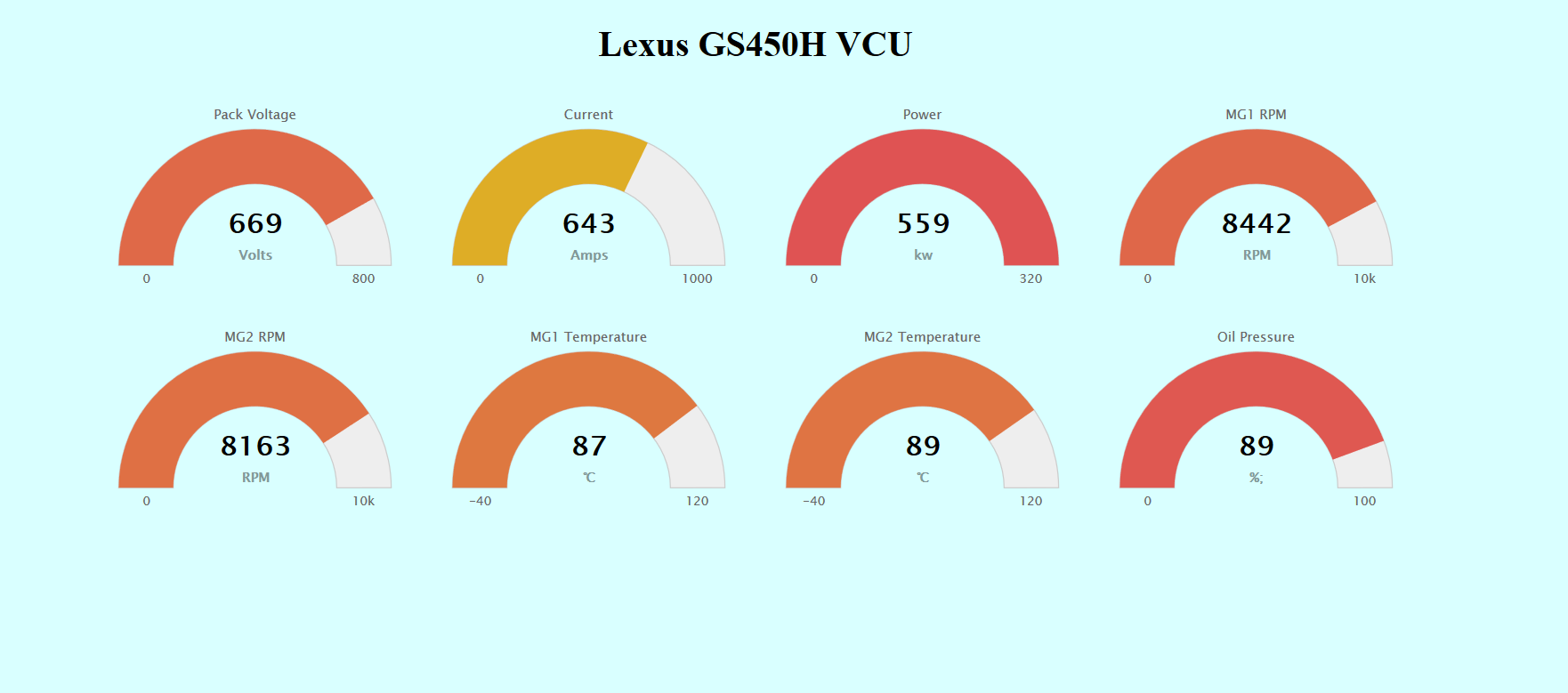

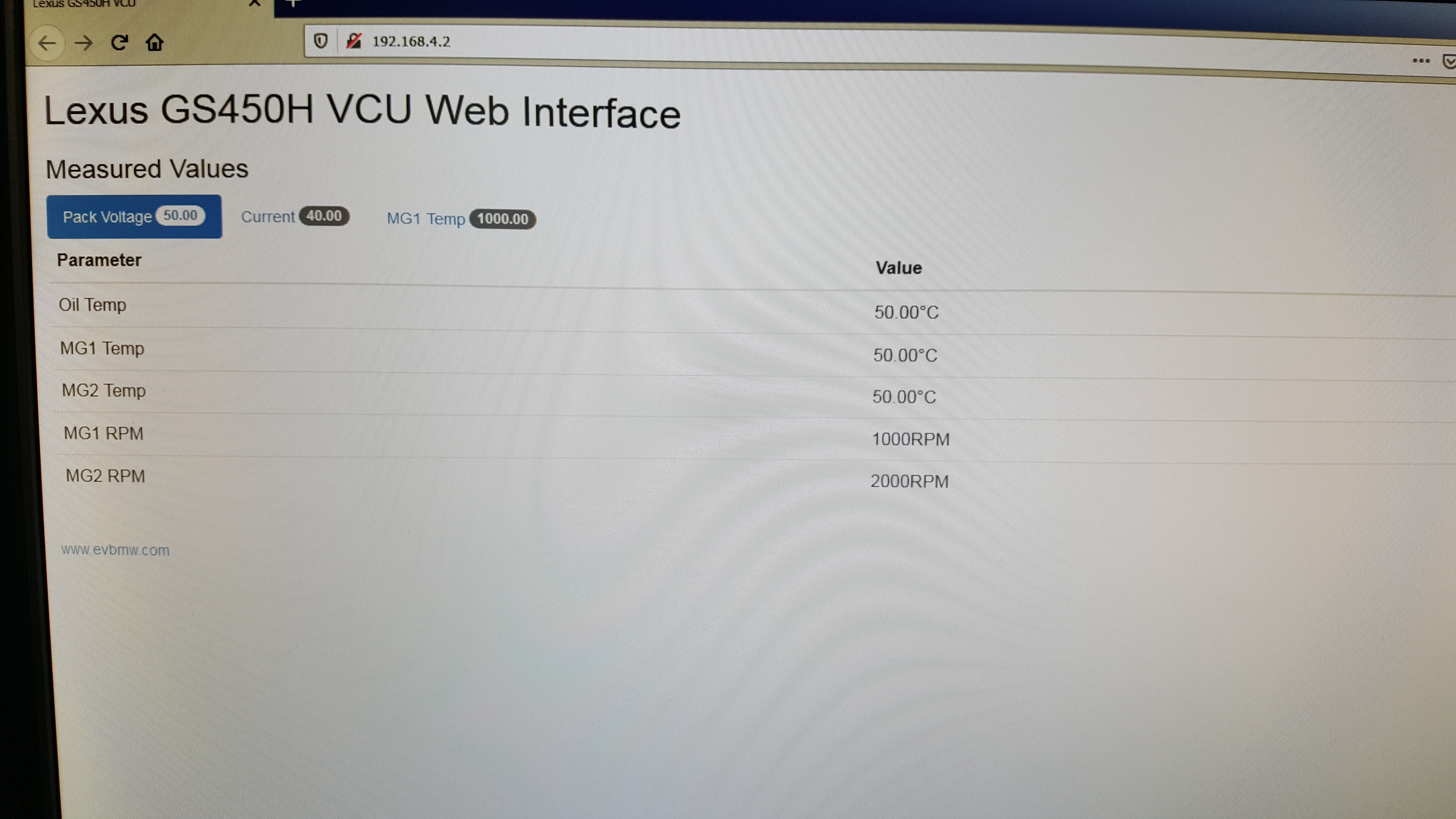

WiFi files uploaded to Github. Will require a mod to the software to pump out the required serial string on Usart 3.
xp677
- Posts: 442
- Location: UK
- Been thanked: 15 times
This is nice. Is the communication bi-directional? Can you send parameters to the VCU using the web interface?
- Posts: 4003
- Been thanked: 1125 times
What is it built on? My expertise focuses on web/UI so I don't mind lending a hand there.
Most of the work displaying data is done on the client-side using java script. The server side is an ESP8266, so as such doesn't have powerful frameworks available, it is mainly written in C/arduino wiring language.
You can review the source here:-
https://github.com/damienmaguire/Lexus- ... aster/WiFi

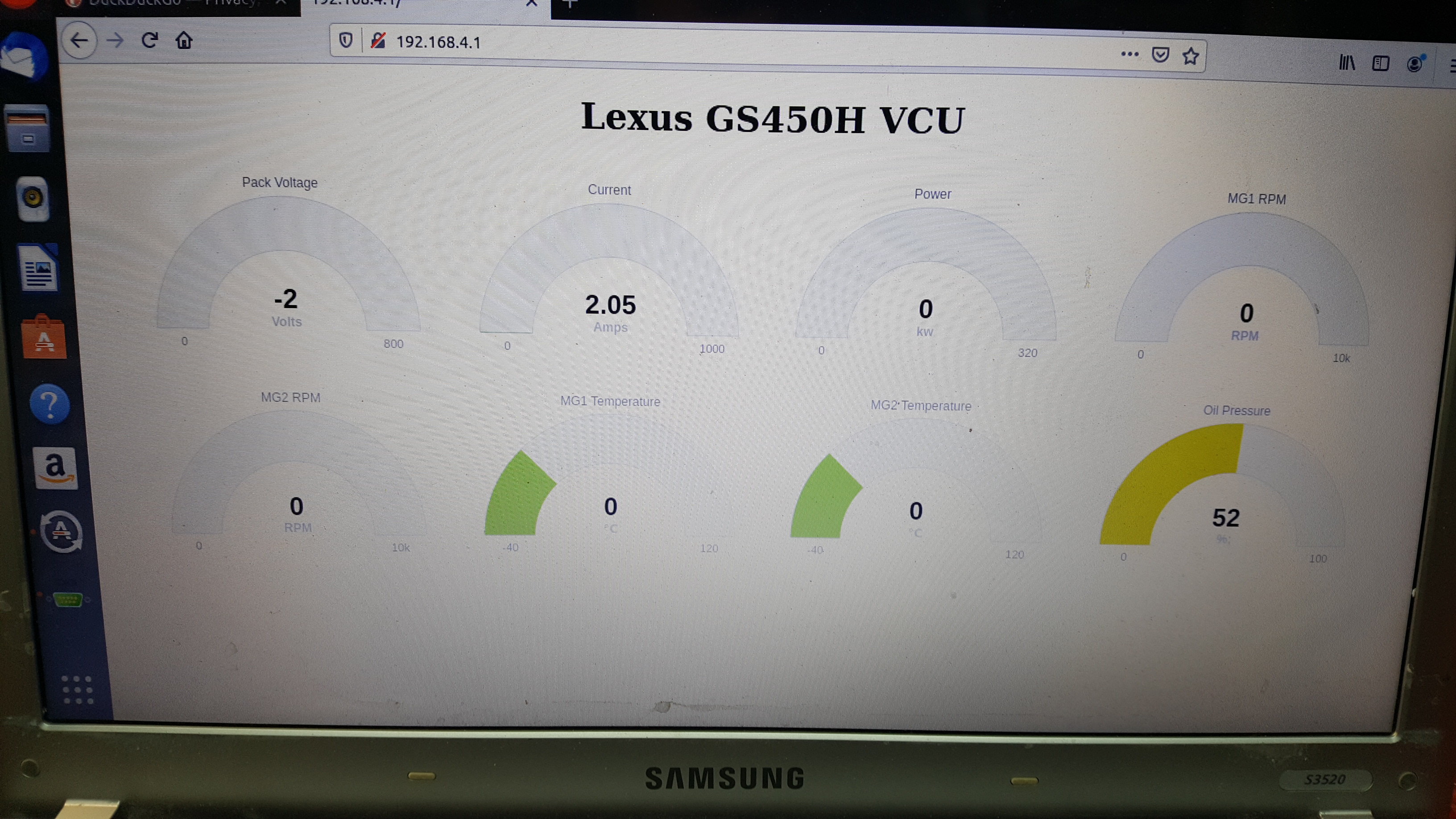

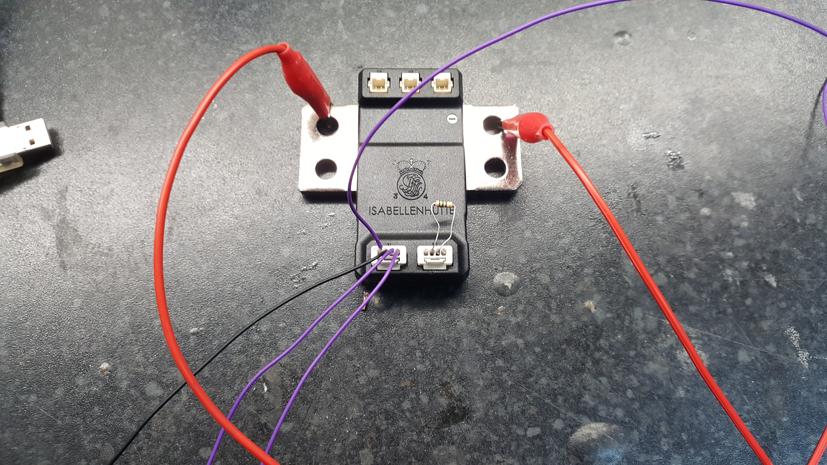

- Posts: 4003
Made some good progress with the VCU today.
WiFi interface up and running.
Integrating with ISA CAN shunt.
New software on Github.
ISA shunt datasheet attached for those interested.
Datasheet_IVT-S.pdf- (1.6 MiB) Downloaded 622 times
