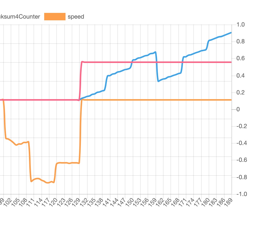

Tom DeBree has been helping with this and to sum up here what we've got so far:
Changed the code to add a counter for checksum errors and added the transferSize to a spot param (note this is data left to transfer)
So the end of this plot, we can see that the speed is working then suddenly the DMA transfer gets stuck and the checksum errors start adding up.
So Tom discovered the DMA read it set to low priority so we went full send and set it very high
I forgot to screenshot the plot for that, but the transfer size remained at 0 (this is good, all bytes transferred) and the checksum error count incremented a couple of times
We dropped to a Medium priority to match the write and the errors returned
Ive set it to High for now to see how it goes.
NOTE:
We both do not yet fully understand the impact of the priority of the DMA (direct memory acess) on the rest of the zombie functioning. Possibly due to all the features that have been rolled in, too little time is left to write the memory
The Priority of the DMA write is MEDUIM.

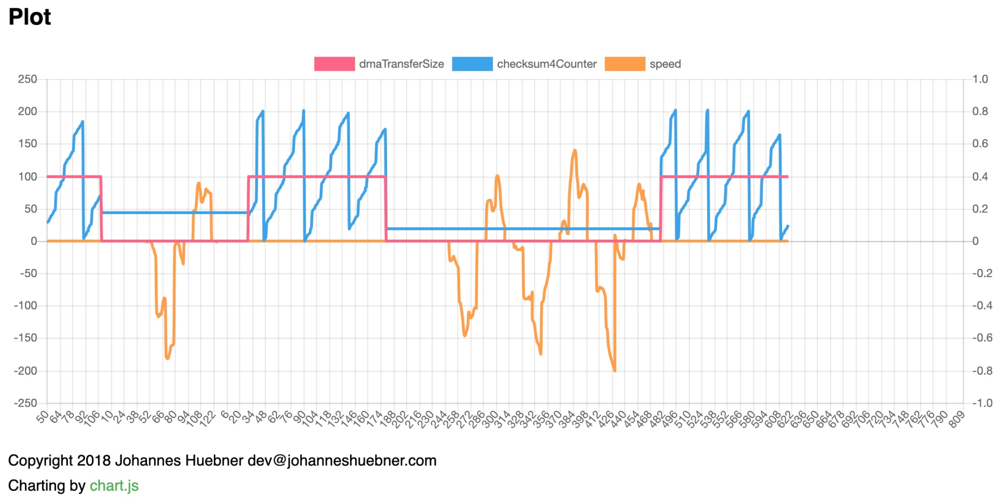

Re: GS450h RPM feedback always 0
So, this issue remains, even on very high priority.
I've done some logging (attached), when it's not working these 2 flags are set USART_SR_RXNE, USART_SR_IDLE, not currently sure why.
case 3:
transferSize = dma_get_number_of_data(DMA1, DMA_CHANNEL6);
Param::SetInt(Param::dmaTransferSize, transferSize);
Param::SetInt(Param::dmaReceiveFlags, (DMA_ISR(DMA1) & DMA_FLAGS << DMA_FLAG_OFFSET(DMA_CHANNEL6)) >> DMA_FLAG_OFFSET(DMA_CHANNEL6) );
Param::SetInt(Param::usart2Flags, USART_SR(USART2));
