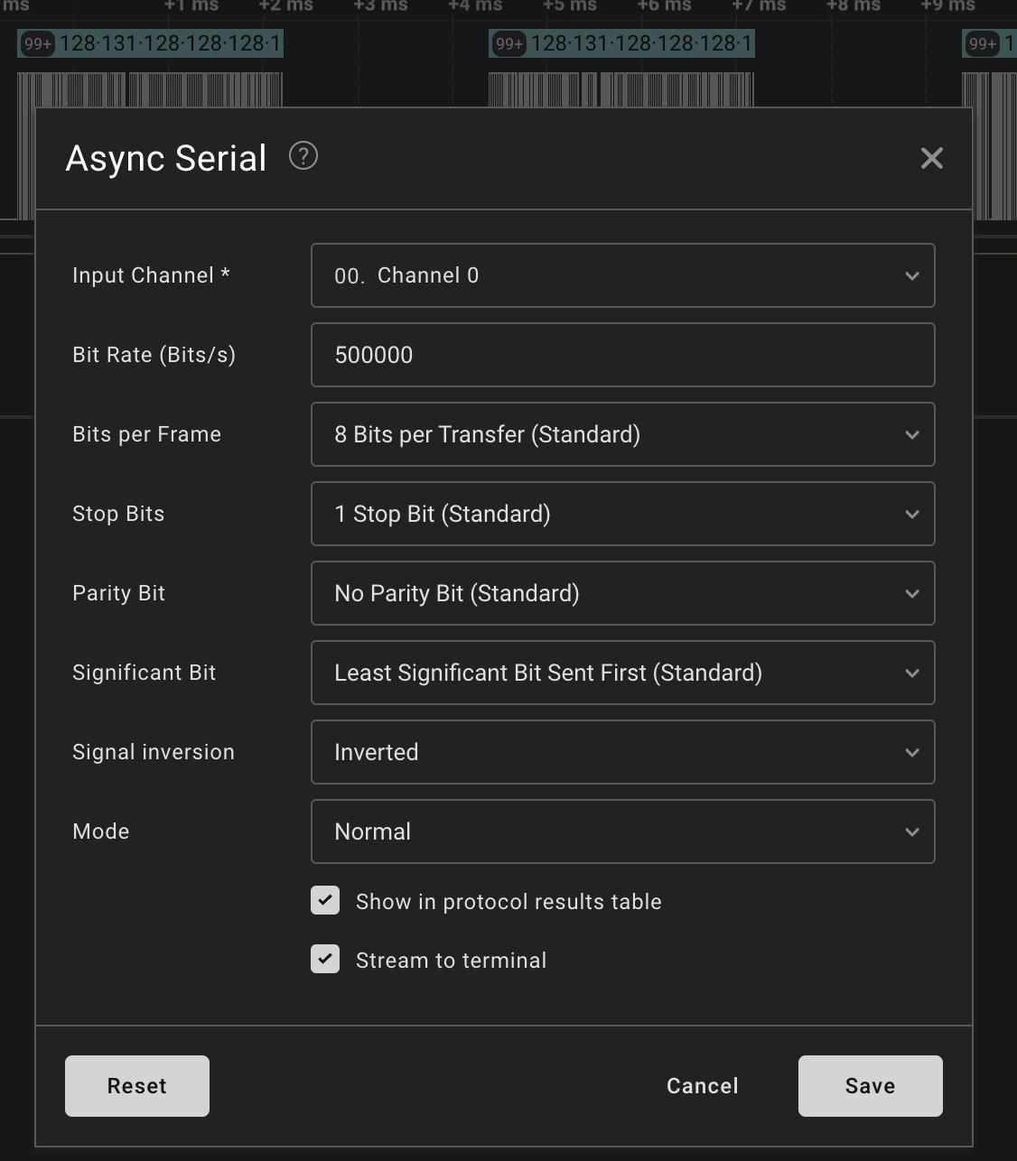

I've got the GS450h inverter/transmission setup in my BMW, with zombieverter, it's driving nice but the speed param is always 0. I added spot params for mg1 rpm and mg2 rpm and these are always 0.

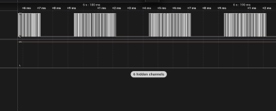

I've attached a capture from a cheap logic analyser driving back and forward a little, if anyone could take a look who knows the sync serial protocol and identify if there rpms are in there or if they're 0?

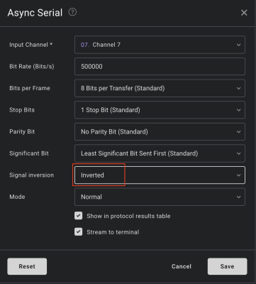

Hi Jamie

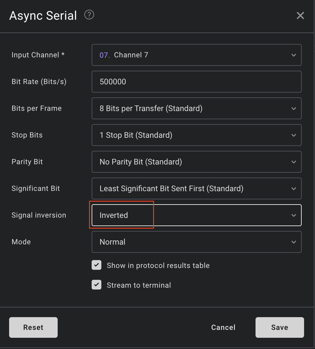

The data seems to be corrupted. With my cheap logic analyser, it only worked properly if I capture one channel at a time. MTH example below Syncserial settings:

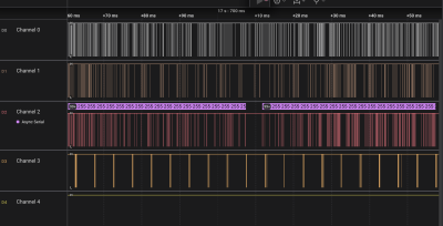

Re: GS450h RPM feedback always 0

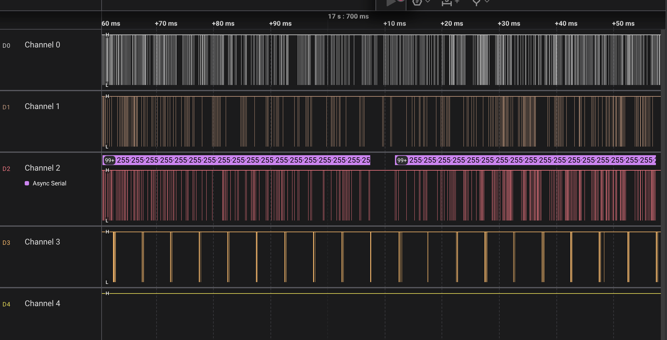

Are these any better?
- Posts: 1774
- Has thanked: 82 times
- Been thanked: 424 times
And separate

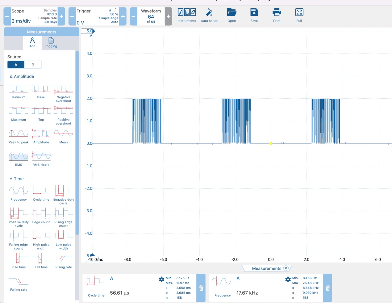

My picoscope captures look better

Still not looking good.
Do you connect MTH- to ground and MTH+ to channel 0 when capturing the data on the analyser?
Nope, I had ground to ground and mth+ to channel 0

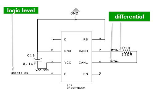

Found this thread,
viewtopic.php?t=205
where they explain the physical layer. One conclusion is to use a CAN transceiver to convert the differential signals to logic level. Then we have 500kBaud async serial with the usual start-data-stop, which should be decodable with the Saleae software.
viewtopic.php?t=205

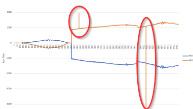

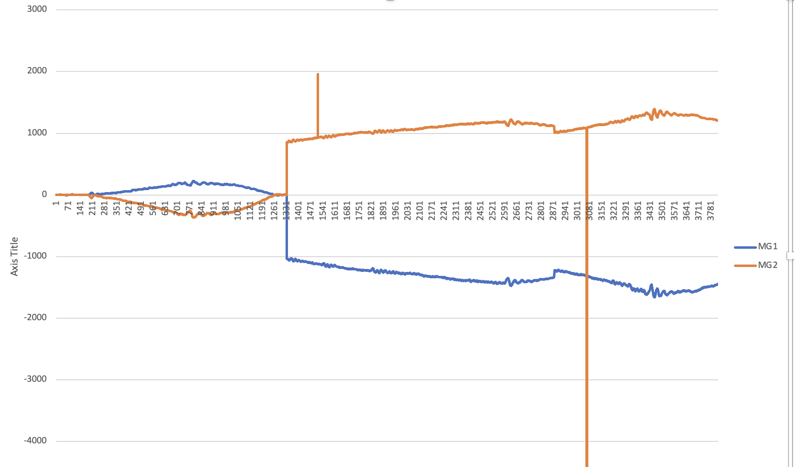

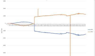

Is that spreadsheet using my data?
That seems to be working mostly, the bus voltage is about x2 what it should be

I've getting my invudc to be 117V in Zombie, which is around 1/3 of the value :S

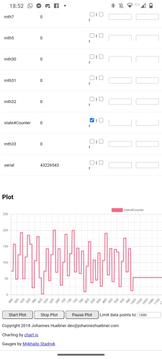

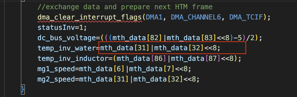

So it seems I have some sort of comms issue.

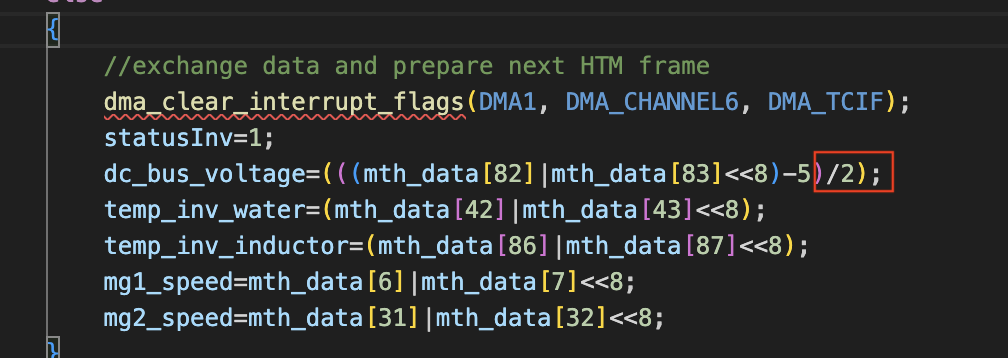

I've added a counter in as below
counter seems to work until I engage drive or reverse. The Sync serial lines wires are the OEM harness and not extended. Ive depinned them from zombie and checked the crimps. Checked the inverter grounding.
if(VerifyMTHChecksum(100)==0 || dma_get_interrupt_flag(DMA1, DMA_CHANNEL6, DMA_TCIF)==0)
statusInv=0;
else
//exchange data and prepare next HTM frame
dma_clear_interrupt_flags(DMA1, DMA_CHANNEL6, DMA_TCIF);
statusInv=1;
dc_bus_voltage=(((mth_data[82]|mth_data[83]<<8)-5)/2);
temp_inv_water=(mth_data[42]|mth_data[43]<<8);
temp_inv_inductor=(mth_data[86]|mth_data[87]<<8);
mg1_speed=mth_data[6]|mth_data[7]<<8;
mg2_speed=mth_data[31]|mth_data[32]<<8;
Param::SetInt(Param::mth6, mth_data[6]);
Param::SetInt(Param::mth7, mth_data[7]);
Param::SetInt(Param::mth5, mth_data[5]);
Param::SetInt(Param::mth30, mth_data[30]);
Param::SetInt(Param::mth31, mth_data[31]);
Param::SetInt(Param::mth32, mth_data[32]);
Param::SetInt(Param::mth33, mth_data[33]);
Param::SetInt(Param::state4Counter, counter);
if(counter>200)
counter = 0;
else
counter++;

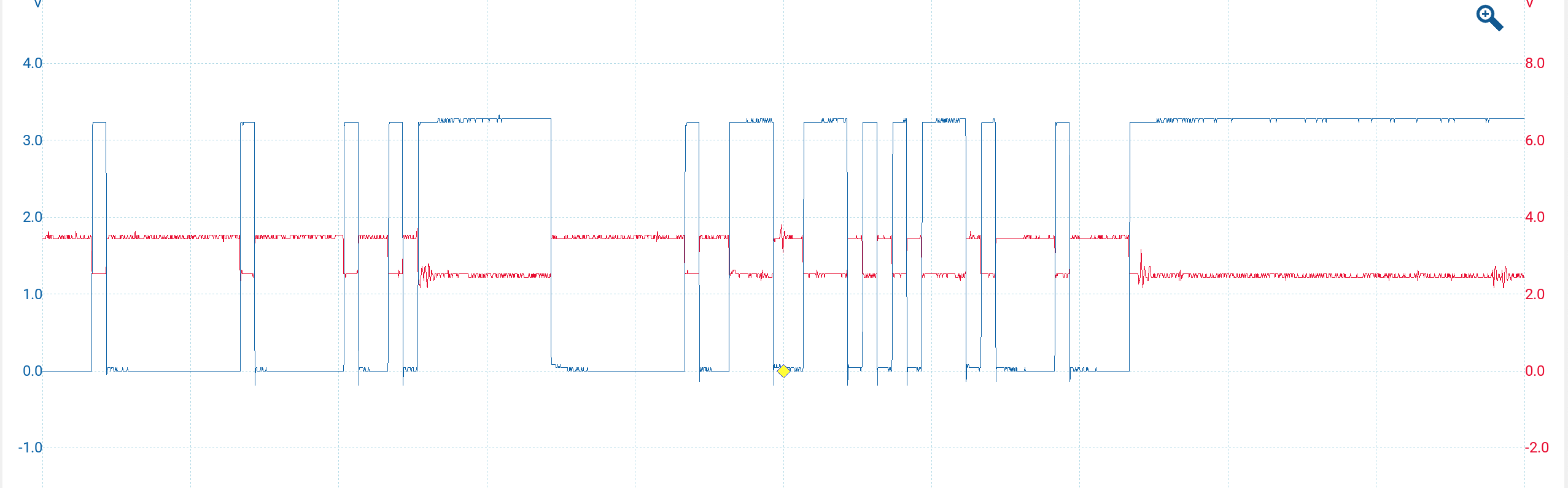

To understand what is happening on physical layer I propose to do the following measurements:
1. With osci ground connected to the VCU ground, measure the MTH+ and MTH-, using two osci channels. These should show zero difference in "recessive" mode (most of the time), and a clean difference during the "active" time. The above shown picture contains spikes which should not be there. 2. With osci ground connected to the VCU ground, measure inside the VCU what the receiver IC made from the differential signal. From the schematic https://github.com/damienmaguire/Stm32- ... ematic.pdf we see that a CAN transceiver is used to convert the differential signal coming on MTH+ and MTH-, to a logic level signal. The logic level side should show the clean serial signal. Another question is regarding the message validity check. Does the VCU check the CRC of the incoming data, or does it just report what it got, even if it is garbage?

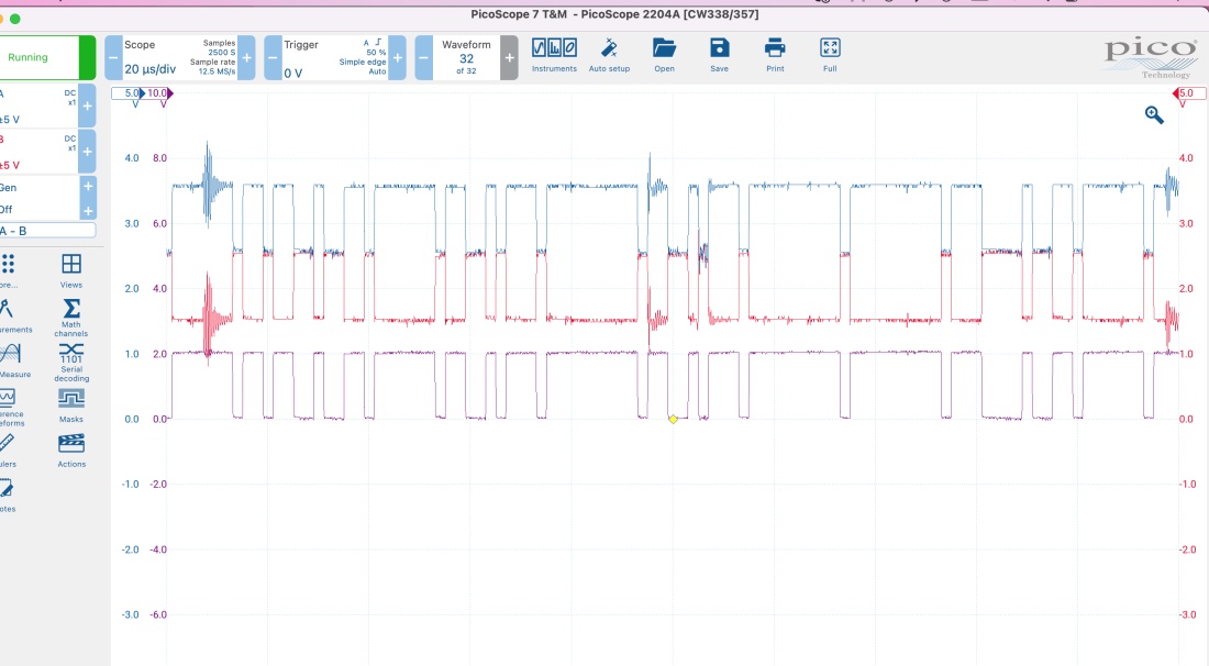

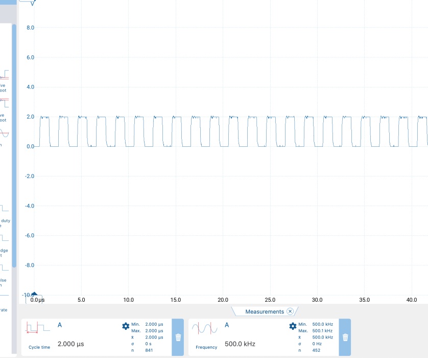

This is the MTH pairs with a 3rd calculated channel of B-A which seems to do a good job of eliminating the noise.

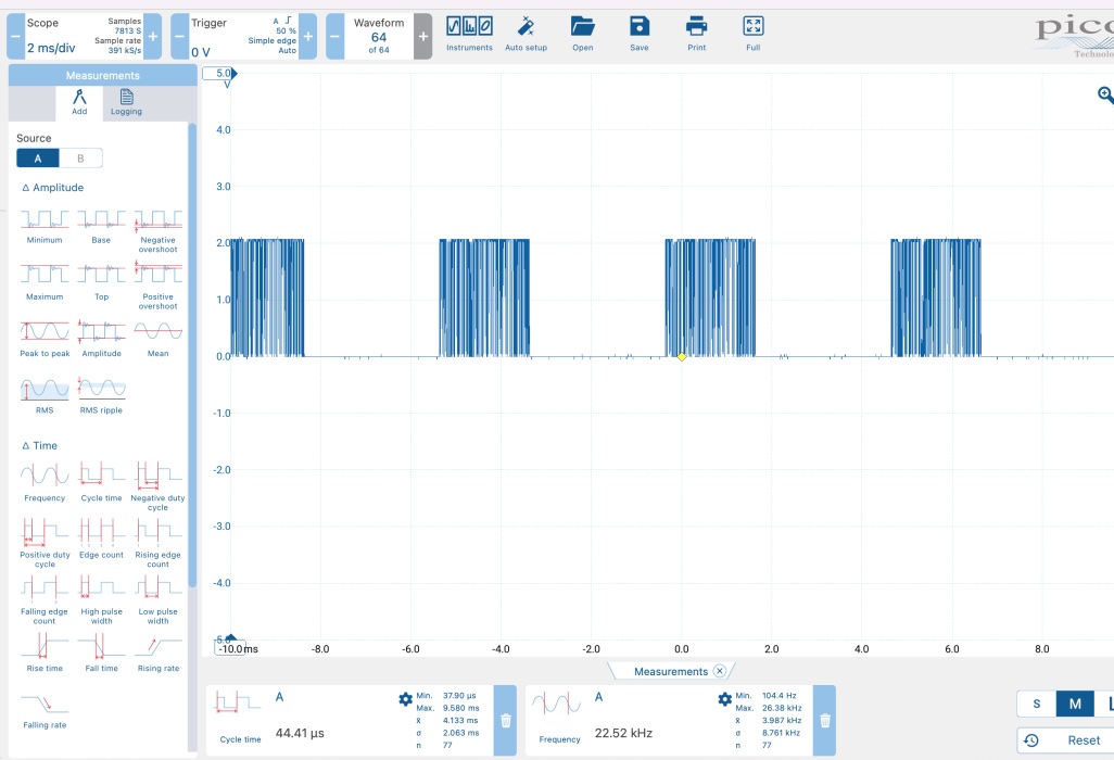

And attached scope to the RX and CAN of the IC
- RX and HTM+.psdata.zip
- (76.97 KiB) Downloaded 143 times
- uhi22
- Posts: 1117
- Has thanked: 206 times
- Been thanked: 617 times
Indeed, the difference and the digital level looks quite good.
Indeed, there is a checksum verification, and the code behind makes sense. Even there is a small chance, that totally corrupted data still has the right checksum, I would draw the conclusion: If the checksum is correct, then the data packet is valid. For me this looks like that the data format, which was found by reverse-engineering, is not always used. Maybe your GS450 uses a different format as soon as you are in drive or reverse. So basically starting from scratch, record the MTH data with a logic analyzer while changing the RPM and the voltage, and find which bytes are changing and what is the scaling. Maybe there is a "format identifier" at the beginning of the MTH data, which selects different message layouts.
