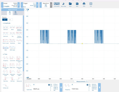

The data seems to be corrupted.
With my cheap logic analyser, it only worked properly if I capture one channel at a time. MTH example below
Syncserial settings:

My picoscope captures look better
PicoCaps.zip
(605.51 KiB) Downloaded 200 times

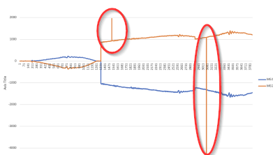

20240630_forJamie.xlsx
(16.64 MiB) Downloaded 224 times

To test if the speed is coming into the ZombieVerter correctly, try and write it to the temperature

Re: GS450h RPM feedback always 0
Is that spreadsheet using my data?
That seems to be working mostly, the bus voltage is about x2 what it should be
Zechy
Posts: 64
Joined: Sat Apr 30, 2022 1:10 am
Location: Australia
Has thanked: 47 times
Been thanked: 38 times
Post by Zechy »
Bigpie wrote: Sun Jun 30, 2024 2:05 pm Is that spreadsheet using my data?
Yes that's your data.
Bus voltage gets divided by 2

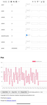

Posts: 1884
Has thanked: 91 times
Been thanked: 517 times
So it seems I have some sort of comms issue.
I've added a counter in as below
     if(VerifyMTHChecksum(100)==0 || dma_get_interrupt_flag(DMA1, DMA_CHANNEL6, DMA_TCIF)==0)
            statusInv=0;
        else
            //exchange data and prepare next HTM frame
            dma_clear_interrupt_flags(DMA1, DMA_CHANNEL6, DMA_TCIF);
            statusInv=1;
            dc_bus_voltage=(((mth_data[82]|mth_data[83]<<8)-5)/2);
            temp_inv_water=(mth_data[42]|mth_data[43]<<8);
            temp_inv_inductor=(mth_data[86]|mth_data[87]<<8);
            mg1_speed=mth_data[6]|mth_data[7]<<8;
            mg2_speed=mth_data[31]|mth_data[32]<<8;
            Param::SetInt(Param::mth6, mth_data[6]);
            Param::SetInt(Param::mth7, mth_data[7]);
            Param::SetInt(Param::mth5, mth_data[5]);
            Param::SetInt(Param::mth30, mth_data[30]);
            Param::SetInt(Param::mth31, mth_data[31]);
            Param::SetInt(Param::mth32, mth_data[32]);
            Param::SetInt(Param::mth33, mth_data[33]);
            Param::SetInt(Param::state4Counter, counter);
            if(counter>200)
                counter = 0;
            else
                counter++;
counter seems to work until I engage drive or reverse. The Sync serial lines wires are the OEM harness and not extended. Ive depinned them from zombie and checked the crimps. Checked the inverter grounding.

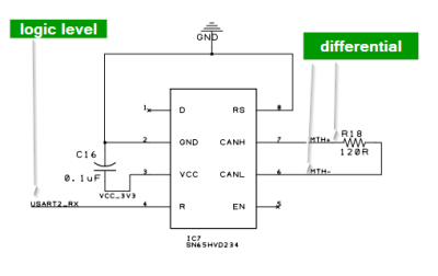

To collect the things together I added some links to the different threads here: https://openinverter.org/wiki/Toyota_In ... a_Protocol
To understand what is happening on physical layer I propose to do the following measurements:
1. With osci ground connected to the VCU ground, measure the MTH+ and MTH-, using two osci channels. These should show zero difference in "recessive" mode (most of the time), and a clean difference during the "active" time. The above shown picture contains spikes which should not be there.
2. With osci ground connected to the VCU ground, measure inside the VCU what the receiver IC made from the differential signal. From the schematic https://github.com/damienmaguire/Stm32- ... ematic.pdf we see that a CAN transceiver is used to convert the differential signal coming on MTH+ and MTH-, to a logic level signal. The logic level side should show the clean serial signal.

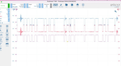

This is the MTH pairs with a 3rd calculated channel of B-A which seems to do a good job of eliminating the noise.
Zoomed.psdata.zip
(119.47 KiB) Downloaded 204 times

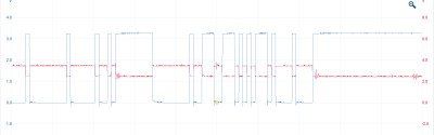

Posts: 1884
And attached scope to the RX and CAN of the IC
RX and HTM+.psdata.zip
(76.97 KiB) Downloaded 201 times
uhi22
Posts: 1244
Location: Ingolstadt/Germany
Has thanked: 245 times
Been thanked: 684 times
Post by uhi22 »
Indeed, the difference and the digital level looks quite good.
