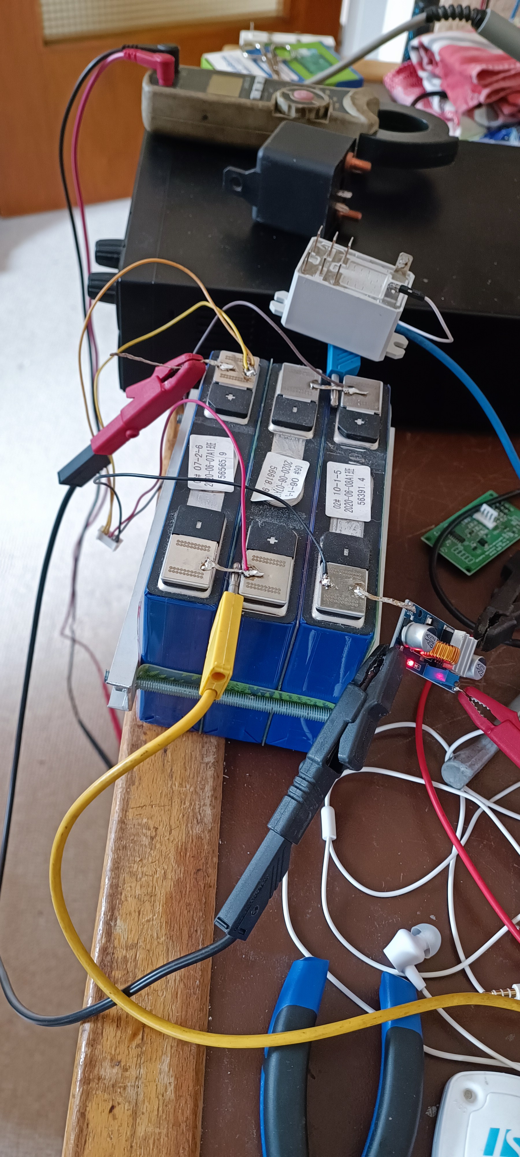

Rigged up a first cut of my hopefully next 12V battery.
Those a 60 Ah NMC cells weighing about 1 kg each. I put some plastic in between them because you shouldn't trust that thin protection foil for electrical isolation.
Currently charging it with a cheesy "2A" buck converter that works also at 7A, at least for now :o When it overheats it turns off for a moment and resumes after a few seconds. Also found it delivers voltage via a diode in reverse direction, so could hook it up just like that. Of course in reality I will use a beefier buck converter.
Will also run an old 4-channel BMS and simply have it switch off a FET when voltage gets too low or high. So this should only deliver standby load, power the 12V systems for a brief moment and then the DC/DC should take over as quickly as possible.

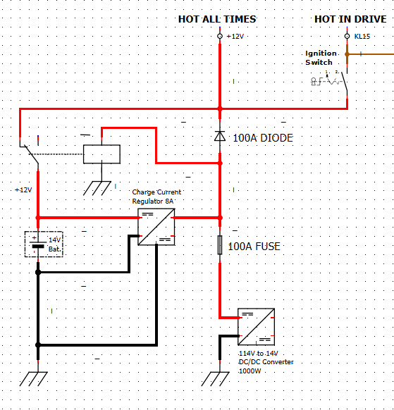

I do have a similar challenge with the weight as DVD3000 and had nearly the same idea as muehlpower to use a battery from the supplier in his link. But I do like the smaller 24Ah batterie much more. https://www.autobatterienbilliger.de/Ac ... gsbatterie You think that's not enough? It looks like we all got the 12V DC/DC converter with 1000W. Plenty of power for any driving situation, or not? The 12V battery would be never used as long as the converter is powering and that's always when the HV battery is active.
Yes, we still need some power when the HV battery is off:
- BMS: checks the state and waits for control signals from 12V key_in or Charger
- Battery: Water cooling pump/fan
- Hazards and position lights: the requirements for an emergency situation and from the TÜV. The duration is not defined.
What's your estimate? 50W for all above? 70W to be safe (charge the phone, listen to the news)? The datasheet lists an operation time of 240 minutes with this load. Is that enough? Does it fullfill the requirements? OK, you can always got for the larger one.
Let me hear your opinion, please.
But both batteries have the same problem that the available maximum charge current with the DC/DC converter is much higher than specified. Let me provocate a bit, please:
Idea 1: Switch it off during DC/DC converter operation.
My 3.3kW charger (Elcon/TCCharger) has a separate 12V/5A output, plenty enough to charge the 12V battery when the 26.5 kWh HV battery is charged from 20% to 80%, let's say for about 5 hours.
If it's just 12V, it's not sufficient to charge a LFP that needs 14.6V for a full charge!
Idea 2: Separate the 12V Battery from the 12V electrical system
A simple Diode could do the job and same as in Idea 1, the charger will recharge the battery because it will be connected behind the Diode.
Idea 3: Use a separate DC/DC Charger
The Orion-Tr Smart DC-DC Charger Isolated https://www.victronenergy.com/dc-dc-con ... n-tr-smart has plenty of options to deal with 1 or 2 batteries. But it puts another load of 1.8 kg into your car.
Update: Another DC/DC charger, much lighter and cheaper: https://daygreen.com/en-en/products/12v ... s=e&_v=1.0
More ideas? Let's discuss them! For reference: The 12V LiFePo4 battery of an actual Tesla Model 3/Y has 6.9Ah.

Actually I'm up to version 3 of my setup with an 24Ah LFP and a separate charge regulator. Diode and Relay contact changed a lot...
The 12V LFP battery is charged whenever the main DC-DC provides energy and it does only supply the car when it does not.
Actually this solution needs more components than expected. Maybe there is a better way, but this one is tested under all conditions.
Best regards
Frank
