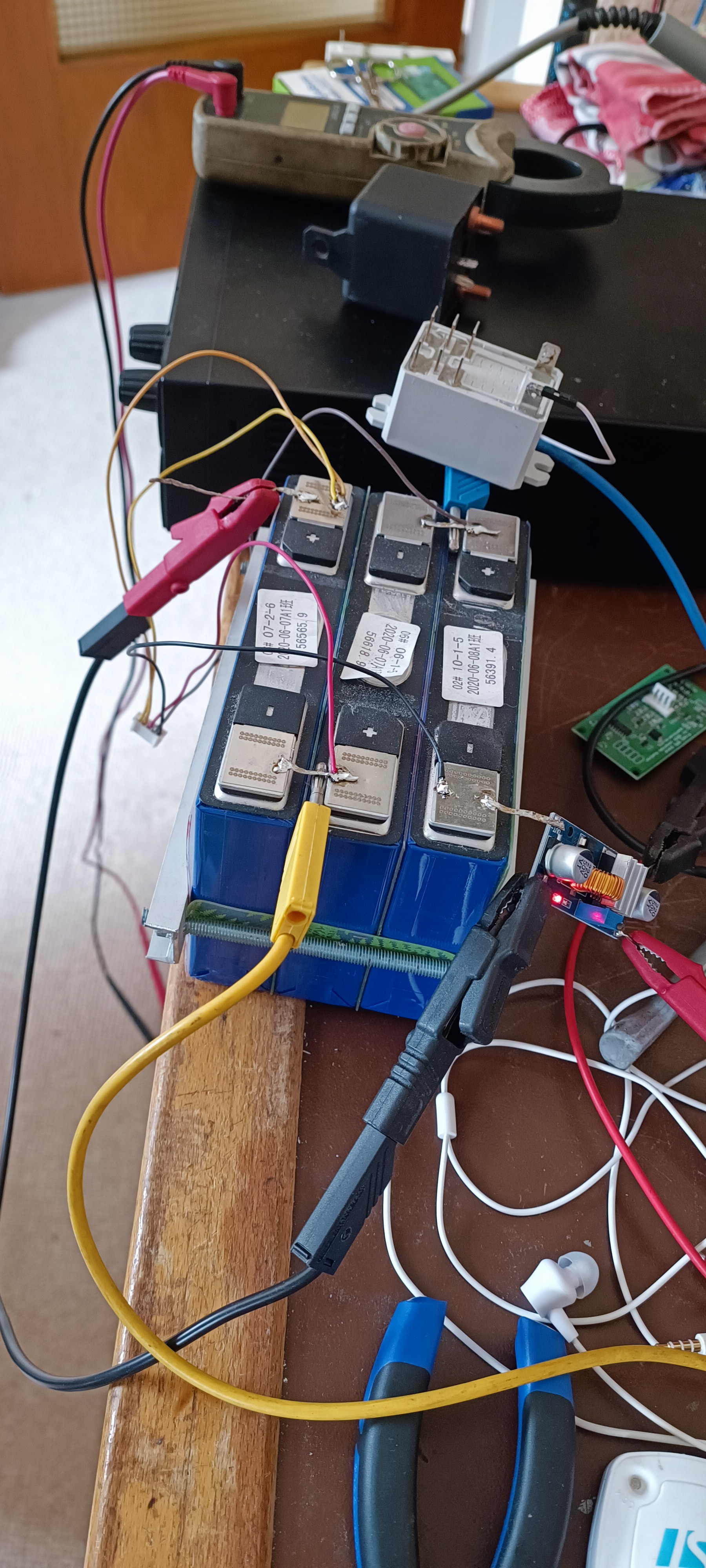

Your question has also brought the topic back into focus for me. I am planning to use a LiFePo battery for the 12V. Approx. 42Ah, so that I have enough power for the radio etc. when the car is stationary. Batteries designed for storage applications are cheap to buy. These, for example https://www.autobatterienbilliger.de/Ac ... uerbefreit . I think you have to make sure that the charging current is not too high, which can happen with an empty battery and a powerful DCDC converter. A voltage limit of 14V will not be sufficient. My idea is to measure the current flowing into the battery and if necessary regulate the DCDC converter down.
The charging current for this battery is limited to 42A. If you are using a smaller battery, it will certainly be less.

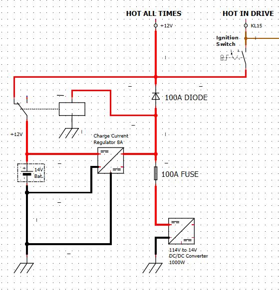

The DCDC should be able to supply all loads without the help of the 12V battery

As johu noted, the DCDC converter should be sized to cover the current requirements of all connected devices when they are all running at the same time. In my experience from the 70s, 45A alternators were the lower limit for simple cars. This corresponds to approx. 600W. The DCDC converter that Fellton sells has 1000W, so it is sufficient if there is no 12V/1000W electrical heating. Nevertheless, the 72A can be too much for a LiFePo battery, which is available when no devices are switched on, e.g. daytime, summer, sunshine. How do you deal with this?

If I understood your initial question correctly, the idea is to replace the heavy lead-acid battery with something lighter, e.g. a lithium battery. Lead or lithium must be charged, for this you need a DCDC converter, the size of which is defined by your consumers. With lead it is simple. You take a DCDC converter with e.g. 1000W or 2000W and regulate it to approx. 14V. That's it. Because a lead-acid battery is insensitive when it is charged with a high current. 2000W corresponds to 140A. If a LiFePo is charged with too much current, it can be damaged. And because of the low internal resistance, high currents occur at low cell voltages, up to the limit of the DCDC converter. In my opinion, this must be prevented. Perhaps one of the gurus will comment on the subject
Translated with DeepL.com (free version)

Yes I use a large lead acid too, so far. Highest charging current I ever saw was 50 A.
Using LFP in the A2 conversion. Never checked what would happen if the cells are low. It is very unlikely as the car draws near 0 standby current and the battery is kept at 14V during driving and charging. There is no accessory mode in that car.
Like said with NMC I would use a buck converter with current limit. Maybe a power tool battery with low voltage cutoff

With a 12V battery, the BMS only distributes the current evenly to the individual cells in the mA range. I have not yet seen a limitation of the total charging current. Even with the HV battery, the BMS does not limit itself, but passes the information on to the charger and opens the contactors in an emergency if the charger is still sending too much.
Has anyone tried removing the 12V battery and replacing it with a second, small DCDC converter that is permanently connected to the HV battery? The converter would only have to be large enough to close the contactors and operate the hazard warning lights, as required by the TÜV. Approx. 120W like this one https://www.fortec-power.de/Mean-Well-W ... AC-12V-10A or this https://www.fortec-power.de/Mean-Well-L ... -12V-12.5A
I know it's for AC, but in my tests they all worked with DC as well.
