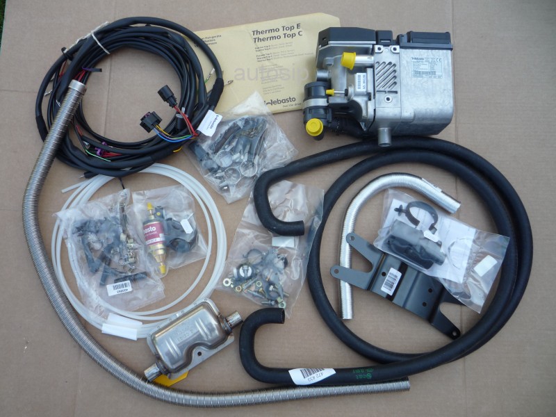

snelly
Posts: 74
Joined: Sun Dec 26, 2021 11:54 am
Been thanked: 11 times
Re: Question about 12 Volt "starter" Battery (Please move if incorrect)
Post by snelly »
Hi
I run a 12V Webasto diesel engine block cooling system heater to heat cab and warm battery's and it runs of home heating oil too.
it only use a about 1 Amp when its running
You could use the cabin heater type that is just hot air
my jeep is 750kg and uses the small Japanese car battery "UK 055 Car Battery - 12V 35Ah - HONDA TOYOTA NISSAN SUZUKI" about 6kg
DVD3500
Posts: 47
Joined: Mon Feb 13, 2023 12:53 pm
Has thanked: 58 times
Post by DVD3500 »
The battery sounds interesting!
I have been looking at some sort of fuel-based heating too but am trying to keep the car as emissions free as possible or at the least using some sort of renewable fuel like alcohol.
My other concern is where to keep the fuel. The German TÜV likely has very strong feelings about that. I am pretty sure I read a rule that it cannot be kept in the cabin and cannot be in the extremities of the vehicle.
The other problem is the most common configuration for these "Sports Six" Triumphs (The Spitfire is based off the Herald, which also begat the Vittesse and the GT6 is based on the Spitfire) is you replace the ICE with an electric motor and pile as many HV batteries as you can on top. The hood/bonnet opens like a clamshell including the fenders/wings. That means that there is not a lot of room for other items. The spot behind the seats where the fuel tank was is then filled with chargers and and if you have space and weight allows it; batteries. So not much space there as well...
Posts: 6735
Has thanked: 378 times
Been thanked: 1559 times
I think the days of Diesel heaters are over with todays battery prices. Who wants that smell back?
