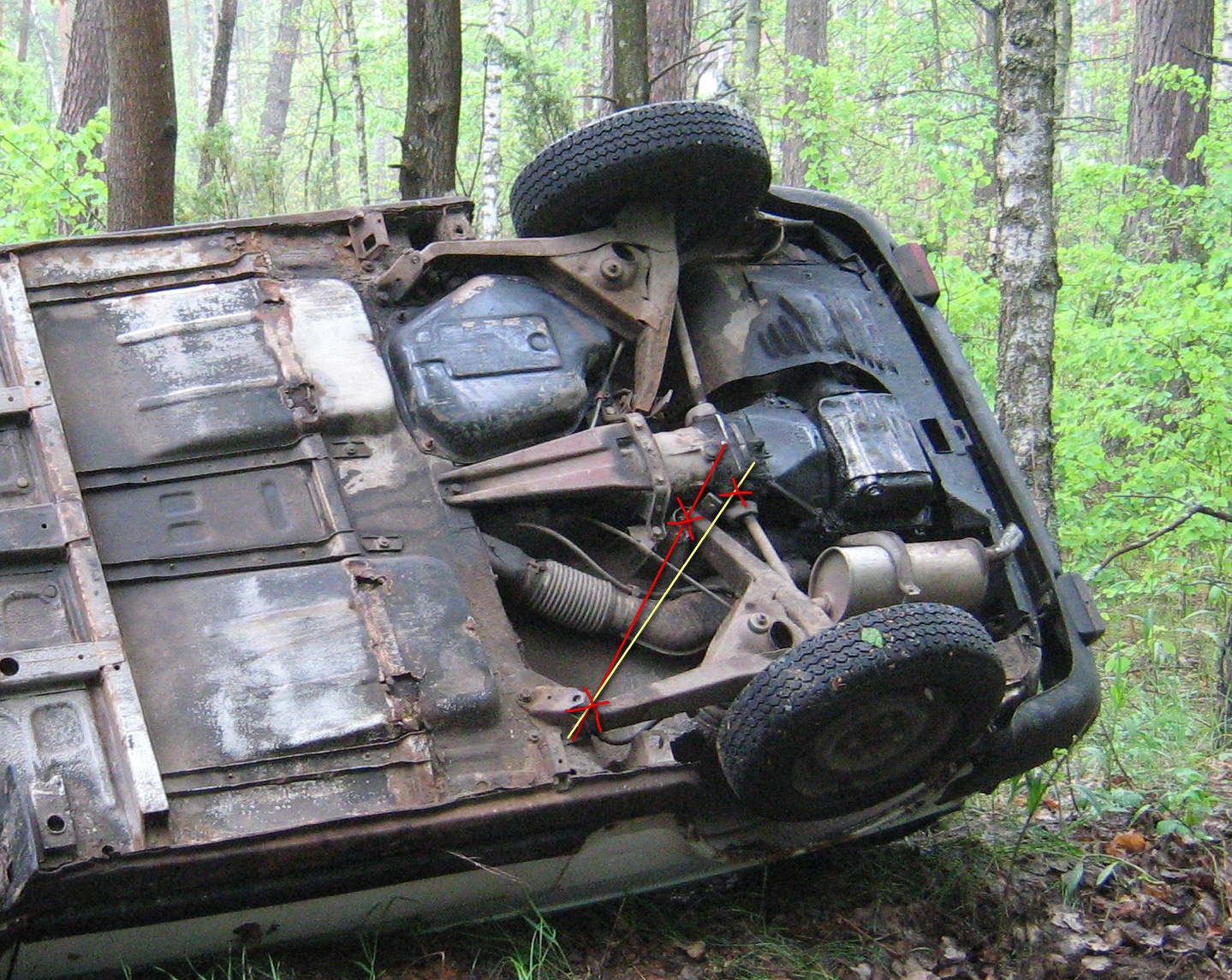

sfk wrote: Tue Mar 24, 2020 12:35 am Well you could mount it facing forward and with correct axle angle then chop out the rear floor to make it fit...
As far as I can see the floor isn't an issue, but mounts for trailing arms are. As an option, it might be feasible to widen the track, but it is cutting/welding and I believe it is not an option in this case, or is it?

Keep in mind that that rubber bushing lives only because axis of trailing arm is close to point where axle goes into gearbox. If you replace gearbox with wider one, or install double wisbone suspension, that bushing will die instantly. Any change must be done with CV joint instalation.

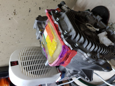

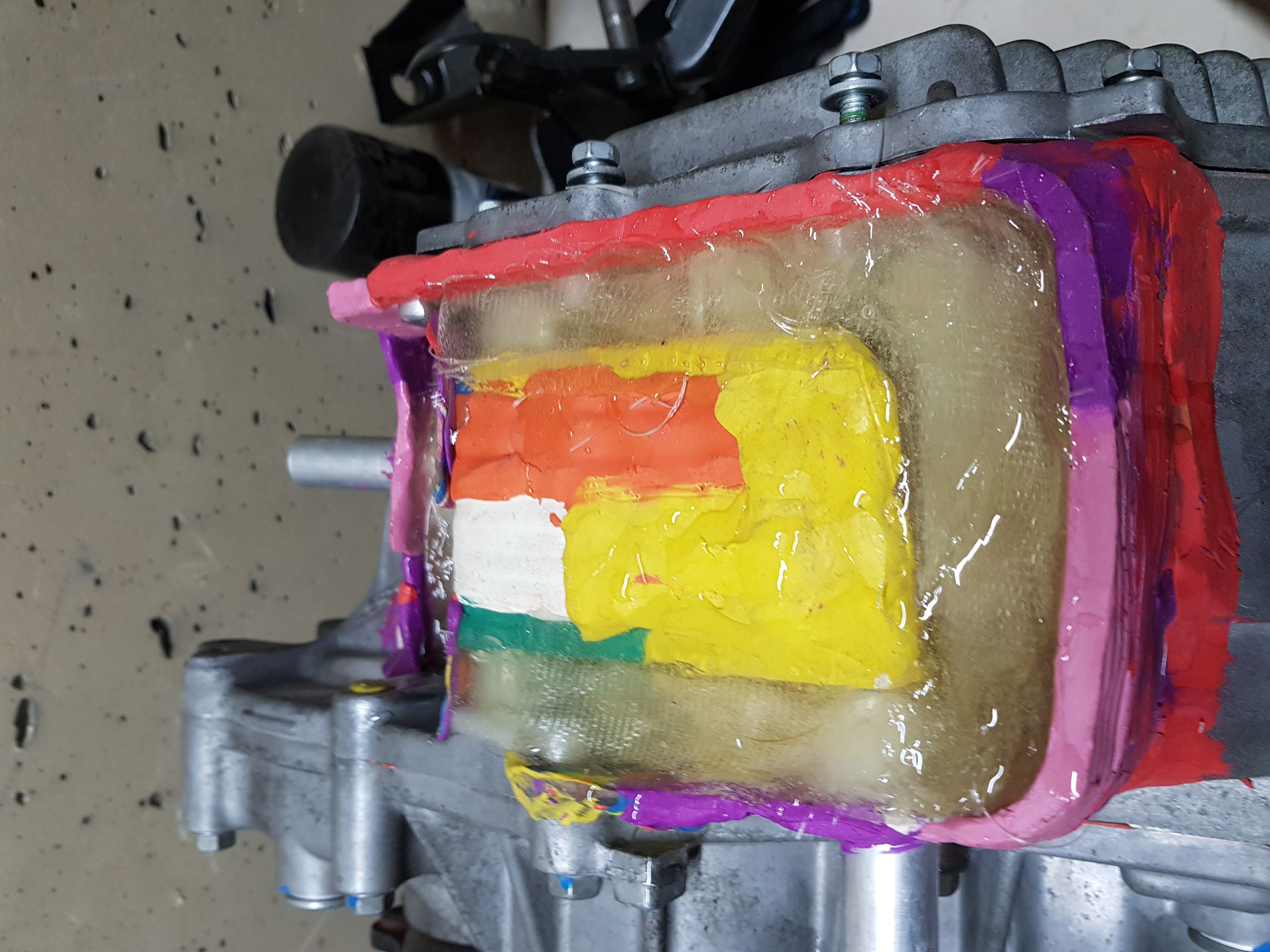

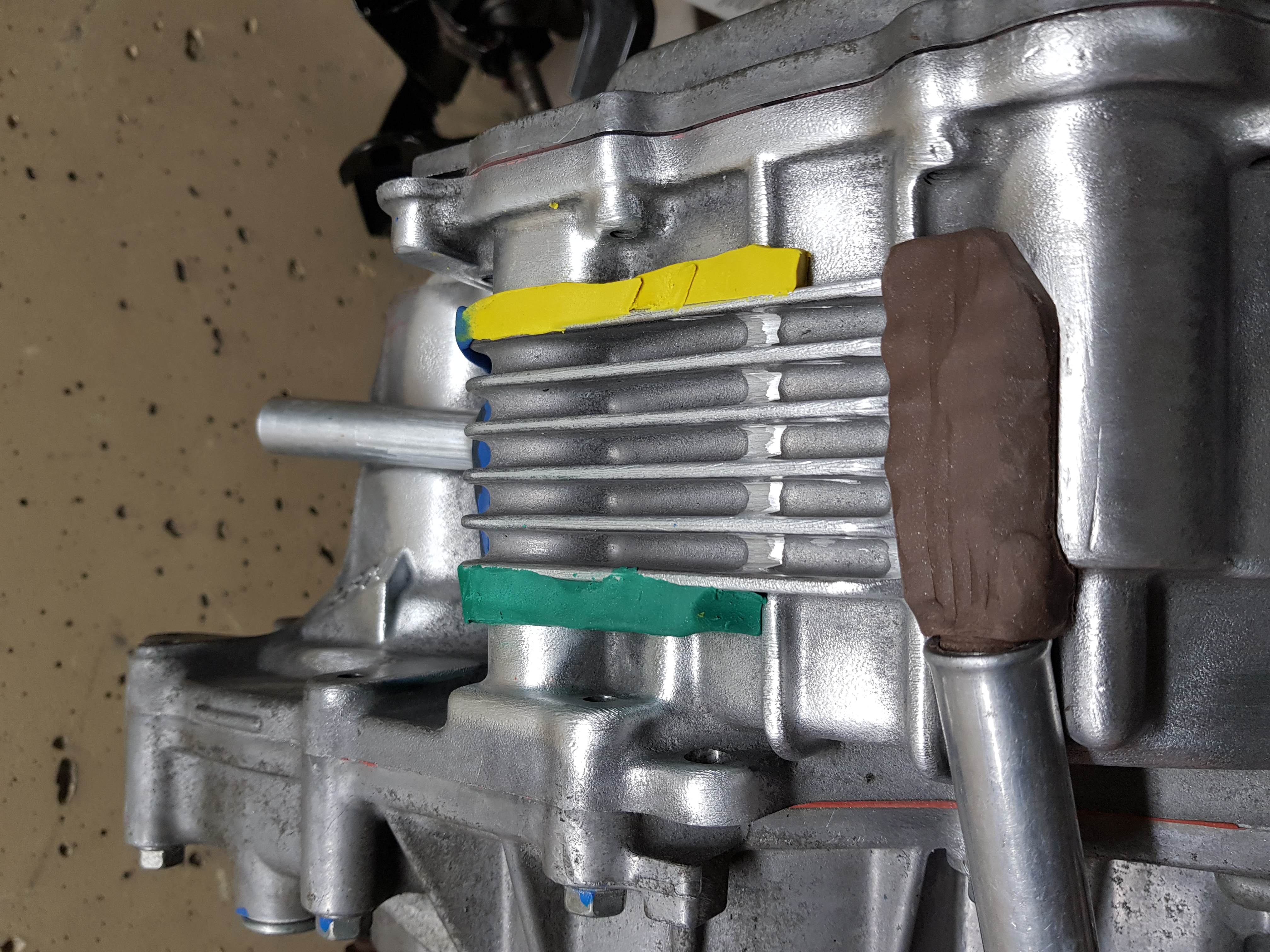

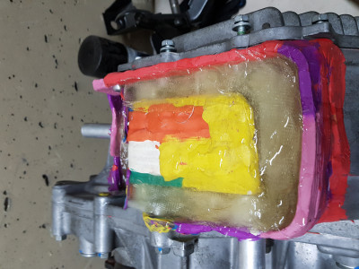

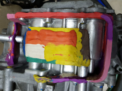

I think Toyota engineers are done it for us :) . As you can see o the MGR exist cooling ribs. On the top, where oil capture chamber, bottom where oil flows down by gravity and motor cap where we have heat from stator and oil comes from rotor shaft bearing lubrication.
I think about additional cooling MGR and make heat absorber for a liquid cooling in bottom from fiberglass and epoxy. See a photos.
Material for a forming:
Inlet/outlet tubes:
Walls forming:
Epoxying:
After removing a forming and sanding, close by aluminum plate with a screws:

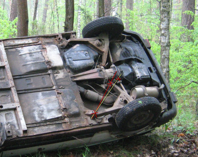

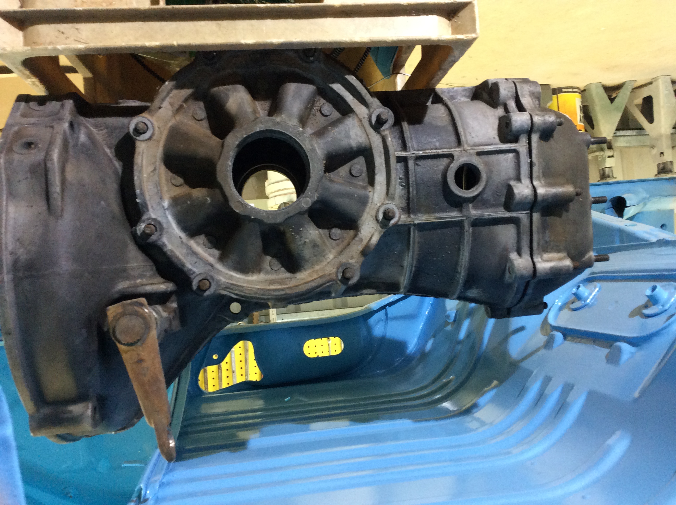

Hi, I’m new here and not quite ready to start my own thread. I have a 72 super beetle in pieces and I’m considering replacing the original traction system with an MGR. In the photo the gearbox is as close to its original position as the cardboard box will allow.
I’m wondering if one of you kind souls could run a tape measure over an MGR and tell me if it will fit running in it’s original direction? The axle centres are approx 250mm below the floor and 125mm in front of the firewall leaving around 355mm clearance to the front.
If it doesn’t fit (maybe with a slight tilt to the front?) I will look at the Outlander rear motor unless someone has cracked the addition of a cooling system and/or oil cooler/pump system to run the MGR in reverse.
Thanks in advance,
Chris
PS if I click on the image it turns the right way up! What am I doing wrong?

Welcome! That photo actually helps me too, as my car is planned to be a '71 Squareback!

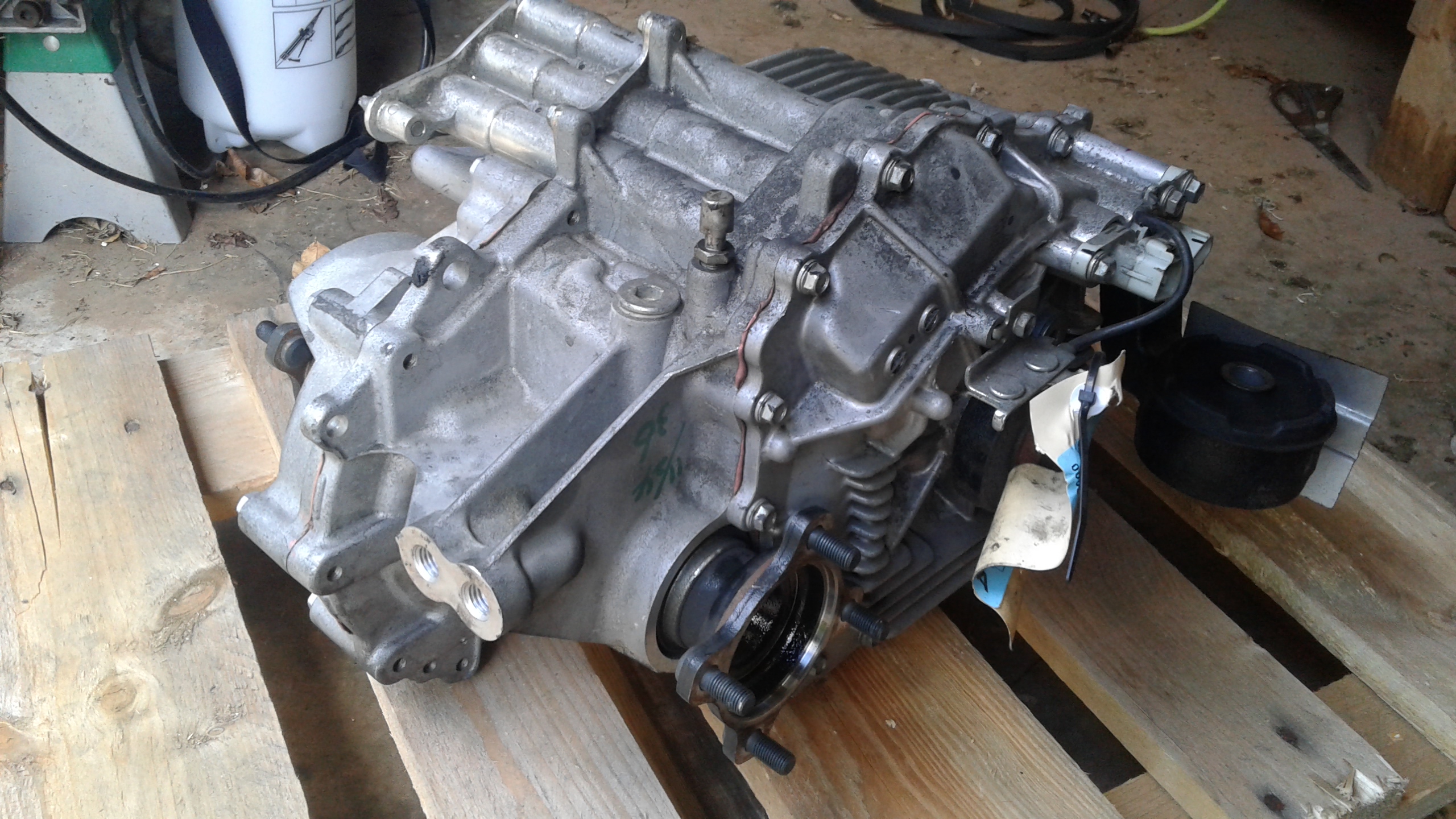

The axle c/l to top of MGR = 7" (180mm) and to the front edge of the mount casting 14" (355mm). Looks like it will fit just fine :D
If I find cooling is needed, I will just install a low pressure BOSCH (or similar) fuel pump to circulate the oil thru an external cooler. But, these motors will tolerate temps well over 150*C, so am hopeful that added measure will not be needed.
The one measurement I do not have is the flange-to-flange width of the stock VW transmission.

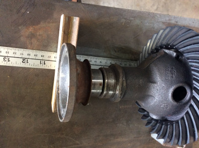

I have downloaded a working drawing and images of an adaptor plate that someone created to join a diff to VW axles but I failed to record the source and details of the diff involved. I will have a search this evening after trying to find a suitable MGR downunder.
Chris
I managed to put together enough pieces from my diff jigsaw to get a pretty good idea of the distance between the flanges. It’s a 72 super beetle 112 2890 748 if that is the same as the square backs.
Looks like it’s about 258 overall but I can’t guarantee the accuracy as there may be spacers missing from the assembly.

Thanks Chris, that measurement is really helpful! The MGR is about 280, so shortening will be required :(
My current plan to join Toyota & VW is to mount the flanges in a lathe face-to-face, true them up and start melting metal!
