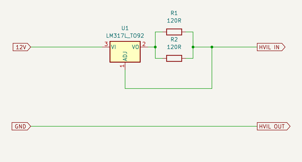

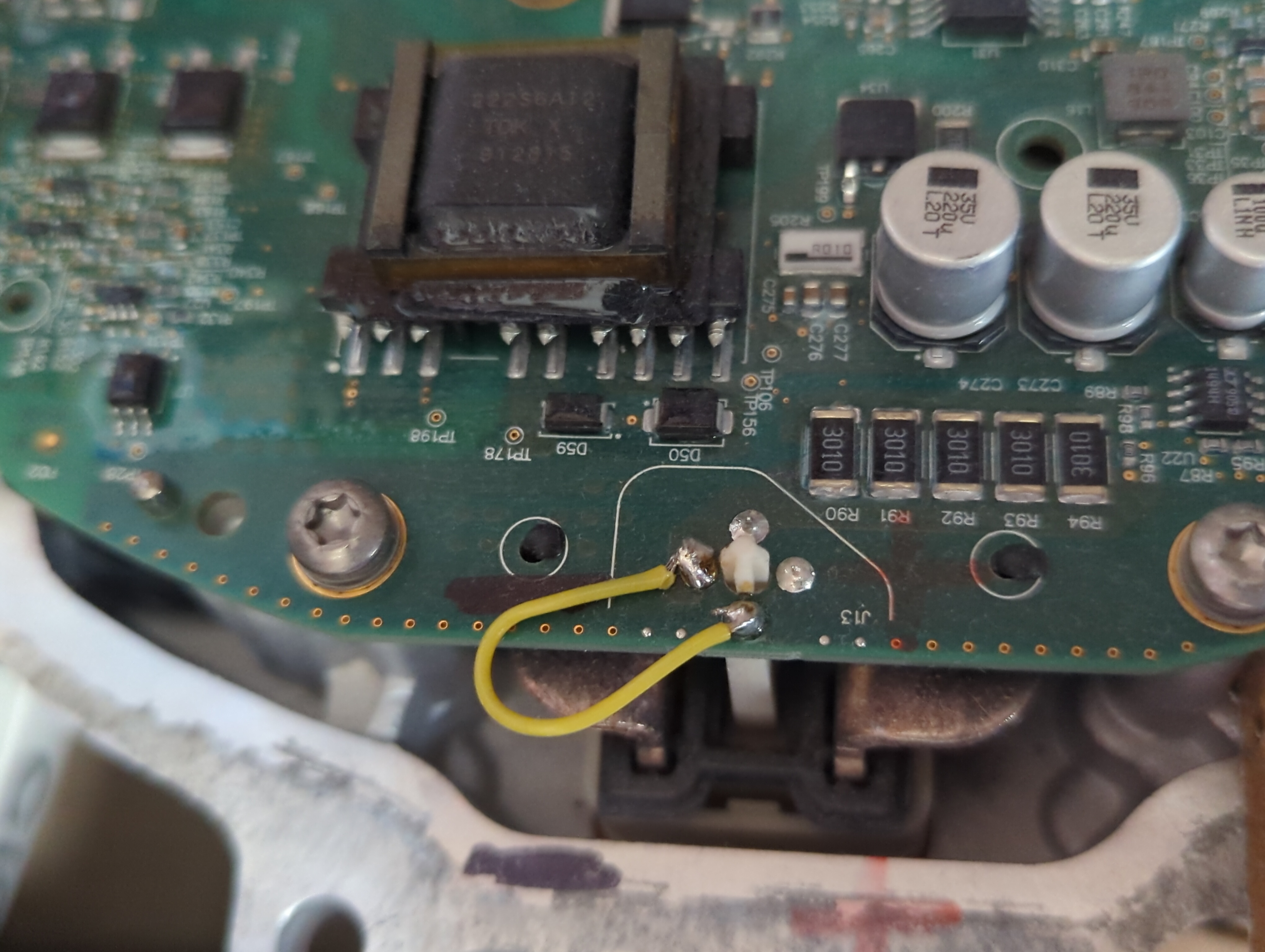

davefiddes wrote: Fri Aug 30, 2024 10:05 am Do you have an intact HVIL loop with a 20mA current running through it? Without that the HV bus discharge circuit on the inverter will not deactivate.
I haven't connected HVIL. Can you tell how to emulate it?
davefiddes
Posts: 294
Has thanked: 77 times
Been thanked: 96 times
Post by davefiddes »
It's quite simple to emulate on the bench. It is a simple 20mA current loop and you can use the same 12VDC supply you use for the main inverter (it is optically isolated from the main inverter electronics).
I use the following circuit with an LM317L regulator:
The HV DC connector is part of the loop. I see you have the official cable so you should be good. If anyone wants to jumper it out you need to do this:
The HV discharge circuitry is completely automatic but the HVIL current is monitored by the main inverter MCU.

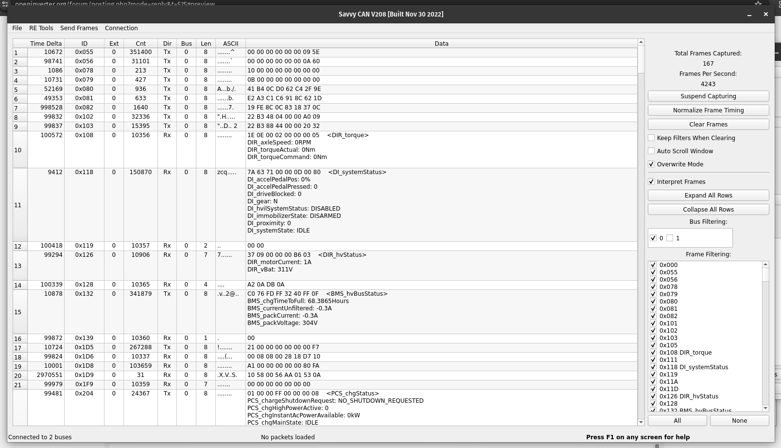

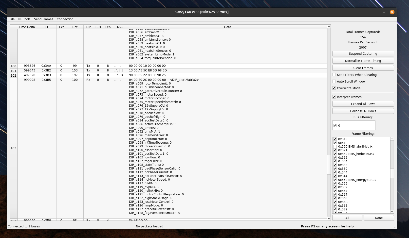

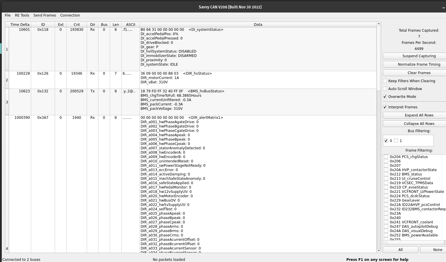

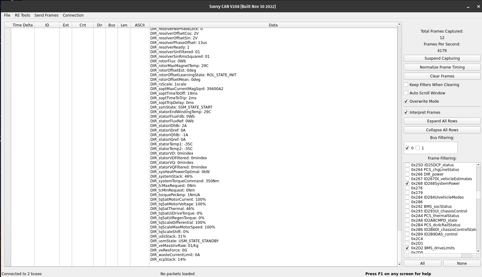

So the immobilizer is unlocked, the inverter shows signs of life with a 10 kHz beep for a split second during power on and shows that it is in the IDLE state, the HVIL circuit is on.
I switch to D, the inverter shows N and the IDLE state doesn't change. That is, in order for D to be ENABLE, you first need to achieve STANDBY in P.

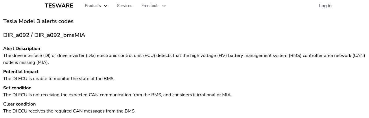

Does the motor need cell voltages? I think the problem lies somewhere in the messages from the BMS. What do you think?

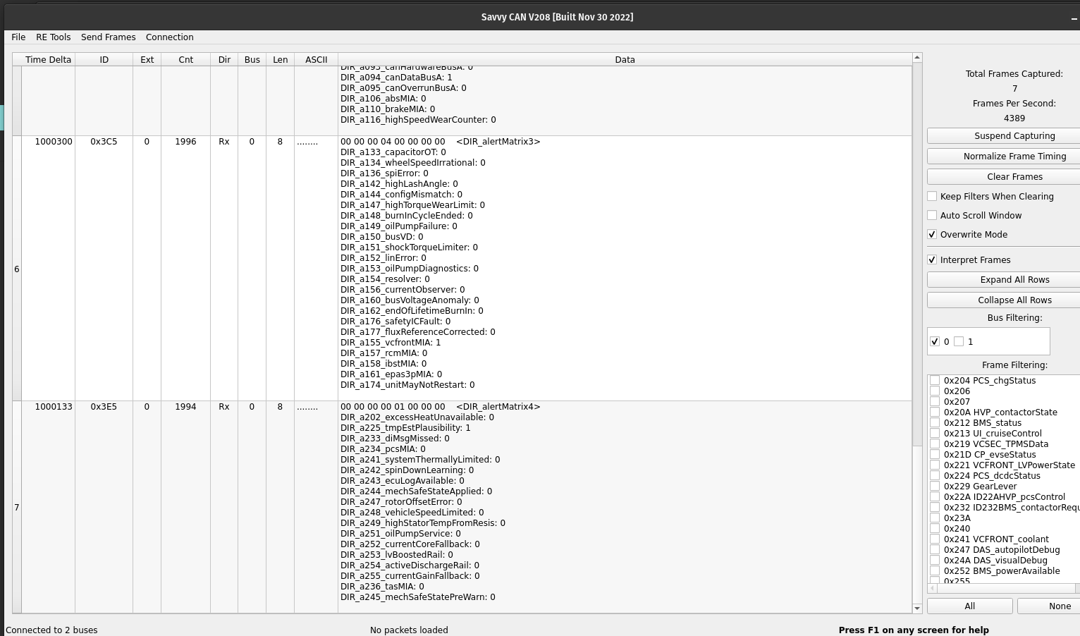

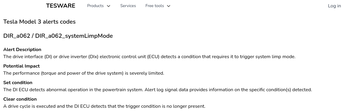

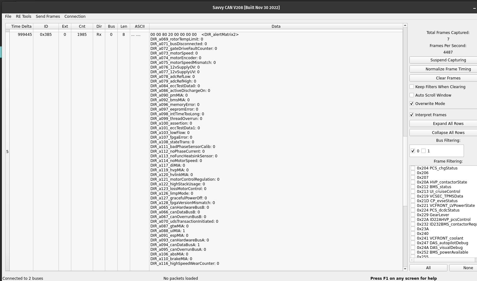

After playing with the motor for a while found some alerts:

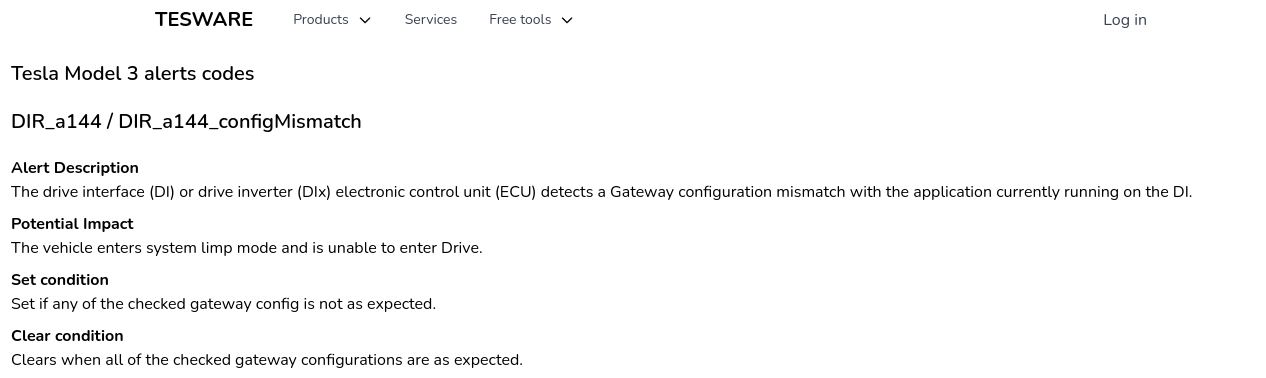

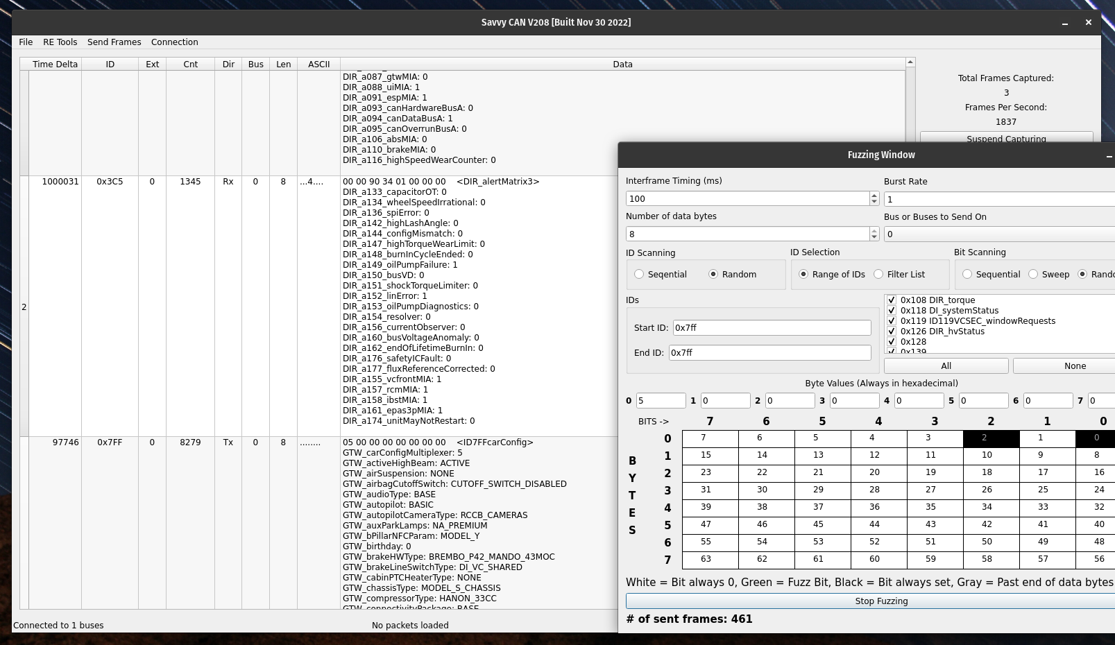

Noticed that DIR_a144_configMismatch is triggered by two messages 0×392 and 0×7FF.
AMP3R
Posts: 125
Been thanked: 53 times
Post by AMP3R »

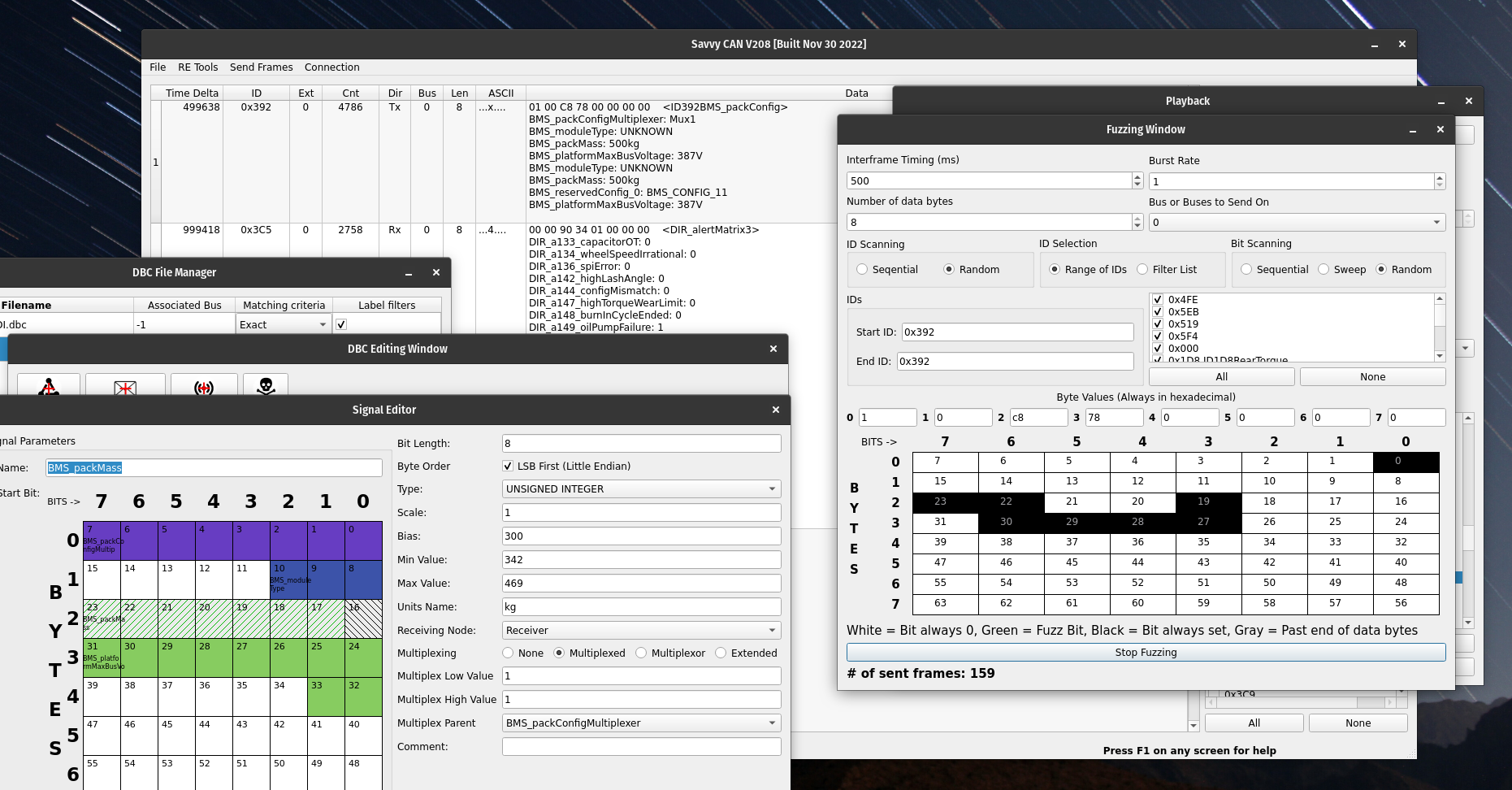

Figured out the 0×392 BMS_packConfig message, which triggers the DIR_a144_configMismatch.
Just corrected max voltage to 387 and alert has gone.
AMP3R
Posts: 125
Post by AMP3R »

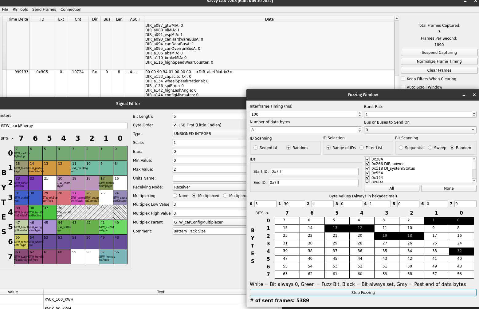

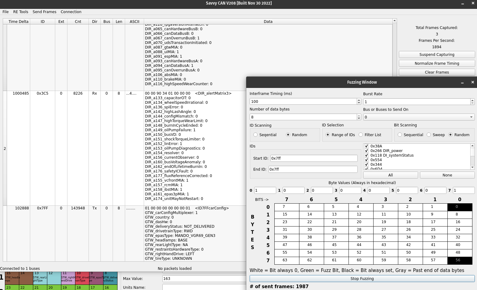

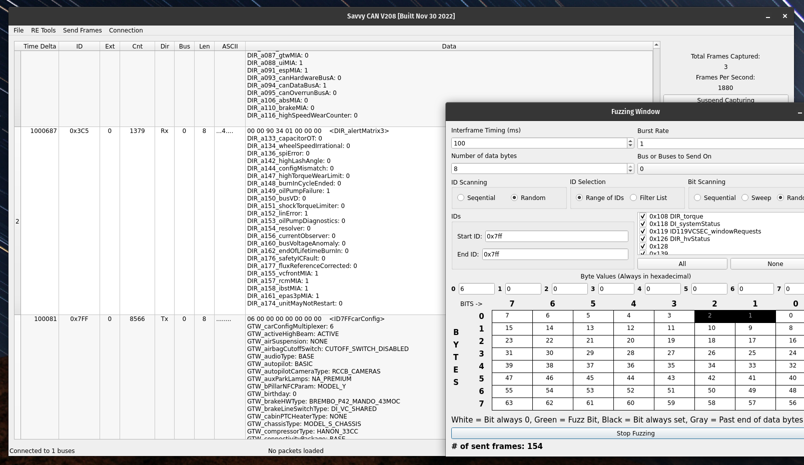

The first frame from the multiplexed message 0×7FF about the car config is ready. It turned out that all bits can be empty except bit 56
The second frame can be completely empty.
The third needs information about GTW_perfomancePackage, GTW_chassisType and GTW_packEnergy. Everything else can be zero.
The fourth can be completely empty.
The fifth can be completely empty.
The sixth is also empty.
DIR_a144_configMismatch goodbye

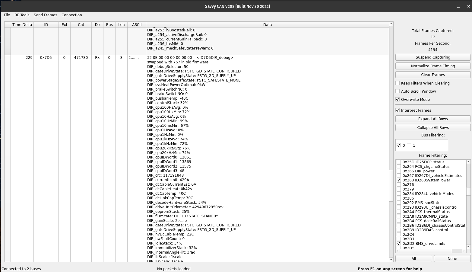

The main system alerts have disappeared, but the inverter does not switch to STANDBY mode yet. Any ideas?

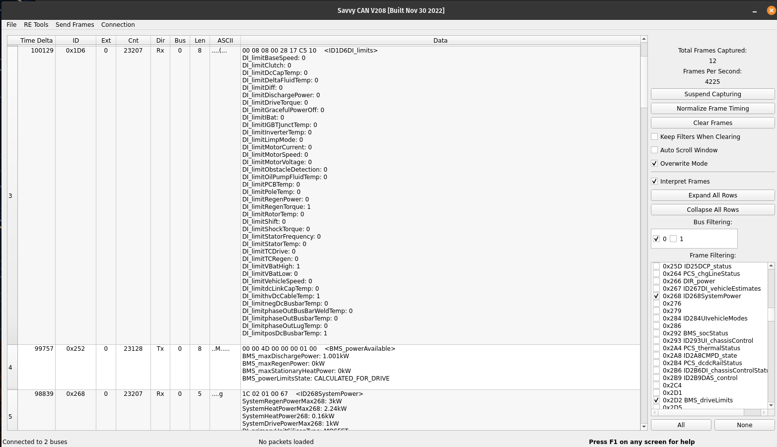

What DI_limitVBatHigh, DIR_ssmState, DIR_usmState and DIR_fluxState are?

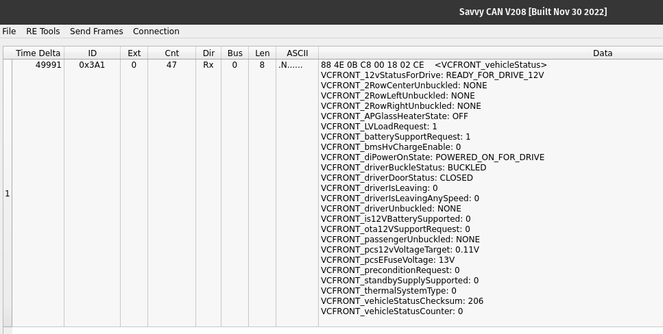

My drive unit probably has last one active alert DIR_a155_vcfrontMIA (The DI ECU is not receiving the expected CAN communication from the VCFRONT, and considers it irrational or MIA)
I assume that this is due to the message 0×3A1.

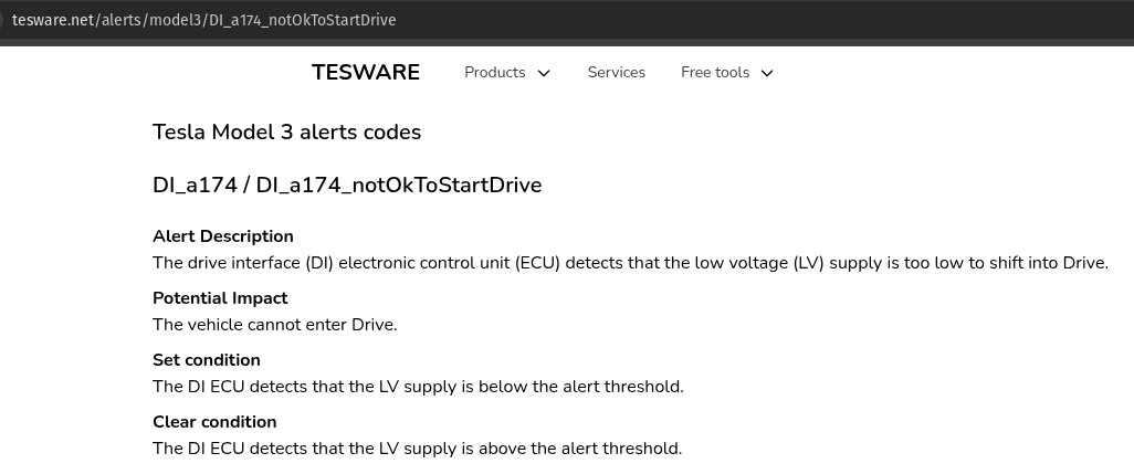

A few days ago I had an idea to take another close look what the inverter sends to the vehicle CAN and after poking around found something interesting. It turns out that there are many more ids with alerts than I thought.
Of course, nothing will work, because the DI_a174_notOkToStartDrive alert is active. If this turns out to be the cause, it will be very funny.

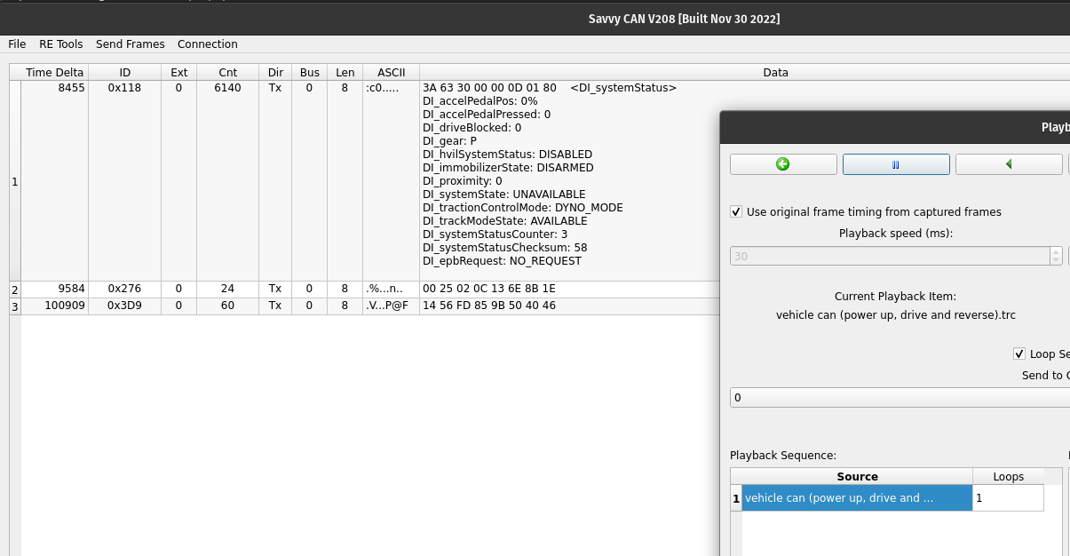

It's interesting to look how the immobilizer works.
As soon as the inverter recieved the 0×221 (VCFRONT_LVPowerState) message, it shoots 0×276 to the CAN vehicle for a split of second. This is a challenge for the VCSEC.
Meanwhile, the VCSEC is already ready and when you put the key card, it responds with the 0×3D9. That's it - the immo is unlocked.
The 0×276 challenge message is always new every time the inverter is restarted. After looking on its structure, I dare to assume that it has 65536 possible combinations.
For fun, it's possible to record the entire range of challenge/response pairs (65536), make look up table and try to replay these answers to the drive unit.
