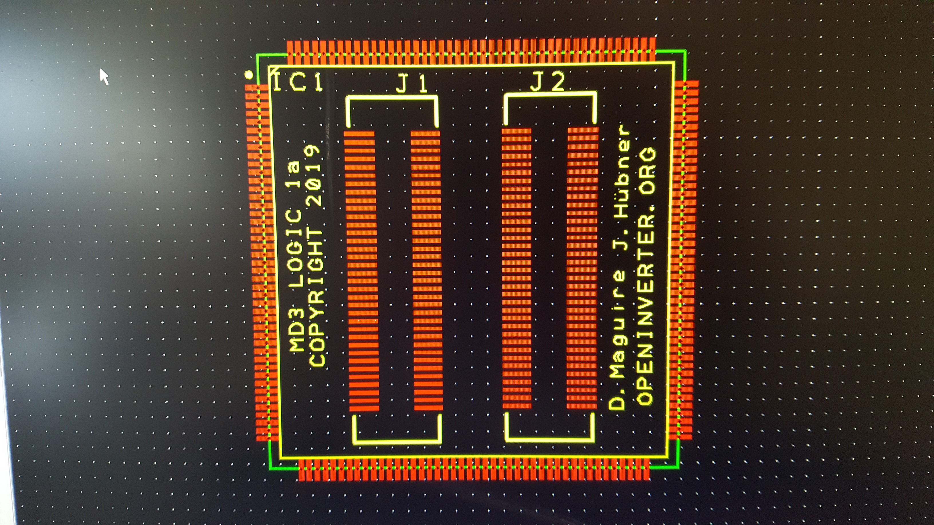

So finally back at the model 3 board. Design has evolved a little from the initial concept. Decided on a board stack system that will allow interchange and upgrade of the main logic pcb with no soldering. The IC replacement board will now just carry two 70 way Molex 52991-0708 board to board connectors. The main logic pcb can then be larger and or double sided smd if required and simply clip into the adapter board. In other news it seems the Musk has kinda stolen Johannes's idea and implemented a software resolver interface:)

Thats are very neat idea.
Yes I'm sure Elon has stolen from me
So thats a +1 for interfacing.

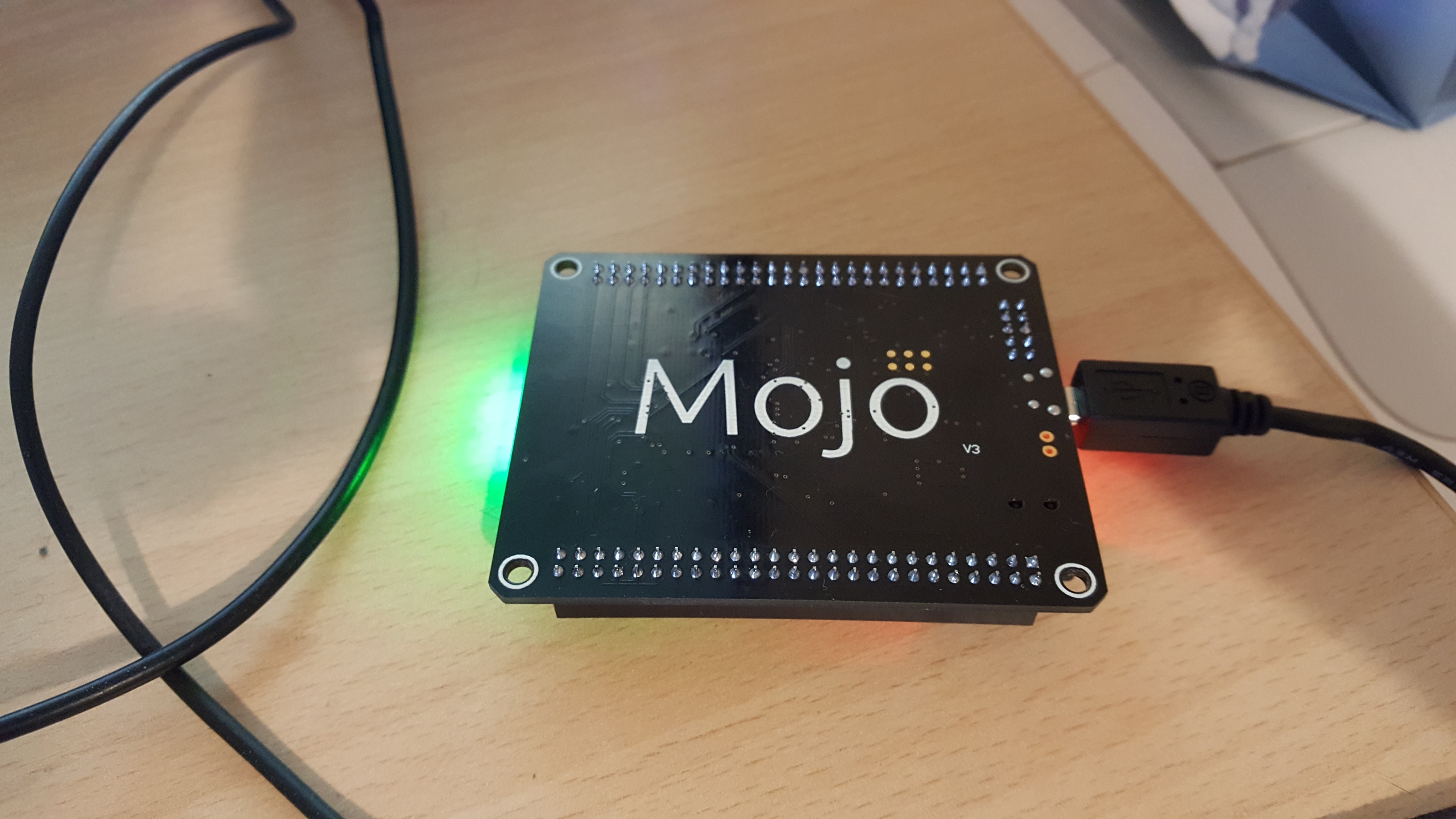

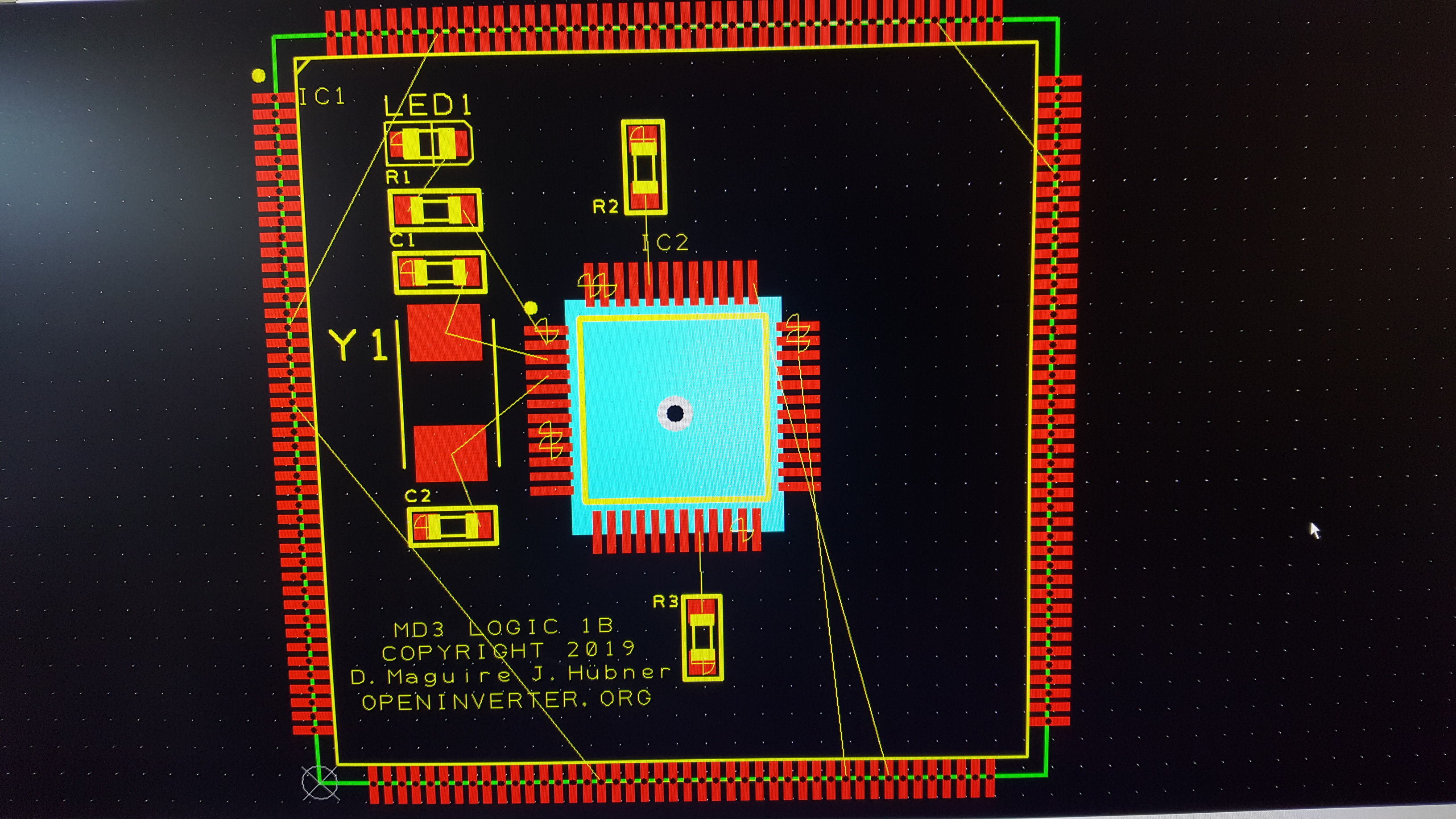

Adapter boards ordered. Now onto laying out the actual logic board. This will be an intermediate design for development. Hence me learning a new trick (vhdl)
One thing I miss out on by not having a drive unit is the ability to run the motor from an external inverter just to prove it will turn under Hubner control.

Who said I'd lost my Mojo:)
All the M3 stuff is giving me the final push to start doing some Verilog. Should have some nice knock on for further developments on other inverter boards.

With recent developments on the BluePill board using the 48 pin STM32F103C8T6 mcu it looks like I'll be able to squeeze everything onto a single sided smt 4 layer board with castelated edges which will replace the TMS C2000.
What we know : Ground, power (3v3 and 1v2), JTAG, Reset, analog refs, can.
the analog pins run at 3v3 and the digital at 1v2.
What we don't know : what analog pins do what and what digital pins do what.
Plan for the development board is to route the unknown pins to pads which can be hardwired to the STM32 using wire wrap wire once functions are determined. The its a simple mater of routing the pcb for the finished design once we get moving.

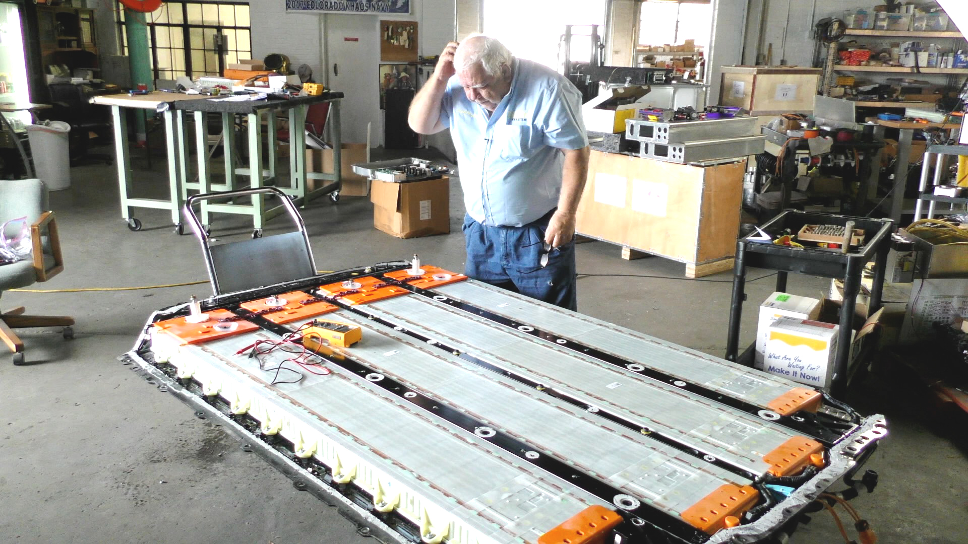

Not sure we've captured this information anywhere... Model 3 battery module information from EVTV (here);
"The two 23 cell modules are at each edge of the pack and 67 1/2 inches long, 11 1/2 inches wide and 3 1/2 inches thick and weigh 191 lbs.
The two 25 cell modules are located in the middle of the pack and 73 inches long, 11 1/2 inches wide and 3 1/2 inches thick and weigh 207 lbs."
Note: the CAD models seem accurate (here).
