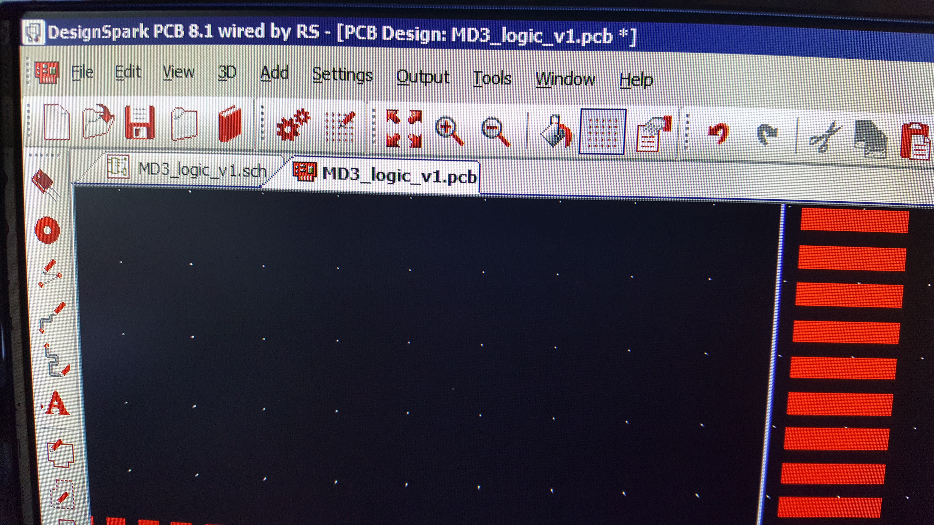

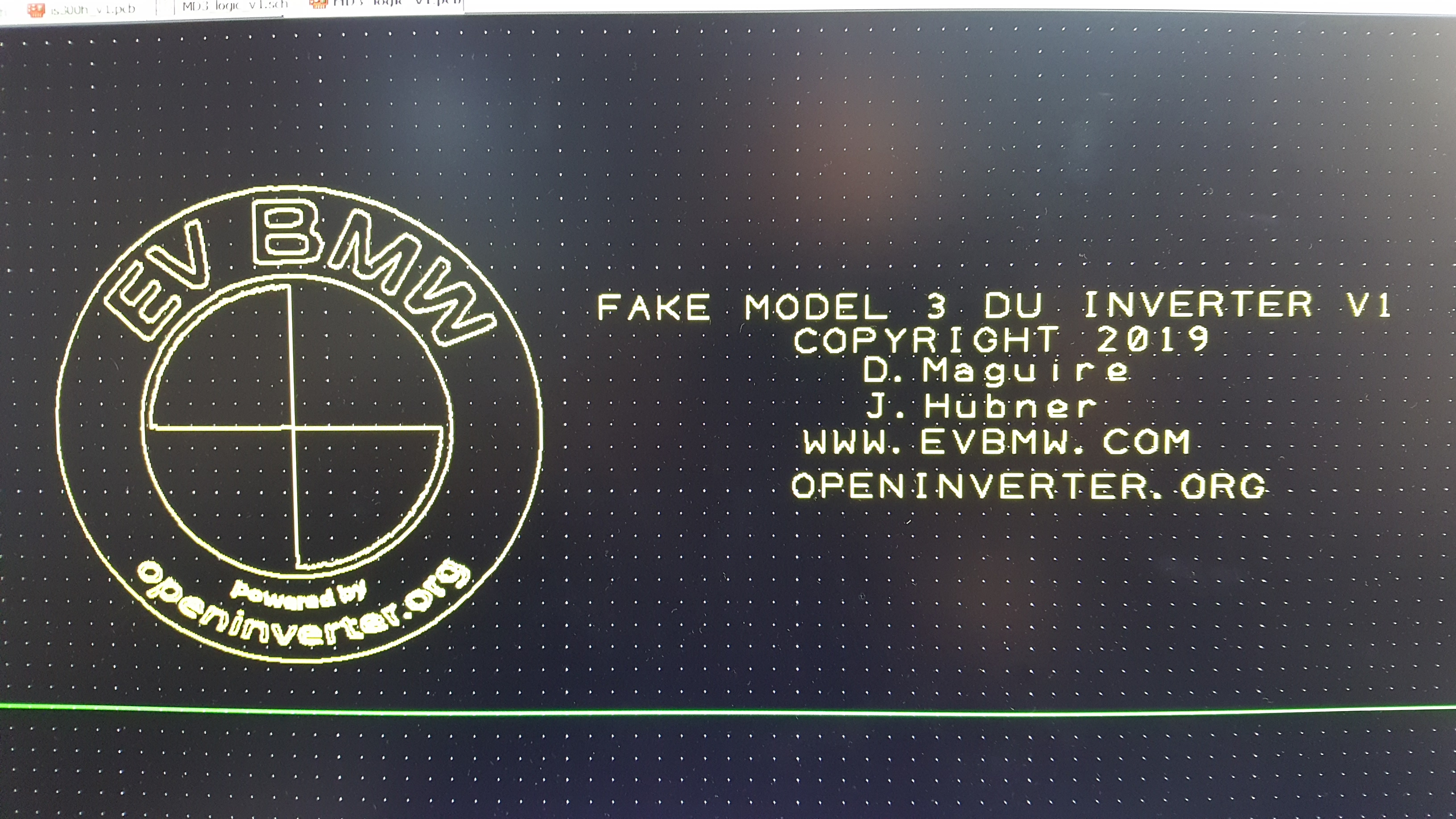

So started laying out a simple pcb today for what I call my Model 3 simulator. Just a little 4 inch square board with the C2000 footprint with power and grounds and some leds and switches to simulate I/O. I'll get this pro built by my board builder to as closely simulate the drive unit pcb. Lead free solder, conformal coating (aka Musk Goo) the works. Then we'll see how I get on removing the C2000 and fitting the V1 logic board. Might take a few goes to find the best way but better to mess up a few 5 euro boards than a M3 drive unit:)

Making progress.

Boards ordered:)
