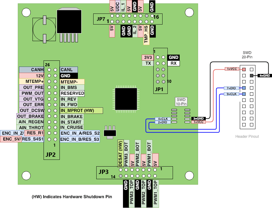

Well you can't run the Prius inverter off a V3 main board as is.
1. At the very least you need 3 NPN transistors that operate the 12V PWM signals.
2. Next you need to convert the bipolar -15V to +15V current feedback signals to 0-3.3V. A circuit has been posted earlier. You need MG2 current feedback for running FOC.
3. You need the blended in MG1 current feedback for charge mode (measure AC input current).
4. Then you can map one of the low side PWM signals, again via an NPN transistor, to the buck converter to allow HV battery charging.
The DC/DC converter, as in HV to 12V, will not be connected to the adapter board. It just needs a 12V control signal.
So 1. is enough for controlling an asynchronous motor with sine firmware
2. Is enough for controlling a synchronous motor with FOC firmware
3. and 4. are needed for charging.

Thanks Johu, as I am trying to use Gen 2 transaxle, will need 2. I would like to spin motor for a presentation, so is it possible to have schematics from somewhere for 3 and 4 that I could build with strip board kit and order the Brainboard V3? I am trying to get funding from my region council to promote this setup as viable solution, so would like to know easiest /quickest way forward. Thanks for reply

You can use SN74LS06N inverter chip and supply the chip with 12V source. There are 6 ports, 3 of them we use to run IGBTs and rest as we please. Pullups or whatever...johu wrote: ↑Thu Apr 23, 2020 5:17 pm
For 3. and 4. I would suggest you use Melexis sensor fixed on the DC rail inside Prius Gen2 inverter. That way you cen have true buck output control from 3phase or boost whatever you need. No need to complicate with MG1 sensor signal conversion. My 5c.
2. Next you need to convert the bipolar -15V to +15V current feedback signals to 0-3.3V. You need MG2 current feedback for running FOC.
I also updated Johu's diagram, but don't know how, and did not want to risk updating his wiki page. Could some one check and if OK, can it be updated pls? It is to have clarity on Pin outputs for us non EE people.

Maybe Johannes could just update Rev3 board with SN74LS06D SOIC version and add 1K resistors to its Y pins.
Then you can use 3x pins to drive IGBTs and couple of pins to drive Buck-Boost. Remaining pin you can use to trigger Fault state by pulling MPROT/FAULT pin low etc...

I've been successful using the ULN2003 chip. All we need is open collector, no push pull logic needed.arber333 wrote: ↑Fri Apr 24, 2020 4:40 am You can use SN74LS06N inverter chip and supply the chip with 12V source. There are 6 ports, 3 of them we use to run IGBTs and rest as we please. Pullups or whatever...
Current sensor wise I thought using the existing sensors would ease the installation. Also when using an external Melexis sensor I would need to add an additional analog input to sample it. I don't think it matters whether the control loop is based on input our output current as they are coupled by a fixed factor anyways (when talking RMS values). When configuring the charger you only have to keep in mind what battery current will result. Say you configure 10A 3-phase (380V) input current it will result in roughly 19A battery current for a 200V battery.
Aha, so we need to support about 600V for rectified 3-phase, thus a 1:2 divider is needed.
I currently wonder if an adapter board is the way forward or whether a bespoke Prius board would be better. After all it just means copy and pasting the V3 design and adding some components around it. Manufacturing-wise the adapter board needs to be made separately anyway.

My vote is for a dedicated board. An adaptor board only makes sense in high volumes and has all the issues related to board-to-board connector reliability in an automotive environment.johu wrote: ↑Fri Apr 24, 2020 11:04 amI currently wonder if an adapter board is the way forward or whether a bespoke Prius board would be better. After all it just means copy and pasting the V3 design and adding some components around it. Manufacturing-wise the adapter board needs to be made separately anyway.
Having a mechanism for identifying the board type in software could be useful going forward

You could do it with existing Rev3 boards, but you would have to make a different adapter for Gen2 and Gen3 since inputs are not similar at all.jnsaff wrote: ↑Fri Apr 24, 2020 11:43 am Any way this could be incorporated as a universal board that can run both Gen2 and Gen3 inverters (not at the same time ofc)? I know the Gen3 board is meant to go inside the case and there are differences between Prius and Auris/Yaris versions but if the differences are small and Gen2 support can be squeezed onto the Gen3 board that would greatly simplify supply chain. There could also be a case for a split BoM where Gen2 components are not populated if only Gen3 is needed.
Hm... You know what? It is not such a bad idea! Considering we would have to make Gen3 board to one size fit all Gen3.
Then vertical space is enough to house one Rev3 board on top of fake Prius master board. Also that board could include Arduino chip to control charger function of Buck boost, keep MG1 transistors down, current sensors signal converter, some small relays and 12V DCDC. Board size can be extended around small connector as i demonstrated before.
Gen2 would require totaly different board which would fit in a separate box, but could still be Rev3 on top of an adapter board. Or maybe just expand Rev3 board to house all sensor inputs... What would be easier.
