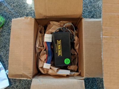

Been thanked: 608 times
Re: 2004 BMW 330 with SMG/SSG Gearbox
Oeps, porting the CODA charger over to the Volt Gen 1 code now. :)

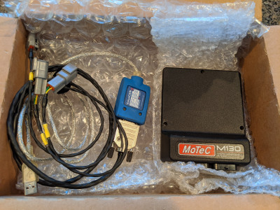

In other news, a new arrival (or maybe I should say an old arrival has returned?):
From my business partner, Dundon Motorsports -
Old item: CAN Sniffer. New Item: Motec M130 that will be the control unit for the 330.
The M150 that's currently in there will go in the M3, because I need a lot more IO for that project. MPC555 processor, an FPGA for crank-angle computation, and 256MB of flash for logging. Runs Linux! Calibrated via the XCP protocol, over IPv6. (For the network nerds: Hey at least something uses IPv6 :D )
-Matt

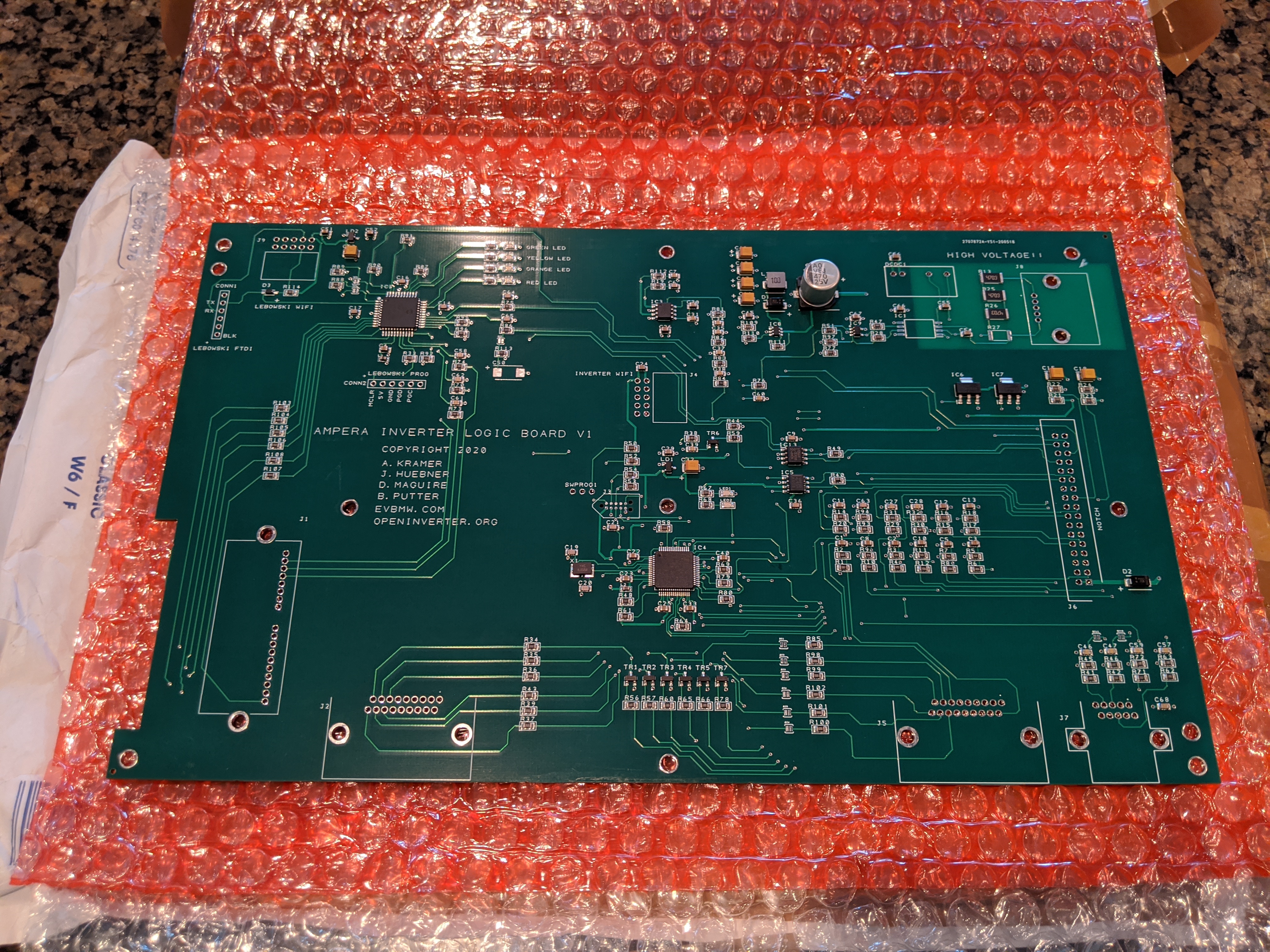

The nicely-made board from Damien, thank you sir. JLCPCB quality does seem to be pretty high, especially for their pricing.

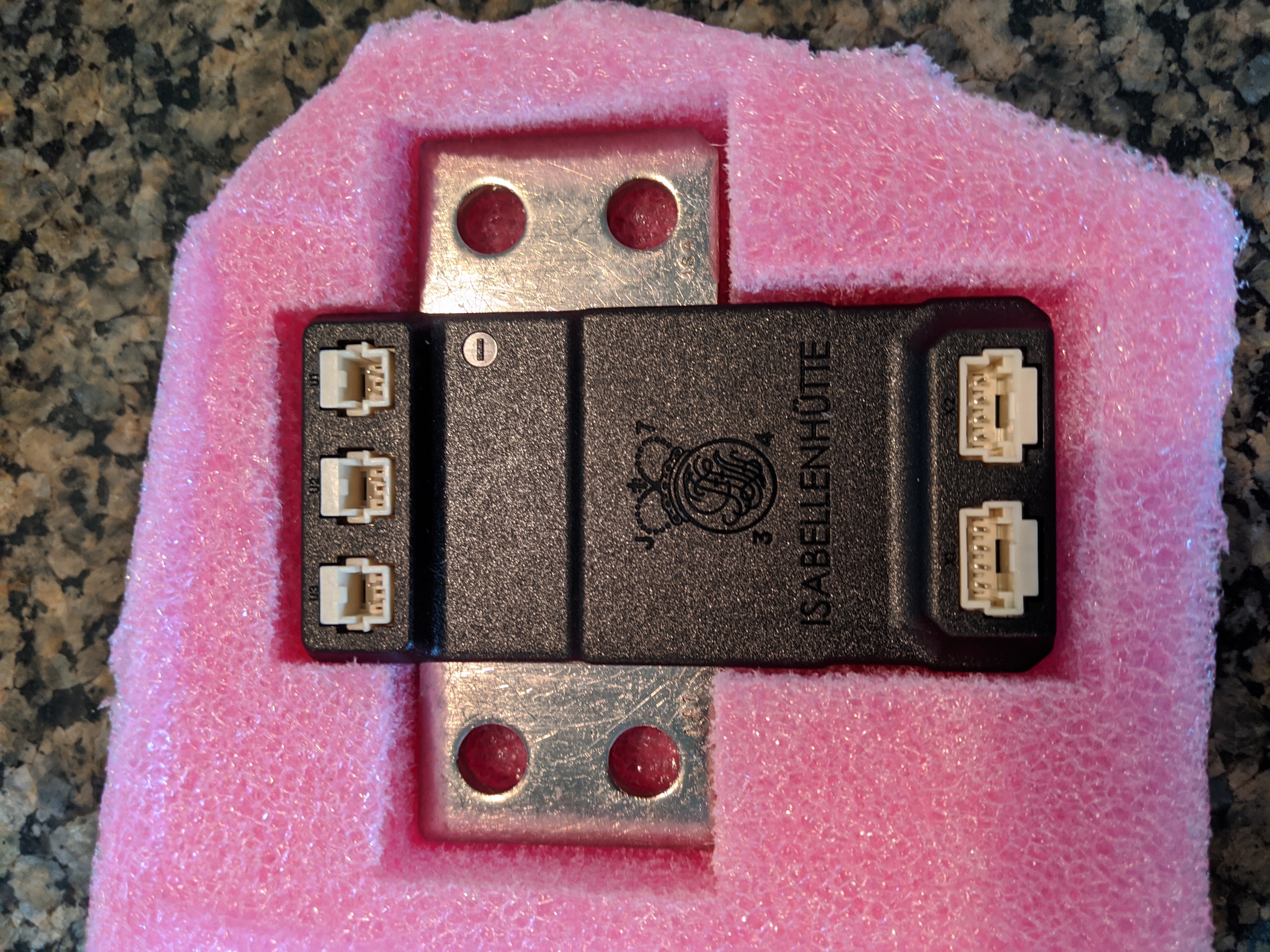

I also received the bazillion-in-one device:
The ISA shunt. 1000A version.
Updated first post of BOM and costs.

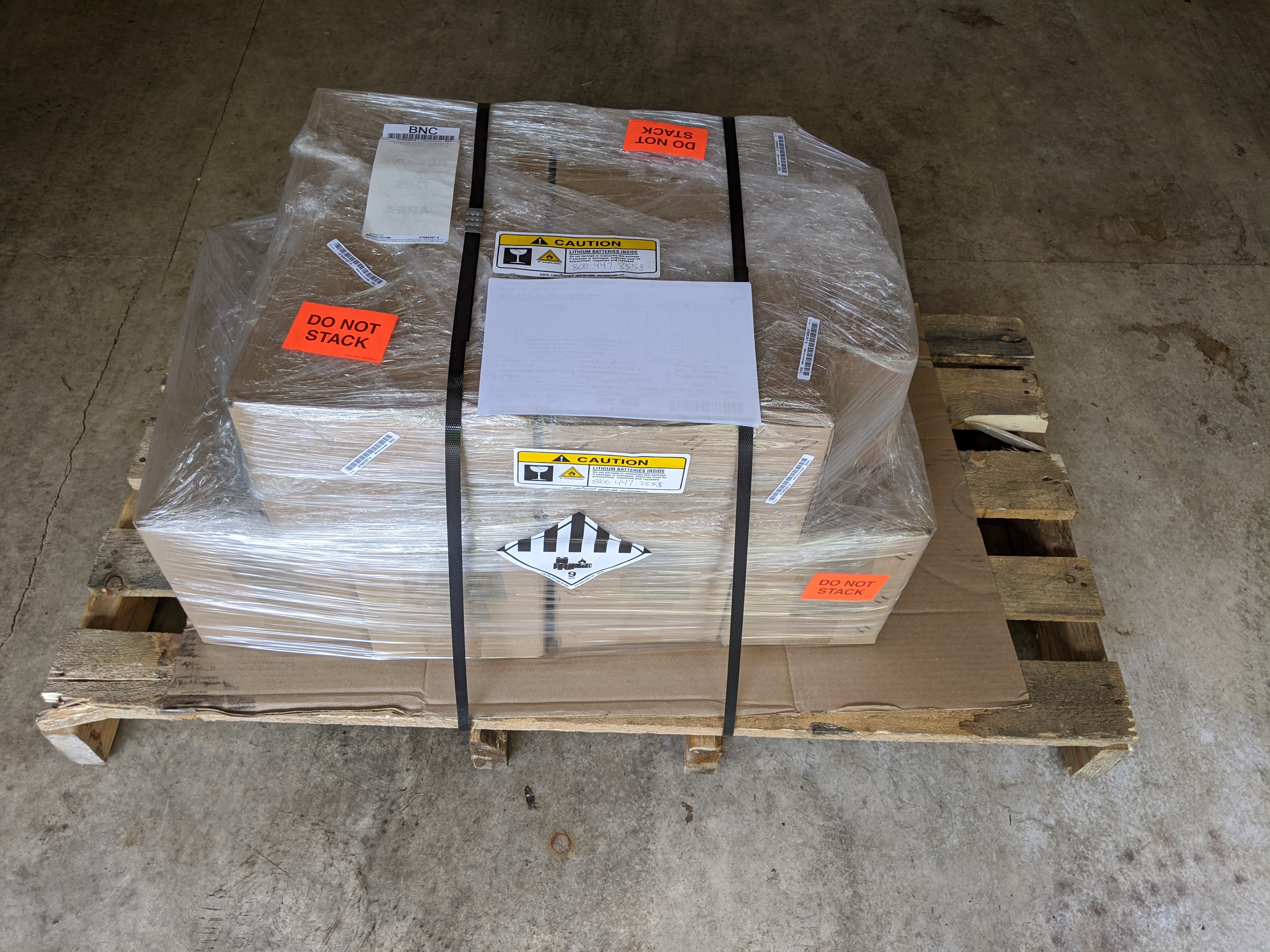

They're here, they're here!
Now I just need to unpack them and put them somewhere for now. :)

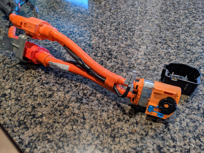

Not strictly related to this conversion per-se, but I've picked up a few items of interest:
* CHAdeMO charging cable (station side.... :D and unfortunately not cheap! - $80 in shipping because these things are so heavy!)
* J1772 and CHAdeMO socket from Nissan Leaf (with harness!)
* EVTV CAN sniffer for Model 3

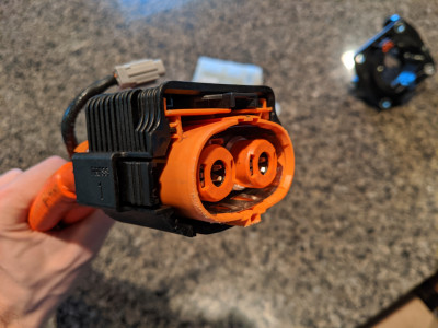

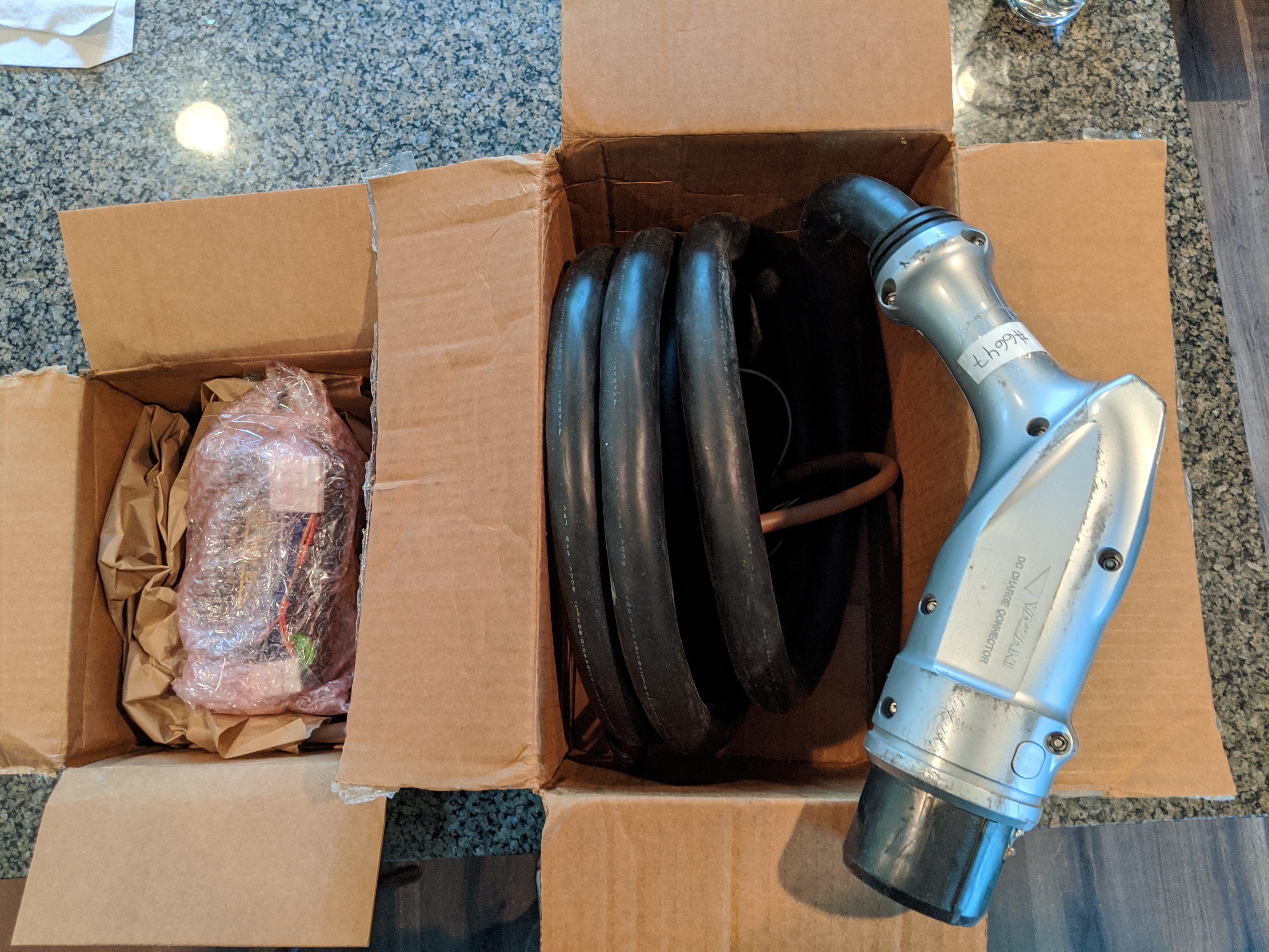

Two fun items arrived today:
That cable / connector is huge and heavy. 20 LBs :D
This thing better be more form vs function, because $200 for that .... Box wasn't even closed all the way. And old-school full size USB cable, not included.
Waiting on a CHAdeMO port / cable, I need to find the mating connector to that, hook that up to the cable I have, and splice in the CAN. Then I can use my CHAdeMO to Tesla connector and hopefully get somewhere with that.
-Matt

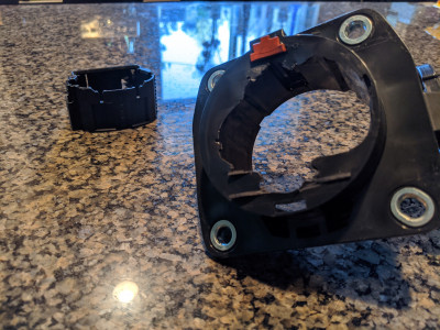

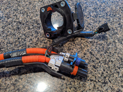

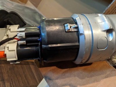

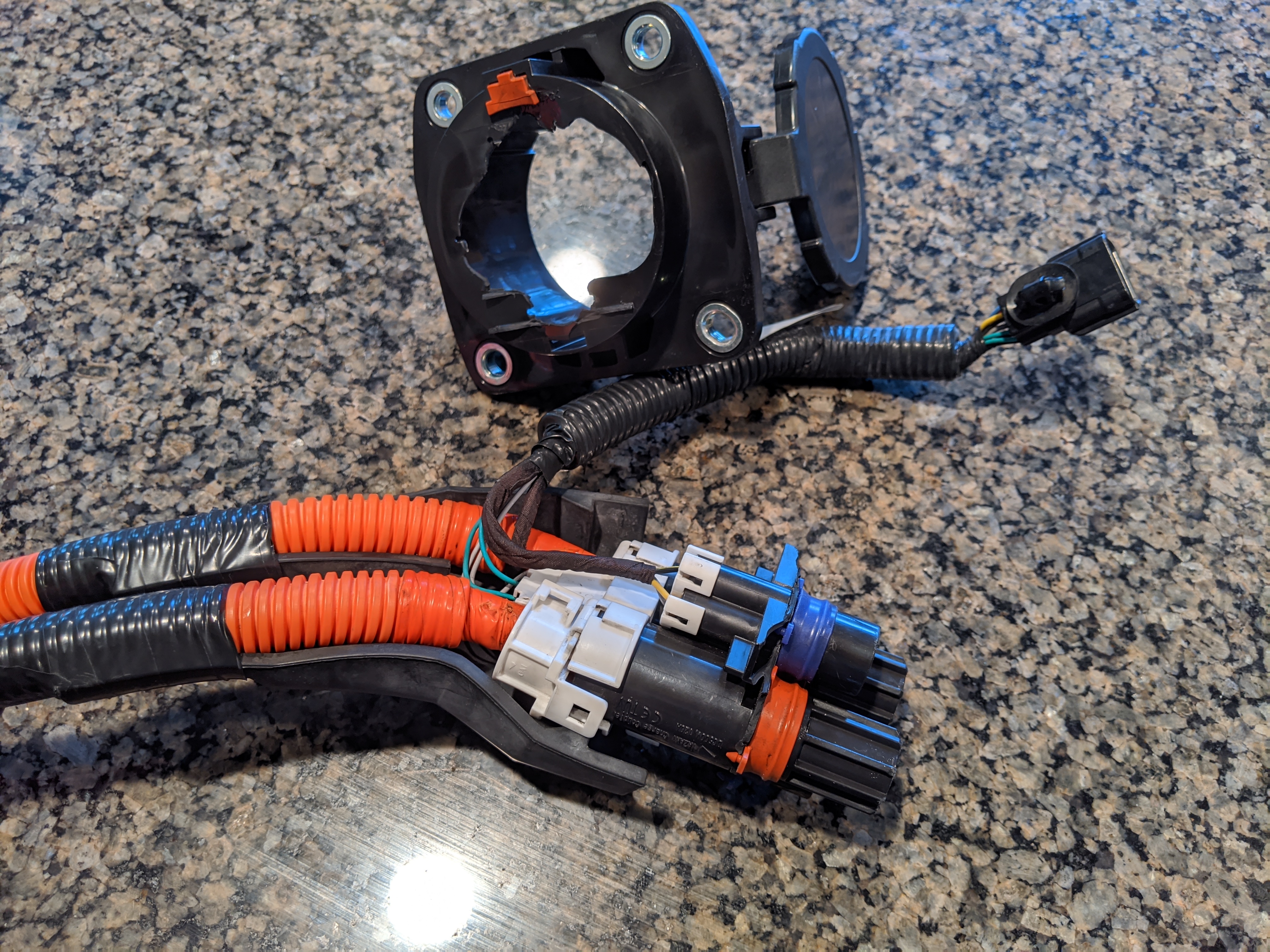

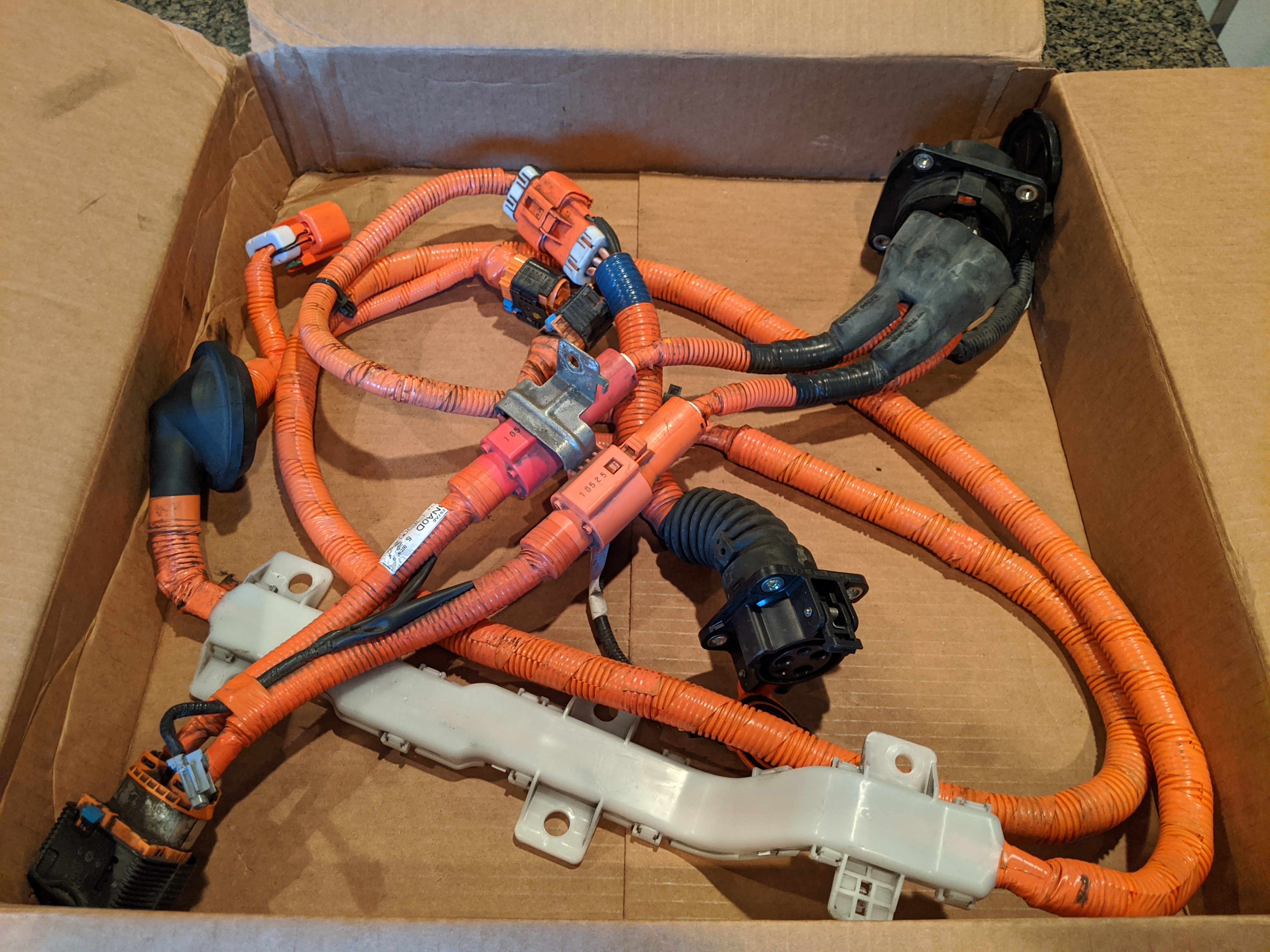

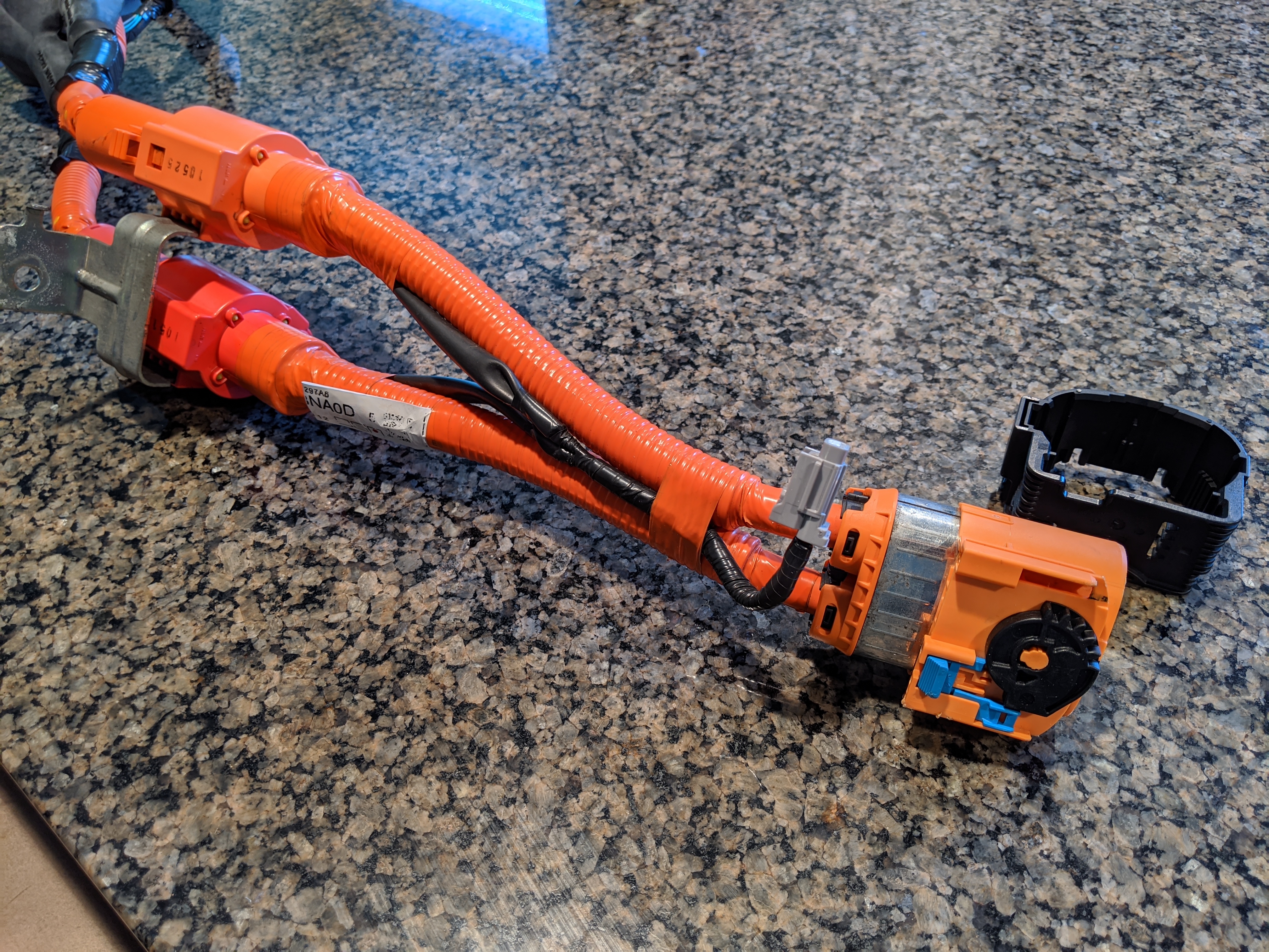

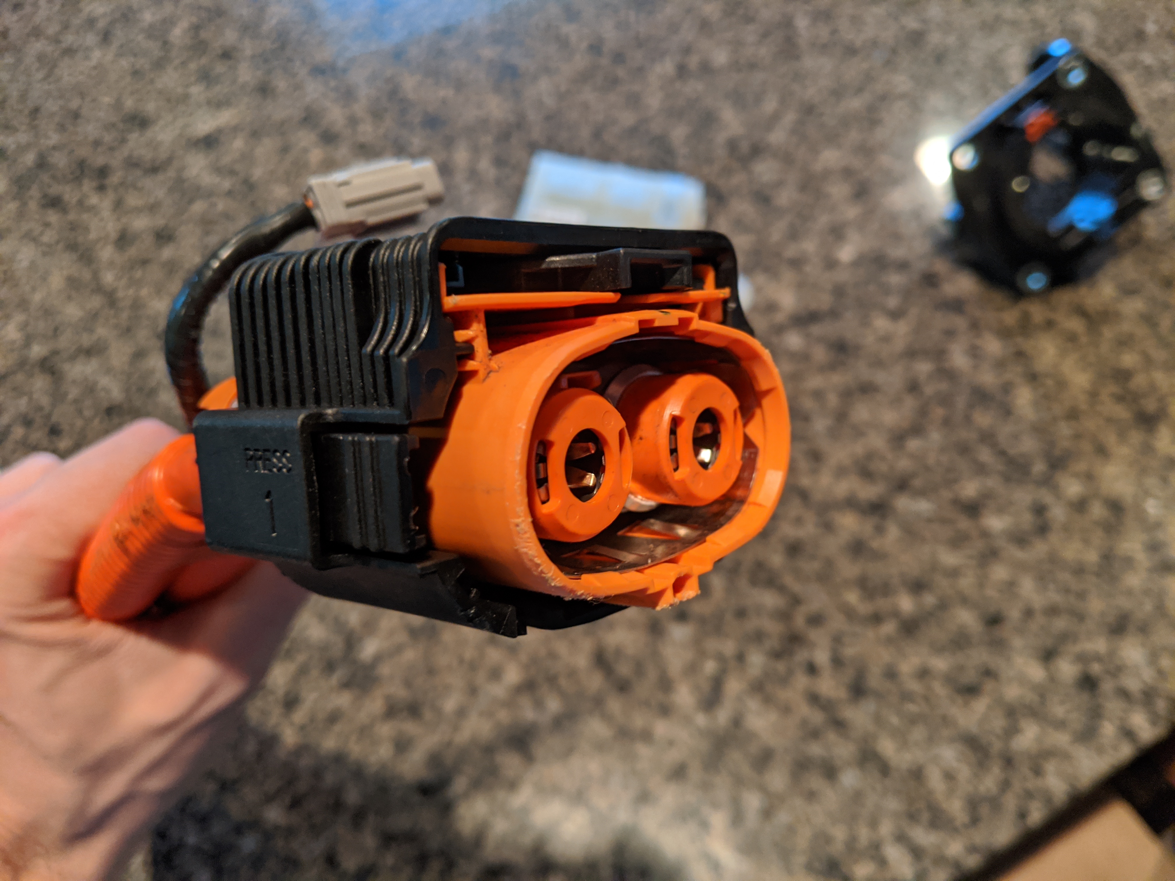

I got the CHAdeMO port (along with a J1772 port) from a LEAF.
Seller must sell a bunch of electronics stuff given the amount of times the box was used already. :)
Packaged well.
Dirty as usual.
It got a little broken. You can also see the covering connector which pretty easily came off.
It cleaned up pretty well.
Part number.
I'm looking for the mating connector to this, so I can hook it up to the CHAdeMO cable...
As you can see it fits well enough for a 5 minute test session to log data. Need to figure out how to log the SWCAN side too. (Chademo, SWCAN, Car CAN all at the same time should prove to be fairly illuminating.)

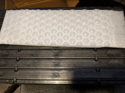

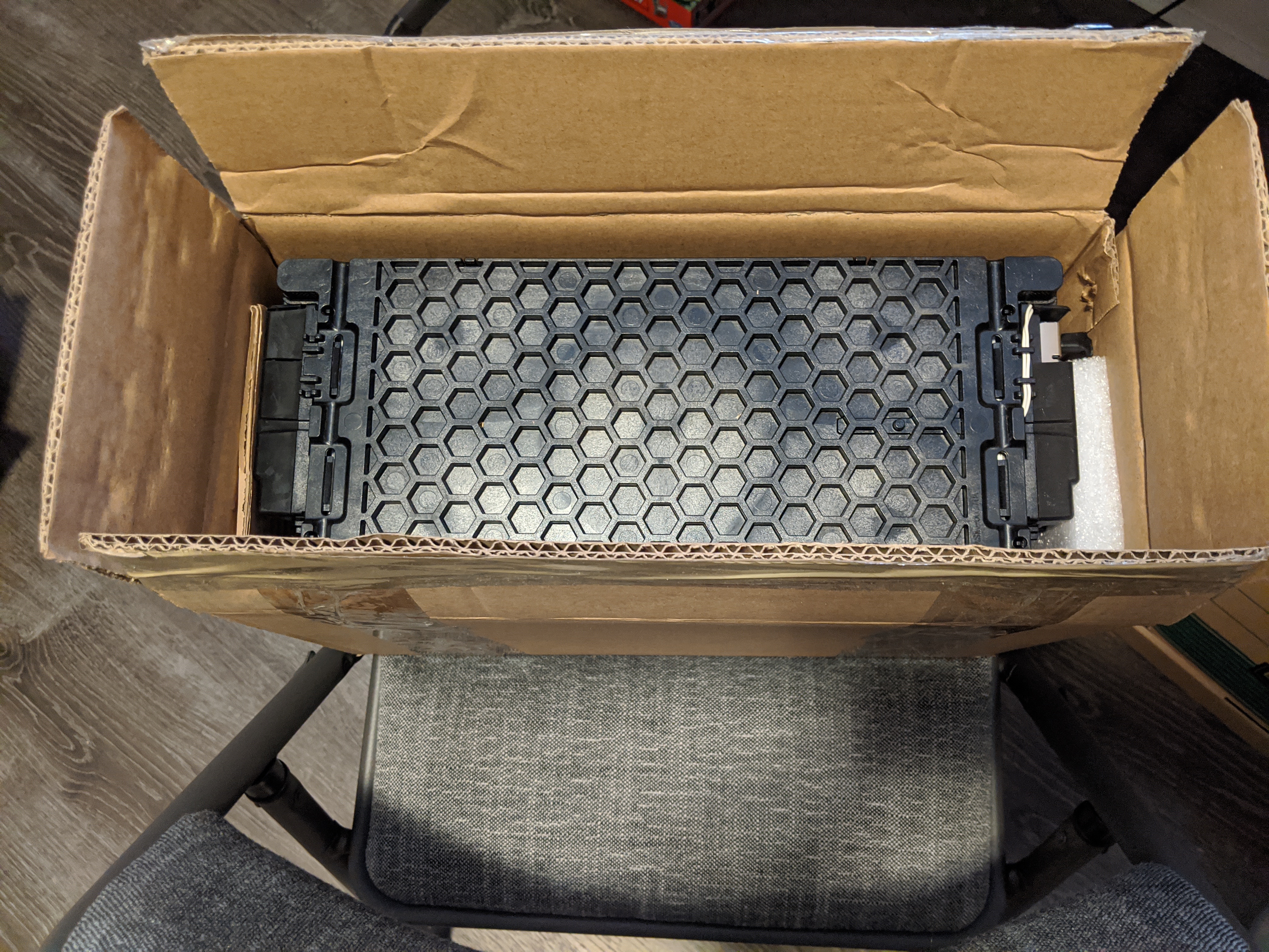

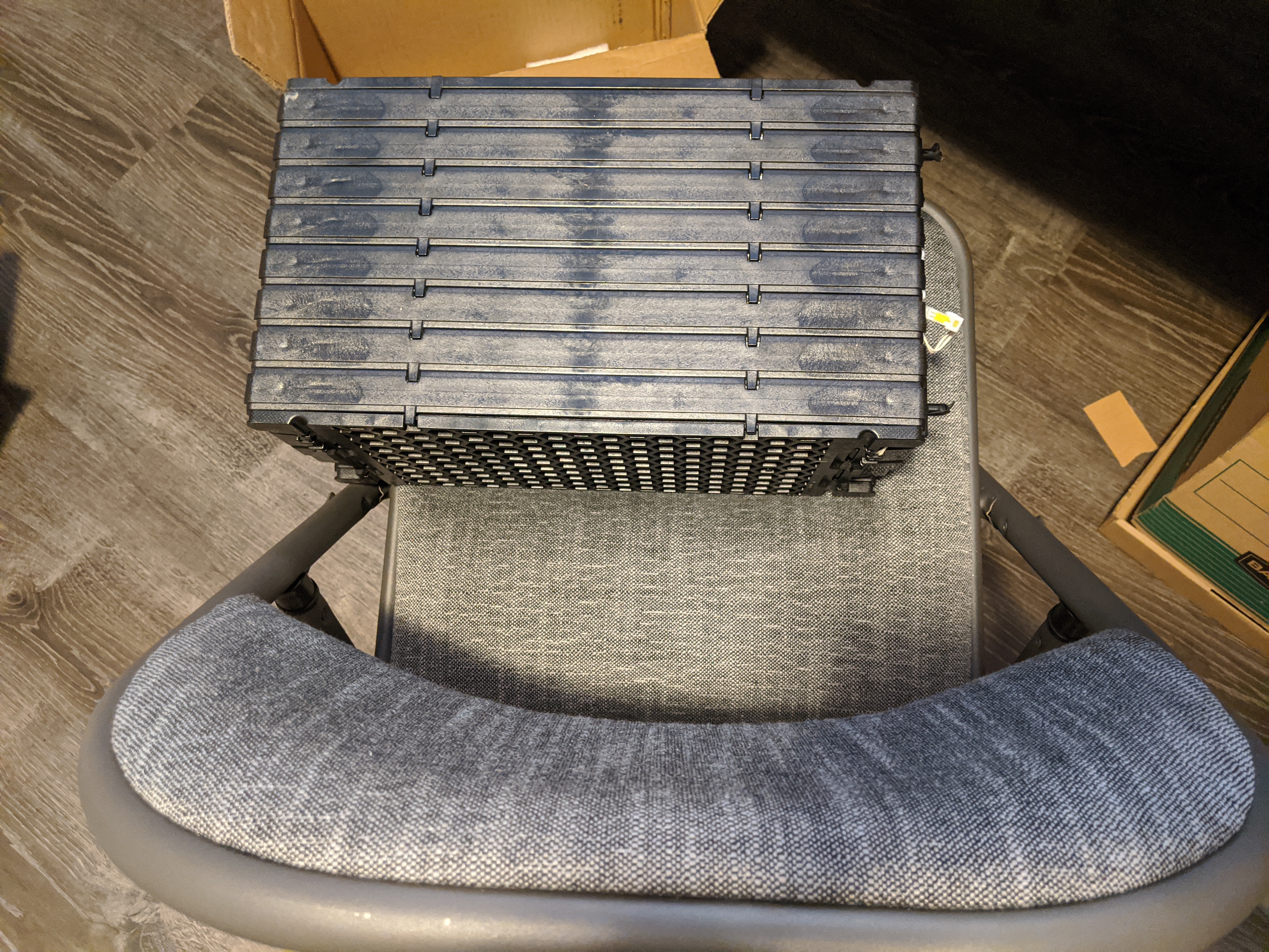

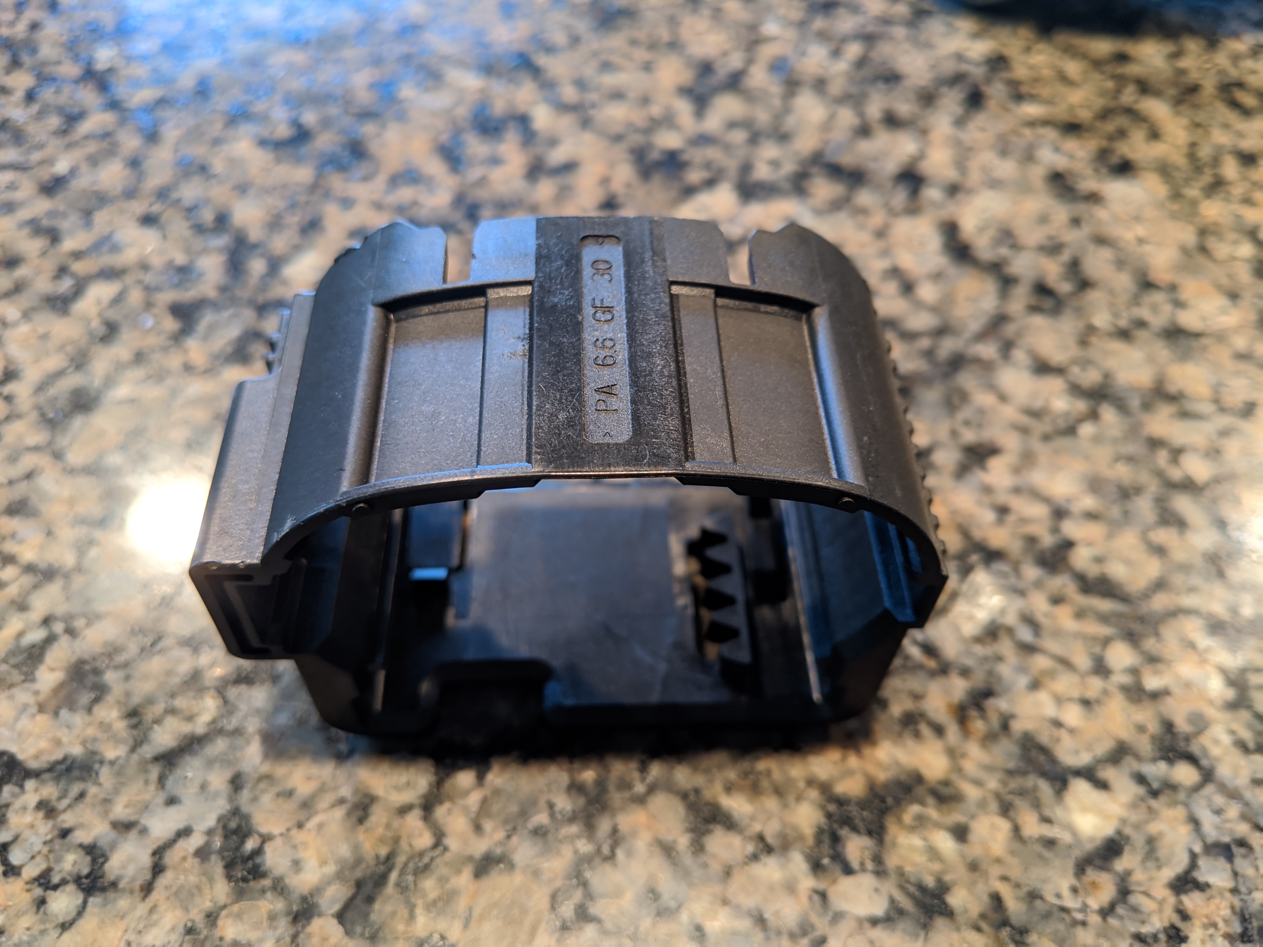

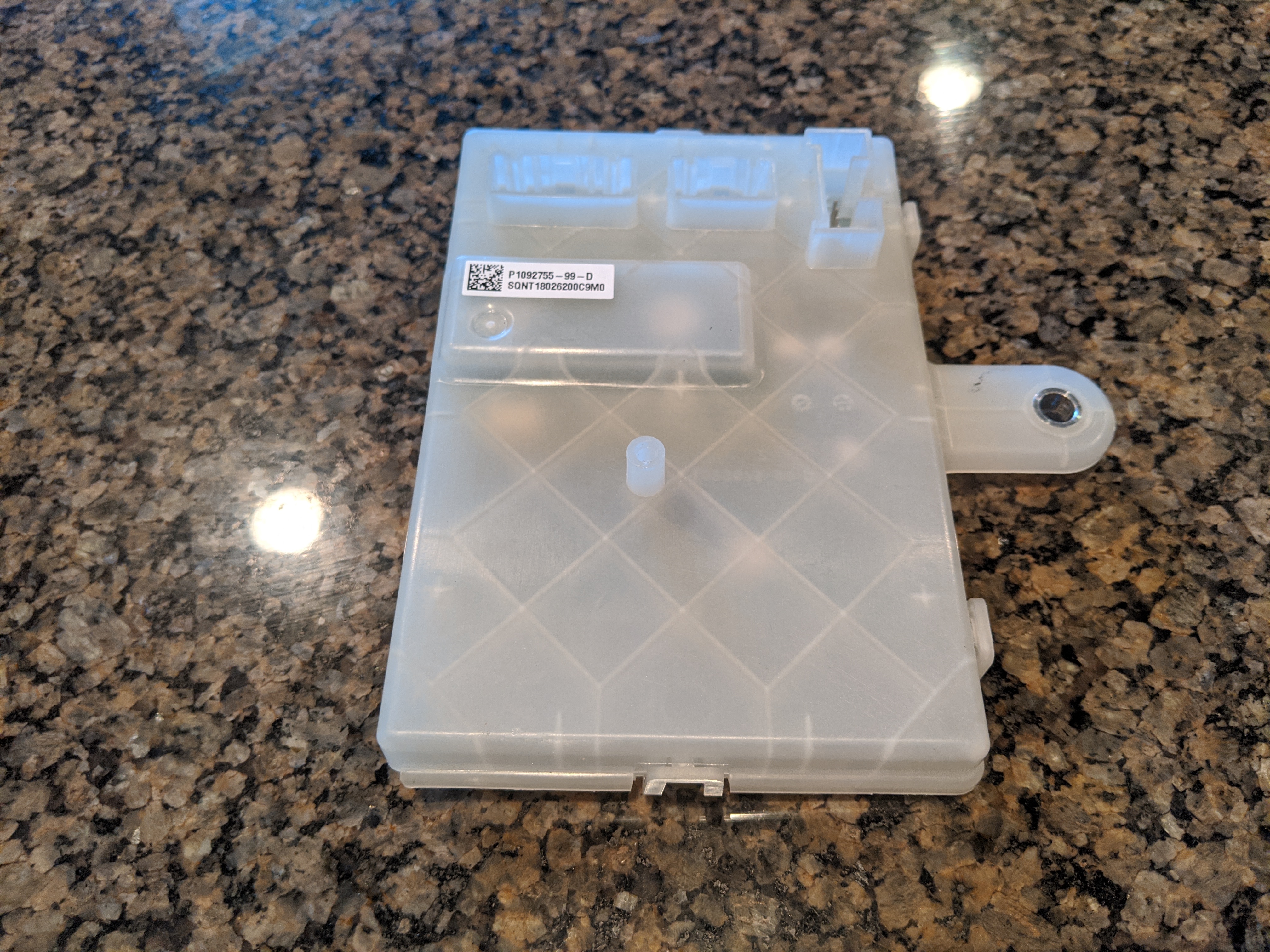

I also finally unpacked a LG battery:
I guess I should have unpacked it a little sooner. :D
For a size comparison...
As of today, EV West and Thunderstruck have no more of them. :(

Ordered a port + cover: https://www.ebay.com/itm/273925308022
Design is definitely different between S and 3, but in the SAE version (ie NA version) there's still some contactor fun that goes on in order to route the AC and DC to the right destination.
From my limited success so far, it does not seem to generate the fast charge ARBIDs I would have expected.

Well, this won't help on the CCS front yet unfortunately. It's a US spec controller, which means no GreenPHY and therefore no CCS. I've got the physically huge Tesla to CHAdeMO adapter, and that's how I logged the session. This is on my Model 3 Performance. The thought here is that:
a) I already have something else using the Tesla connector
b) The port isn't that expensive (you need the cover though - it's part of the HVIL!)
c) I have the CHAdeMO adapter
d) A working CHAdeMO port was about the same price
So why not use a port that is only slightly larger than a J1772 and allows for fast charge as well? If I didn't have a Tesla, I'm not sure I'd go this route. I'd probably buy a CCS port even if I only had J1772 for the moment. (Meta observation: I've gone the way of Apple. Ugh.)
I have some theories as to what is needed to make it go. I also think that too much traffic throws it into a CAN overload mode, which it may or may not recover from. So to confirm things I probably need to hack into the car side connector on my car and see what ARBIDs are being sent to it.
