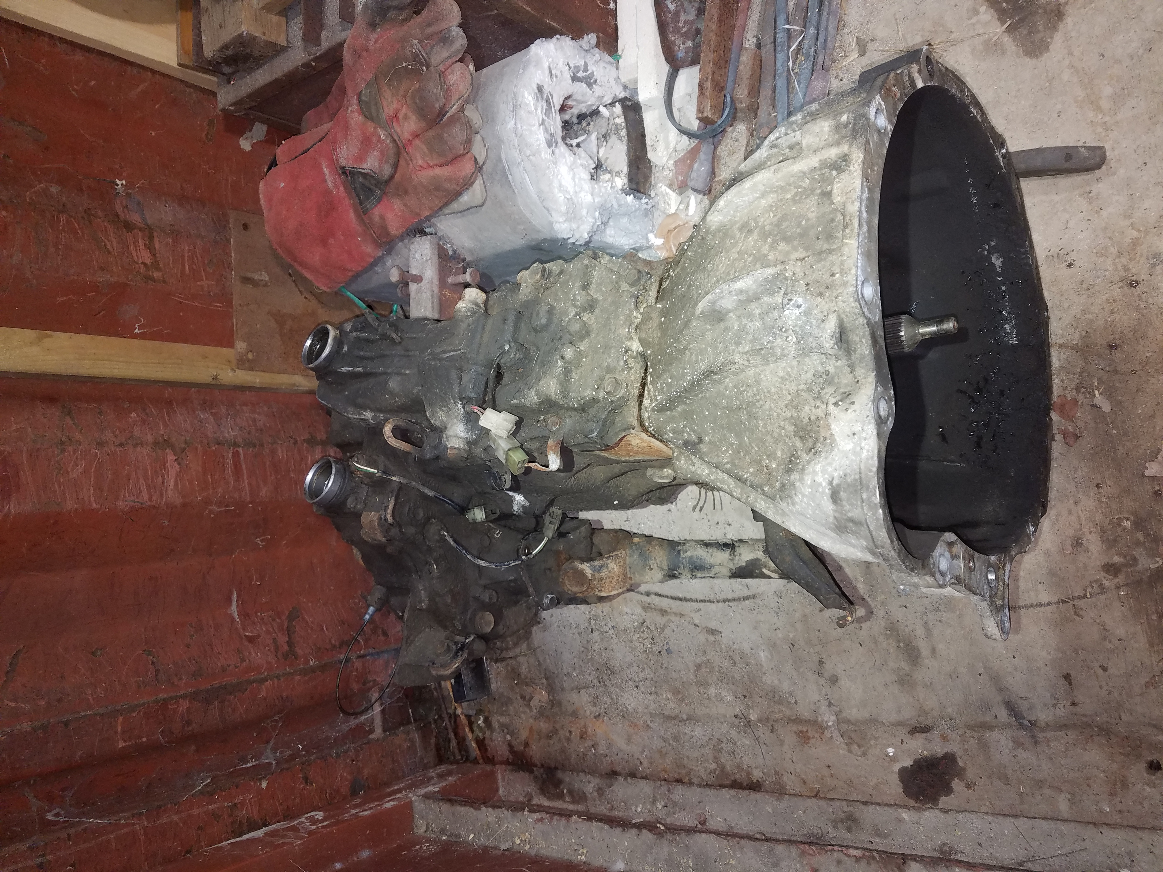

Fourtrak looks OK, if I mount to the bell housing I'm well forward of the T-case

Greenbeast wrote: Tue Dec 29, 2020 5:32 pm Fourtrak looks OK, if I mount to the bell housing I'm well forward of the T-case
It looks like you'll be OK there. Until I get my coupler I won't be 100% certain but I think it will be OK.
A mate from Landyzone is making it for me but he has had some major car issues recently that have held him back.

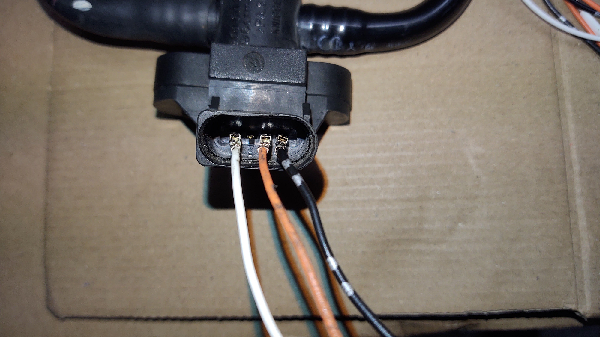

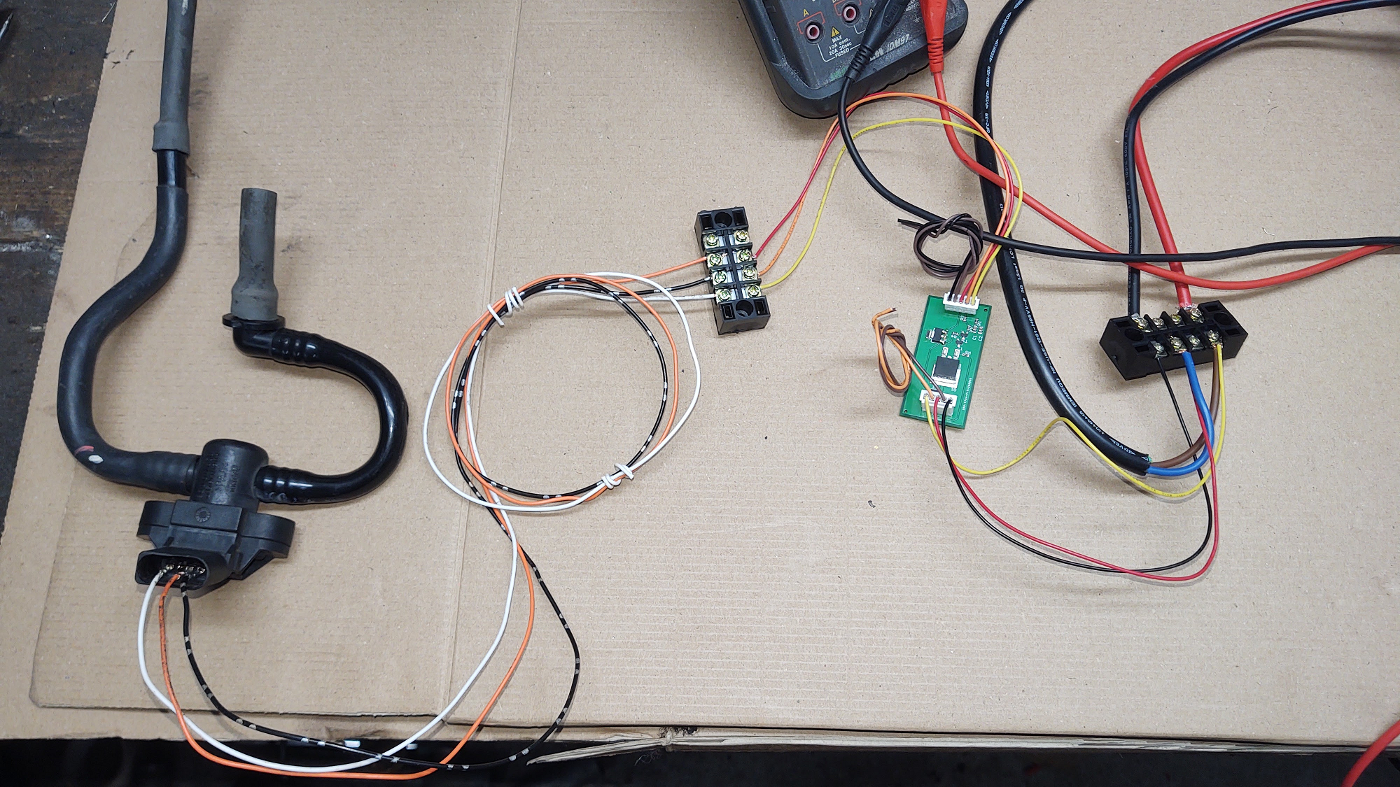

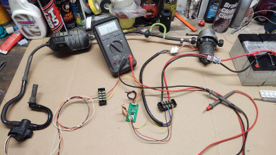

While I'm waiting for the coupler to arrive I'm doing other things that will need done anyway.
I bought a Zafira power steering pump but I think it's faulty as it spools up to full power but won't fall back to normal power.
So as the Zafira pump seems to be faulty I decided to see if I can drive the Freelander PS pump with an alternator adapted to run as a motor.
Also I've just tested the circuit board sent by Johu with the Audi sensor and pump and all working perfectly so far. :)
Thanks Johu :)
