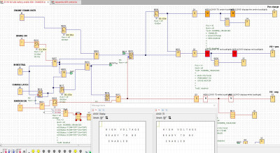

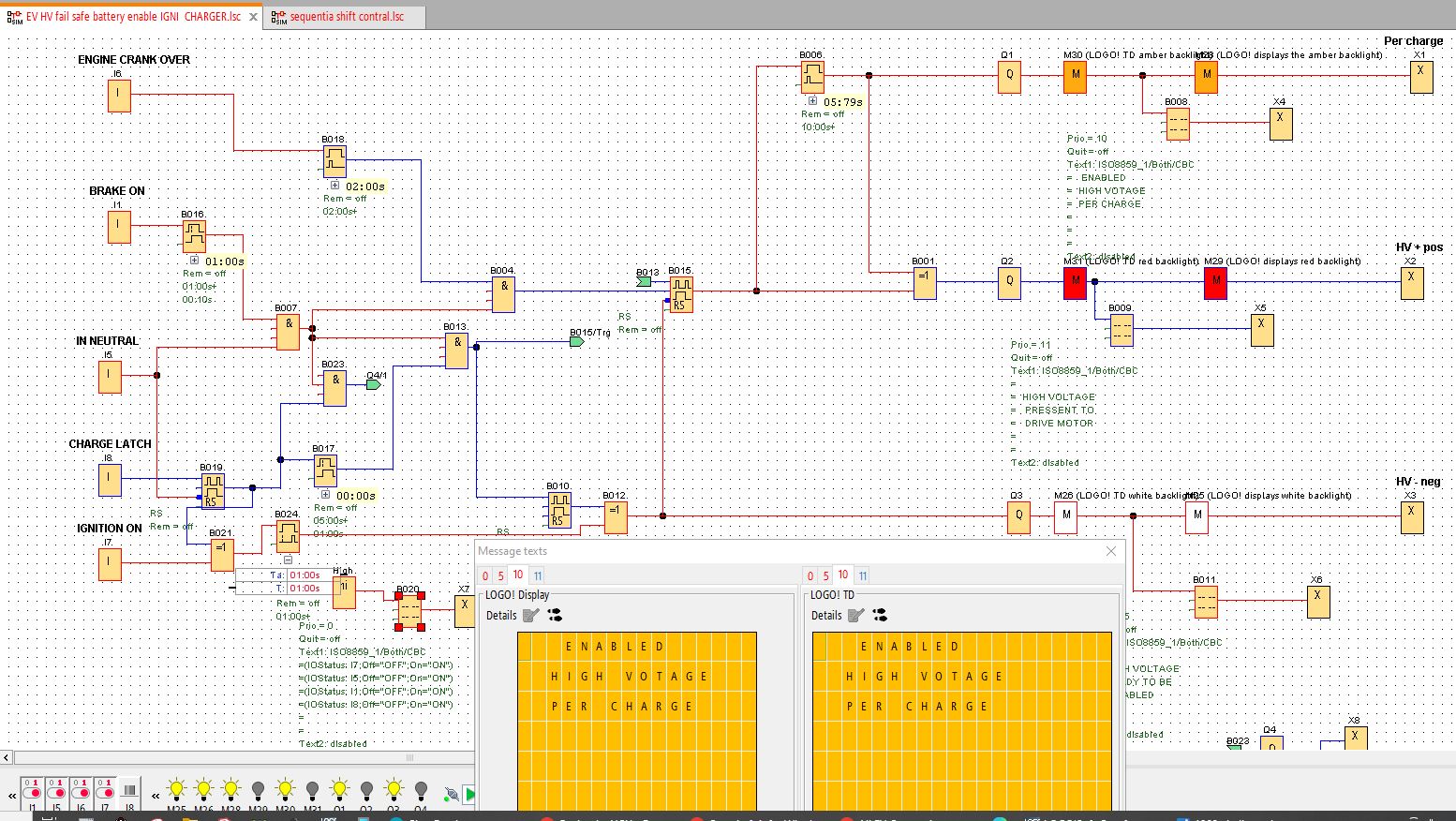

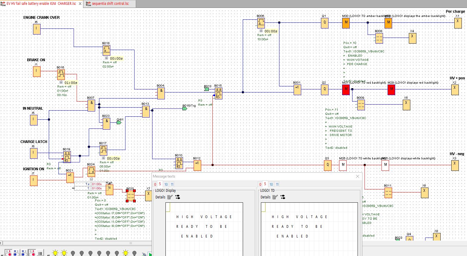

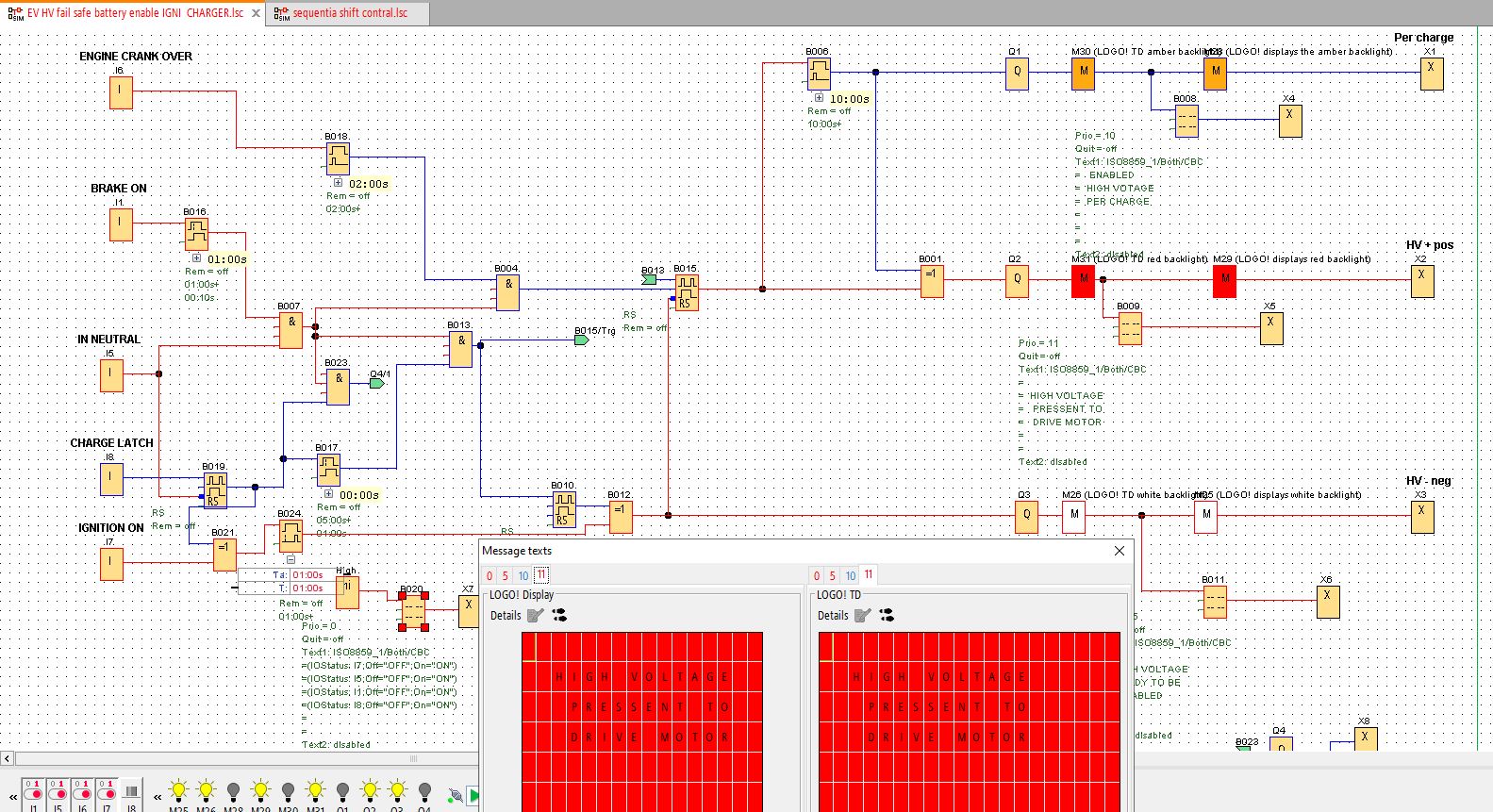

I will be use a industrial PLC siemens Logo8 with display for my High Voltage safety control.
Paul

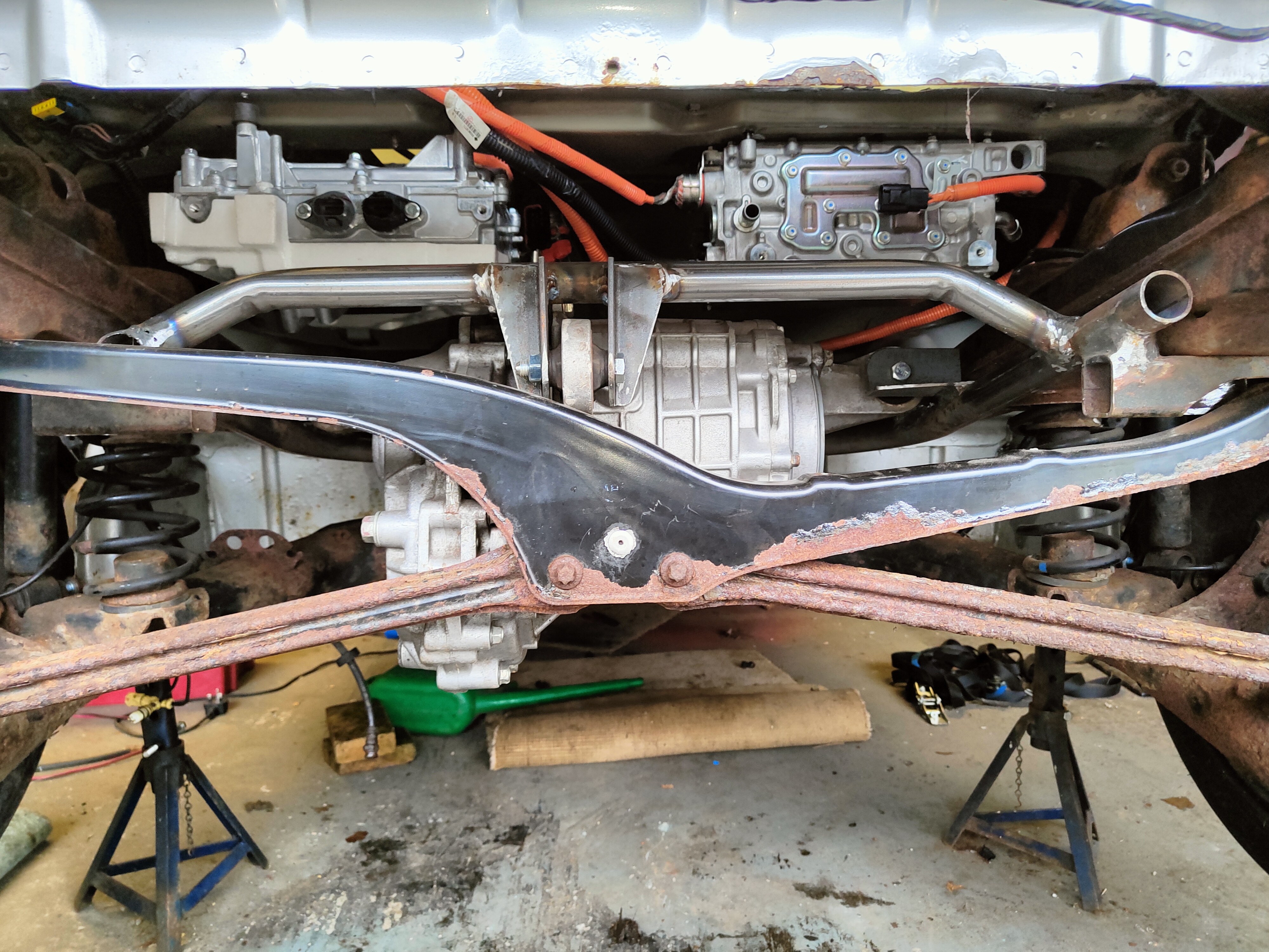

where in the ipace car is located the ISA ? I am going to search for a used one and most wreckers dont know what this part it is and where is located
aot93 wrote: Fri Nov 17, 2023 1:19 pm Hi,
I will send you a version you can test with via DM without the BMS hooks, there is not much to change just hard code some values.
As for chademo, I used an ISA from ipace, but there is no reason you could not use any kind of current and voltage measurement device.
EV_Builder
Posts: 1205
Location: The Netherlands
Has thanked: 18 times
Been thanked: 37 times
Post by EV_Builder »
In the battery pack.

is it inside this box ?
EV_Builder wrote: Wed Dec 13, 2023 8:24 pm In the battery pack.
Posts: 3796
Been thanked: 413 times
chentron wrote: Thu Dec 14, 2023 8:17 pm is it inside this box ?
Check this... viewtopic.php?t=1182
There are big fuses under the black plastic cover where three copper lines are leading on top of the batterry back to front.
There are large contactors and analog LEM current sensor as well.
