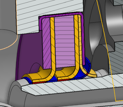

I made the attached slide to give to seal maker to engage discussion. Please free free to use all or part. If they can speak English, I can also join in german time zone (I'm in west coast USA)
Actually once initial parameters are fixed, we can also challenge additional consideration such as
- any benefit to cut concentric rings to aid bending for the tighter lips? (primary media facing lip)
- bi directional pumping aid? Or maybe single direction helix is okay since mostly forward? (would need to then make separate seal for Rav4 EV... I don't know MB's rotation direction) Or does pump aid's microstructure likely clog and become useless anyways?
- any chance for a slinger like shape to collect leak and route to exit in guided path?
If can reach beyond sales to engineering. Very desirable to hear their expert suggestions :)
Thanks!!!

muehlpower wrote: Tue Dec 06, 2022 10:21 pm If I summarize, I come up with a PTFE seal and a good shaft that only needs to be polished, or the use of a speedi sleeve with something for better heat transfer. The PTFE seal would then be the same. So I will ask GFD what the best material and design is. Shaft 55HRC, Ra 0.4µm, medium water/G48, speed 28m/s, pressure max 0.3 bar, temperature max 90°C. And what he thinks about a diameter of 30.5 with a sleeve instead of 30. Did I forget something?
Seems correct and mildly conservative, which is good. Maybe the 28 m/s (seal slip speed) is a bit high because it corresponds to 250km/h = 155mph for my wheel size. Maybe use 137km/h = 85mph -> 16m/s seal slip speed, which may open up a larger solution space for seal designs? Unless faster driving is a desired.
Also the max coolant pressure could be higher: 1.3 bar (source).
Also mention, just to be sure, that the seal should seal both statically and bidirectional dynamically (duh) and that the shaft is horizontal.
Maybe also request a dynamic service life of at least 500 hours (500 x 100km/h = 50000 kilometers)?
Also there is a bunch of dimensional constraints like the primary lip (touching the coolant) can stick out no further than 2mm from the housing because if more, it may rub the shaft chamfer edge. Also the excluder (if any) cannot stick out further than 3mm (assuming 8mm thick housing) to avoid touching the shaft chamfer edge for the reluctor wheel. Also not sure what the best interference fit size is, i.e. best outer diameter for stainless steel housing (Ceimin is 55.2mm I think).
Disclaimer: Despite all efforts, all (which I write) should be conservatively interpreted as a poorly informed, error-prone, non-expert opinion that is subject to continuous change, especially in this age of hyper-specialization and newly gained insights.

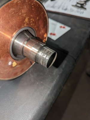

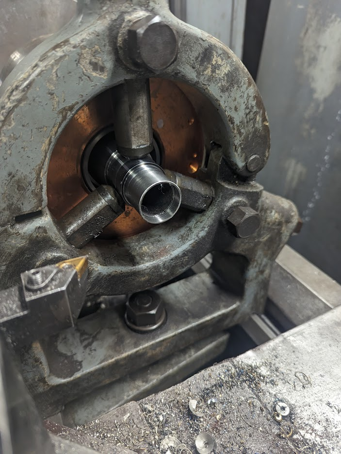

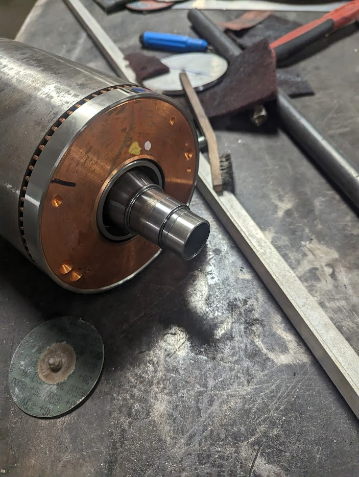

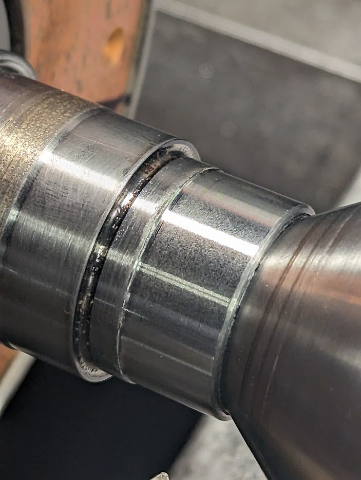

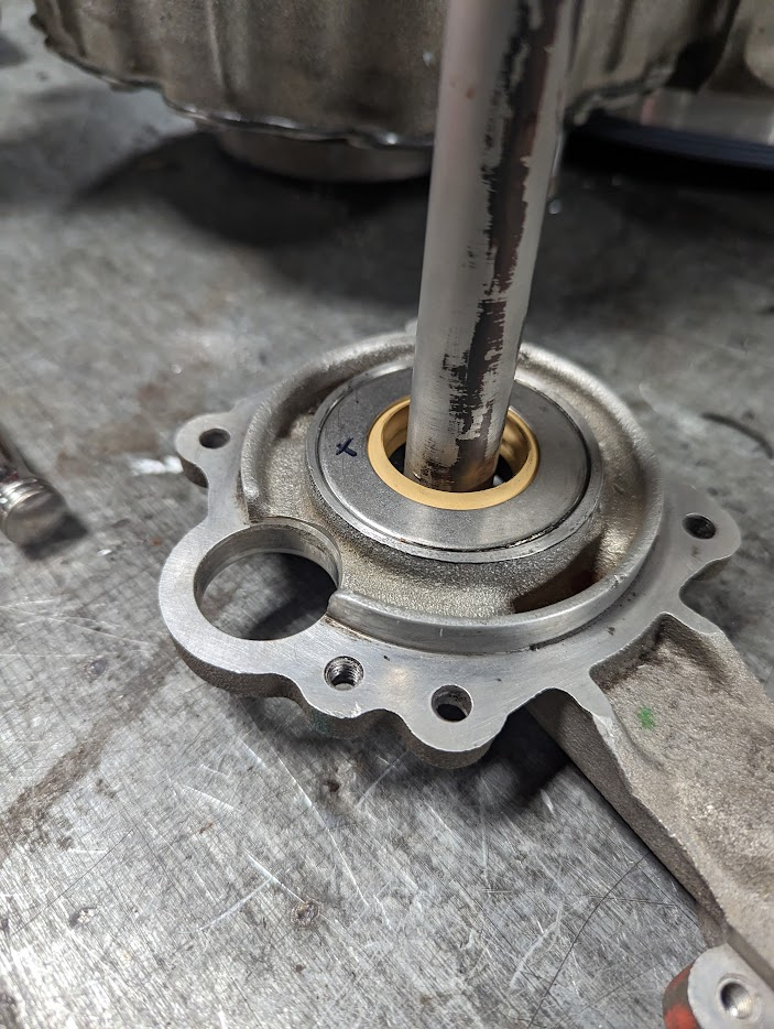

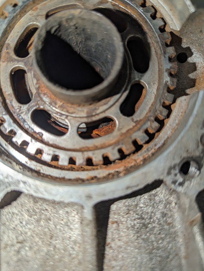

Shaft Surface Damage
Been thinking about shaft damage source and repair. Here are some thoughts. Note it is mostly just guesses, no way to confirm without lab level material analysis

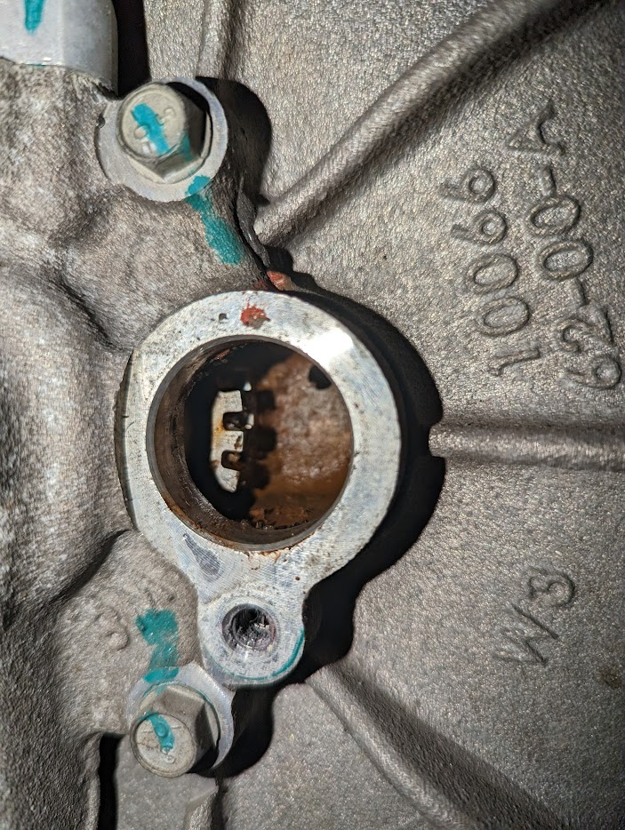

Corrosion Damage
EV builders that source salvaged LDUs which has been sitting around awhile shows high rust/oxidization damage. Here is @Boxster EV's original pic
viewtopic.php?p=36449#p36449

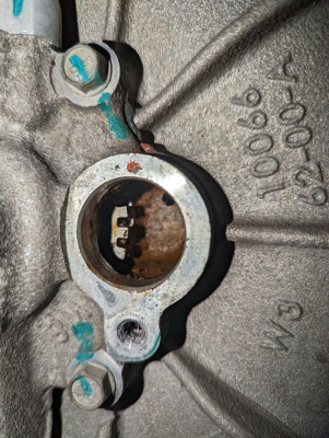

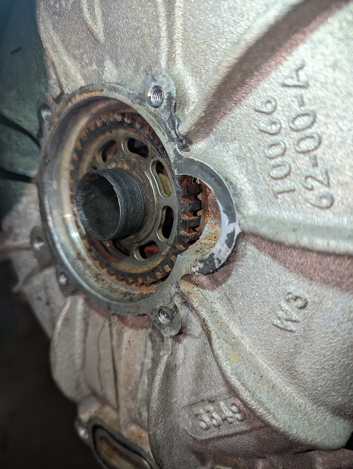

Here is a pic of another Porsche EV builder recently reached out to me for LDU seal repair. This LDU sat idle (drained with whatever coolant trapped inside and no drain path in reluctor chamber) for 2.5 years. Installed and pumped with coolant 1 year ago. Manifold just pulled and reveal this pic
This info + what we have heard on shaft metal material suggest it is not stainless. Johan did some guesses and I revised my post on shaft hardness to reflect this thinking it is maybe hardended 1045 steel.
viewtopic.php?p=49511#p49511
Note the seal is a triple lip seal. LDU was a T13 (originally 2013 made) Rev Q Reman

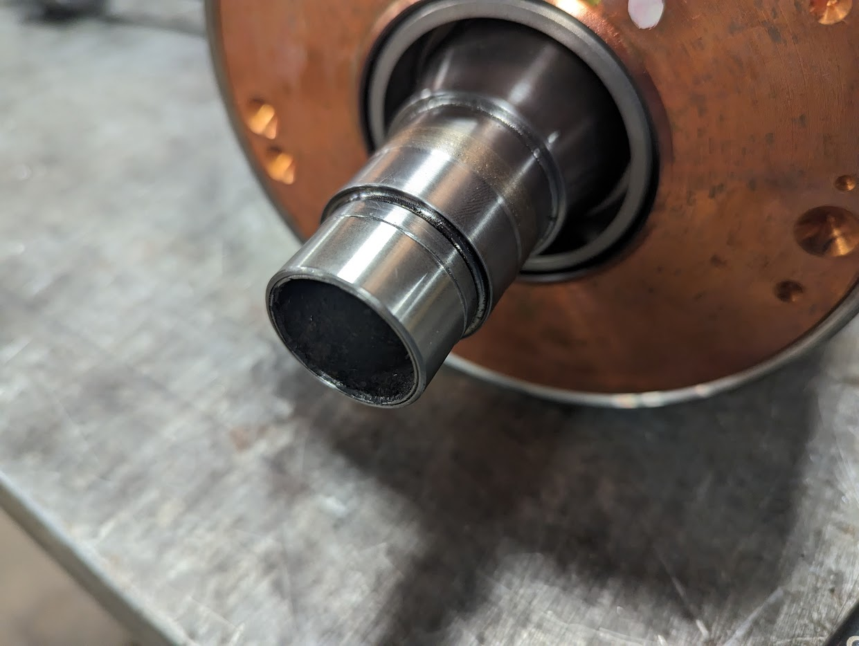

Seal/Debris? Damage
Scientifically, we've been very focused on PTFE lip material hardness in relation to shaft hardness. But the close up on wear pattern may suggest differently...
Here are some close up on my shaft surface before and after 600->1500 grit prep
Here is @Wim_V's shaft with triple lip seal. We can see the accumulated debris on the rotor facing side of the lips
viewtopic.php?p=46359#p46359
Similar rotor facing side lip surface debris is present on my single lipped seal
viewtopic.php?p=46858#p46858
Given the location of the wear on mine and WimV's shaft, it seems to suggest the shaft scoring might be on the dry side of the lips by debris rather than the PTFE lips? If so, perhaps triple lip with its trapped region between the lips could retain debris including any dislodge lip material and cause scoring? AND maybe this is why Tesla rebuilds shifted to single lip?
Debris is probably left over solids after vaporizing the leaks water content?
What happens to the vaporized water from the leak?
Assuming PTFE lip are hot from friction. Wonder what happens to the water content from minute leaks on the dry side? Would they steam/vaporize and expand? Where does the expansion go inside the triple lip seal? Cavitate back towards media btw the 2 media facing lips chamber and exit the excluder in that chamber?
These are all guesses of course, but putting it out here for all to consider since we have so little data and no lab material study results.

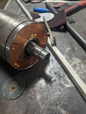

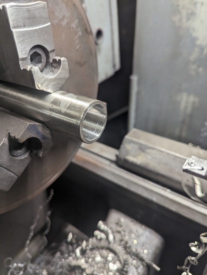

Spray Metal Deposition Shaft Repair
Was curious about what is involved. Here are the Ukraine rebuilder's quick video. Turn on CC + auto translation can hear what they are saying
Youtube shows machinists doing this.

@muehlpower
If GFD engineer has interest to include a sling. I don't know how to solve mounting problem. Coolant seal bore and shaft are on 2 different body on LDU. Mounting 2 object with sealing interface (object A to shaft and object B to body) in LDU seems not possible with LDU design? 2 face seal, isolator, slinger all have same assembly problem.
If they are interested and have answer, I am very interested to know. I make new version of design request (PDF attached), pg18 include this picture and explanation.
coolant seal design request.pdf

@muehlpower
Maybe this is better slinger design. But we better ask experts if they think solution is possible. v5.0 of design request attached.

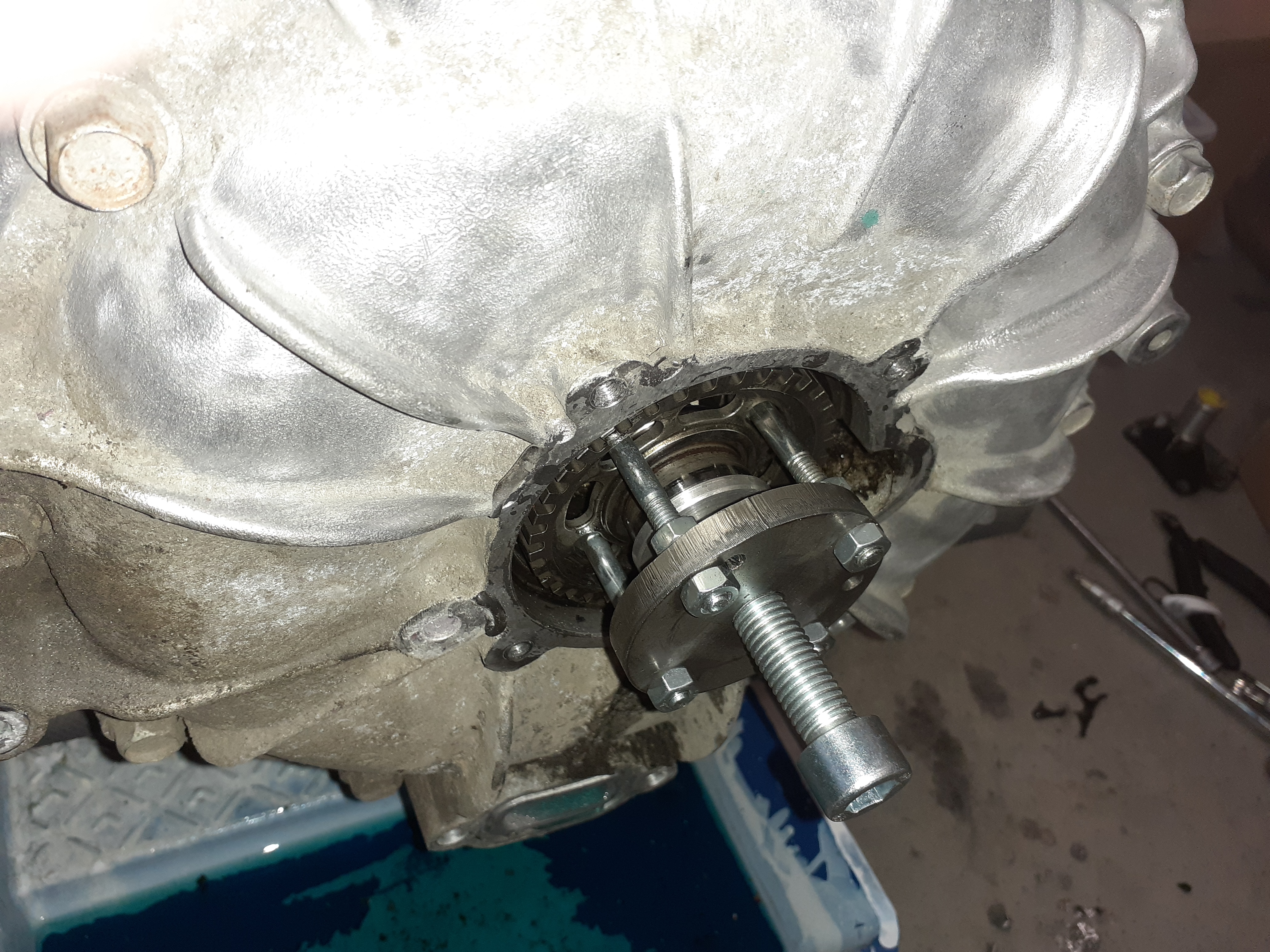

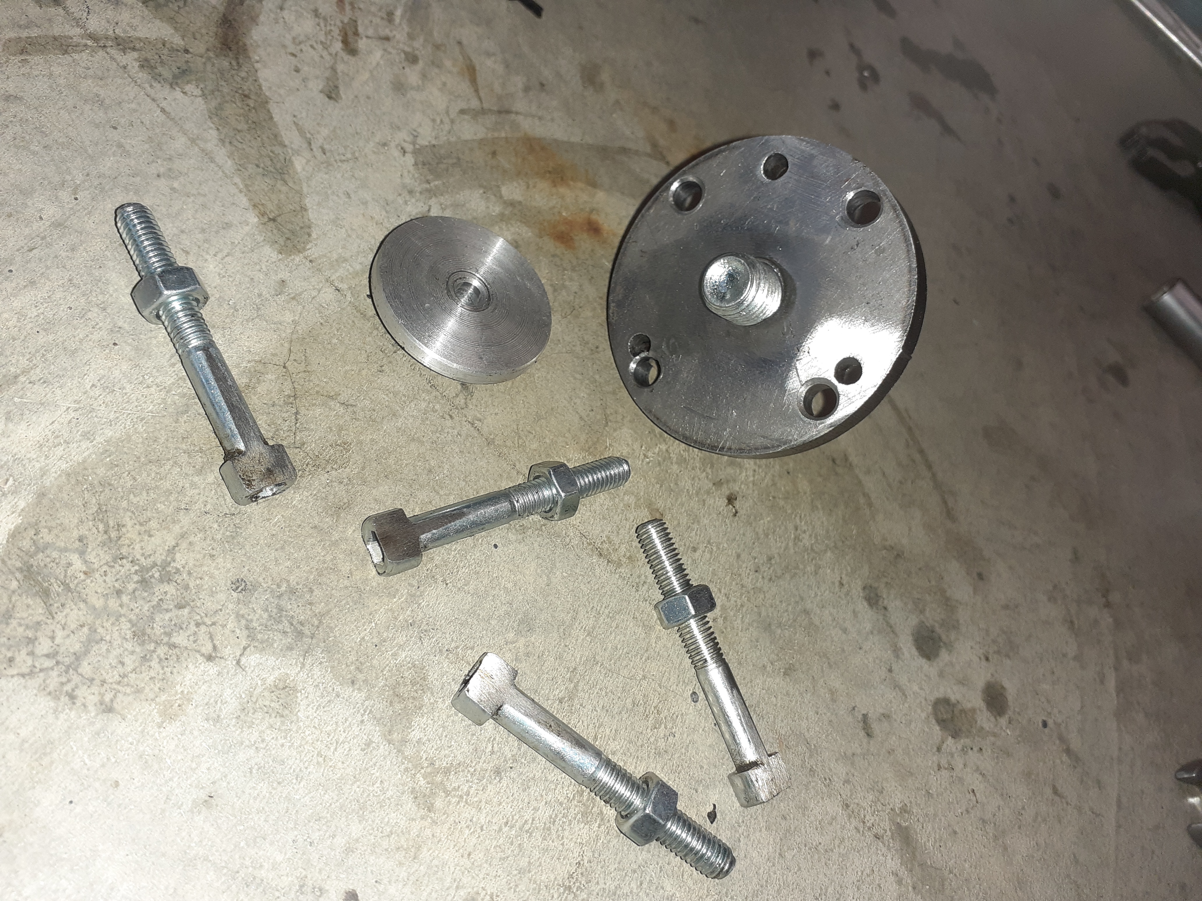

A little tool I made to pull the gear off. Should also work to dismantle a Speedy Sleeve.

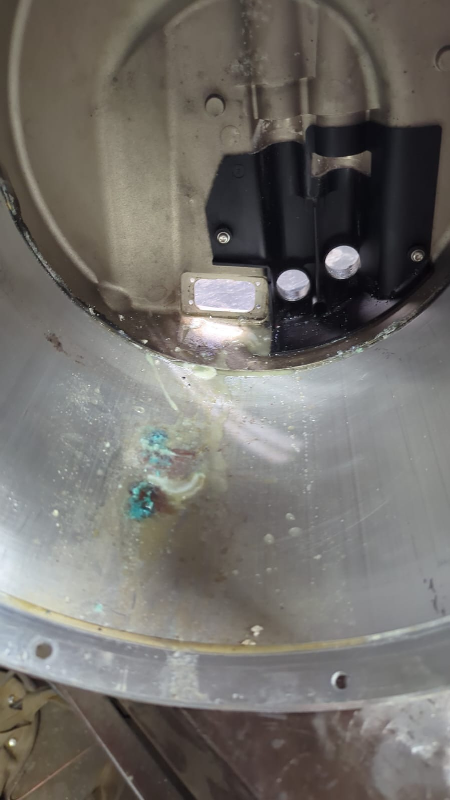

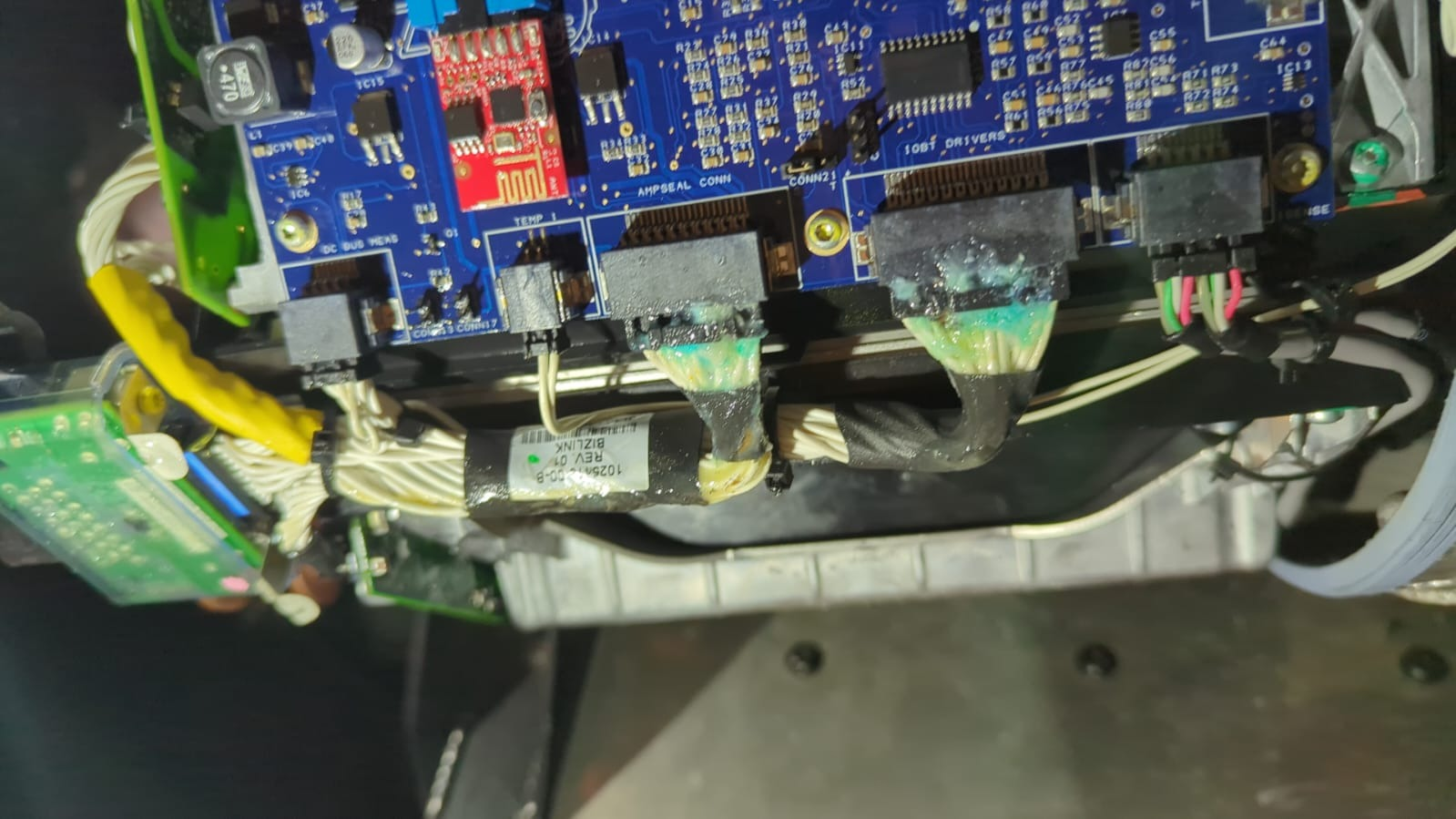

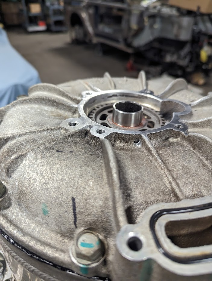

I wanted to share my coolant leak experience, since it is now "patched up" thanks to the help and resources of Howard. I believe he shared some photos already, but I obtained my LDU back in 2018 and it sat for a little more than a couple of years before coolant was added to the system and then maybe close to another year before the coolant was running through the system with pumps on a regular basis with testing. I got about 90 miles of driving before the erratic behavior began. I posted about that on here before I knew the issue. It started with losing power on braking and having to be towed home in shame :cry: . . . and then the overcurrent issues that I thought was in the programming . . . and finally the pot settings went awry and the temp was reading -1230 c, which is below absolute zero!!!!
I was assuming the card was bad and when we opened up the inverter to replace the card, we saw the coolant invasion.
This meant we needed to check the other side of the motor and sure enough . . .
After cleaning off the rust, it was clear the shaft was pitted, which was not unexpected by Howard.
CONTINUED IN NEXT POST
jsimonkeller
Posts: 112
Joined: Sun Oct 30, 2022 2:21 am
Has thanked: 7 times
Been thanked: 9 times
Post by jsimonkeller »
CONTINUED . . . .

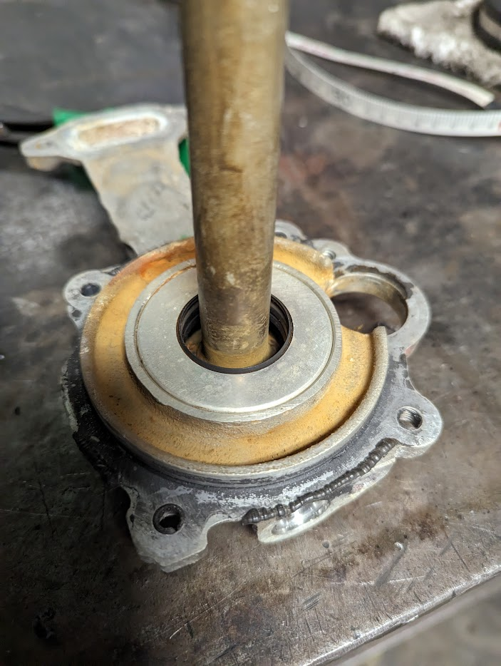

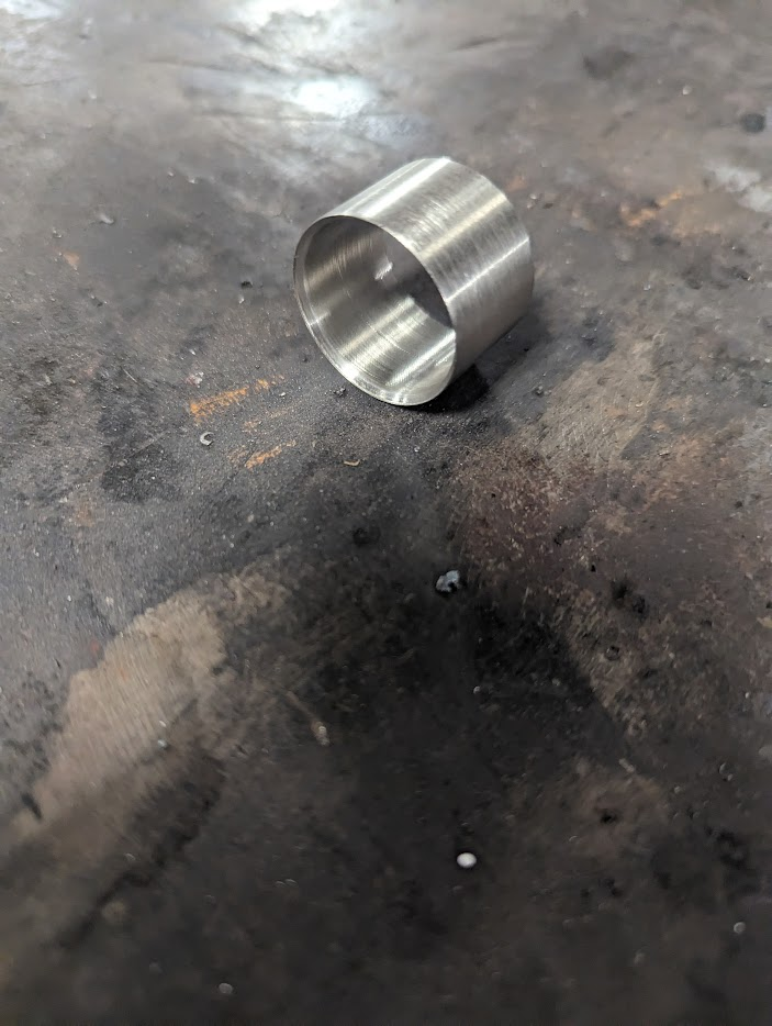

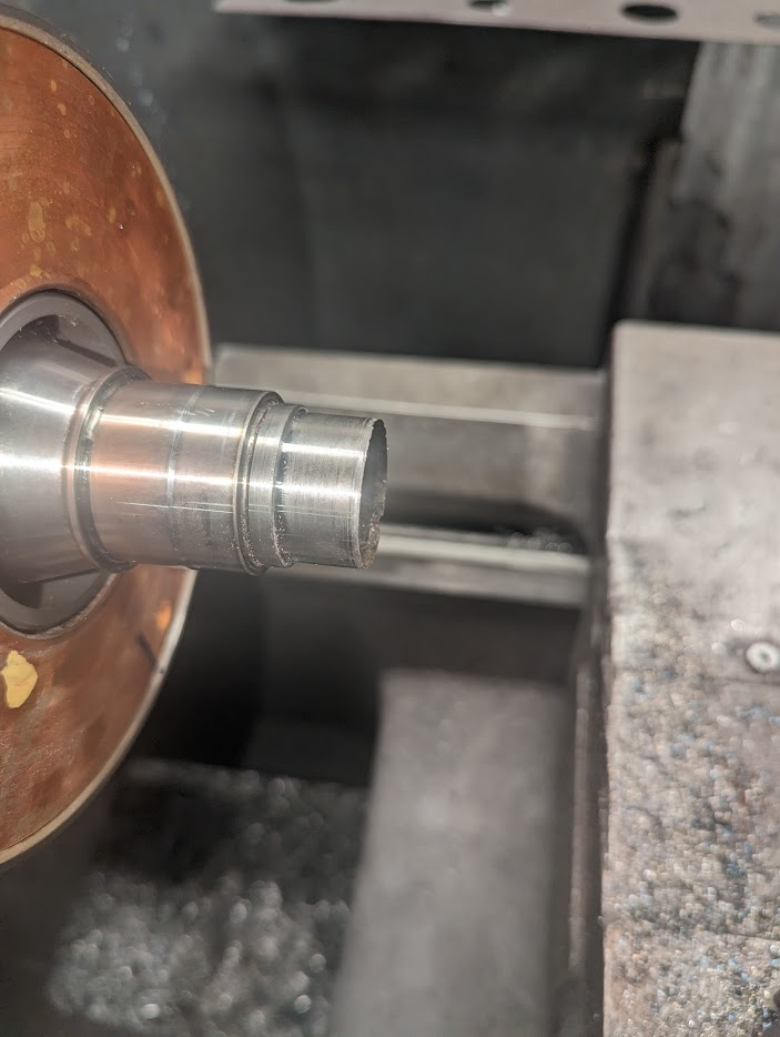

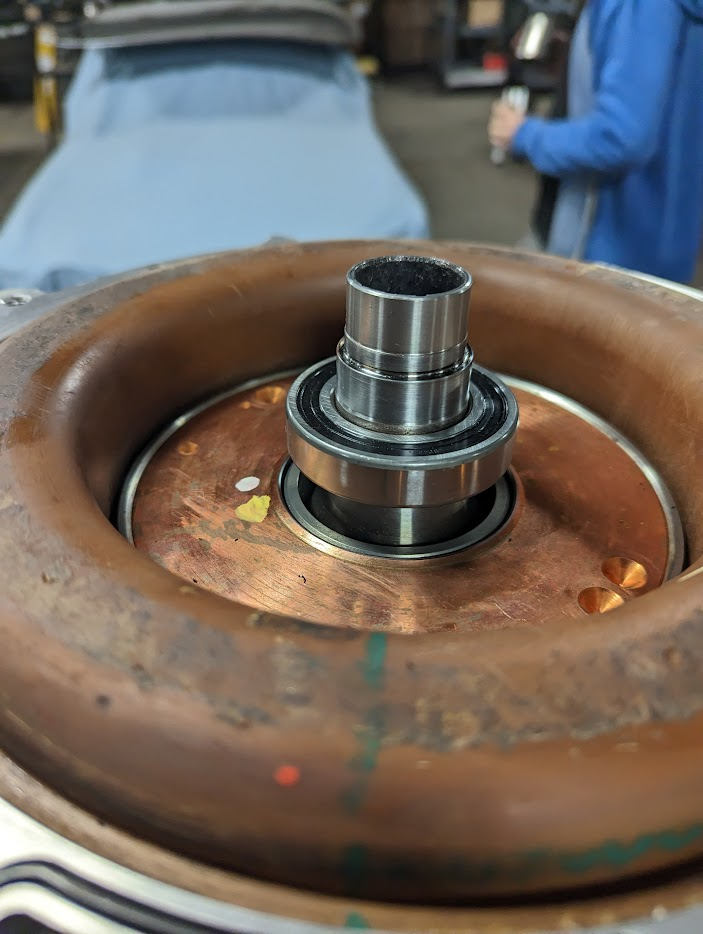

Howard explained all of the options and since my car was in a shop with lots of cool tools and my partner on this build has a lot of experience in metal work and welding, we went for the option to undercut the shaft and then add a new outer sleeve of stainless steel at the same length as the shaft to accommodate the seal.
We closed up the breather hold and drilled out the new emergency drain and set the new seal (courtesy of Howard's stock) and re-installed everything.
We also added drain holes on the Inverter side.

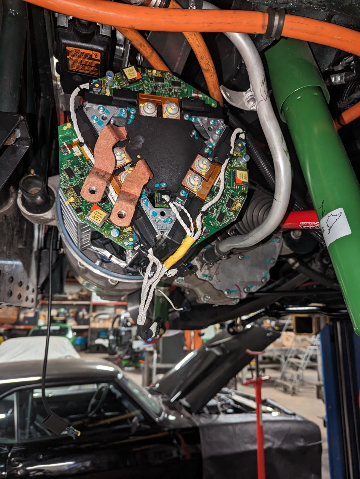

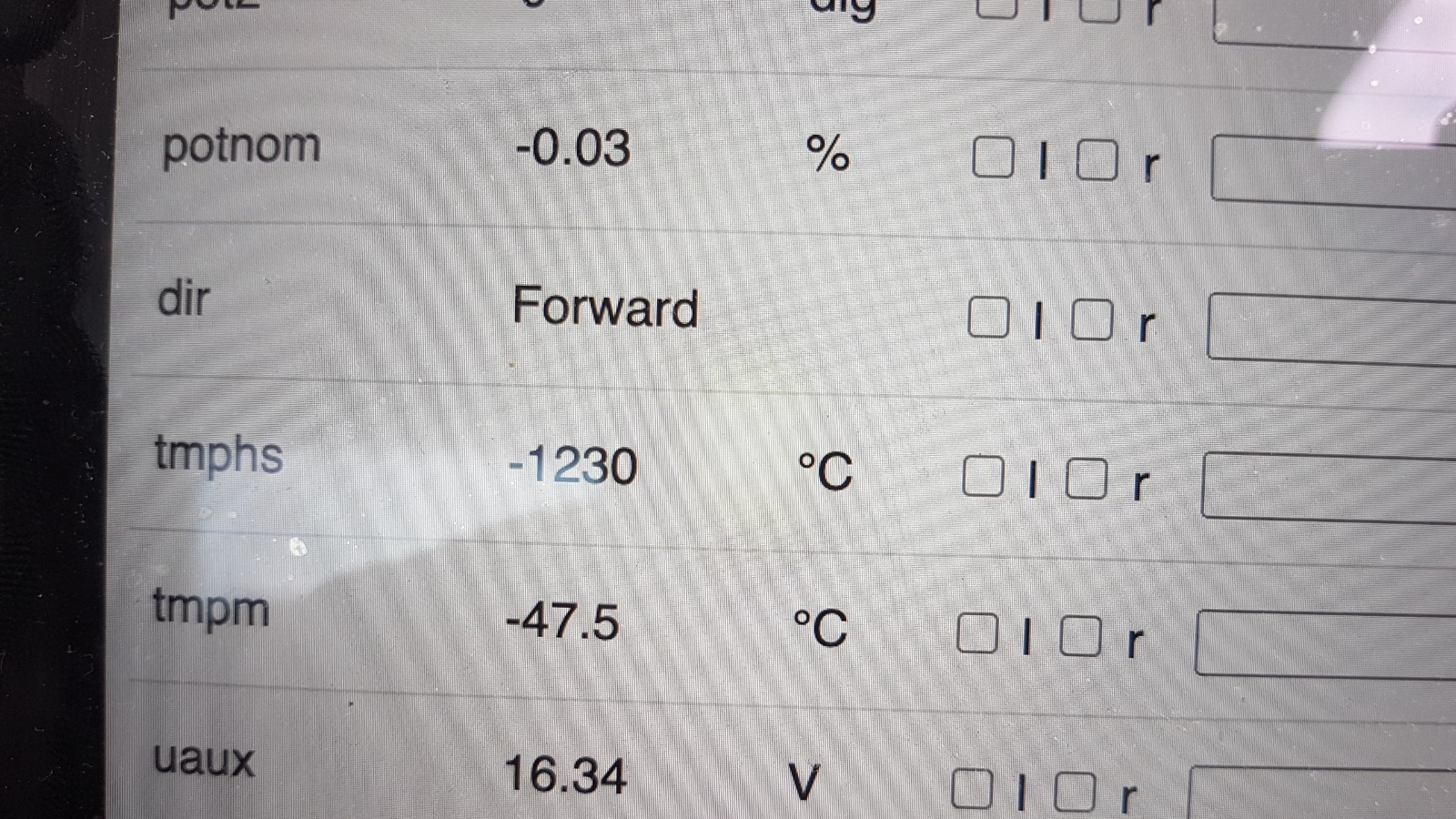

I am reusing the DU card that was in there during the coolant leak, along with same harness (thorough cleaned) for now and it powered on fine and temp readings are correct again and pot nom is back in line with where it should be and voltage readings are accurate.
I am getting NO ERRORS at the moment BUT the OPMODE is staying in OFF and I have not been able to get it back to ON. I am trying to determine if the card just has some damage I cannot see that is causing this or if the inverter has any damage. No visible damage to the inverter.
I am not sure if there is any troubleshooting anyone would suggest at this point. I plan to swap the card out for an older one I have in a box somewhere to see if that solves the problem and answers the OPMODE not coming on and damaged DU card issue.
