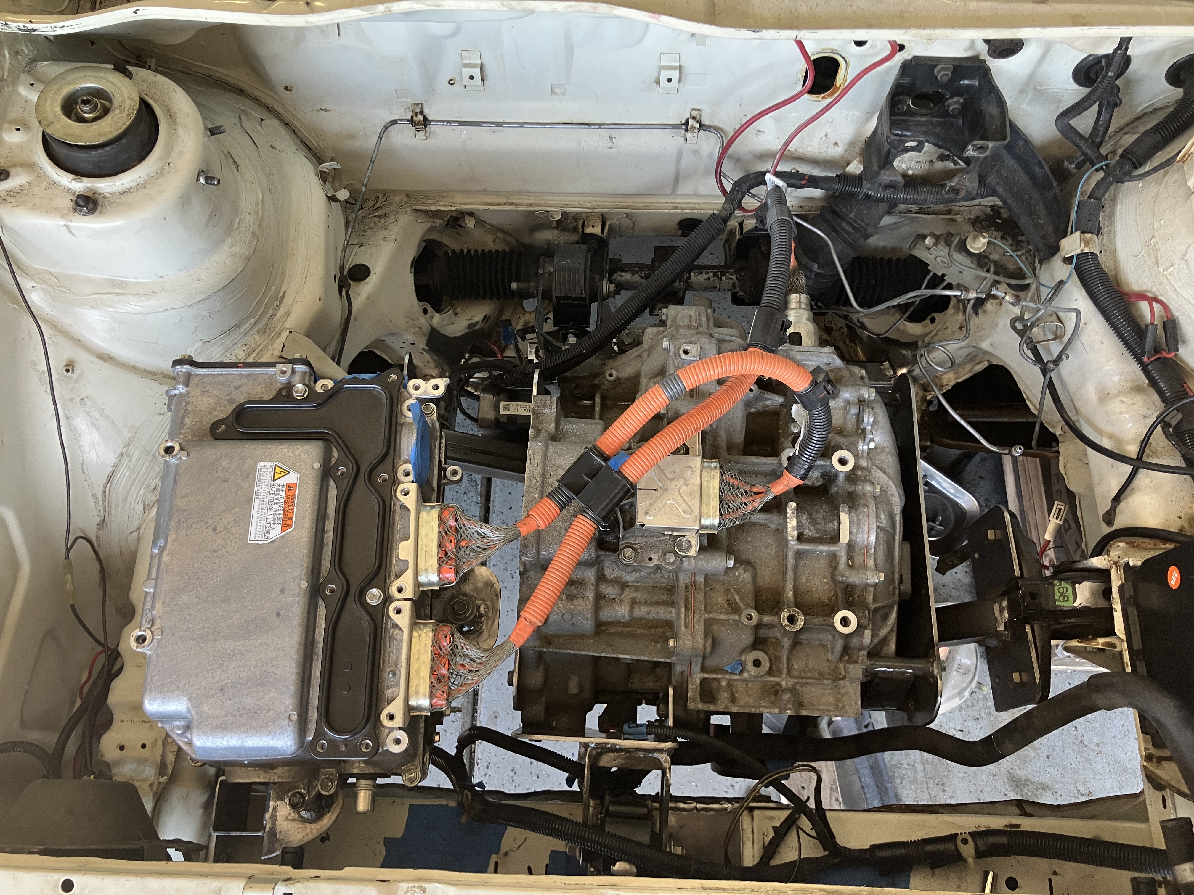

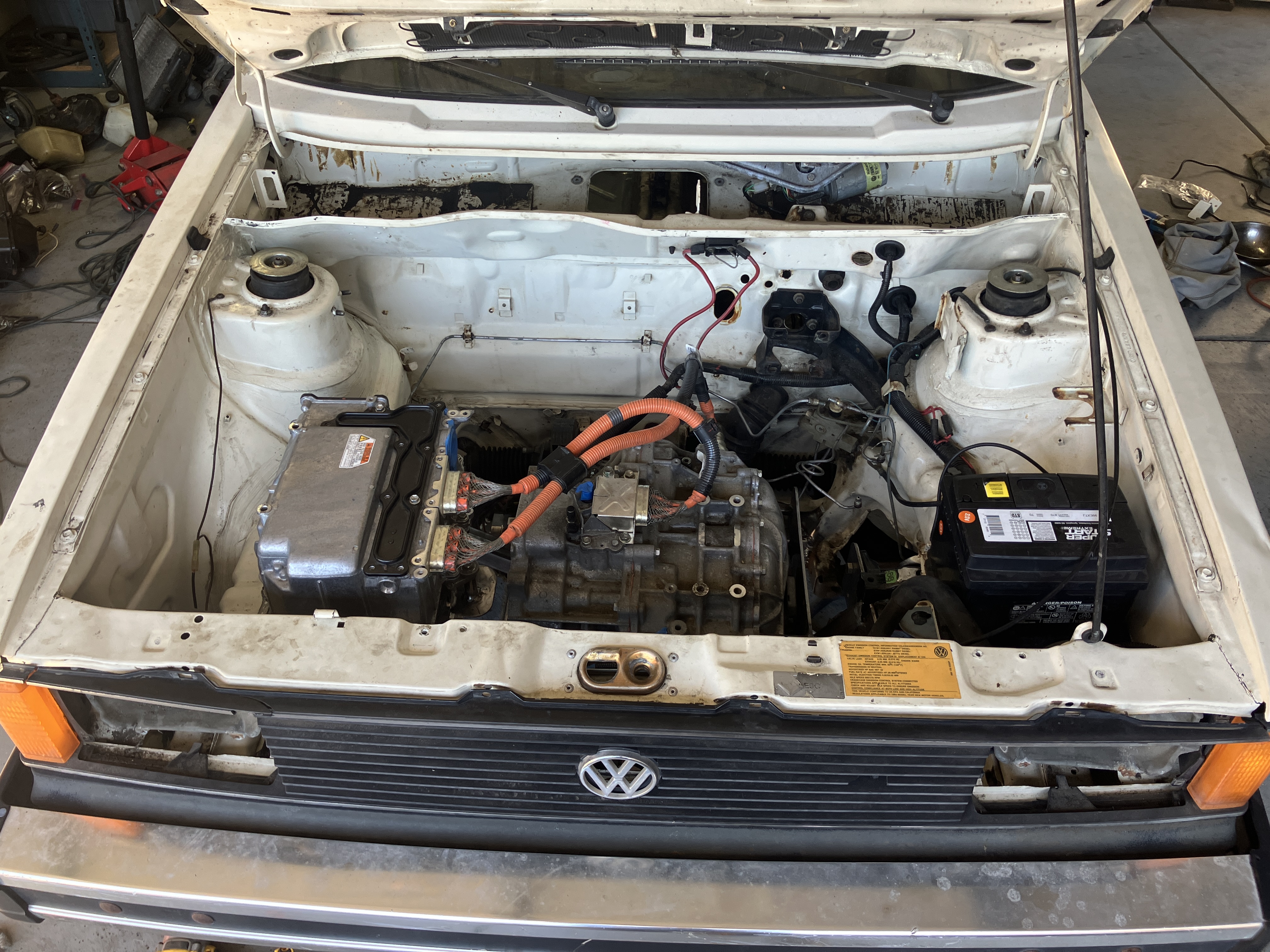

couldn't wait any longer, had to tether the Prius transaxle to the newly installed inverter with the orange jump ropes

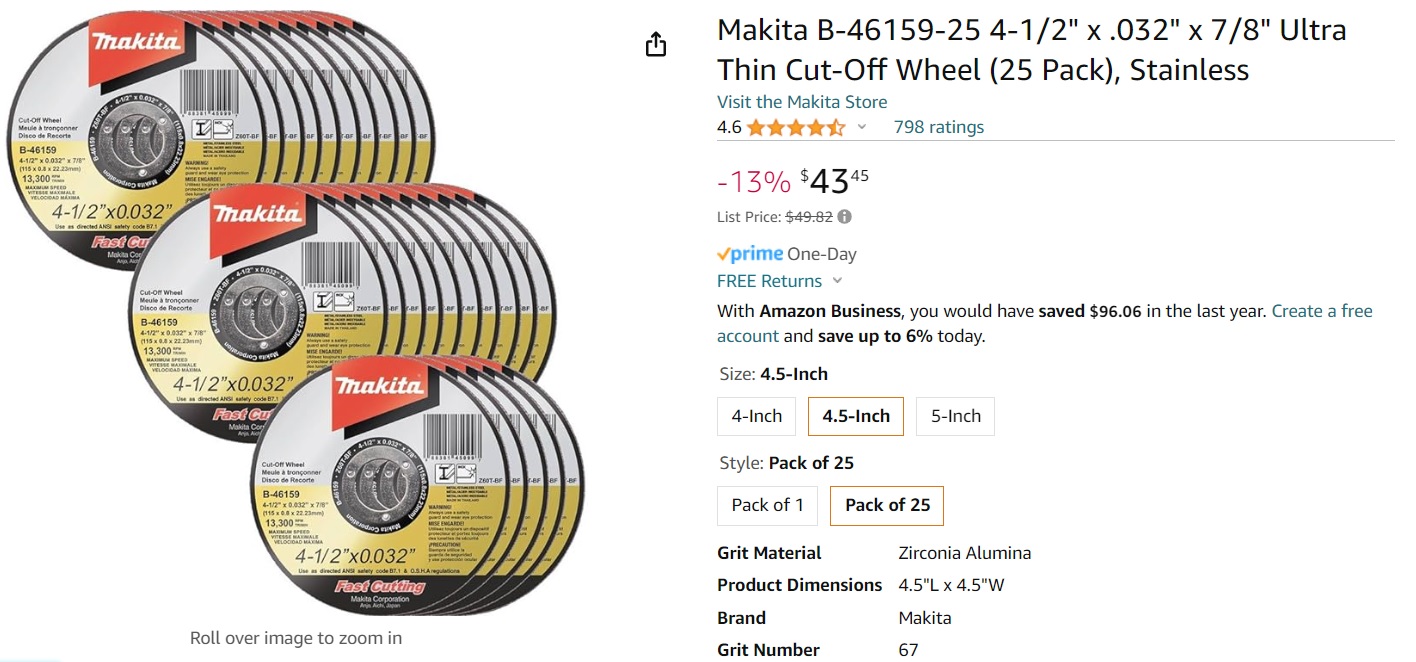

rstevens81 wrote: Thu Mar 21, 2024 4:56 pm PS you need to get get sponsorship ...from angle grinder manufacturers :)
ha ha, I'll settle for the cut off discs - wonder if Costco sells them?

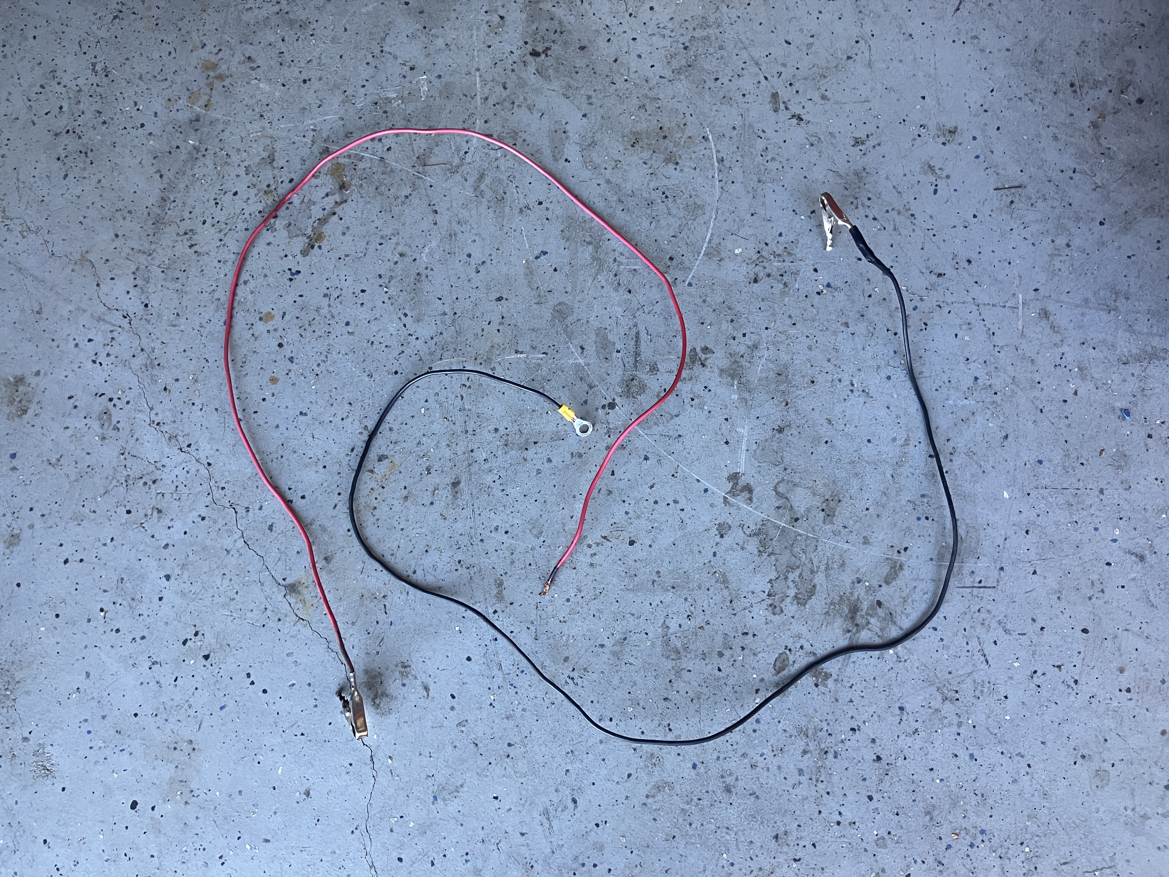

Gregski
Posts: 2744
Has thanked: 501 times

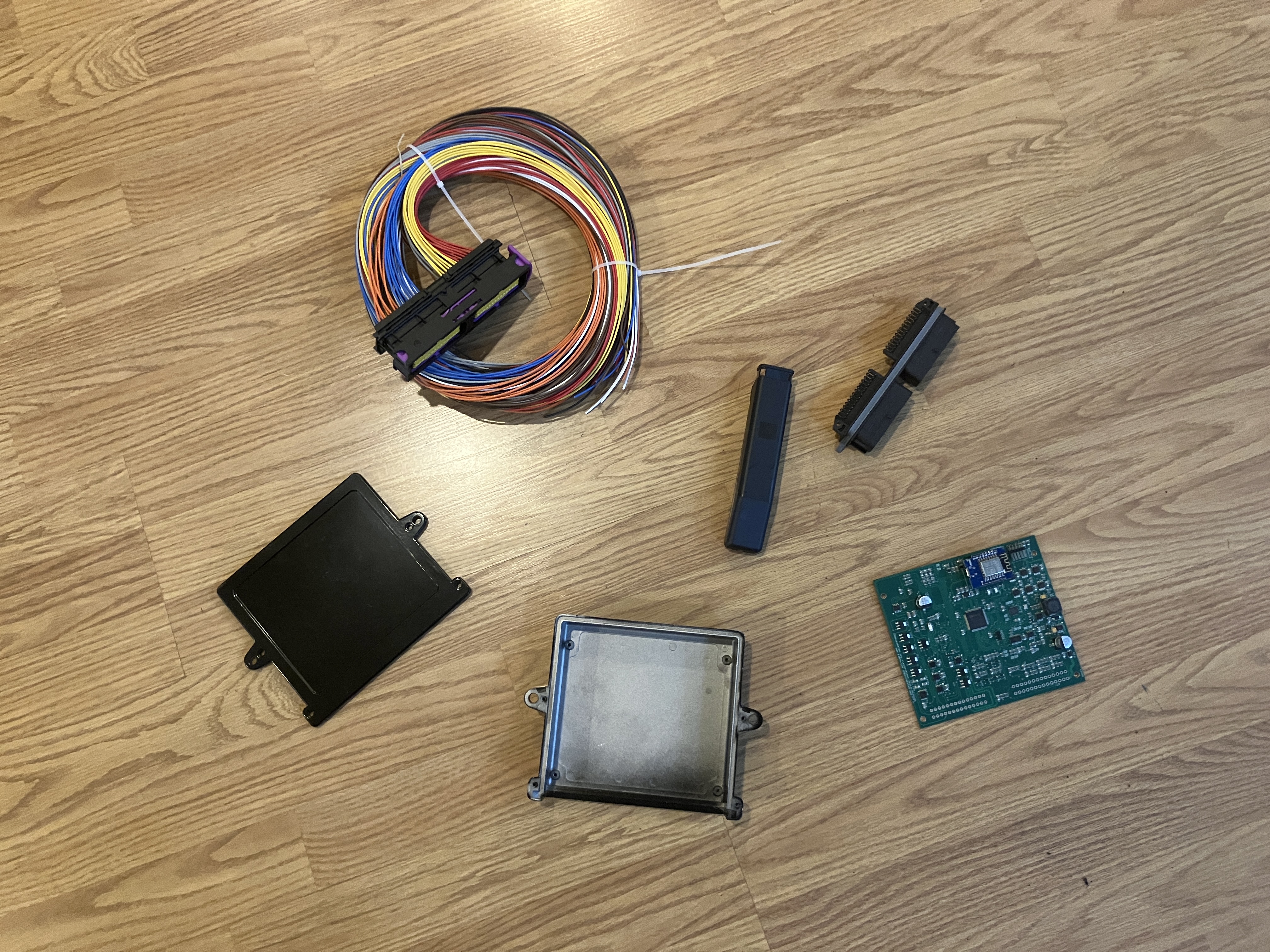

Re: 1984 Voltswagen Rabbit Prius Gen 3
Post by Gregski »
it's raining out so I'm jumping around a little bit (order be damned!)

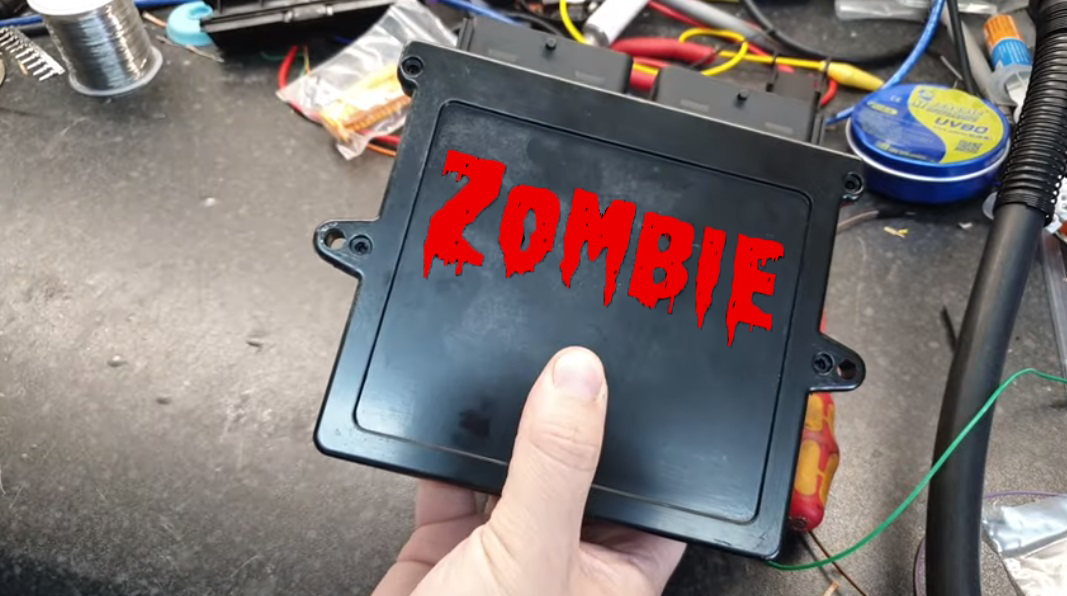

Thanks be to Mr. Damien Maguire of the EVBMW.com fame, and all you Reverse Engineers here on openiverter.org

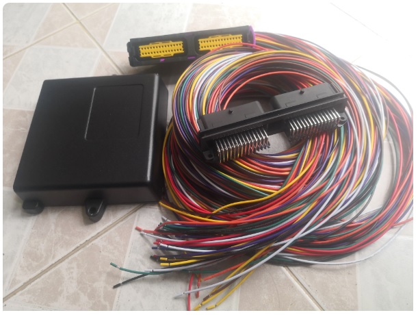

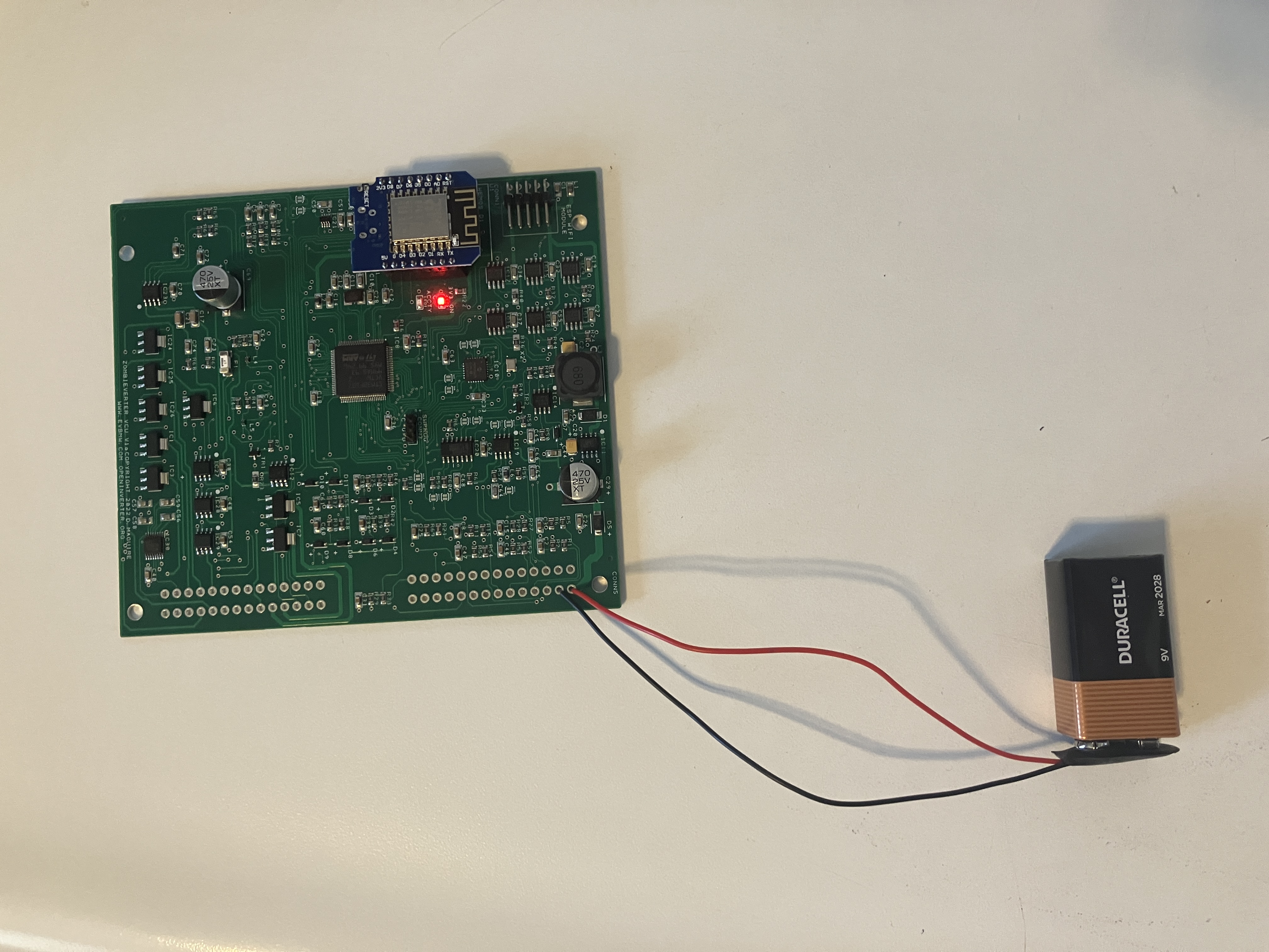

there's 5 ways to power this thing up, and here's one of them, just a dime a dozen 9 volt battery - luv it !
the blue thing is a WiFi card
sourced from AliExpress FCI 56 Pin/Way Female And Male ECU Connector Plug With 18AWG 3 Meters Full Wire Cable With Shell 211PC562S8009 211PC562S0008 $90 bucks

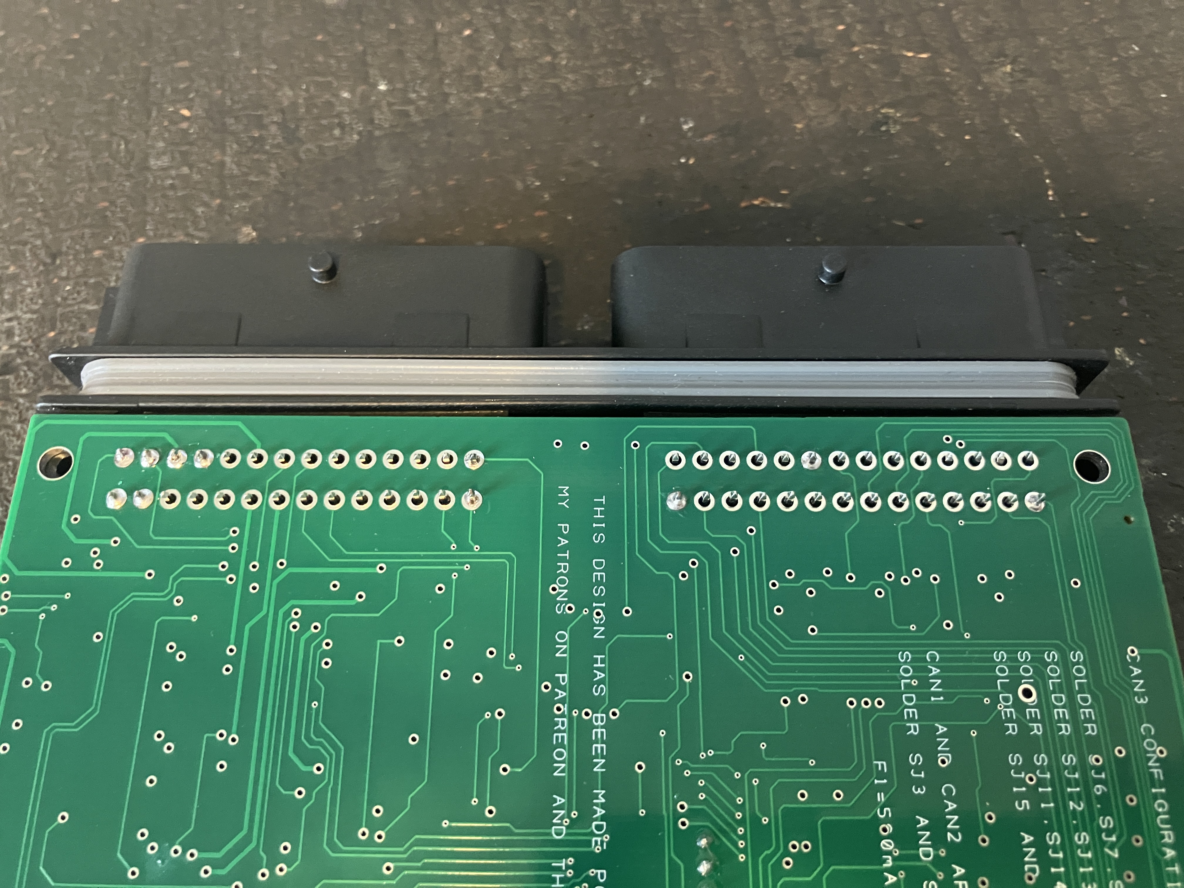

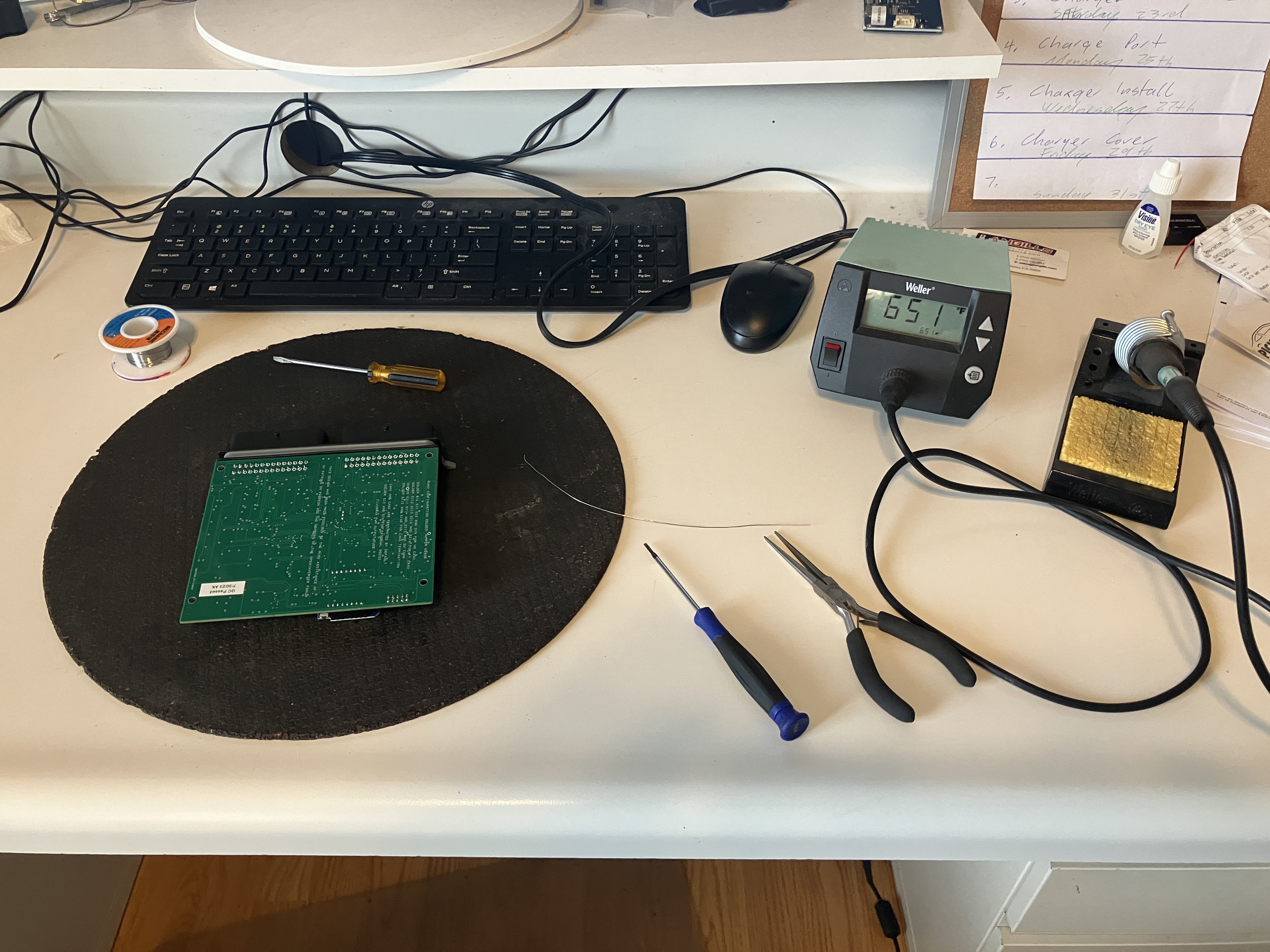

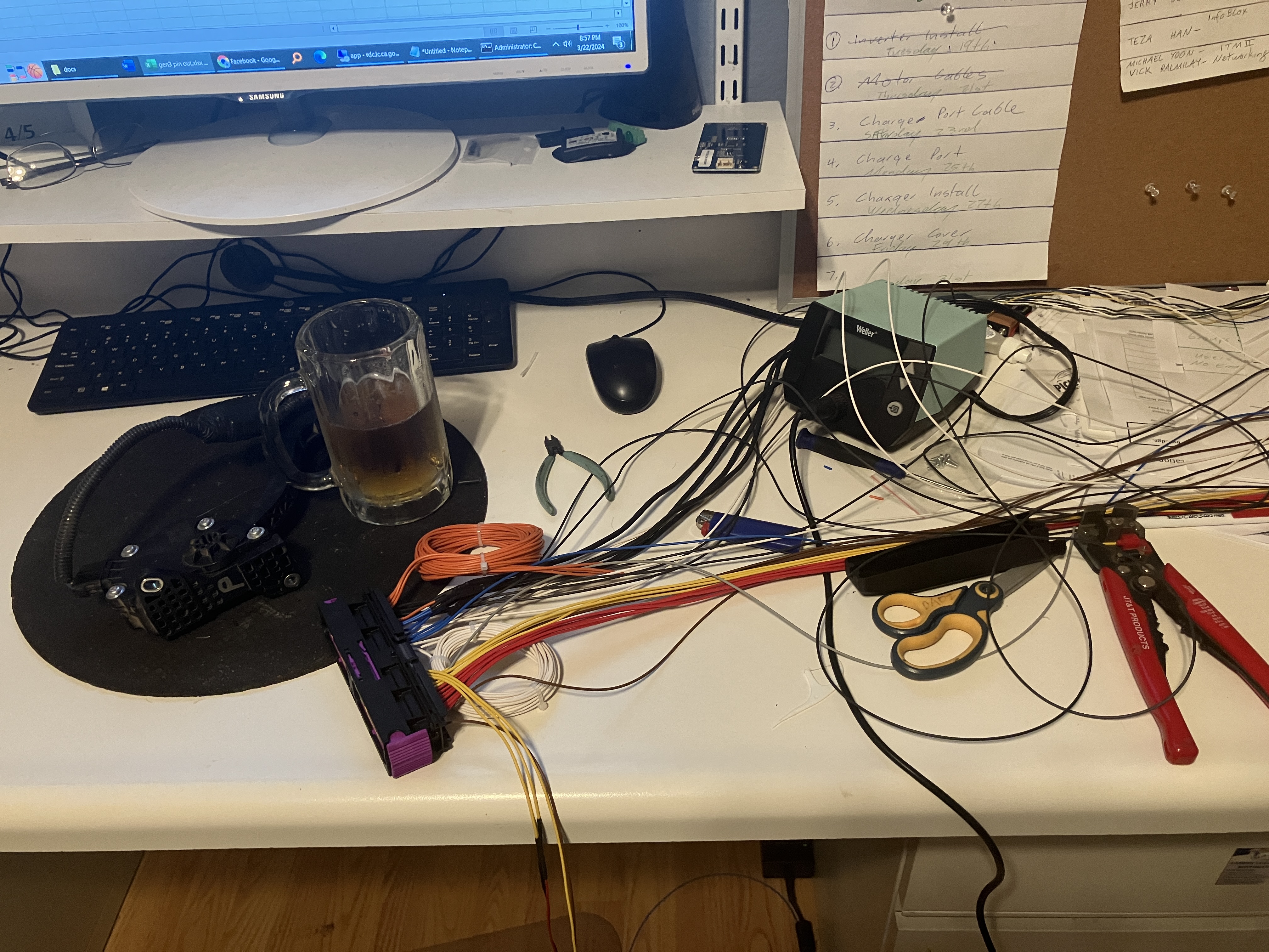

soldering on the 56 pin header connector
Fun Level: -2

Post by rstevens81 »
Gregski wrote: Sat Mar 23, 2024 7:50 pm soldering on the 56 pin header connector
Fun Level: -2
soldering though hole components is a doddle after soldering smd :)
just get good leaded solder and its fine, just dont try and buy it from rs components apparently it restricted to professionals as i might eat leaded solder :?

rstevens81 wrote: Sat Mar 23, 2024 7:55 pm soldering though hole components is a doddle after soldering smd :)
the soldering is the easy part, getting all 56 pins through the holes at the same time is an art

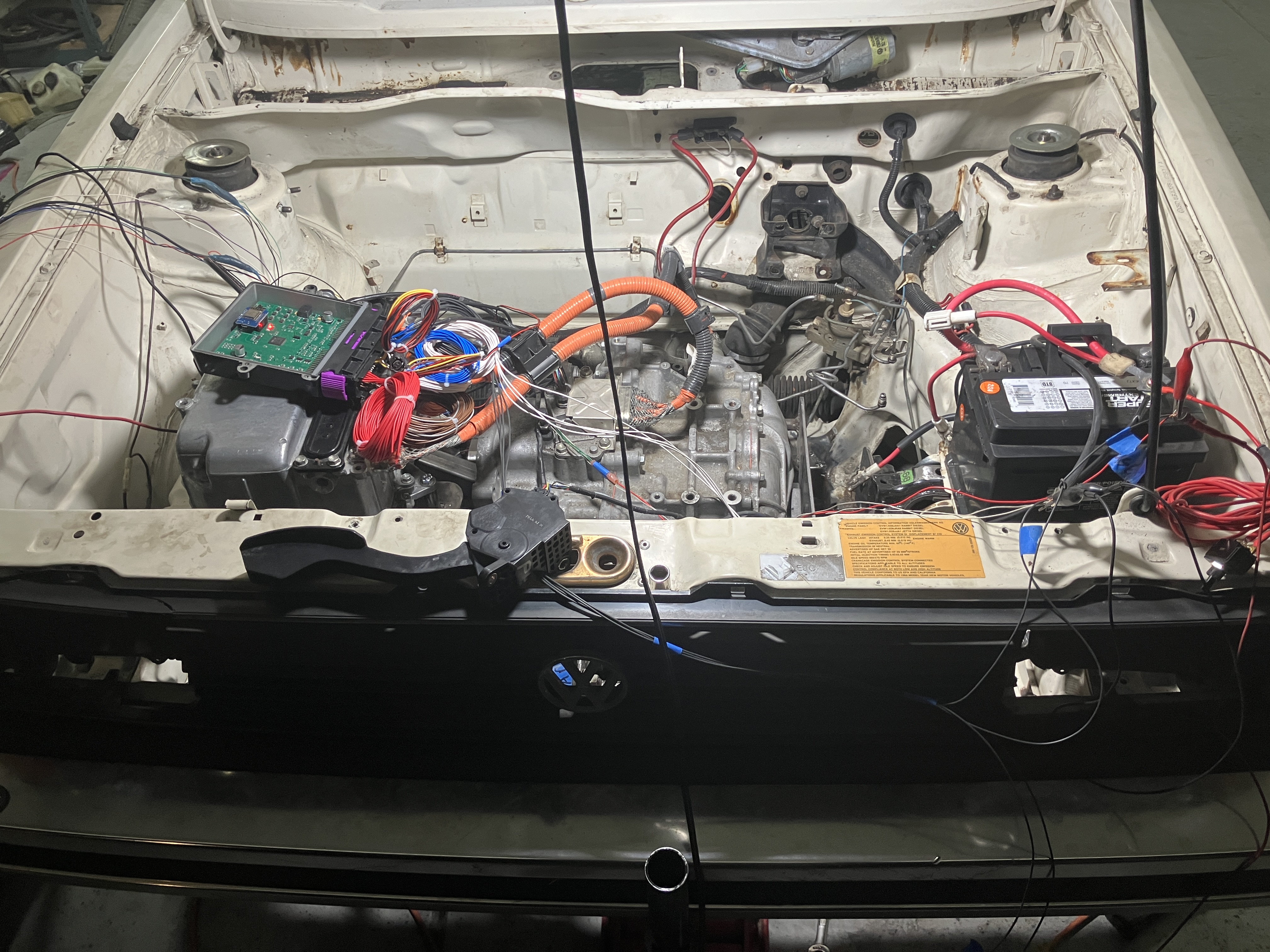

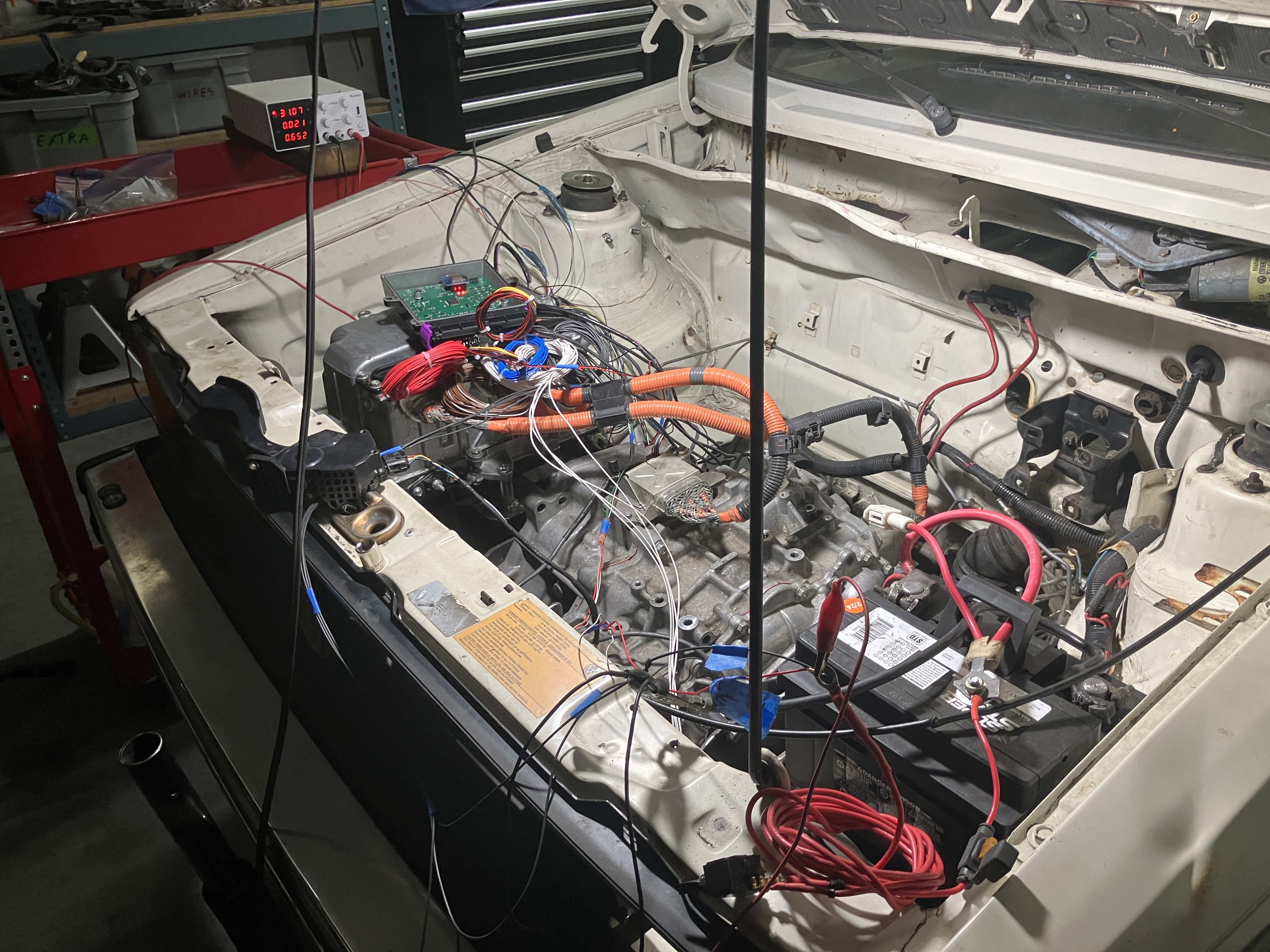

minimal wire harness, about to head into the garage for the first spin of the motor
Gregski
Posts: 2744
Been thanked: 955 times

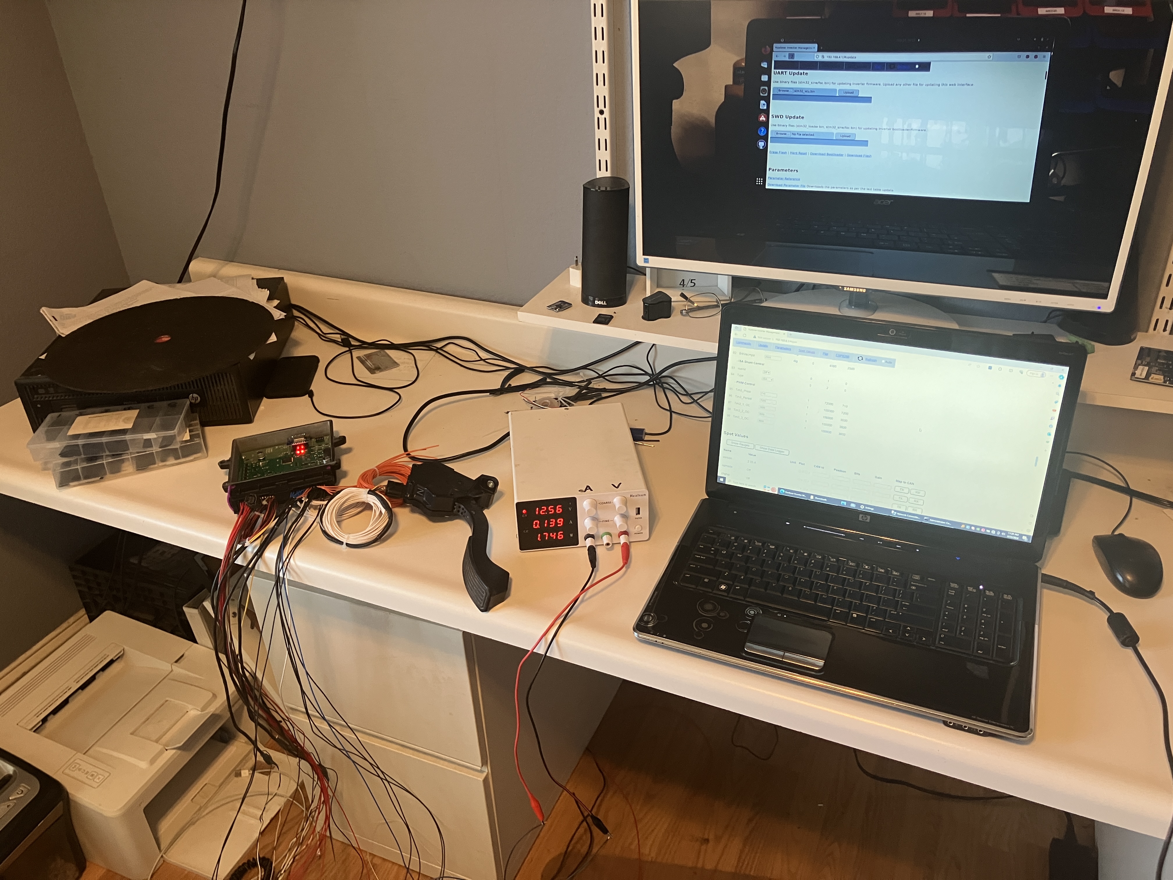

Post by Gregski »

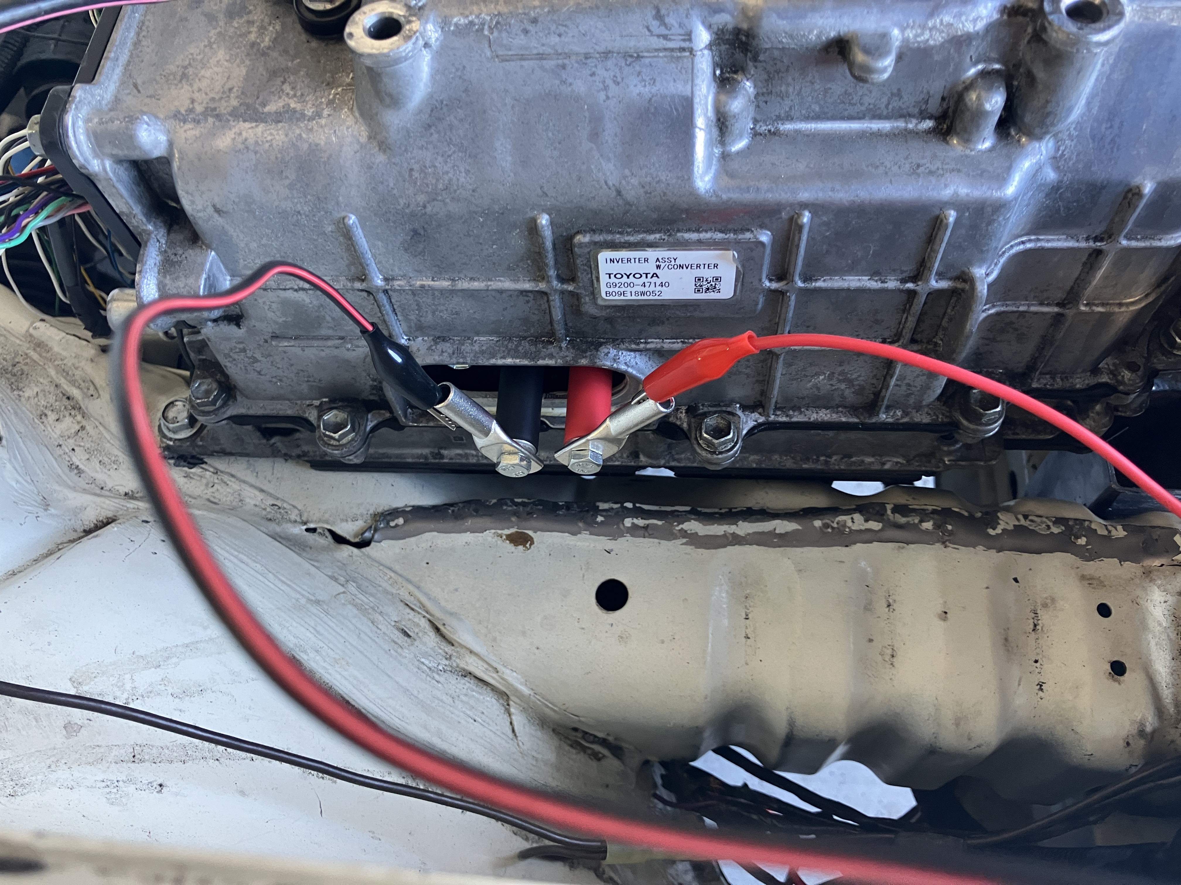

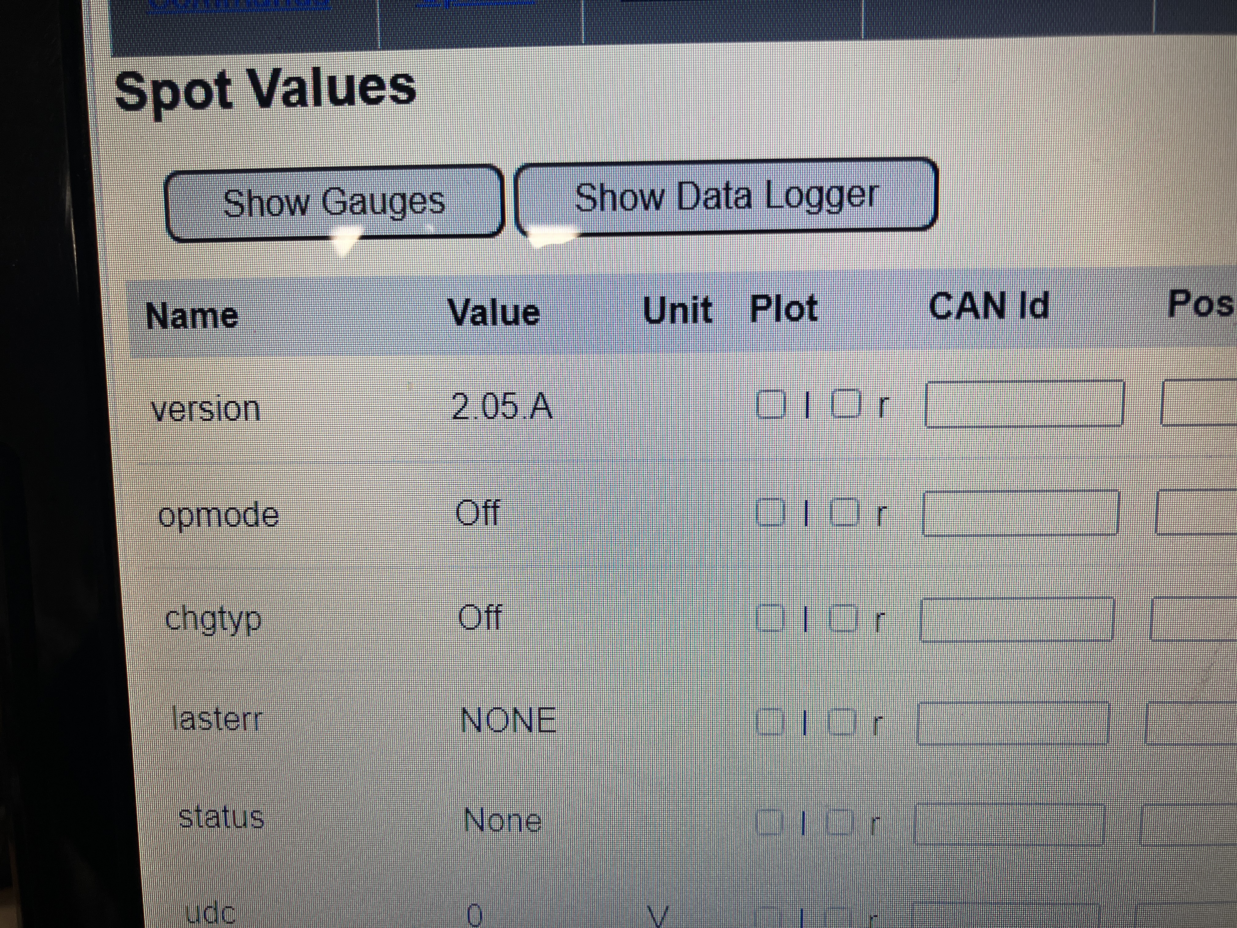

well the first attempt to spin the motor late last night proved UNSUCCESSFUL
- the inverter had power and made the whinny high pitched noise
- Forward signal had 12v
- Zombie VCU Pin #15 had 12v
No ISA current shunt implemented
No BMW sBox implemented
just using a 300 watt 30 volt 10 amp bench power supply for my high voltage battery pack (this worked on the Lexus GS450h)
Posts: 2434
Location: Bristol
Has thanked: 211 times
Been thanked: 593 times
You get into run mode? Also what version are you using?
Gregski
Posts: 2744
Post by Gregski »
tom91 wrote: Sun Mar 24, 2024 3:07 pm You get into run mode? Also what version are you using?
thank you Tom, short answer is No, and I should have mentioned the version: 2.05A

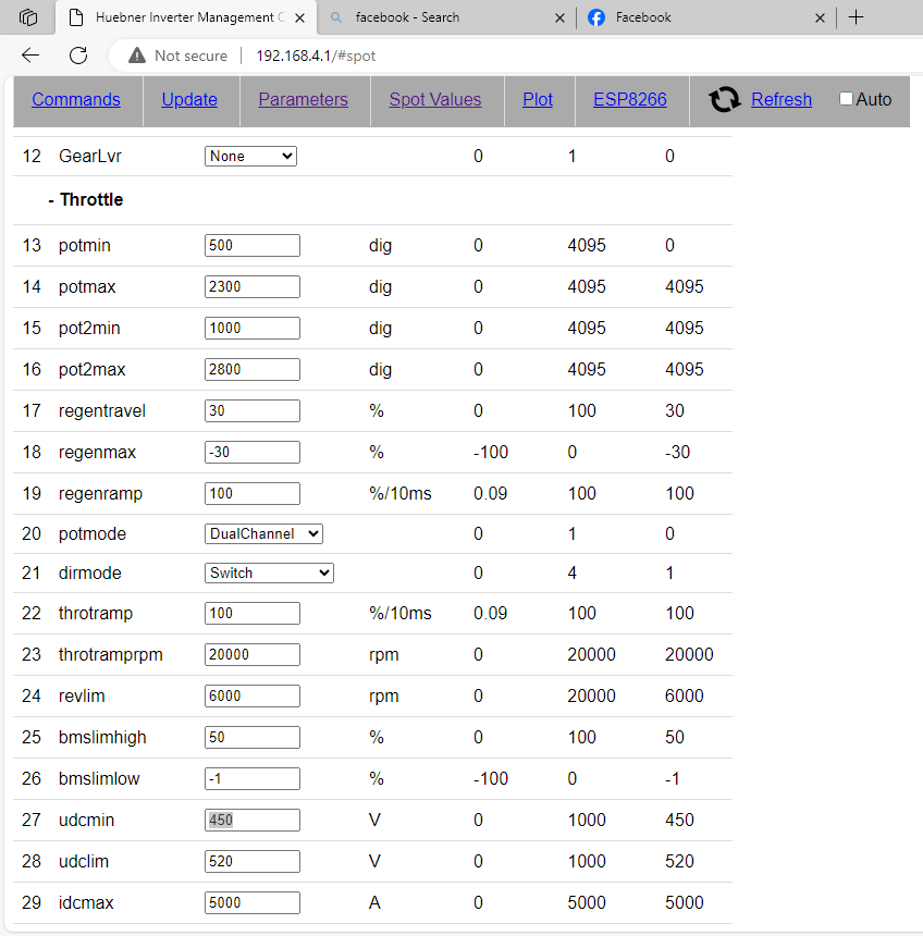

here are some screen shots, at first I forgot about the udcmin which was set to 450 volts, I have since changed it to 20 since I am using a 30 volt bench power supply
I do not have a shunt neither the ISA nor the BMW Safety Box at this time, so I set that to na
Posts: 2434
Location: Bristol
you need to set UDCsw to 0 to bypass contactors. Please post your full settng download.
You need ignition power this should be the pin 15 you mention, and then also a start signal pin 52 as per diagram linked.

tom91 wrote: Sun Mar 24, 2024 4:01 pm you need to set UDCsw to 0 to bypass contactors. Please post your full settng download.
https://openinverter.org/wiki/File:Zomb ... inout2.jpg

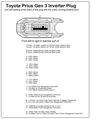

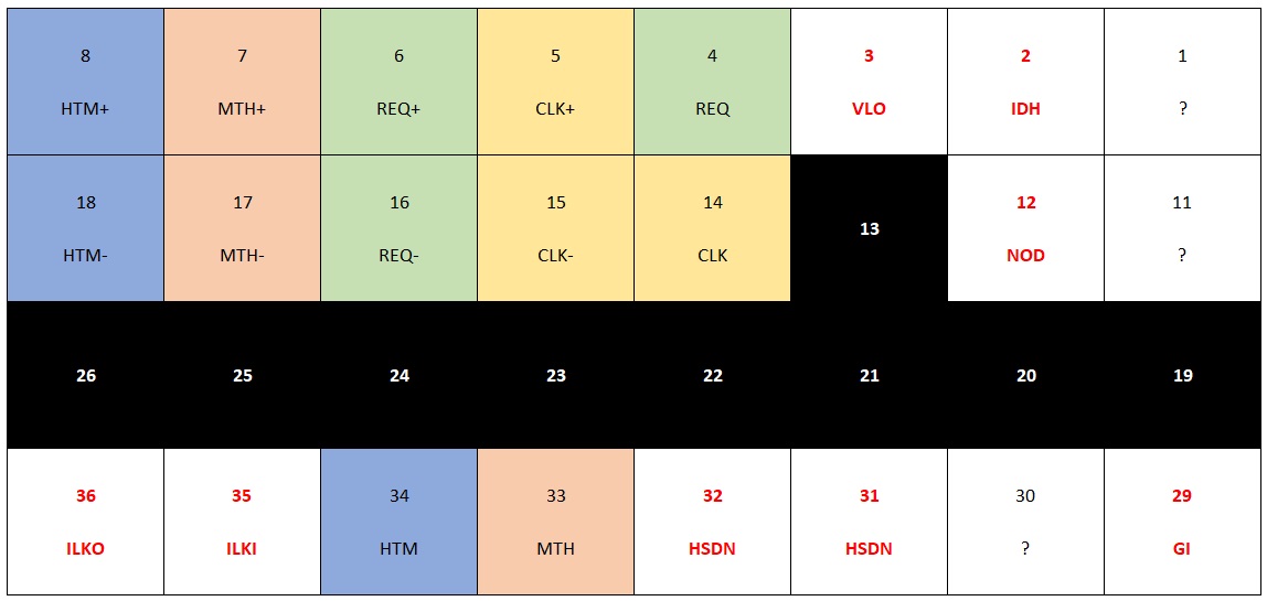

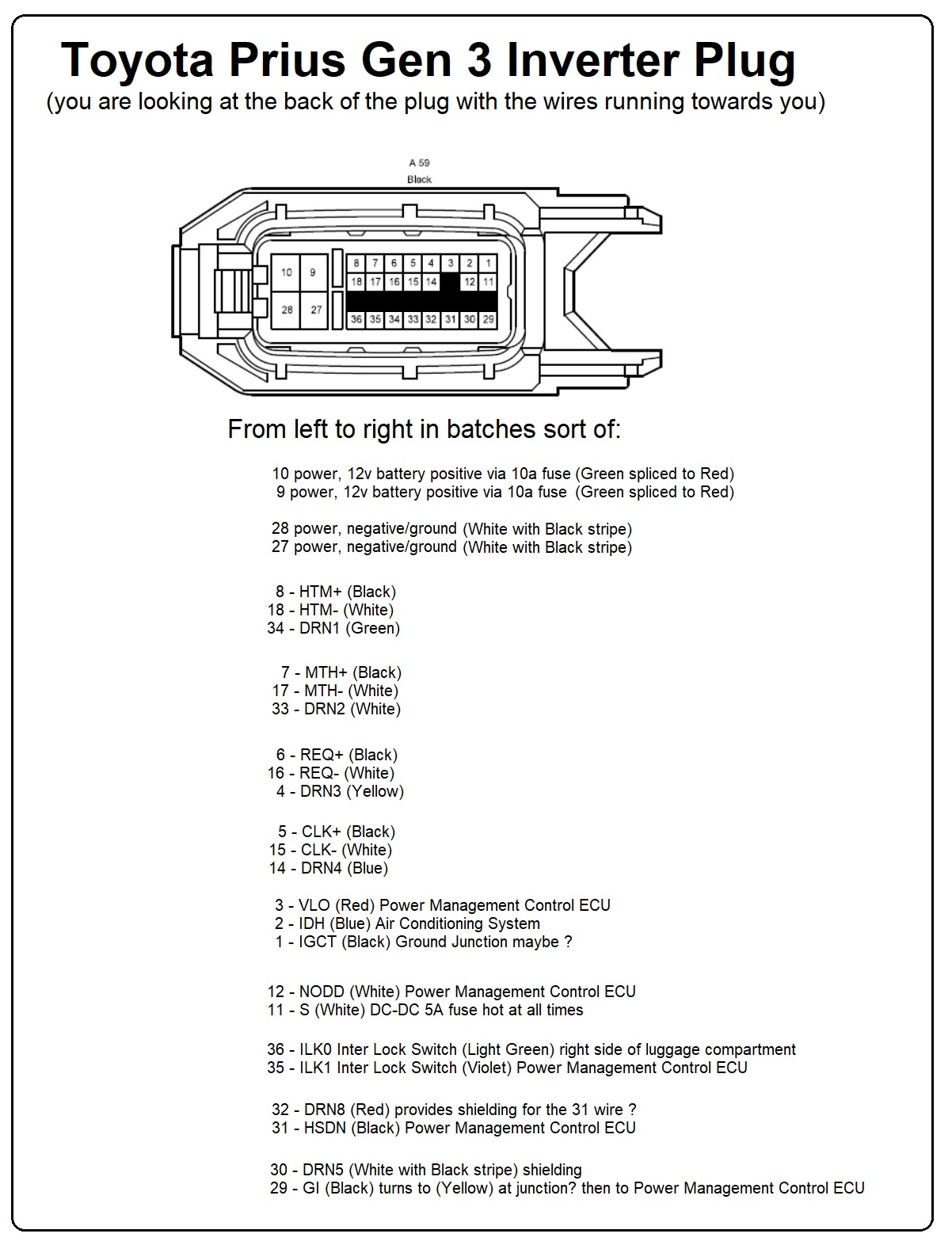

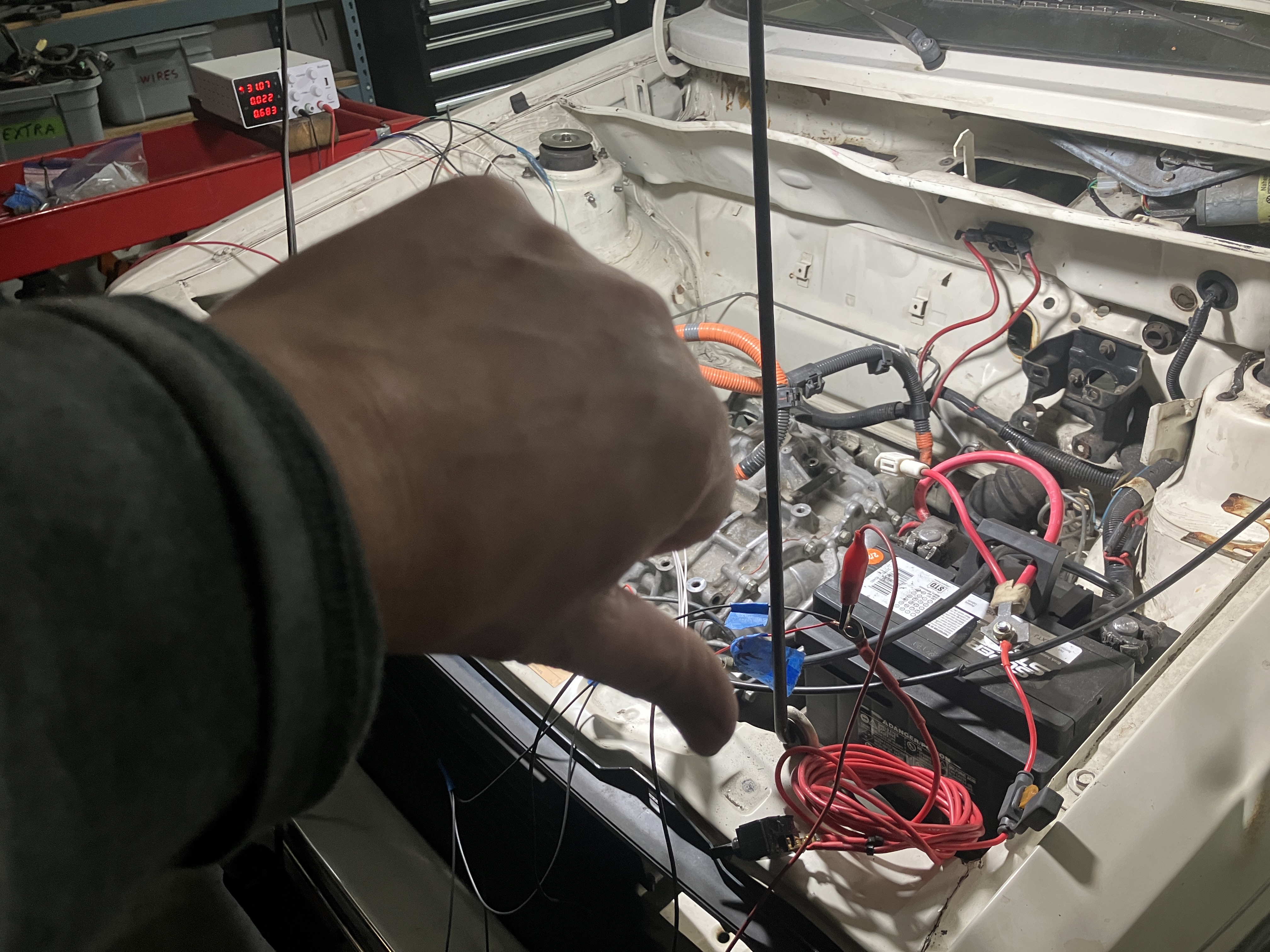

Thanks Tom I will post that in a minute, however I wonder if my problem lies in the inverter connector wiring or lack there of, all I have wired up to it is the 4 sync serial wires and the two grounds and the two 12v wires, nothing else, below the red items are not wired
Gregski
Posts: 2744
Post by Gregski »
son of an itch it works !!!
you will not believe what it was
I guess these extension leads offered too much resistance for that little Power Supply
once I removed them and connected the short original bench power supply leads directly to the inverter posts all worked fine

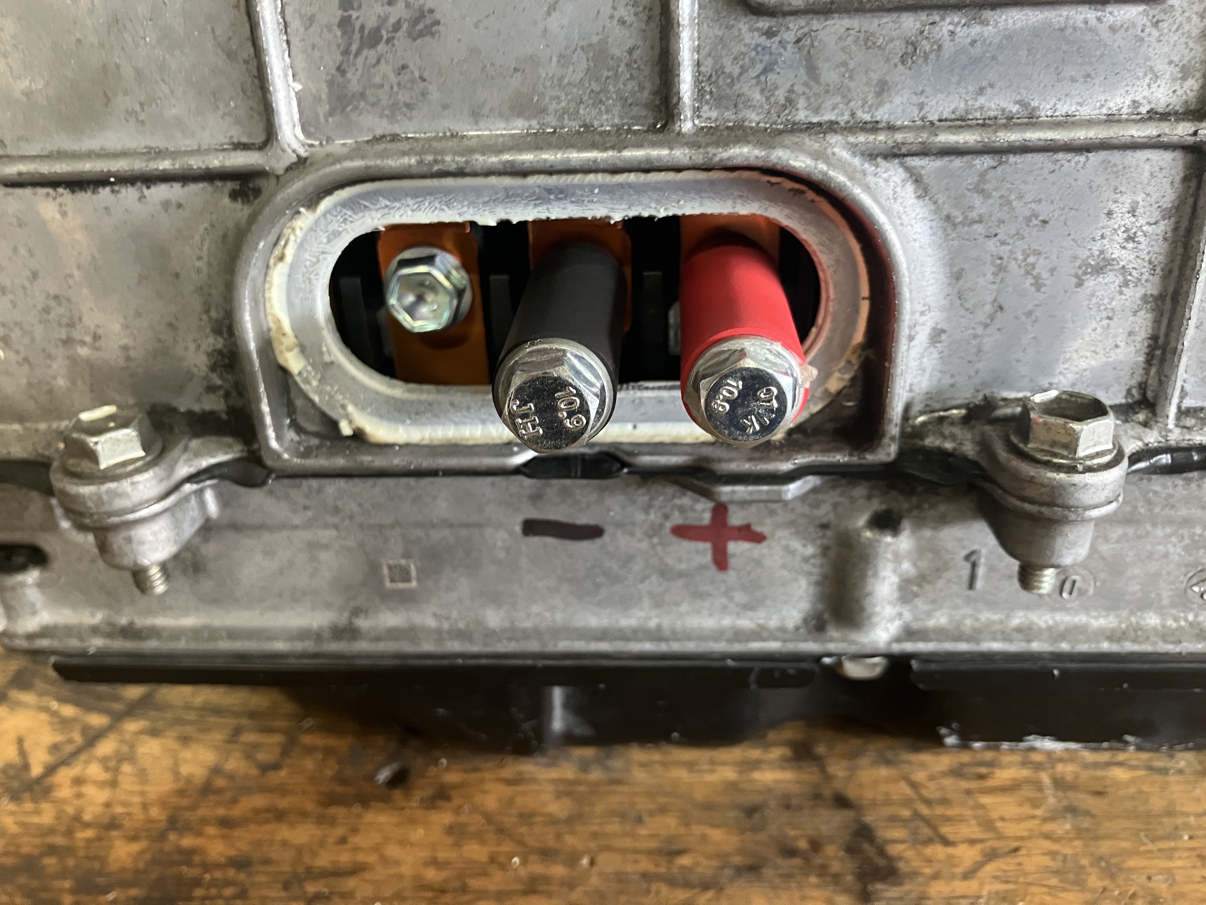

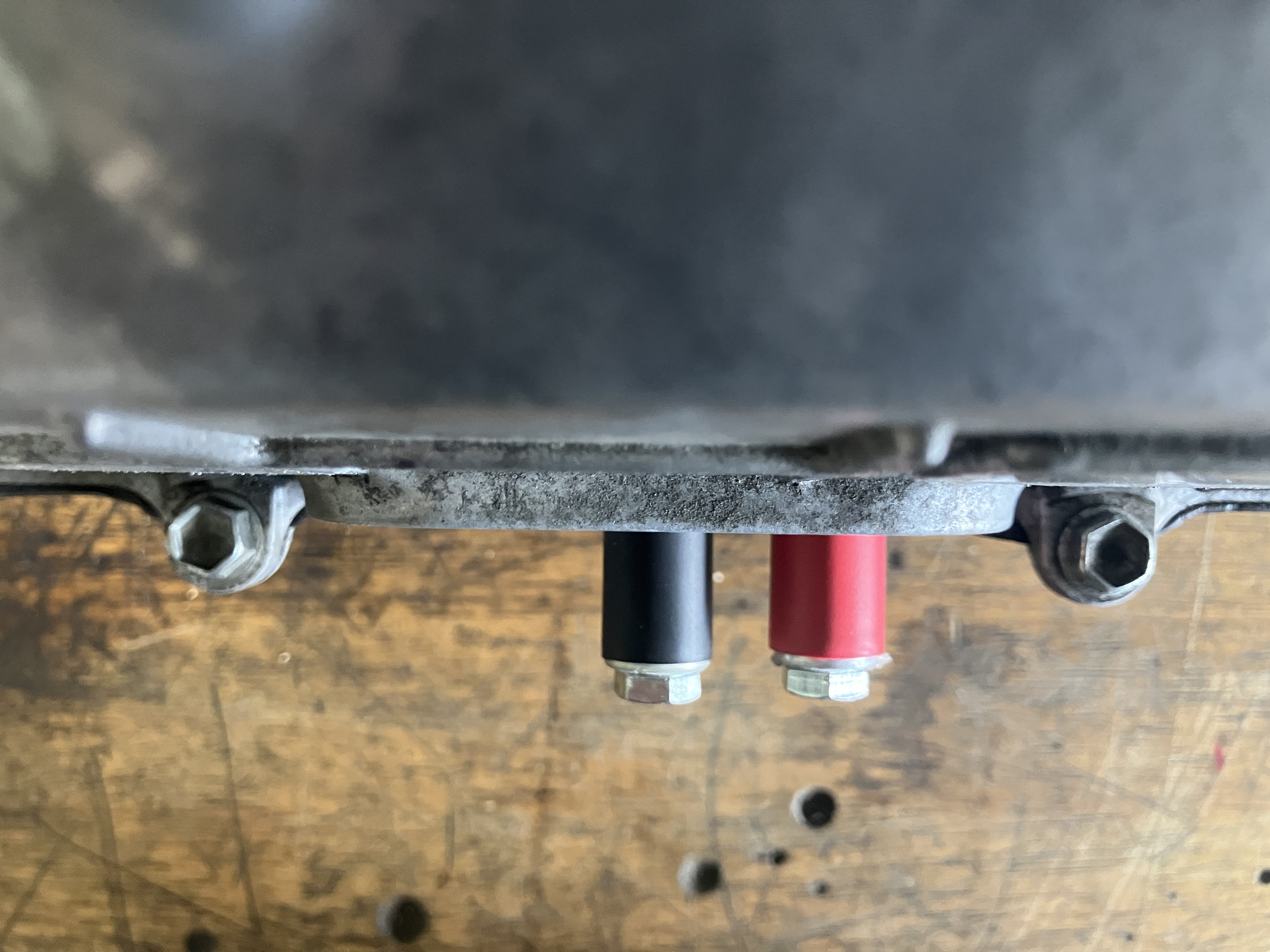

Gregski wrote: Sat Mar 23, 2024 8:16 pmPrius Gen 3 HV Stand Offs DIY EV Conversion
Copper and aluminum exist on opposite ends of the electrochemical scale, and thus when touching, create a battery that powers its own corrosion. It's why we don't do aluminum wiring in houses anymore, and the retrofit option for not tearing it all out is steel conductors inserted to separate them at the wire nuts in every box.
I'd do copper or brass.
Also, iirc Damien had his at 2 different heights so that the ring terminals can't accidentally touch each other if the bolts slip and allow the cables to rotate. That is your + and - straight off of the battery.
Do you have an oxy-ace torch? Poke your finger into some sand mixed with ground up kitty litter, and pour a bar of copper for yourself. Think of all those discarded wires from cannibalized wiring harnesses, they can ferry electrons once again!
In traditional scrapper culture, to honor its spirit, no part, of the buffalo/vehicle, shall be wasted.
Metals supermarket for a brass bar and then drill a hole in it, if you prefer throwing change at the problem.
The rattling is normal-ish I think. Seen that a lot. Put some load on it and it stops.

MattsAwesomeStuff wrote: Mon Mar 25, 2024 10:20 am Copper and aluminum exist on opposite ends of the electrochemical scale, and thus when touching, create a battery that powers its own corrosion. It's why we don't do aluminum wiring in houses anymore, and the retrofit option for not tearing it all out is steel conductors inserted to separate them at the wire nuts in every box.

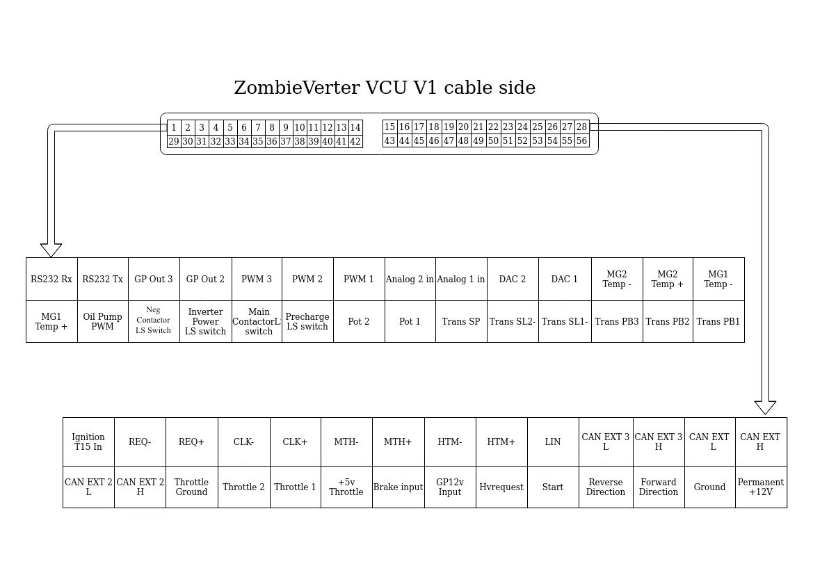

Post by Gregski »

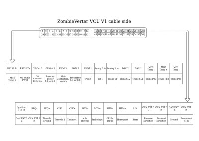

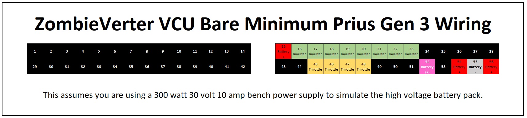

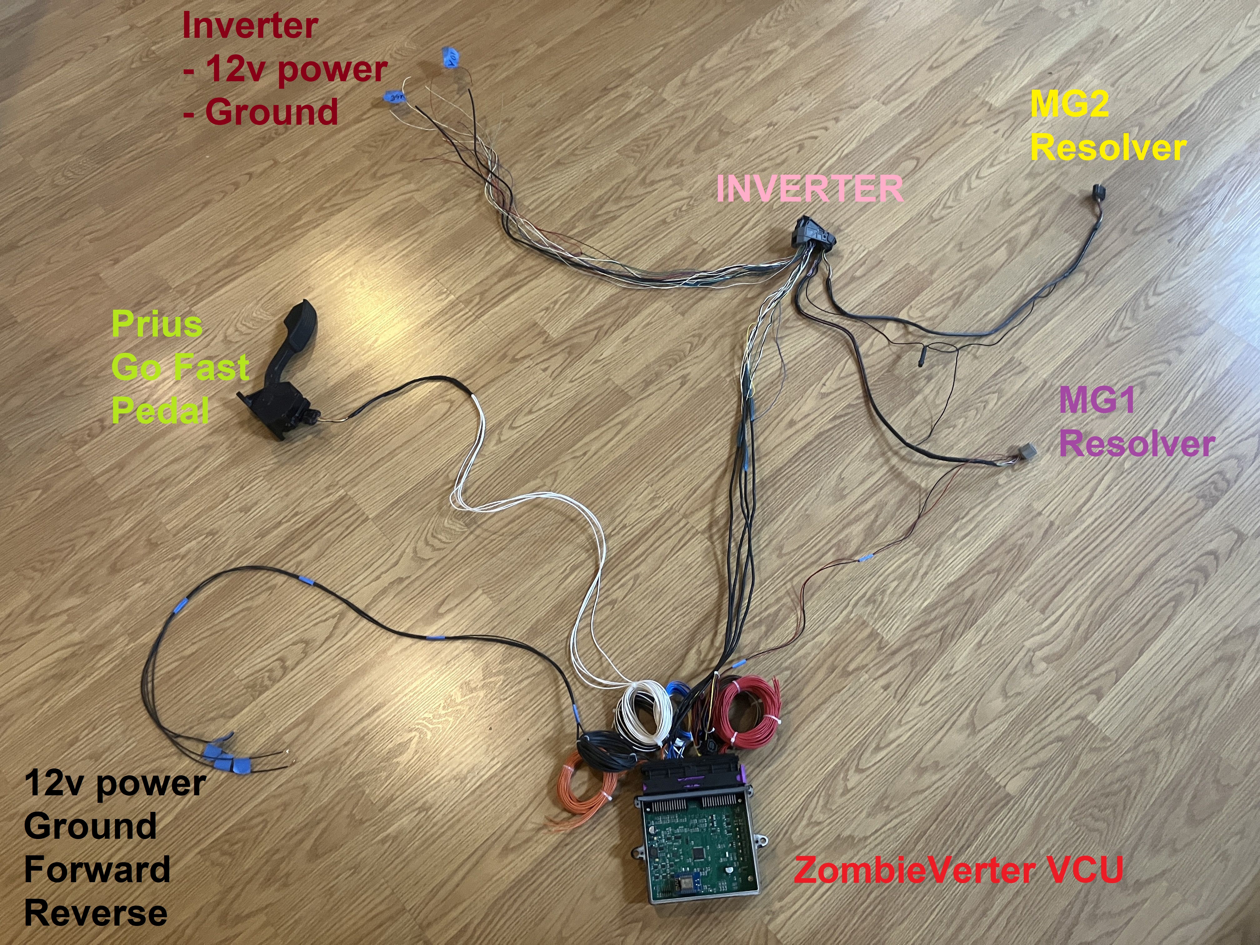

below I attempt to Stupidize (TM) the ZombieVerter VCU wiring, presenting just the bare minimum for a first motor spin.
First as documented on the Wiki.
and this is what worked for me for my first spin
Narrative:
  • The greenish represents the 4 synchronous serial twisted pair cables that run from the VCU to the OEM Inverter plug, this is what I call the Intelligence Super Highway (well Autobahn on the account of the Rabbit)
  • Our input comes from the four wires represented in yellow(ish) that run to the Prius OEM throttle pedal (the pedal actually has 6 wires, two for ground and two for 5 volts).
  • Additional input comes from Pin #54 in the form of 12 volts from the regular car battery telling the VCU we want to move Forward.
  • The VCU actually needs three power wires represented as two red and one pink wires that go to the battery positive. Pin #56 is 12 volts, Pin #15 delivers 12 volts when the key in the ignition is turned to the ON position. Pin #52 shown in pink delivers momentary 12 volts when the key is turned further to the right to the START position and then springs back to the ON position. (this can be simulated by briefly tapping the battery positive terminal with the bare wire)
  • Finally Pin #55 represented in gray runs to the battery negative terminal ie ground.

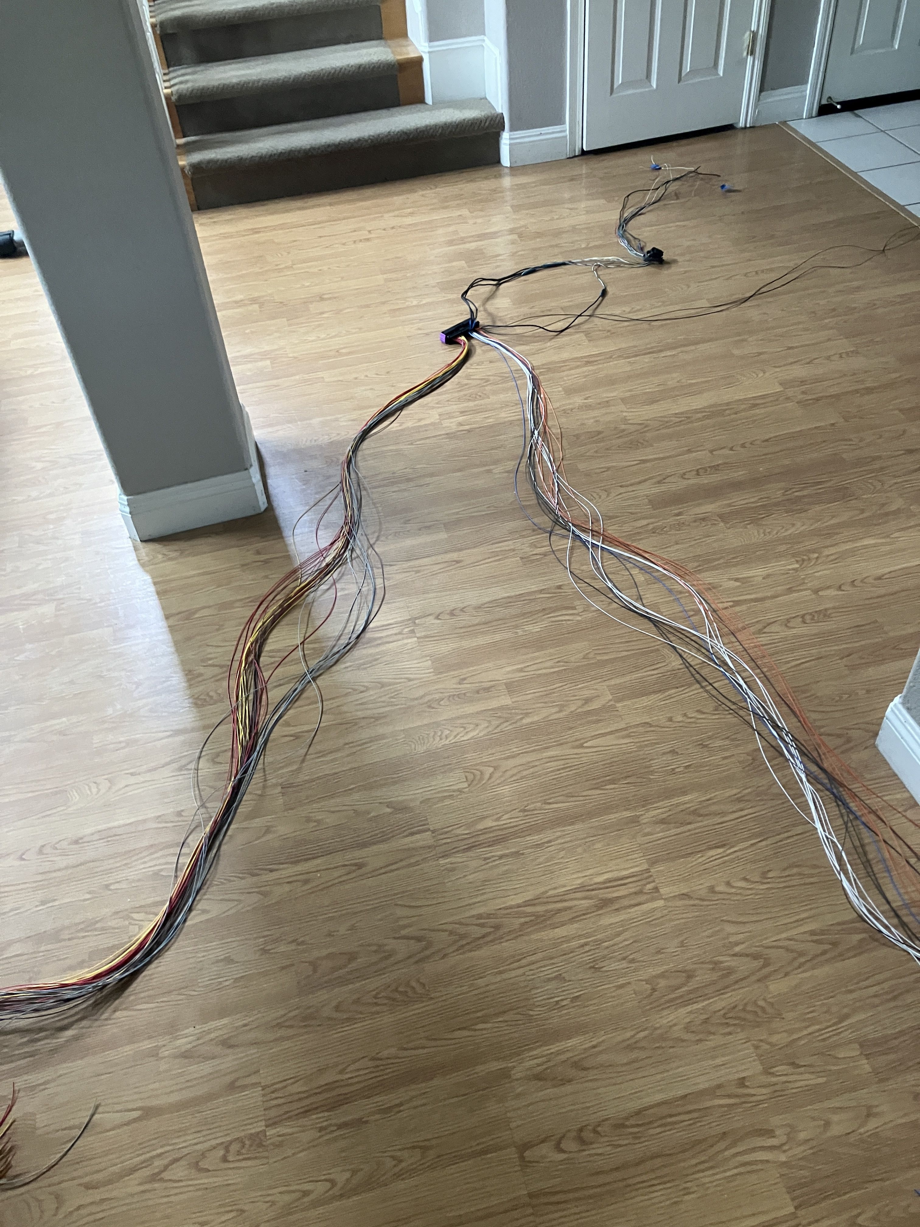

84 VW MK1 Rabbit ZombieVerter VCU Wire Harness
