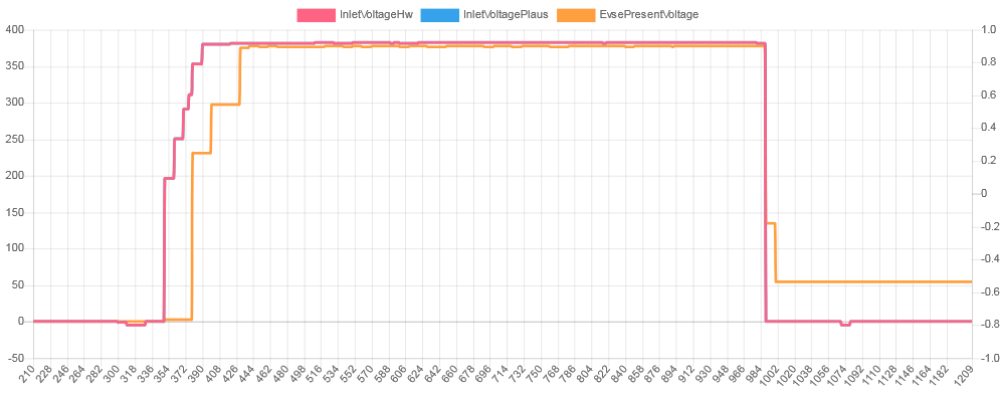

Very good data. This means, the charger has half a minute delay between the physical voltage on its DC pins and the reported voltage in the communication. Or do I interpret the time axis wrong @johu?

To tolerate the time offset between the pyhsical voltage and the EvsePresentVoltage, added a two-seconds tolerance in the software.muehlpower wrote: ↑Tue Jan 06, 2026 12:06 pm I have made further attempts. When I take the DC voltage from the charger output, it works. I think the problem is checking the difference in connection with a time offset!
Binaries: https://github.com/uhi22/ccs32clara/act ... 0752458118
Github issue: https://github.com/uhi22/ccs32clara/issues/52
Github commit: https://github.com/uhi22/ccs32clara/com ... cf9b11a9f9
Ready for tests @muehlpower

Seems to be working. The log is again about 10 seconds long and also shows the voltage curve when I press the cancel button to stop it.

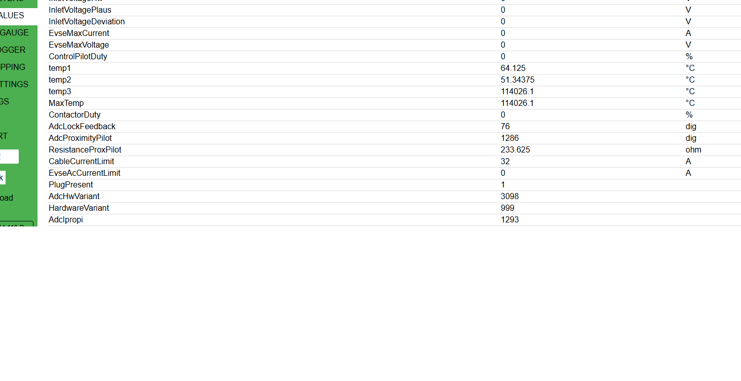

My last post referred to 44.116. Now I have tried 44.119. Pt1000 with 1000 ohms shows:
- uhi22
- Posts: 1244
- Has thanked: 245 times
- Been thanked: 684 times
Re: QCA7000 Foccci+Clara User thread
Improved software: https://github.com/uhi22/ccs32clara/act ... 0760825425
It treats the unconnected temperature sensor 3 as "invalid", which means -50°C, so it does not hurt the max temperature.

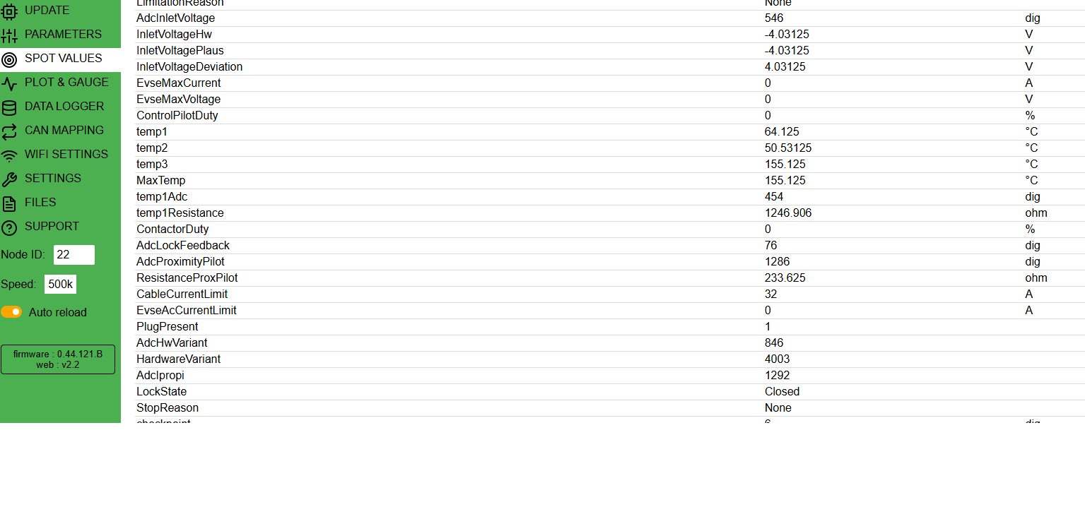

The big deviation (64°C in the picture versus expected 0°C with 1000ohms) needs more analysis. To understand the issue, I added two spot values
temp1Adc and temp1Resistance. What do they show when connecting a 1000ohm resistor? We may have a tolerance problem with the pull-up, or a ground shift problem, or something else.
- muehlpower
- Posts: 807
- Been thanked: 188 times
Try with 44,121. I connected to temp3 1k, 1k2, and 1k5. 1k ->25.3°, 1k2->76.2°, 1k5->155.1°. temp1 and temp2 are connected to the real sensors at approx. 22°. The intervals look good. The two built-in sensors have at 22° 1087 ohms and 1088 ohms, measured at the disconnected plug from the Foccci, i.e., with the entire cable to the CCS socket. This fits exactly to 22.5°.

Confirmed the wrong ADC values for the temperature inputs on my desk. Further discussion in the developer thread https://openinverter.org/forum/viewtopi ... 749#p88749
