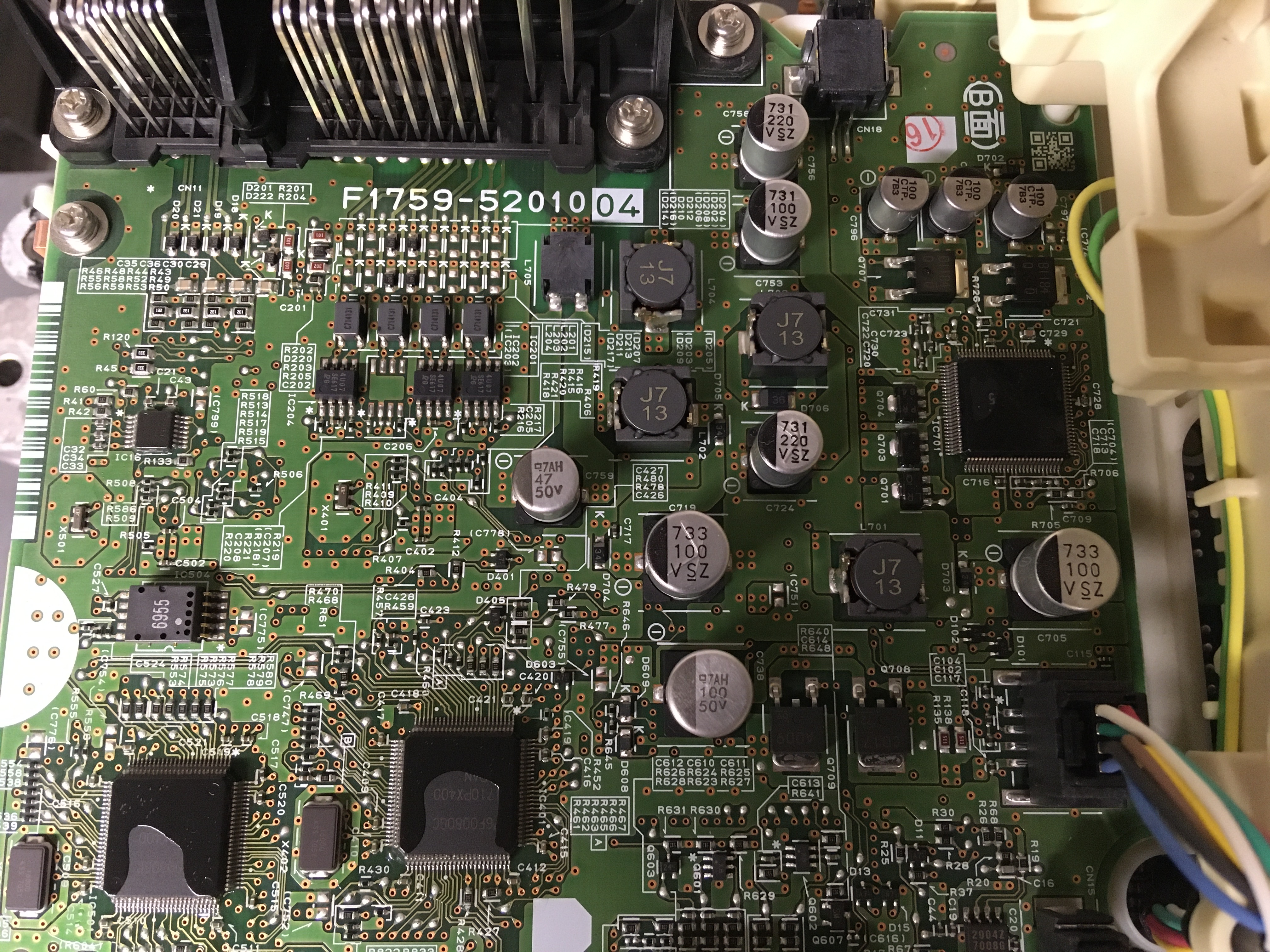

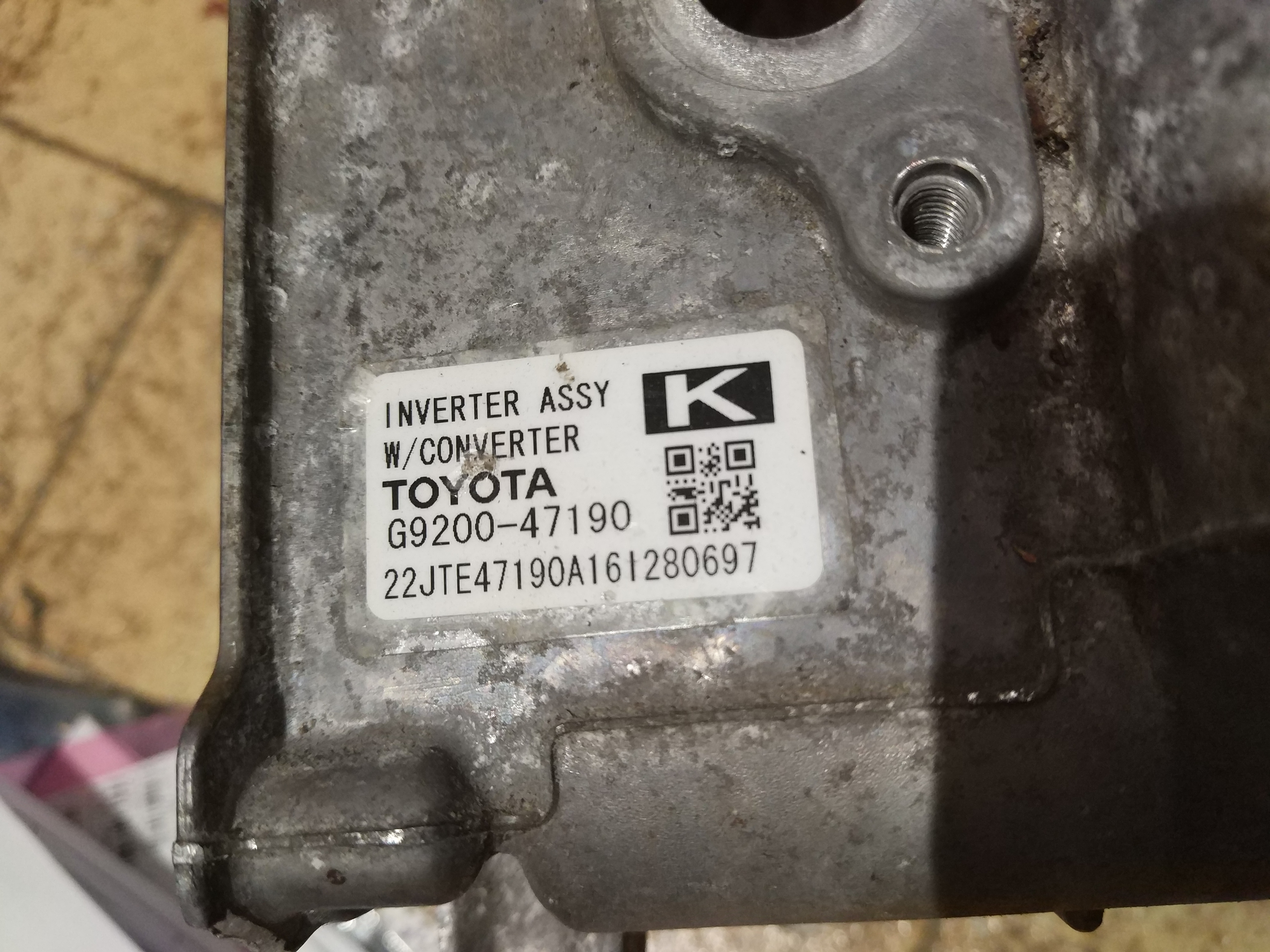

Is there somewhere useful a cross reference table can be made of Toyota Gen3 inverter part numbers and their related vehicle models so that folks can expand it when a new one is dissected for inspection?
Like Aquinax and Alexstarex I've ended up with different but similar Gen3 inverter. A Yaris 2017 inverter to be exact which appears to be externally similar to the Prius Gen3 inverters but has a different logic board. However the logic board part number is the same as the one recently listed in this thread. Having a central look up list of what is from where would help folks make purchasing decisions and compatibility options.

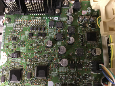

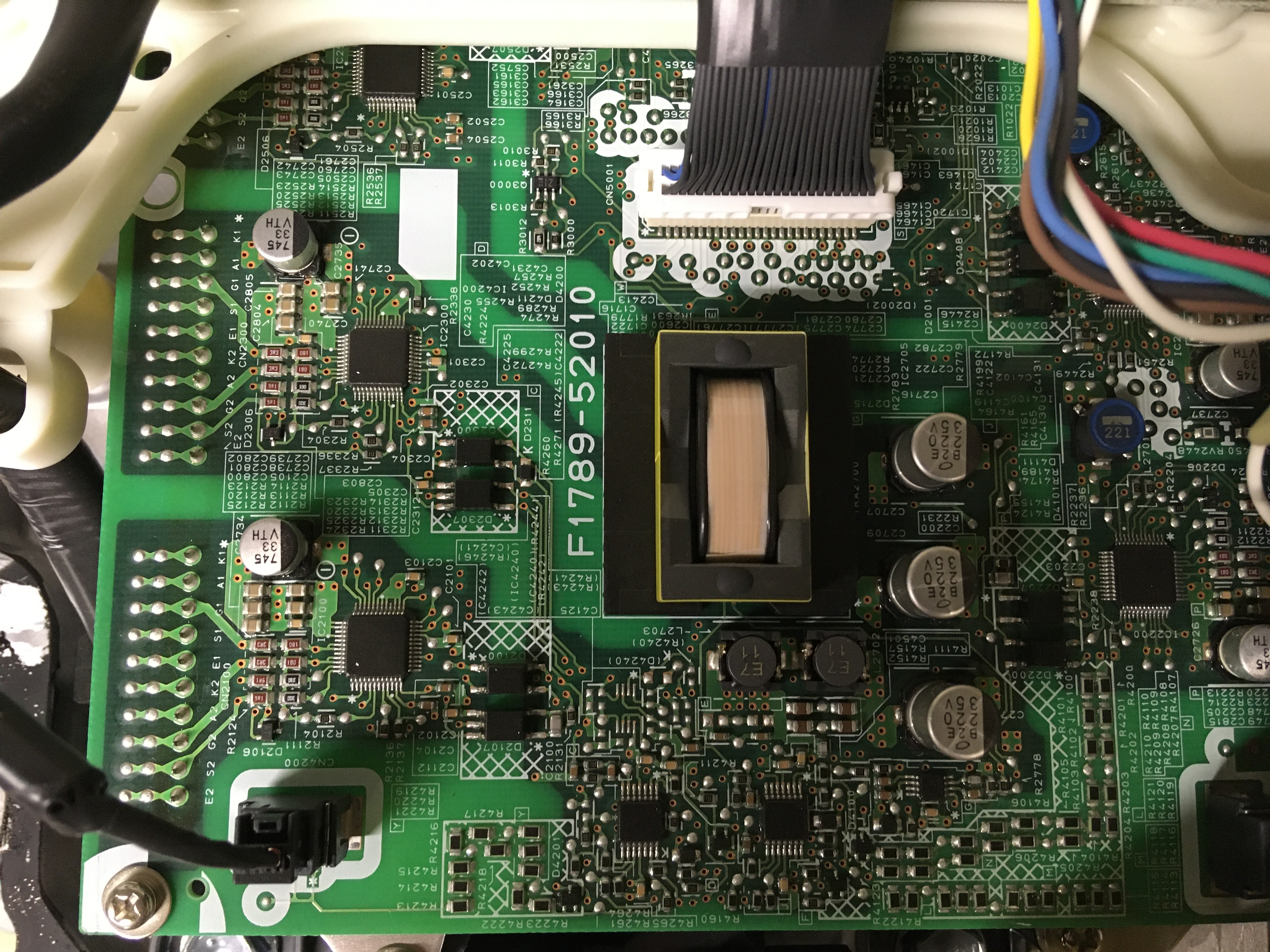

Here you go: proof that most Yaris boards are the same.
In other news i have this Auris inverter and it has the same mainboard as Yaris. Seems reasonable.
Like i explained here difference is probably in transistor density and main cap. When i too it apart i found out Yaris has many internal contacts separated that Auris and Prius have on main cap. Otherwise everything functions the same way on both inverters.
viewtopic.php?f=14&t=257&start=10#p3098

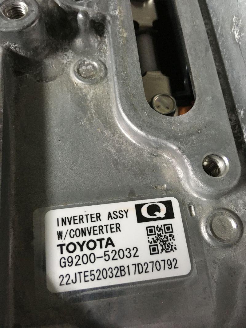

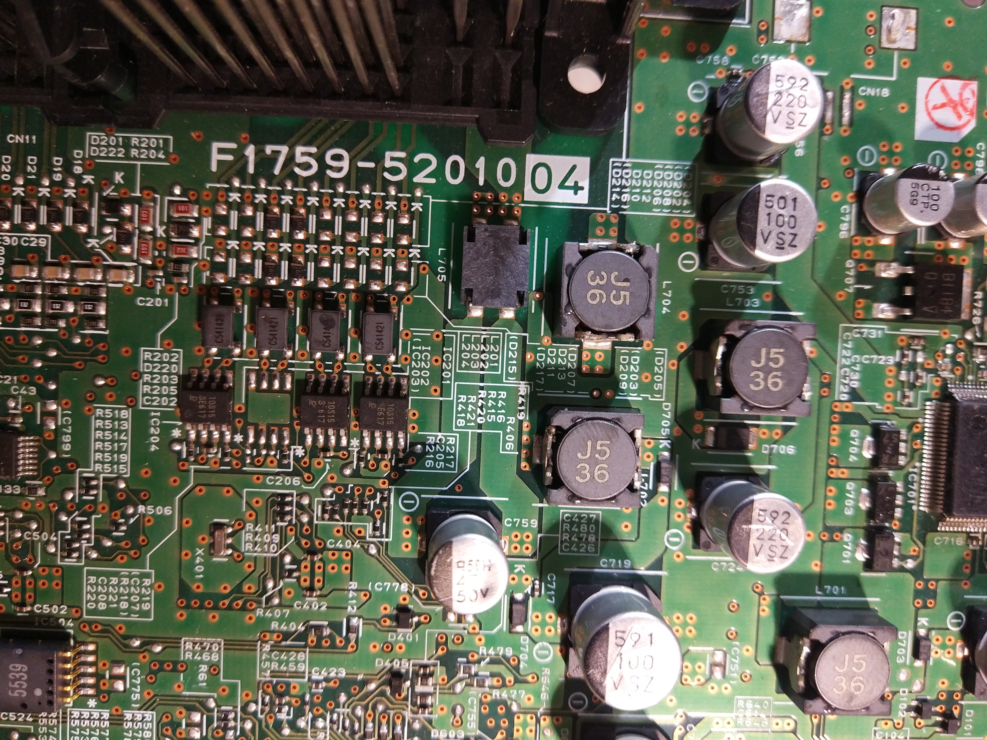

damian.lo
Posts: 123
Location: Poland
Re: Prius Gen3 Inverter Hacking
Post by damian.lo »
So for comparision I'm sending also pictures from Yaris inverter, but another one G9200-52032.
Looks, that inside is board with the same description, so probably will be the same?
Here is also second board, maybe will be usefull for someone.
If I can also check something for comparision with another boards - I'm waiting for questions.

I've made a table and entered the vital details of the inverter I have plus a the one listed just above this post and another that Damien just posted on the Gen3 thread but don't have the energy to go trawling through the forum spotting other serial numbers.
Hopefully it will turn into a useful reference for compatibility especially the differing long / short PCB mounting holes.
