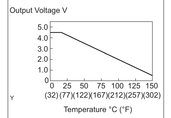

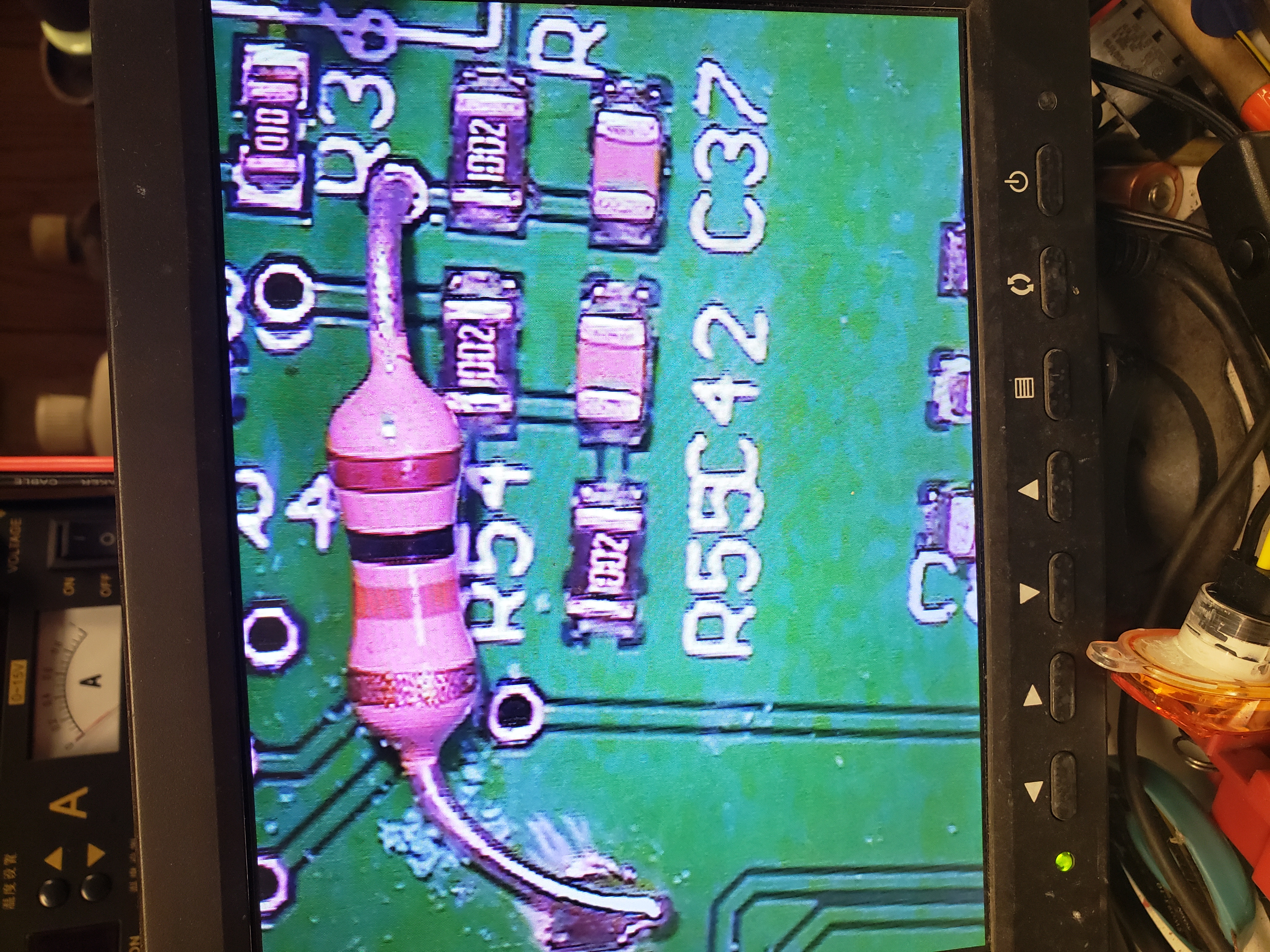

I have a Prius inverter as well, but I'm too lazy to find the temp curve myself. It's supposed to be in the service manual but I couldn't find that either. So if someone could just post a screenshot that would help.
EDIT: I checked some old mails and found it. Small problem: I forgot the voltage divider so there will only be valid values starting at like 40°C
EDIT again: looks like -30mV per °C. Or -37 digit/°C. So T=167°C - ADC / 37 . Maybe I'll just add a "linear" option for tmphs
More editing: So it seems like the lowest measurable inverter temperature without voltage divider would be 56°C. So maybe it would be a good idea to add a 10k resistor in parallel to C37 to form a 1:2 voltage divider. I will add a hard coded formula in the next firmware that is always used in Prius hardware, i.e. "snshs" becomes meaningless, just like for the Tesla boards.

Thanks for checking all that Johu.

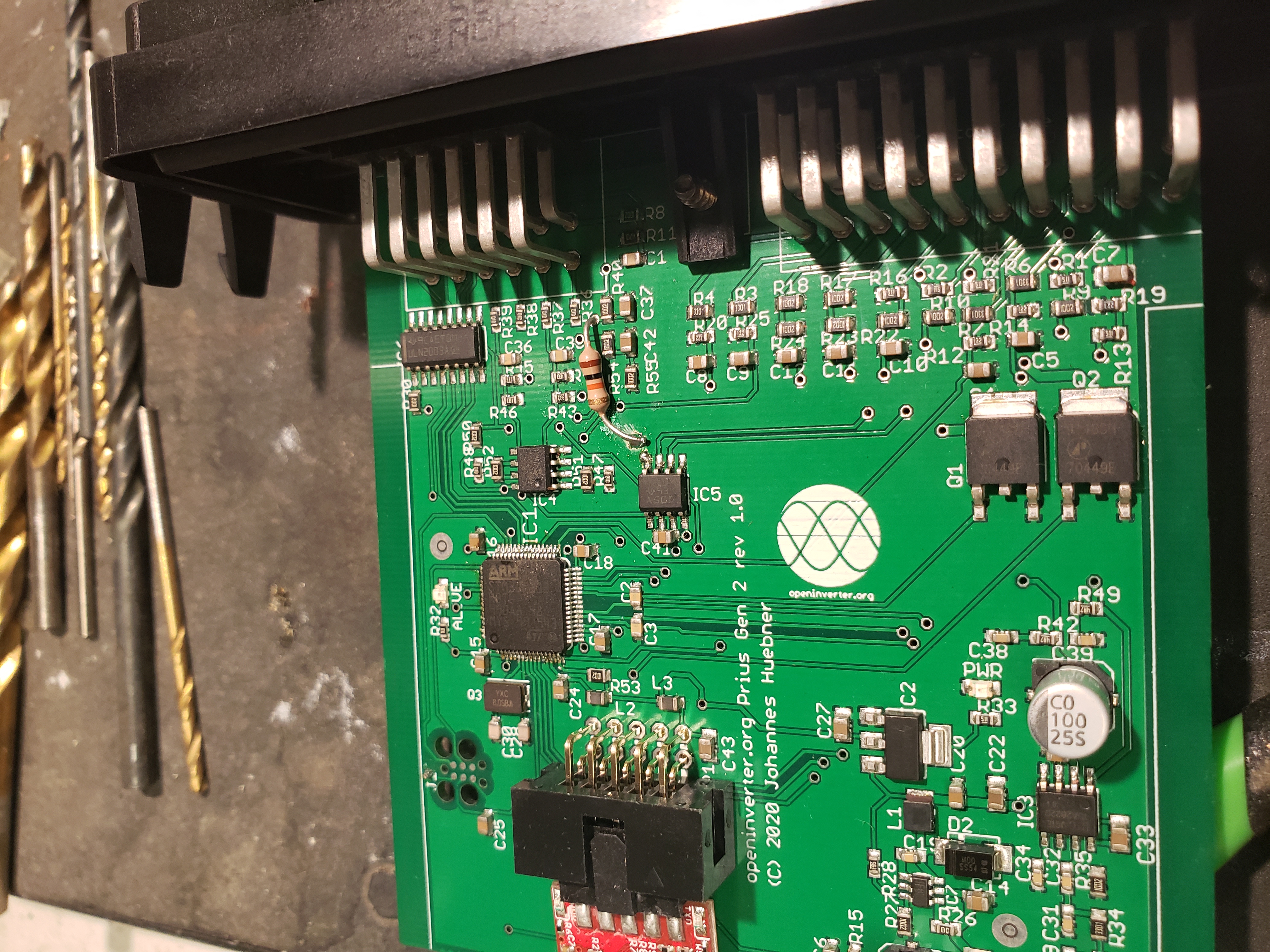

So for testing purposes, keep inverter cooled below 75°C (real) as to not create temp error.
Whilst waiting on next firmware update, a 10k resistor in parallel with C37 will solve the problem.
Me personally, I'll wait until firmware, even if I need to put iceblocks inside the inverter. Adapter board looks too good to go soldering resistors in addition
- Been thanked: 1914 times
The firmware is not going to increase the input voltage of the ADC
It will just get you a valid reading in the first place. Without the resistor you only see temperature changing above 56°C.
Just tested it with my Prius power stage and it works. If you install the 10k resistor you can measure down to about 0°C, otherwise it starts at 56°C. At startup it will check once for a voltage > 2.6V and if it sees that it will assume no 10k resistor is installed. It will of course fail to detect that if you start into a hot inverter, i.e. warmer than about 85°C.

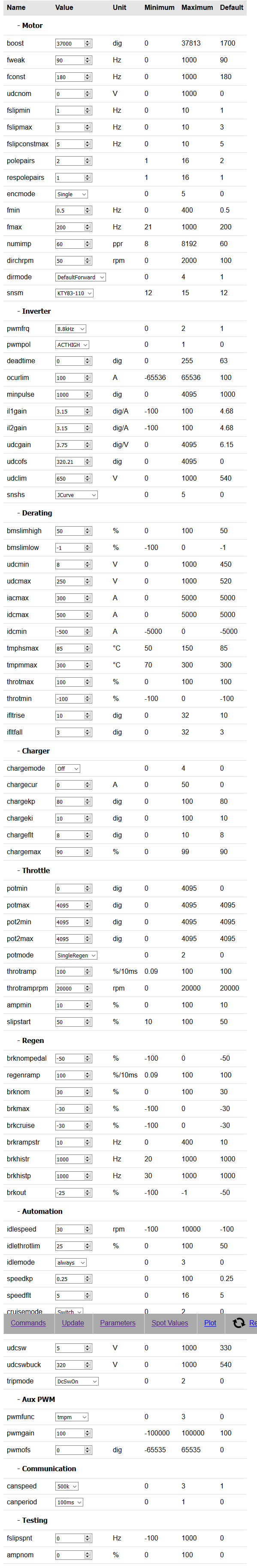

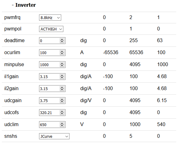

WHEW! That was not fun, but I got back in

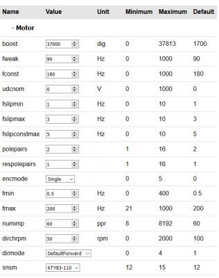

As we can see, I have messed about some with the parameters trying to get spin. Screenshot is obviously not attempting any output as am not in manual mode and test params are zero.

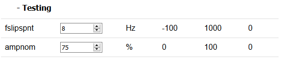

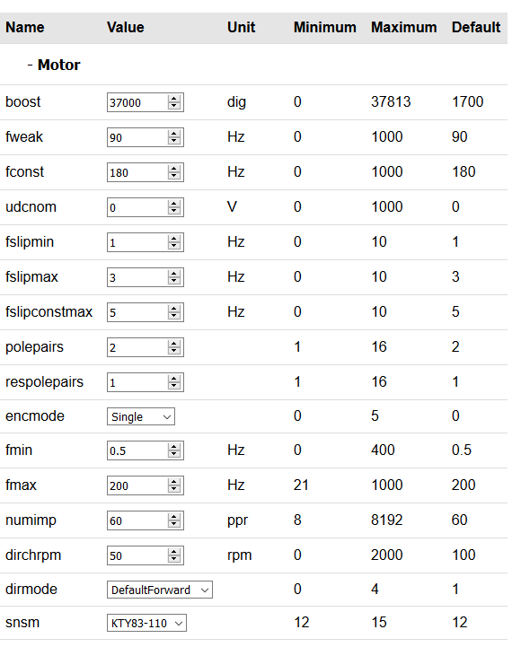

I started with 12v supply.
Boost 37000
Mode Permanent Forward
Fslipspnt 8
Ampnom 75%.
Got light bulbs in delta form to flash, then hooked up MG1
Boost 37000
Fslipspnt 8
Ampnom 75%.

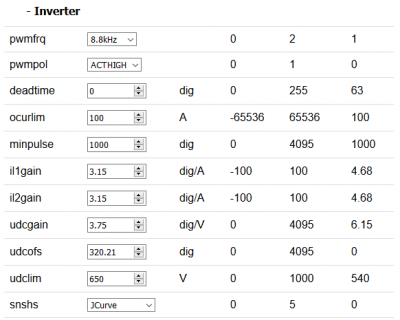

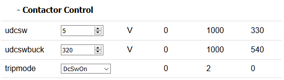

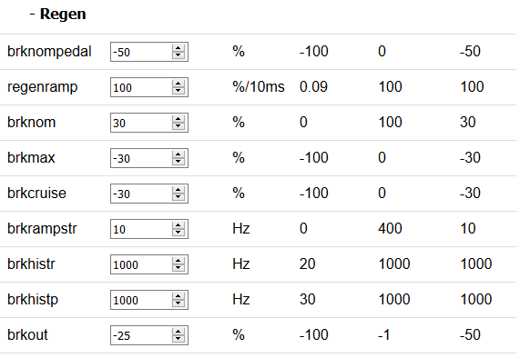

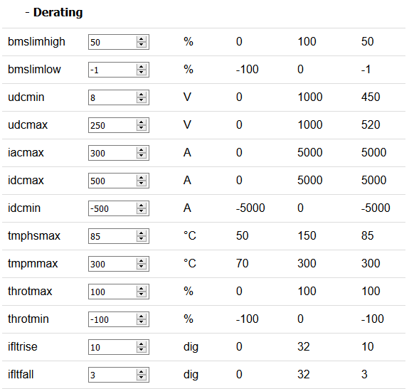

IT WORKS! Flashing lights AND Jiggling MGR
MORE POWER!!!!!! "I'm Givin' her all she's got Capt'n"
Answer was provided by JH, I had pin 25 of the Prius Inverter marked for shifter I/O, needs 12v "Run" (Ignition switch, relay, etc) signal.
<edit: Adding settings, hope this helps others>

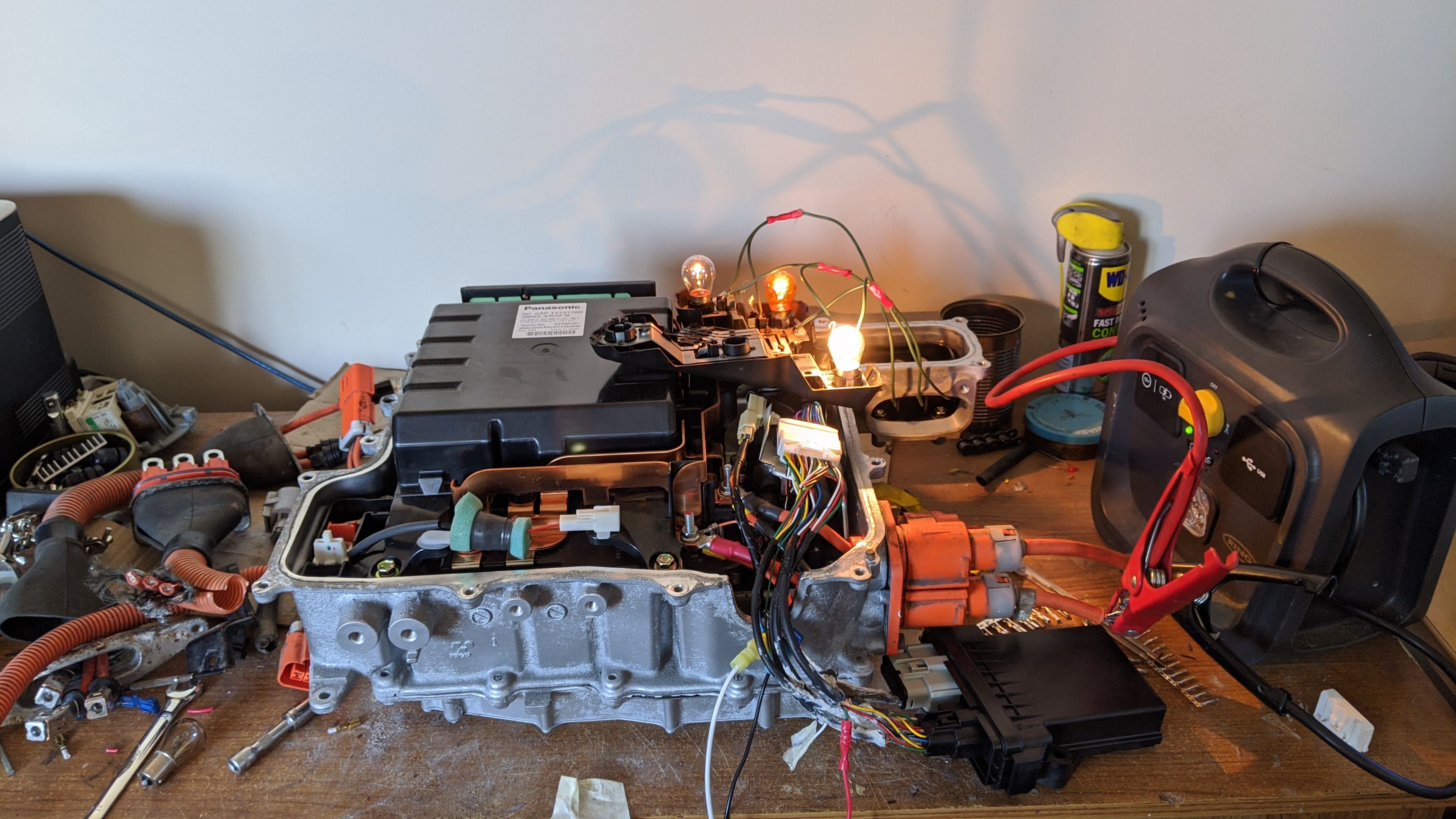

Got the delta lights to flash using manual mode. Used the settings that Retrozero used as well as connecting inverter MSDN pin to the 12v supply.
I was expecting each light to flash in series. What I got was all lights flashing at once but at different levels of brightness. Is that the correct outcome?
- Posts: 3795
- Has thanked: 166 times
- Been thanked: 411 times
Hm... that would be consistent... you are using incandesent bulbs. I used LEDs so i guess filament doesnt cool down very fast. Maybe you could command it 0.3Hz slip? That should make each light flash 1 second apart. What deadtime are you using?LRBen wrote: ↑Thu Jul 16, 2020 6:55 pm Got the delta lights to flash using manual mode. Used the settings that Retrozero used as well as connecting inverter MSDN pin to the 12v supply.

Yeah, that's what I got. Good to see another 12v start up in progress.
I didn't touch deadtime. Left it as I found it. Don't have values with me, but I think it was 26...

Using 0 deadtime. Tried it again at 0.3Hz slip. Now they all flash at the same time in one second intervals.
- Posts: 3795
You may want to use Deadtime 160 to start with. Remember Damiens gen3 destruction story?
It is just empty space between pulses. If it is too wide it doesnt hurt. If it is too short on other hand...
No we are on a gen2 here. The lower channels remain unused, the power stage creates its own deadtime. Leave it at 0 or it will distort your waveform.
