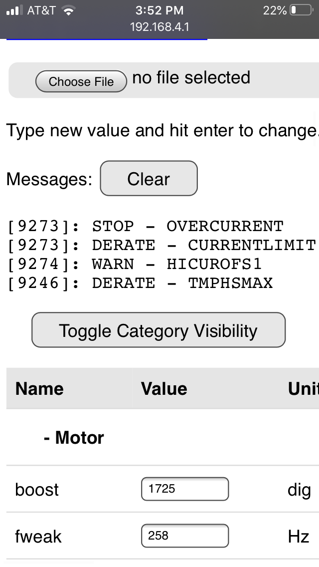

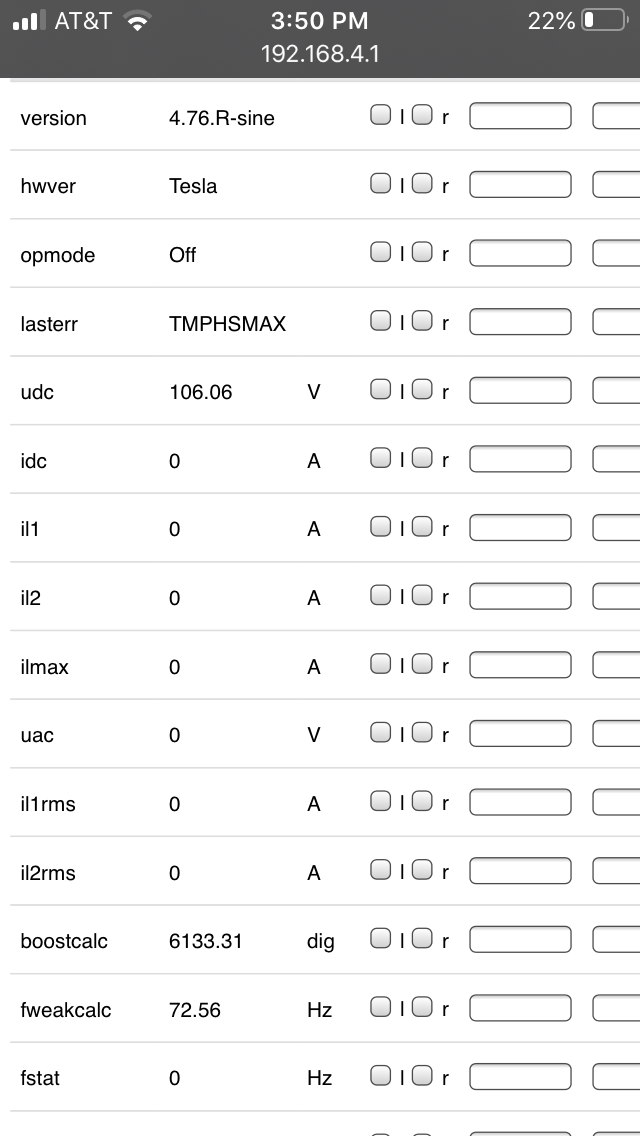

Starting for the first time error codes
Hello, I read through the forum and guides and searched for my problems but could not find the answer.
I'm testing my motor with one Chevy Volt battery that gives 89VDC.
Everything is wired correctly. I started by calibrating the accelerator pedal values. No issues.
Secondly, I changed my UDCMIN to 0 and my UDCSW to 79.
When I flip the ignition switch the precharge relay comes on and I measure 86.6VDC out of the contactor to the motor. The precharge resistor stays on and does not turn off after the ignition is turned on.
I get the following error messages with the ignition on-
302- derate- TMPHSMAX
11- warn- HICUROFS1
1- warn- PWMSTUCK
When I flip my start switch the precharge relay goes off and the main contactor clicks on and off. I get the following messages after the start switch is pushed-
3894 derate CURRENTLIMIT
3895 warn HICUROFS1
3866 derate TMPHSMAX
3894 stop OVERCURRENT.
Is this happening just because I'm testing with lower voltage? I don't want to damage any components and it seems like these codes refer to too much current draw and too high of temperatures.
This board came fully populated and I did not adjust any parameters besides the ones mentioned above.
Thanks!
11- warn- HICUROFS1
1- warn- PWMSTUCK
3895 warn HICUROFS1
Thanks!
What is your ocurlim and idcmax limit set to?
Have you tried uploading a known config like this? https://github.com/damienmaguire/Tesla- ... arams.json
idcmax is 5000
ocurlim is -2500
those were the parameters the board came with.
I have not tried anyone's parameter settings.
I see the ocurlim default is 100 but my board came with -2500 as the setting. Should I change it to 100?
ocurlim is -2500
Try lower udcmax of like 100 , looks like you are allowing more current than your overall current limit?
I tried to lower udcmax with no results
I changed ocurlim with no results

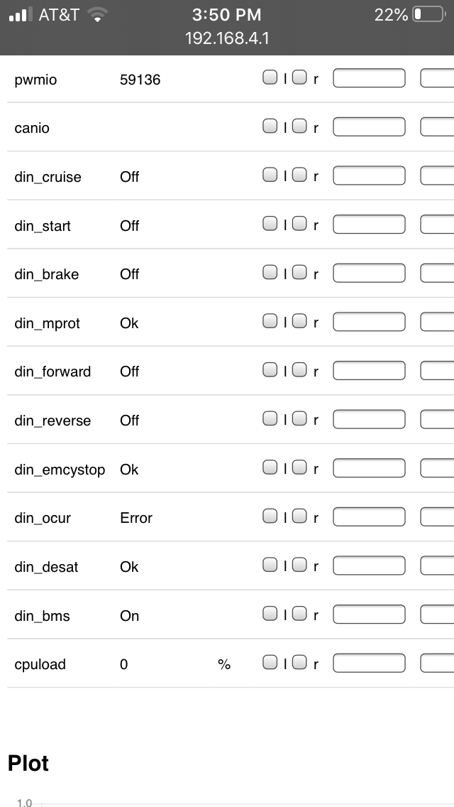

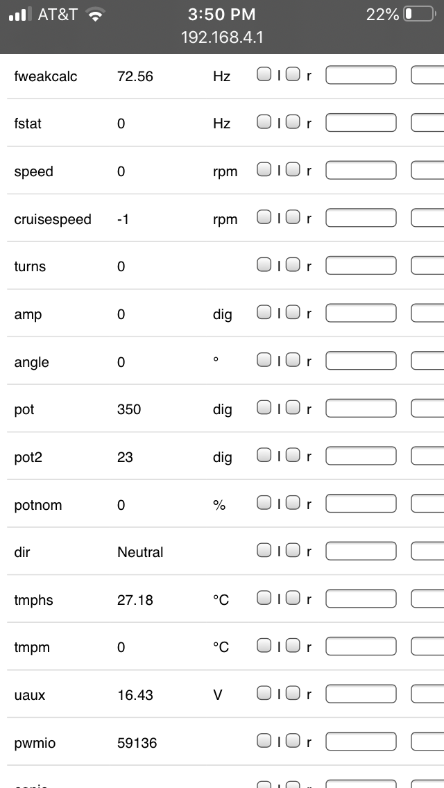

I started watching spot values and noticed potnom jumps between 0 and 9%. Tmphs jumps between 100c and 23c and tmpm jumps between 0c abs 23c. I plotted them on a graph and they jump up and down like I see them on auto refresh.
Also my din_ocur always reads error. I Data logged din_ocur and got 0
I data logged all the amp and voltage readings through flipping the Start switch and they read 0 the entire time before and after.
In general the web browser sometimes doesn’t load the parameter and spot data and I have to turn ignition off and open a new browser sometimes multiple times to get it to load.
Could there be something wrong with my board?

I think that the overtemp is pulling back the throttle (derate) Looks like you have similar temperature reading issues to those I was having - for me it was caused by one of the mux select pins not being set as an output correctly in software. That fix is posted in the small drive thread, but you'll need to remap it for the large drive unit sensors as I didn't have one to go through... Are you experienced with programming?

Very true, I would say the overcurrent stop is the reason the main contactor is cutting out immediately - what are your spot current values before start pulse is sent? high current offset you are getting before start when everything should be near zero...

I don't know the overcurrent behaviour well, but sounds like the fault condition is already there and is only reacted upon when trying to go into start. Can you share your spot values after precharge? Hopefully somebody with more experience will be able to add more suggestions

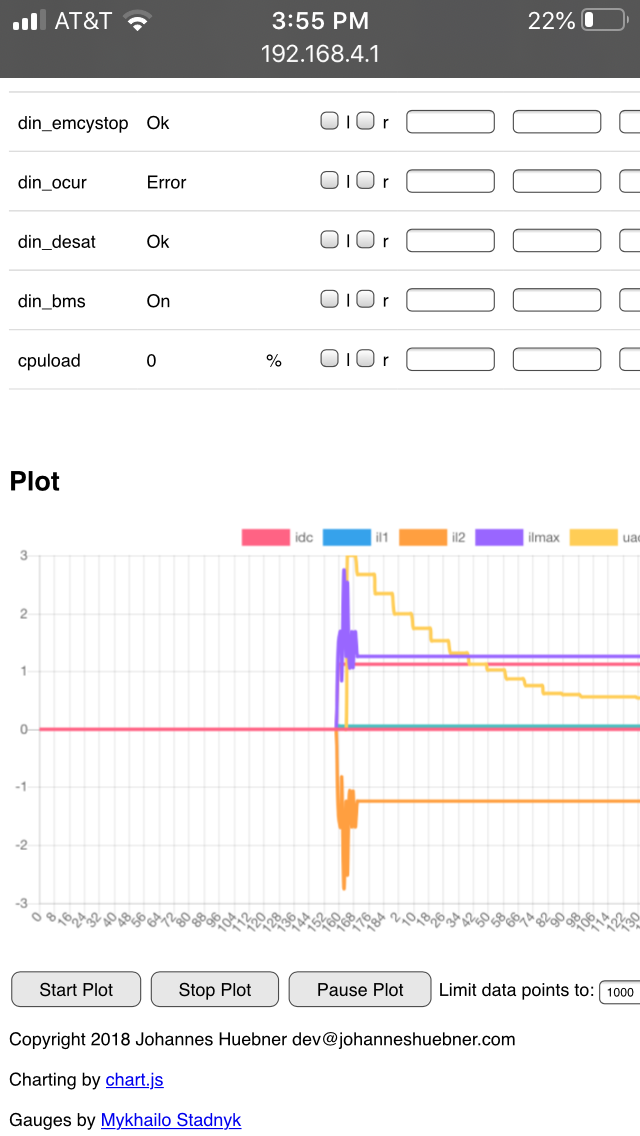

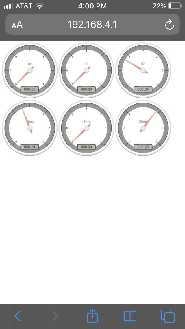

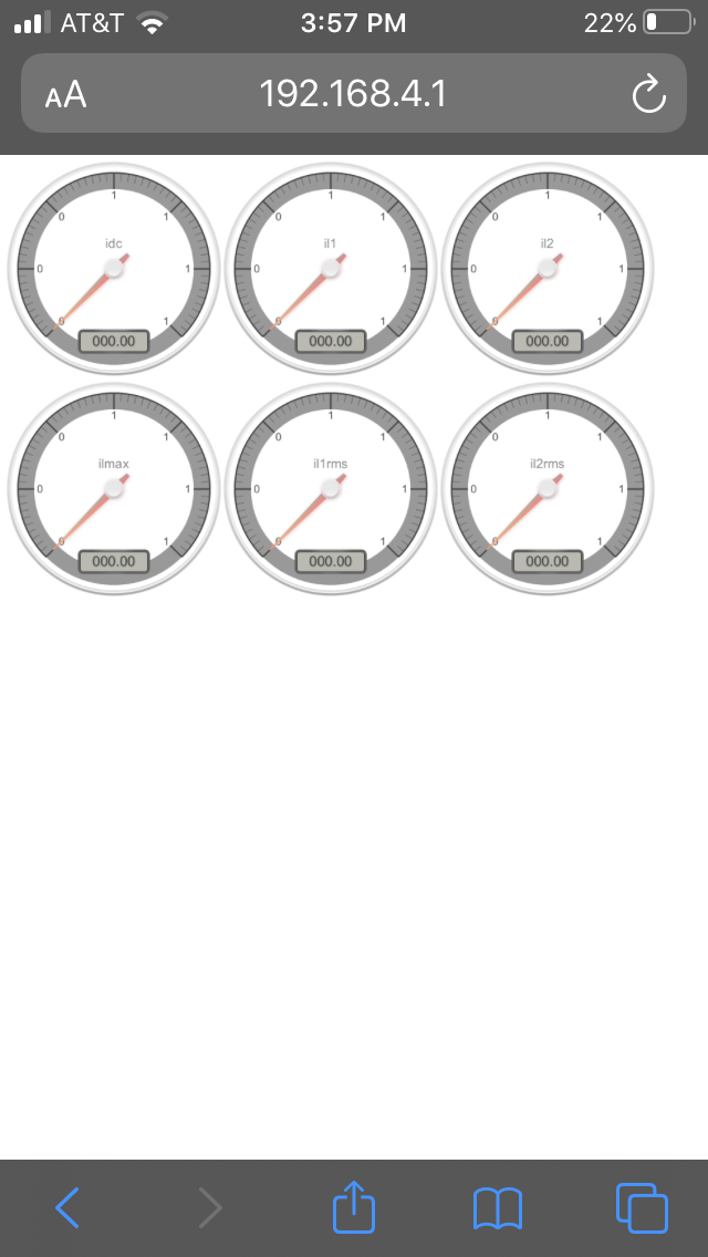

Here are my spot numbers and plots.
The spot numbers are ignition on with a successful precharge (DCV is 106)
The plot shows everything measure in amps before during and after the starter switch is pushed and the main contactor goes on and off within a second.
The gauges show 0 before the starter switch is pushed
The second gauges show the values after the starter switch is pushed.
I updated the firmware to the newest version available.
Any help figuring out the issue is appreciated.
