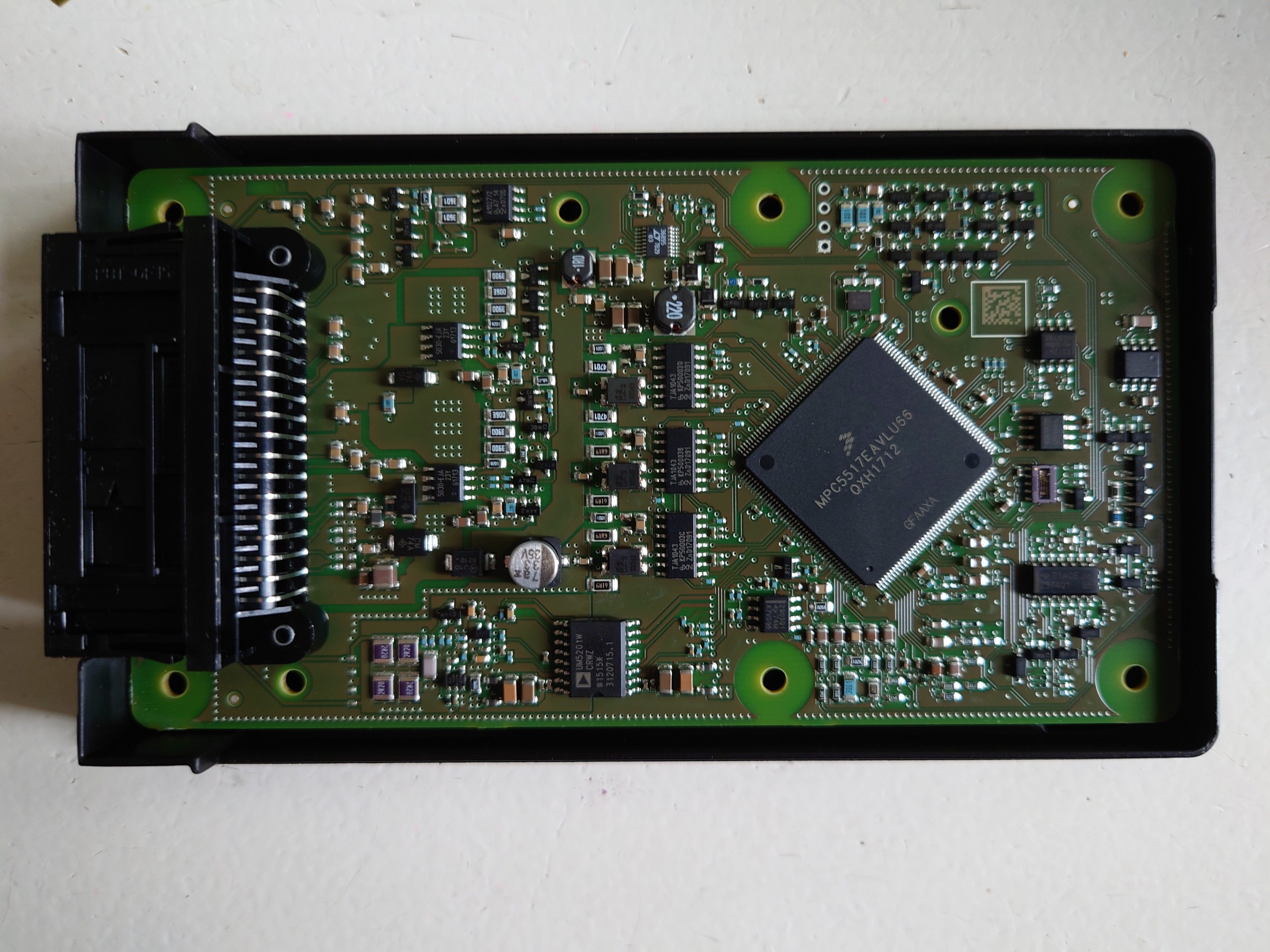

Hi Tom, any luck with VW balance magic?
Here is a E-golf gen2 BMC ECU
Posts: 2460
Location: Bristol
Has thanked: 216 times
Been thanked: 606 times
Re: Simp BMS
None as I have yet to get a pack myself that is willing to balance or someone who has a can capture showing balancing behaviour.

JaniK
Posts: 395
Has thanked: 58 times
Been thanked: 14 times
Re: Simp BMS
Post by JaniK »
tom91 wrote: Thu May 27, 2021 8:42 pm None as I have yet to get a pack myself that is willing to balance or someone who has a can capture showing balancing behaviour.
OK, so puzzle is missing some pieces, do you need CAN capture from pack in car, or if it does it without car, should that be enough..?
Bigpie wrote: Fri May 28, 2021 7:14 am Have you tried fuzzing in savvycan? I have some spare slave bms pcbs and 12 18650s that I'll be trying that with when I get chance. Might have to replace one of the balance resistors with an led or something.
Not yet, I have got a mcp2515 and some Arduino boards for testing, allthough might just be a lot easier to plug SimpBMS into the controller and see what happens, but I want to get the mcp2515 working because I bought it for this.. I am allready out of my area of expertise, but you gotta start somewhere. :P

JaniK
Posts: 395
Re: Simp BMS
Post by JaniK »
I have traced the BMC wiring and plugged in 5V to VW battery packs CAR side connector to see what happens. Nothing happened, except the board drawing 70mA of current. 8-) Oh well, I think I am missing some enable signal/wire/command maybe.
There is 2 CAN buses in the black round connector outside of VW battery pack. Only if I had a working E-Golf now to see how it should work.
I wonder about 4 the pin through hole section on board, on top of the MCP5517, there is +5V and GND (square) and 2 (data?) in the middle. Maybe I plug in serial there to see if it is that easy? :mrgreen:

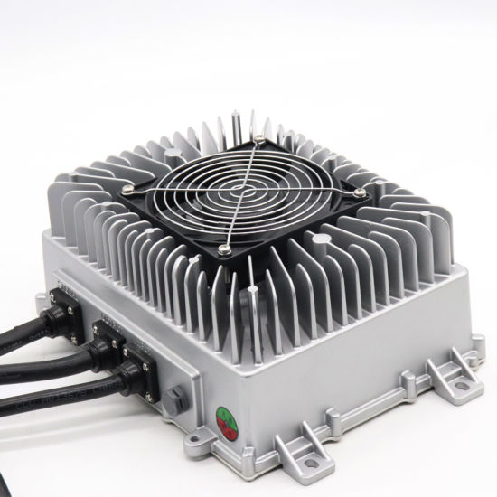

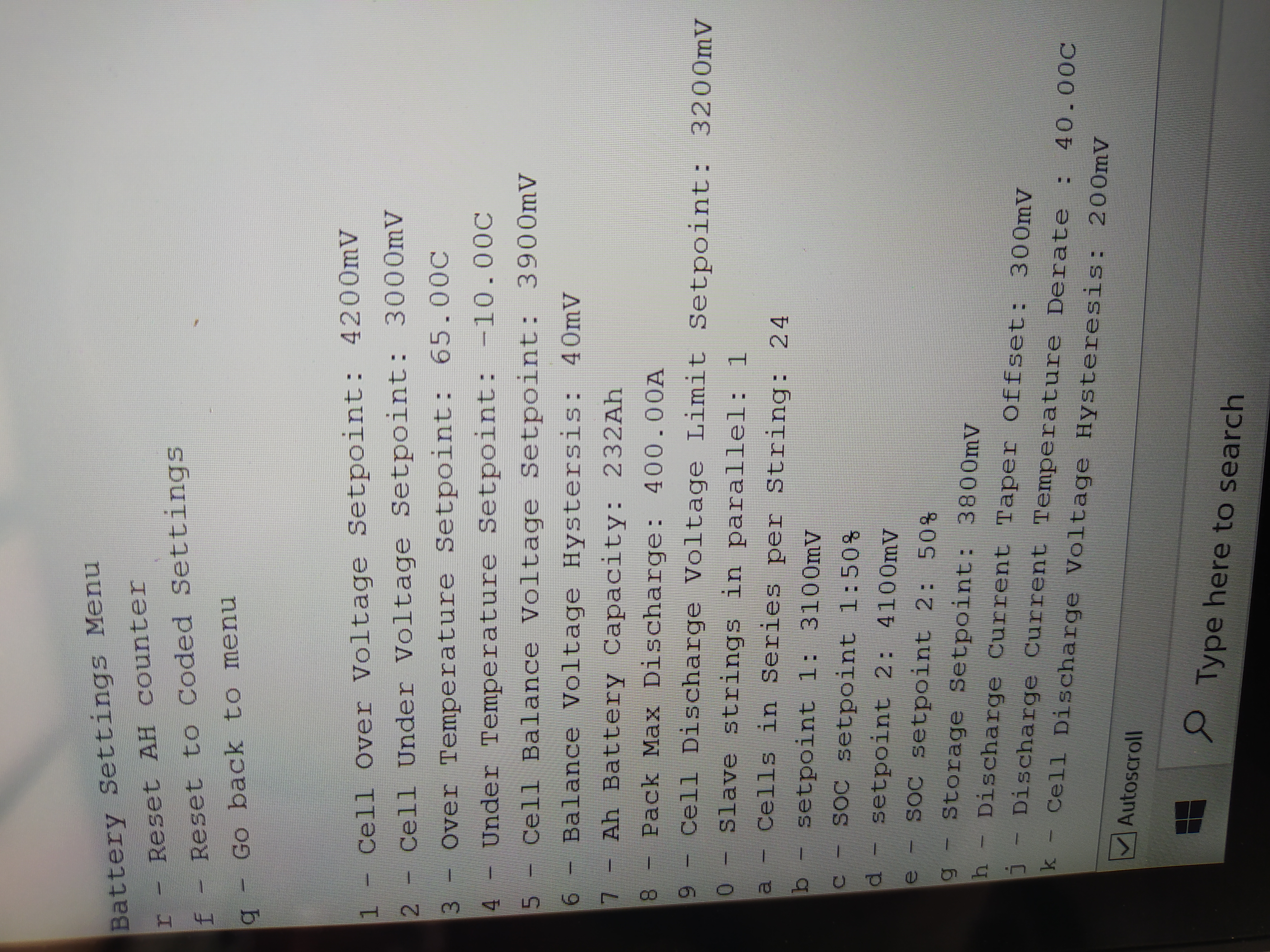

Got my SIMP communicating with my "elcon" charger. The charger flashes red and the fan kicks in but there is no output whatsoever... tested with clamp meter and is reading 0A also no voltage whatsoever. The simp is happy and believes its charging.
I ordered an Elcon UHF 3.3kw charger from evlithium and after 4 months they sent me out a knock off basically and refused to replace it with a genuine elcon charger. be careful of this company!!!..apparently the can comms is identical to the elcon and it is communicating. Evlithium aren't being that helpful, I presume it must be a fault with the charger itself perhaps an inboard fuse has blown ?
Modules are tesla x 4 serial. currently sitting at about 88v.
please see image charger, the information on it is terrible/non existent!!
Also my settings...
Many thanks!

Re: Simp BMS
why is cell votlage limit set to 42000mV instead of 4200mV?

Post by Jackk »
tom91 wrote: Mon May 31, 2021 10:22 am why is cell votlage limit set to 42000mV instead of 4200mV?
not sure have put it to 4200mv now.
on the main screen its saying no charge current limit set but it is set to 35A on the charge setup...also the CP current limit is fluctuating quickly from zero up 4000A in a random fashion.
BMS Status : 3 Charge | AC Present | 24
Out:0010 Cont:0000 In:0010 Charge Current Limit : 1 A DisCharge Current Limit : 400 A CP Current Limit: 1800A No Charge Current Limit
BogdanT
Posts: 9
Joined: Thu Dec 17, 2020 7:52 am
Location: Romania
Re: Simp BMS
Post by BogdanT »
Looks like a TCCharger, they should work fine.
This is a long-shot, but try setting param 6 Charger CAN msg spd to 1000ms (1 sec).
LE: is it flashing only Red? or combination Red/Green?

tom91 wrote: Tue Jun 01, 2021 12:11 pm Please leave the CP input disconnected for testing. What do you have connected?
If nothing is connected please tie this input to 12V.
The CP is connected to pilot out from simp charge via a 5k resistor... this pin appears to be getting voltage once charge has initiated but the voltage isn't steady... around the 3v .
OK so i pulled the CP pin all together and now getting a nice 30A from the charger!! SUCCESS IT WORKS! but what about the CP line? what is its purpose? why was it stopping the charger outputting...
Thanks!!
Posts: 2460
Location: Bristol
Re: Simp BMS
Jackk wrote: Wed Jun 02, 2021 9:44 am
Thanks!!
The manual states this feature is still under development. I have not yet had time to fully finalise it. The CP line is a PWM signal used to determine the
maximum allowed AC current the charger can draw. The biggest challenge will be getting it reliable, as it will be some what susceptible to noise.
