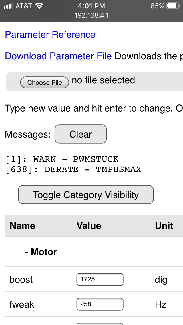

I’ve completed the testing and here are my results-
Ignition on (no hv, no start signal)-
Test point #45 = 1.76vdc
Test point #58 = .202vdc
error codes-
Pwmstuck
Hicurofs1
Tmphmax

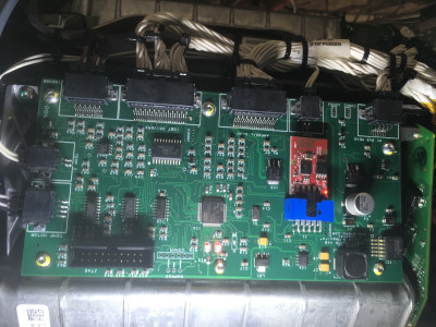

A high resolution photo of the inverter board might help us spot a problem.

Attached is a hdr photo of the board. Tested pin again and now it has .037v and it’s back to overcurrent stop as soon as the start signal is sent.

First comment... I see you're using EXRAD shielded cables and the shield is not stripped clear of the core conductor (most obvious on the first contactor visible in the video). Are you sure the shield isn't shorting to ground somewhere or even providing an intermittent contact for power?
Other than that, I can't see anything and hopefully someone with LDU experience will step in now

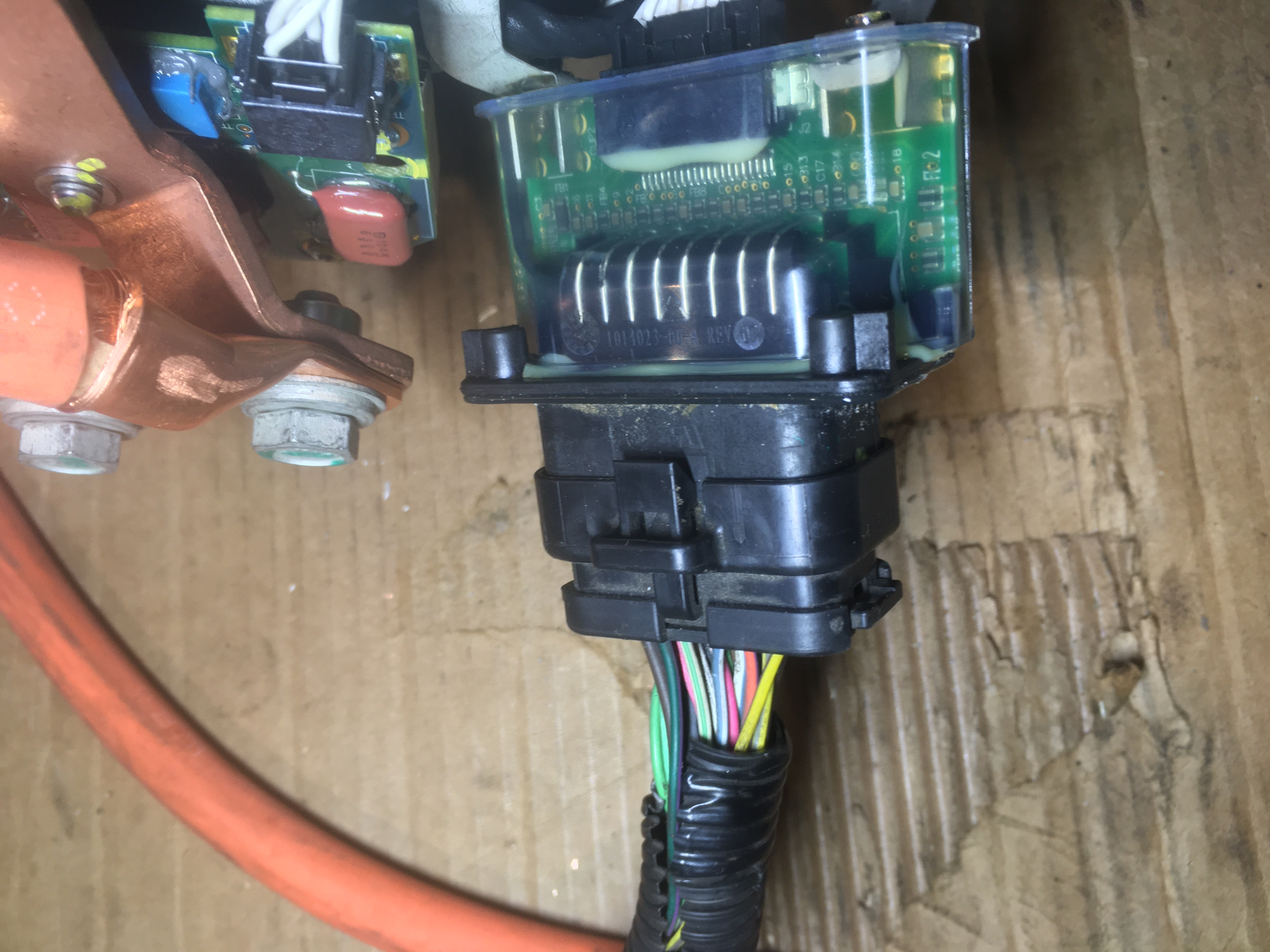

I figured out the issue.
After testing the current sensor A circuit I discovered pin 2 on harness 13 does not have 5V.
For proof of concept, I jumpered pin 10 on harness 15 that provides 5V for current sensor B to pin 2 and all the values on the test points for the current sensors were equal and the motor would start and spin without throwing an overcurrent code.

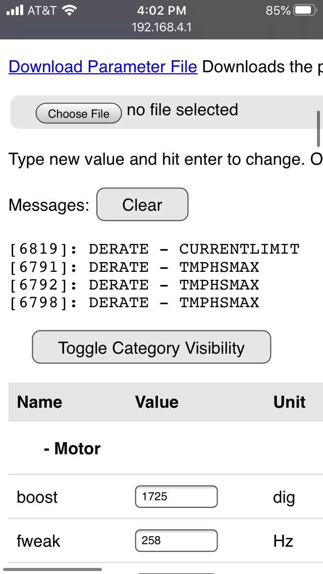

I still get tmphmax derate and current limit derate codes
After I took the board off I was able to see why there was no 5V on the pin. The connection between the harness socket and the board was not connected as is displayed in the video below. Hopefully I can get a new board that will solve all of these issues.

Excellent work fault finding. This is the sort of thing I'm trying to encourage because although painful it ensures a level of knowledge about the circuit that will be invaluable for future support. It's kinda hard to see for sure in the video but is the pad lifted from the board or is the solder joint between the pad and pin broken?
Regards the derate errors are they warnings or errors? Warnings would be normal as not all motor temp sensors are implemented in the code.

I believe the pad is still connected and the solder joint is broken, but I will take a close look today and confirm. Here are photos of the exact errors I’m getting even when jumpering the bad connection.

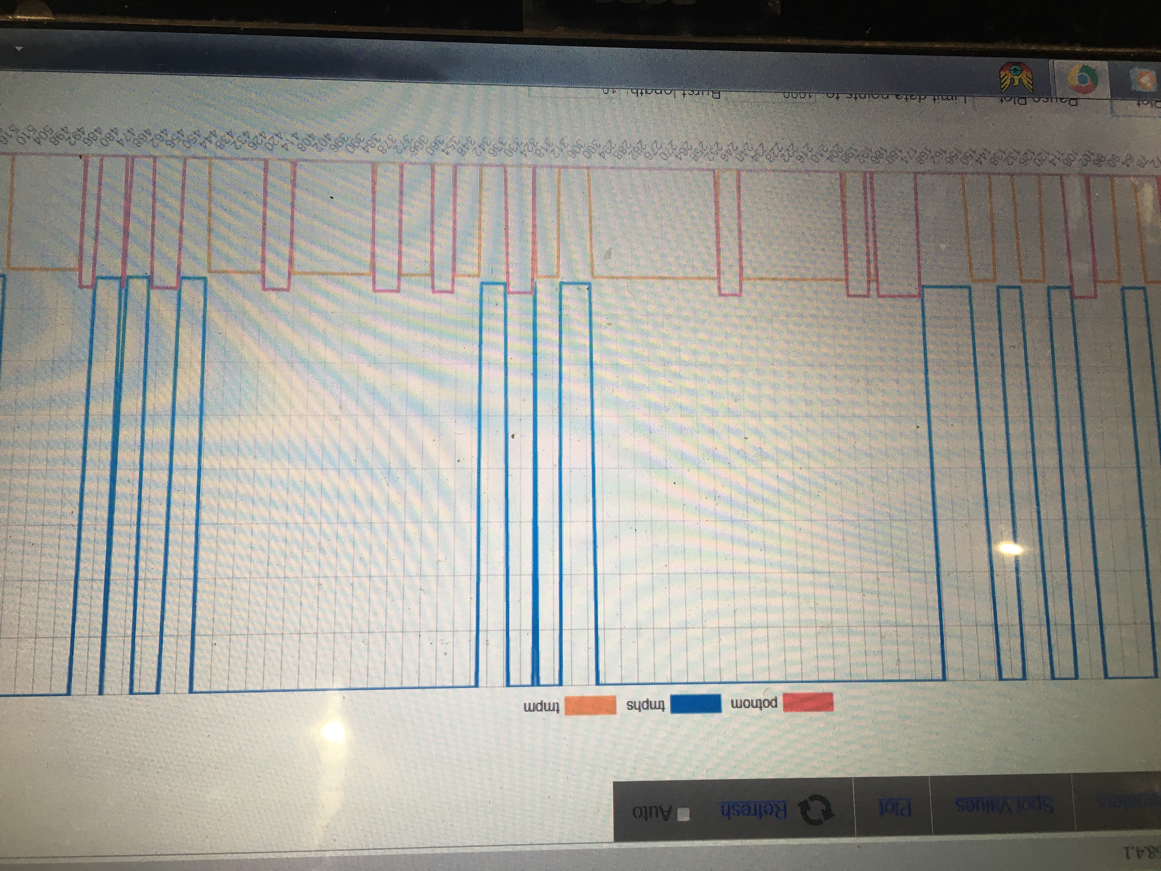

For the temp, I can see it toggle between 100C (maxed out) and 23C (actual temp) so I’m assuming the overtemp code is because of the toggling to max temp every couple seconds.

Hmmm...sounds like you may have another open solder joint on one of the heatsink temp sensor pins. It would be worth checking on the igbt driver plug on the logic board.
Also check the mux select pins are both toggling if you have a scope. This looks like issue I had, the randomness was from the temp values changing rapidly as the wrong inputs were read in - then being sampled for the graph at a lower rate.
