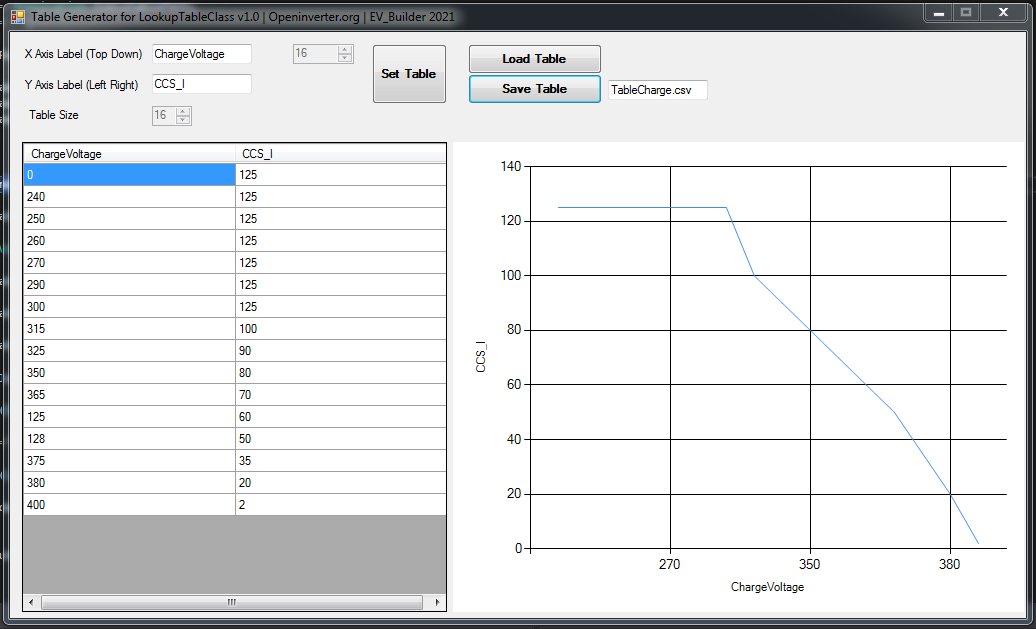

Ok lets start first with a Simple 2D one.
GUI app is done.
Now the C++ Class which will be fed with this data :).
This can be used for all sort of mappings/tune-ings not only charging so i kept it Universal. (so maybe a move to the VCU section is better?).

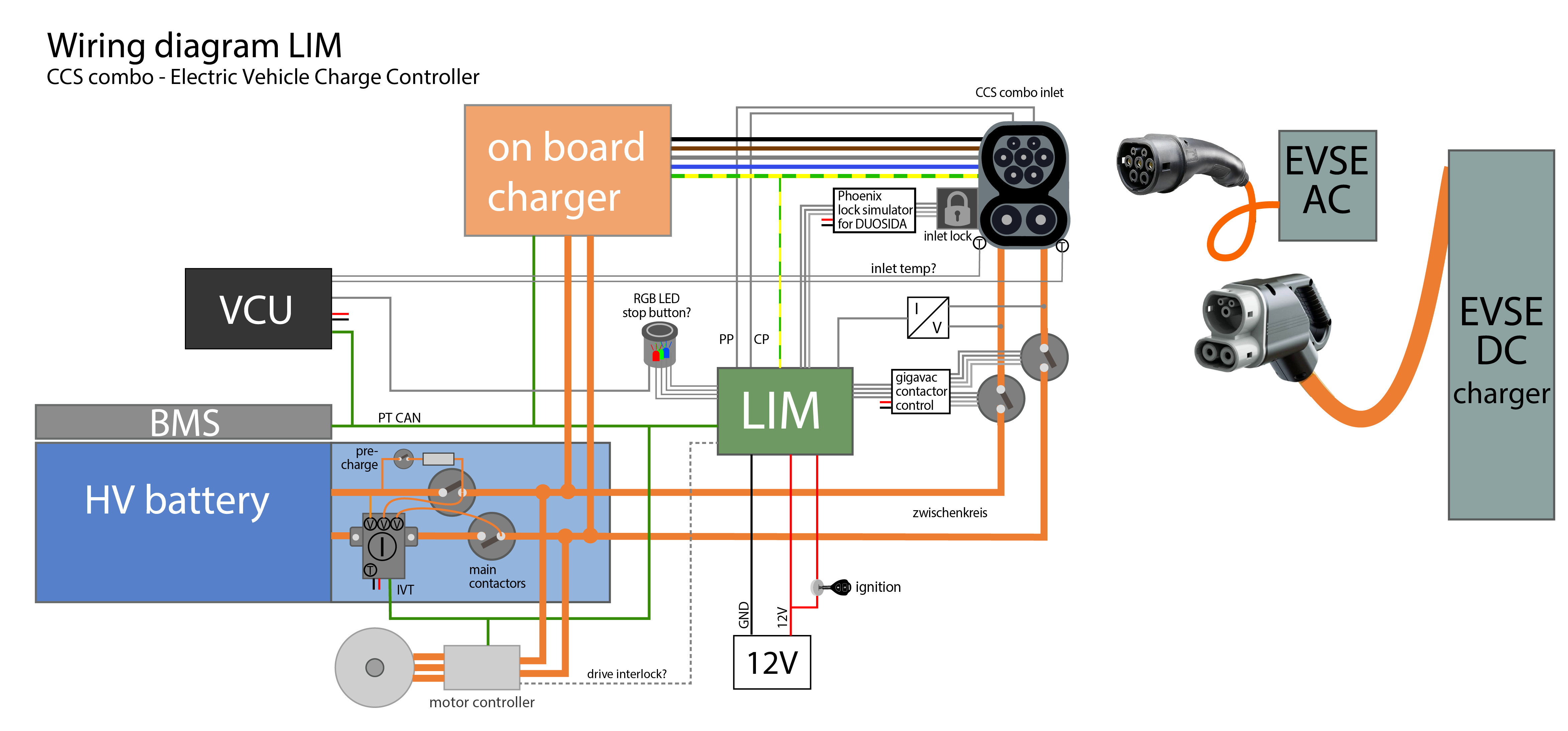

I have a few questions:
- Has someone tested to directly control the DUOSIDA servo lock with the LIM?
Is it enough if I add the two resistors to the lock feedback?
- How about the RGB LEDs? Can I wire it without additional series resistors? How much current can the LIM deliver?
- Since there is no stop charge input on the LIM, could we wire the stop charge button to the VCU and terminate the session over CAN?
- @muehlpower how far is the design of the voltage sensing board?
We could also measure the inlet voltage with the Isabellenhütte IVT and generate the current signal from the information on the CAN bus if we want.
- Are you using the Gigavac contactor feedback signals to emulate contactor failure?
- Does the i3 measure the CCS inlet temperature? Are there any thoughts about it?
- Are there any ideas about a 12V drive interlock signal?
Attached a basic schematic CCS setup with the LIM.

Posted: Wed Jun 16, 2021 12:42 pm
by muehlpower
your graphics are good and almost correct. You should also add the main contactors. Make the voltage inputs of the isa shunt between the main and DC contactors and the third voltage input directly to the battery. The main contactors must also be controlled including the pre-charge relay, e.g. from the VCU. On the charge port only the voltage is detected, no amps. On my LIM 1B-1 and 1B-2 are not connected (not populated on the LIM PCB) 1B-14 is in the LIM connectet to GND. 2B-6 is on US models (CCS-1) connected to PP (2B-2).
Posted: Wed Jun 16, 2021 5:04 pm
by bitterandreal
muehlpower wrote: Wed Jun 16, 2021 12:42 pm your graphics are good and almost correct. You should also add the main contactors. Make the voltage inputs of the isa shunt between the main and DC contactors and the third voltage input directly to the battery. The main contactors must also be controlled including the pre-charge relay, e.g. from the VCU. On the charge port only the voltage is detected, no amps. On my LIM 1B-1 and 1B-2 are not connected (not populated on the LIM PCB) 1B-14 is in the LIM connectet to GND. 2B-6 is on US models (CCS-1) connected to PP (2B-2).
Thanks for the corrections. I changed the pinouts in the wiki.
Sure the main contactors need to be closed with a pre-charge first. Could be done by the VCU or by the BMS. Depending on the setup.
But does that matter for the LIM?
In which state is the LIM expecting the battery voltage on the zwischenkreis?
Is the timing when the main contactors are closed very critical?
All CCS setups I saw used the IVT to measure the voltage on both sides of the DC charging contactors. No additional voltage measurement was necessary.
As I understand the LIM has the voltage measuring board in the KLE and does expect both the battery and "zwischenkreis" voltage on the CAN bus. I changed the diagram.
Do you actually have the IVT on the battery side of the main contactors?

Now it looks good to me!
In my opinion, it doesn't matter what the main contactor controls. It's not time-sensitive either. The LIM needs the analog signal for the voltage from the charge port to work, it is not enough to send something over CAN. It need also the feedback from the Charge port door on the right pin, simulatet or real. It only carge with open door and does the weld test only at closed door.
Posted: Wed Jun 16, 2021 8:22 pm
